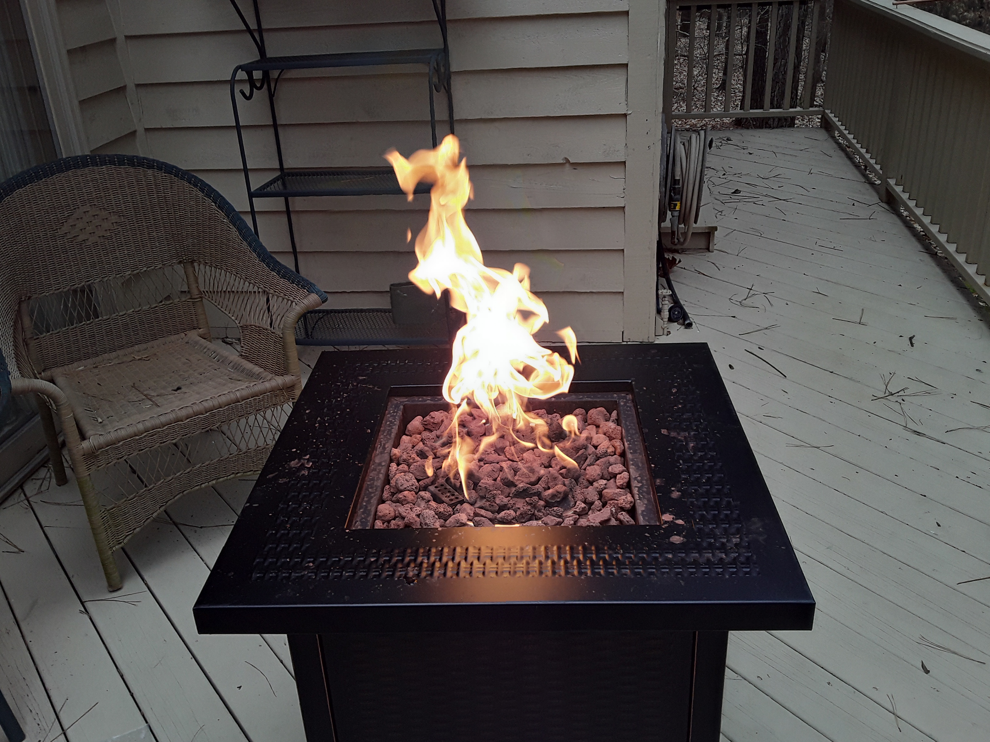

Well, there were three problems. I didn't know that the necessary tipping of the tank to get it inside the fire pit would trip the the tank's tip over safety feature. (THANKS, GM) Second, something that wasn't explained in the instructions, the fire pit gas control valve has to pushed in not only to turn the knob (which I knew) but must be HELD IN for a bit to let the gas continue to flow. Third, there are no service facilities in the US and not much help from the Chinese customer support. Those three things compounded and had me buffaloed.
While it was disassembled, I hot-rodded it a bit. A small orifice in one fitting was drilled out to let more gas thru.
Seems it's always the little things you don't know that mess you up. Thanks to TS.ORG, it's all good now.
The control knob can be turned down to low so the flame isn't that high but I like it high.
