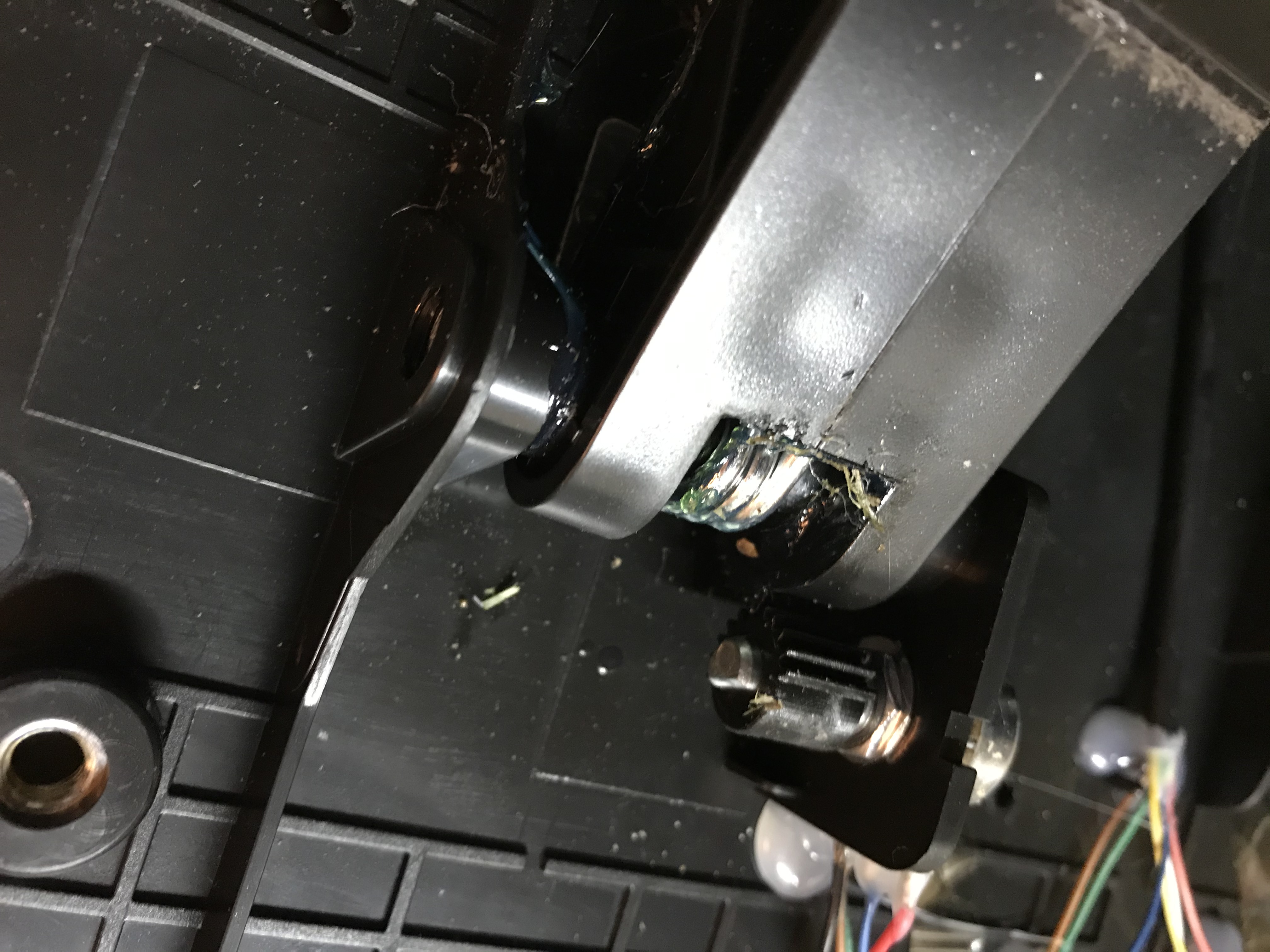

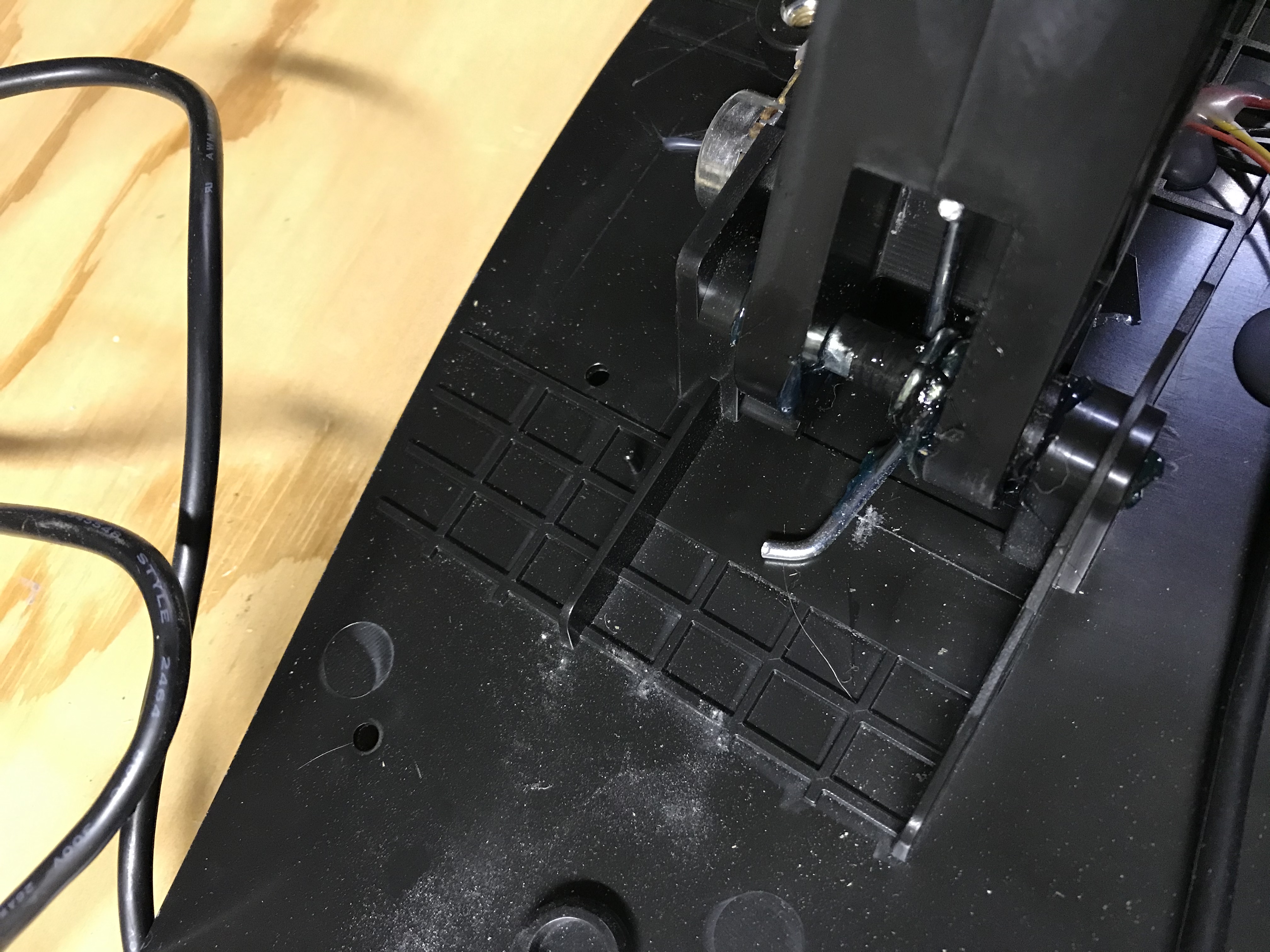

- partially remove the pin for the gas pedal arm - push it from the inside out it should slide out - far enough to get the spring out

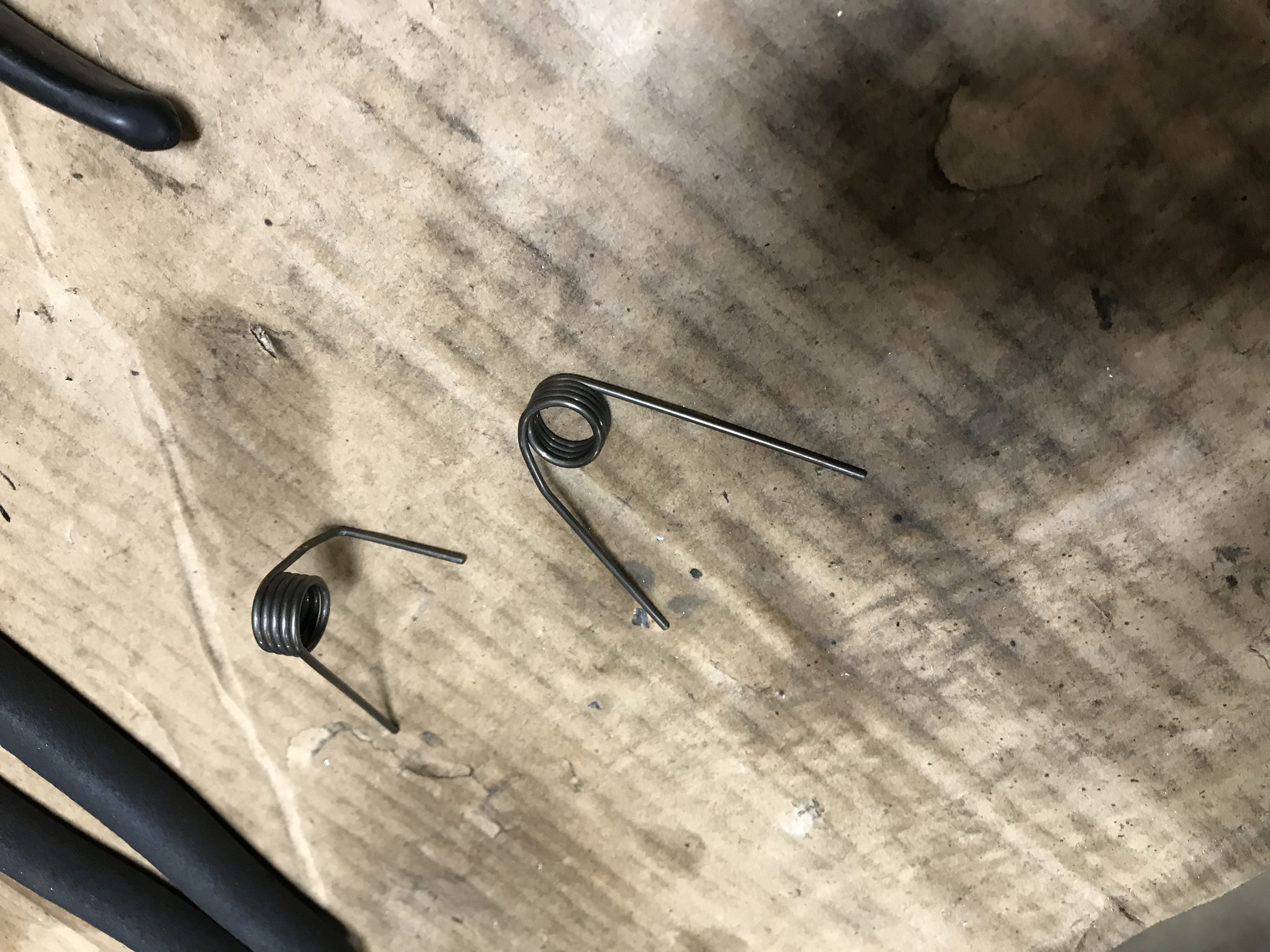

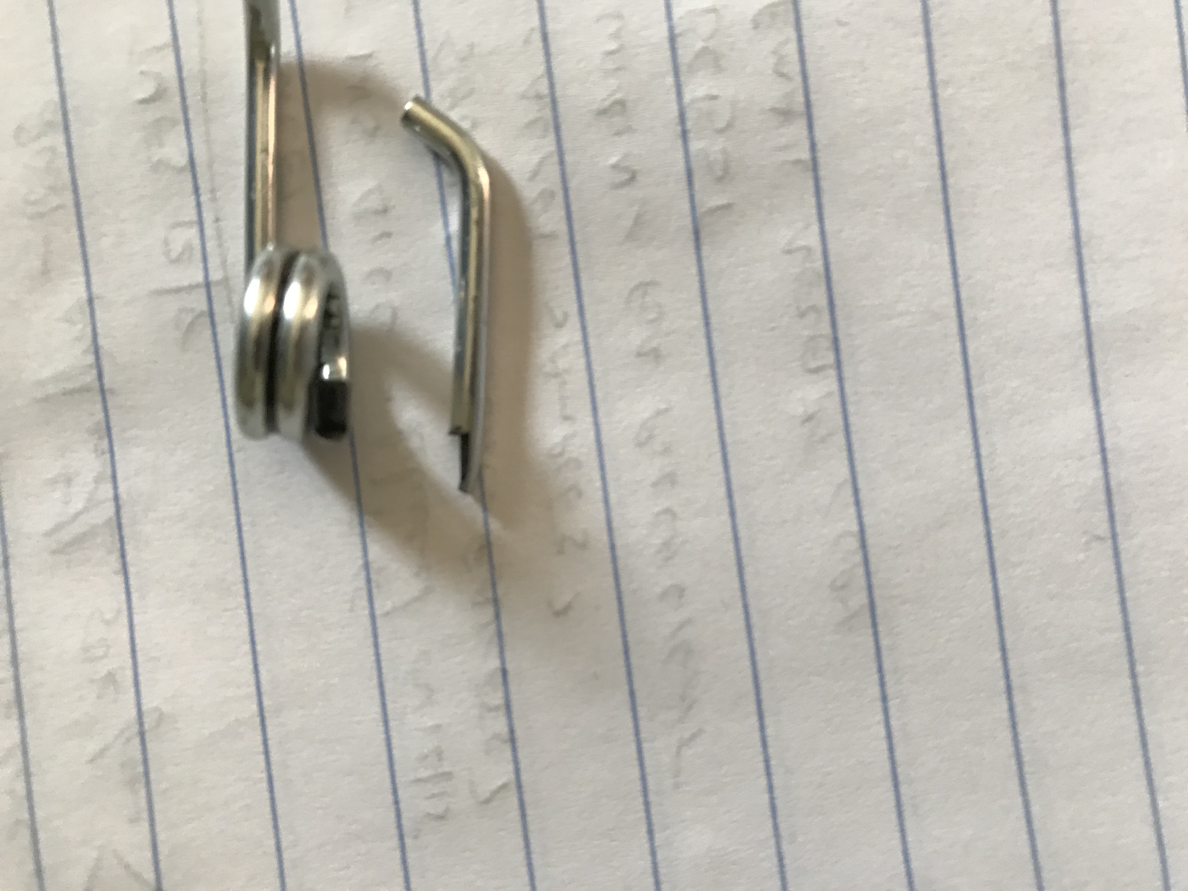

Upon removal the last thread failed and this spring broke in half.

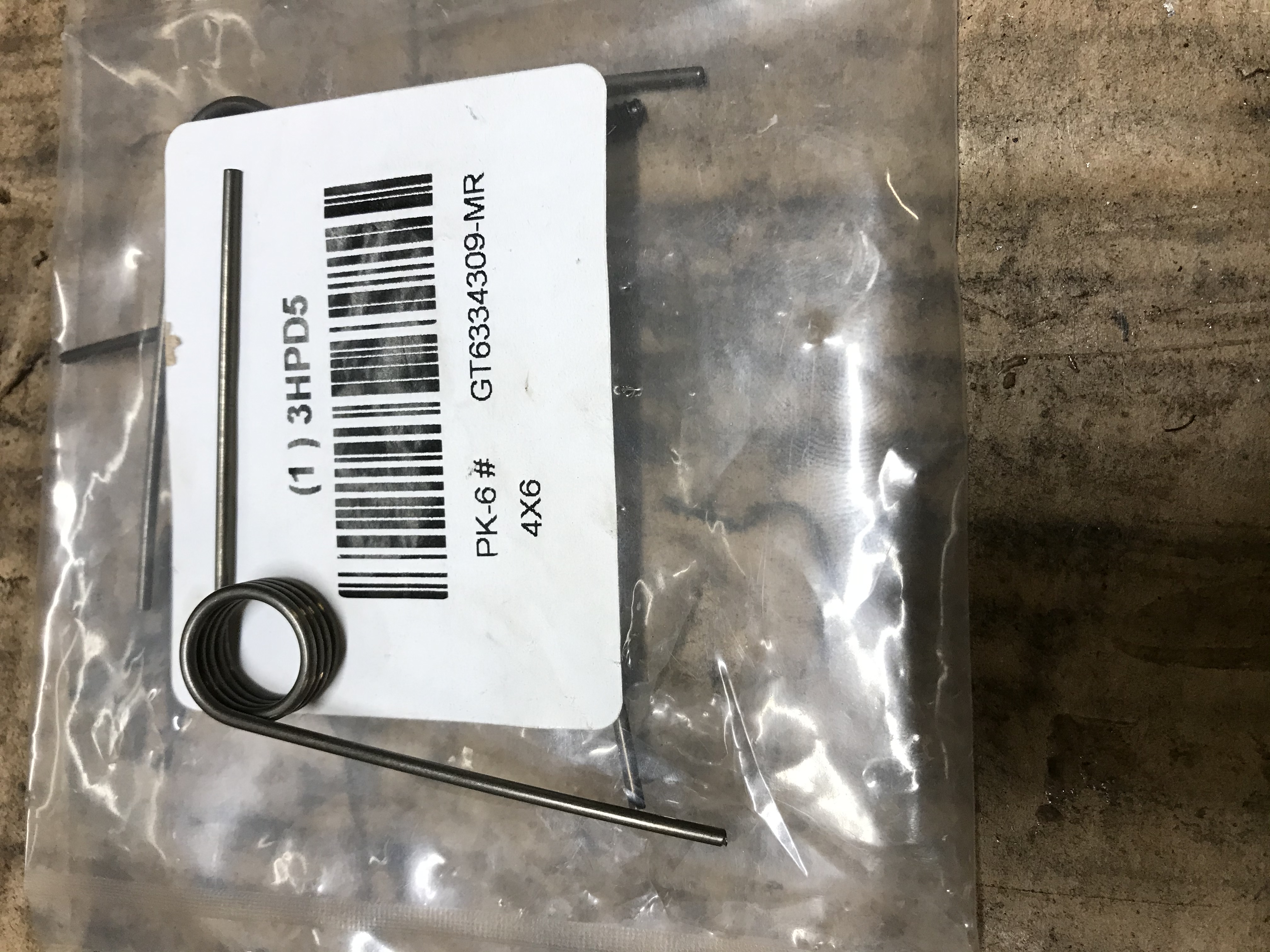

Here are the replacement springs I bought
2) Get a replacement spring. There is more than one way to do this
- Option 1: If your unit is < 1 year old Thrustmaster will send you a replacement. Mine failed after 8 months. I cannot attest to quality of replacement but I wanted something from a better quality wire.
- Option 2: Get a replacement torsion spring and configure it to work with this unit. The original has .090" diameter wire, the loop is .505" outside diameter and something close to .305" inside diameter, and the arms are 1" long and in 45 degree configuration.
- I located a torsion spring on Grainger.com - well I had to buy a pack of 6 and pay $10 shipping so cost was just over $20. I chose one with .06x diameter, figuring I wanted a little less torsion on the plastic parts. This worked, but the tension was quite low, so I ended up using two of them.

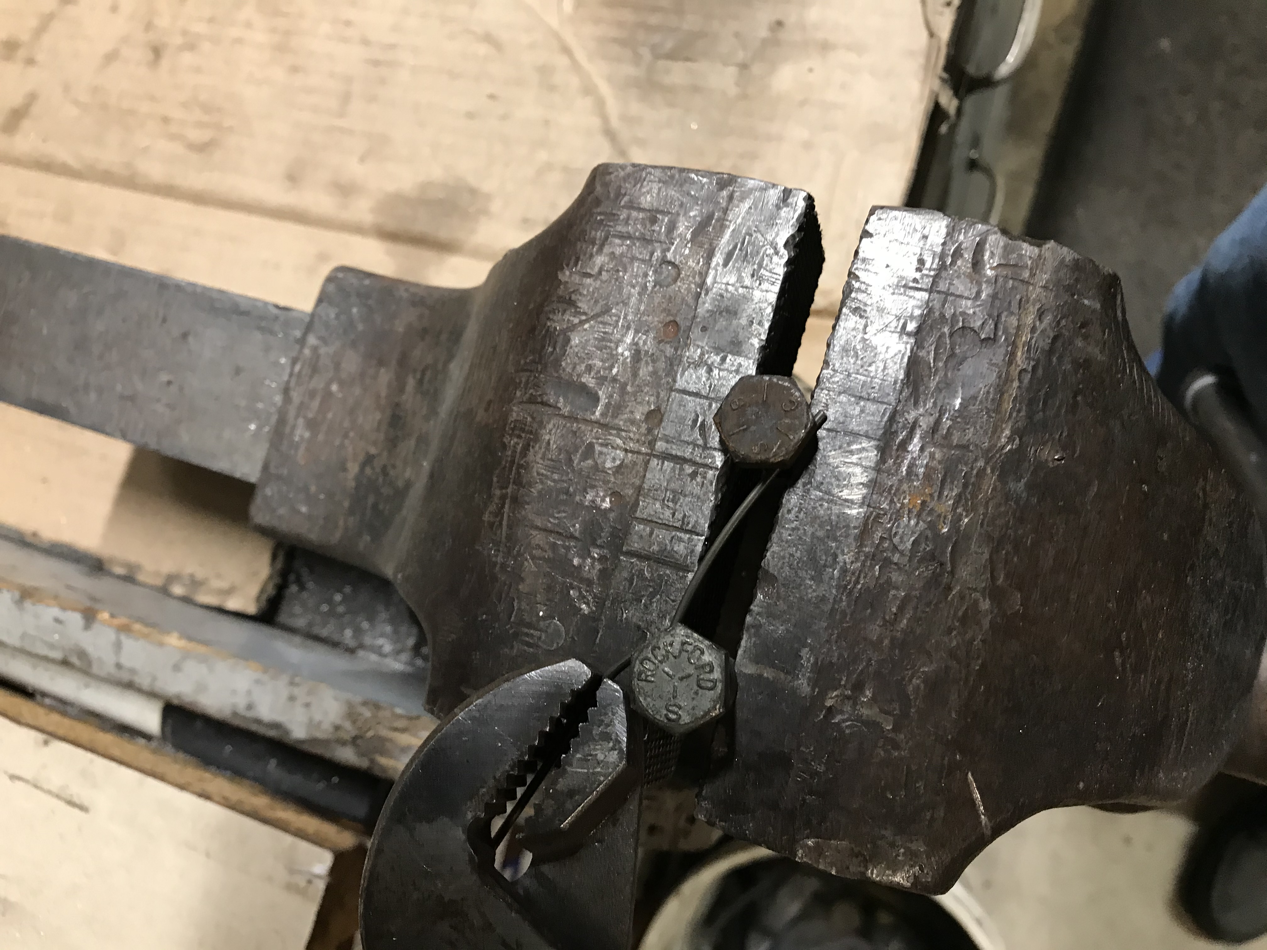

- the torsion springs I selected had 90 degree configuration so I chose to bend them to something close to 45 degrees. There are YouTube videos on making a torsion spring (like this one: https://youtu.be/aT8ET5t6f20 ), the same method applies. This is best done with the help of a bench vise.
- The torsion arm did need to be shortened on the pedal arm side
- after that I chose to bend the arm that would contact the pedal arm.

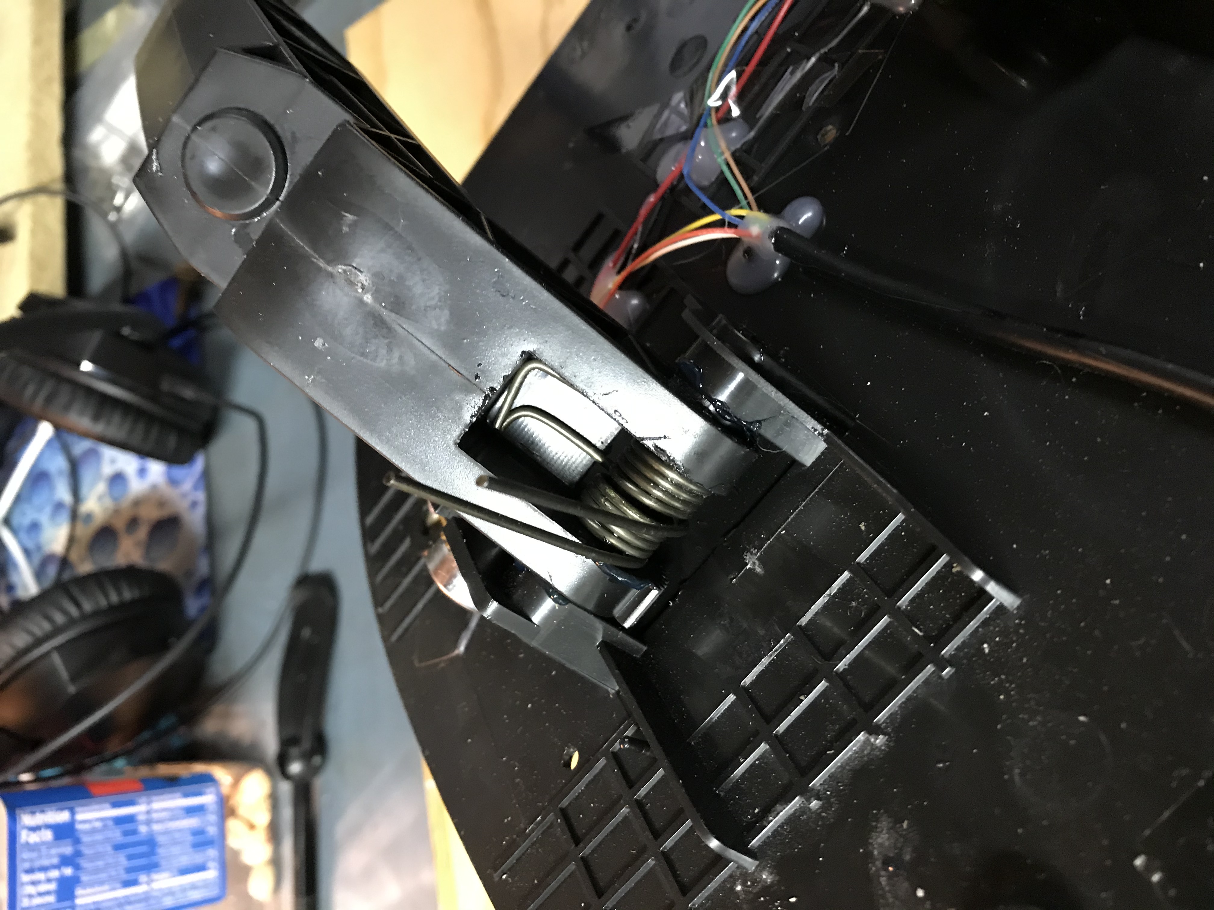

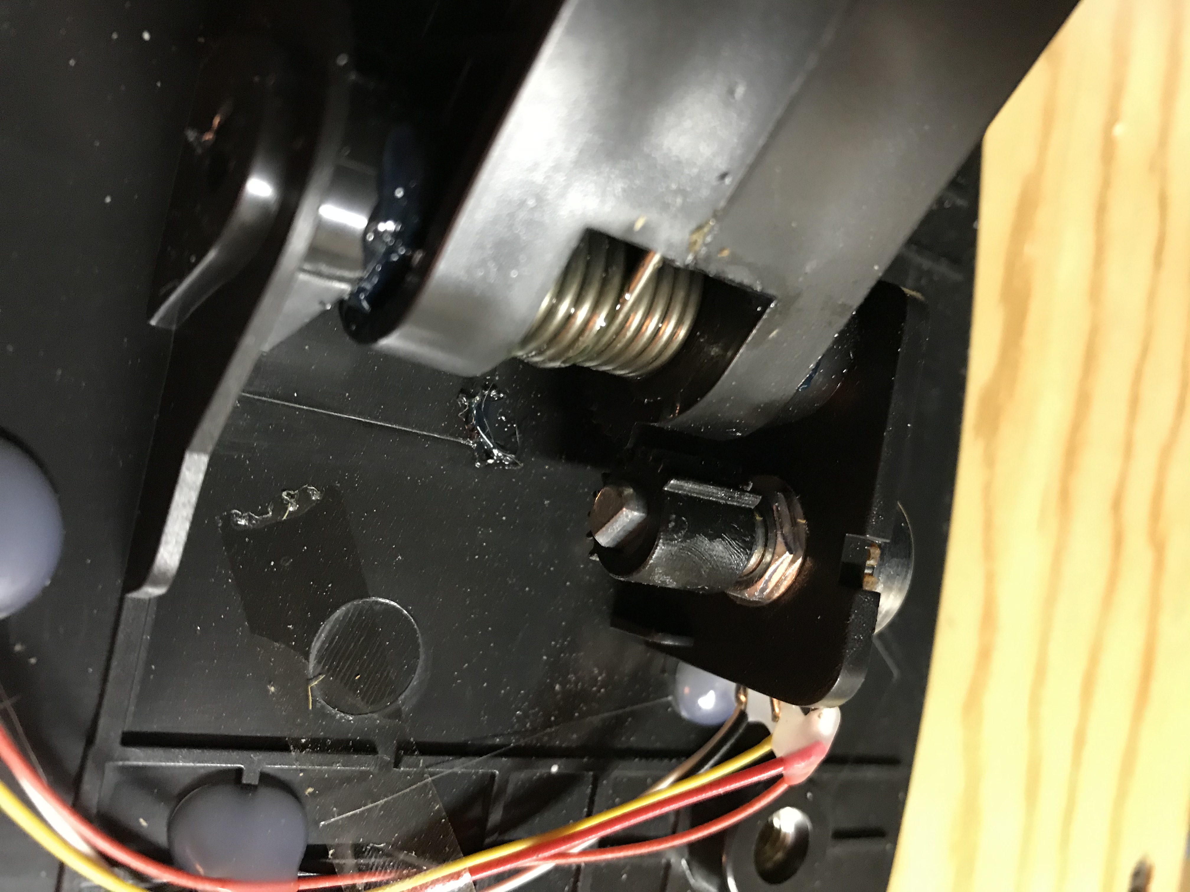

- install the new torsion spring and push the pin back in for the gas pedal
- install the top cover and hold them together by hand
here is what the dual spring setup looks like installed:
