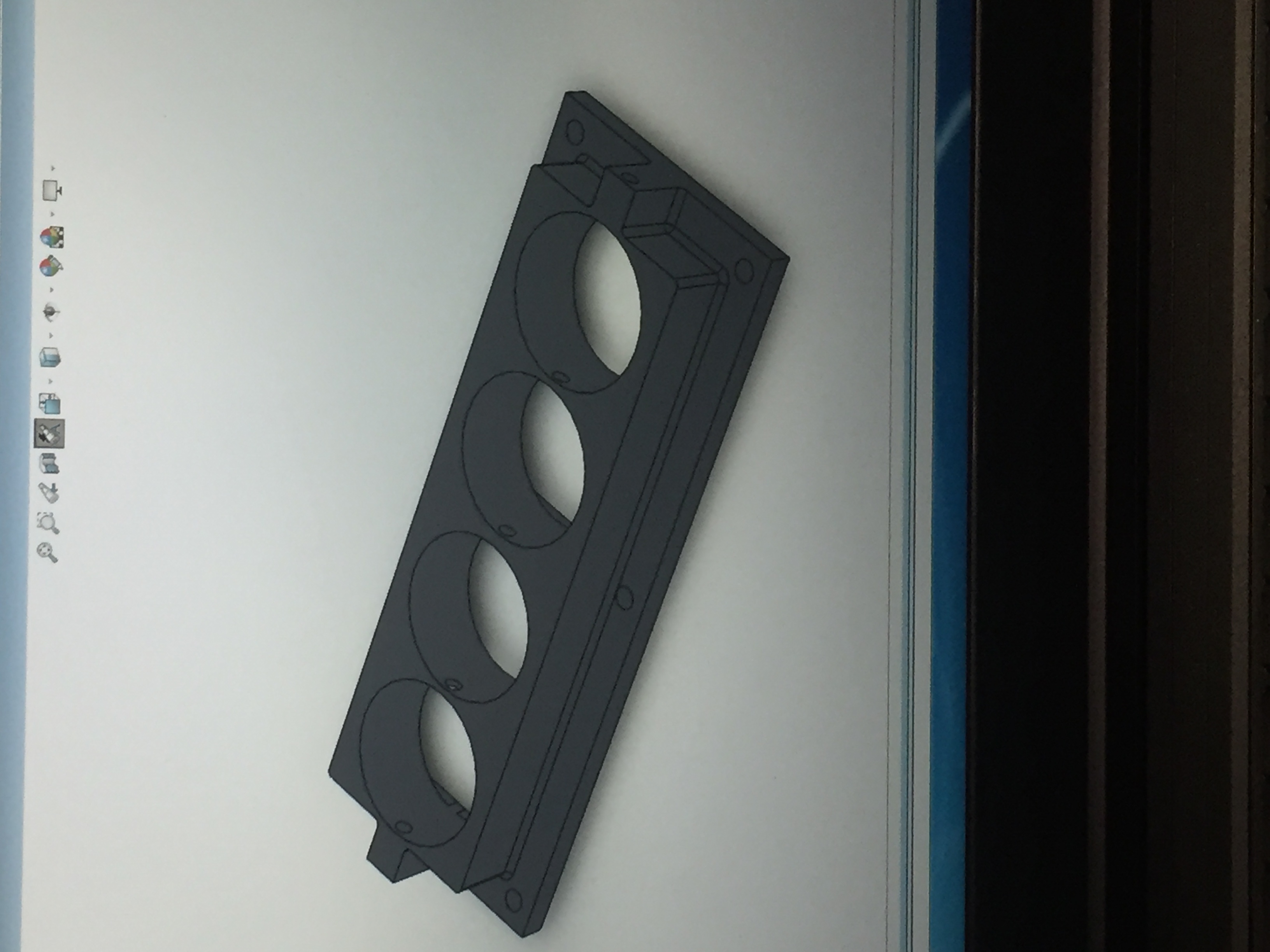

My next folly begins! (Forgive me as I try to inject a little humor here and there) Anyways back to the project - Operation Cheap Bastage Fuel Injector. Yes I already have a 4 port on the dragster. Yes, there's nothing earth shatteringly new or different - I just want to blend a couple existing ideas that I think are cool. So let the chips fly AND the one's and zero's get shuffled! Basically I'm attempting to build a low-profile 4port with a Scott top. Pretty much trying to combine what is easy to work on with what I think looks the best. Time will tell whether it'll FLY or SINK!

Yes, pretty much. Except I want it SUPER low profile and with a Scott top (the scoop fromMad Max)

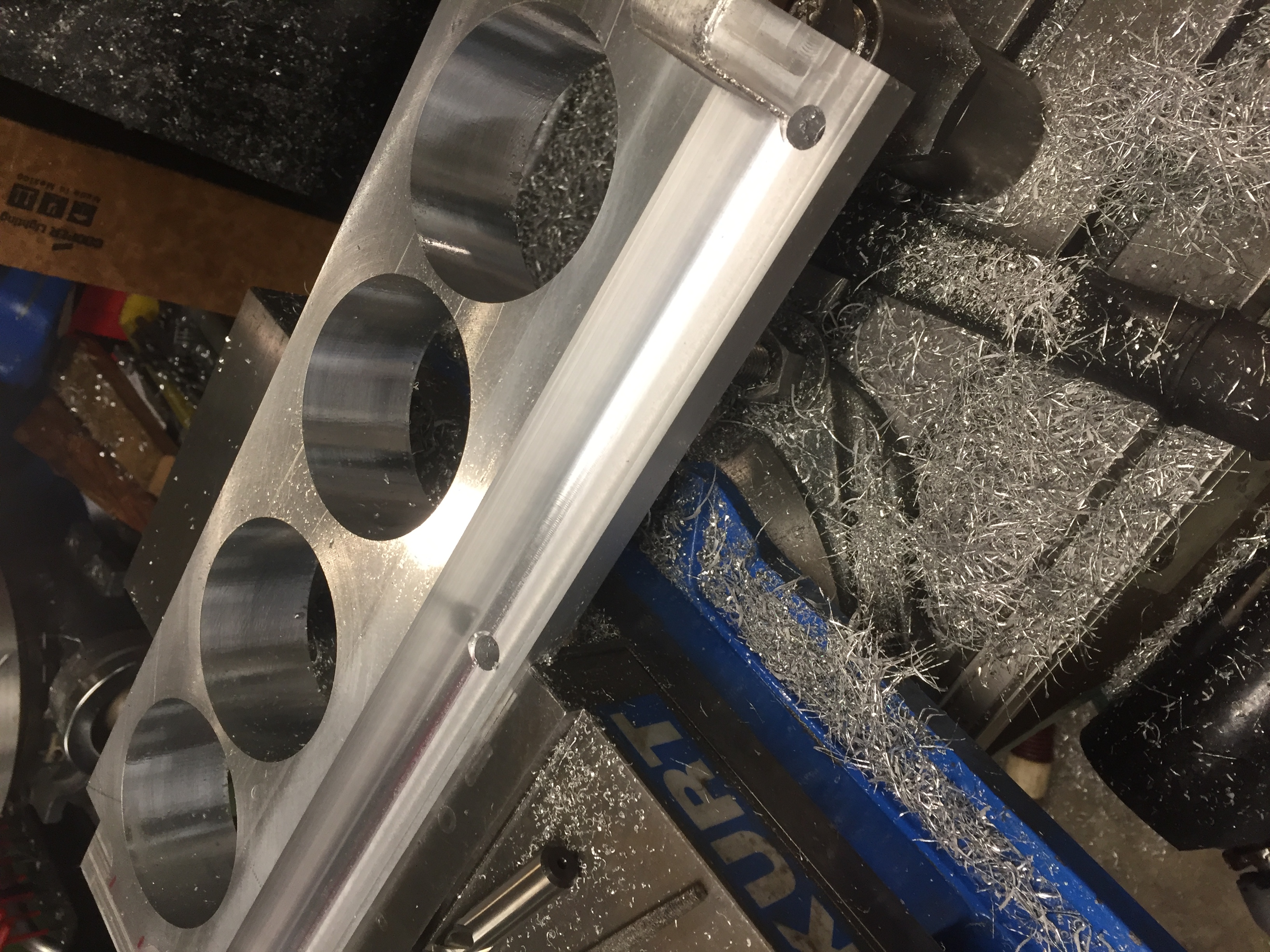

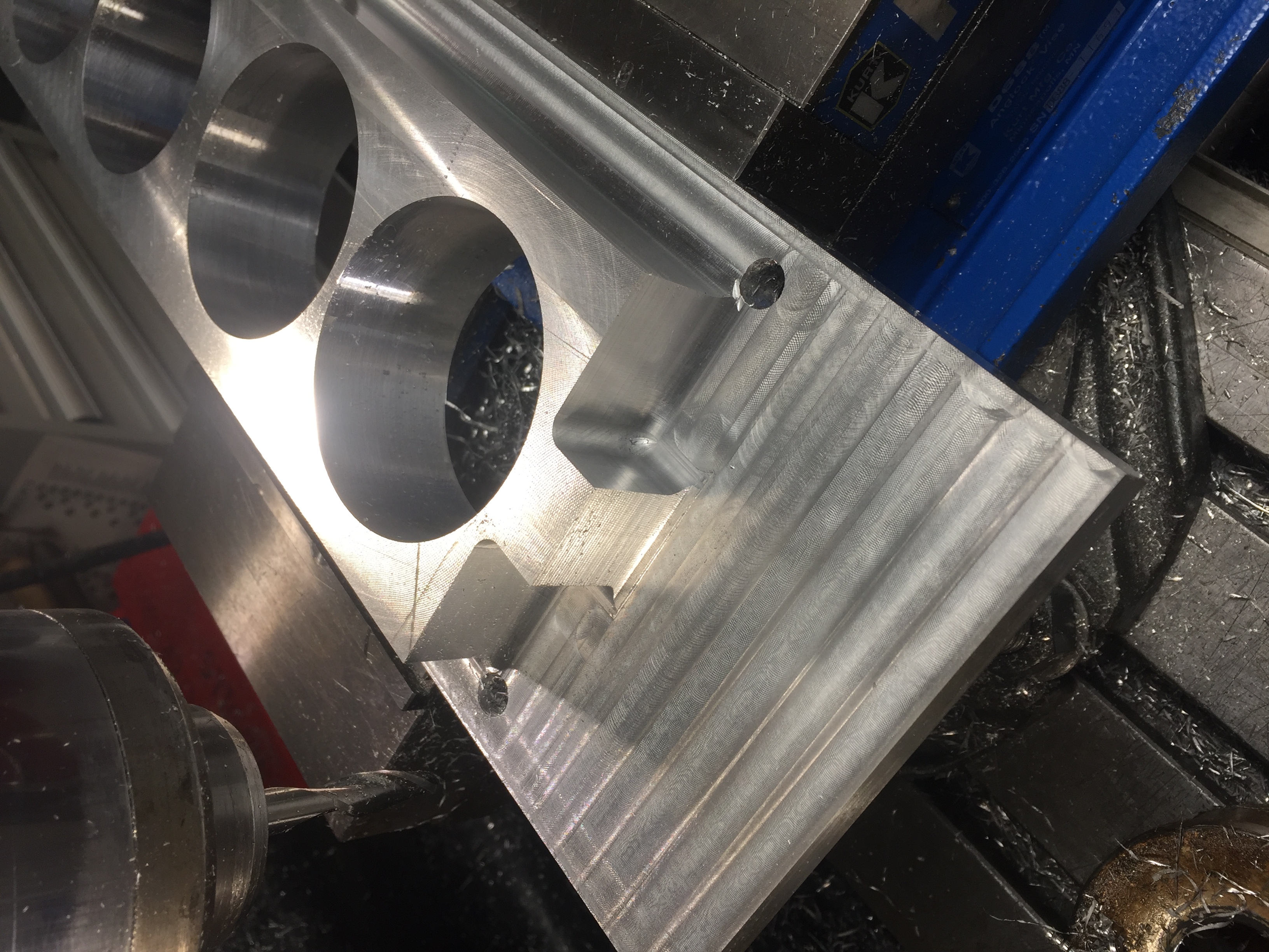

A little progress..bores are .040" under- will finish bore near last

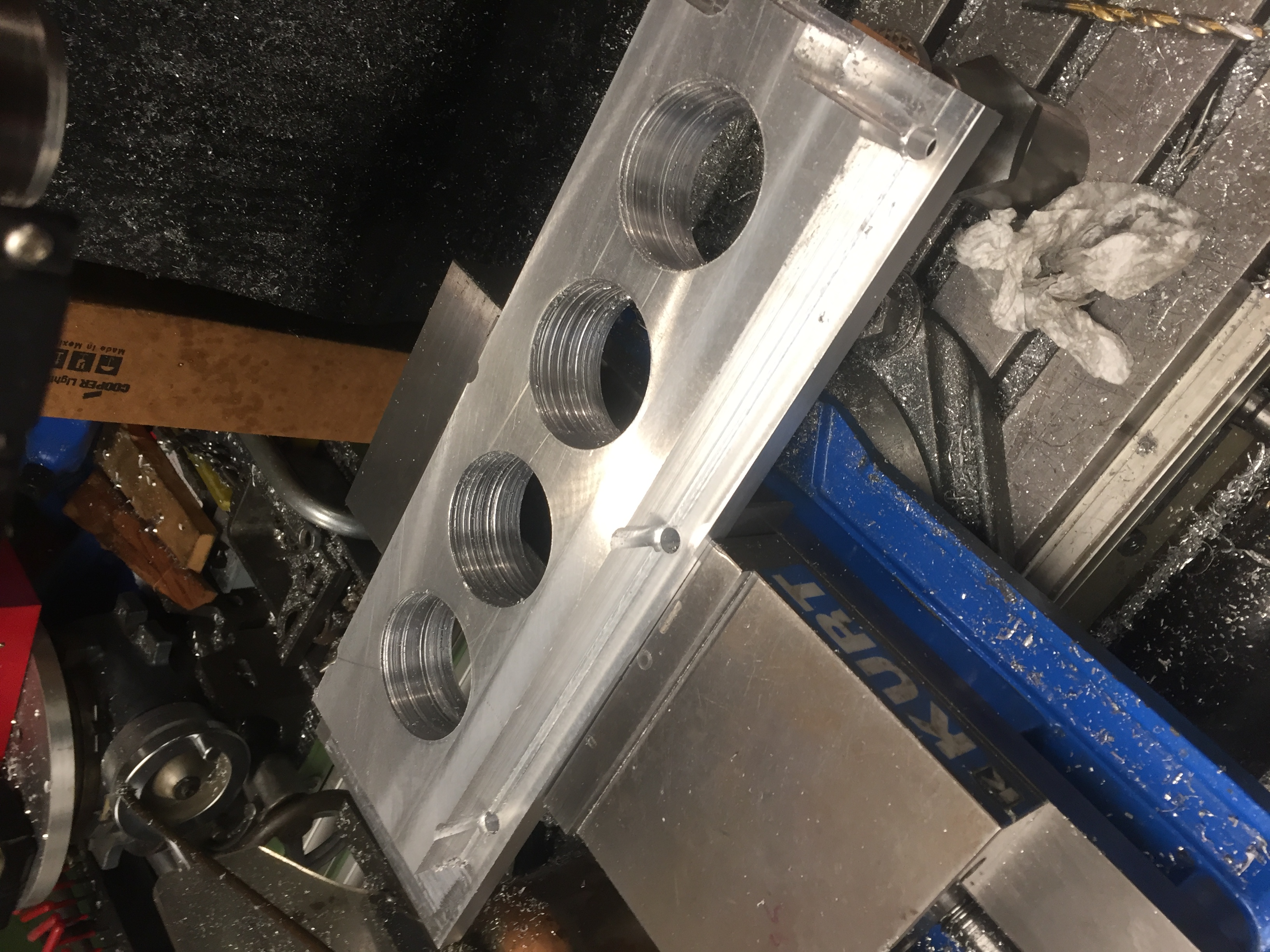

A shot from the other side after putting all the fillets in. Ready for final boring. Followed by cross drilling for the throttle shaft - I ain't gonna lie - the throttle shaft holes have me a little nervous!

In THAT case I will DO! Here I am hitting the bore pretty much dead nuts! It was a good day on the Bridgeport today - I may have to quit while I'm ahead.MostMint wrote:Do, or do not. There is no try.Racin'Jacin wrote: I'm trying!!!!

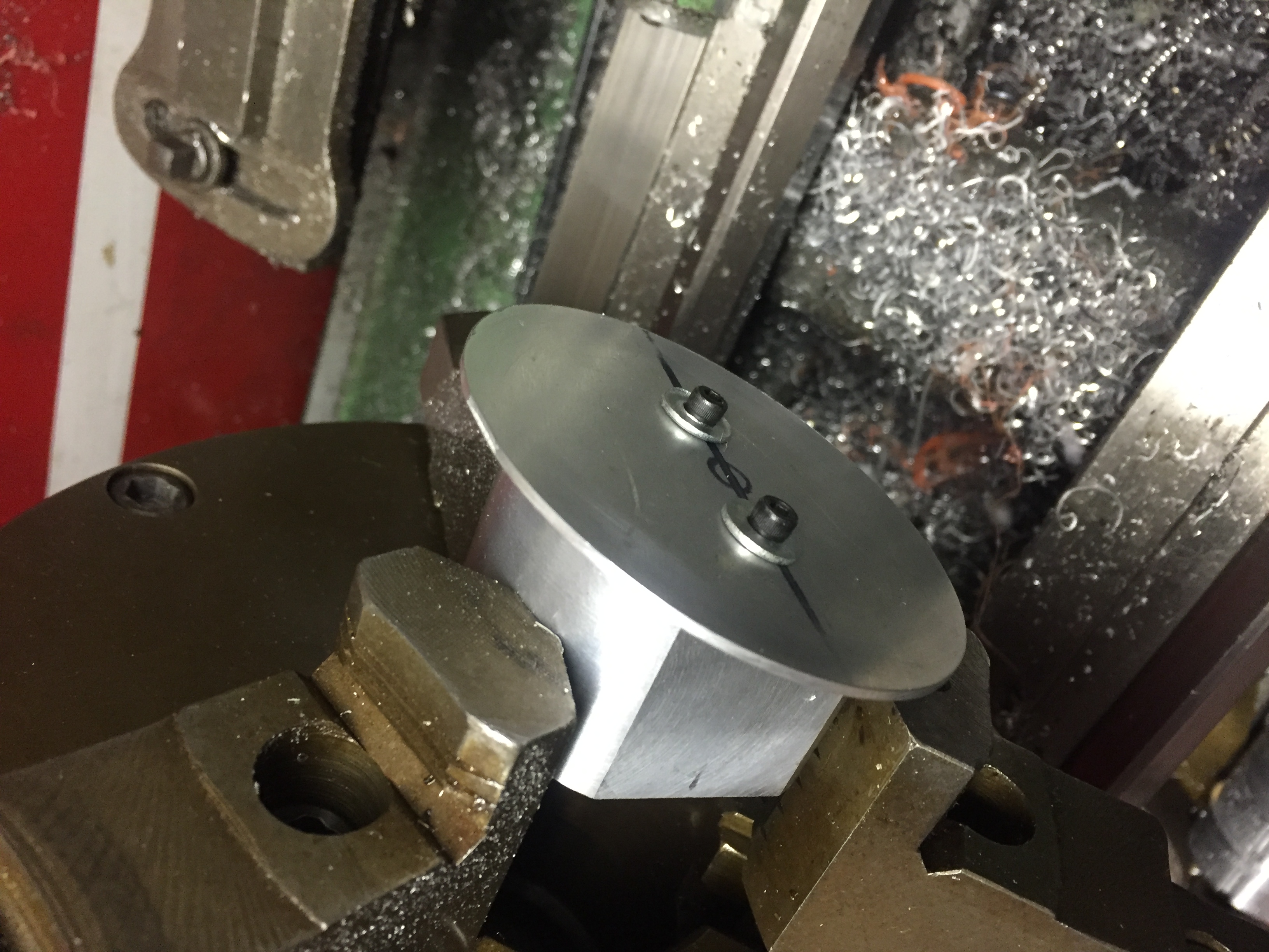

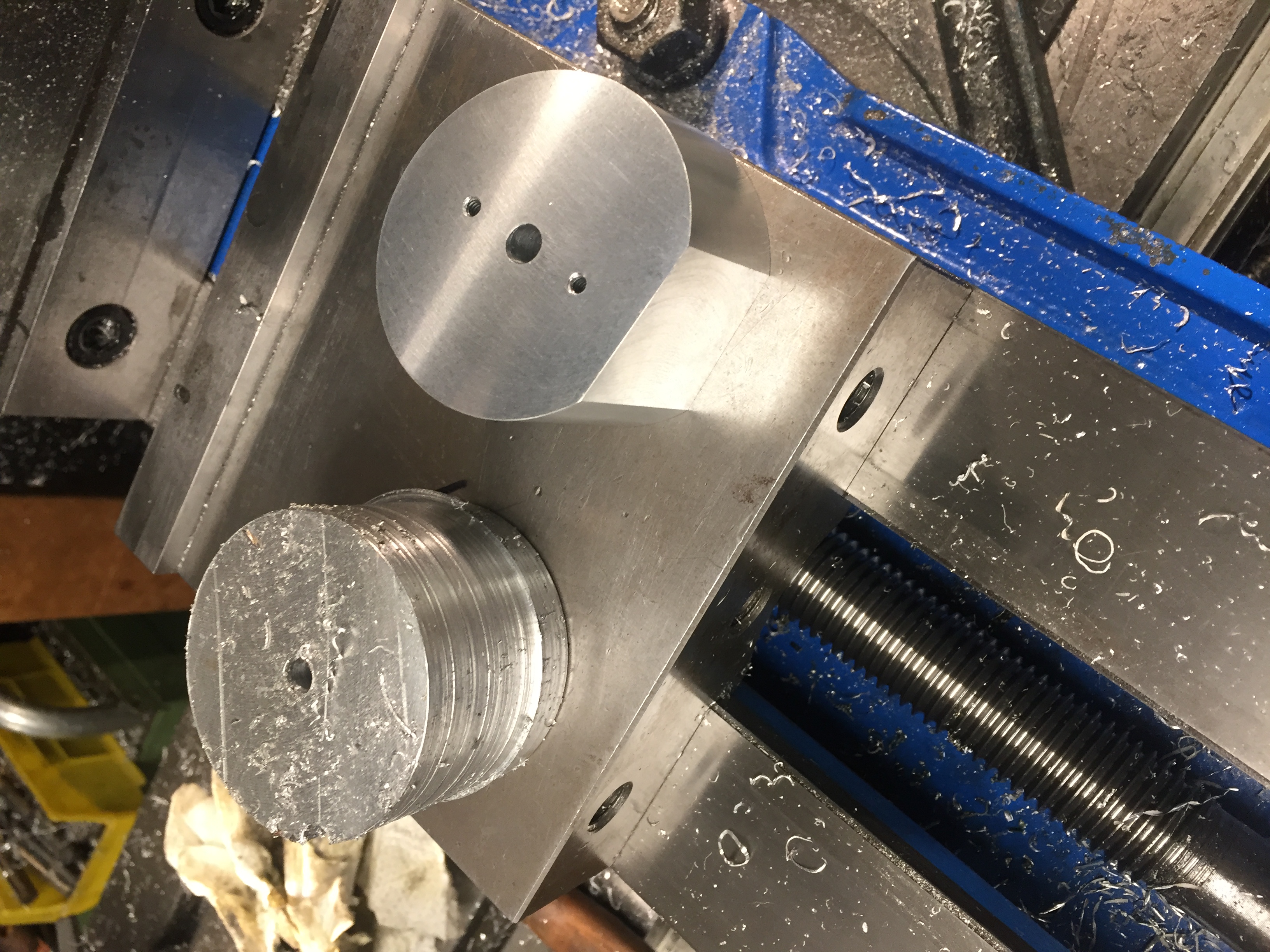

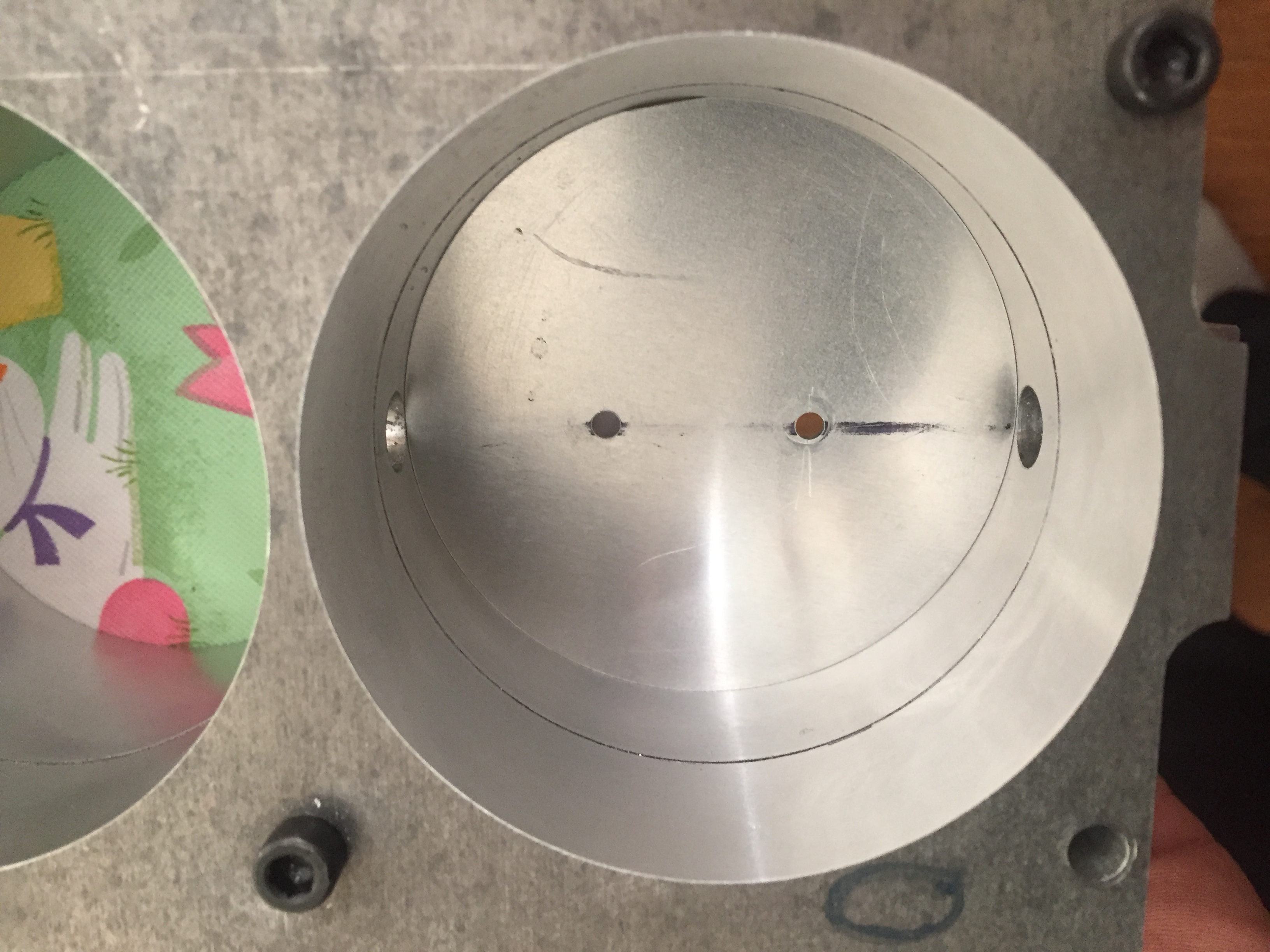

Makin' butterflies...ignore the gap on the butterfly fit - I was careless trimming the sheetmetal blank and cut too deep. So that butterfly is junk, but the proof of the approach is sound.

Thanks Guys! I have to admit i am having a blast making this thing. Learning as I go can be fun. I agree with the notion to make a few extra. The butterfly fixure really helps in making those. I've made a couple so far just for practice. I'd like to get some 2024-T3 aluminum for the real ones. These so far are made from left over scraps from the dragster body. The next challenge will be the throttle shaft - I think I'm gonna have my hands full on THAT!!!! We'll see! Soon I hope!!!!

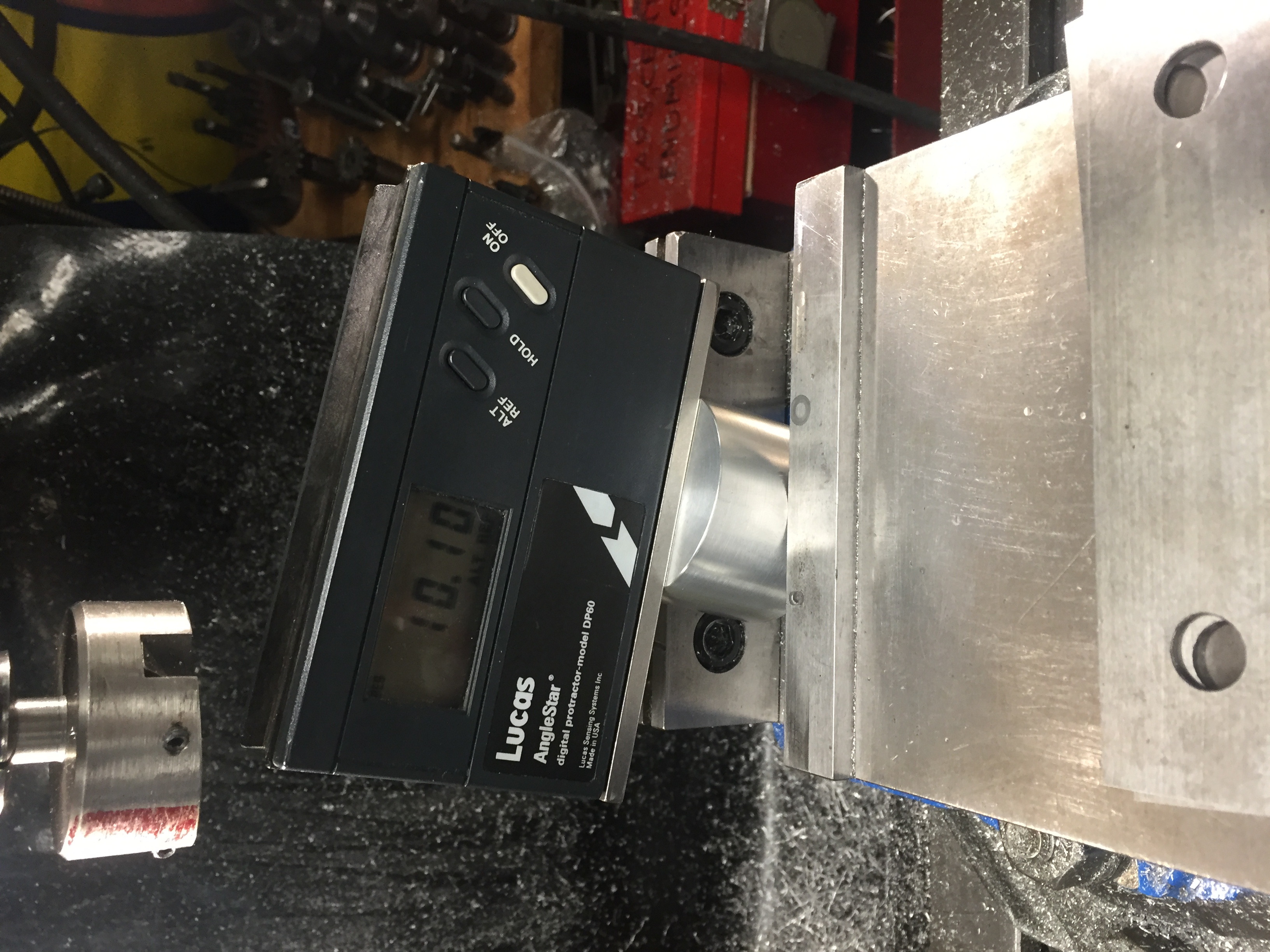

Made a fixture of sorts to hold the throttle shaft. Found a cutter and viola - we have SLOTS!!! Still need to flip it over to clean up a tad from the other side, but I'm getting a little excited - this thing might actually work!!!
