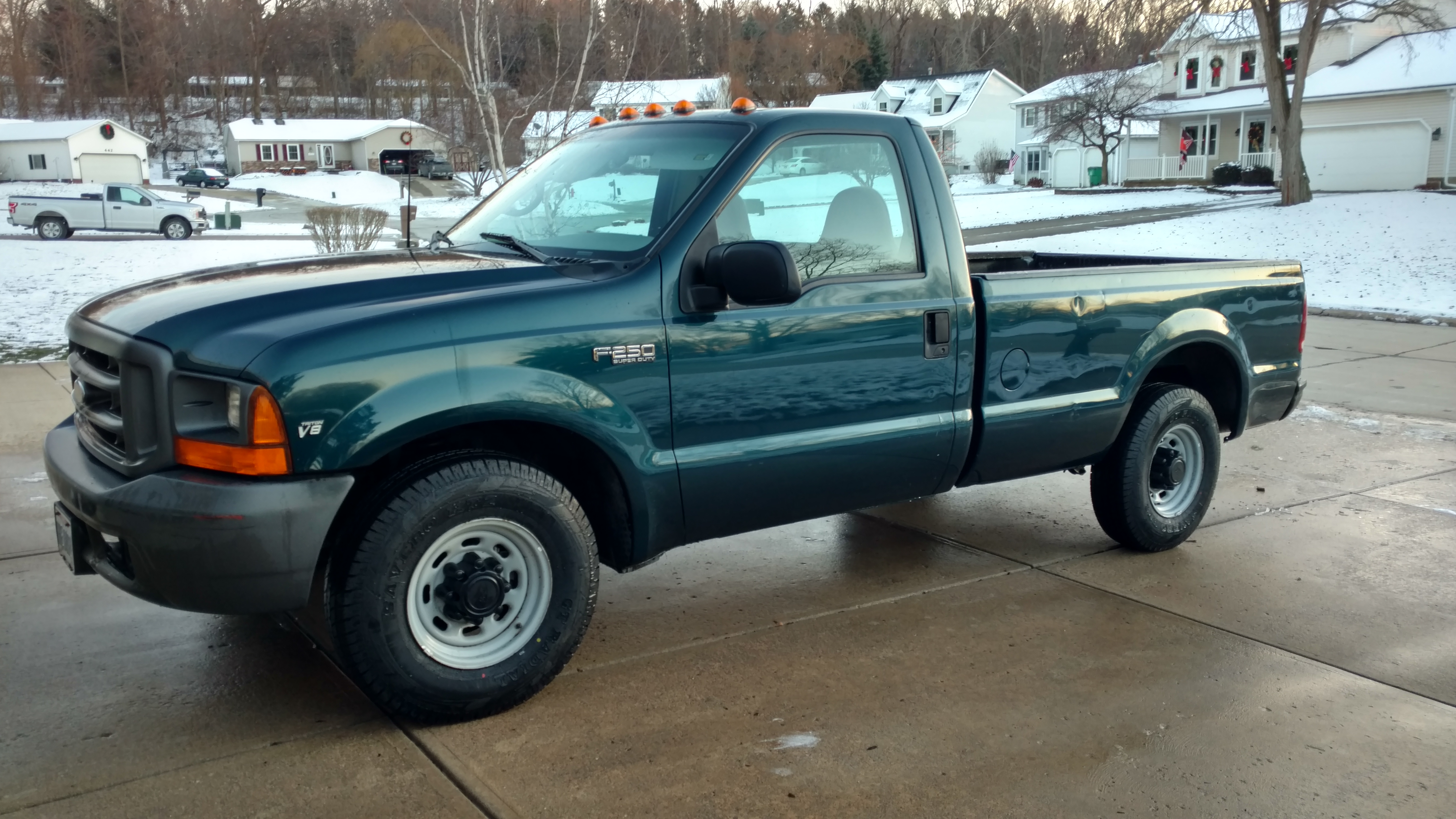

Since we started working on this truck today, it seems time for a new project post. I didn't take any great pictures of the truck itself yet though. It seems that it's been sitting more than it's been driving, but a 1999 with only 62k miles on it will have spent most of it's life doing nothing.

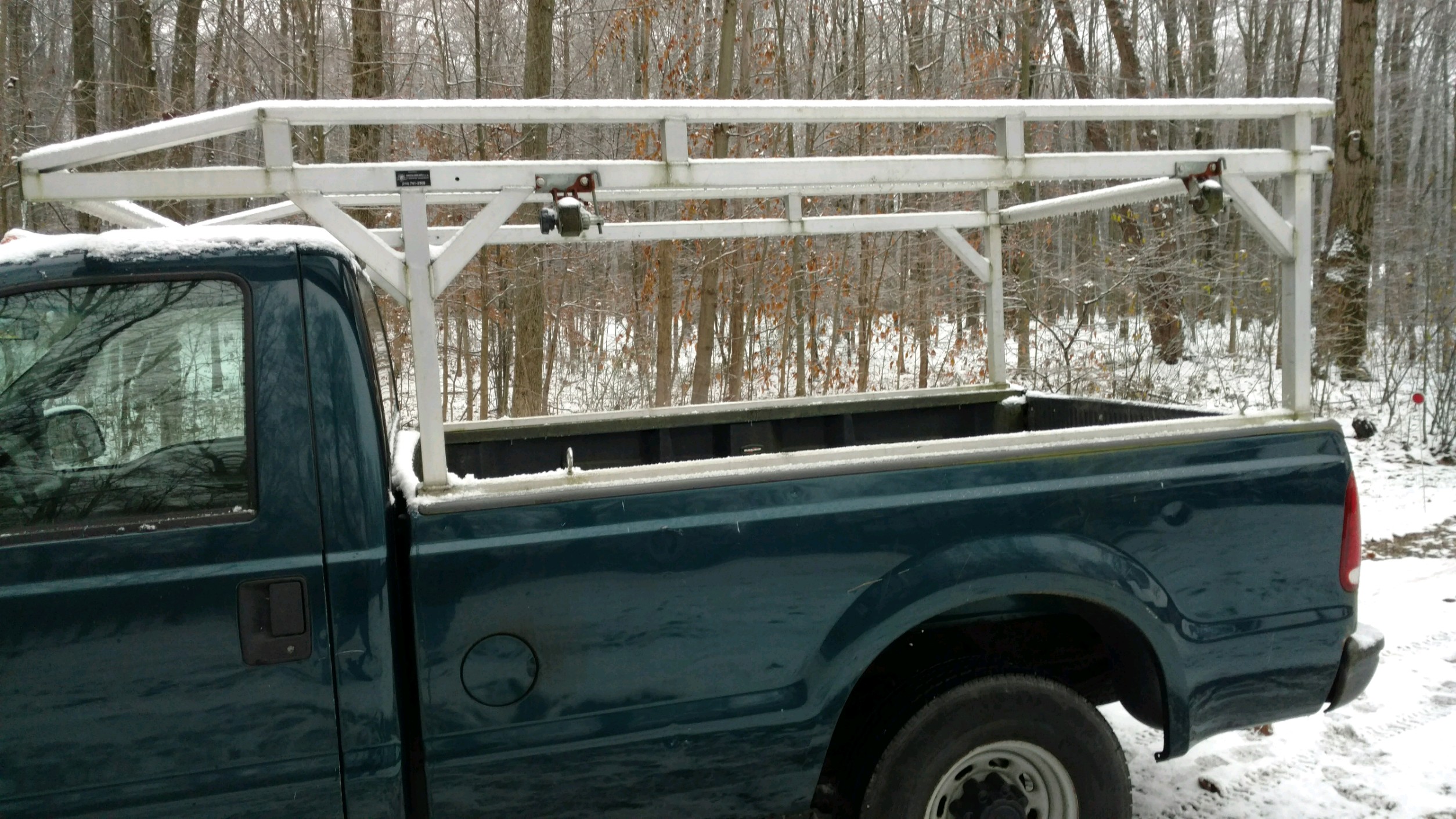

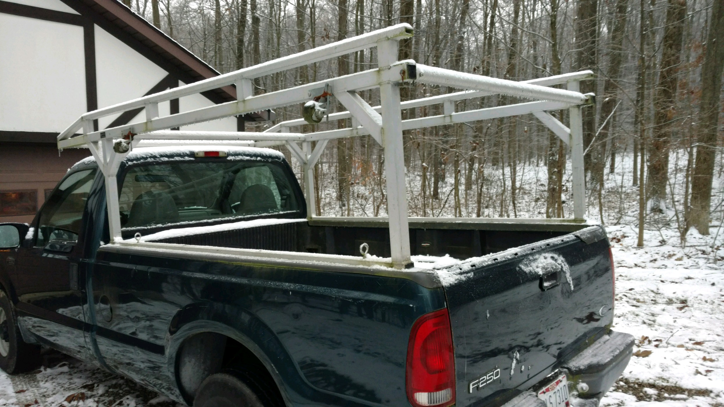

32V and I brought the truck home from his next door neighbors on Friday evening, and promptly removed the ladder rack because with it on there, it wouldn't fit in his garage. Plus, I planned to sell it right away anyway so it took some pics with it on before removal.

Last night I posted the ladder rack on FB and CL and by about noon today, it was sold and gone. $150 back in the right direction.

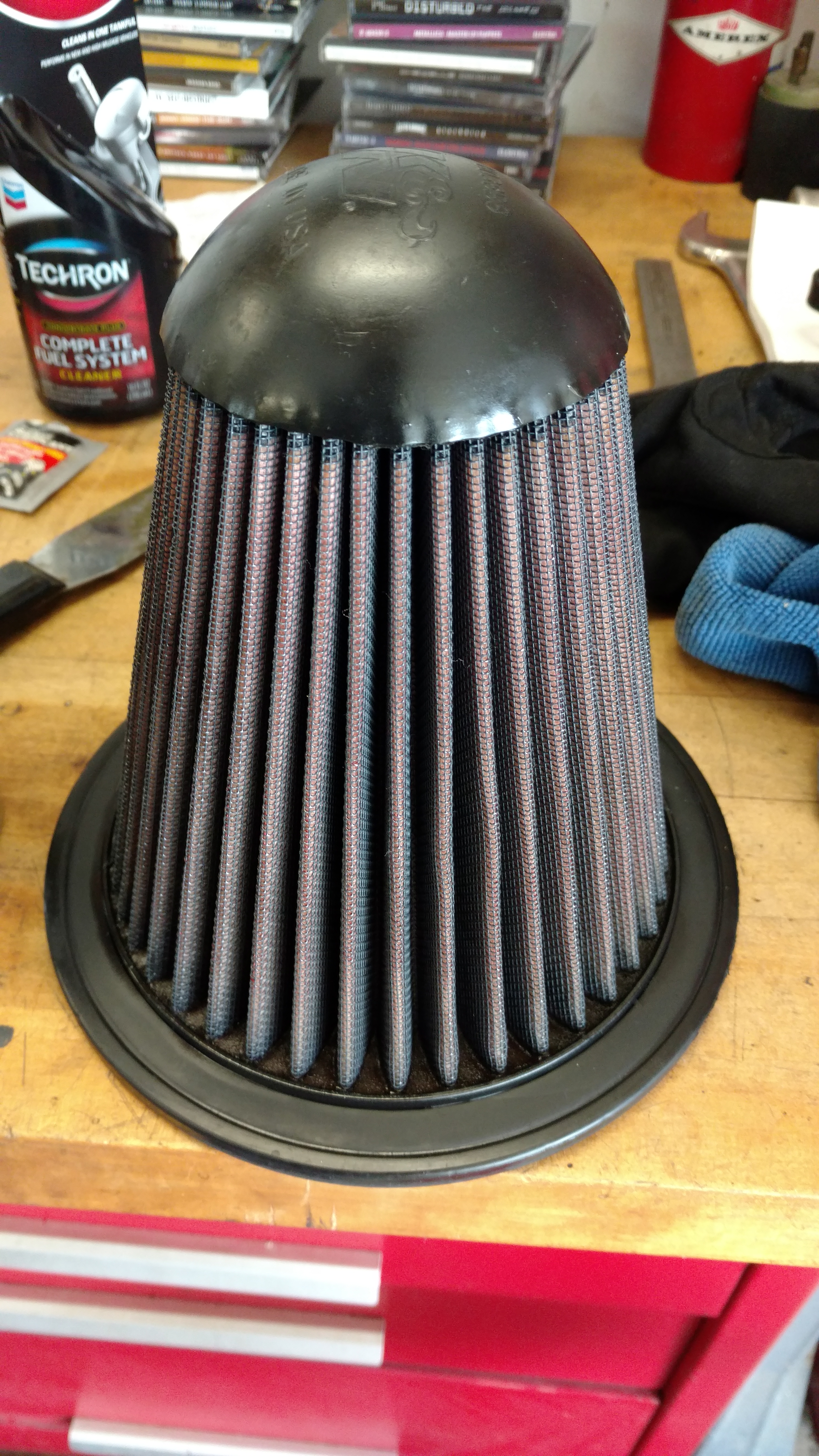

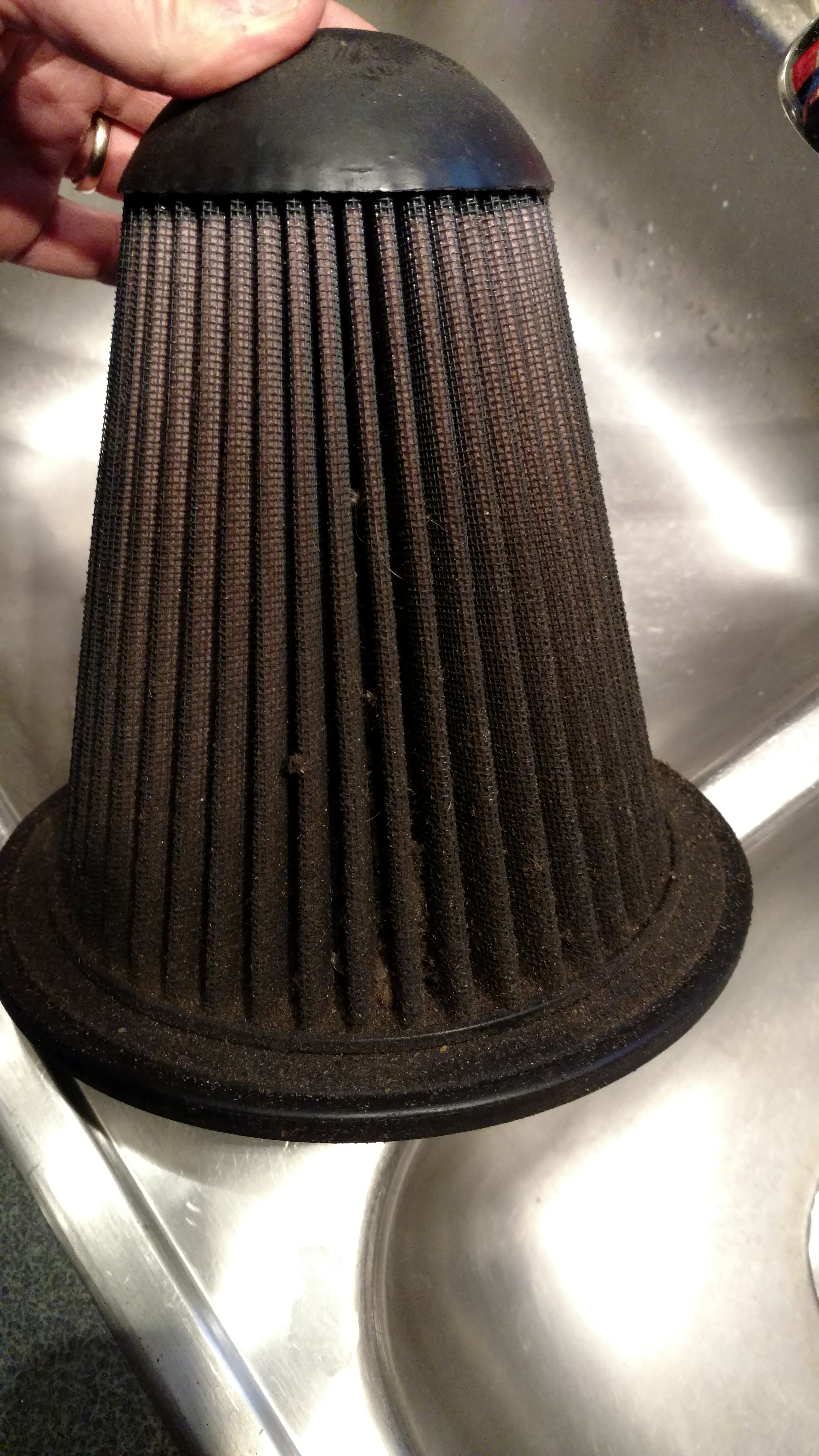

The tires from Newbury Tire got installed on Friday. I also received the used K&N ( yeah k&n ) air filter from eBay on Friday. It was nasty when I got it but it only cost $20 including shipping. With about 10min in the sink and my air filter cleaning kit, it cleaned up very well. After drying overnight, I reoiled it and it looks like new.

With the new coils and all seven spark plugs installed, this thing is smooth. Apparently there was some piece of spring loaded plastic wedged between the hex on the rearmost passenger's side spark plug and there was no getting it out. But apparently the plugs that came out were in real nice shape so I should be good for well past the time I have it. I also just installed the K&N after my trip today.

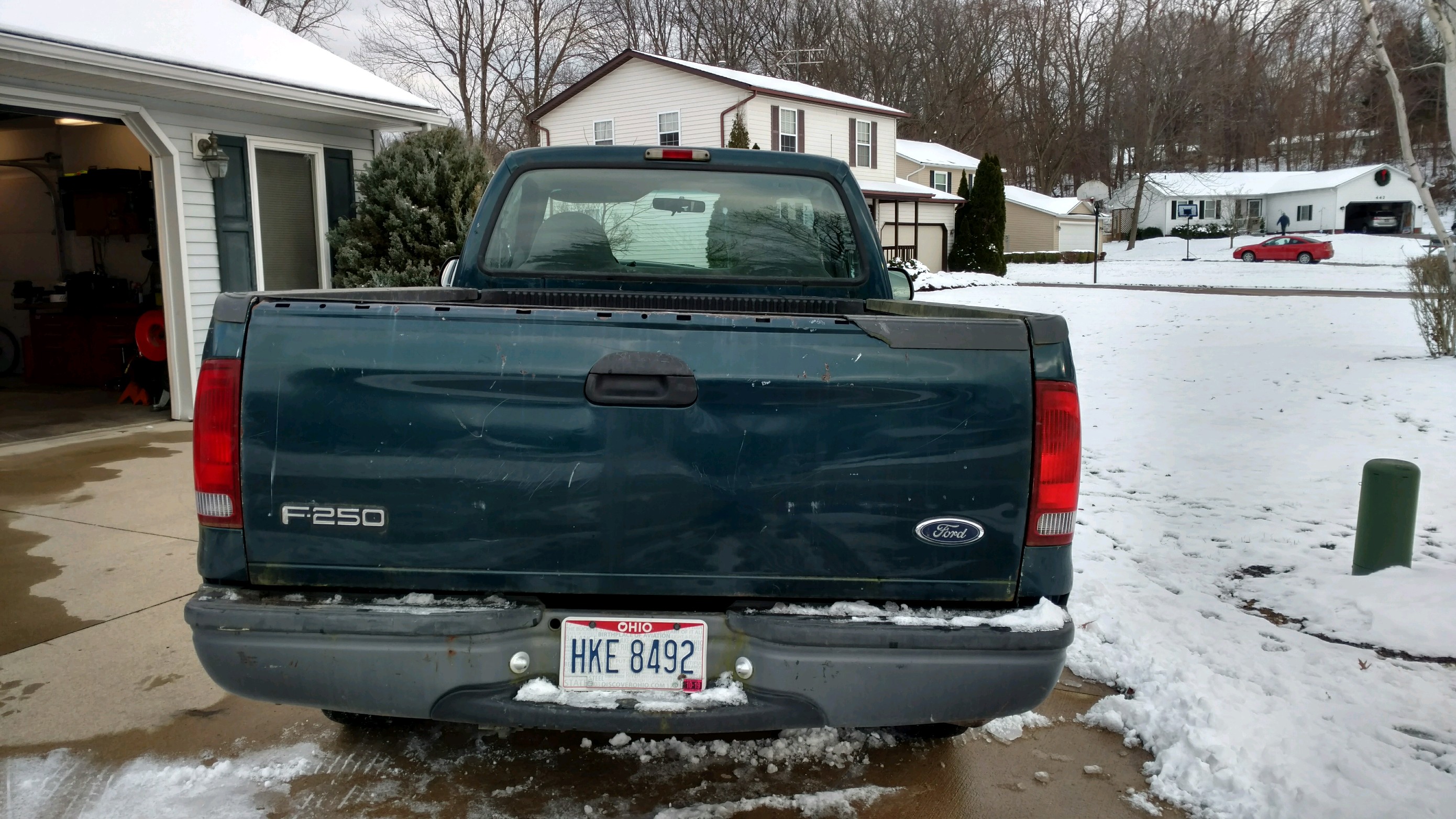

Looks a lot better after a good scrubbing wash. Was a little tough as some of the body kept freezing over as I washed, but worth it.

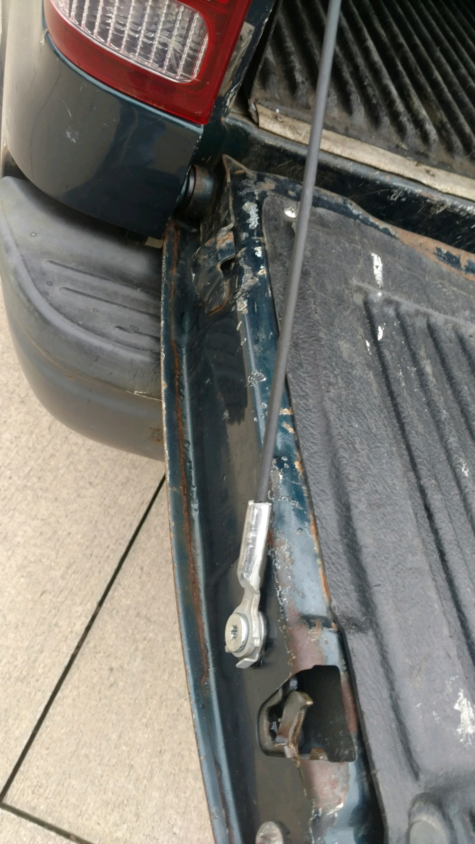

Today's work session was focused in the bed. With Xmas coming early for me, 32V and Mrs 32V got me a new tailgate cover, cables, and pivot bushings. All were in pretty bad shape. So after completely dismantling the tailgate, we got all these parts installed without any major issues. Now the gate closes smoothly and tightly without any jimmying or screwing around and looks a ton better than the half broken cover that was on there. I don't mind my work truck being a work truck, but I'm not a fan of looking hillybilly while doing it.

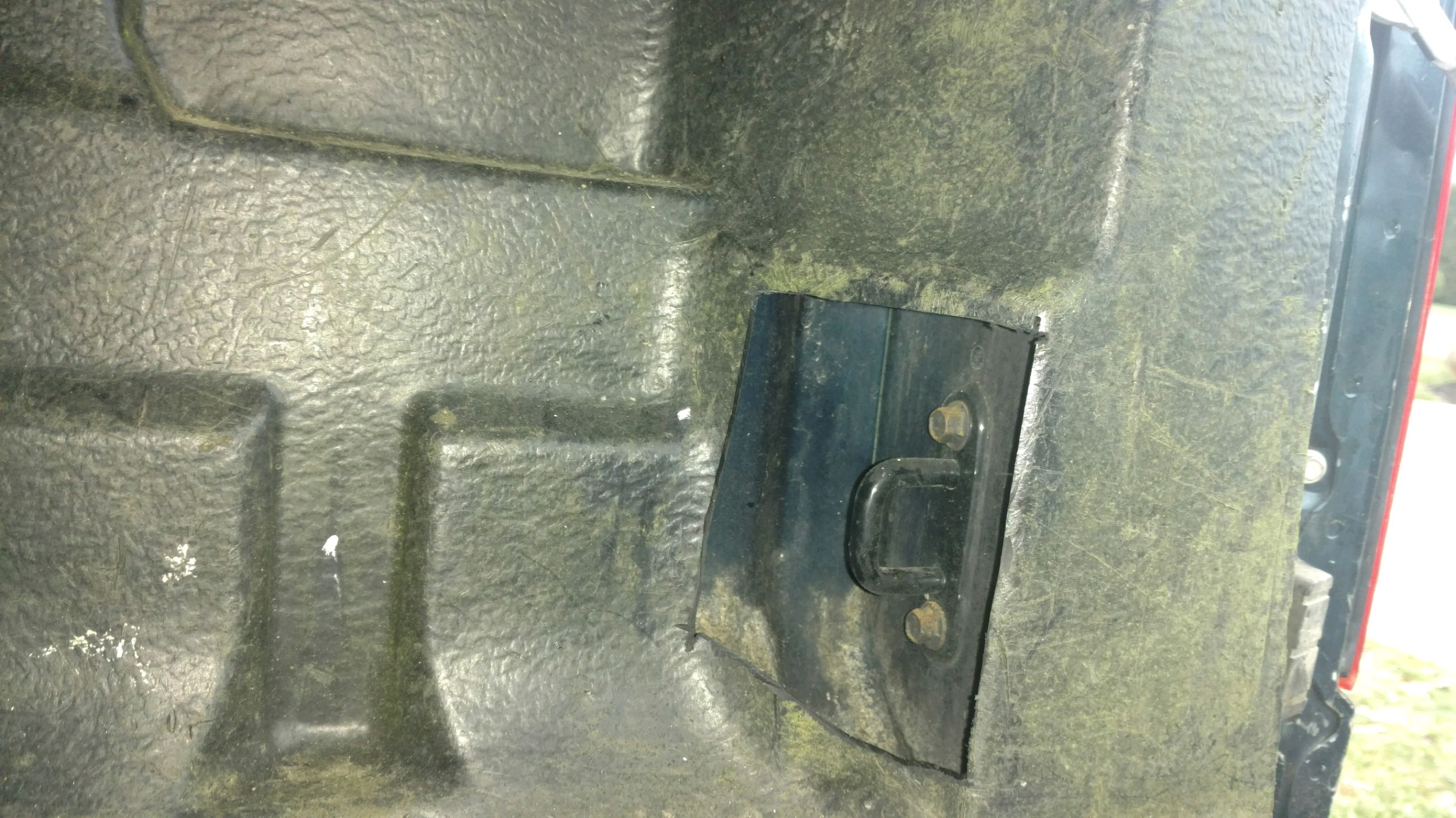

The bedliner was very unfriendly when it came to trying to use ratchet straps. The holes to access the bed tie down hooks were way too small so we cut the openings in the back to a much more user friendly size and the front holes had these covers that made them hard to access but were bolted UNDER the hooks themselves. This created a small hurdle when I broke one of the bolts removing it. Nothing a we couldn't fix with a couple drill bits and a new bolt.

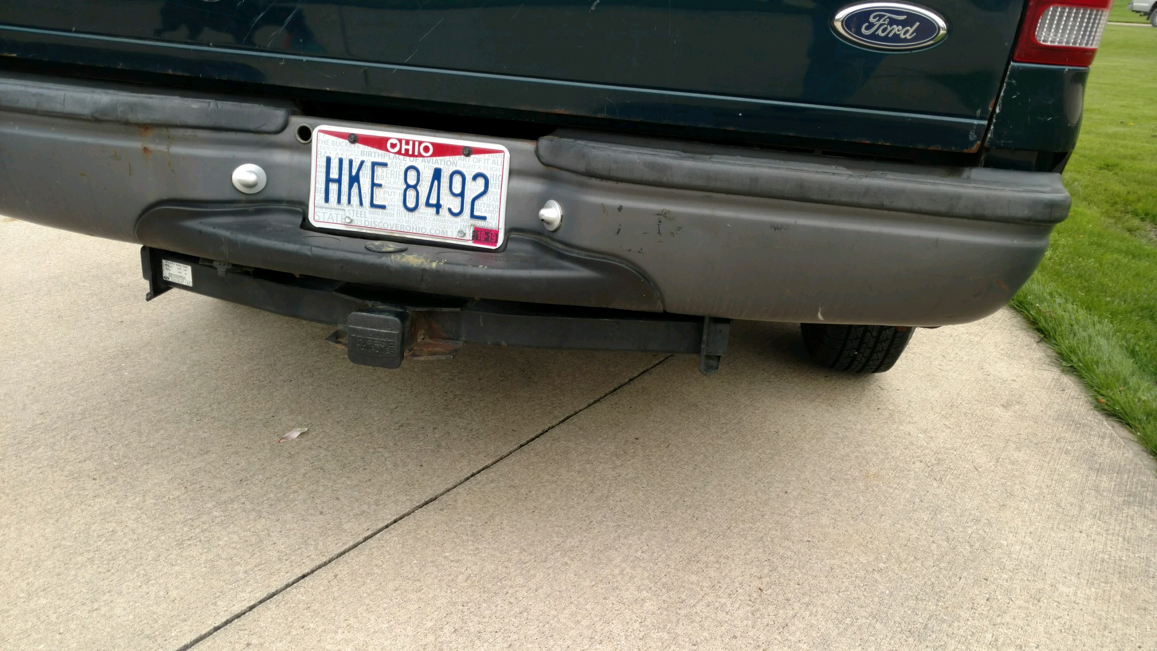

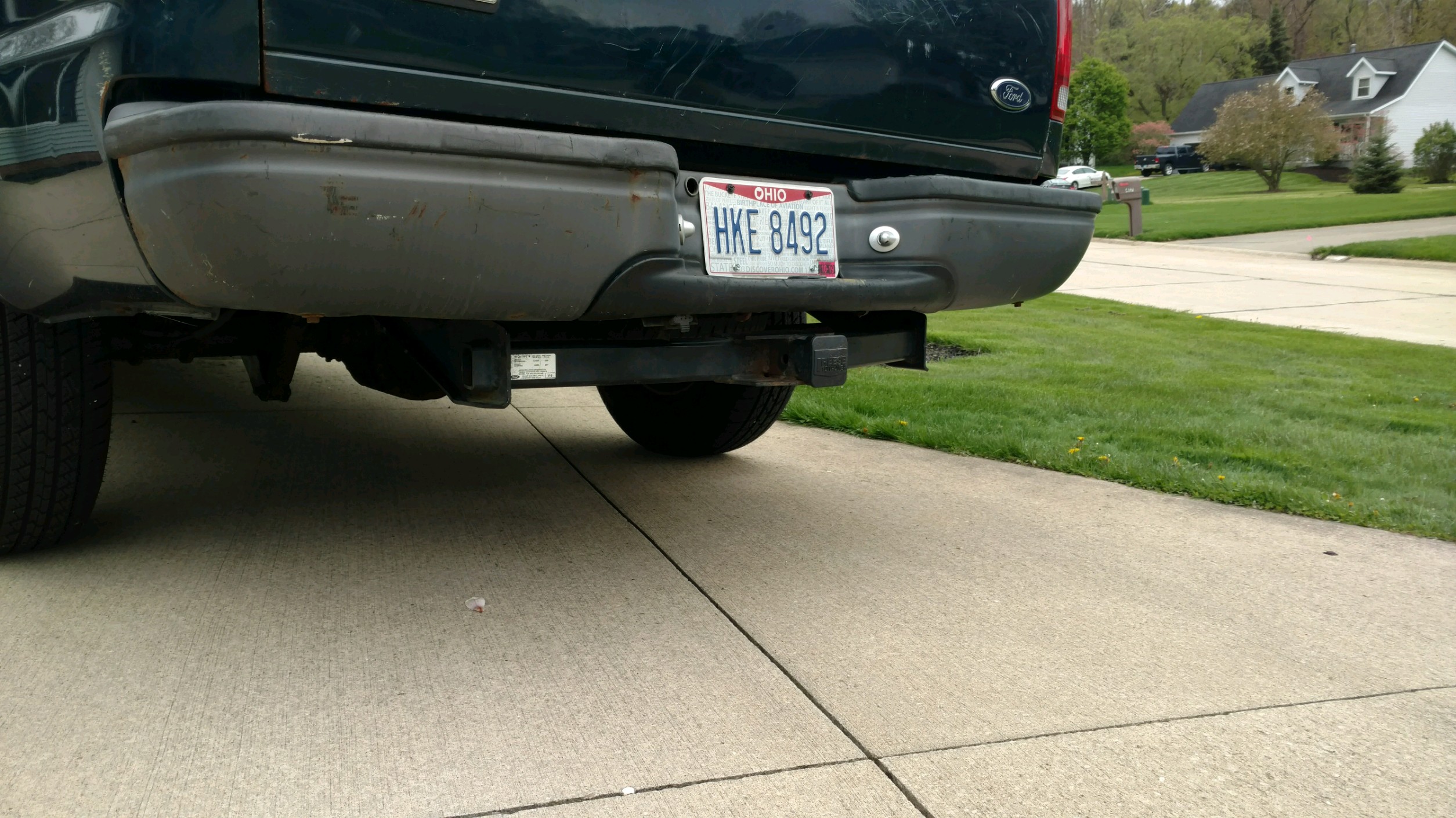

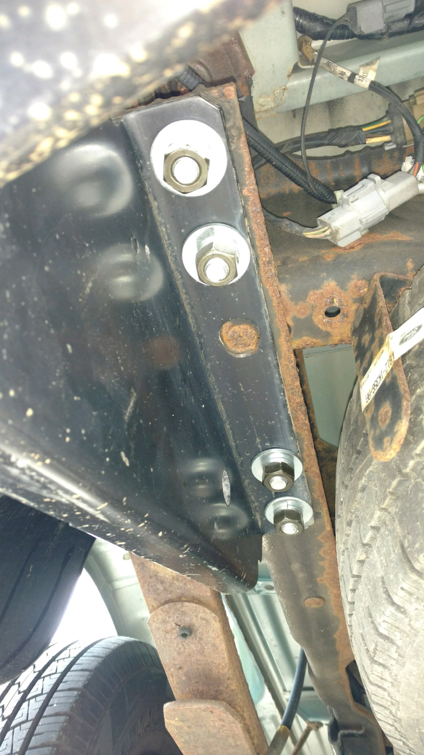

From the wagon to the truck, the hitch is installed. Fred had all the hardware but the flatwashers, so we made a quick trip to the hardware store in Burton and remedied that problem. I did have to slightly open up one hole on the driver's side so the hitch would sit flat.
