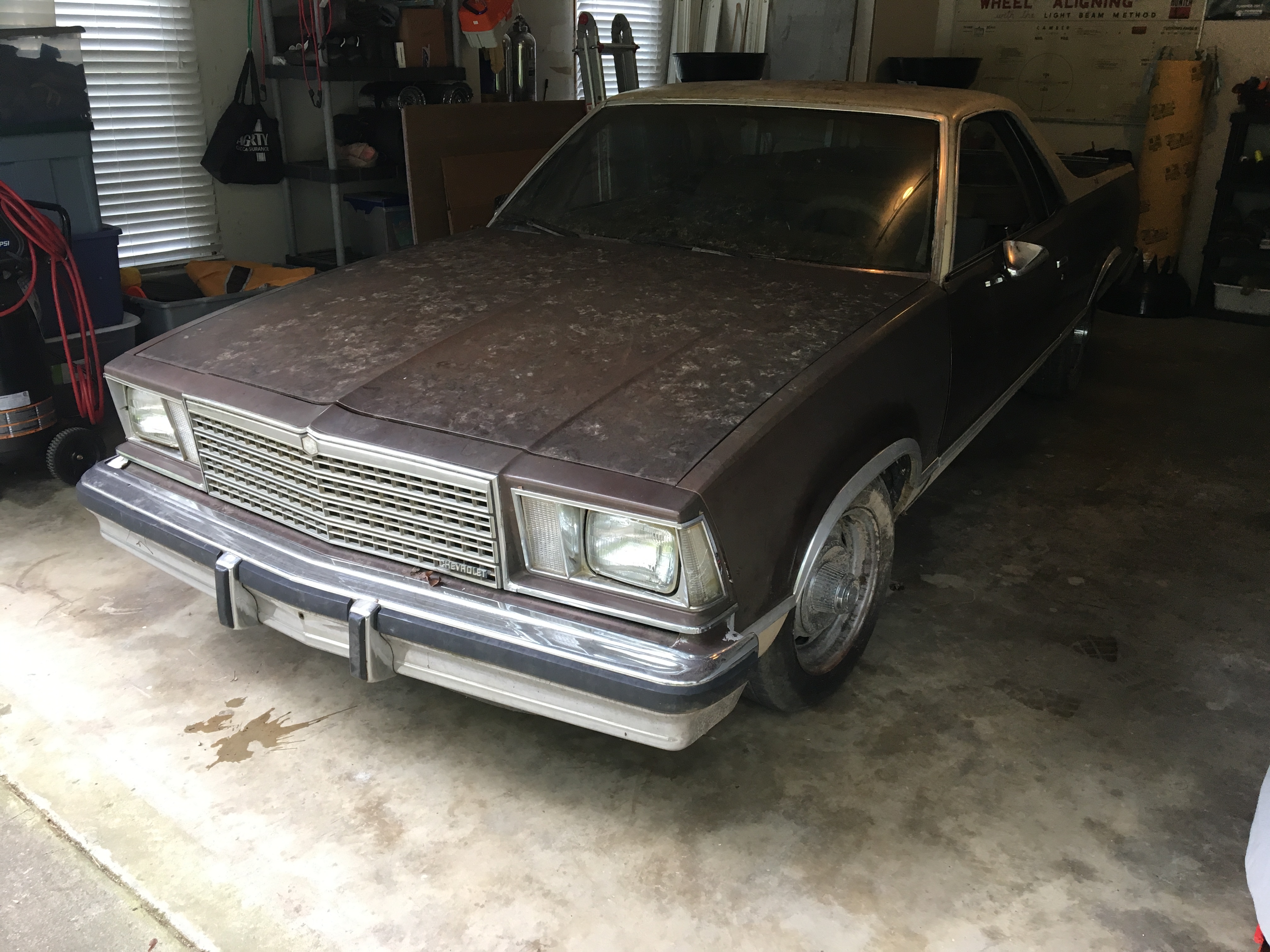

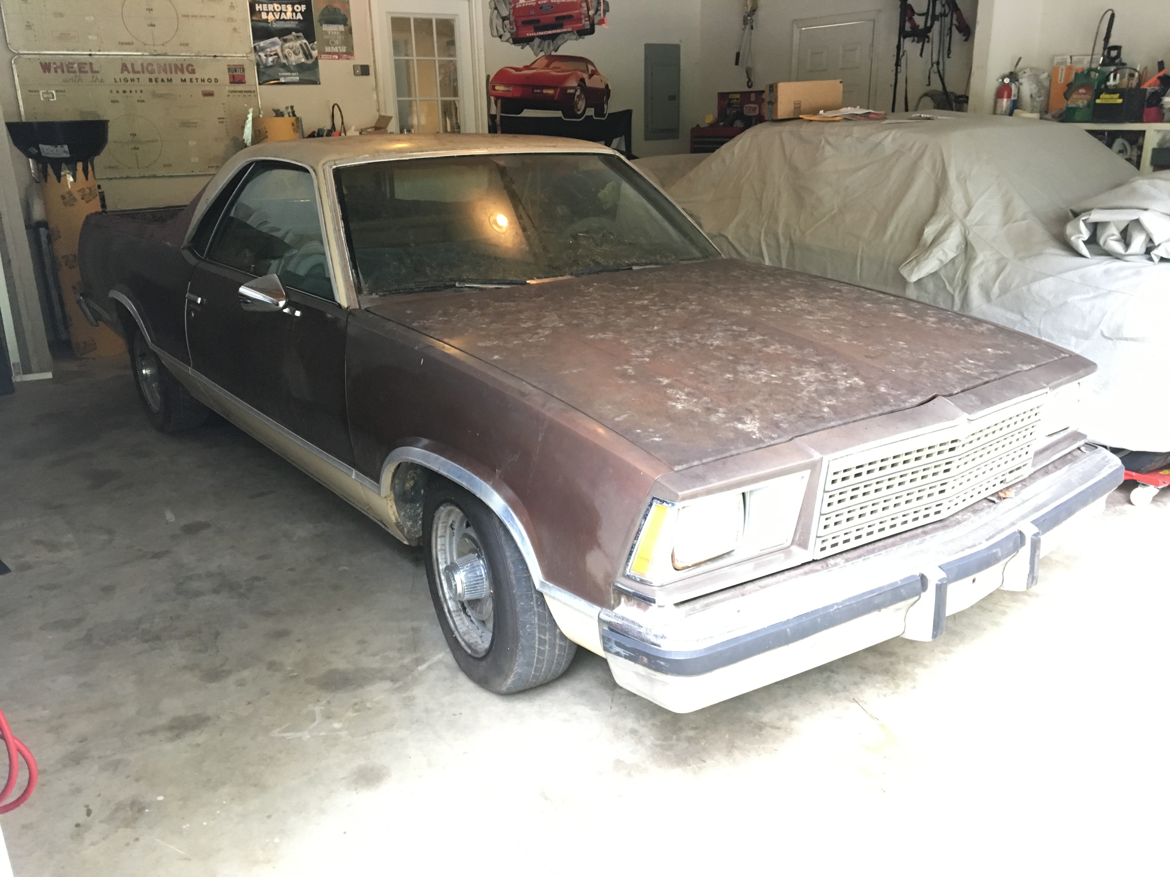

Well. Kind of a long story. Alex and I were selling popcorn door to door in our neighborhood. We go to a guy I know down the street and his wife answers. She tells me someone called the county on them and they need to get rid of a bunch of cars and stuff out of their yard. So I say which ones and she tells me. Alex asks me to point them out and he says "that one is kind of cool". So I tell her to have her husband let me know what he wants for it. Well we work a deal for an AR15 and 500 rounds of ammo that I had "extra". Since I have like 4 AR rifles I figured it was a fair trade.
So I am now the proud owner of a 1979 El Camino. The engine needs rebuilt as far as I know. So off with the top end in the near future. Then I can judge where I stand with it. My goal is to simply get it running and driving. As I need a tow vehicle for the e30 when I get it ready for paint and bodywork.

Its great to see another Gen 5 El Camino on here. Lots of pictures please!!
Jim
Posts: 3669
Re: 1979 El Camino
305 car? Looks pretty solid. We were just talking about car-trucks at breakfast this morning. Good find.

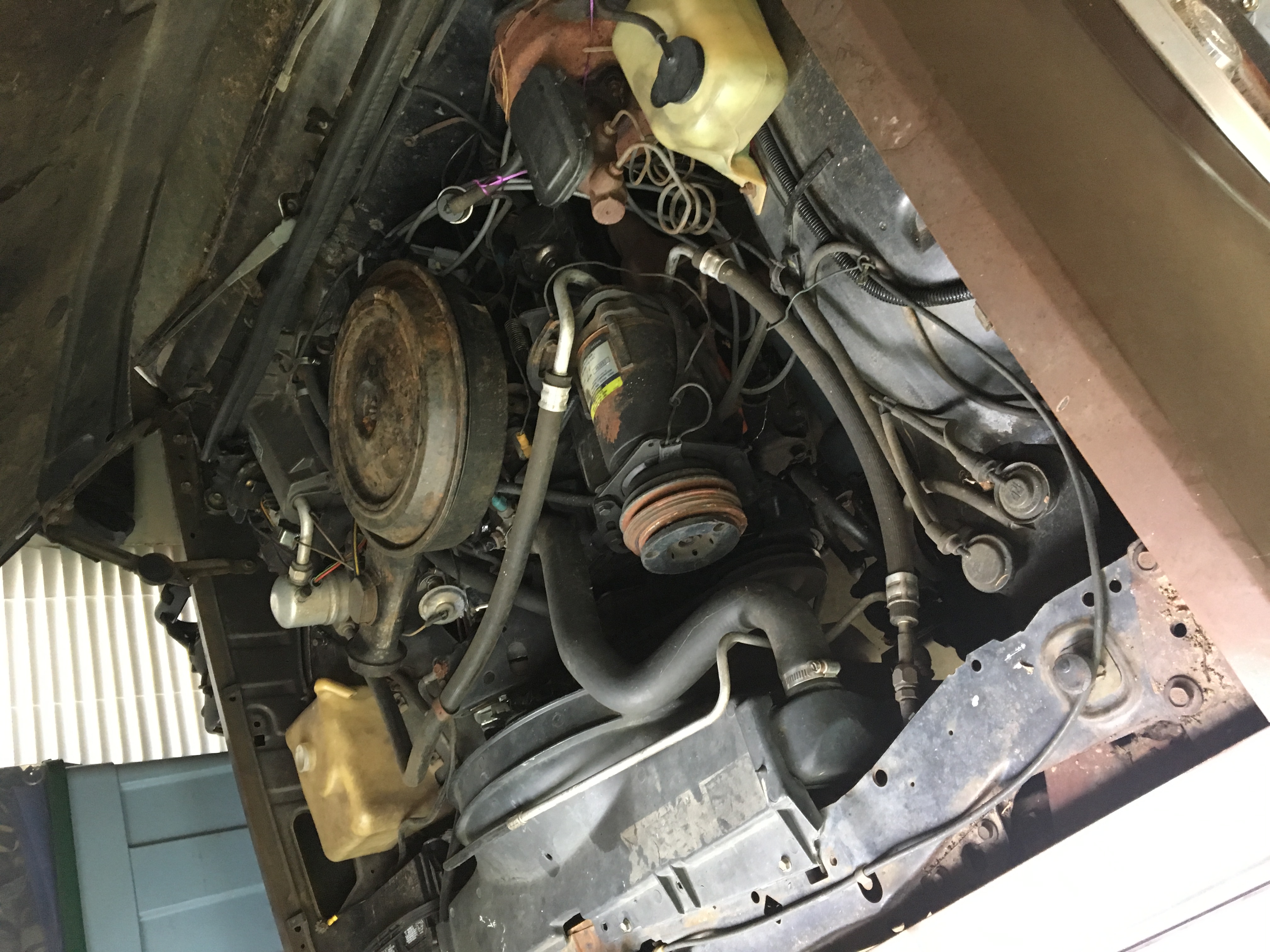

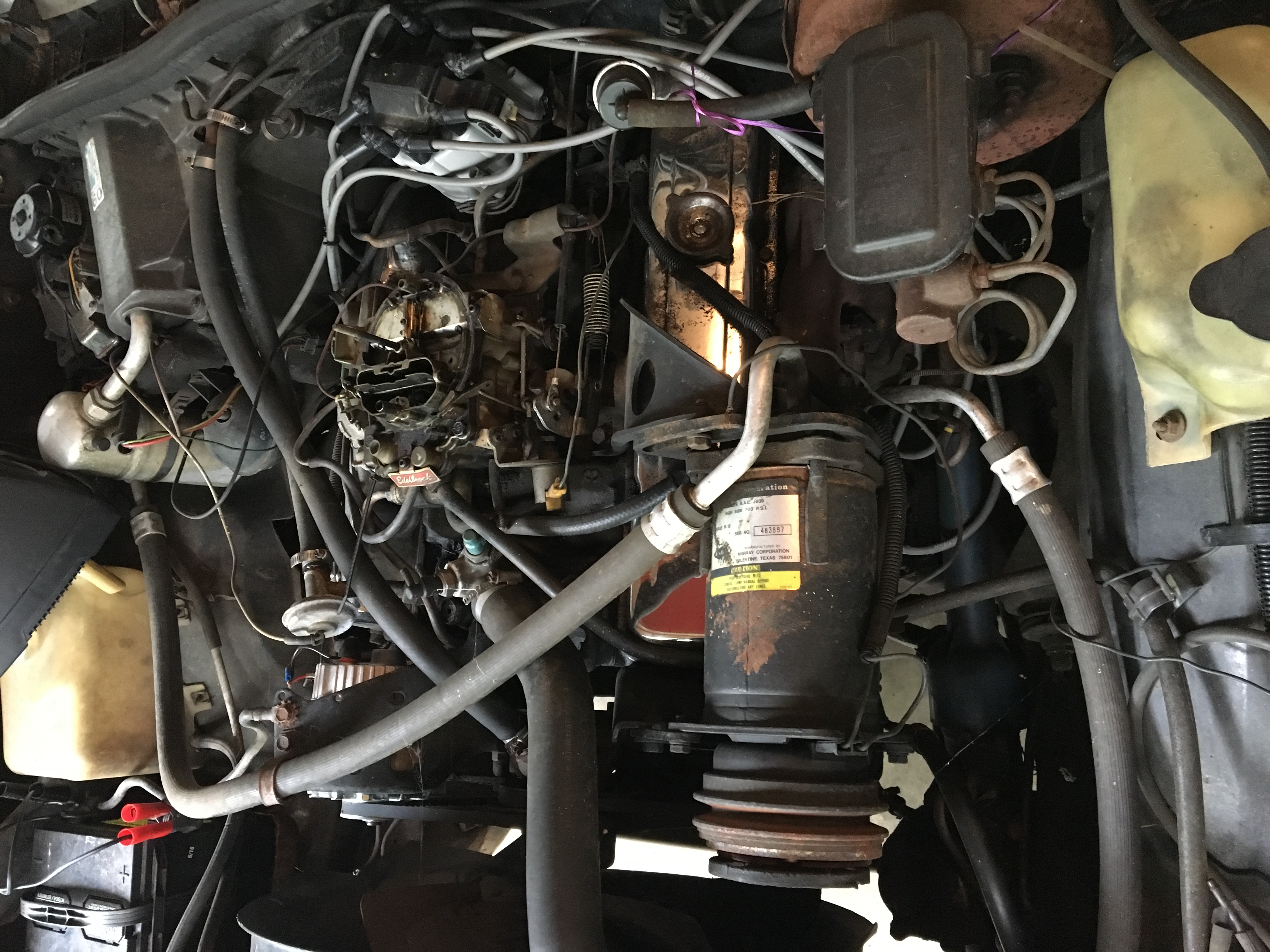

yes, 305. going to try and pull the valve covers this weekend. Maybe the intake too, to see what I can see.

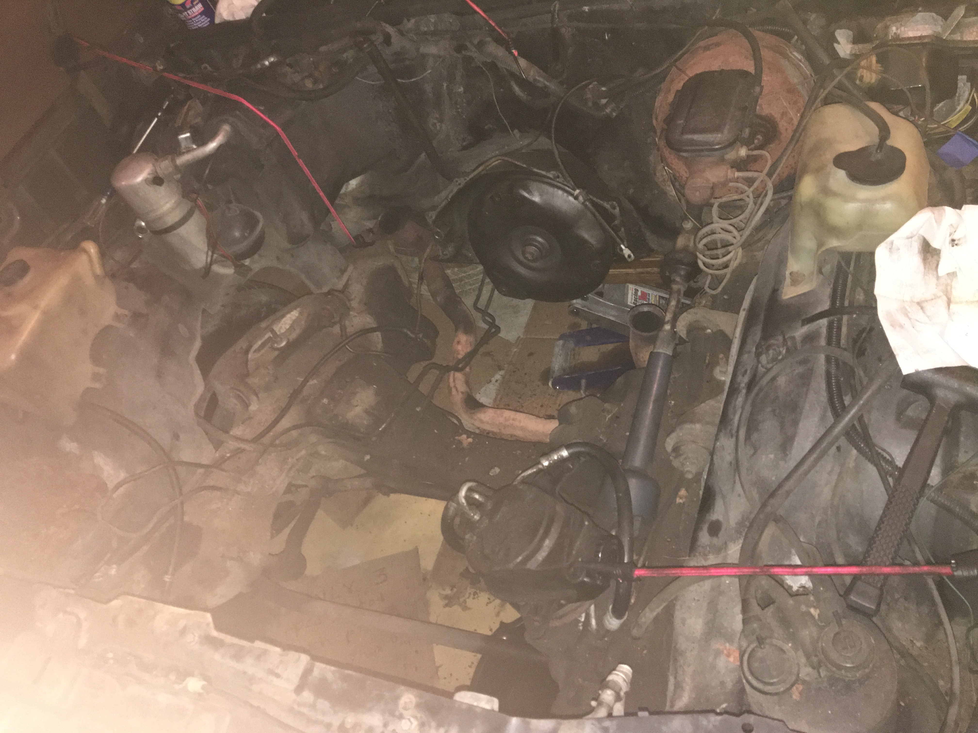

So I pulled the radiator and begin tearing off the top end. I took off the valve covers and smelled gas. I am thinking the valve seals are bad. Plus when I moved the car there was a puddle of trans fluid under the car. So I am going to go ahead and yank the engine and trans. Then we will see. Hopefully a simple rebuild/reseal kit and it will be fine. Time will tell.

So on Saturday I was removing the engine by myself, which isn’t too bad but it’s always nice to have company. Well as I was taking out the last 2 bolts my hand slipped and I sliced my arm open. 10 stitches later........

Tonight I felt motived and a little irritated because I didn’t get the engine out Saturday. So I removed the2 motor mount bolts and extracted it from the engine bay.
