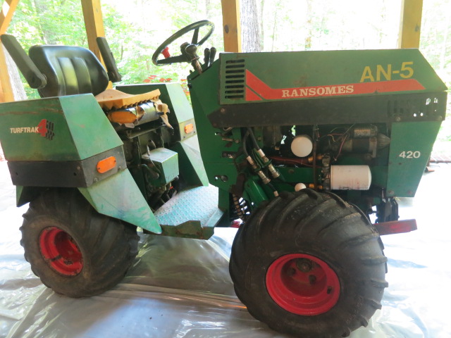

I've finally decided it's time to focus on my tractor. I'm guessing that this tractor is at least 25 years old, but it has only 1700 hours on it. The hydraulic pump is a bit noisy on startup, but seems to provide plenty of power. I've had it since 1999 and have done virtually nothing to it.
I'm starting with the hydraulic leak.

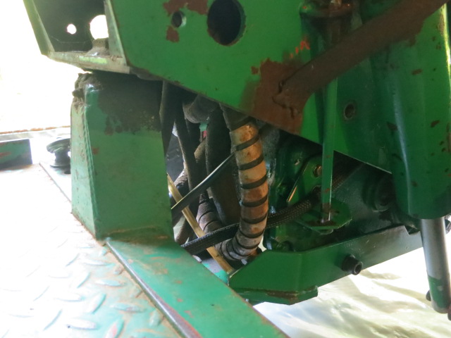

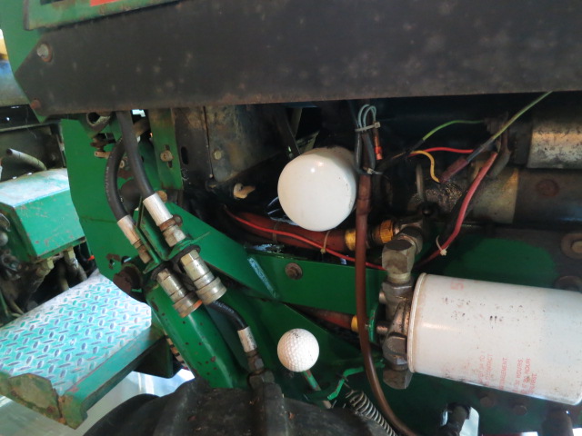

It's an all hydraulic drive 4x4 compact tractor and the hoses snake around in places that you can't see. I've done some cleaning of the muck I can get to, but have yet to discover where the leak is. Any thoughts or ideas?
The other thing I need to know is how to disconnect these hydraulic hoses if I decide to dig deeper.
Here are some pictures:

We normally will find hydraulic leaks by cleaning the machine up first. We pressure wash, degrease, pressure
wash some more, and when you think you have it really clean, wash it one more time. A water-based degreaser
called "purple power" can be purchased at Wal Mart and works sweet. I'd also strongly recommend changing the
hydraulic filter. If you haven't done anything to the tractor in forever and the pump is whining that's a good start.
It might not hurt to change the fluid either, but if you haven't impregnated the fluid with contaminants, and it
looks clear you might be ok there. There's a good chance that your leak is just a loose line, especially if they
snake through spots you can't see and if the ends are hard to reach with normal wrenches. We have a rule that
we follow when fixing machines: Start with the extremely basic and work to the most extreme. Normally, things
will not have catastrophic failures. More often than not the issue is just something small. My two cents.

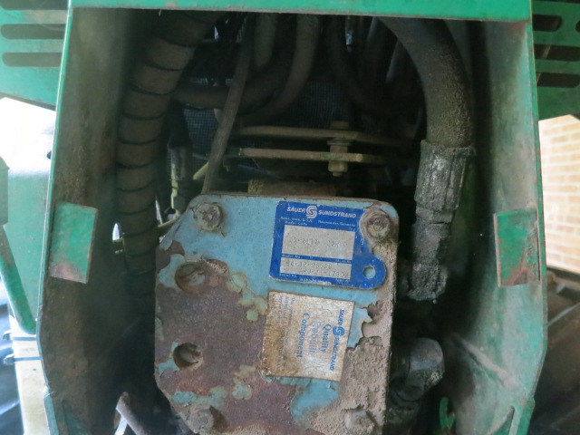

After removing much of the crud, I can see that the main high pressure hoses on the output of the pump are looking bad. The outsides are dry and checked and I can see a bulge on one of them near the fitting. I assume it's condition is due to the heat of the engine. I think it would be best to replace them after 30 years of service. I can get one of them from Messicks in Carlisle for $40 plus shipping. This hose is described as 5/8 x 26-1/4. It has brass screw-on fittings on each end. Is this a generic hydraulic hose that I can go out and buy locally or should I try to stay with the Steiner hose?

I think you can go either way. We typically make (or have made) our hydraulic lines. If you have a
hose making shop around your place, you can get instant gratification by going there. Take in the
hose you have, they will make a duplicate, and walk out the door with it. If you order online and the
hose is not an exact match, you have to go through the hassle of sending it back and such. Hydraulic
hose ends are not all the same, they have different thread pitches and the inside of the coupler is
not the same on all of them. Some have conical ends and some have flat ends with O-rings in them.
I think if you order online, you're making an assumption that someone didn't do some custom work
along the way and it would be a drag if the hose was wrong. I guess if I had to tell you how to do it,
I'd go to a hose shop. Your call.

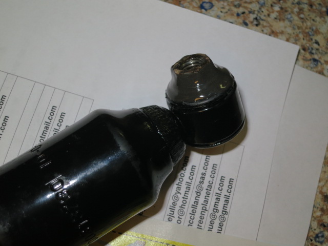

Before attacking the hoses, I decided to analyze a problem that has been plaguing me for a long time no. When moving the control handle that moves the tractor forward and backward, it, over time, becoming increasingly jumpy. As I would move the control handle past the center stopping detent, and then go to change direction, the movement of the tractor was at times violent. Being unfamiliar with hydraulically operated machinery, I thought it was something wrong in the system as a whole. After more concentrated focus and observation, I saw that the system had plenty of power to drive the tractor and the implements worked smoothly and as expected. I noticed that, attached to the control mechanism, was a shock absorber! The parts diagram calls it a stabilizer. Bingo! I pulled it off and, indeed, it was no longer working. A new one is coming today and I'm anxious to install and try it out.

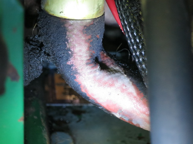

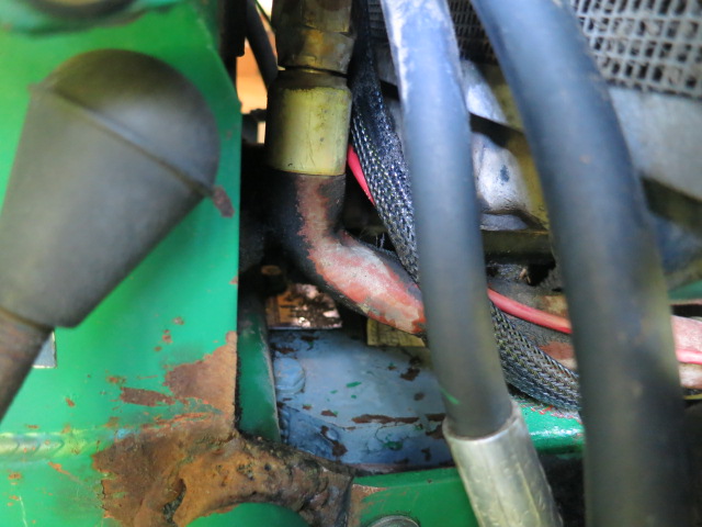

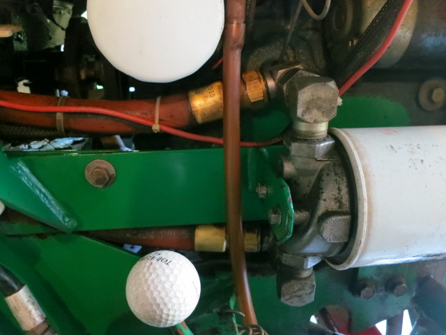

After removing the old stabilizer, I continued removing the encrusted crud and saw this:
As you can see, there is a severe crease in this hose which carries the fluid from the pump to the filter. Something like this should have an impact on the performance of the hydraulics. I think, when replacing this hose, I will have a longer one built and then reroute it to try to avoid the kink.
Posts: 1309
Re: Steiner/Ransomes Model 420
WXO...
Perhaps you can get a hose with a 90* or 45* fitting on it to help improve the angle down. Talk to
your hose guy. That definitely can't be helping the machine work properly, hydraulic flow is important
to a hydrostatic machine.

Having seen this, I'm getting more enthusiastic about refurbishing ol' Gladys. When I started to remove the stabilizer, I dreaded the thought of trying to get a wrench on the nut on the inside bottom. Clearly, it was going to be difficult if not impossible. Just because I didn't have any good options, I just tried to unscrew it. And it worked! Something was holding the nut in place. Lo and behold, someone had glued the nut onto the shock. What a great idea. So I did the same thing with the new shock. Good ol' JB Weld is now holding the nut. It's glued to the rubber with only minimal holding power on the metal, but it should do well to keep the nut in place until I can tighten it in place
I've got the Jackleg blues. After spending hours trying to install the new stabilizer I finally referred to the parts diagram and saw that the bottom of the shock should be outside the frame, NOT INSIDE. All this time, It has been installed cocked so that it is not in line with its actuator. Give me a break! :x
Forget all that about gluing the nut on. I've got to rethink how to get this into the proper location. All the sudden I've lost the fun factor. :x
