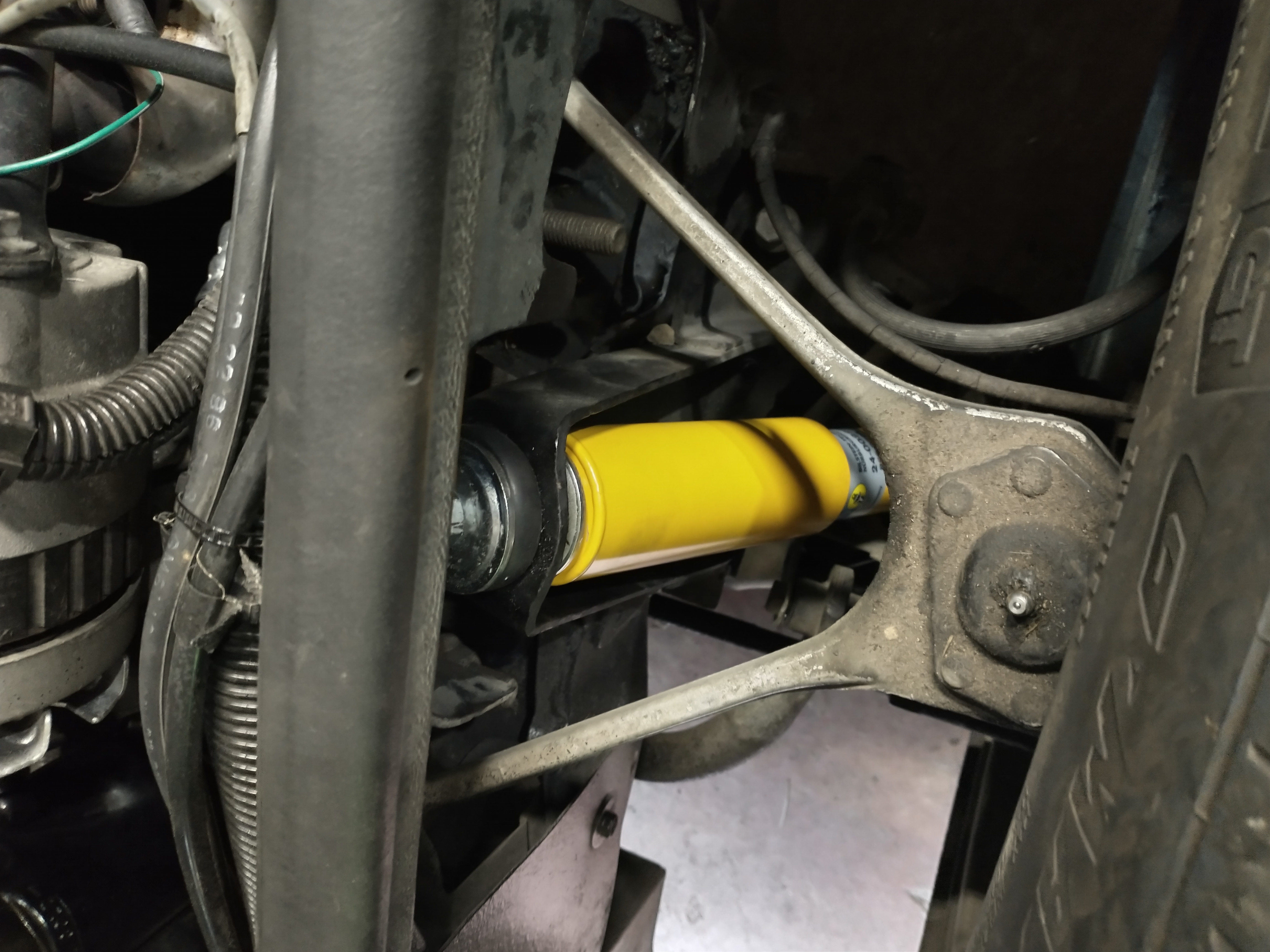

Today we got the new PowerStop front brake pads installed. Probably the easiest pad slap I've ever done. If I would guess, this is what they call a floating caliper. So simple. While we had the wheels off and the parts on hand, we replaced the original Z52 Bilstein shocks with brand new Z51 versions. Apparently there's a difference and we wanted the stiffer shock.

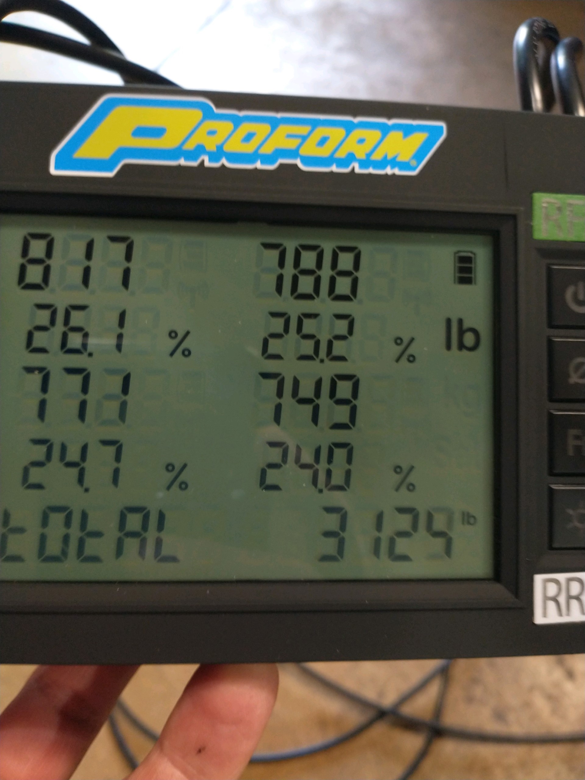

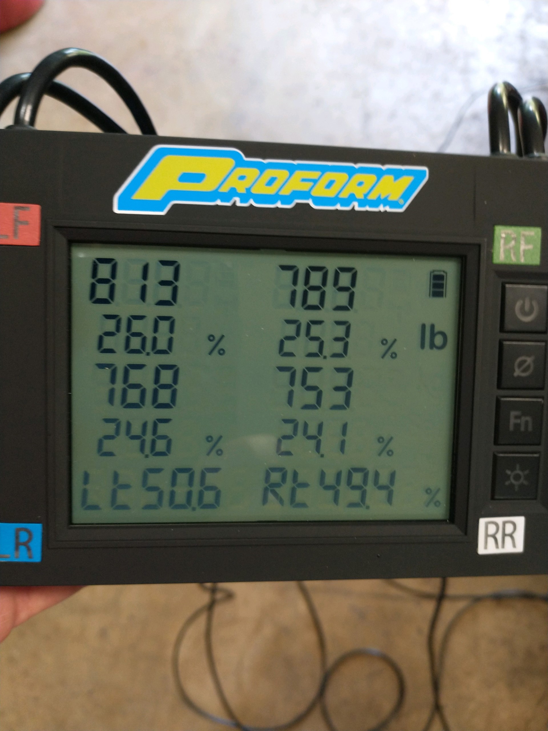

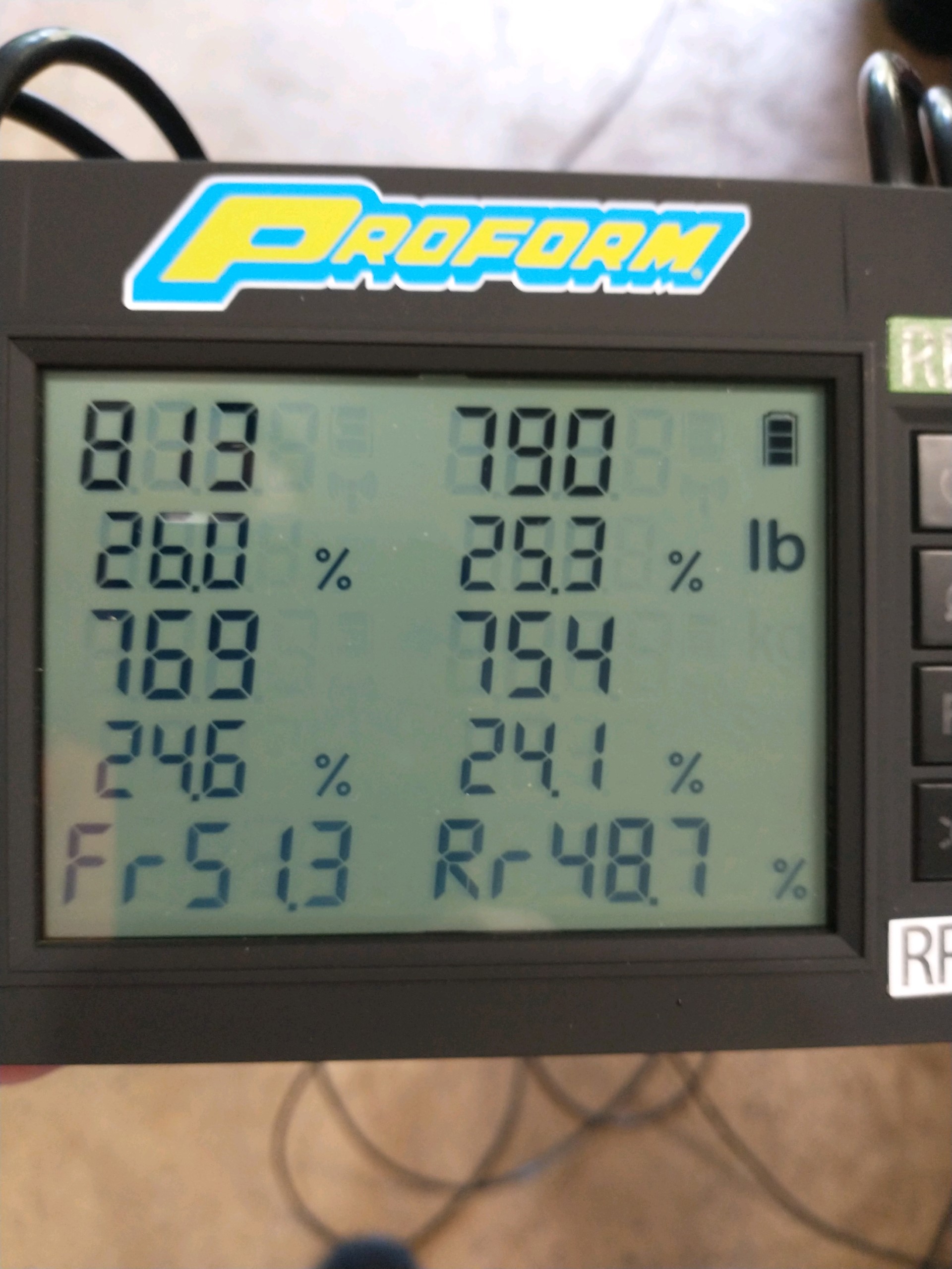

Saturday was a short day, but we got the car weighed and put new wiper blades on it. The weights shown are with almost a full tank of gas, so at least 18 gallons in there. With less than a half tank, it should be closer to the 3000lb mark. Then over the winter I think we'll attempt to lighten the load, but keep it completely stock looking inside. Gutting the interior on the Firebird was fun, but ultimately put us in some race car class at the autocross. So we'll have to be more selective in what we do now.

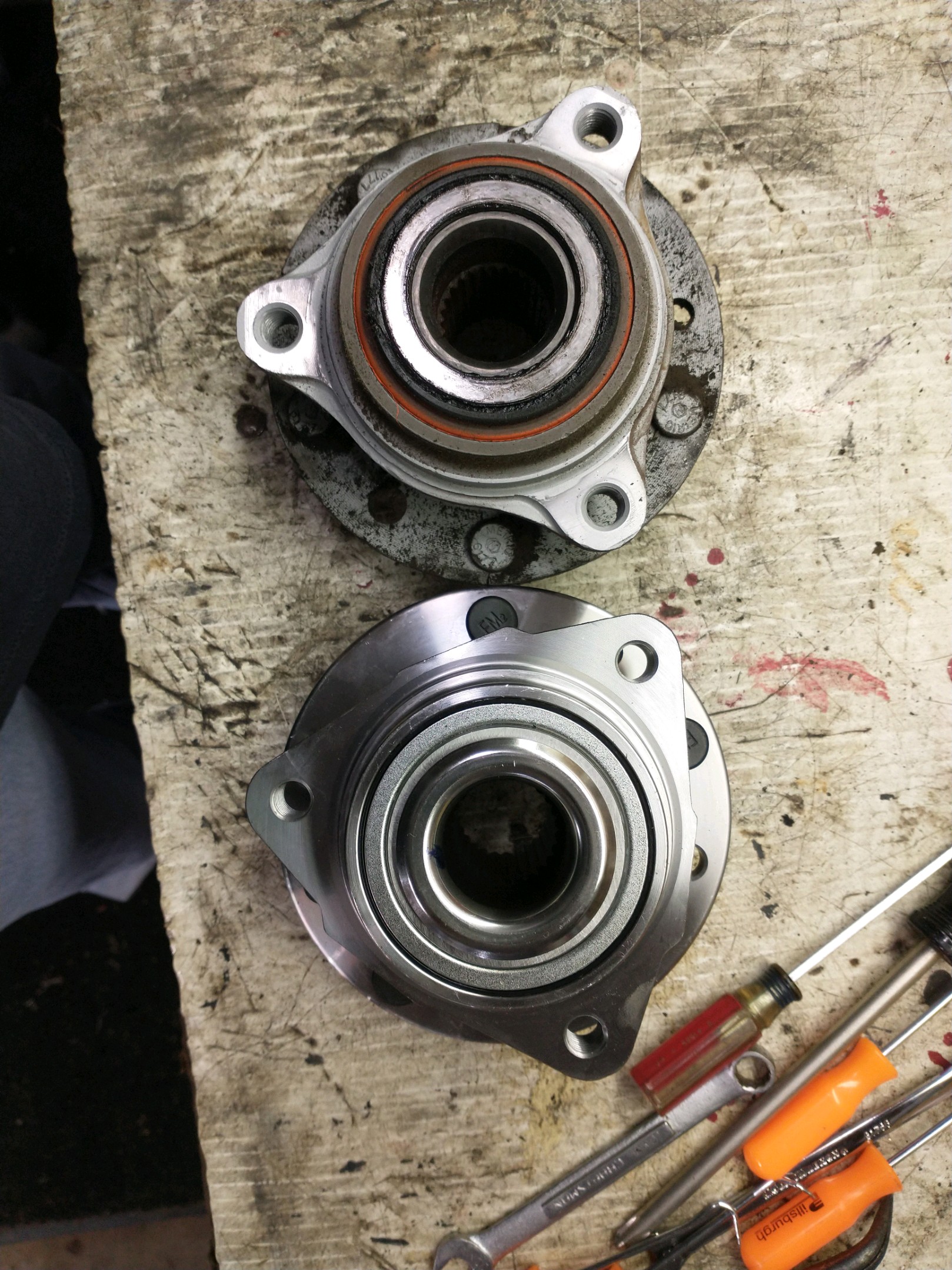

On Saturday we got the driver's side rear wheel hub replaced, and today we got the passenger's side one done. I struggled on Saturday getting the new hub inside the parking brake assembly and ended up dismantling all of it. I did this because the new Moog hub is made slightly more material than the stock hub that basically just fell out. The problem is not dismantling, it's reinstalling all the parts with the hub in the way. After lots of cursing and aggravation, we got it back together and installed.
Today I showed up with a different outlook on how to handle the problem and within five minutes I had the new, bigger hub installed inside the brake parts with no dismantling. Just like on regular drum brakes, there are springs and some movement available so I got a tiny pry bar and was able to literally shoehorn the hub in. This job went WAY faster the second time around. We also took the spare tire holder assembly out of the car completely. Probably about 10lbs worth.
Tomorrow I'll recheck the oil (and probably add some) and I'll be off to the track again.
