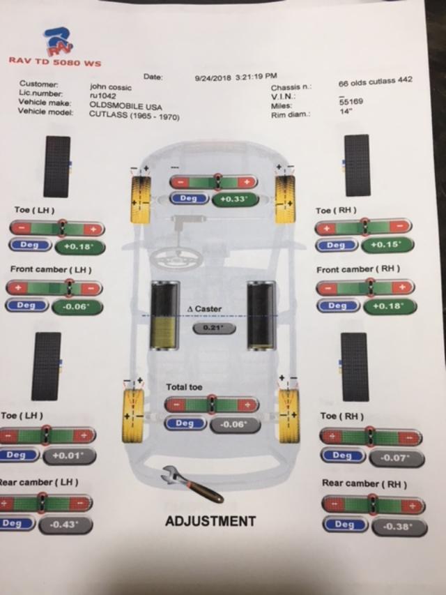

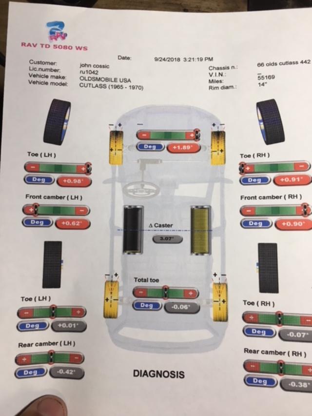

I had a small vacation which started on Thursday. I had slated the 442 for a front end alignment on
Friday. Paul Carson took the car to his work with him on his way in. On his way in, he called and told
me that the generator light came on and the volt gauge was reading 12 volts. I told him to keep going,
there's nothiing but the points running off of the battery, I knew it would make it to his shop. It did.
When he put the car on the alignment rack he noticed that the center link is bad. I haven't rolled under
the car to see how bad it is yet, but the new center link is on its way here. I drove the car back with
the generator light off, but the gauge still read only 12 volts. When I got home, I whacked the voltage regulator
with a wooden hammer handle and cleaned the contacts with WD-40 and it starting charging. Not wanting
to rely on my repair forever, I ordered a new regulator also. The parts will be here this week. I did

changed the center link. I'm not at all convinced it was even bad, but the new one
is epoxy coated and has grease fittings on it, the other one was non-greasable. The
replacement took me about an hour, it wasn't horrible. I'll try to schedule a front
end alignment this week. With the wheels up in the air, you can really tell that it
needs one.

Re: 1966 OLDS 442
Front end alignment was done yesterday. Fortunately I live very close to my mechanic friend
who drove the car to his work and did the alignment. I could tell the alignment was bad, especially
after the new center link was installed. Here is the computer printout of before and after the
alignment. I think I just saved myself a tenth or two in the quarter after seeing how far out the
alignment really was. I'm going to have to put the front tires on the back now to true them up
a bit!! It's pretty obvious which is "before" and which is "after".
