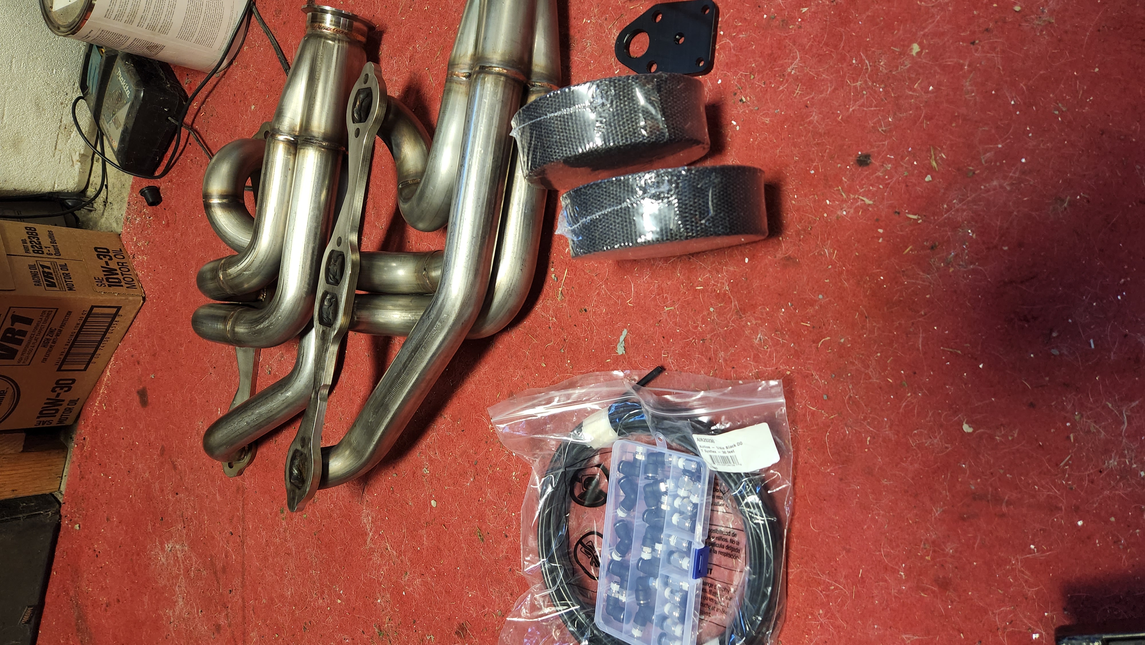

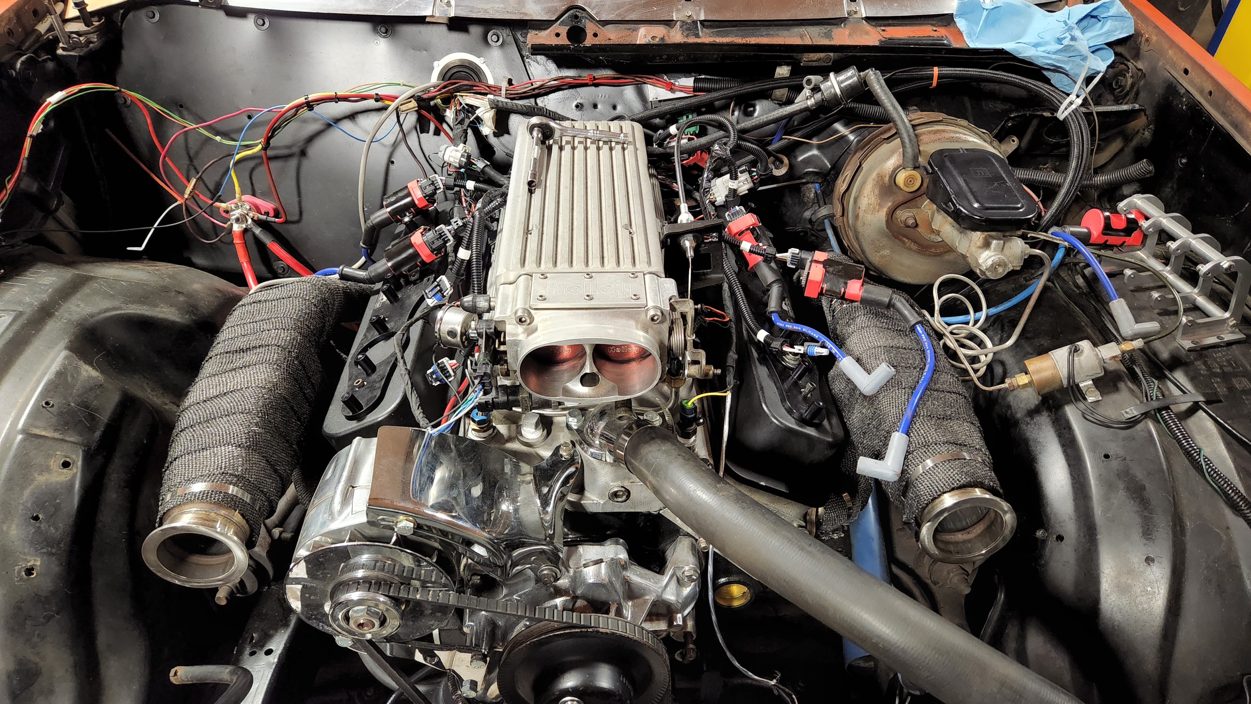

Picked up some turbo headers plus header wrap. I also picked up these fittings and hose to use where vacuum lines go. They are 1/8" npt on one side like a lot of vacuum fittings, and the other side is sorta like a shark-bite connector in plumbing. Stays tight, but easy to release. Also picked up an oil drain back plate for where the fuel pump is normally mounted. This will receive the drained oil from the turbo. Saves having to modify the oil pan.

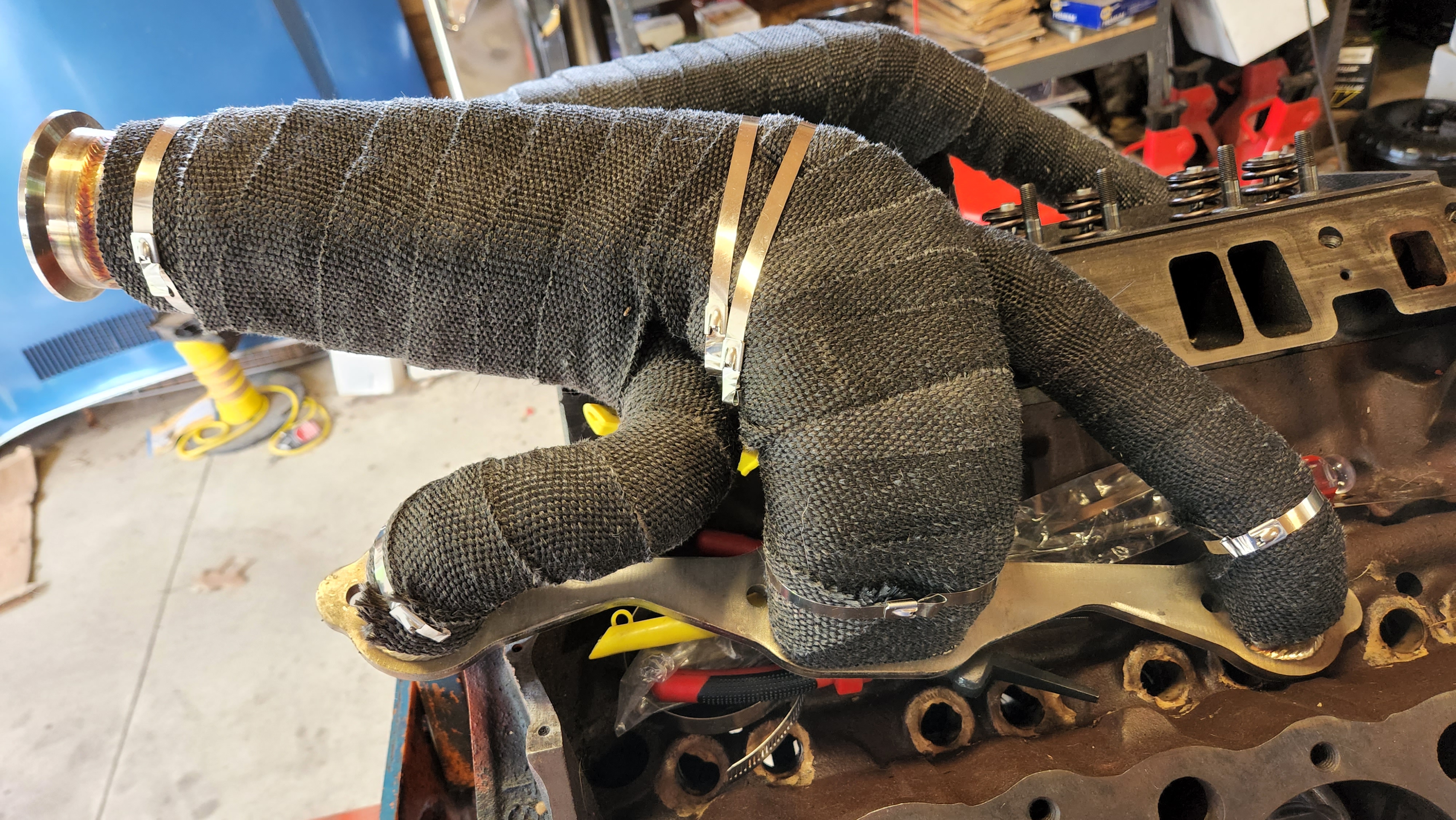

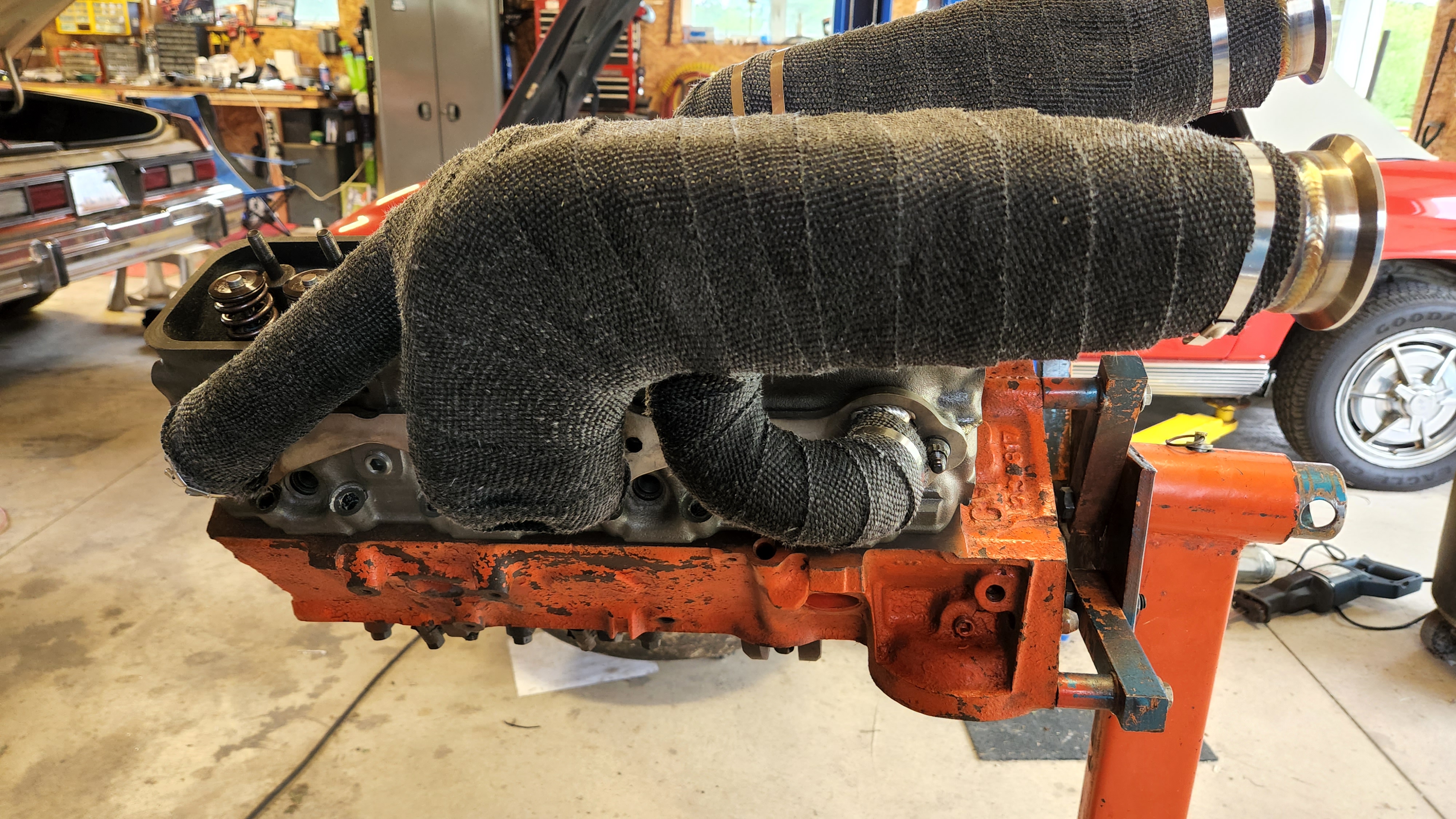

A few years back, Gwen wrapped the exhaust on her old motorcycle and it came out pretty good. I asked her if she'd give these a try and she agreed. I wheeled an old 400 block (the one from Bailis!), put a head on with a single bolt, and mounted up the headers one at a time. She did a great job :-) The one with the bands in the middle was the first one, and like most things, the second one turned out a little better.

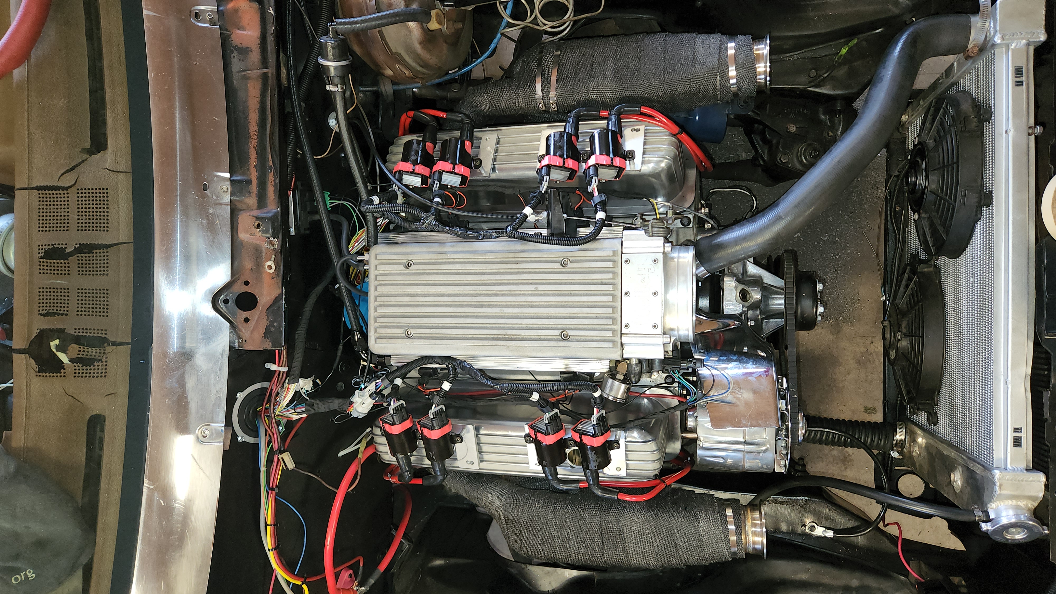

Well 1 step forward and 2 steps back. The new wrapped turbo headers are in... and my coils dont fit, at least the front two on each side. More re-engineering!

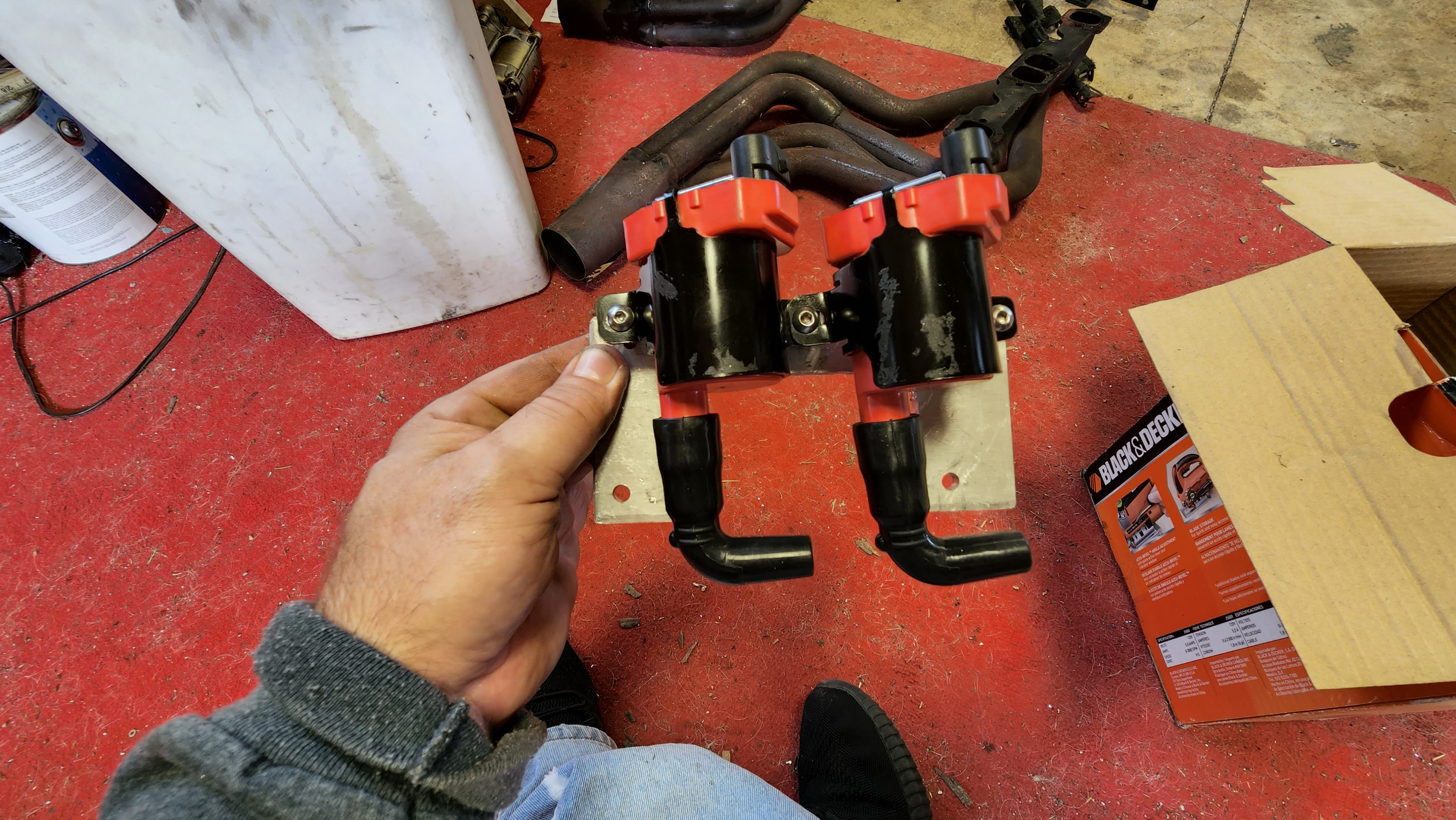

Alpha prototype.. spark plug wires will route around front and rear tubes of headers, instead snaking straight down between header and valve cover.

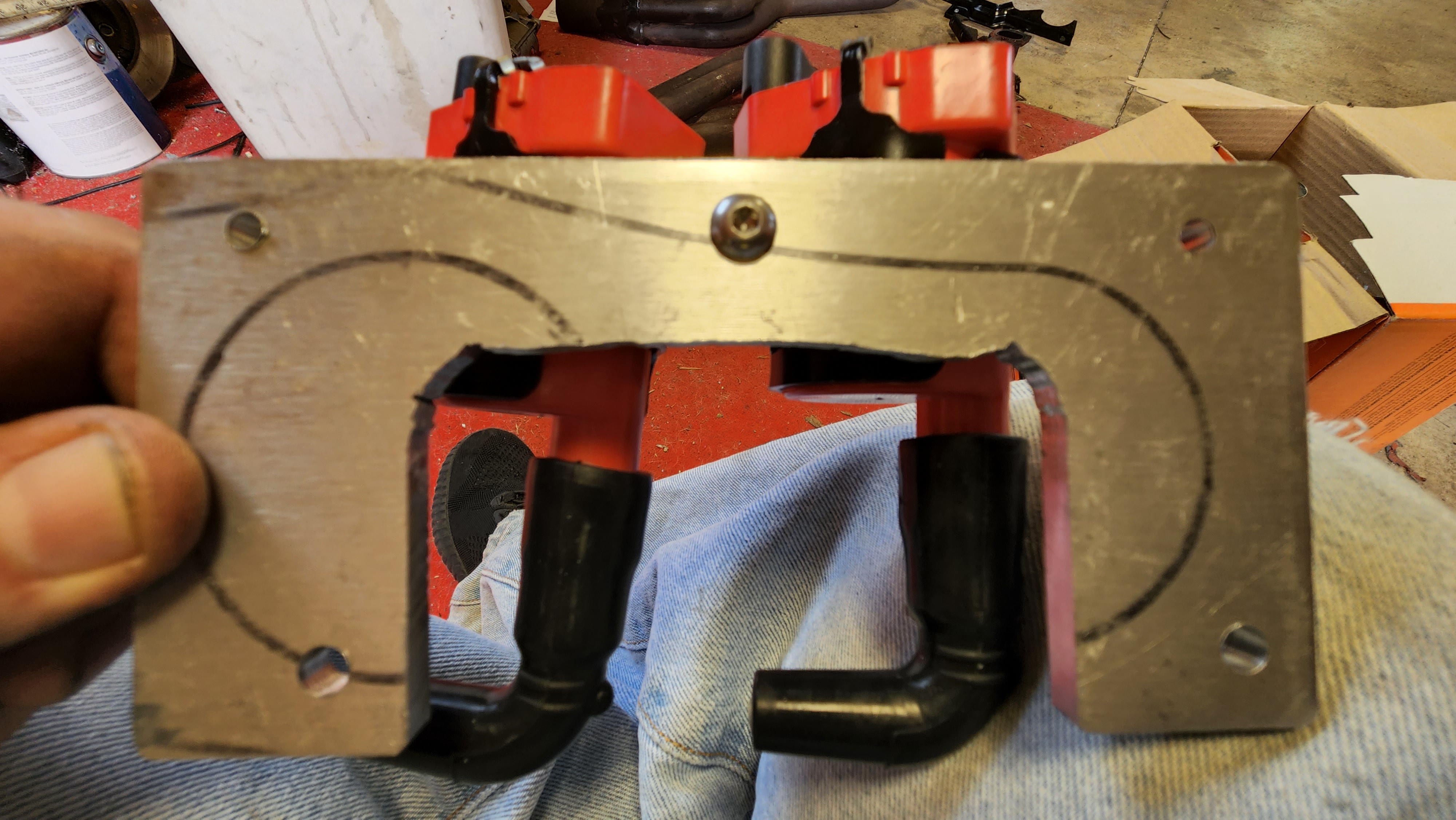

I made some coil brackets. They're not pretty, but I think they'll work. I'll get them all finished up and then finish off the new plug wires. I'm also going to use these talled, finned valve covers. As a bonus, I put my good EFI Connection coil brackets back on the Chevelle, which means I can put everything back together on that one.

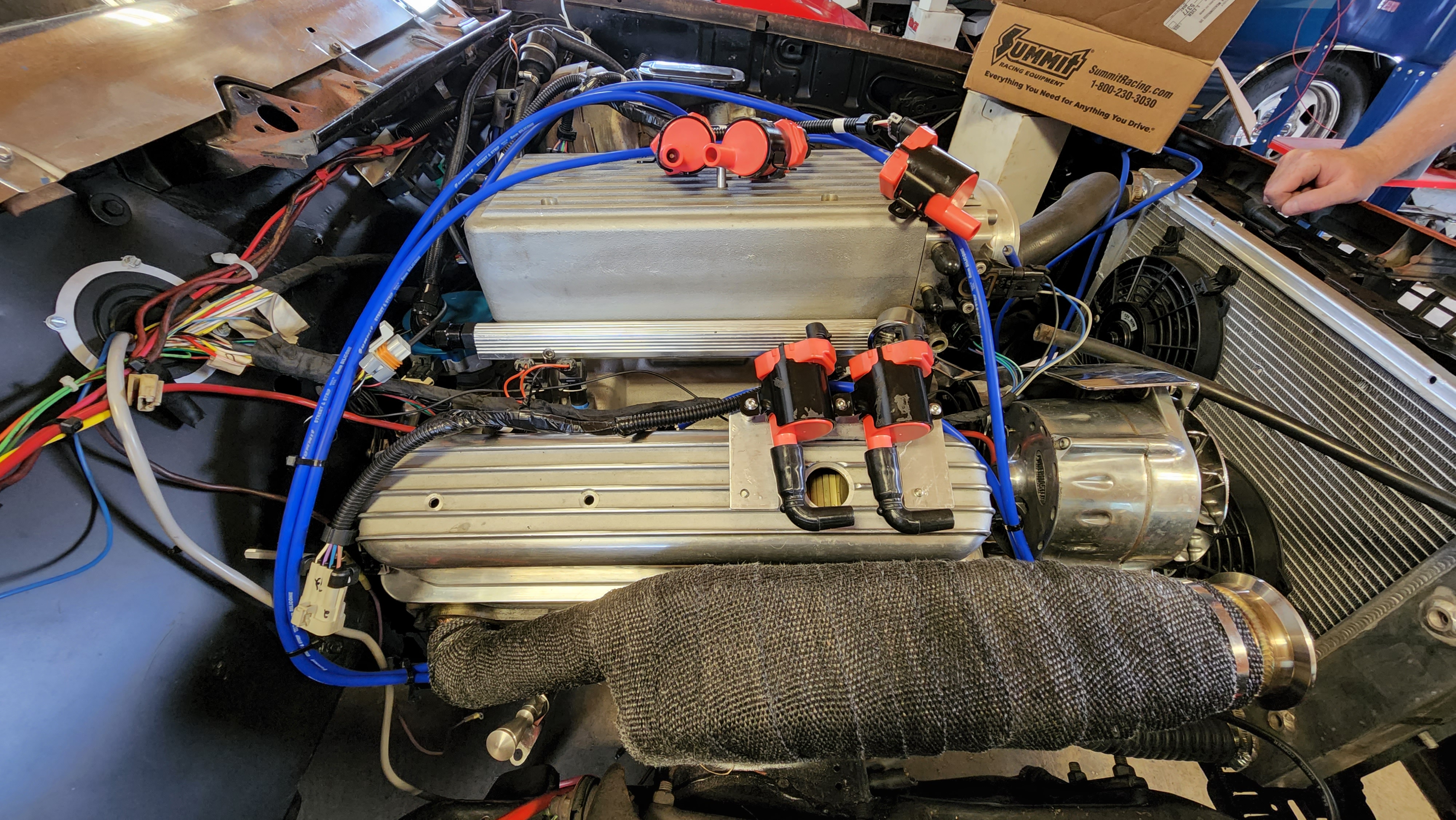

Finished and ready to fire, save for longer studs for the valve covers. I dont want the coils flopping around. But otherwise done.
Fun facts I learned.. the spacing between the front two valve cover bolts is different than the rear two.., by about 5mm. I really need to space the coils further apart on the pairs that go around a PCV/breather hole. Also, those coil boots are so big and everything is sealed so tight, I end up having to 'burp' them with a small screwdriver between the coil and boot to let the air out. You can hear it.
I modified one of my tools to have a small hook. This was huge in trying to get those 90 degree boots on the coil side. I fished my hook through the boot so I could pull on the plug wire while guiding/sliding the boot down the wire. (wd 40 to make everything slide easier) Otherwise, it's like trying to push a slippery rope. The spark plug ends are a piece of cake.

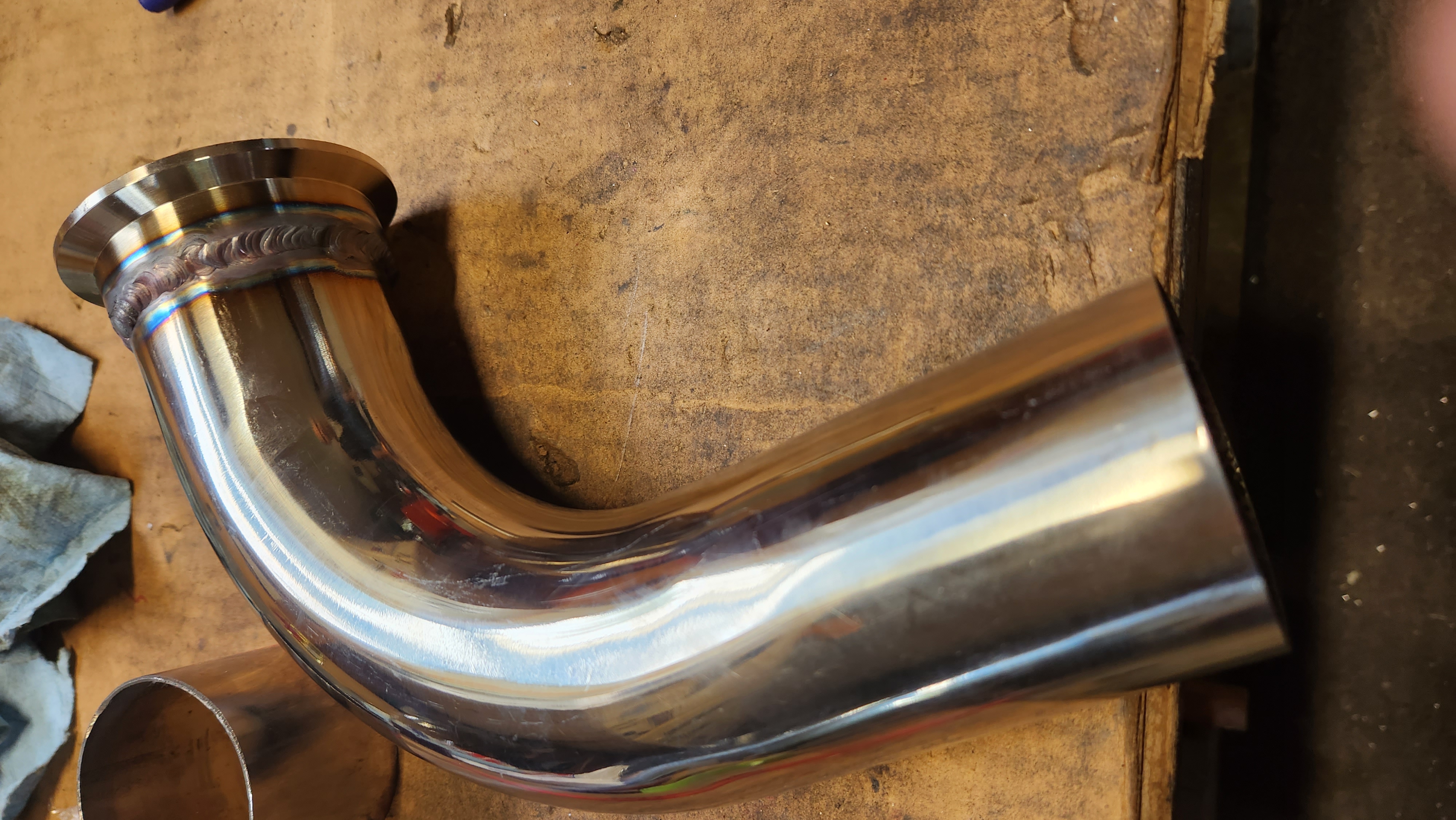

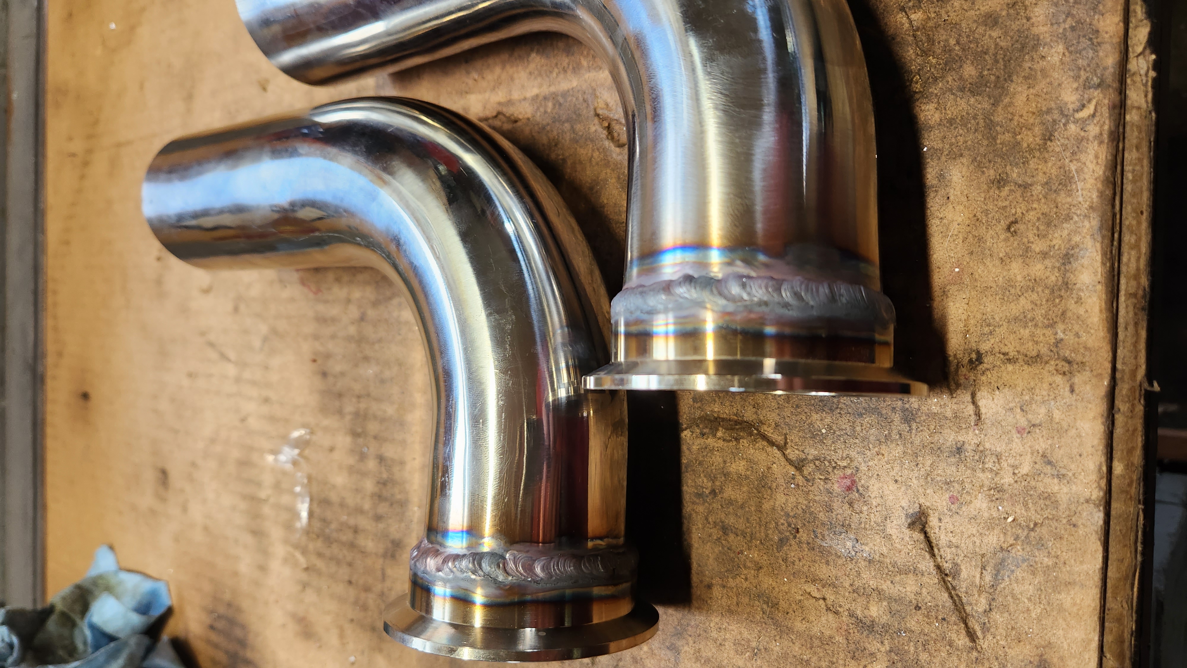

Made a trip down south today and stopped to see Cut N Paste welding to get a couple temporary header outlets made up.

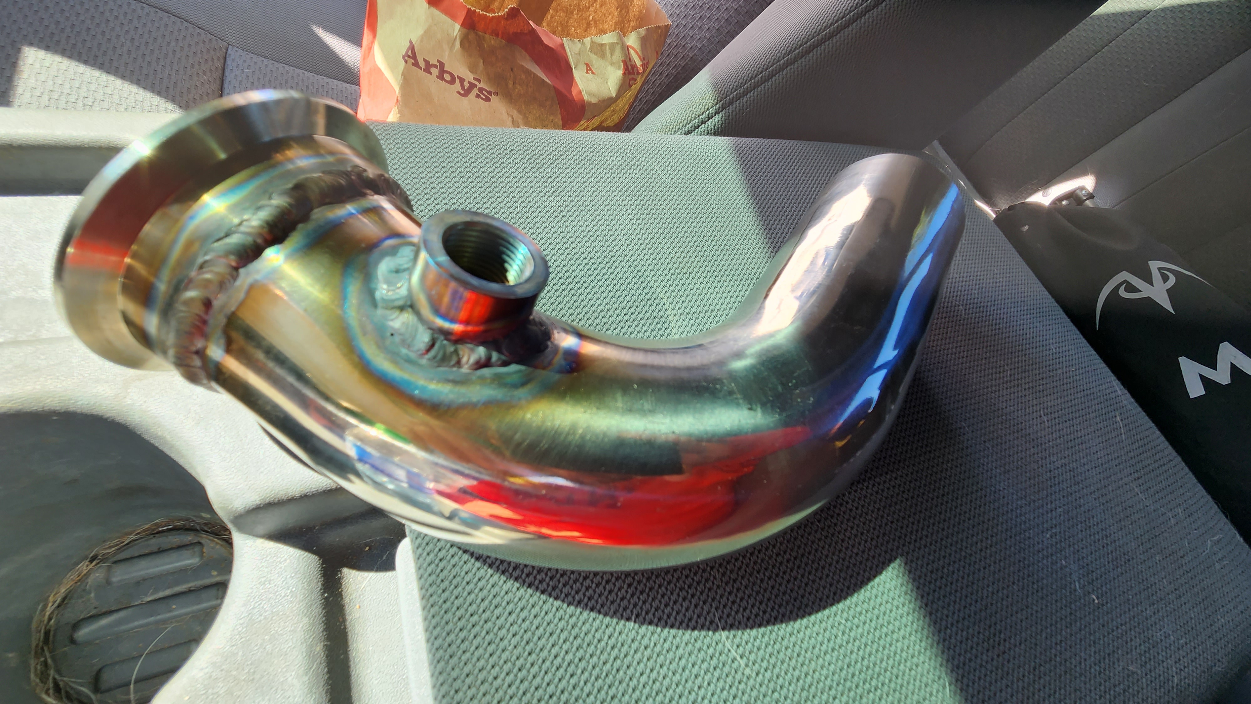

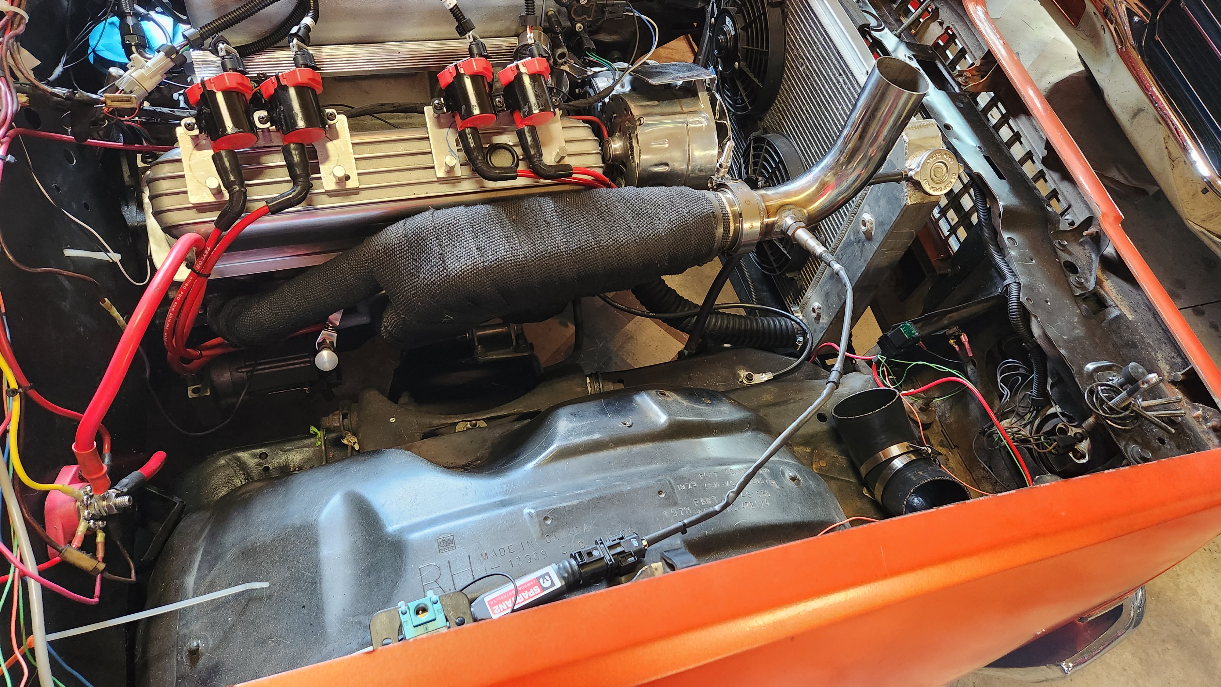

Well, I made a key mistake/omission on the pipes I had Kurt make up -- no O2 bung. They're fine for running the car around the garage or driveway, but when I was thinking about whether I could make an N/A pass with it this weekend, I didn't wanna do that without an O2 sensor. I have new, much larger injectors installed and my tune will surely require a little tweaking.

since you have easy access to the inside, could you drill a hole and double nut the sensor in place?
the other option to consider is if you have a pipe with a bung you could band clamp it on top of one of the stacks.

Since I had to make a trip over to Team FIckle Bitch to empty out the race tires from last weekend, I made another stop at Cut N Paste Welding to get an O2 bung added into my pipe. I'm not sure how well it's going to work, but gotta be better than nothing. It should be OK under load.
