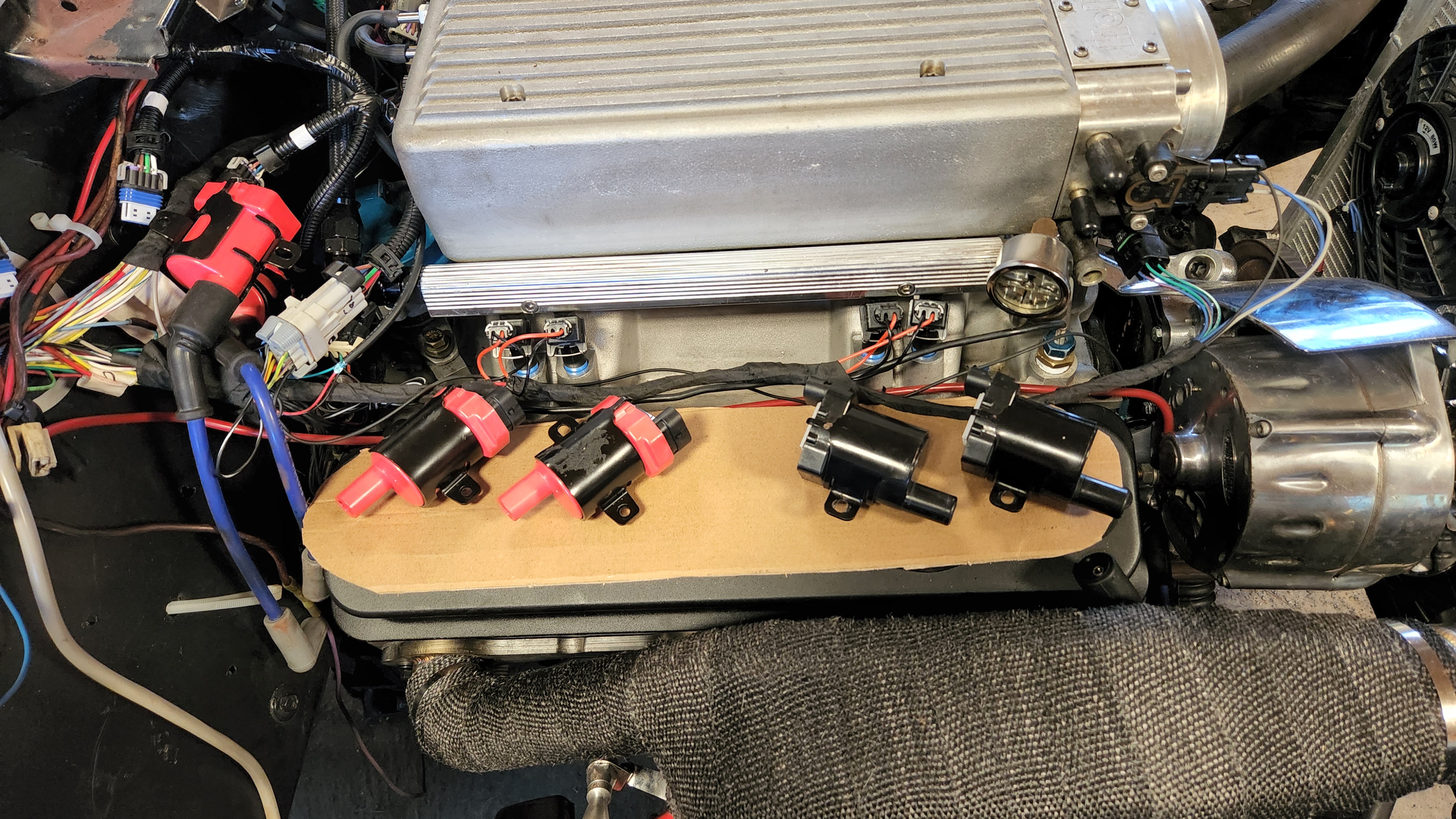

Well 1 step forward and 2 steps back. The new wrapped turbo headers are in... and my coils dont fit, at least the front two on each side. More re-engineering!
- Posts: 2632
Re: 1979 Malibu
Alpha prototype.. spark plug wires will route around front and rear tubes of headers, instead snaking straight down between header and valve cover.

I made some coil brackets. They're not pretty, but I think they'll work. I'll get them all finished up and then finish off the new plug wires. I'm also going to use these talled, finned valve covers. As a bonus, I put my good EFI Connection coil brackets back on the Chevelle, which means I can put everything back together on that one.
- Posts: 2632
Re: 1979 Malibu
Finished and ready to fire, save for longer studs for the valve covers. I dont want the coils flopping around. But otherwise done.
Fun facts I learned.. the spacing between the front two valve cover bolts is different than the rear two.., by about 5mm. I really need to space the coils further apart on the pairs that go around a PCV/breather hole. Also, those coil boots are so big and everything is sealed so tight, I end up having to 'burp' them with a small screwdriver between the coil and boot to let the air out. You can hear it.
I modified one of my tools to have a small hook. This was huge in trying to get those 90 degree boots on the coil side. I fished my hook through the boot so I could pull on the plug wire while guiding/sliding the boot down the wire. (wd 40 to make everything slide easier) Otherwise, it's like trying to push a slippery rope. The spark plug ends are a piece of cake.
