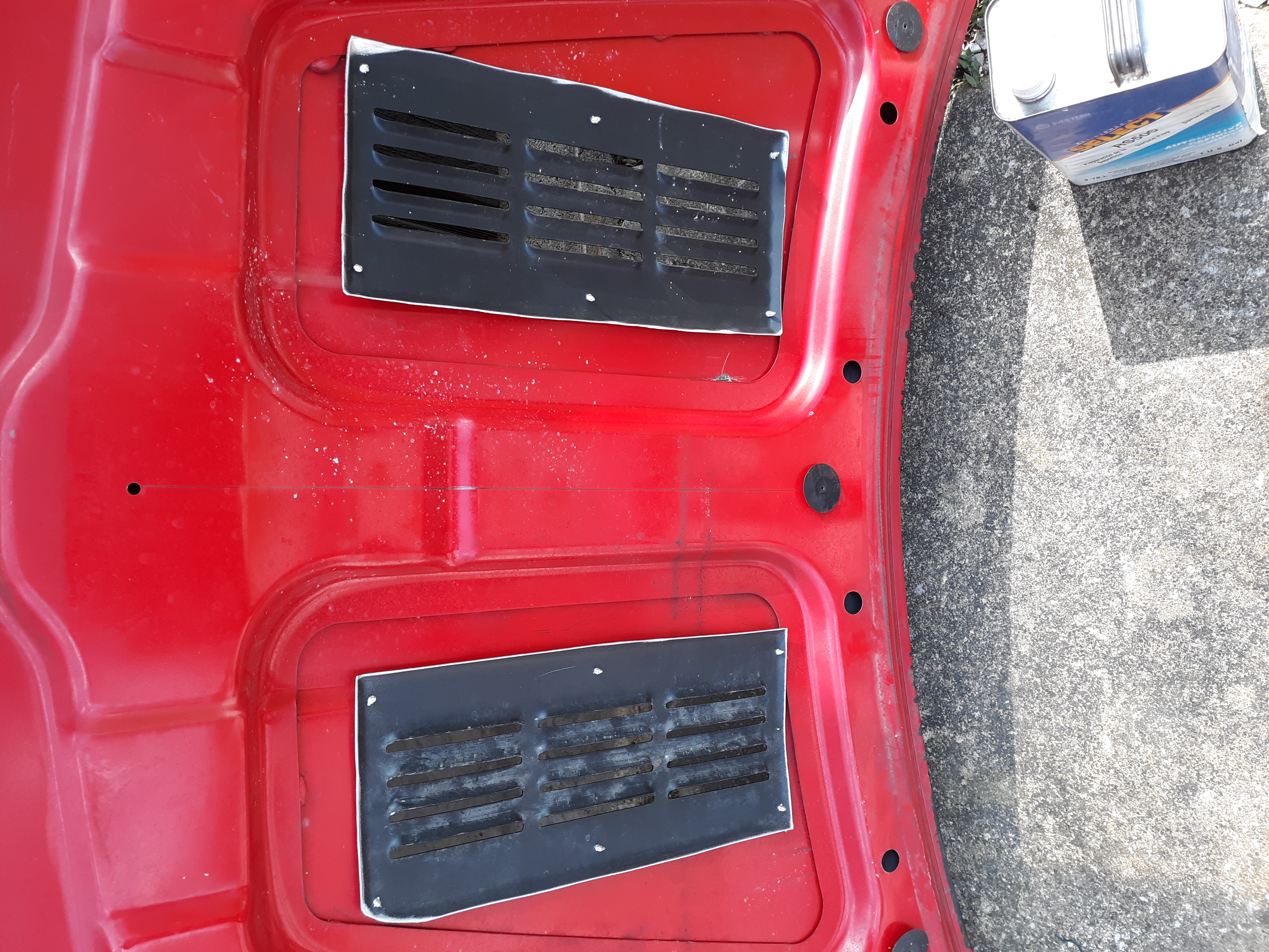

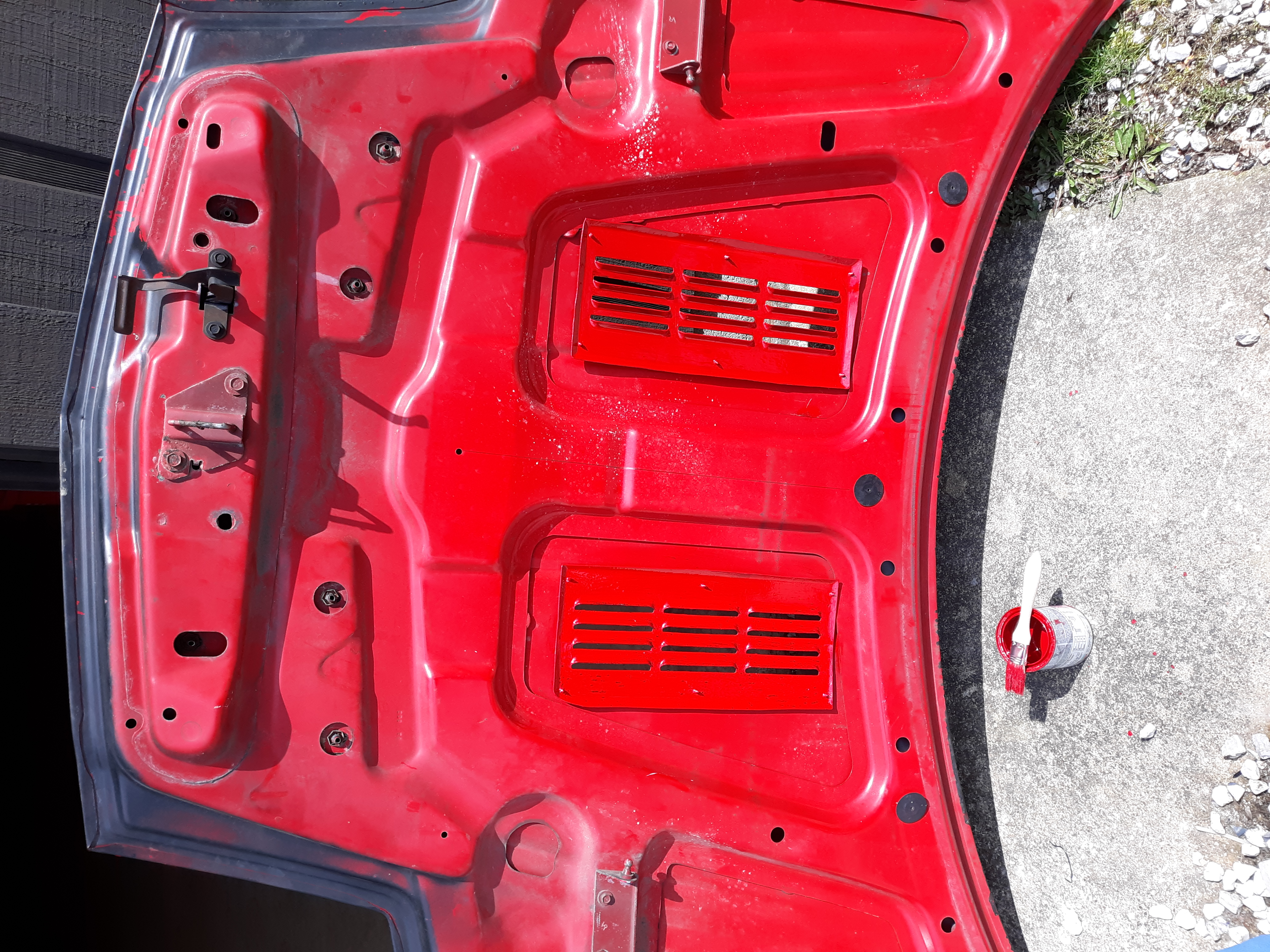

The nice weather allowed me to work on the TrackBird's louvered hood.
First thing was to go underneath and make the vents Red.
I brushed on some '05 Silverado Red that I had after I prepped and sanded.
To my surprise, the right vent had fish-eyed badly. I put on 2 more coats,
looks not good, but under there it doesn't matter.

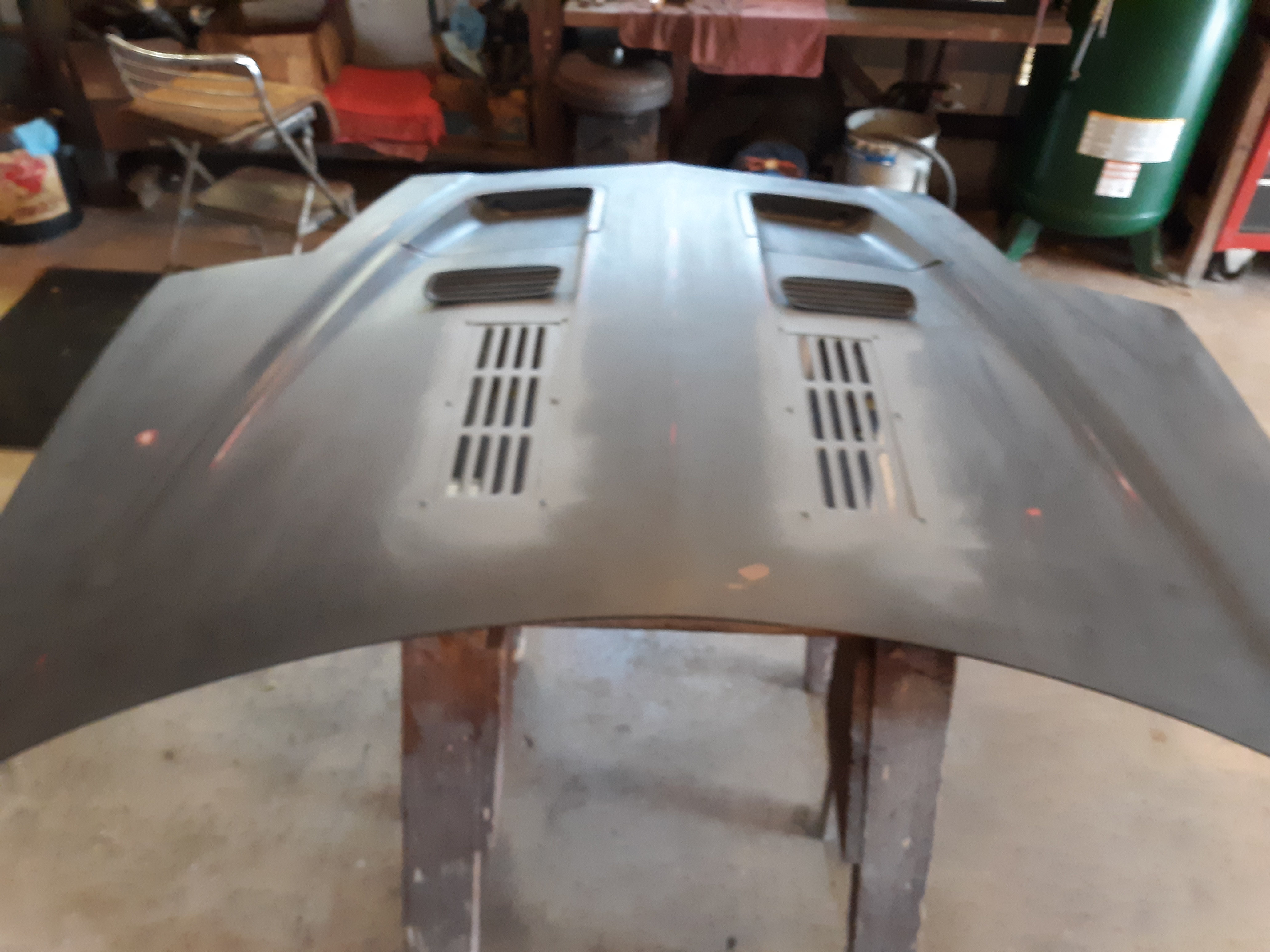

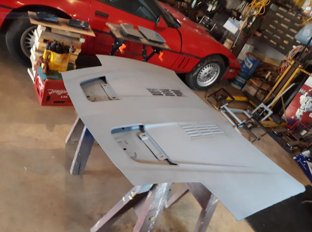

I then turned the hood over and much more thoroughly cleaned and
hand sanded the new louvers. Then I DAed the rest of the hood with 320.
Lastly, I put several coats of primer on the new louvers and no sign of fish-eye.
Under hood - before
Under hood - before
under hood after
under hood after
ready for paint
ready for paint
It was just like I was back at Ralph's Forbes Rd. Auto body, 60 years ago.
A strange kind of fun, can't wait to see that hood in Firebird Red.

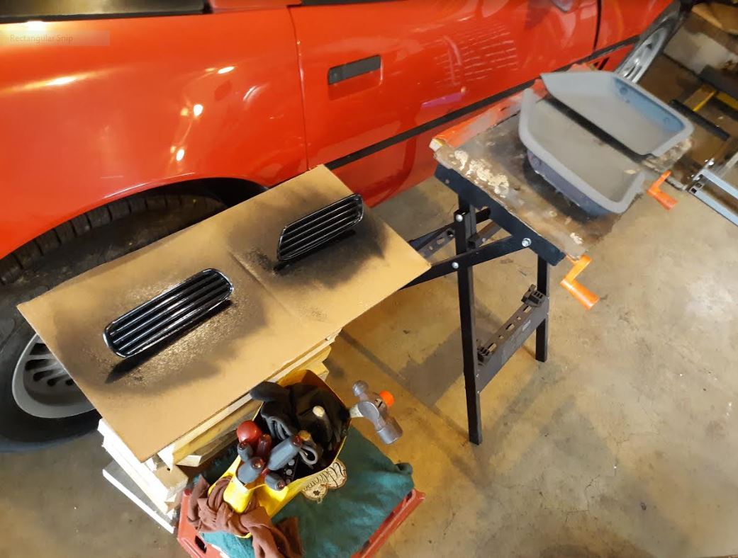

Today I did the final primer coat on the hood and painted the simulated vents black.
vents are black
vents are black
hood ready for paint
Ready for color after a light sanding.

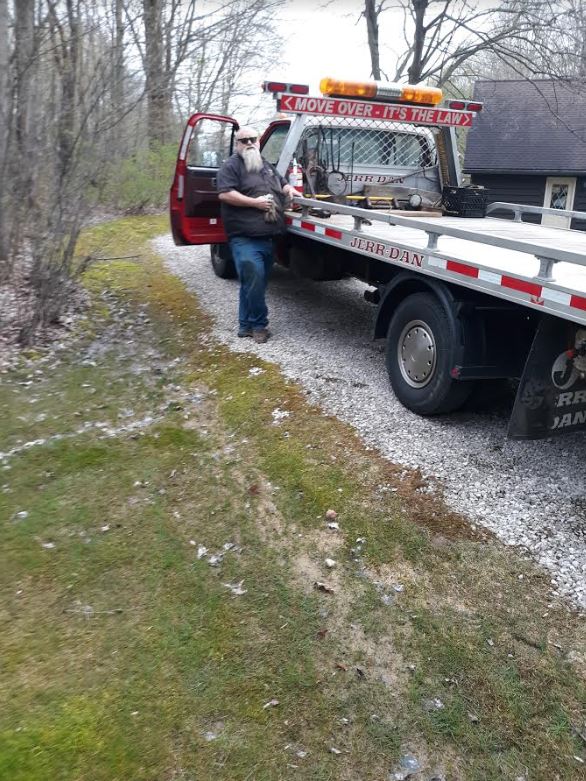

After 11 good passes at the test n tune, TrackBird was not able make it home from Dragway 42.
The rear end has issues, we'll have a look at it soon.
Bob Fade
Bob Fade
Our old friend Bob Fade brought the 'Bird home.
We plan to have the car ready for June 8th.

Re: 1997 Pontiac Firebird
Boba Fade with the Millennium Flatbed to the rescue. hope it didn't blow up the gears but i am not optimistic
Posts: 3682
At those speeds, I'm figuring anything that rotates is junk at this point. Worst case scenario is JD Race (assuming this wasn't his fault) has a completely rebuilt 3.73 sitting there ready to go for under $1100 that would bolt in...
Posts: 3682
There is also the possibility that the rear u-joint let loose somehow... The more I thought and talked about it, there is a definite chance this happened. I'm not sure if that's better or worse at this point. I know everything is still in place for the most part under the car. More to come.
Posts: 2645
You know, I thought I saw a u-joint cap on the ground, as we were pulling away from our 2nd inspection, on the right berm of the road. I wasn't sure if thats what i saw, because I only caught a glimpse.
Posts: 3040
a driveshaft, u-joints and a new yoke seems like a better deal than replacing the housing inners.
