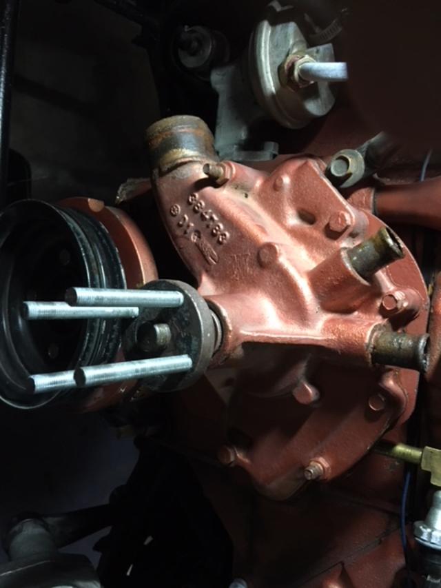

Saturday I spent some time working on the 442. The goal was to get the water pump and harmonic balancer
changed and, with the coolant out of the car, switch the gauges the next time I had time. I drained the coolant
and took the radiator out. The water pump came off easily and so did the harmonic balancer. Things were going
pretty well until I went to put the balancer on and it was the wrong one. Turns out that Summit listed it for
Pontiac and Oldsmobile 400's and it won't go on an Olds. I called Summit and I can ship it back to them (even
though I painted it and the box) without a problem and they'll give me credit for it, less shipping. The real issue
is getting a new balancer. They said they'd be able to ship in Mid-May. I'm not wanting to wait that long. I really
thought that the harmonic balancer was my vibration issue, but the water pump nose bearing was going bad
and, when you grabbed the front and wiggled, there was movement. I'm guessing that any bearing bad at 3500
rpms will cause a vibration. That fact, coupled with the fact that I've never had a harmonic balancer go bad
in all of my years of driving, made me pretty confident that I could bolt the old one back in. The balancer came
off very easily, so IF it is bad, I should be able to change it pretty easily with the front of the motor together.
I have the water pump on the car now and the balancer. I removed the spacer between the pump pulley and
fan ( the spacer that made it so you HAD to pull the radiator to get the fan off!! -- 1/8" between the fan blades
and the radiator ) and installed short studs that I purchased when I was going to put TireSmoker's 7 blade fan
on my 69 Chevy truck. I'm going to go with the 7 blader over my current 5 blade, so I put his fan on my clutch
and we will be good to go. Here's a pic of the bad water pump with the super long studs in it. I'll hopefully
make some more headway this afternoon.

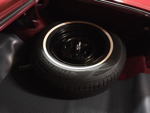

With time left to tinker, I went to work putting my jack together. It went perfectly! The
jack post and base are a Carlisle find, they are Chevy parts. The hook was from an Ebay parts jack
that was from a 66 Cutlass. That jack had no base. I opted for the Chevy jack which is a bit more
substantial but in very nice condition. It was about two inches too long, so I took my torch to it to
make it the correct length. With the jack post to the correct length, I was able to get all of the parts
wire wheeled, sanded and painted. I did this earlier in the day so they had time to dry before I put
it in the trunk at 8:30 pm. I used Dupli-Color satin black and Rust-o-leum aluminum for the finish
coats. Both of those paints are quick dryers, and were perfectly dry when installed. I bought some
foam pipe insulation to wrap the jack in to protect the floor of the trunk. They sell thin rubber sleeves
for this application, but I wanted a bit more clearance between the jack and the trunk floor. It all
went together super nice. When I think of all the effort that I went through to just get a spare tire
and jack it makes me laugh. It feels like a major project has been accomplished!

I started on the pile of new parts that were on the bench this weekend. Sunday, I bolted on a new heavy
duty fan clutch ( part # from a 66 Toronado ). Good thing I did this, as the old clutch was starting to come
apart and leak. You could also push in on it and feel some bearings grinding. I also installed and a new harmonic
balancer. After having to tap tap tap the new balancer on, and re-assembling, I fired the car up and set the timing.
It ran like crap and I was not pleased, so I pushed the car in the corner in disgust, and decided I needed to regroup.
Fred had some time Monday afternoon, so he came over AFTER I rebuilt the center carb and bolted it back on the car.
He and I discussed the issues that I was having, and we decided that a trip to Paul Carson's for a minor consultation
was in order. After explaining my stalling issue to him and a short conversation about the new harmonic balancer,
we headed back home. What Paul discussed with us was that the ( and we knew this but didn't think about it, duh )
timing mark should be on 0 at top dead center. Obvious. We pulled the #1 plug out and put a screwdriver in the
hole to find top dead center. At that point, the new harmonic balancer was about 12 degrees off! Unreal. So we
pulled it off ( which was a chore because of the tap tap tap scenario described above ) and re-installed the old one.
The old one was dead on 0, proving that it was still good. ( I read that balancers would sometimes fail when old
and get out of center and vibrate. ) After firing it up and setting the timing ( which is proving to be a real chore with
this distributor and we don't quite know why yet ) we took the car for a couple of test runs. The good news is that
the stalling issue is gone and the vibrations are too. The bad news is that it's dieseling when it shuts down. I'm hoping
that the final timing will help cure some of this. We are struggling to set the timing because the car will overheat when
it idles too long in the summer-like heat we have this weekend. We do a minor adjustment and the distributor is SO
sensitive that we need a lot of time to do the work. We will have to go at it another day or at night when it is a bit
cooler out. I leave this long weekend feeling a lot better knowing that I've cured that idle issue and the vibration deal.
I'll keep on forging forward.
