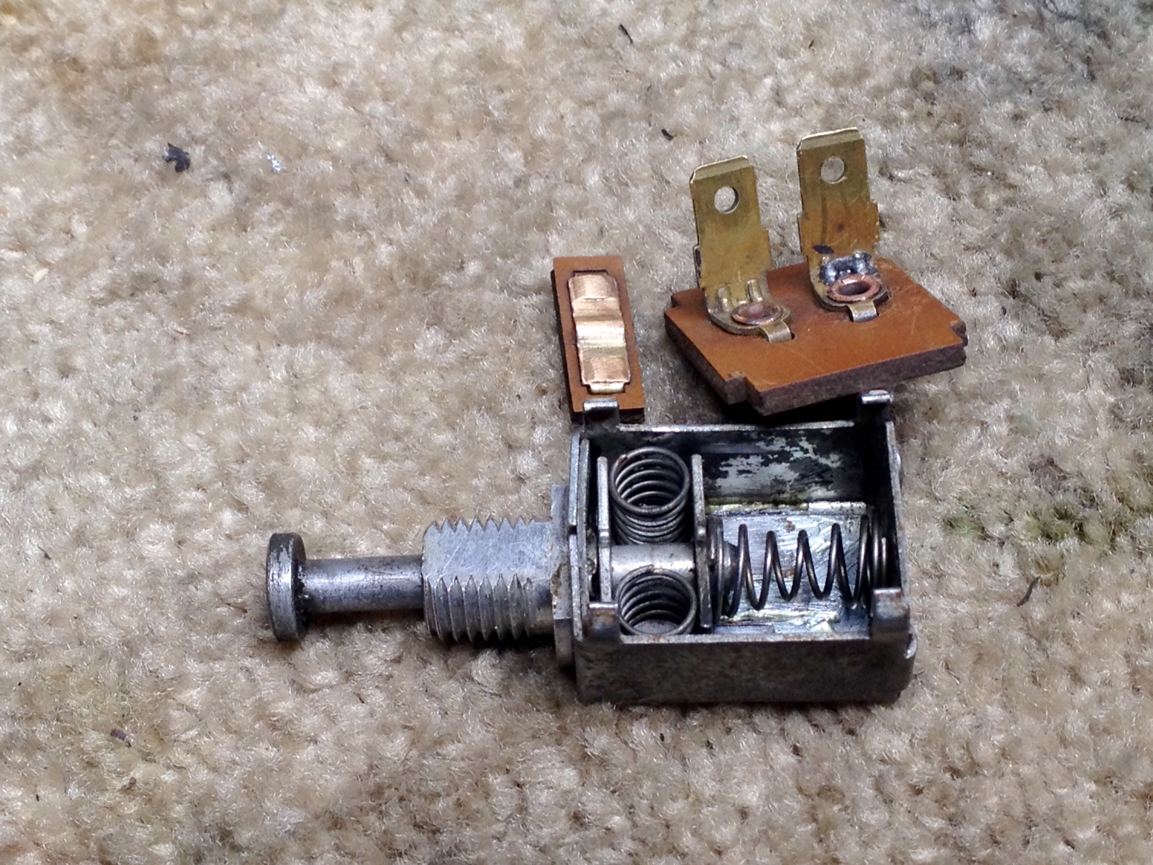

I decided to disassemble the bad neutral switch to see what it looks like inside. I was amazed to find that it was in quite good shape. I cleaned it up, tapped the rivets to tighten the connectors and lubed it. Then I checked it with a meter and it was working as good as new. I decided to reinstall it in the PTO circuit and remove the jumpers that had been added. It works like a charm. Here is what a great, "old school", rebuild-able, switch looks like inside.
