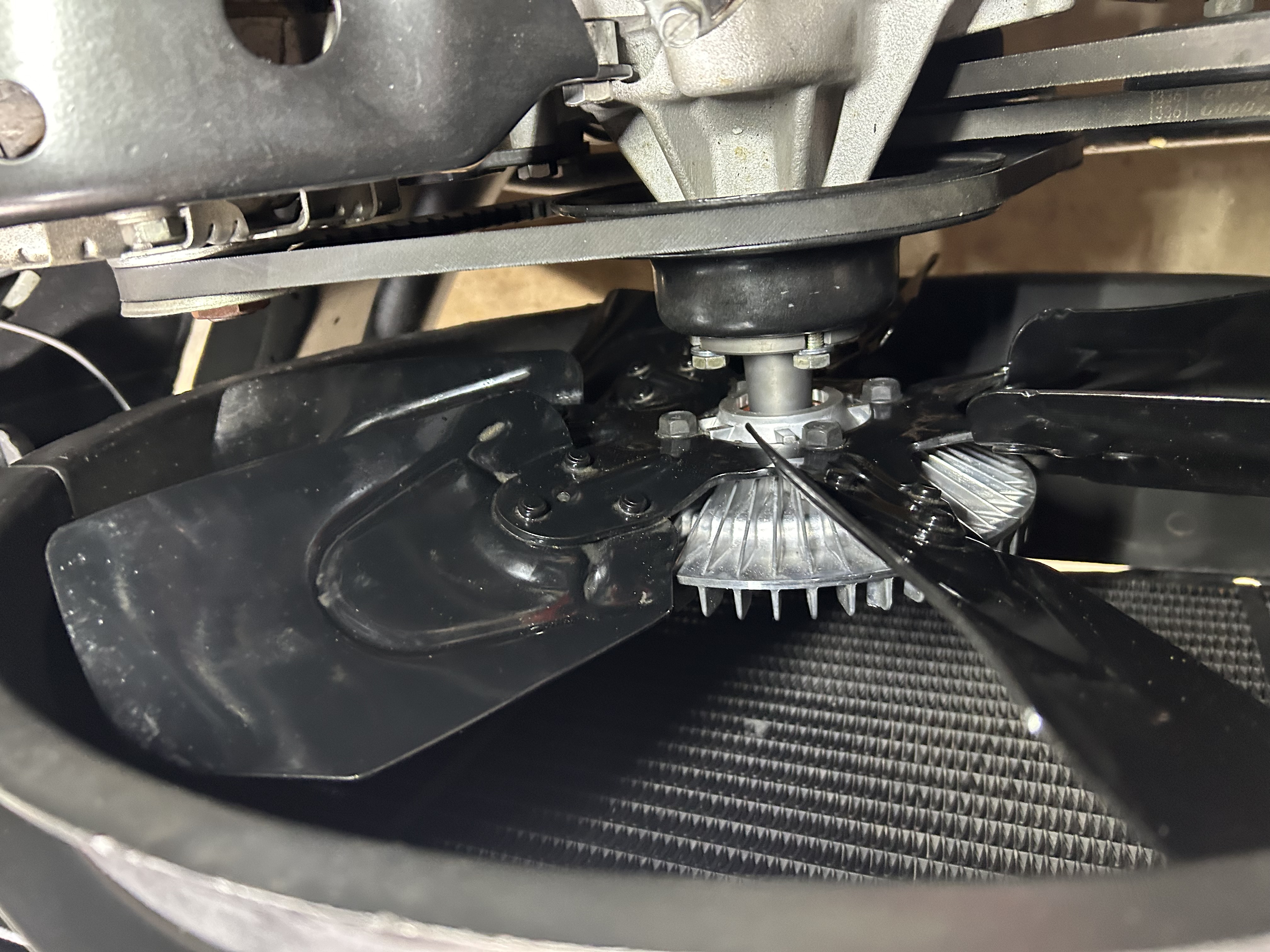

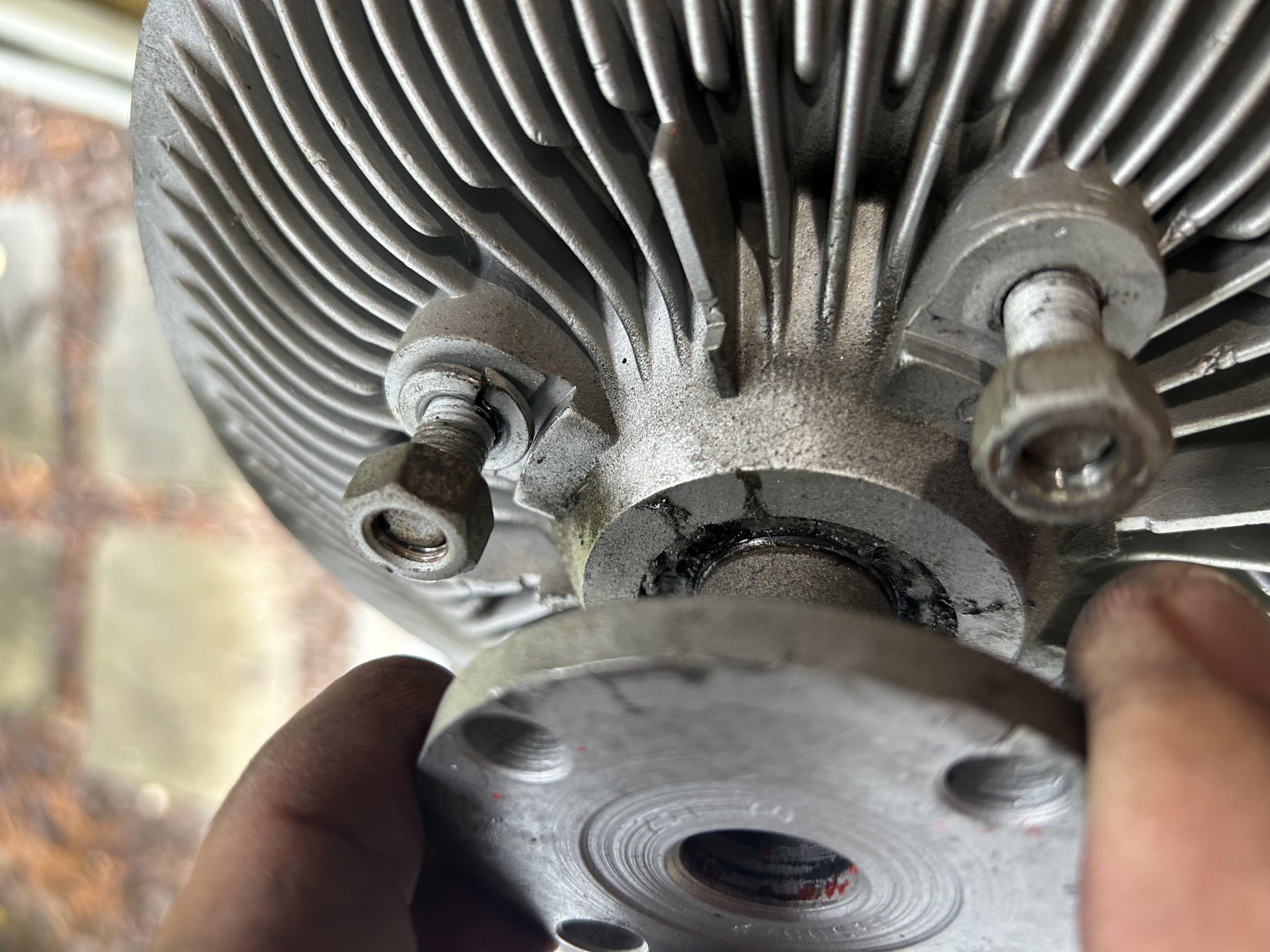

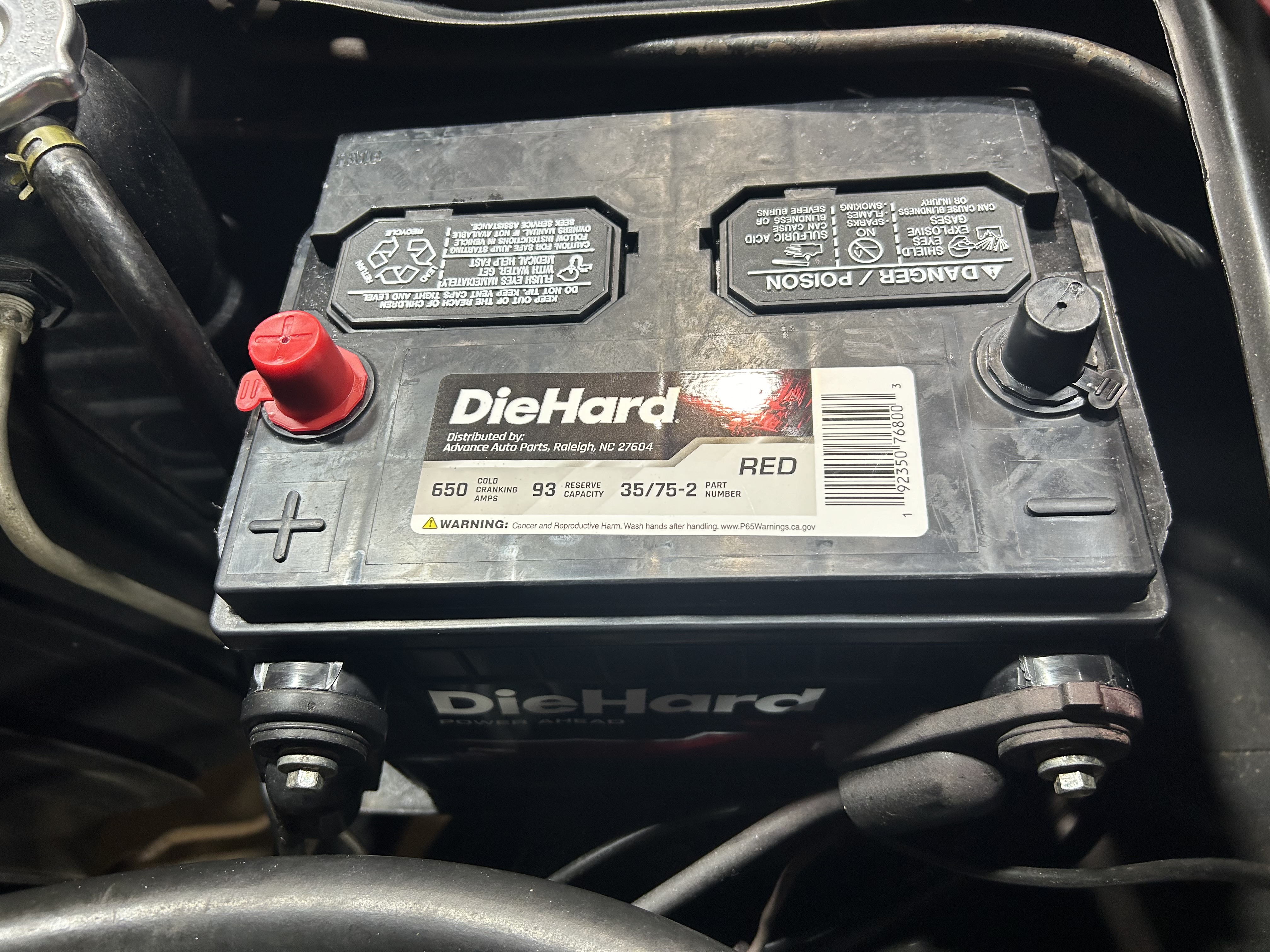

1908…. So about a week ago I went out to fire up the El Camino and I got a click-click-click from the starter. I haven’t driven it a bunch, so I thought it might be a fluke and I charged the battery. The next day the car started fine, so I figured the no-start was just a fluke situation. I waited a couple of days and tried it again. I got the click again, so it was time to retire the (only 4 year) old battery. For $140 I was back in business. I put the battery in the car and took it for a cruise, on a 90* day. On the freeway, not going over 2100 RPM, the water temps got to near 200*. I wasn’t comfortable with that and checked the fan clutch. It was slipping heavily when it should’ve been engaging, so I ordered a Hayden 2747… a heavy duty clutch that engages when air temps are 160* as opposed to 180* of a standard duty. I installed the clutch today. I’m certain it will help a bunch as the old one was leaking fluid and most likely working at half capacity. I wasn’t able to go for a ride because of rain, but I started and ran the car in the barn. I’ll report on the temperature findings after the next test run.

New Battery
New Battery

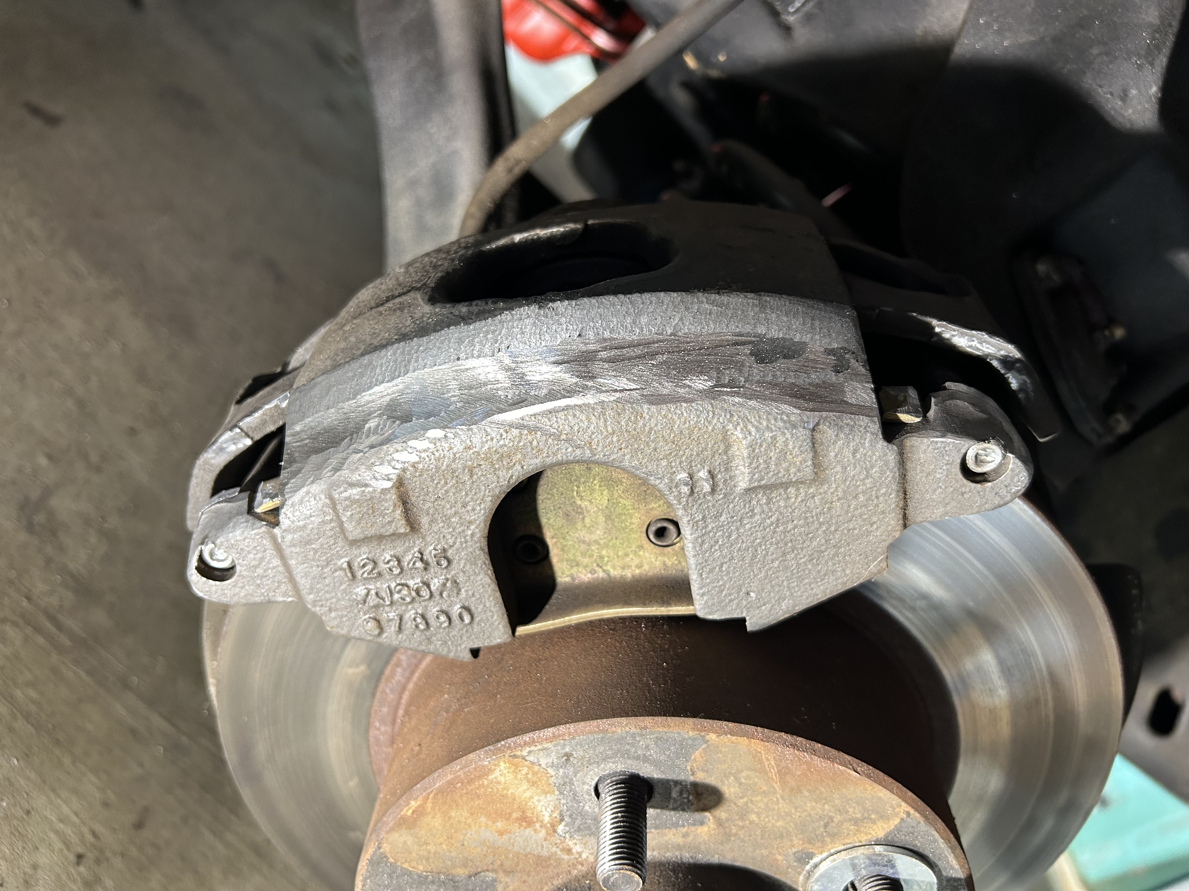

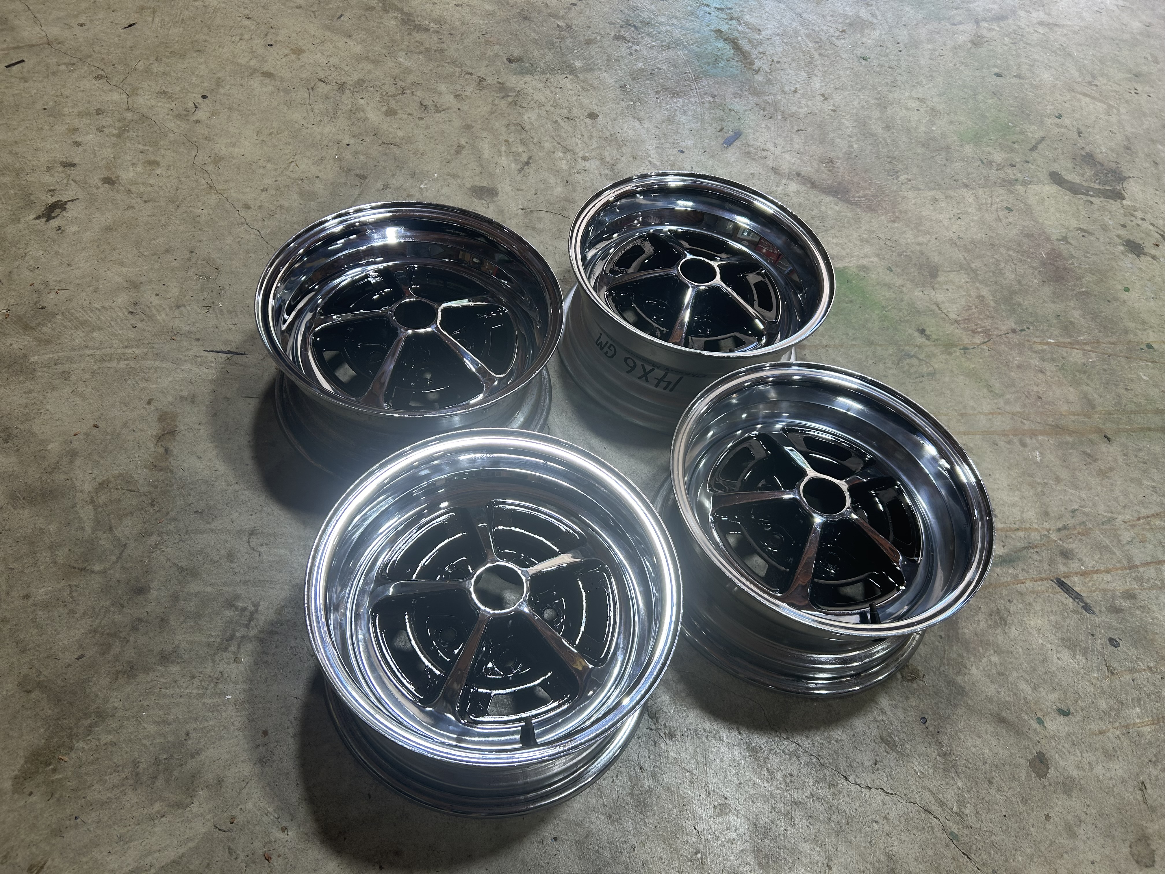

Wheel Upgrade

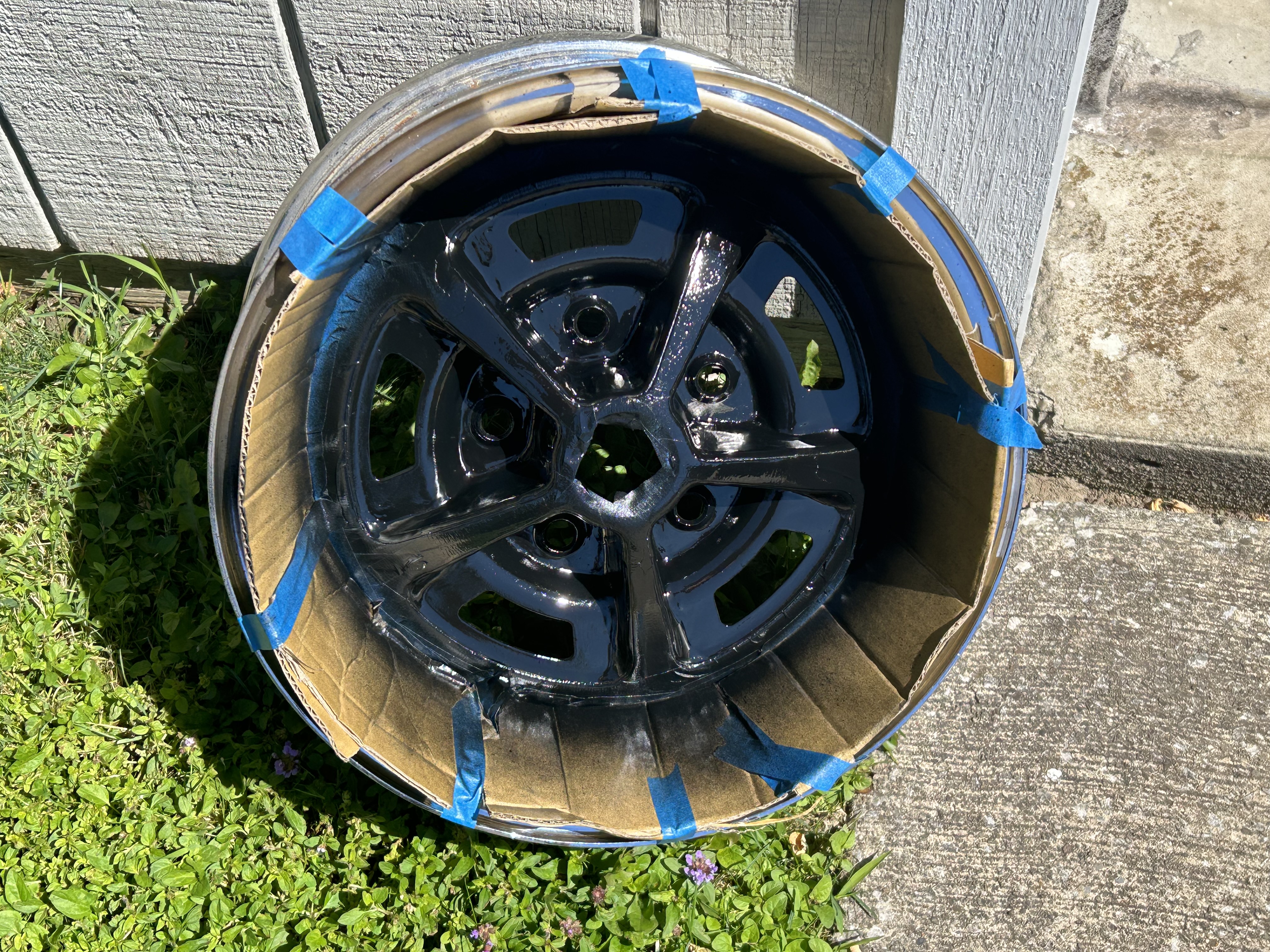

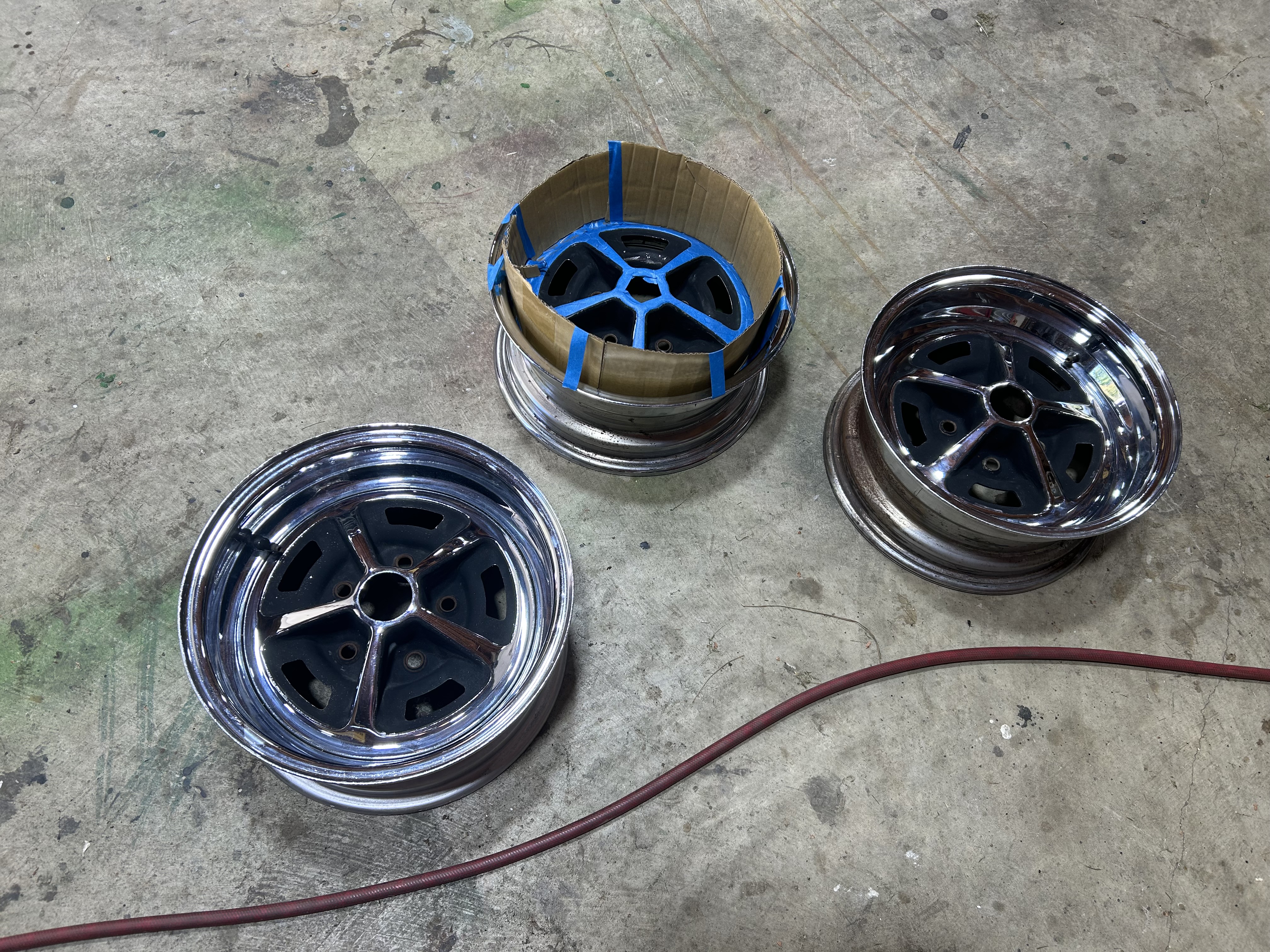

So I liked the torque thrusts that were on the El Camino, but I didn’t like them on my car. They were dull, and the truck, being a Custom, doesn’t have fender trim and it’s also missing the chrome El Camino emblems on the side. This makes for a pretty dull look when looking at the side of the vehicle. I thought it really needed chrome and black to match the grill, bumpers, and Chevy emblem on the tailgate. I’ve been searching for the chrome 5 spoke wheels used and finally found a set less than an hour from home. I researched them online (Unistyle 833 - 14” x 6”) to make sure they would fit and went and bought them for $300. They’re over a grand new. I painted them, bought lugs and centers for them, and went to test fitting them on the car. They fit perfectly on the rears, but hit the calipers on the front. I was ready to purchase a couple of new wheels when BP convinced me to grind the calipers so the wheel would clear on the front. It took a bit of time to make them clear, but I made it work. I ran washers on each lug nut to give me some additional clearance. I was able to test drive it this way, but I now have 3/16” wheel spacers coming to make it a more safe install. After getting the wheels on, I’m super stoked with the outcome and it was well worth the effort! I re-used the tires that came with the car and sold the other wheels right away. All in, after selling the wheels for $280, my net out of pocket with lug nuts, centers and tire mounting is about $200. Pretty inexpensive upgrade!

What a pain taping these off!
Painted!
Painted!

Re: 1971 El Camino
I think they are perfect for your El Camino, GM. It looks great from any angle. You did a great job in detailing them, and with shrewd buying and selling the good overall price is just icing on the cake.
Posts: 1310
Re: 1971 El Camino
wxo wrote: Tue Jul 09, 2024 9:30 am I think they are perfect for your El Camino, GM. It looks great from any angle. You did a great job in detailing them, and with shrewd buying and selling the good overall price is just icing on the cake.
Thanks, Walt! This one’s starting to come together nicely. I’m pretty pleased
so far. Like all of them, it’s far from complete in my mind, but working toward
completion is a bunch of the fun for me!

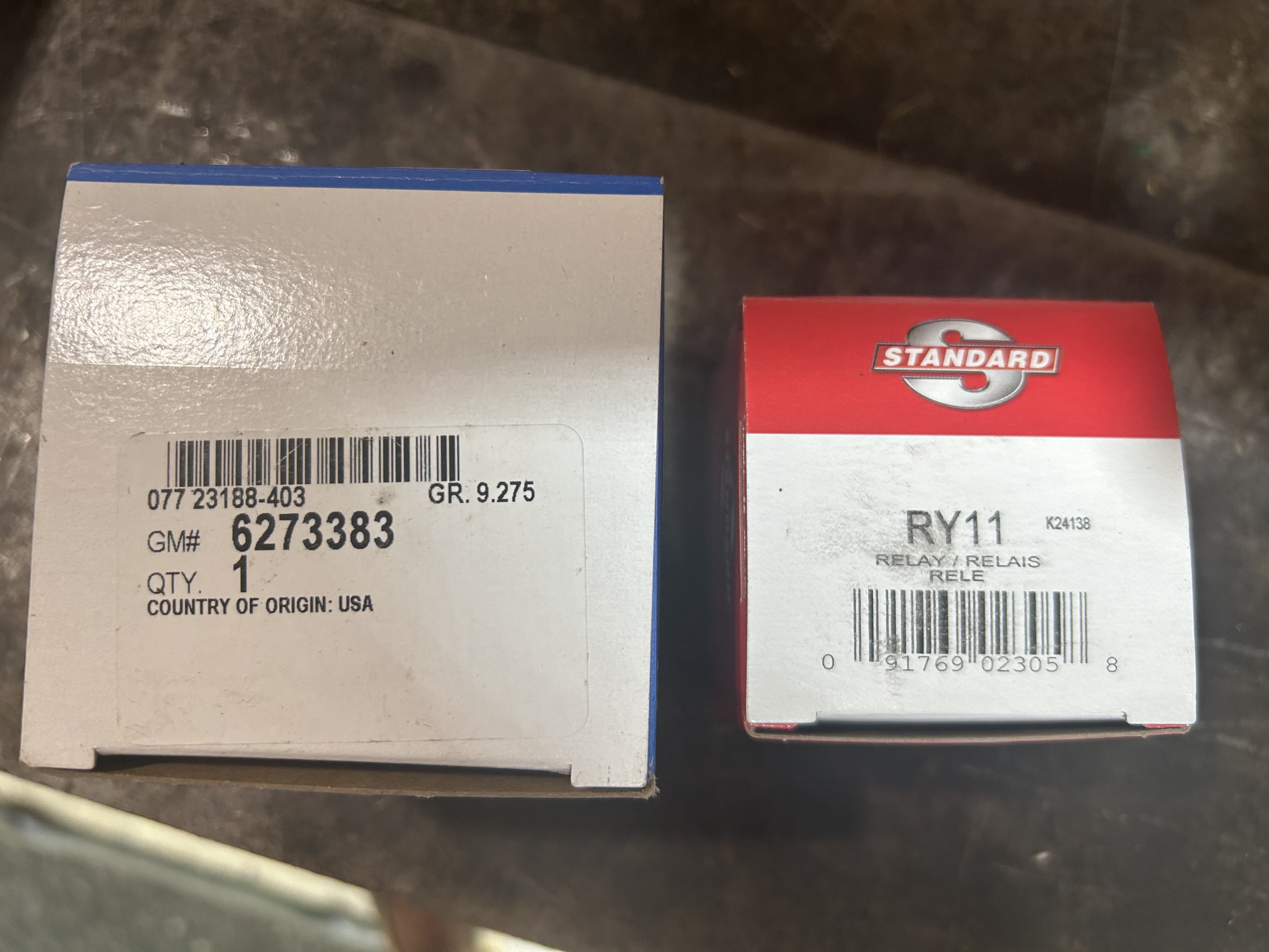

Horn Repair
This post is a little behind the times. This work was done prior to the tornado that knocked Tiresmoke central down for a bit:
The horn wasn’t working on the El Camino since the day I got it. I went after it last weekend. In the chance that the horn relay was bad, I ordered one online for $20. After installing it, of course, the horn still didn’t work. The only thing left to do after the relay install was to pull the steering wheel off. I did and found the guilty party. The plastic stub that holds the spring loaded horn wire in place was broken. No doubt, the hack who put the steering wheel on wasn’t careful and snapped it off while installing it. Because there’s a big, spring loaded ring in the way, that needs to be removed with a special tool, I decided to try to repair the stub. A bit of super glue, 24 hours dry time, a bit of JB Weld, 24 hours dry time, I was in business. My “Weld” job held and after assembly, the horn now works. Another annoyance off of the list!

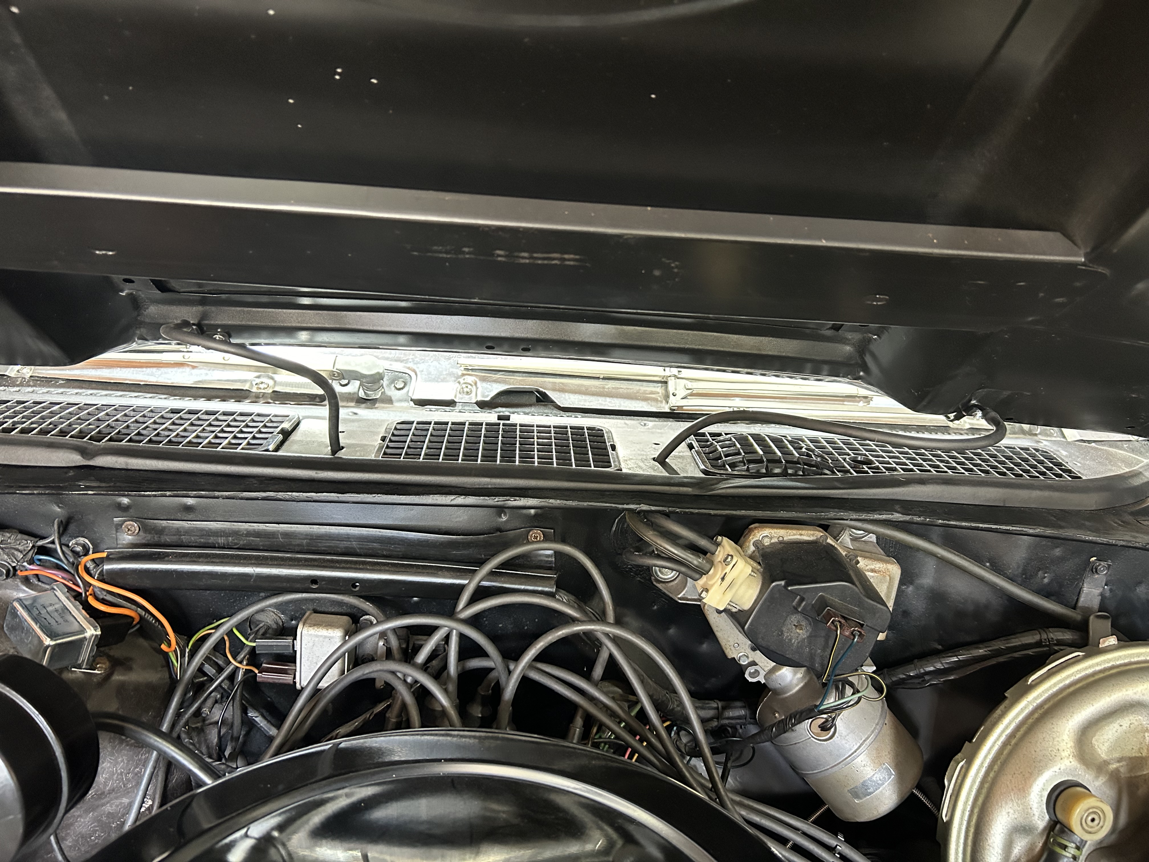

Window Squirter Install

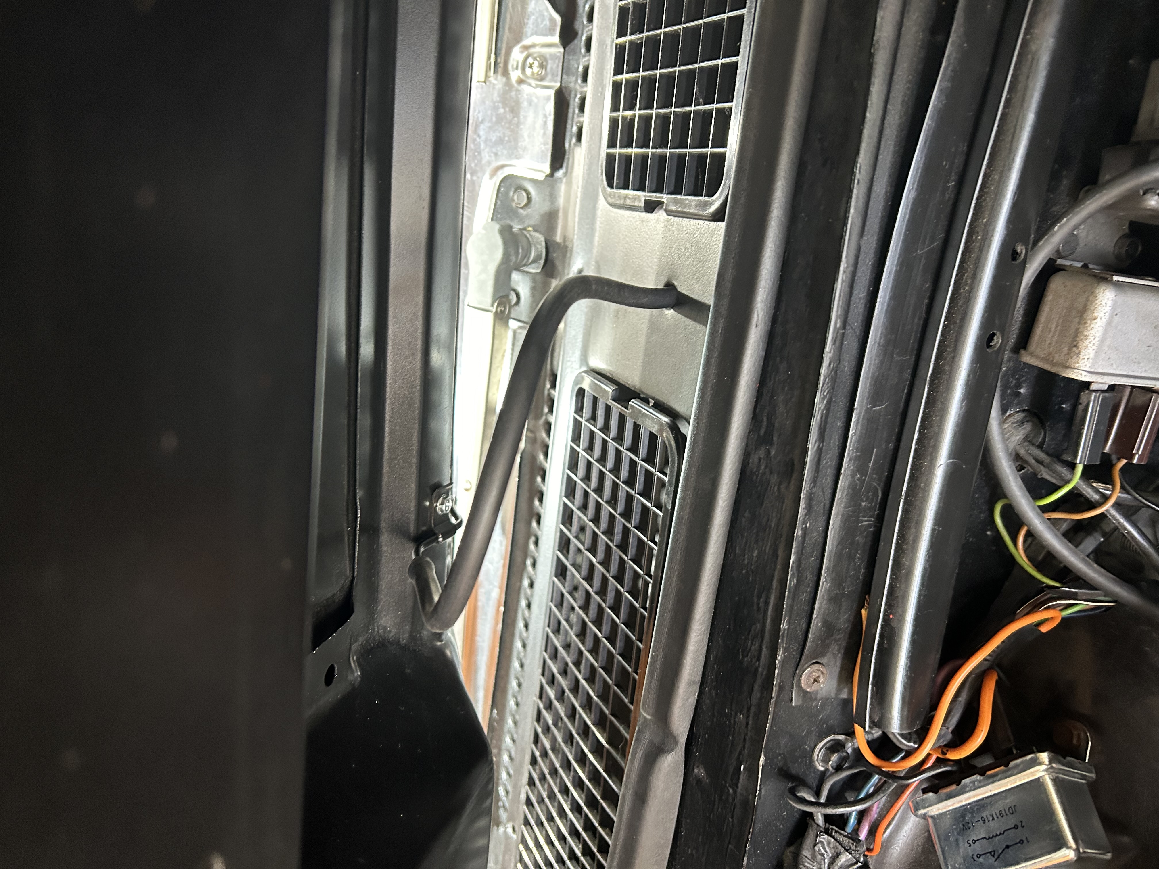

The guy who assembled the El Camino decided to run the windshield squirter hoses to nowhere. Literally, he had them attached to the little pump on the washer motor and ran them to nowhere. Over the winter, I ordered the squirters that were missing and put them in the “to be installed” box on my workbench. I finally got around to installing them today. I purchased some correct sized ( 5/32” ) squirter line and went to installing them. I needed the internet to tell me where the squirters go ( on the hood with a cowl induction hood) and how to route the lines. It was an easy job, except for the fact that I had to lay on top of the motor to get the lines in place. The whole job took 20 minutes. My guess is that I’ll never put washer fluid in the car and test the squirters, but it makes under hood area look more complete. I’m satisfied with the way they look and now I don’t have to look at hoses running to nowhere under the hood anymore.
Left side
Left side
Right side
Right side
Completed project
Completed project
Hose routing diagram

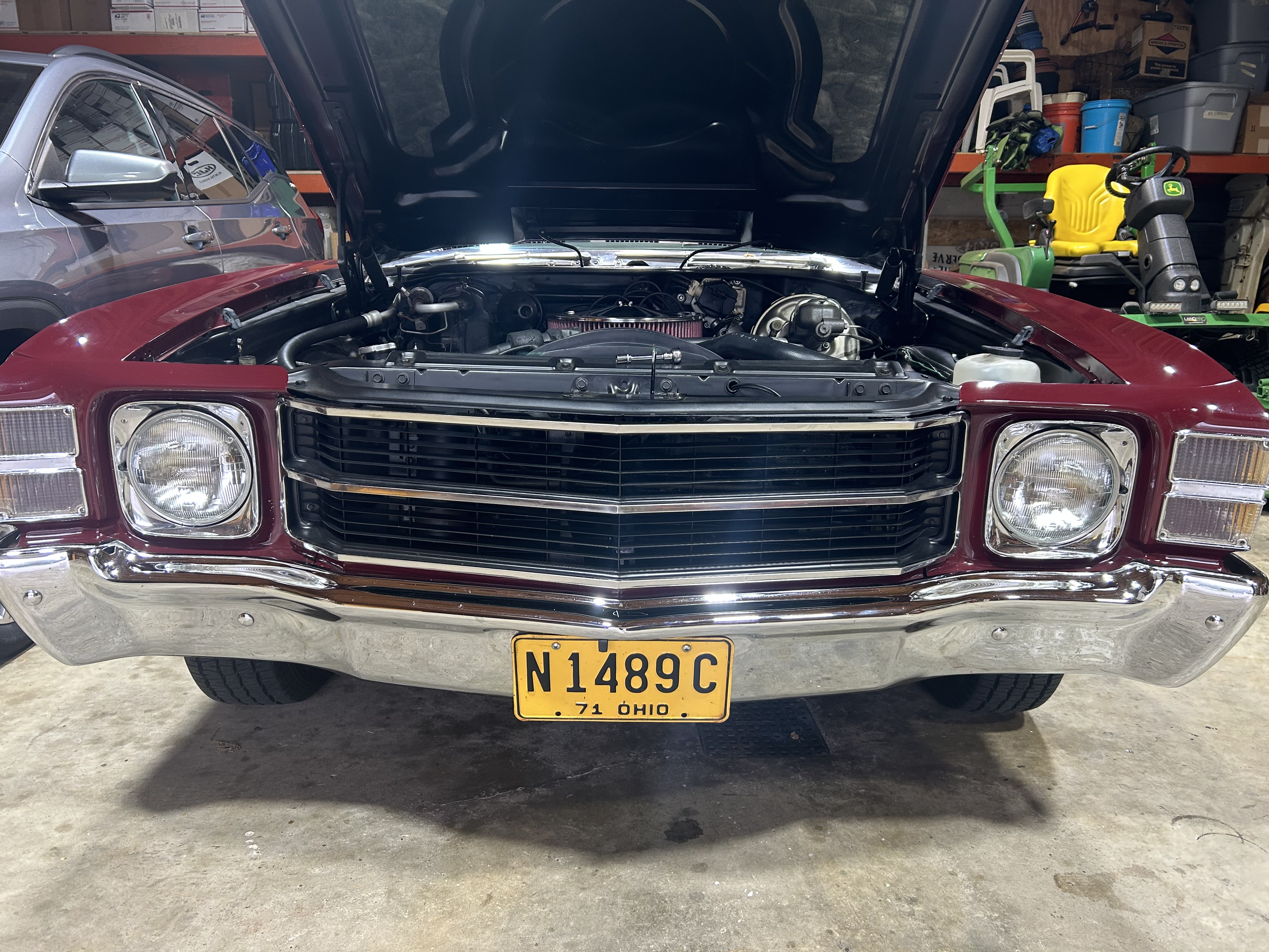

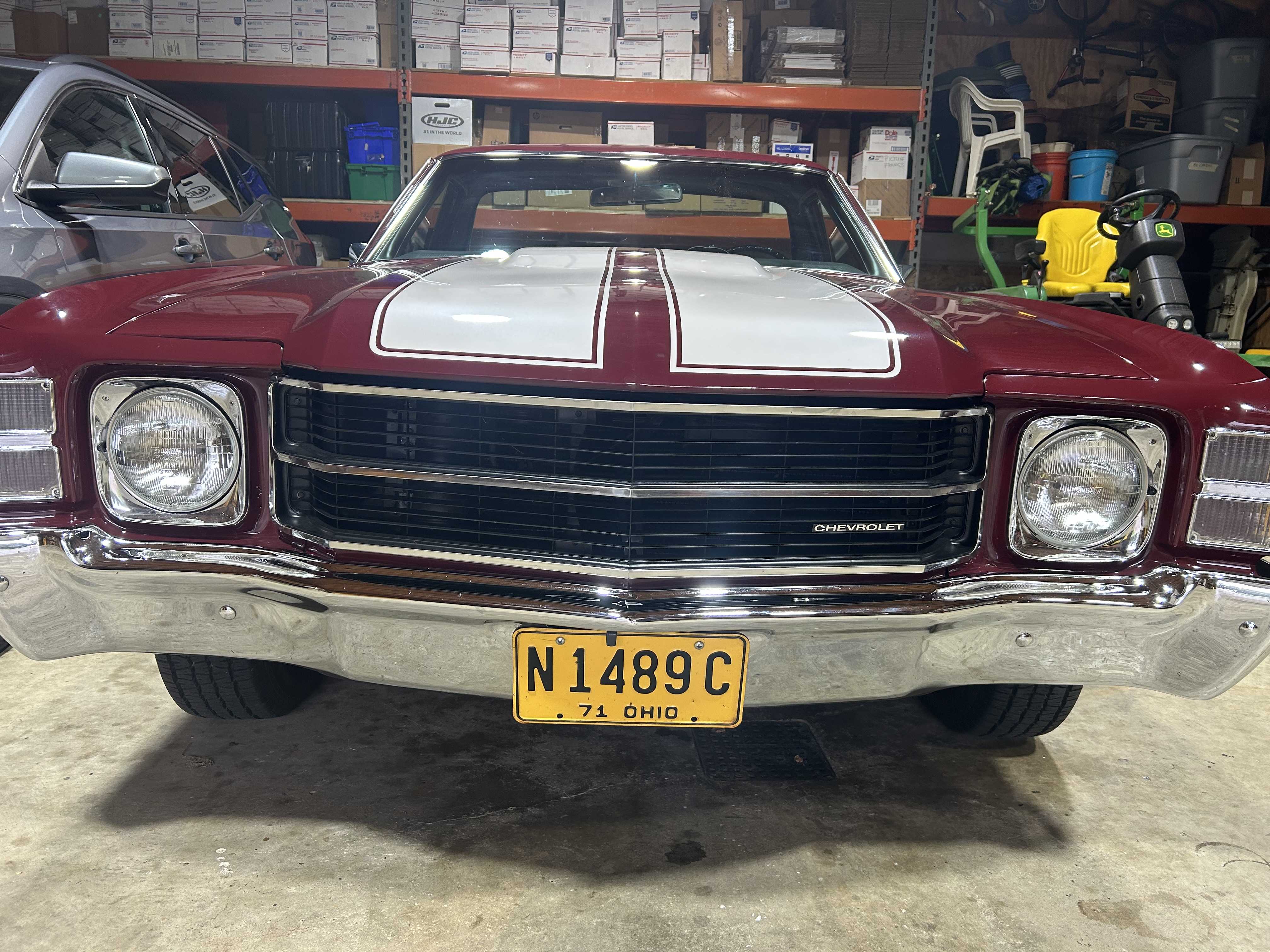

Grill Emblem Install
This mini-project took about 15 mins to complete, but the outcome was wonderful for my mind. I bought the “Chevrolet” emblem that belongs in the front grill. It drove me crazy that I could see where it was supposed to mount and there was nothing there. I like the way the chrome looks with the black grill. It needed the little extra chrome to break up the black.
Parts used
Parts used
Before
Before
After
After

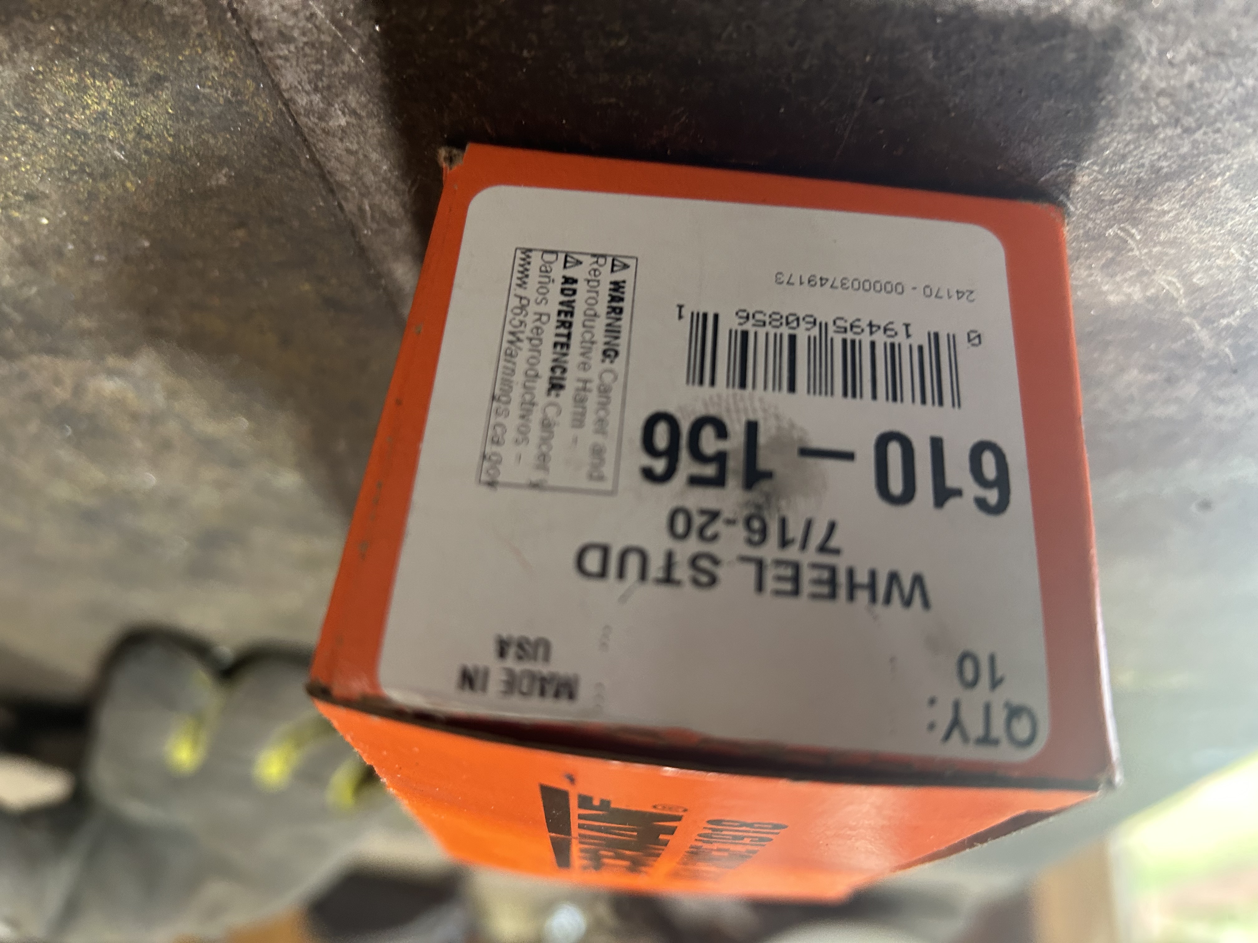

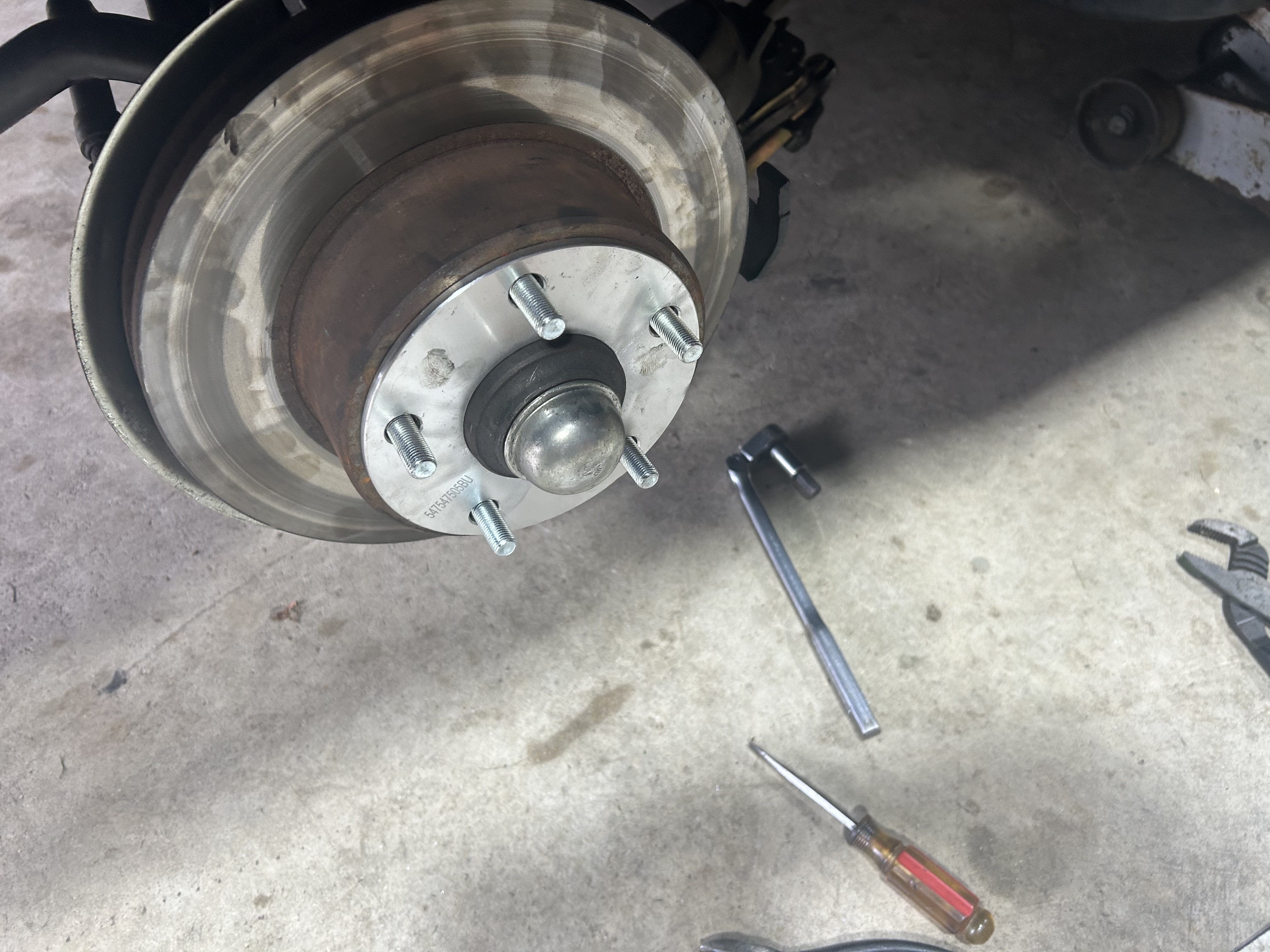

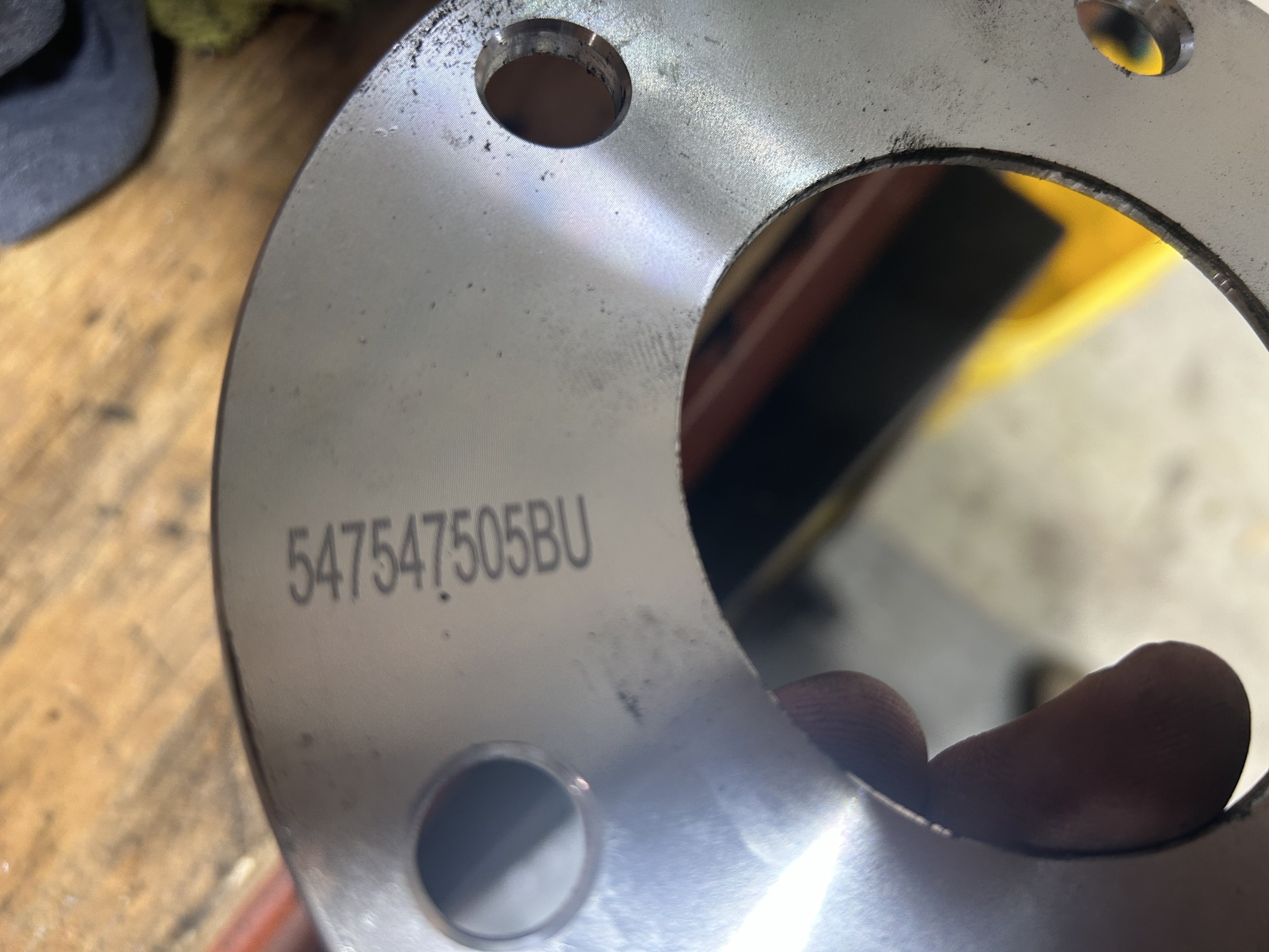

Front Wheel Studs / Wheel Spacers

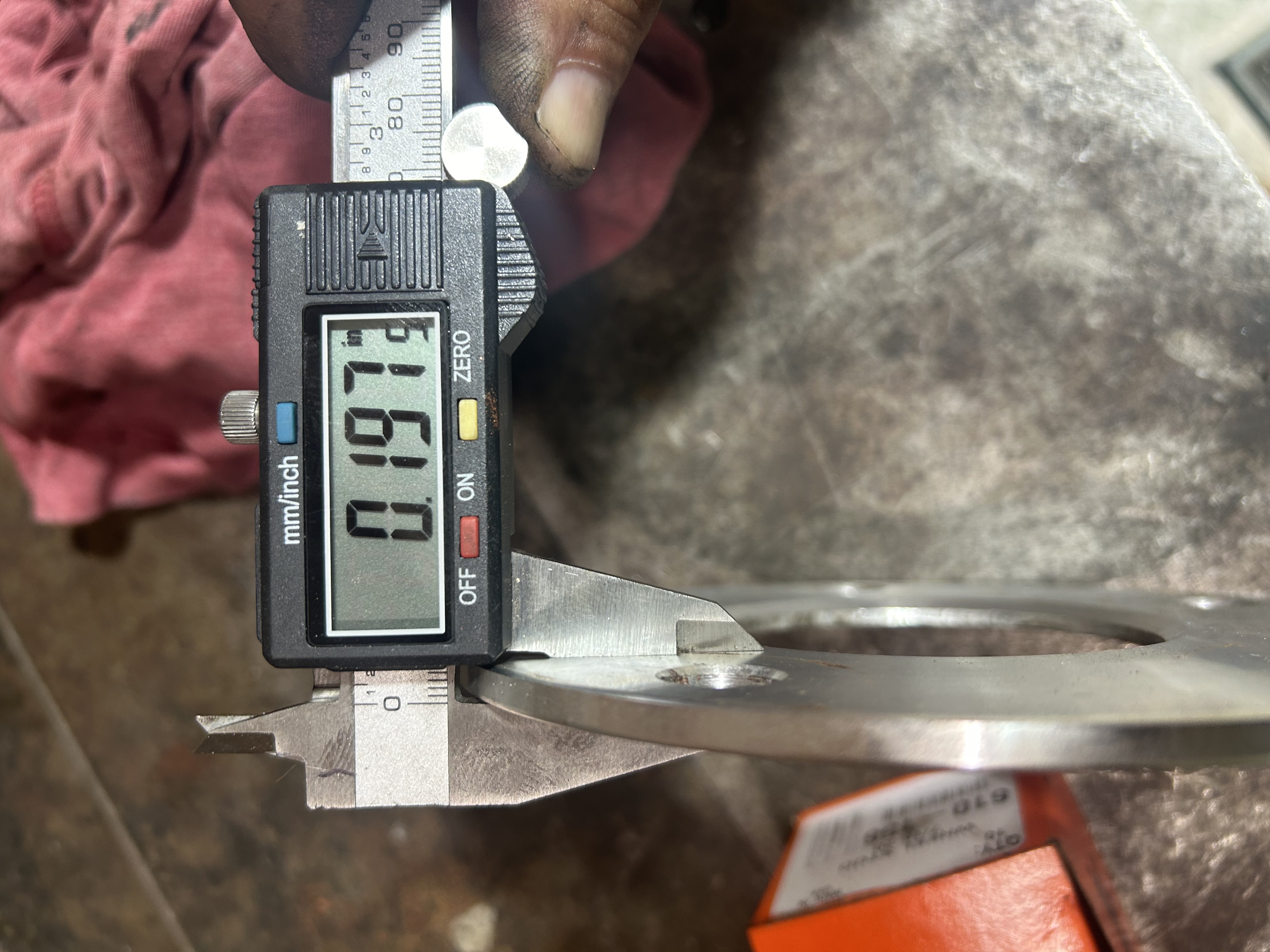

When I did the wheel upgrade, I ran two thin washers behind the wheels to make sure I had clearance on the calipers. I didn’t drive this combo very long, it was just a test to make sure I was 100% clear. After I knew I was safe, I ordered .197 inch wheel spacers and picked up some wheel studs that were about a quarter inch longer than stock studs. The spacers and studs were cheap but are a good upgrade in my mind from a safety standpoint. The whole project took me about an hour to complete and if I ever tried a wheel with more clearance, I think I wouldn’t have to remove the longer studs. I kept the old ones just in case.
Spacer
Spacer
Spacers and studs installed
Wheel spacer part number
Wheel stud part number
