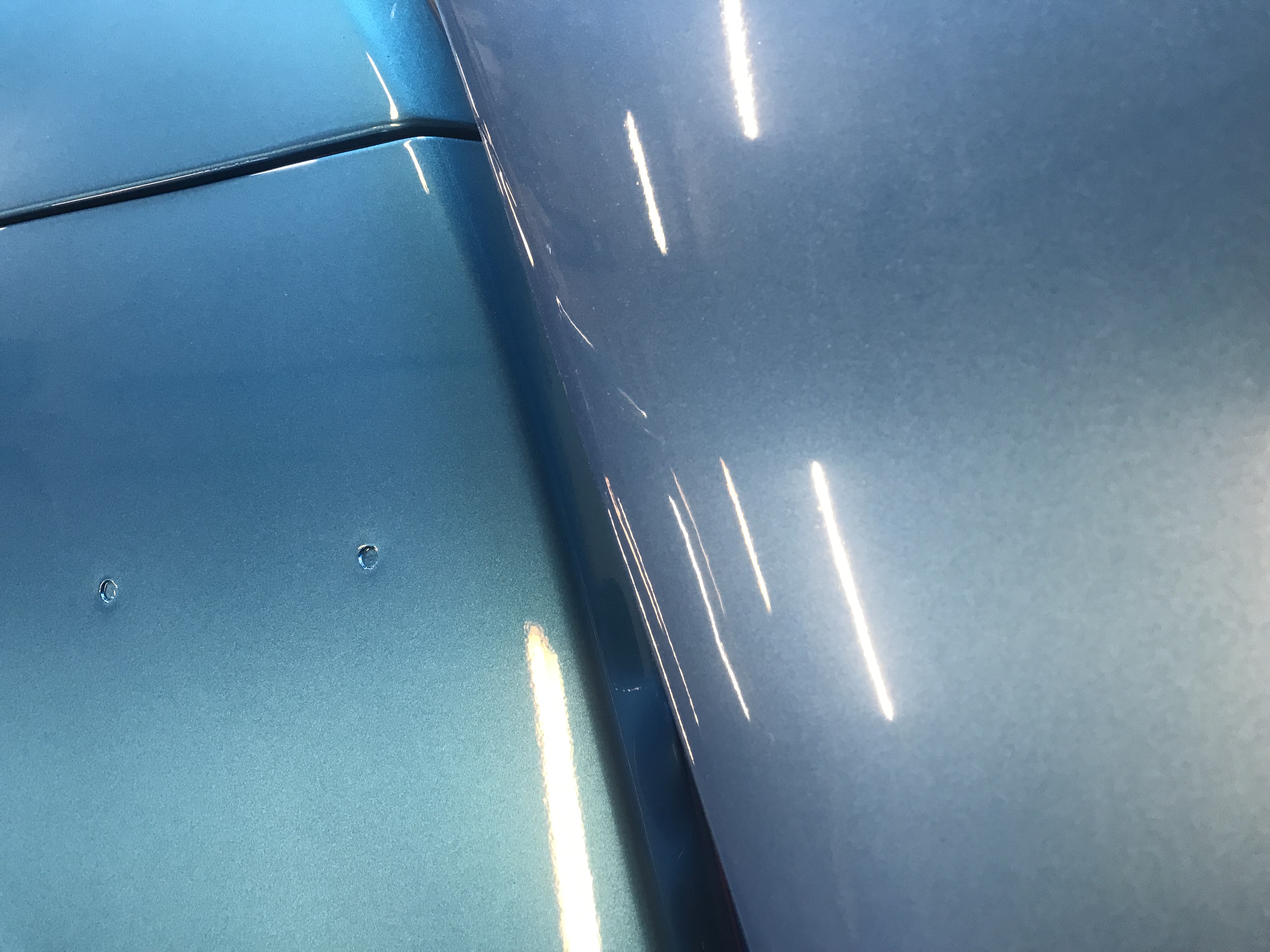

Painting with no spray both invites a lot of dust, and inexperience created some runs in the clear. I was mentally prepared for this based on what I had seen in so many videos. Created a plan, ordered/purchased some stuff. Plan was to scrape the runs and dust nibs off with a razor blade, sand the high spots with 1000 grit, then use 3” DA to sand with 2000, 3000, 5000 and buff our the last of the scratches.
Good plan, however I ran into trouble with the paper, and trying to buff out the last of the sanding marks. I could get a decent shine but there was still a haze to it. I wet sanded almost all the flaws with a 2000 grit disc, only to find the eBay cheap discs wear out quickly. Adjusted to 1 disc per 1-2 panels and it worked much better. The 3000 and 5000 grit discs I had seemed to wear out much more quickly so I ordered some 3M Trizact discs in 3000, 5000, 8000 (6 discs total = $45). These have a built in sponge backing and are great for wet sanding. Results were better but still not right in a lot of places. I got some Meguiars medium cut and tried that – also tried the old Ditzler DRX-16 sandpaper in a buffing compound, and neither would cut the haze. At this point I tried to really slow things down – picked a small section, redid the 3000, 5000, 8000 cycle then hit it with the buffing compound. That seemed to work. There were several pitfalls along the way as the result would look good but then if you got it in the right light you could see the difference in how clear it is. Grrr. This is going to take a while to finish but more practice will no doubt help me find a more efficient way to do it
