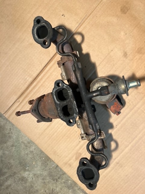

I know why it sounded like the car had an exhaust leak. ALL the manifold bolts on the passenger side were loose.
The OE manifolds, AIR tubes and shields are in VERY good condition. They will likely get sold once the car is running & driving.

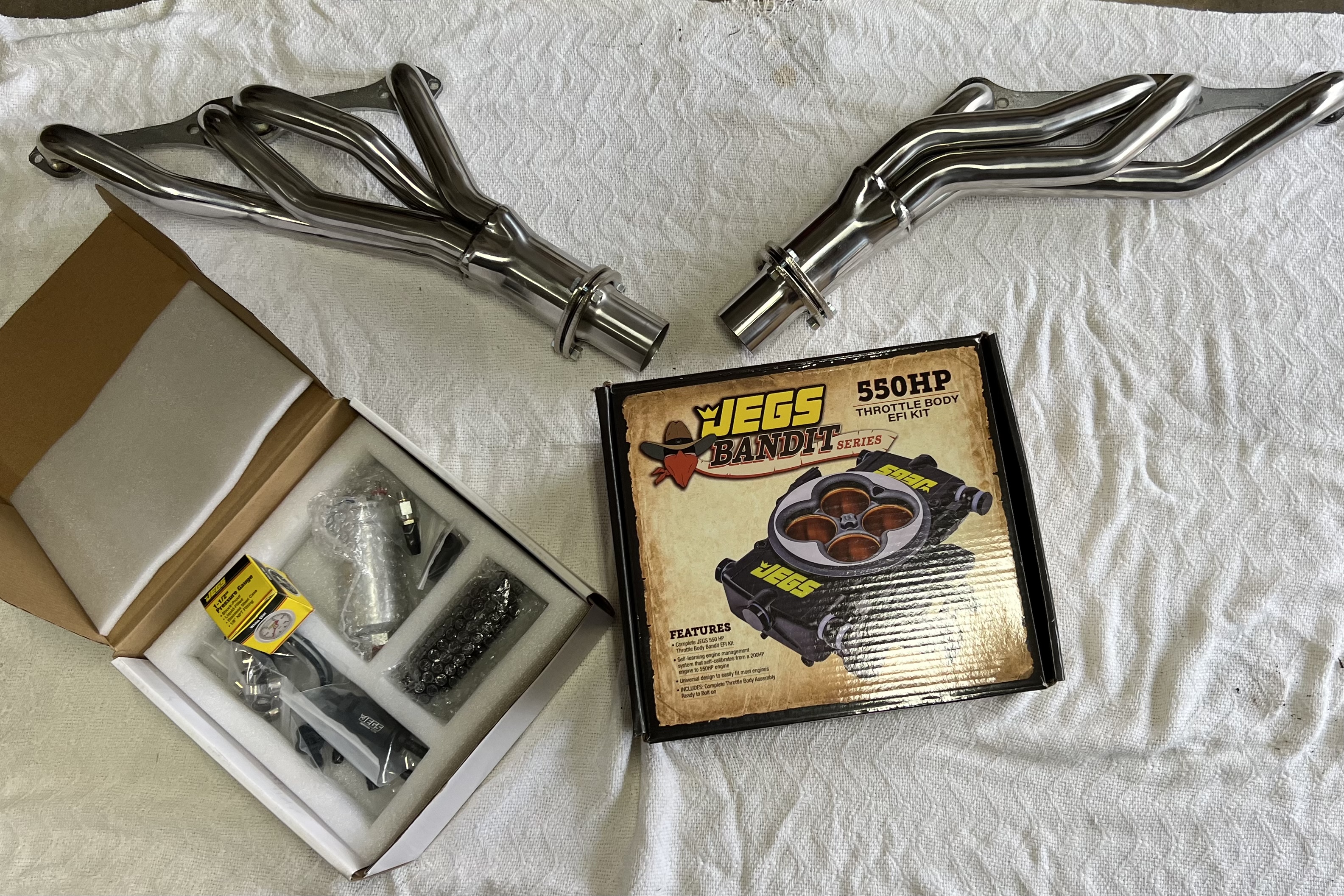

EFI carb on order.
New HEI ready.

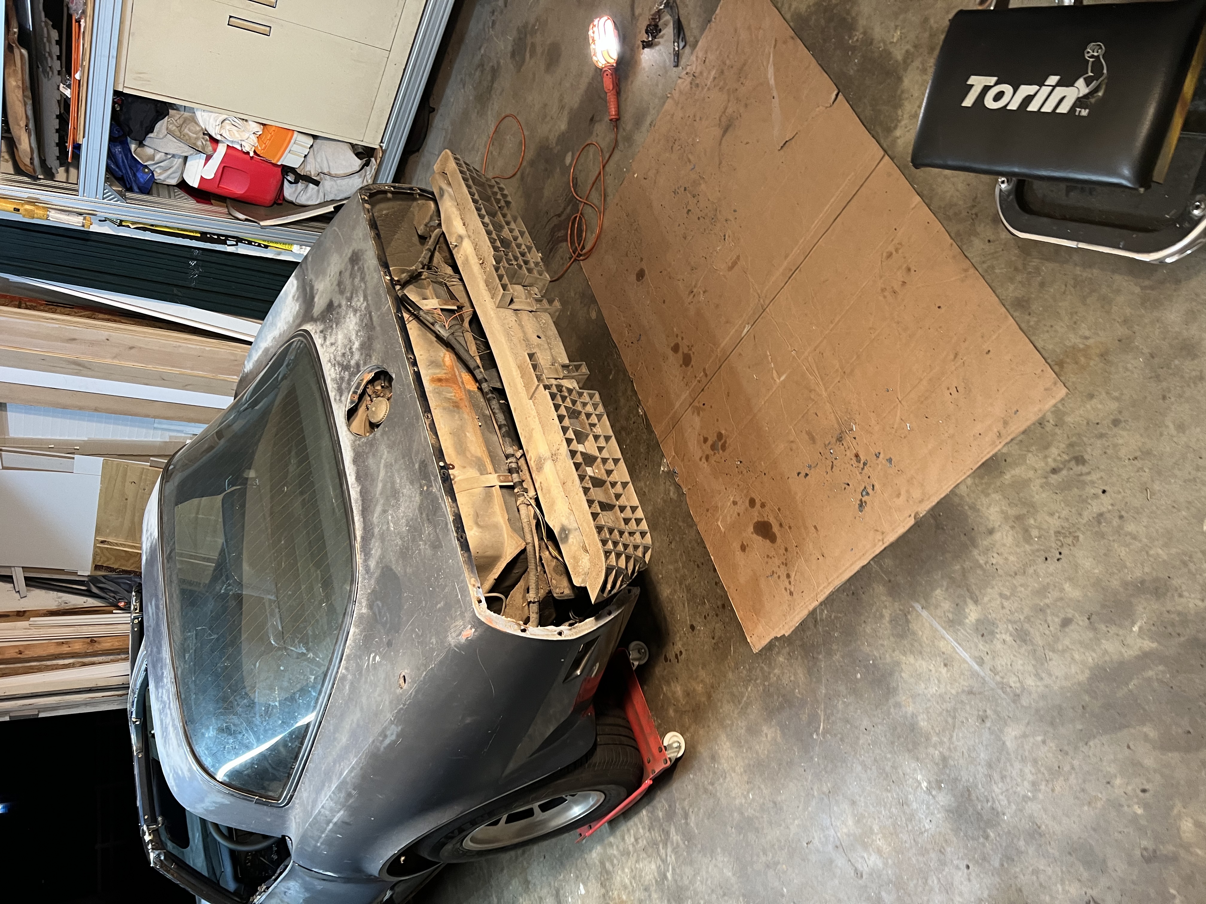

Hopefully this weekend, engine bay pressure wash.
Then installation of components.

I'm curious to see how well the self learning computer is on your new FI setup. Looks interesting for sure.

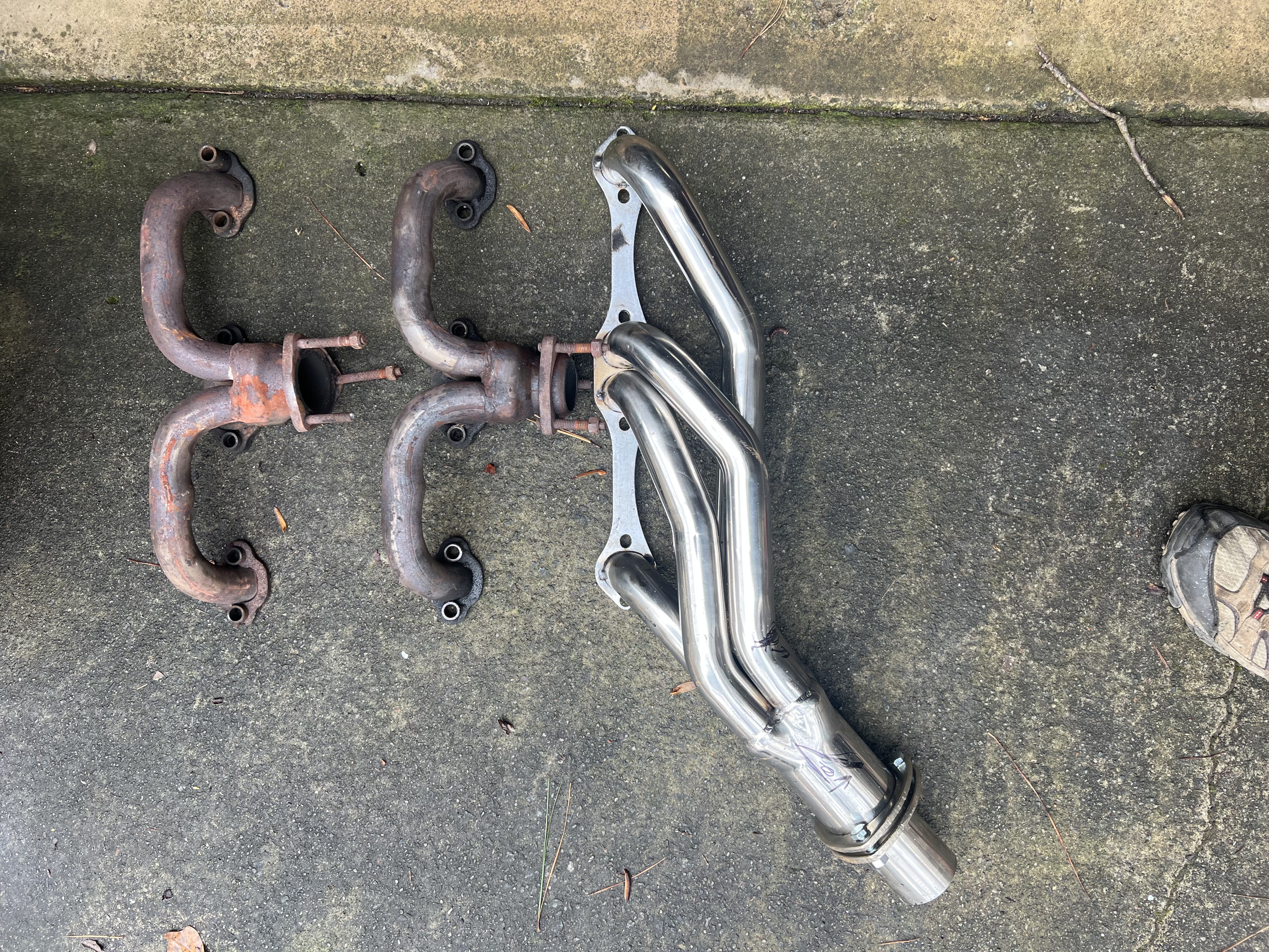

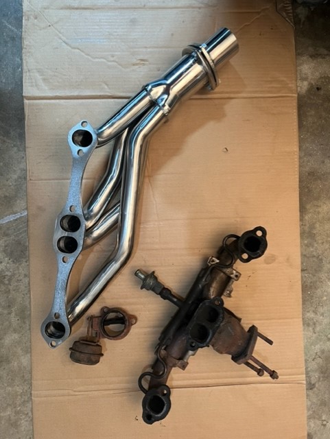

So the passenger header side header interferes with the floor/firewall.
To save money for now I will plug the AIR holes and hi temp paint the factory manifolds.
Getting the car back up and running is more important at the moment.

At least one of the original manifolds is cracked. Plus I broke 1 of each studs removing the manifolds. Direction change again. I’m going to see about finding an exhaust shop and seeing if I can trim/bend the header.

So I dropped the radiator at the radiator shop for inspection and repair.
The muffler shop is welding up the AIR ports and the cracks on the OE ram horns.
He says I won't be able to modify the headers as needed and that I should modify the floor if I want to use them.
Since the floor is fiberglass, I am going to pass on that.
