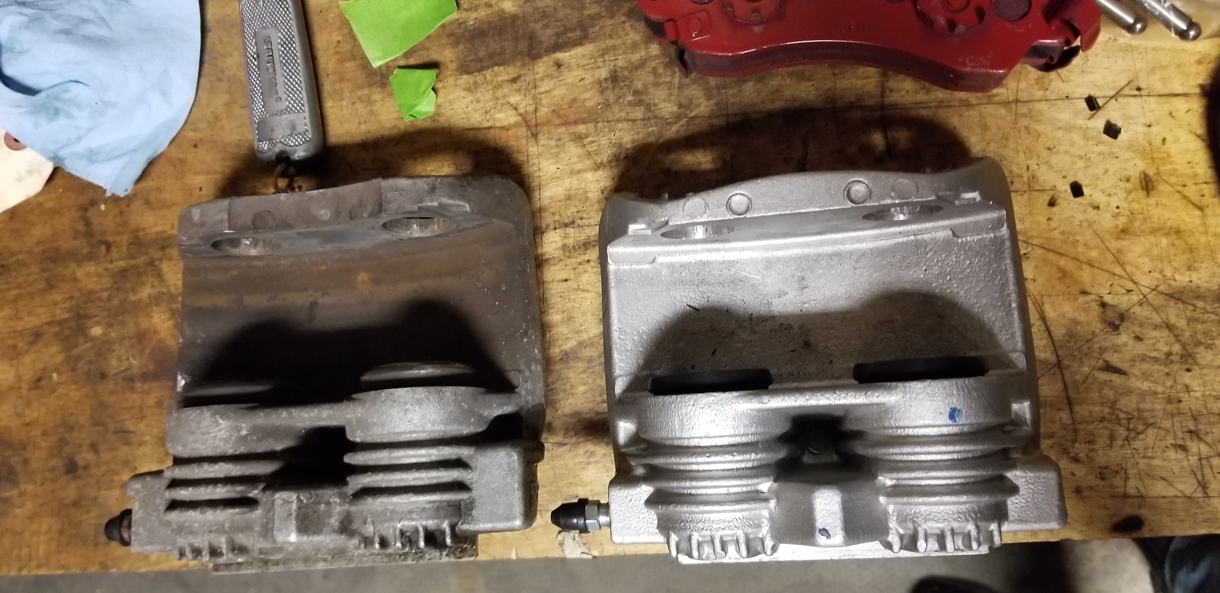

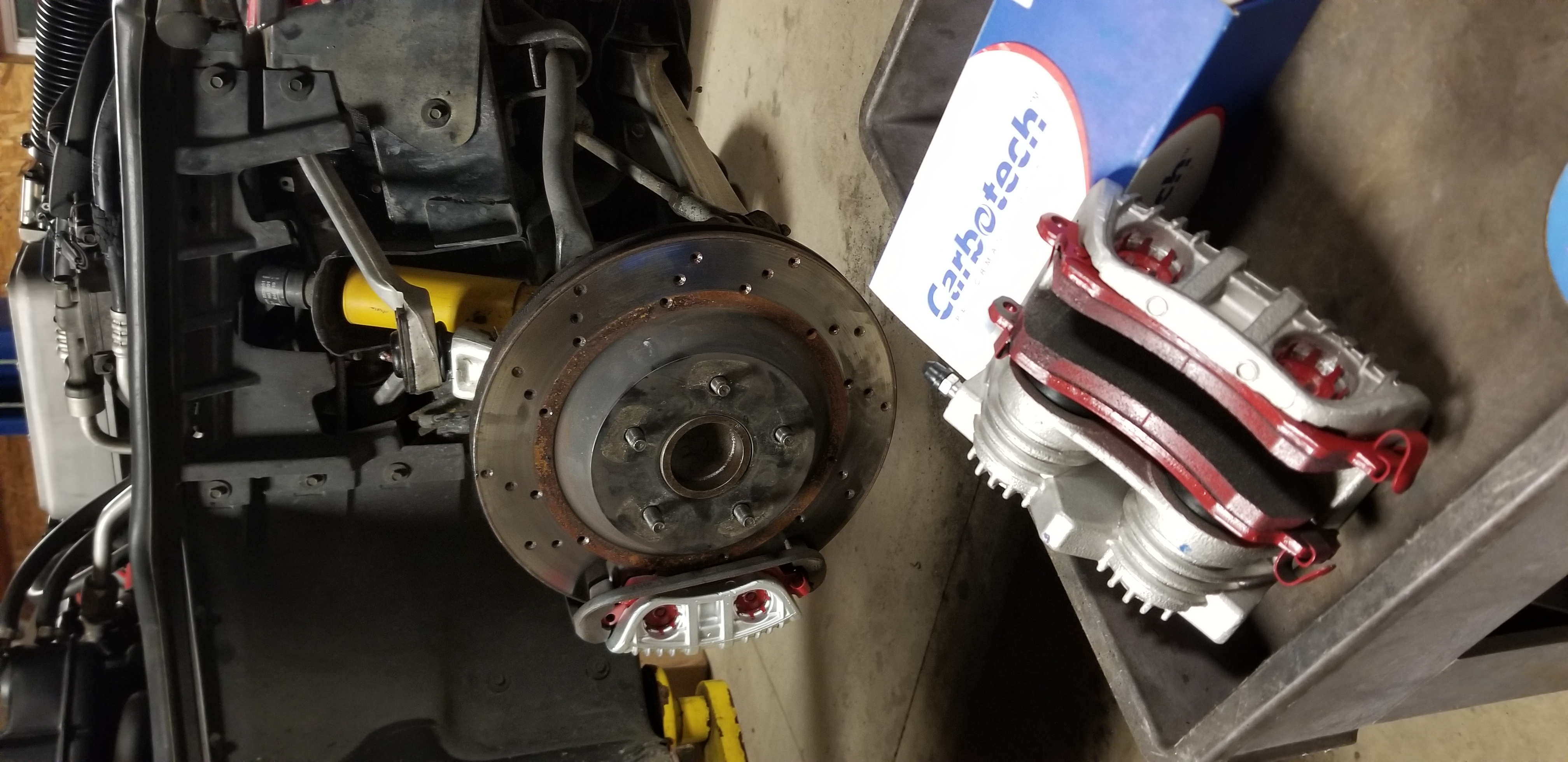

Well, progress moves slow, but it has been made. I moved the Z51 into the lift bay after all the snow melted. I noticed the front brake reservoir was very low, so I filled it up a bit. Once moved and sitting for a few days, i found a little puddle of brake fluid by the RF, master cylinder low/empty again. The caliper is leaking. Maybe damaged in the crash. The brakes were suspect before the crash, though.
I had already ordered a new master cylinder. Tonight I ordered a couple front brake calipers from Summit, but they're saying estimated ship date is Jan 12th. Previous owner installed stainless-braided flex hoses. Along with the CarboTech free swag brake pads, I should have a Vette that stops very capably.

So I *finally* got both brake calipers. The driver's side arrived in mid-January from Summit. The passenger side, the one I actually need, got put on another delay till sometime in Feb. I cancelled the order, and ordered one from Eckler's. I installed the master cylinder a couple weeks back, which gave me occasion to buy some new line wrenches, as I didnt have metric. I put the passenger side together first and everything went easy.
I get to the driver's side and -- wah wah wah --the Summit caliper is wrong. My car has the J55 performance brakes, and I know I *ordered* a J55 caliper, but I apparently didn't get one. Thank goodness this is happening in the off season. I'm just gonna order another caliper from Eckler's and be done. Technically don't *need* this side, but might as well.

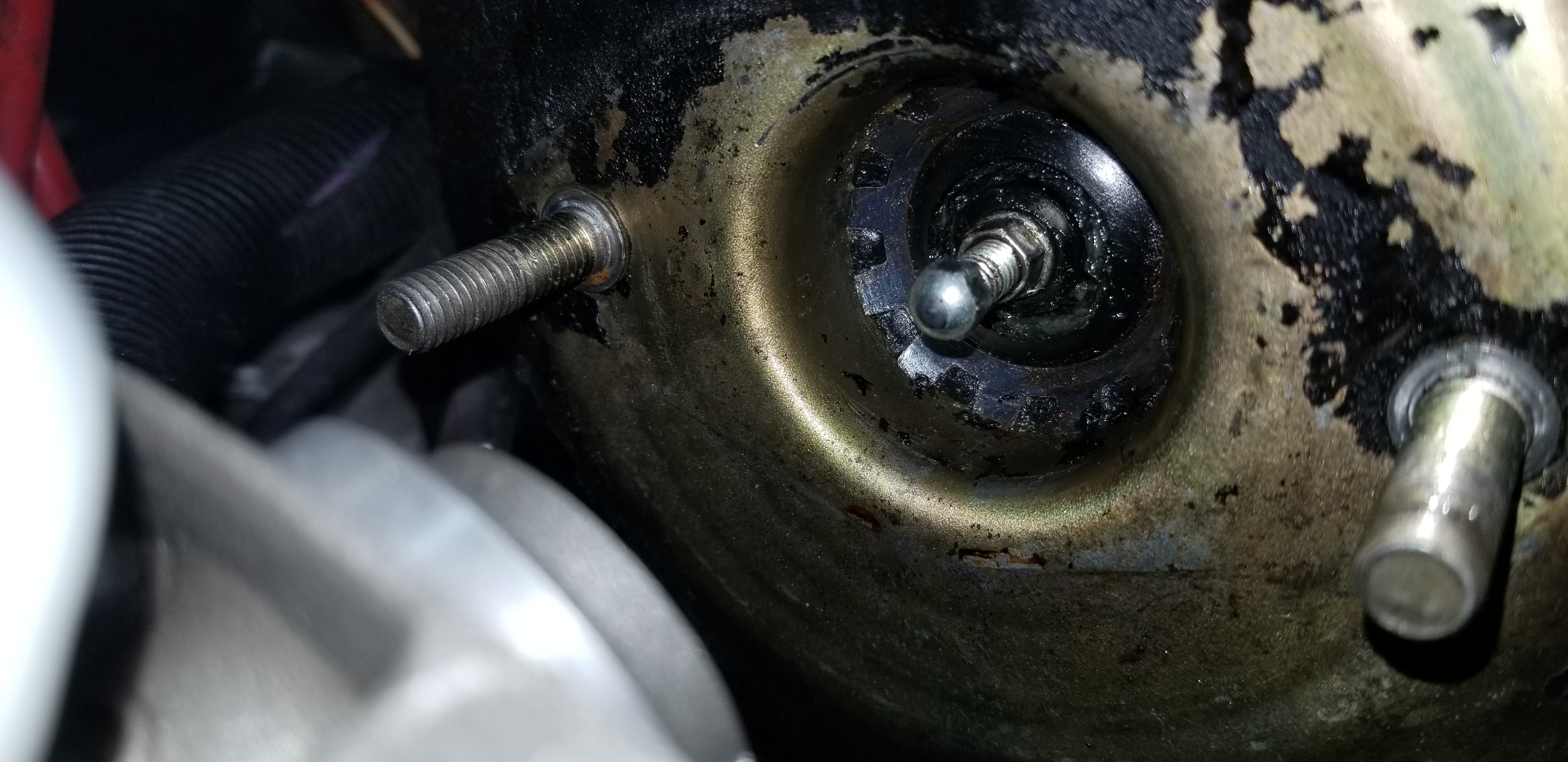

don't forget to check and see if you can adjust that rod from the brake booster that goes into the master cylinder

Well, after ordering the proper J55 caliper for the driver's side from Eckler's, I got all the brakes put back together, bled the master cylinder, bled the front, and flushed the old fluid out of the rear calipers and lines. Driver's rear caliper bleeder was a little difficult, but eventually came loose. I should replace that bleeder.
Pedal feels rock solid now, better than ever. No pedal screw adjustment needed, IMO. With the weather, I haven't road tested it, but I feel confident they will work well.

I took it to Chardon and back, and the brakes still seem to be less than what they should. I pulled the master cylinder off to try and make that adjustment Andy mentioned, but it doesn't seem to want to turn easily and make an adjustment. This was just a quick attempt in the middle of the afternoon, but it will require more investigation/effort.

Well I dug into the master cylinder / brake pedal issue again tonight and made noticeable changes in pedal feel. I was able to get the jam nut loose this time and extended the rod. It felt better in the garage, but by the time I got back from a very short test drive, they were dragging badly. I made a large adjustment, so I brought it back a bit. I haven't made a 2nd test drive yet.
