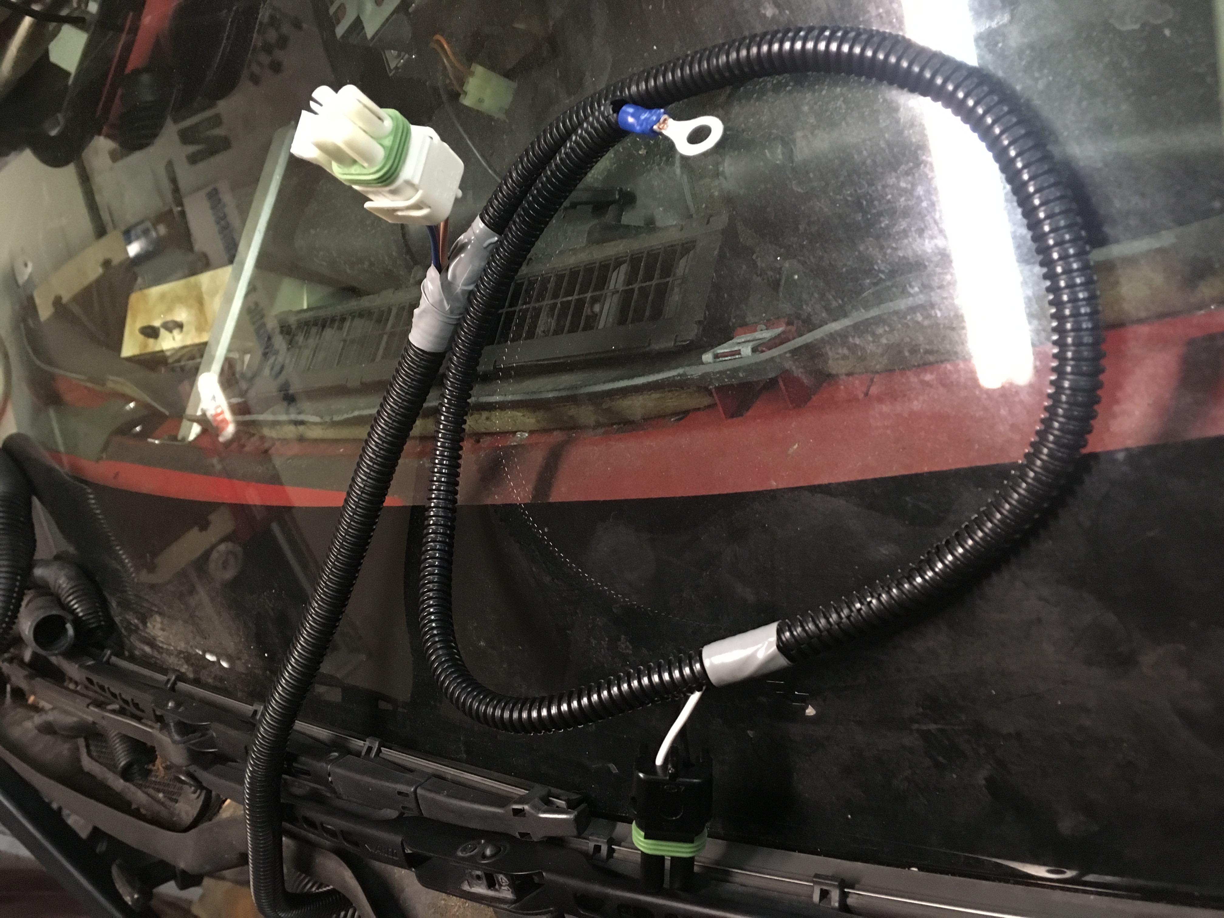

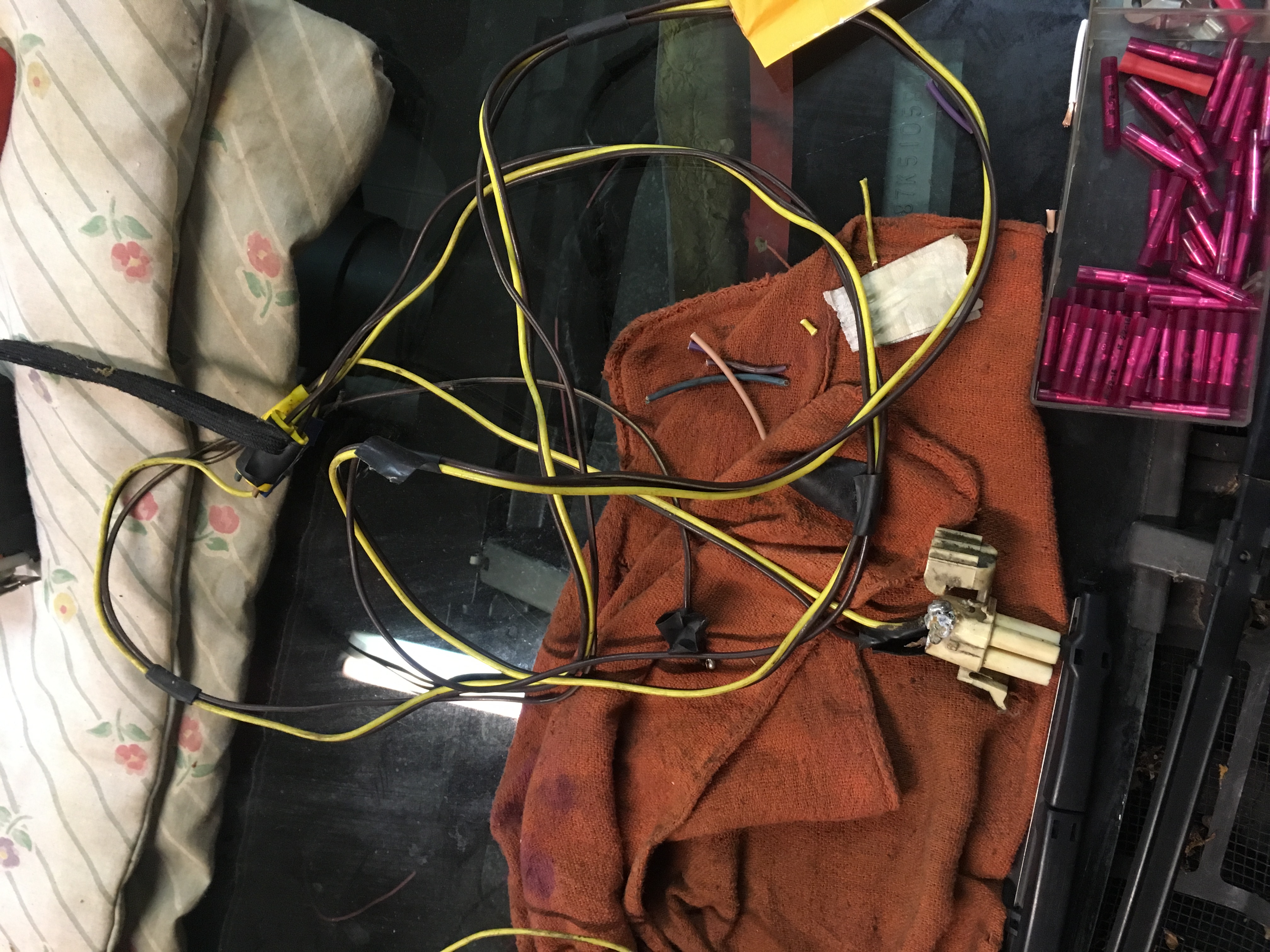

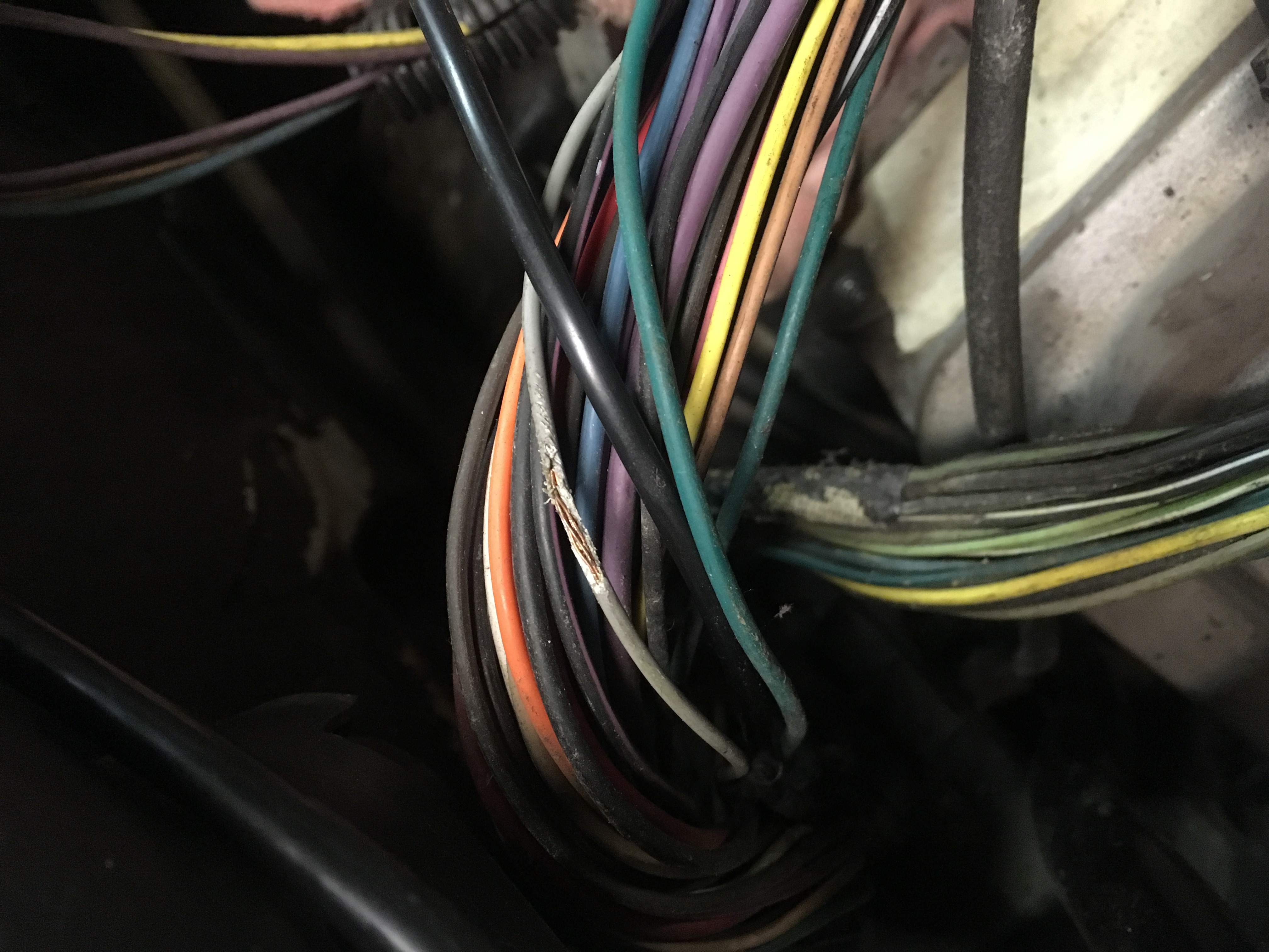

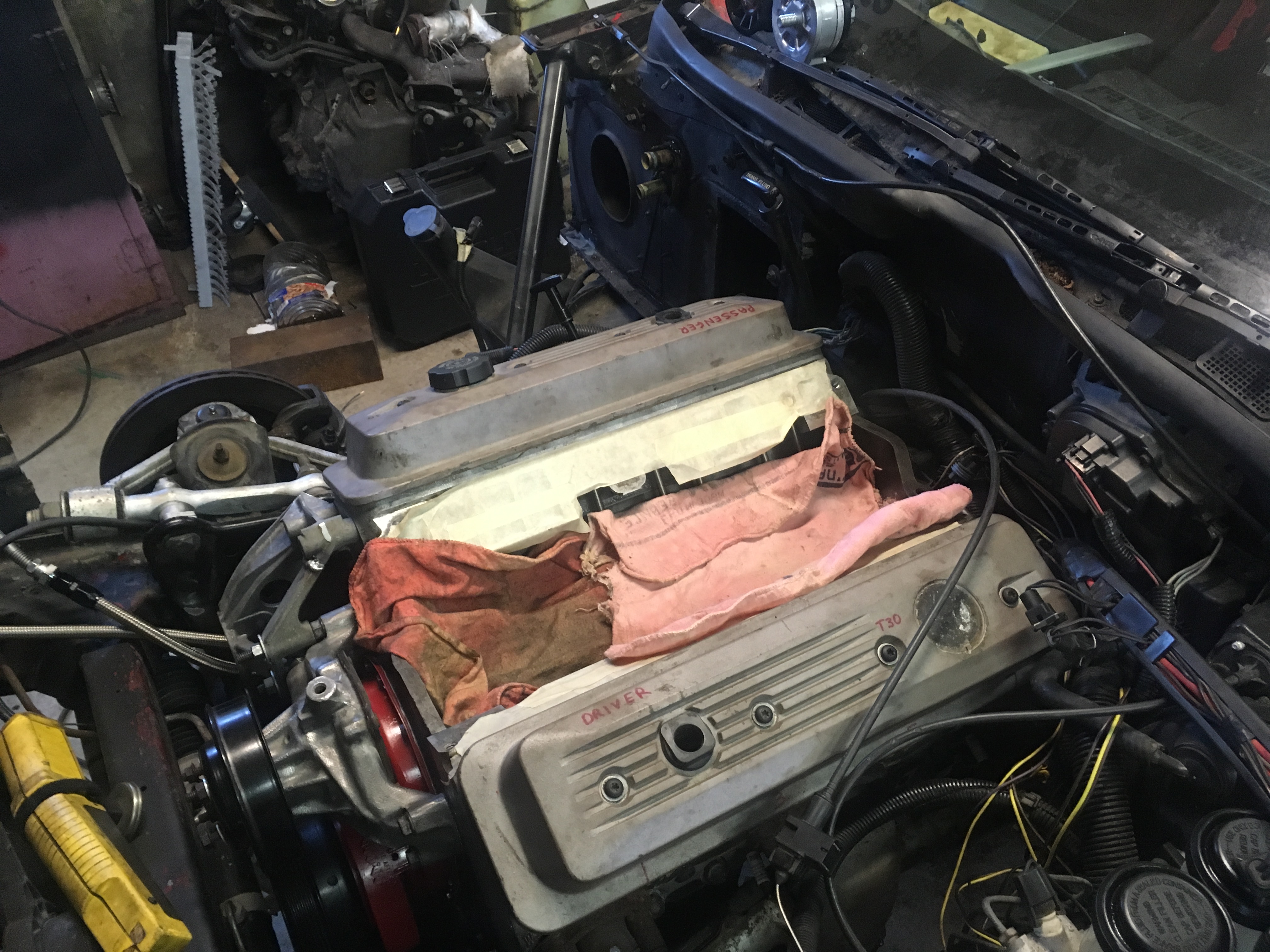

Found the lockup converter wiring and pigtail were wrecked. Also found the speedo sensor connector was gone. Why is that gone? And there was a random wire with damaged insulation Engine accessories installed on front of engine. This uncovered two problems: 1) the alternator is mounted too high I can't close the hood all the way it hits, 2) I am unable to locate power steering to reservoir premolded hose of sufficient quality. The next best substitute is straight hose which will not work unless I modify the power steering reservoir mount.

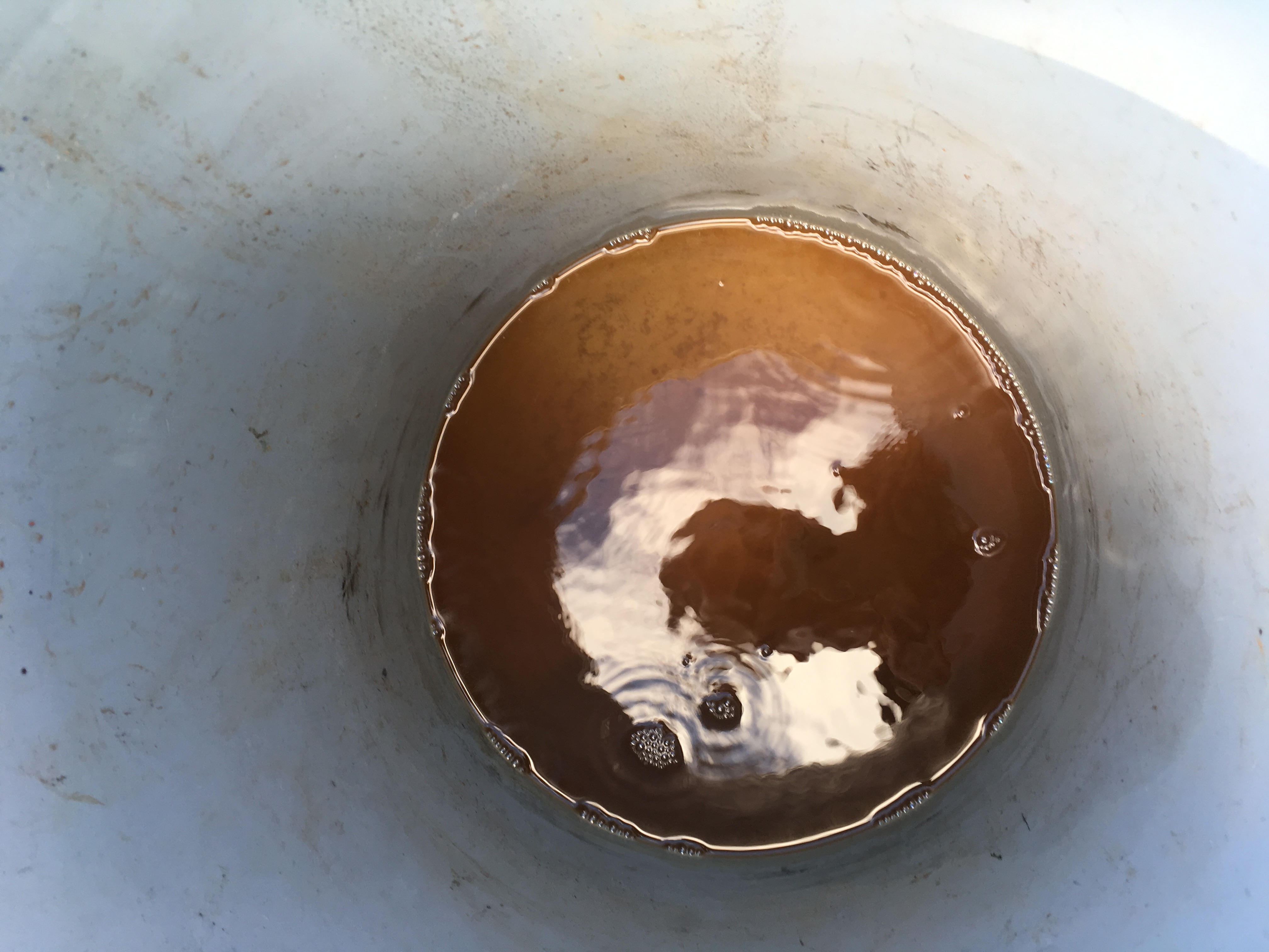

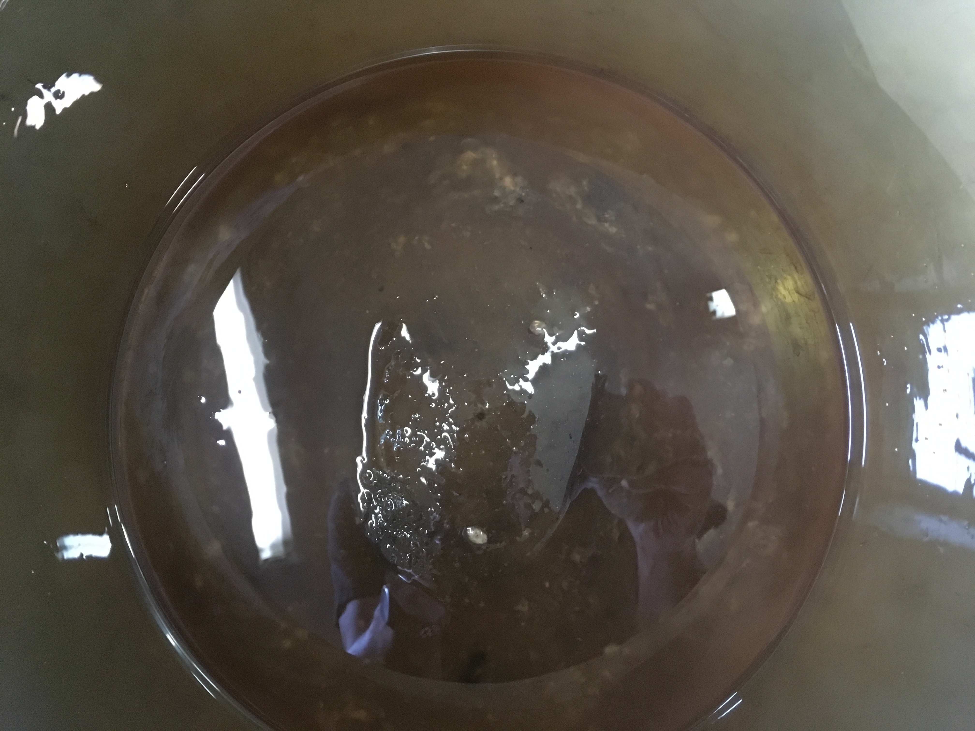

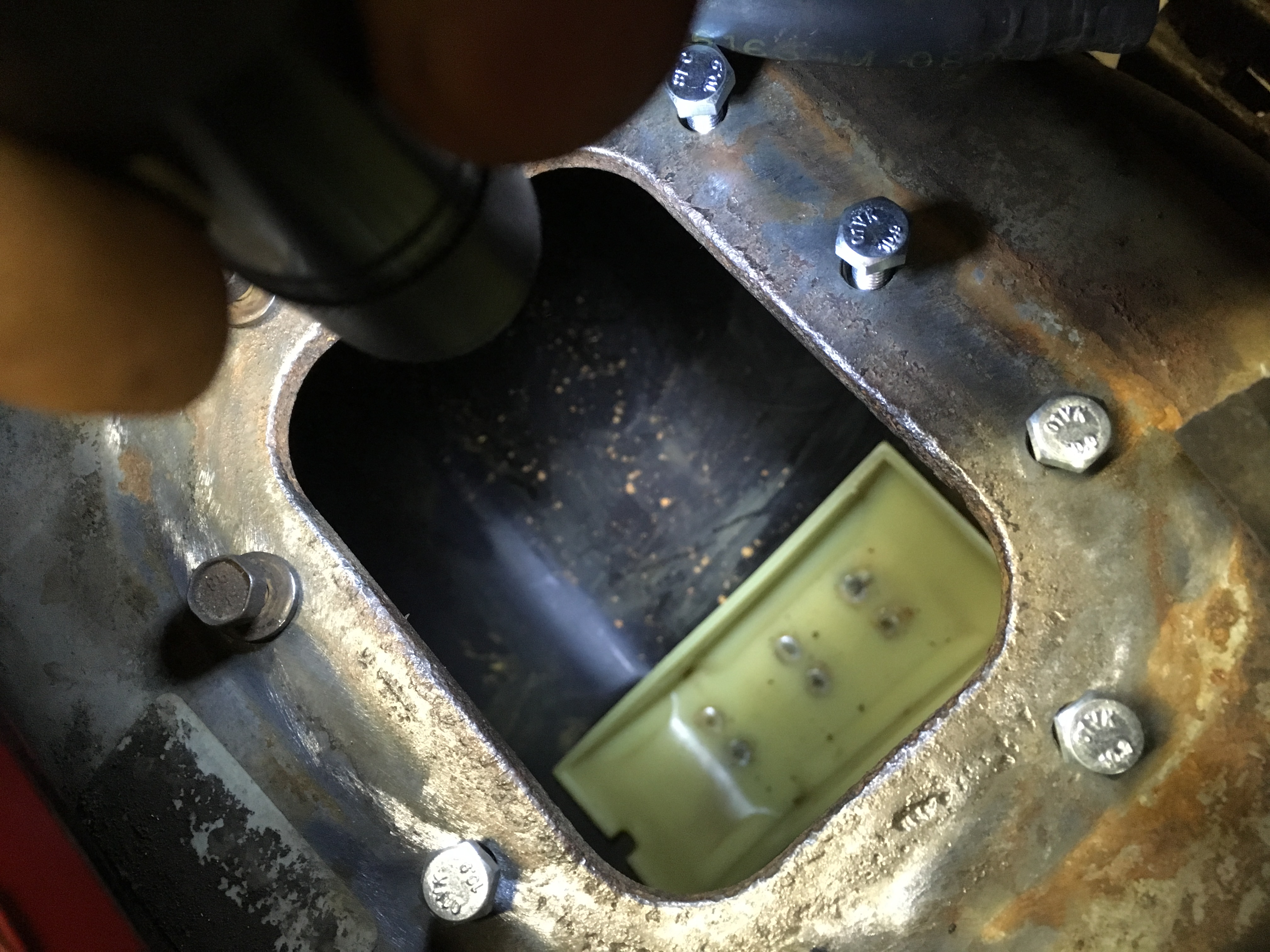

Gas tank. When we first looked in there we found some nasty mix of gas, water and rust. Today came time to install the sending unit in the tank. The car came with only one of the nine bolts. I planned to blow these out with compressed air and tap out the threads. When I did this there was to my surprise a lot of water coming out of there. The Vette has a plastic tank encased in a metal shell. After getting a bunch out with compressed air - enough to make a puddle on the floor - I decided the whole space between the tank and the shell was full of water. I made a small hole in the outer shell and drained over a quart of water out of there.
Then I turned attention to the inside of the tank. Tom had cleaned it a bunch when we first went in there but I found a bunch more debris in there. Used compressed air, shop vac, paper towels to clean the garbage out of the tank. I don't have any pictures yet, but Fred32v has been over several times working on the brakes. All four corners have been disassembled, cleaned up and reinstalled. All the 29 year old rubber brake lines replaced with braided stainless, all the old fluid flushed out, and the e-brake was tested it is just a bit sticky but it is functional.

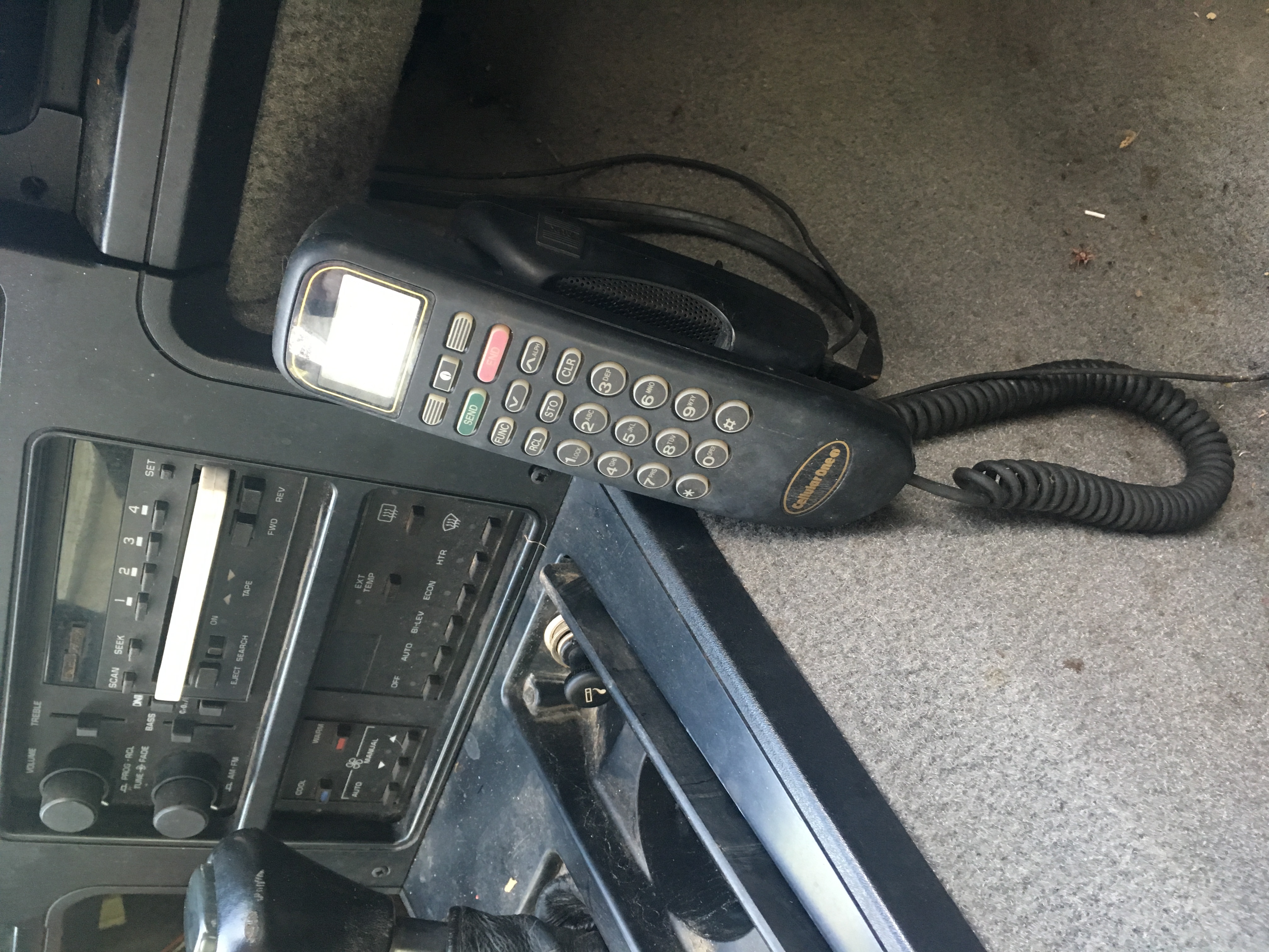

Excellent quality pictures!! But, did you notice the swamp creature in the tank??
https://www.tiresmoke.org/download/file ... &mode=view
Re: 89 Corvette Mostmint #39
And he took a selfie!!Maverick wrote:Excellent quality pictures!! But, did you notice the swamp creature in the tank??![]()
If the swamp creature tried to call I did not answer since I removed the phone from the car
I am not sure but we may have seen this creature before when we drained the oil out of the engine
My best guess is this car sat outside for a time where rain had access to get into the engine and into the gas tank - via the PCV lines in the engine and via the fuel sending unit for the transmission. You can't make this stuff up

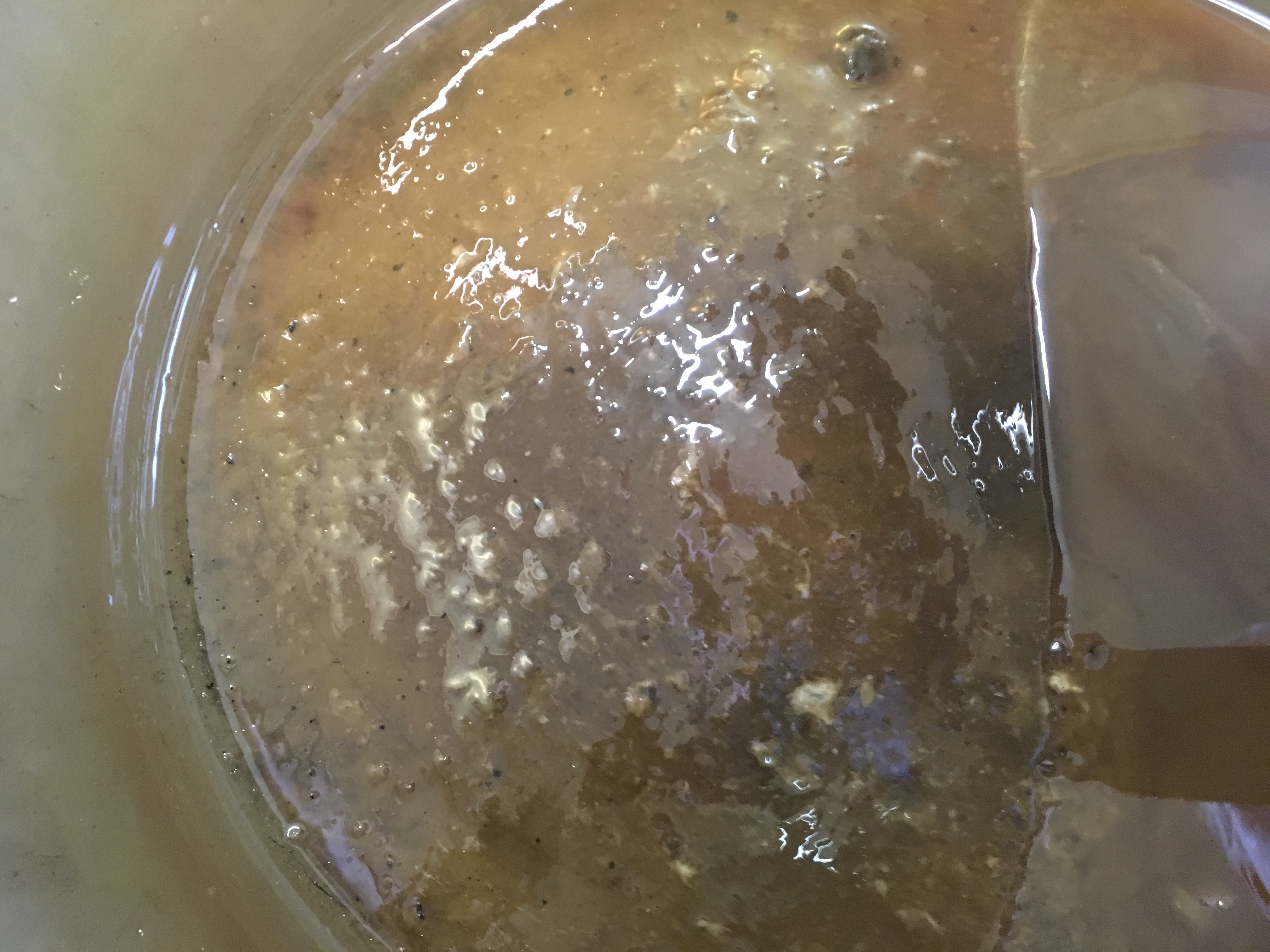

So this is how much water was trapped between the plastic gas tank and the metal liner. It is still dripping now though very slowly.
I think this is at least 2 quarts
That is probably the factory setup to improve the weight distribution.
