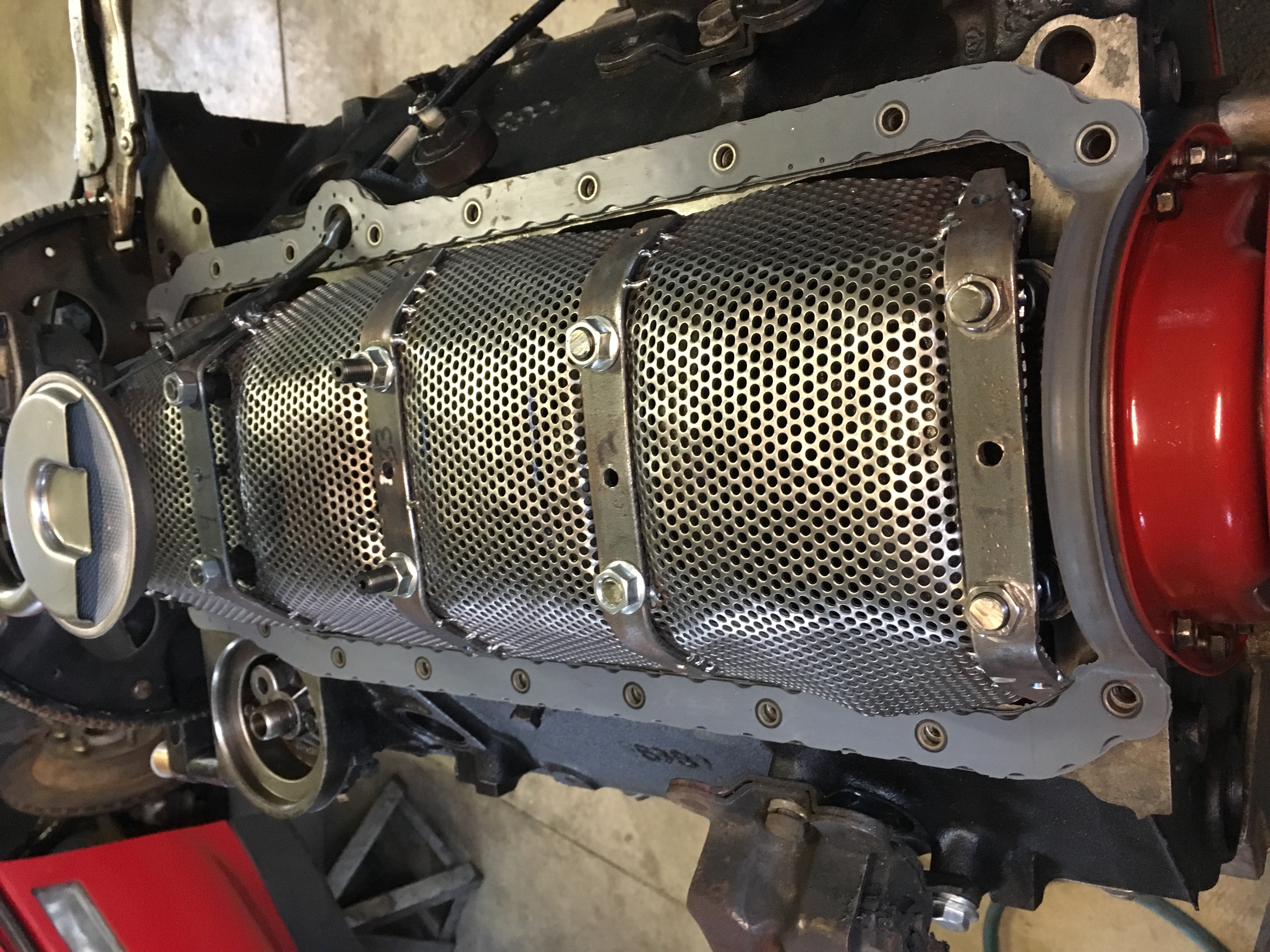

Your windage tray, however, did generate an interesting question from Maverick. How do the cylinder walls get lubricated with the windage tray in place? Isn't some oil splash needed?
Posts: 3037
Re: 89 Corvette Mostmint #39
there is always oil coming off the crank from the rod journals that will be splashed up on the bores.
https://www.summitracing.com/parts/ctr- ... /chevrolet
Similar products are commercially available but I felt this was not close enough to the crank, it did not extend to the front of the pan, and who knows what ChampCar would charge me for this point-wise. What I have was hand made and they charge like 1 point per square foot of sheet metal.

After way too many hours the windage tray is complete.

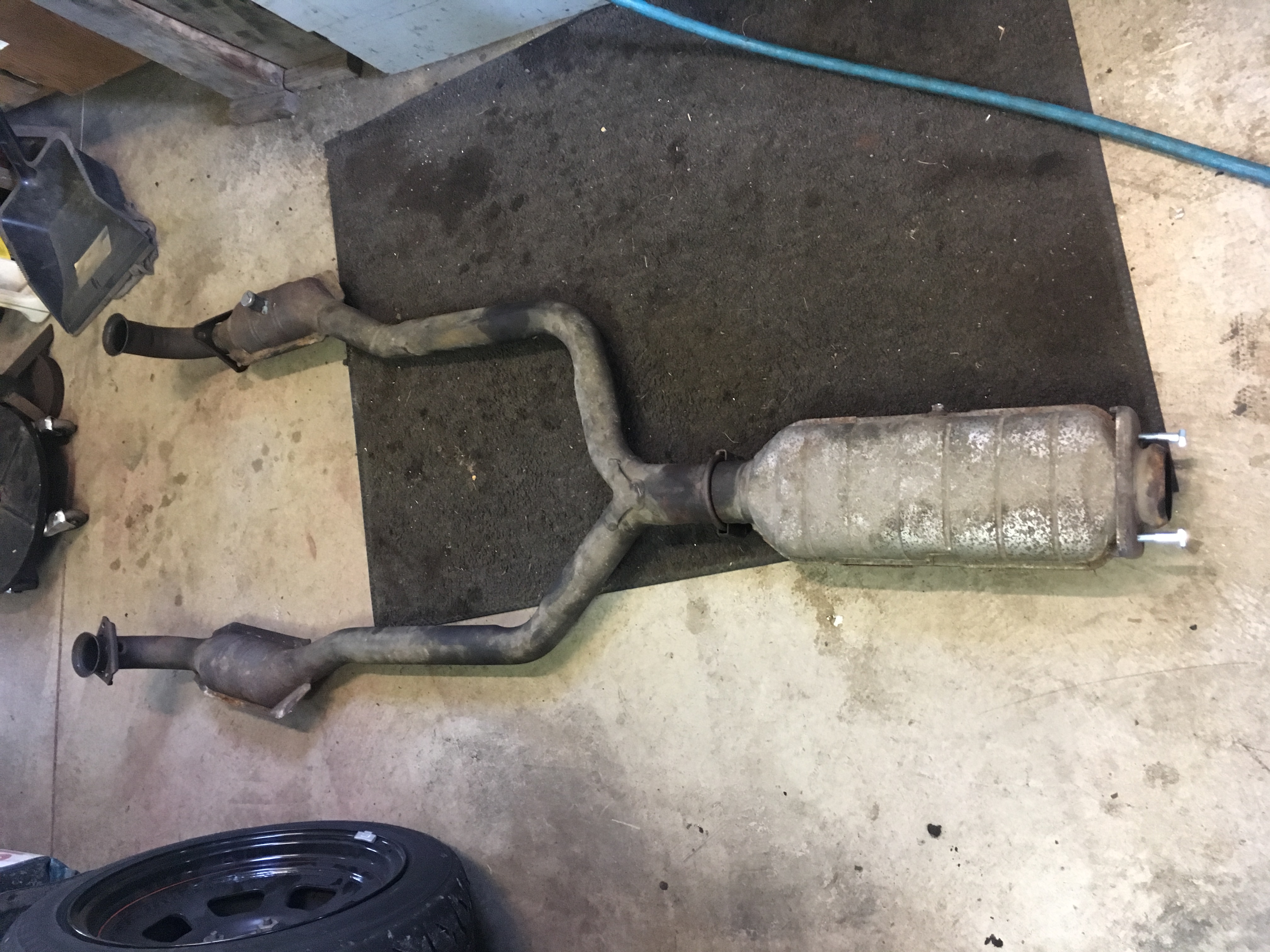

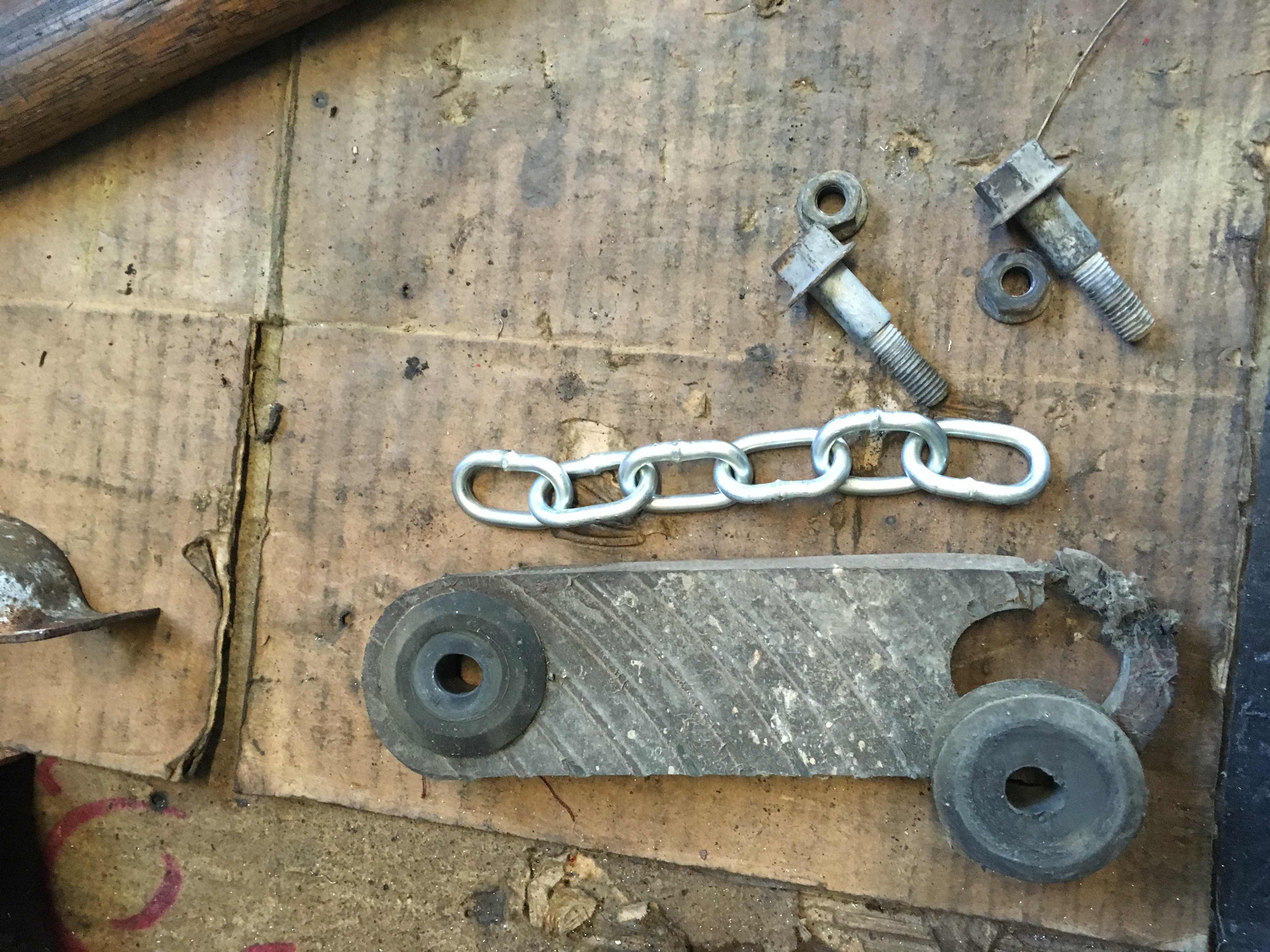

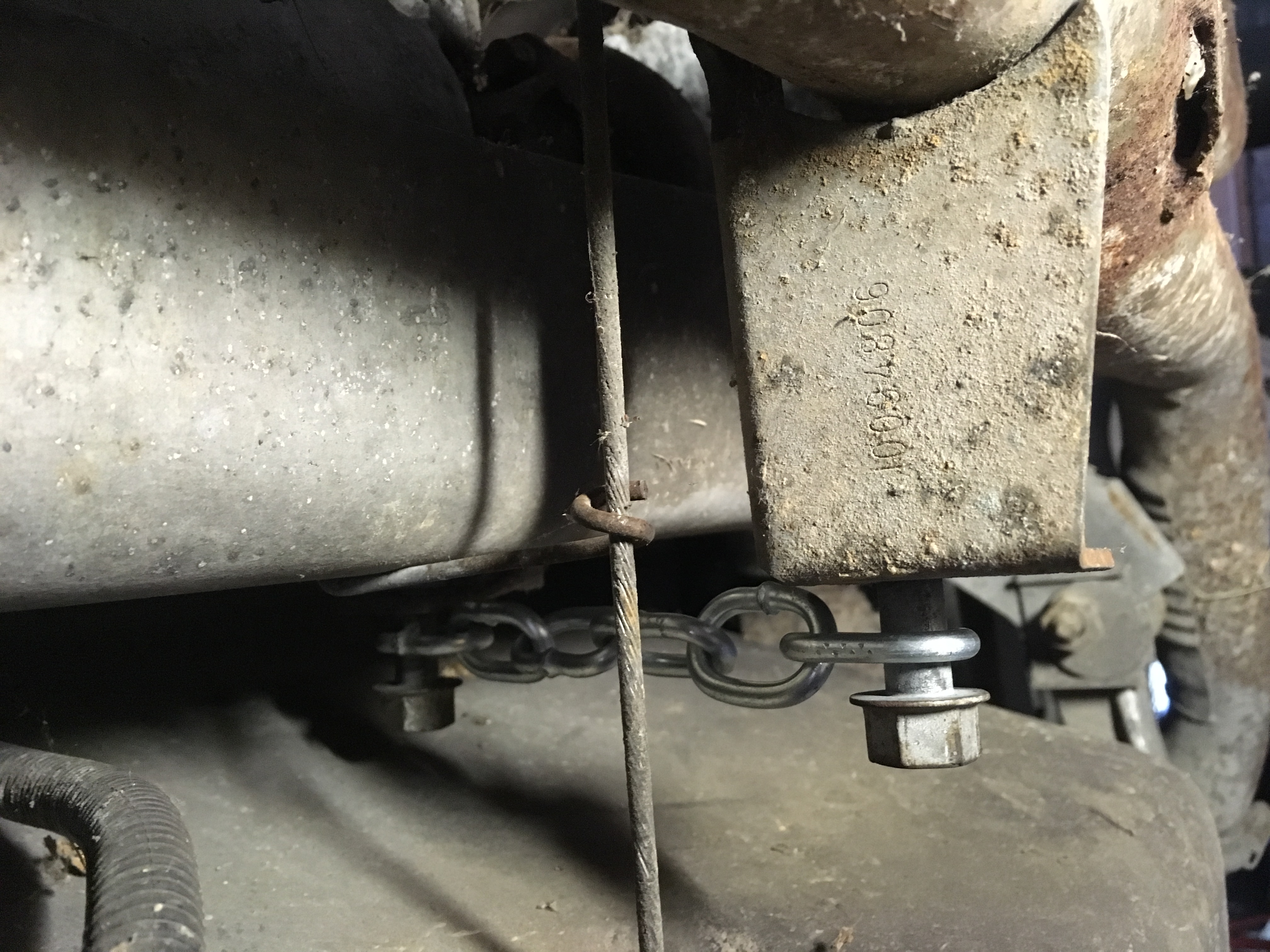

Checked the exhaust found the cats had already been emptied. Removed the tube for the EGR and had the opening welded closed, put an O2 sensor bung on there for the AFR gauge. Fixed the center hanger under the trans by removing broken bolt. Replaced broken rubber hanger with chain. Replaced bolts connecting catalytic converter to exhaust pipe. Reinstalled the downpipe and cat. New O2 sensor installed.

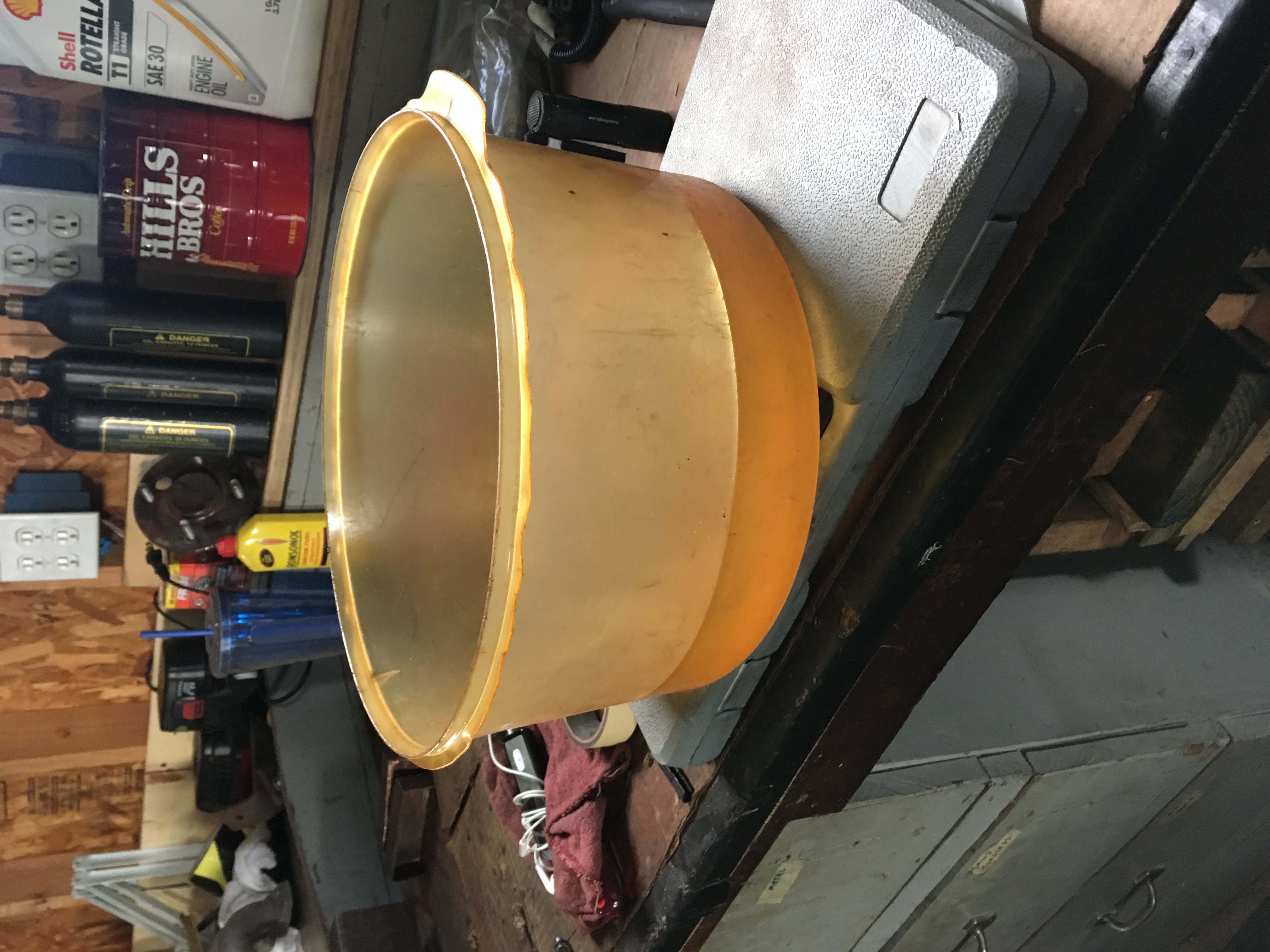

So this is how much water was trapped between the plastic gas tank and the metal liner. It is still dripping now though very slowly.
I think this is at least 2 quarts
