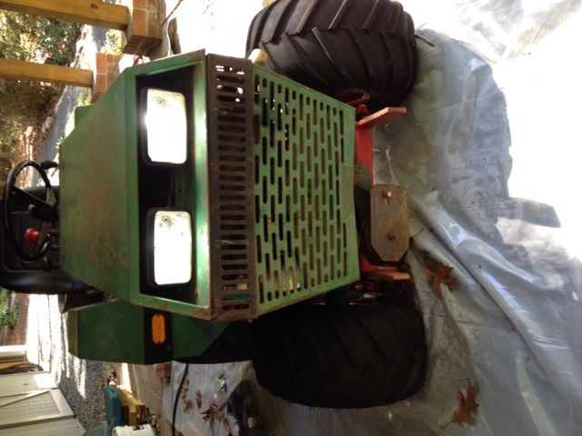

The new LED tail lights and headlight bulbs arrived and I finished the installation today. Unfortunately none of them light up. The condition of the connections is tenuous at best. Someone has replaced the terminals on most of the ends of the wires and I'm afraid of disturbing anything that doesn't need to be disturbed. I found one red wire that is connected to nothing. It's time to dive in and figure things out. Good thing I have a wiring diagram to work with.

Lights are functioning now. There were multiple problems. The first thing I fixed was the wiring to the tail lights. I had them hooked up backwards and the LEDs wouldn't light. Once that was fixed I ran into a dirty, corroded light switch. Since it was so old, I was able to open it up and clean and lube the slide and now it's as good as new. Just to be thorough, I cleaned all the connections to the switch and that was it.

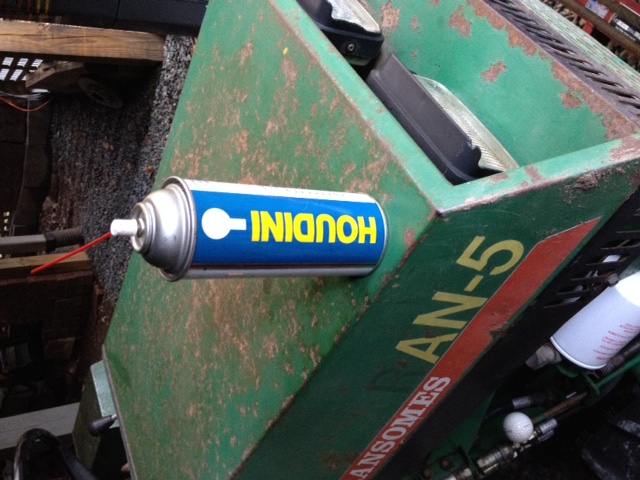

The starting problem is the neutral switch. Unfortunately it is buried where the human hand cannot possibly touch it. I'll save it for another day.

BACK IN BUSINESS! "Houdini" was instrumental in getting the neutral switch to work reliably. The switch was so inaccessible I had to resort to other means.
Houdini is a dielectric spray among other properties. I was able to soak the plunger that actuates the switch so that it flowed down and helped get it working.
