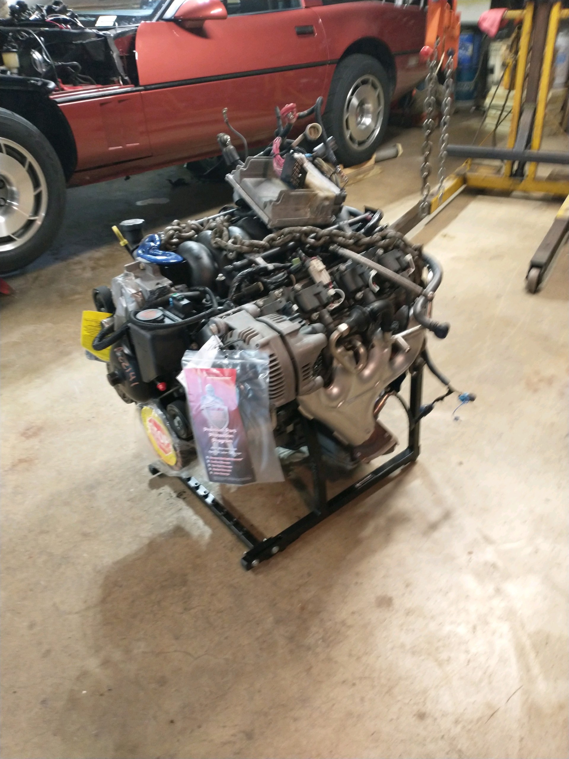

Well, I'm in deep now:
https://www.ebay.com/itm/135150839550
This will be headed my way. Lots to do in the meantime. It's more than I wanted to spend, but it's a BIG upgrade so I shouldn't have to do much to it in the future or buy a whole lot for it now that isn't swap related. Next up, transmission stuff. Working with RPM transmission for that...

Re: 1987 Corvette Z52

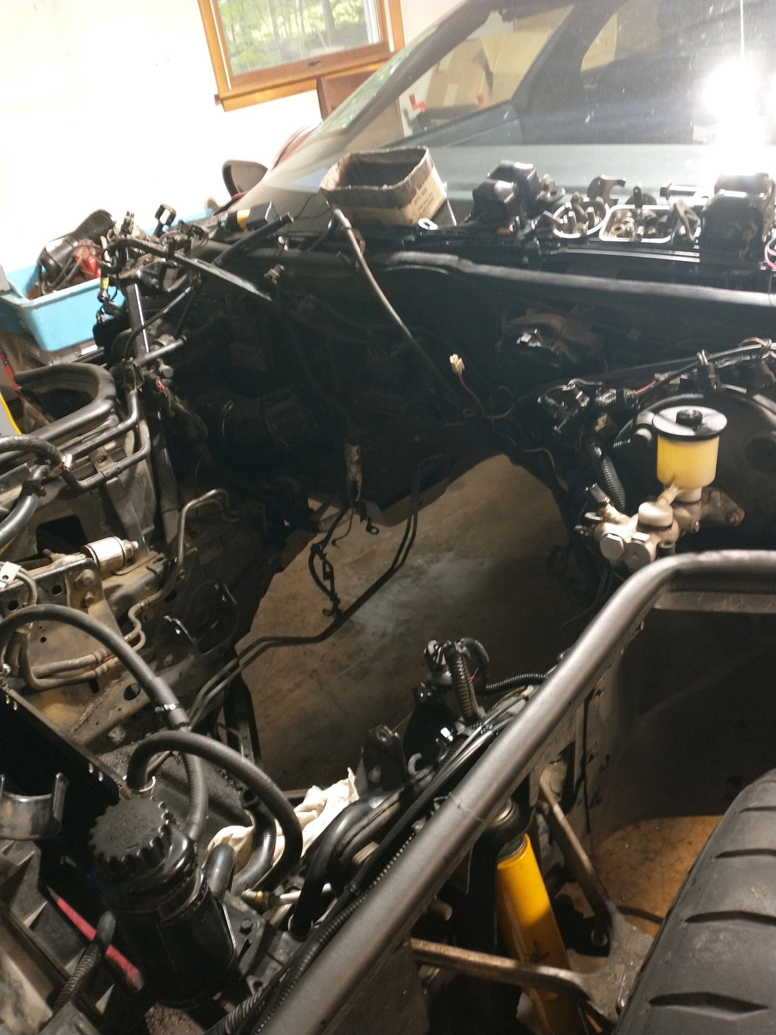

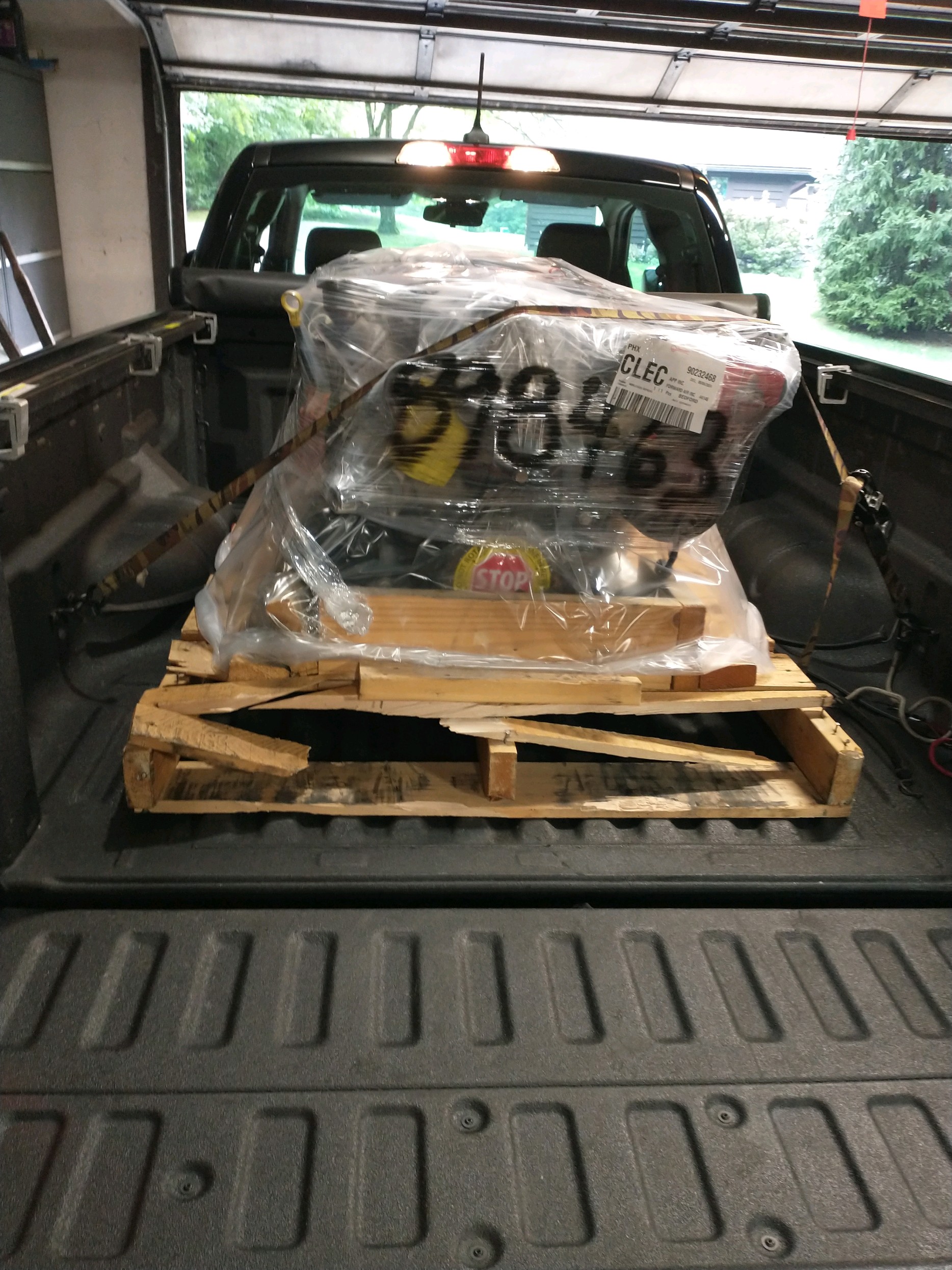

Saturday we got the trans out so the bay is ready and waiting for it's new powertrain. The new motor is supposed to arrive today according to tracking.

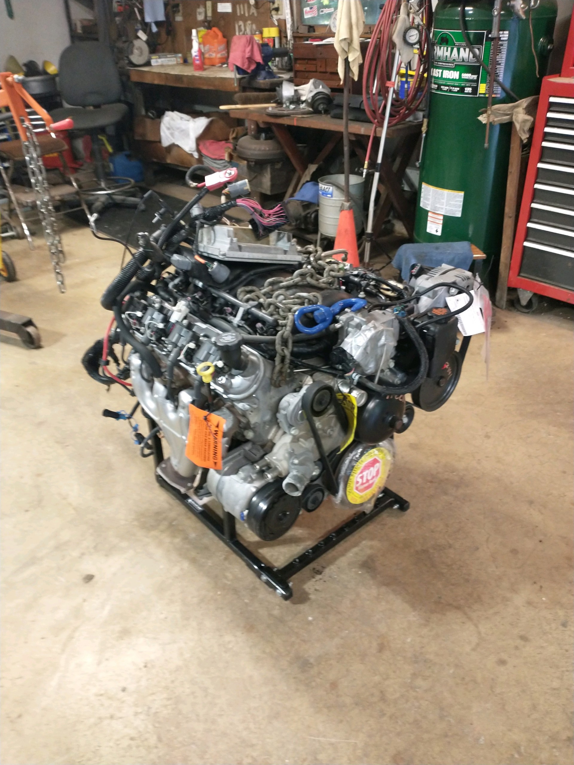

The "new" motor made it safely to it's home in Chardon. Today I started taking advantage of the no tax days in Ohio and bought a wiring harness of sorts, LS to C4 motor mounts, and a 1996 Corvette automatic transmission core. This will be sent to RPM Transmissions in Indiana for a Level V rebuild. These guys built the trans in my S10 and I've beat the balls out of it for over 20k miles, so I figure they're good. The trans core from a '96 is critical because it's a one year only, OBD2, C4 Corvette automatic.
More parts will be ordered this week as well. Just getting the major stuff going.

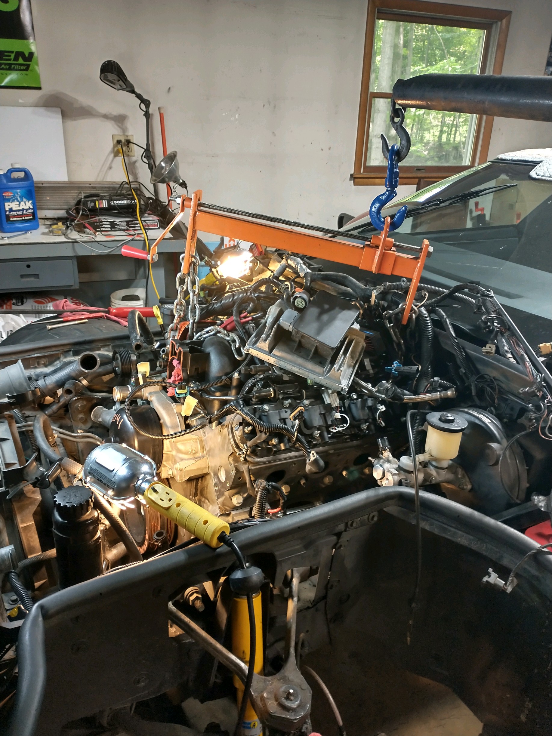

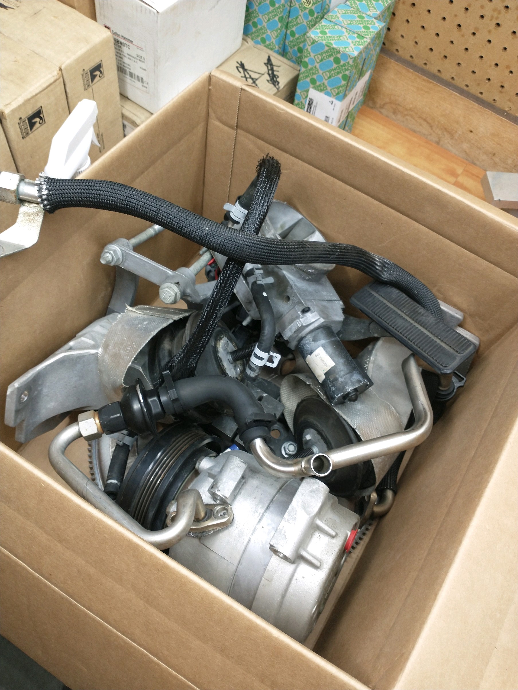

We pulled a bunch of parts we weren't going to use off the LS1 so I could get them promptly on ebay for sale. The AC, throttle body, egr tubes, flexplate, and motor mounts. We got the new swap engine mounts bolted up and did a quick attempt at setting the motor in the car. Unfortunately we have a couple obstacles, so next week we'll pull the wiper motor out (which I knew would be a problem) and try again.

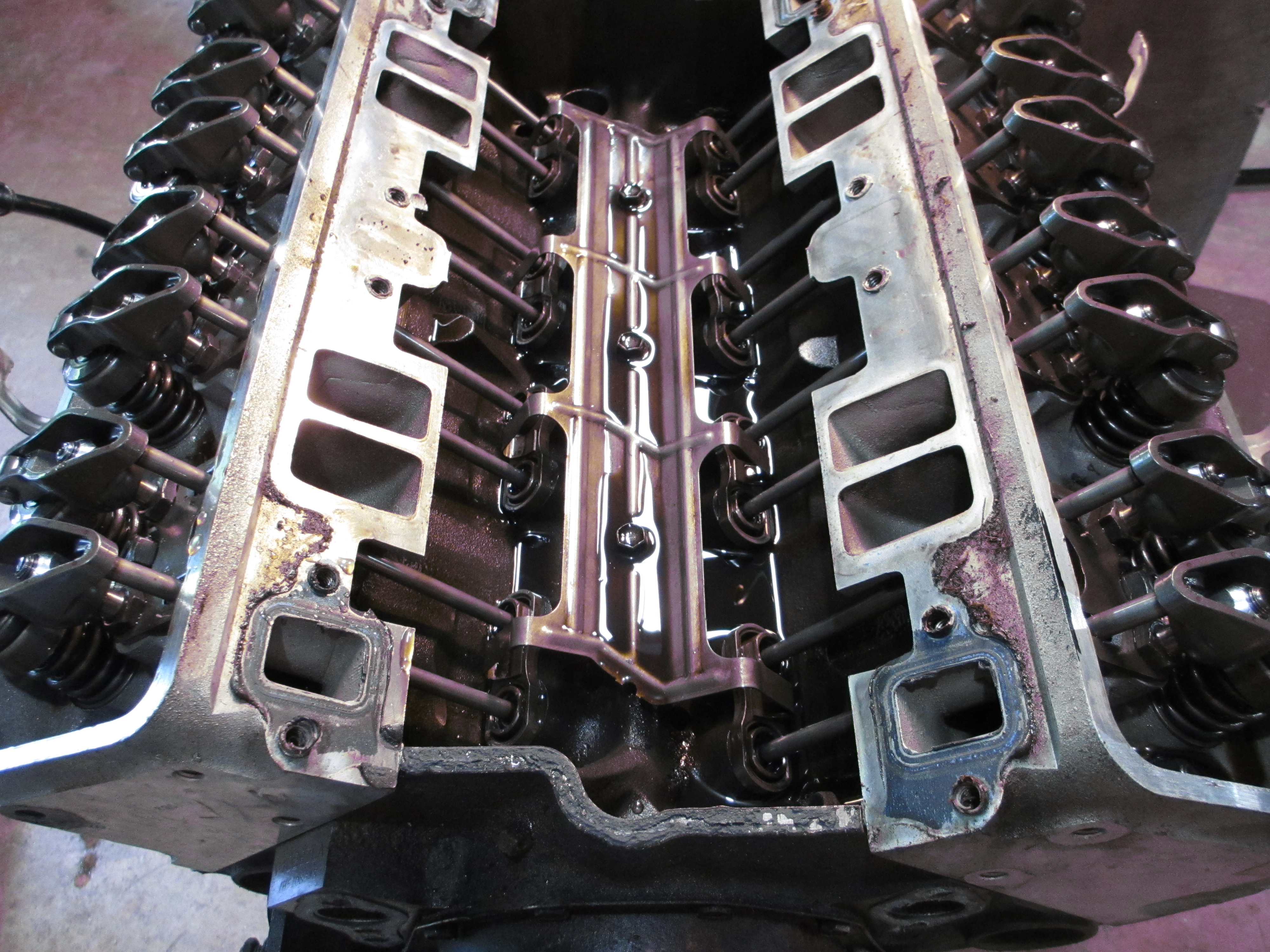

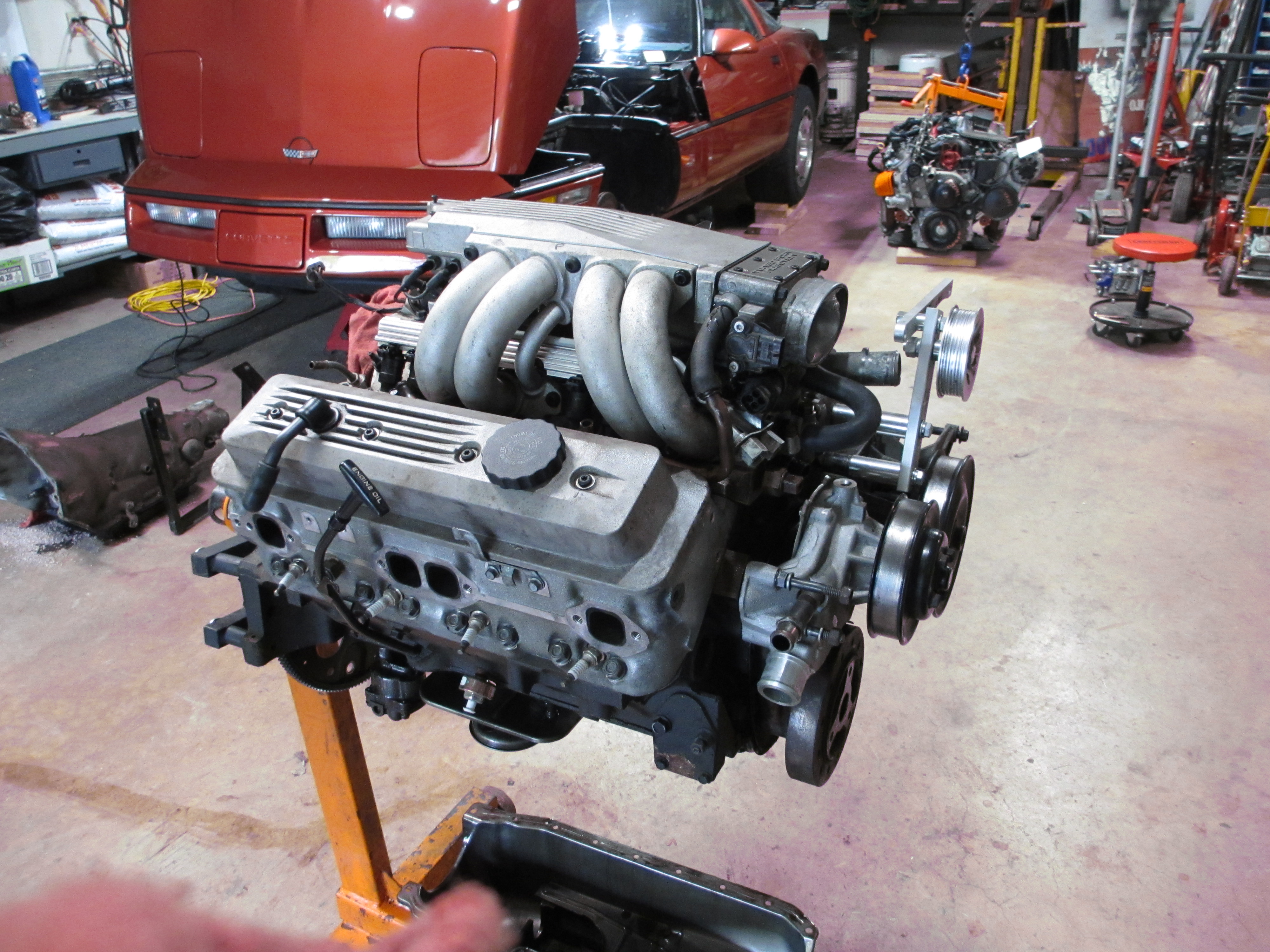

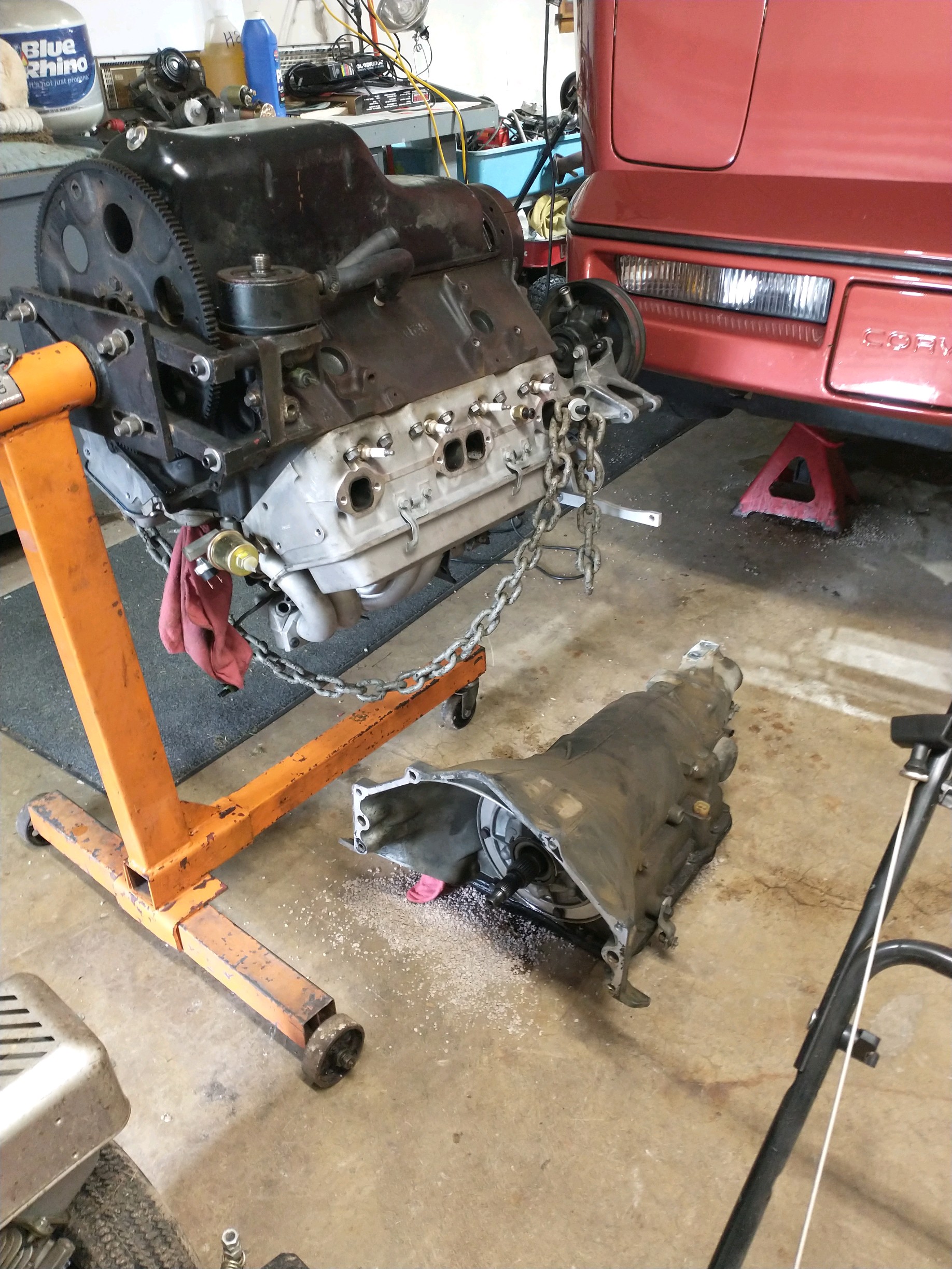

This past Saturday we tore the L98 engine down to nothing but the rotating assembly. These parts will also end up on ebay for world to purchase at a reasonable price. I did list all the extra LS1 parts and already sold the throttle by wire throttle body. I also bought an old used cable operated t-body from the "Mad Scientist" collection. If you've ever seen any of Chris Hill's vehicles, you'll know why I call him that. He's the one with the mid-engine Silverado and Express Van to name a couple.

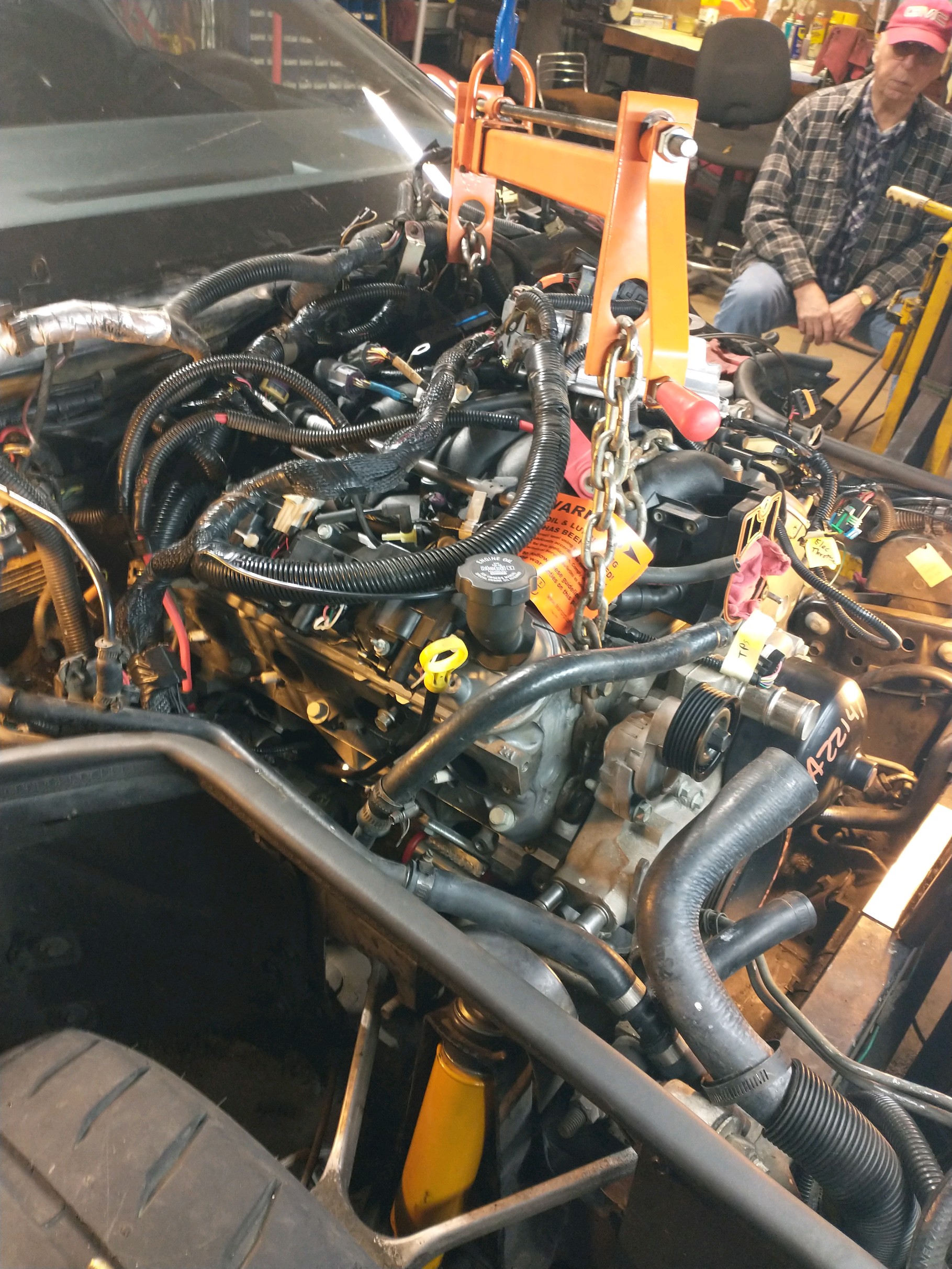

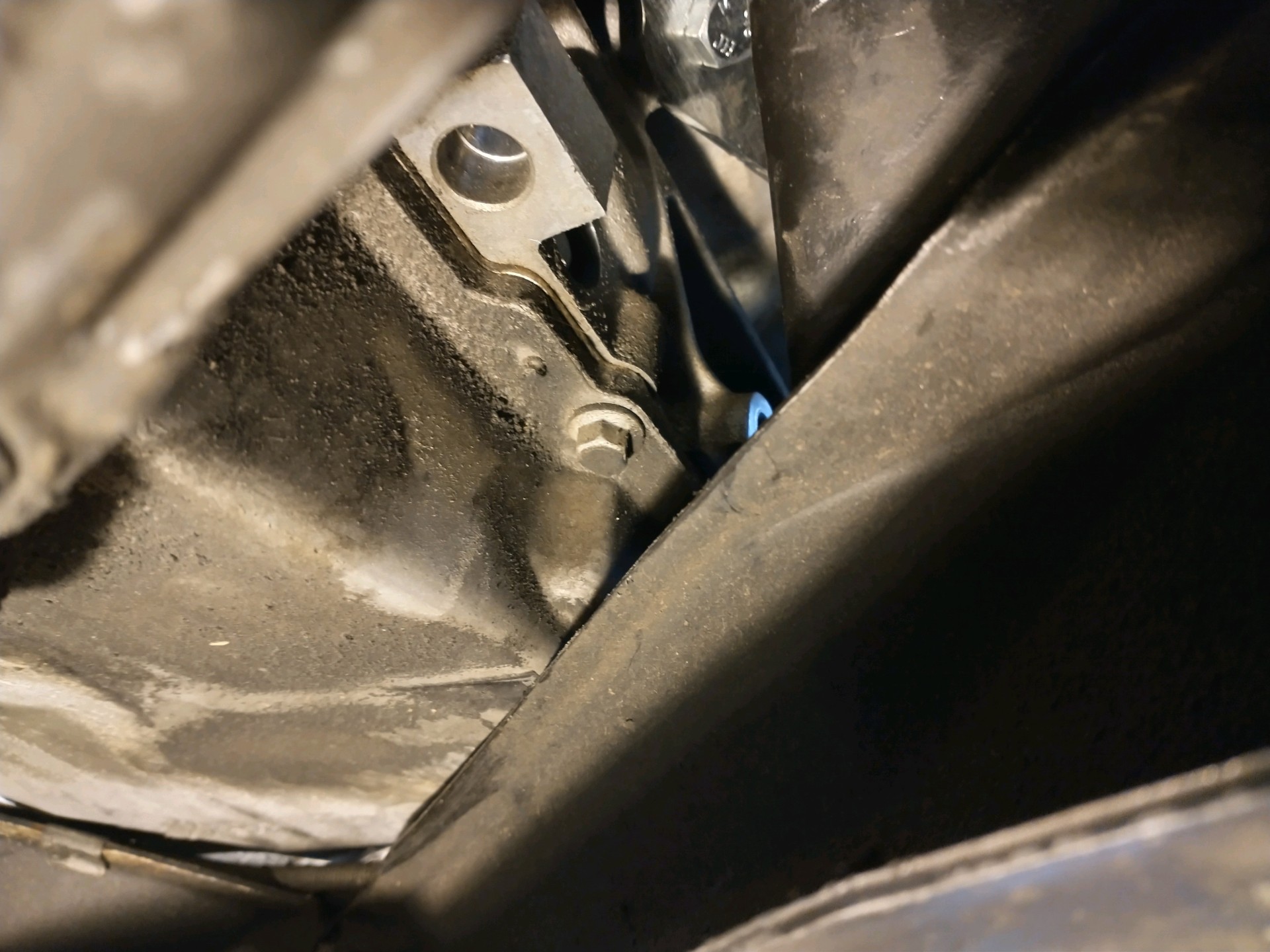

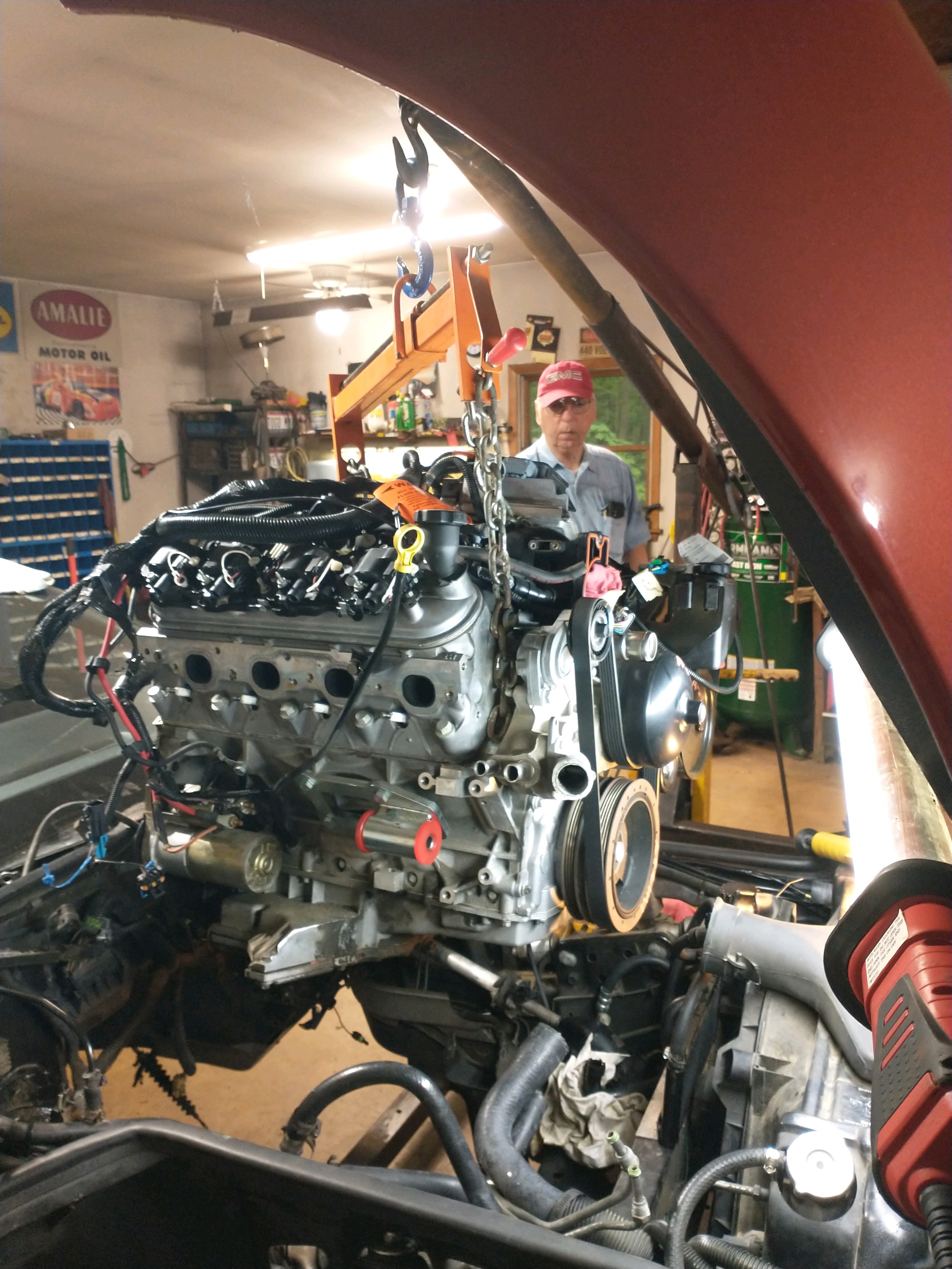

The past few Saturday mornings have been spent trying to get this LS1 to sit on the engine mounts. It's been in and out no less than five times, and each time learning something new. At this point the exhaust manifolds are removed, the alternator came off, the power steering pump and bracket have been removed, and the rear wiring harness has been moved. We got to the point where I was able to get the bolt in the driver's side mount, but the passenger's one is about a 1/4" shy of going in the hole. After further inspection, the oil pan is now touching the frame. Some guys say it fits, some guys don't. Ours don't. So I've found a pan that is shorter up front than our pan by about 3/8". Hopefully this is enough, but I'm betting it is. My pan is just over 2" from the mounting surface to the bottom of the pan, and this one claims to be 1-5/8". I also like the baffling design inside the pan, which is basically identical to the Canton road racing pan.
Here's the pan:
https://www.speedwaymotors.com/LS-Swap- ... raEALw_wcB
The torque converter and adapting parts are ordered too, and should be arriving in the next couple weeks. Since there's dirt drags for the next couple weeks, there won't be a lot of progress on this thing.
Lots more to come.

So as I'm doing more reading, a lot of people are just notching or modifying the crossmember where the pan hits, so before I blow a few hundred bucks on a pan and pickup that may not work, I'll look into modifying what I have...
