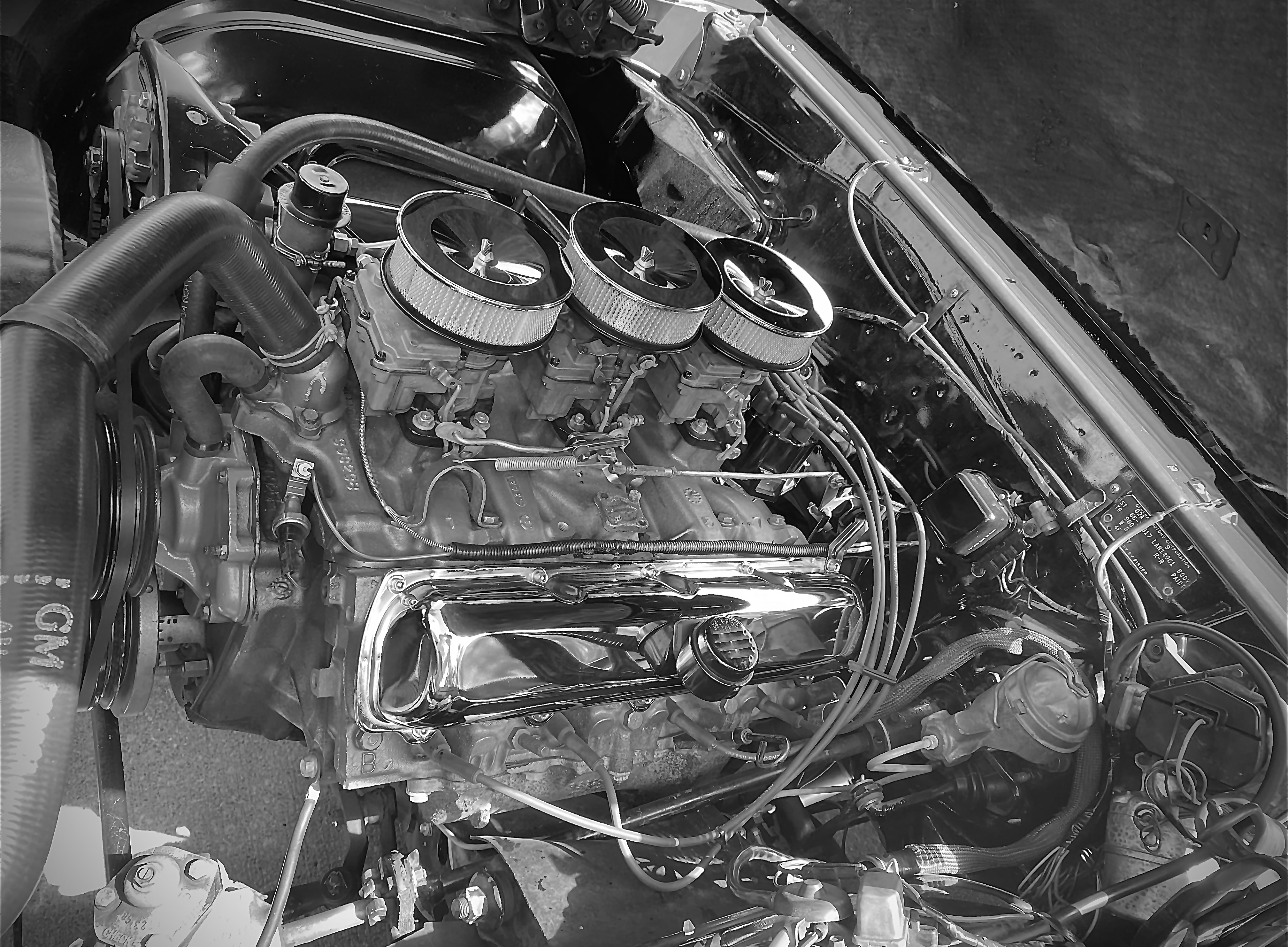

Valve Cover Change
59700.....On Memorial Day I had some spare time to install some chrome valve covers on the 442. I found a set of center hole valve covers on the cheap on EBay and went for it. I’m normally the “chrome don’t get you home” type of guy, but these are a nice clean look and the painted ones that were on the car were looking a bit rougher than I wanted. I got the covers, gaskets and bolts all for under $100. Before install, I permatexted the rubber gasket to the covers so the complete install took about 40 minutes. I was very pleased to see how clean the inside of the motor is. It looks like it was just assembled in there. Anyone who has taken a valve cover off of an Olds knows it can be pretty nasty in there, but I’m in the clear as it’s beautiful in there. I also discovered an adjustable valve train kit that I wasn’t expecting to see. I’ve test driven my work for over 200 miles and I’m not leaking a drop. GM

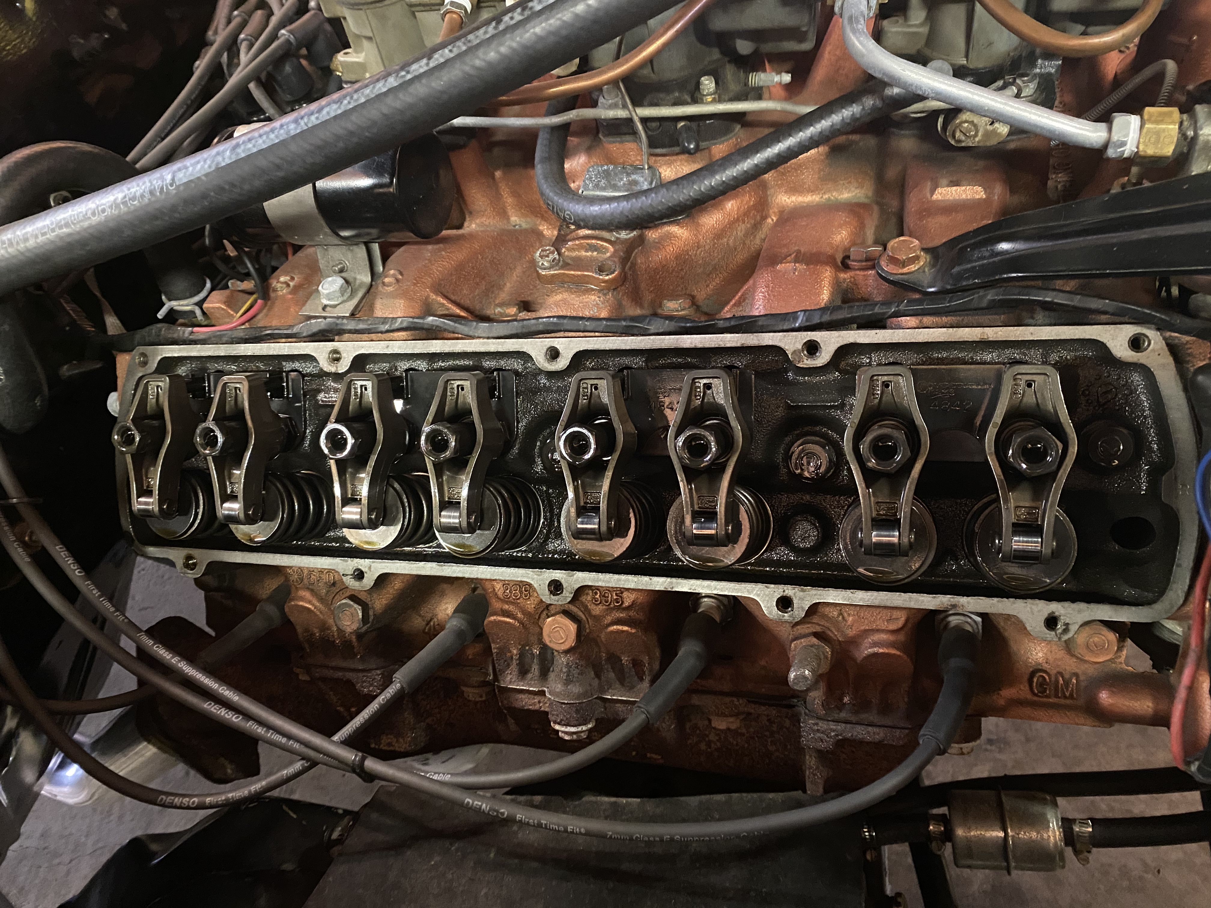

As I read the text I got all excited to see the new chrome valve covers,
clearly they are not chrome, they must be clear, since I can clearly see the rocker arms.

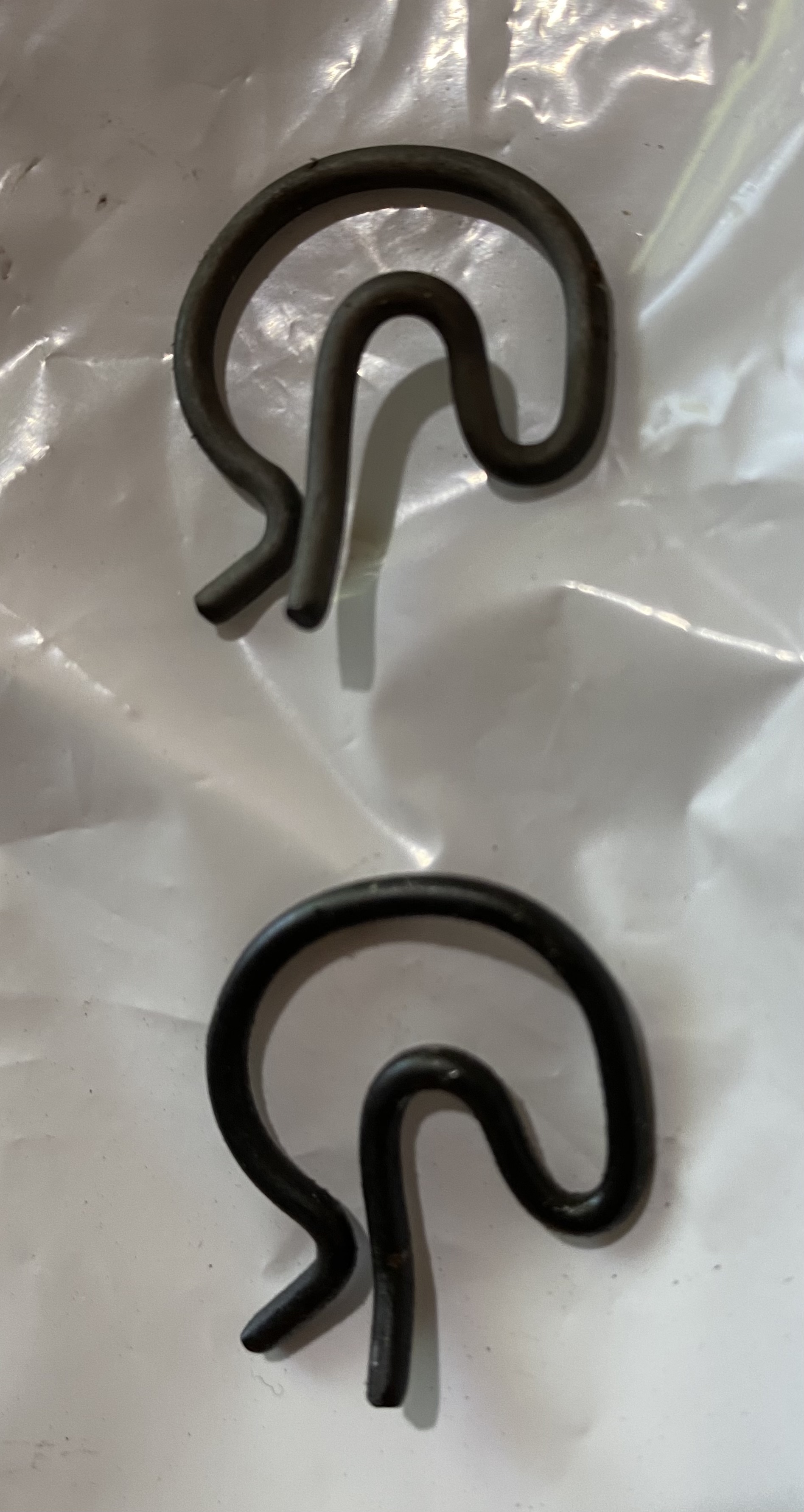

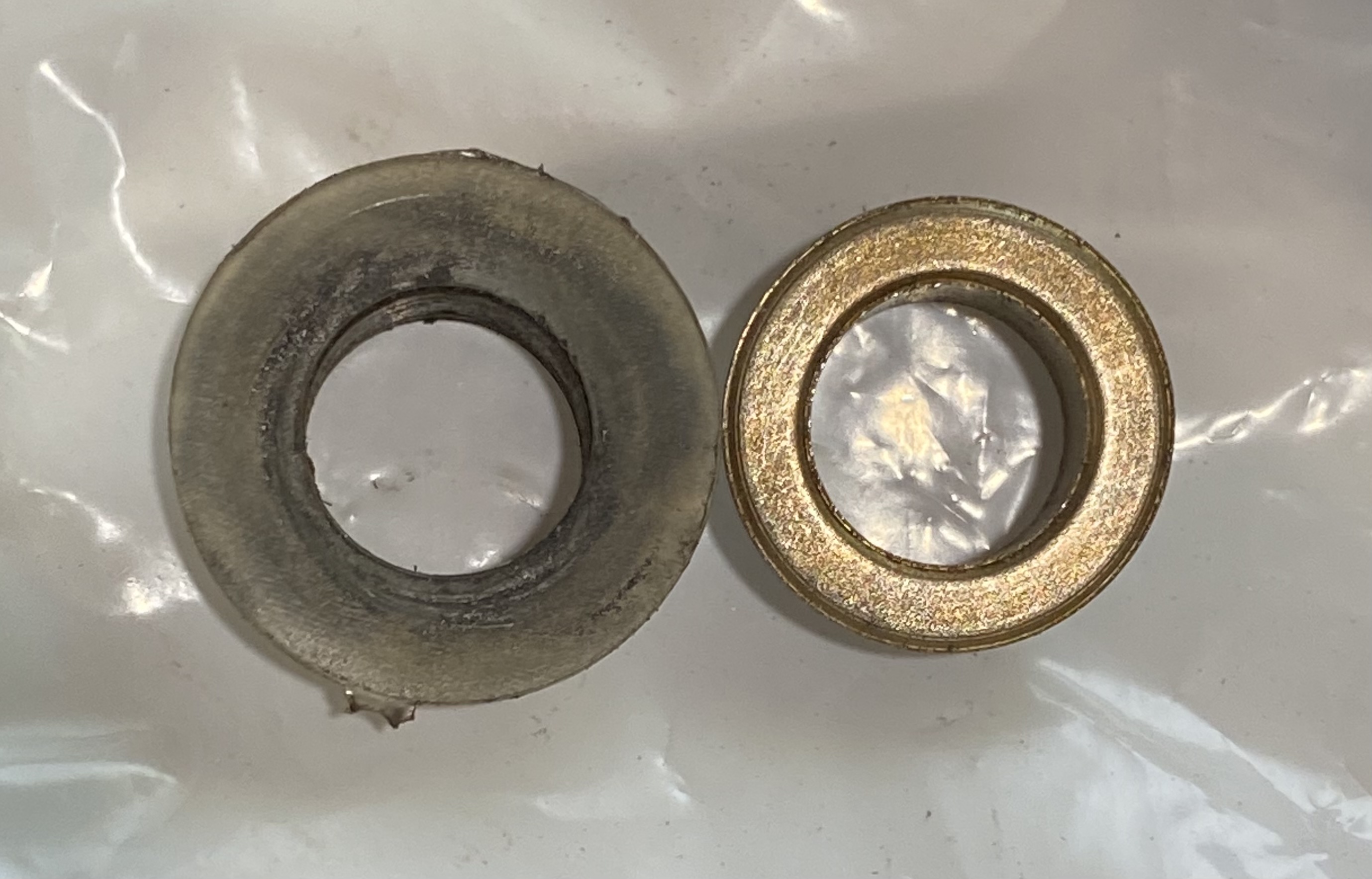

60000... On my ride home from golf the other night, I was making sure that all six barrels
were still functioning properly. When I went to make the 2-3 shift, I couldn’t. The car was
stuck in 2nd gear. Fortunately, I was within two miles from home and I was able to gimp
it to the barn. I checked out the deal today. The rod linkage was bound up. I freed it up
by hand. I’m going to replace the nylon bushings that are there. They’re not horrible, but
the kit is cheap and they aren’t that hard to get to. I also decided it was time to replace
my ignition switch. The switch worked fine, but the nut that holds it to the dash was unable
to thread firmly enough to it to hold it tight to the dashboard. It would twist when the key
was turned. I had a spare switch in the parts inventory on the shelf. The only cost was a
sore back and stiff neck. After the work was completed, I enjoyed 40 mile ride on an 80
degree afternoon ride with all the windows down.

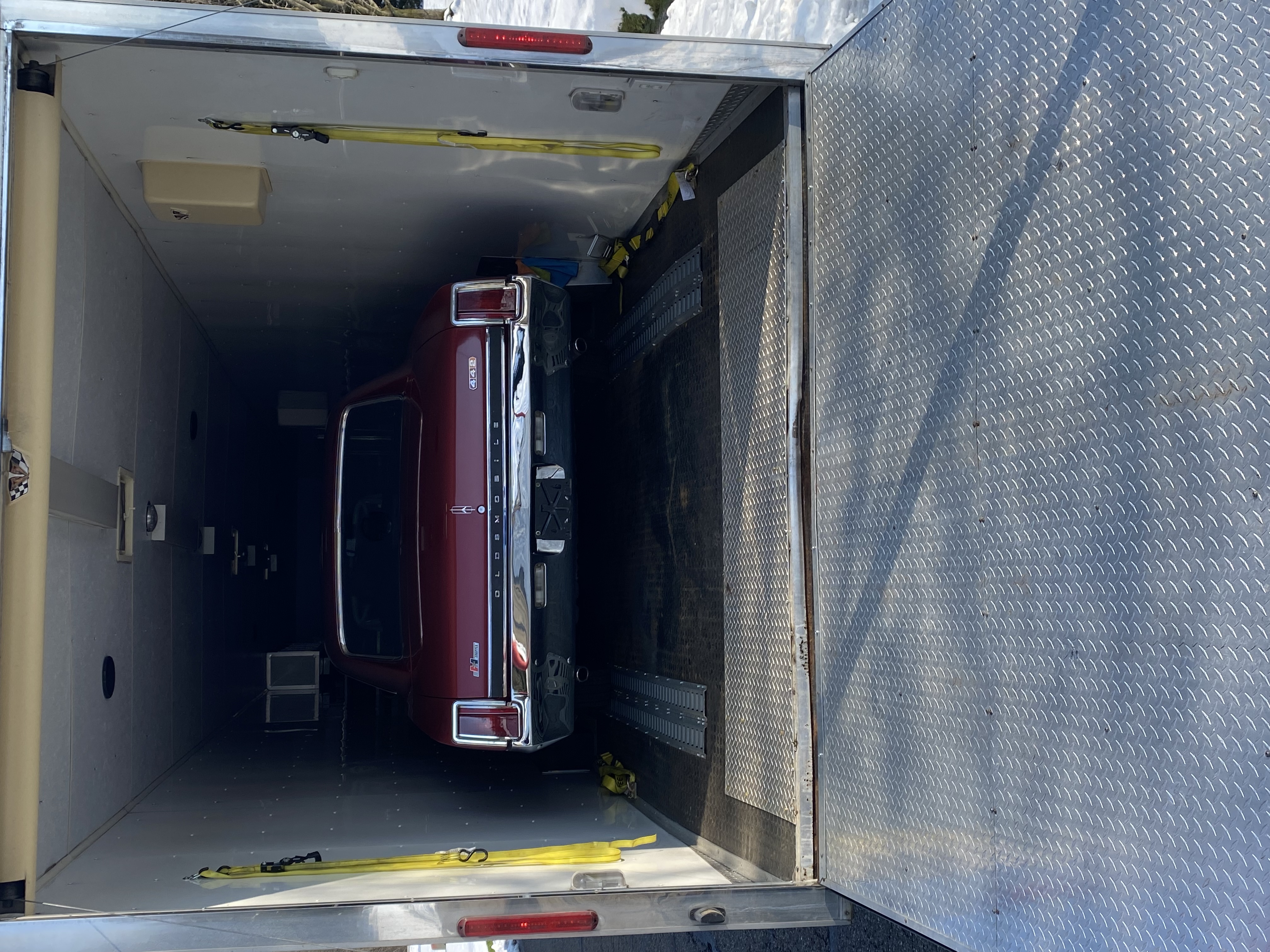

Re: 1966 OLDS 442
The 442 made it to its new home. I got a text at 8 am yesterday morning from the hauler stating that he’d be at my place around two to pick it up. After some communication, he was at my place at 1:30. We loaded up in the street and his intention was to make a few stops then deliver the car to its owner on Thursday. Sounds like plans changed somewhere along the way as the text came in the evening that the car was going to be at its destination at 11:30 pm…. I got the pic of it in its new crib at 12:30 last night. I plan on having a phone call to discuss any questions the buyer might have, but in the text he stated that he was very happy with the car, which is pretty important to me! This sale from day one to completion went flawlessly. Now to focus on a new project!
