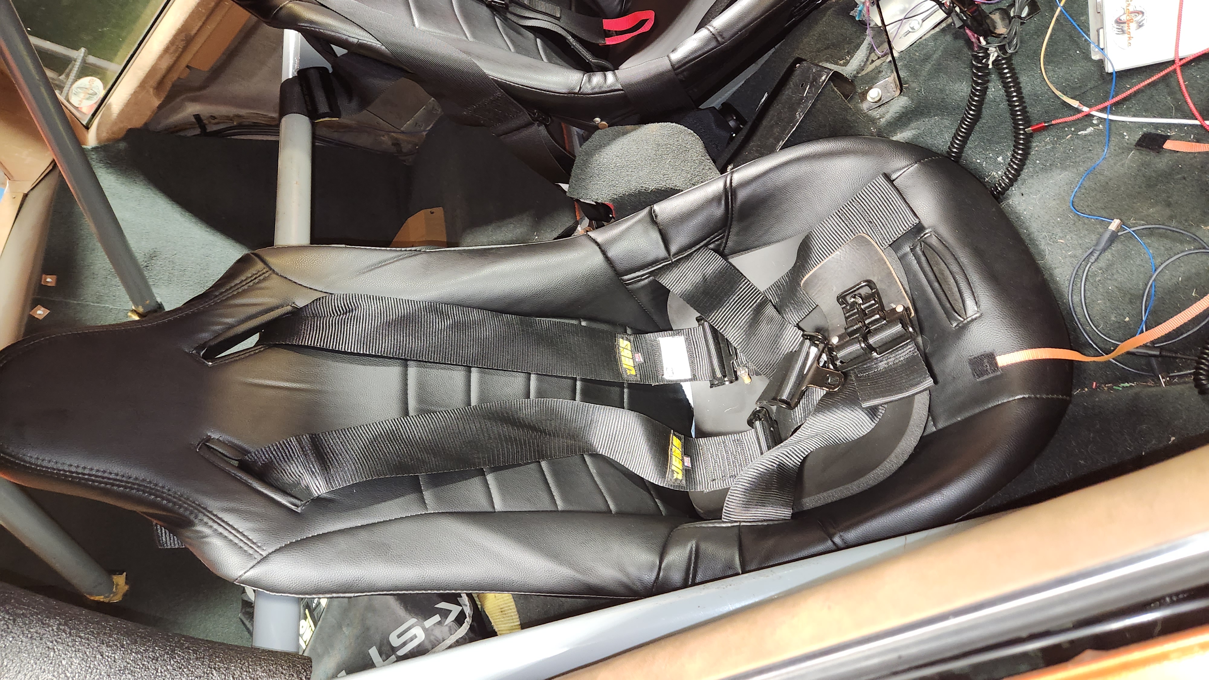

I got the new seat belts installed last night. I went with a cam-lock style, and what an improvement over the ones that were in the car. Everything fits better, and it's easier to put them on / take them off. I moved the old seat belts to the passenger seat, although I still need to drill a couple holes for the lap belts.

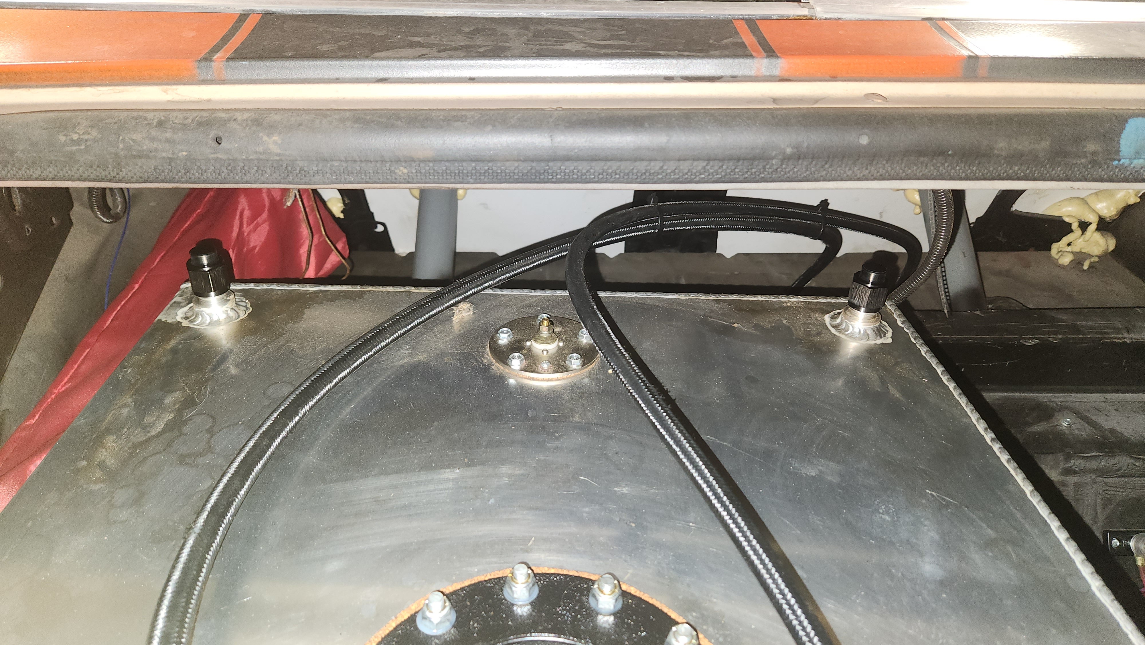

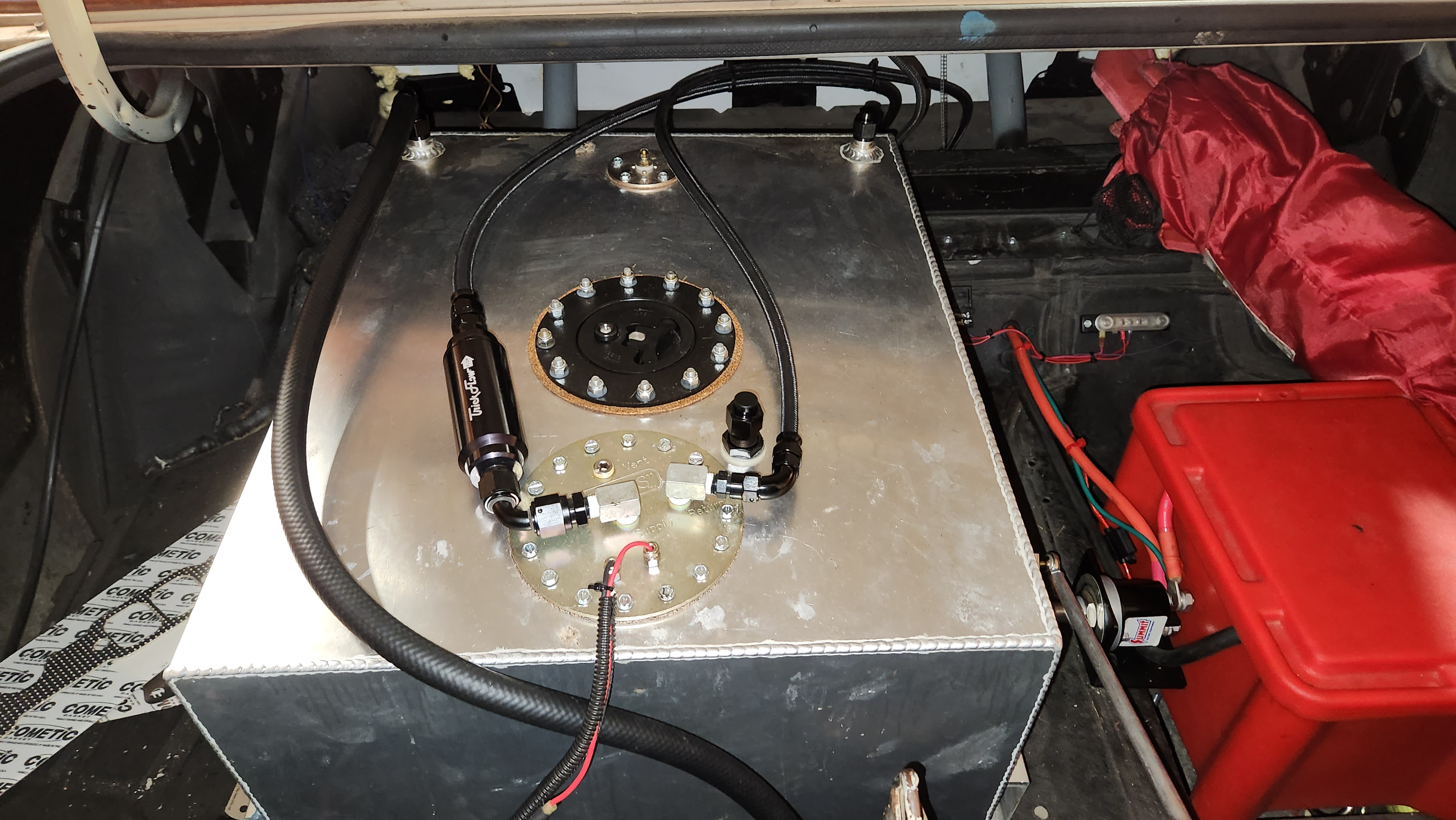

I also got the fuel cell vent setup. I capped the fittings at the front, and drilled a hole behind the license plate for the rear vent hose to run through. Hopefully this will eliminate the occasional fuel smell inside.

I would also recommend a breather filter or at least a fine screen of some sort for that hose. Being at the back of the car, there will be a lot of dirt and debris flying around while you're driving down the road, doing burnouts, etc that may potentially get breathed into that system.

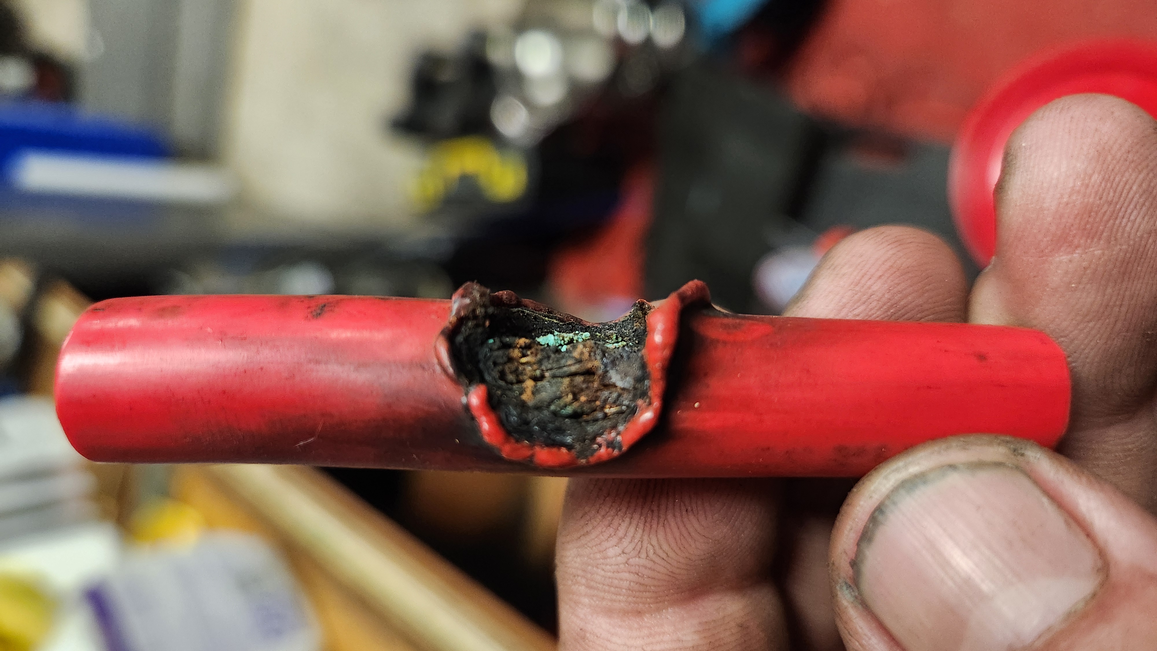

The Malibu made its street driven debut at Thompson on Wednesday. The good news is that is made it there and back without any real issues -- other than not being able to make a full pass due to an electrical issue. When I'd come off the line, on either the transbrake or footbrake, it would cut out electrically. It almost seemed related to suspension rise or something. I can see a reflection of a light-strip on the windshield going off and on when it happens. But I could hammer it on the return road (from a roll) without issue. It was a little frustrating, but it also felt really strong!!

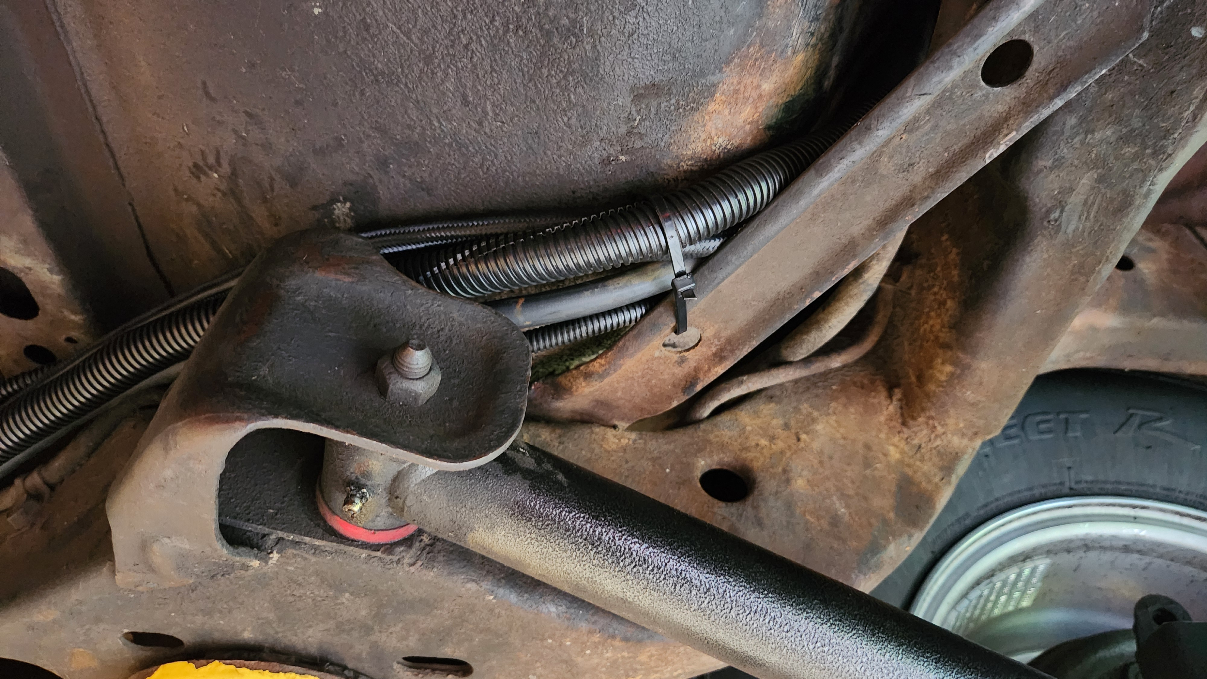

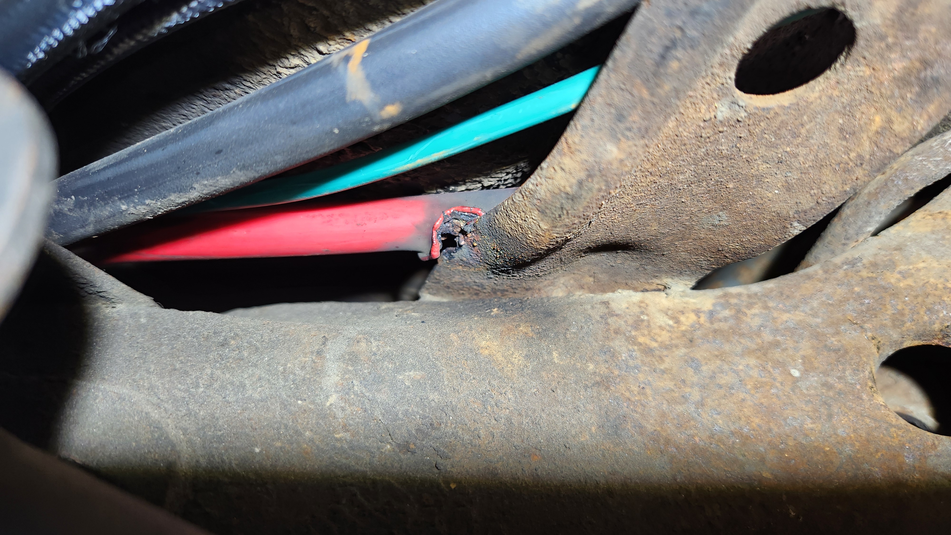

Well, I found the electrical issue.
A well placed zip-tie may have prevented that.
I ran a new cable, added split-loom** around the positive cable and the alternator cable.

I got the passenger seat belts fully installed.
