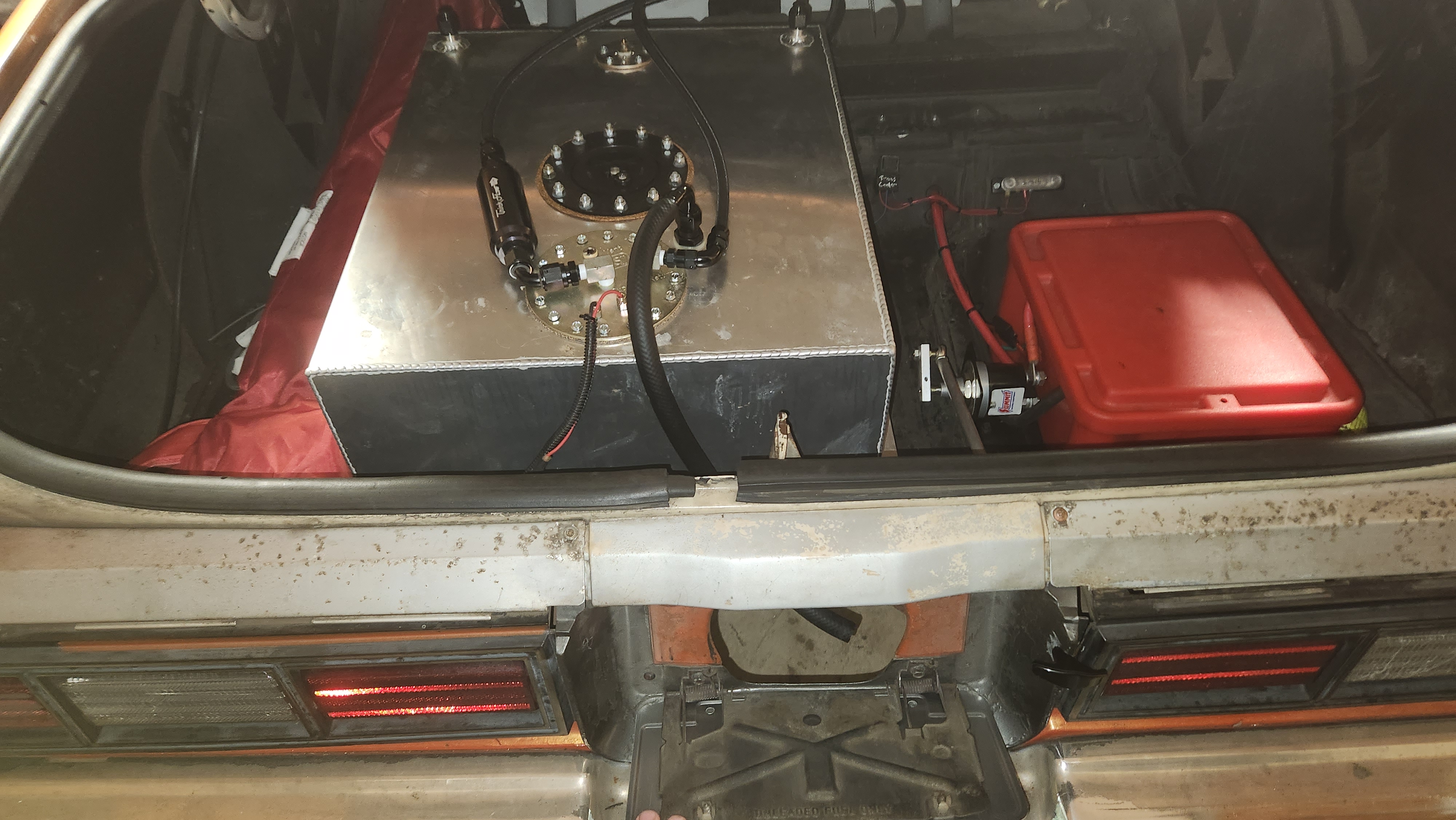

I got the new seat belts installed last night. I went with a cam-lock style, and what an improvement over the ones that were in the car. Everything fits better, and it's easier to put them on / take them off. I moved the old seat belts to the passenger seat, although I still need to drill a couple holes for the lap belts.
I also got the fuel cell vent setup. I capped the fittings at the front, and drilled a hole behind the license plate for the rear vent hose to run through. Hopefully this will eliminate the occasional fuel smell inside.

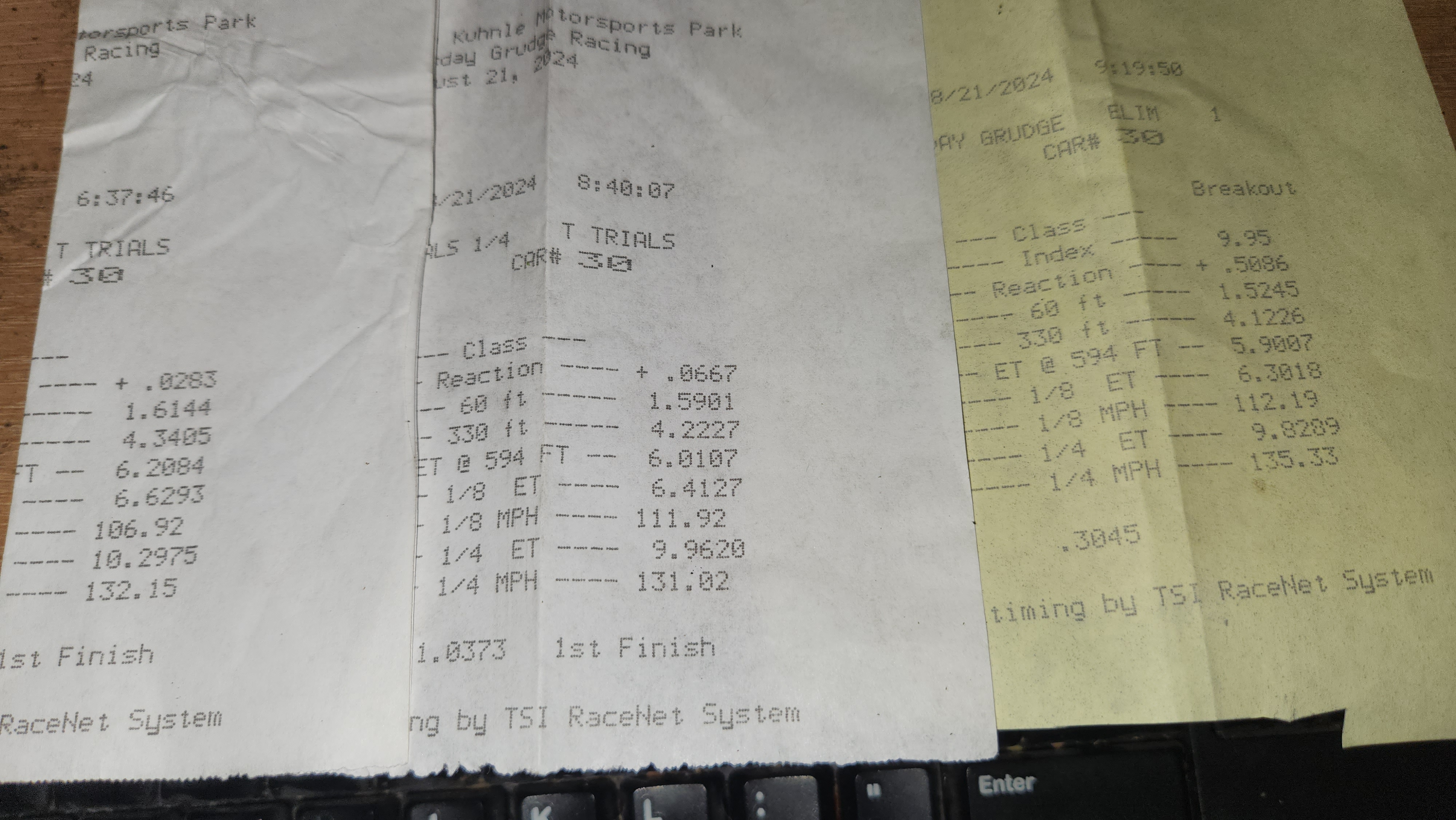

I'm in the 9s!!
Holy cow, I did it! I made 3 passes tonight, and only 1 was in the 10s. The other two were in the 9s!! And I drove it there and back. Soooo excited!

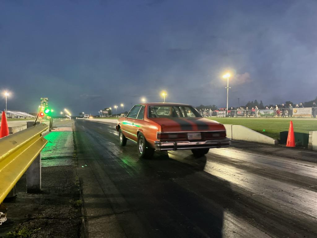

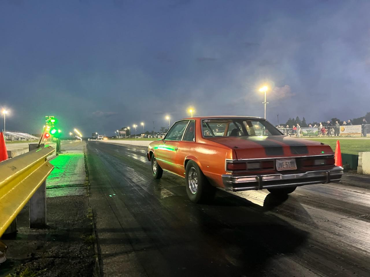

These pics were taken by Mike Trimboli on on the 9.96 pass, my first ever 9.
