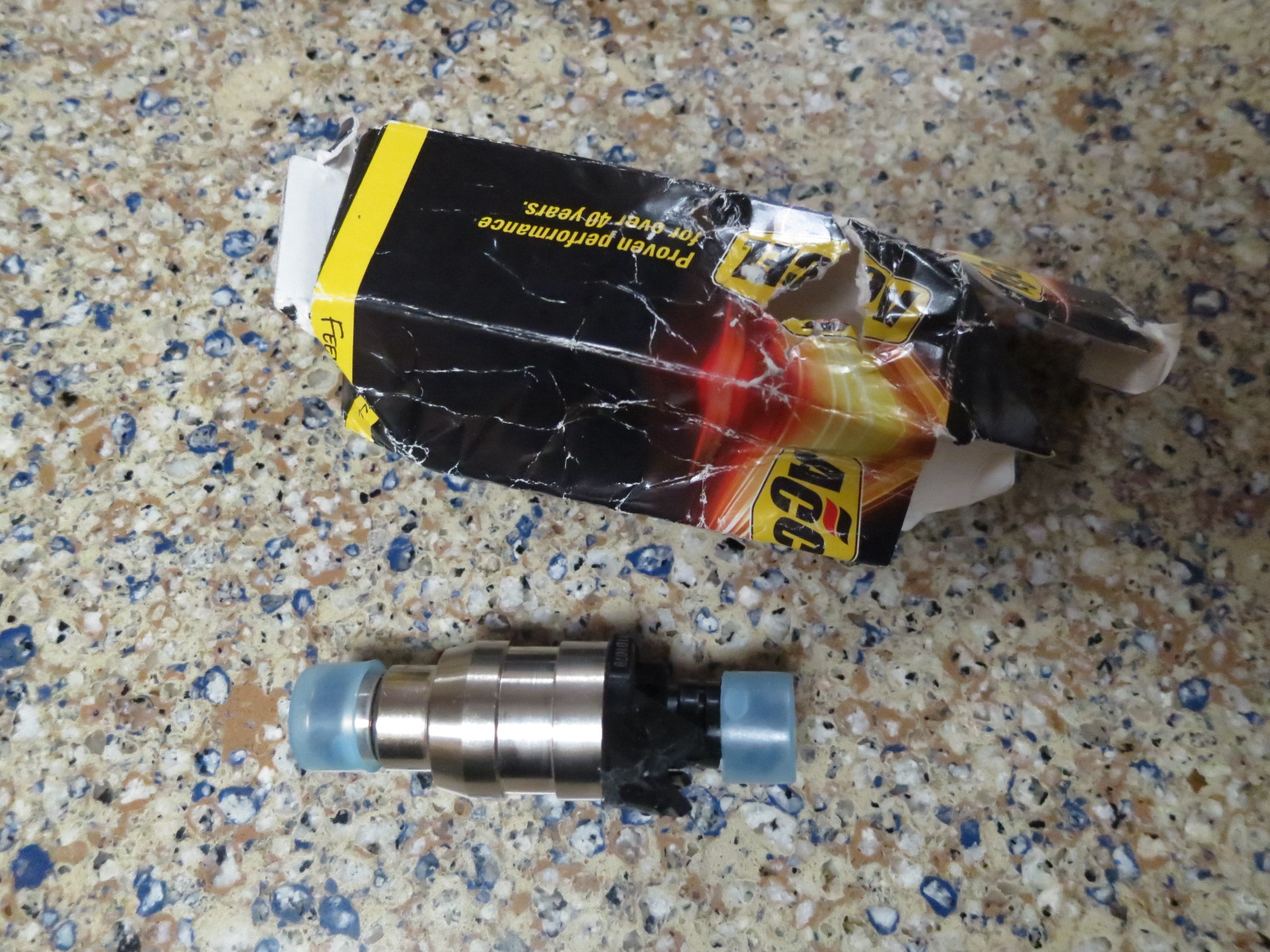

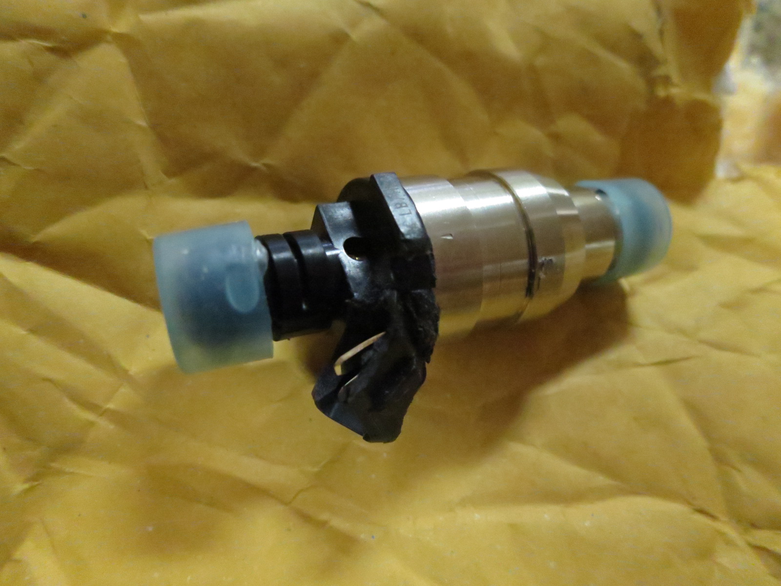

I did order a new injector from Holley to replace #6. This is how it arrived a few days ago via the USPS.
Posts: 3589
I ship a lot of stuff and IMO that's the packager's fault and not USPS. Even if a 40 lb box dropped on it, it never should have ended up looking like that if it was wrapped up correctly. This car just won't let anything go easily for you.
I agree with you, BP, up to a point. This injector was damaged to the point of smashing the plastic connector and actually taking nicks out of the steel body. It had to have been run over by something very heavy. I'm doubt the sender can pack to protect against that. Furthermore, Holley seems to be overwhelmed at this point in time. I reported this 5 days ago and haven't heard from them.

It actually occurred to me to take a small Dremel saw and cut away the damaged plastic connector parts and take a donor part from an old injector, superglue it on and see if I can get it to work.

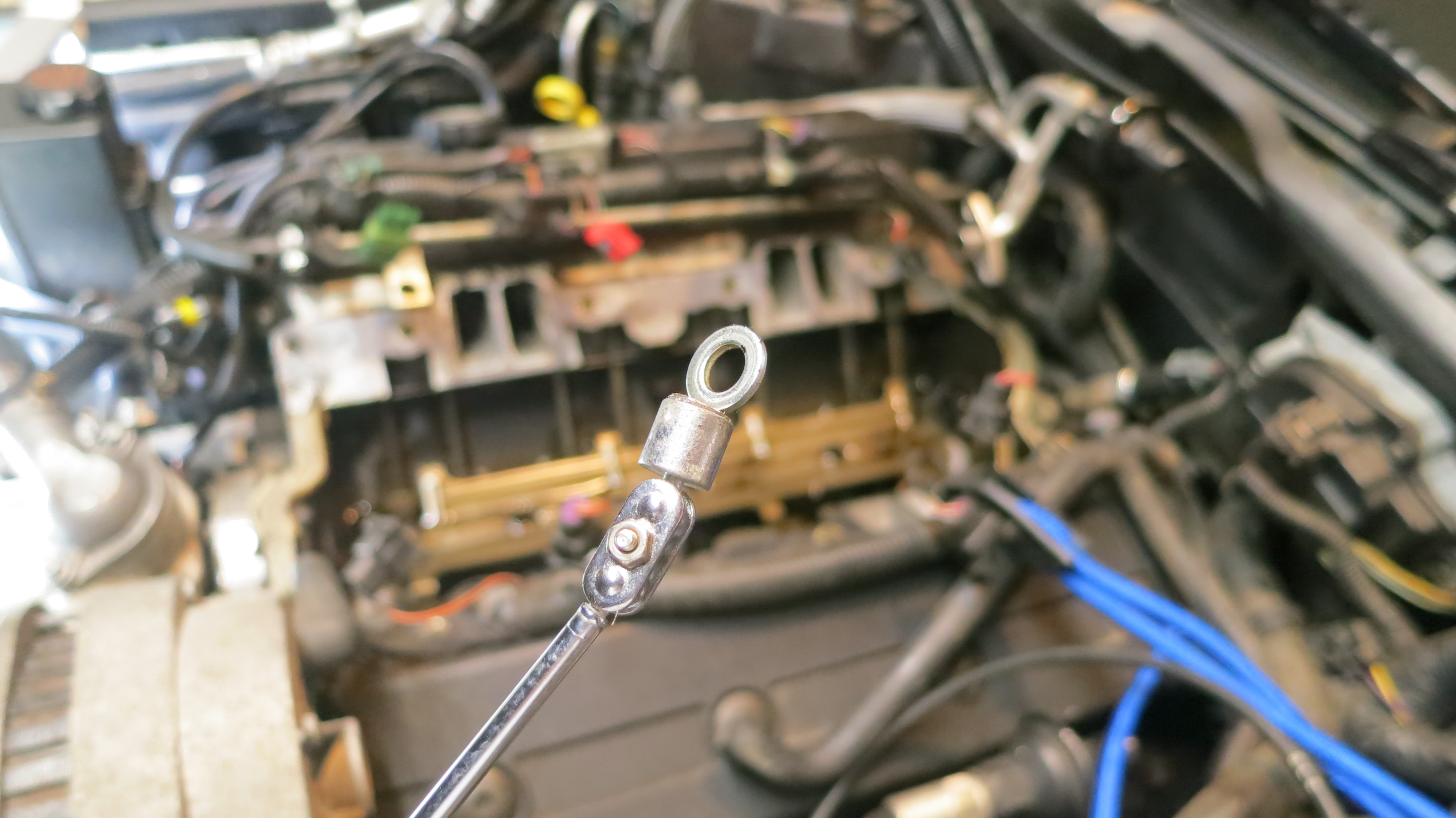

I took another opportunity to look for the lost washer. Maverick gave me a video camera and I stuck it down the suspect injector hole in the intake. To my surprise it was wet with gasoline when I pulled it out. I got out my MitiVac and sucked about a third of a cup of gas out. I'm still struggling with perspectives from the injector hole, and trying to understand where that gas was puddling. Anyway, I'll figure it out when I take the intake off.

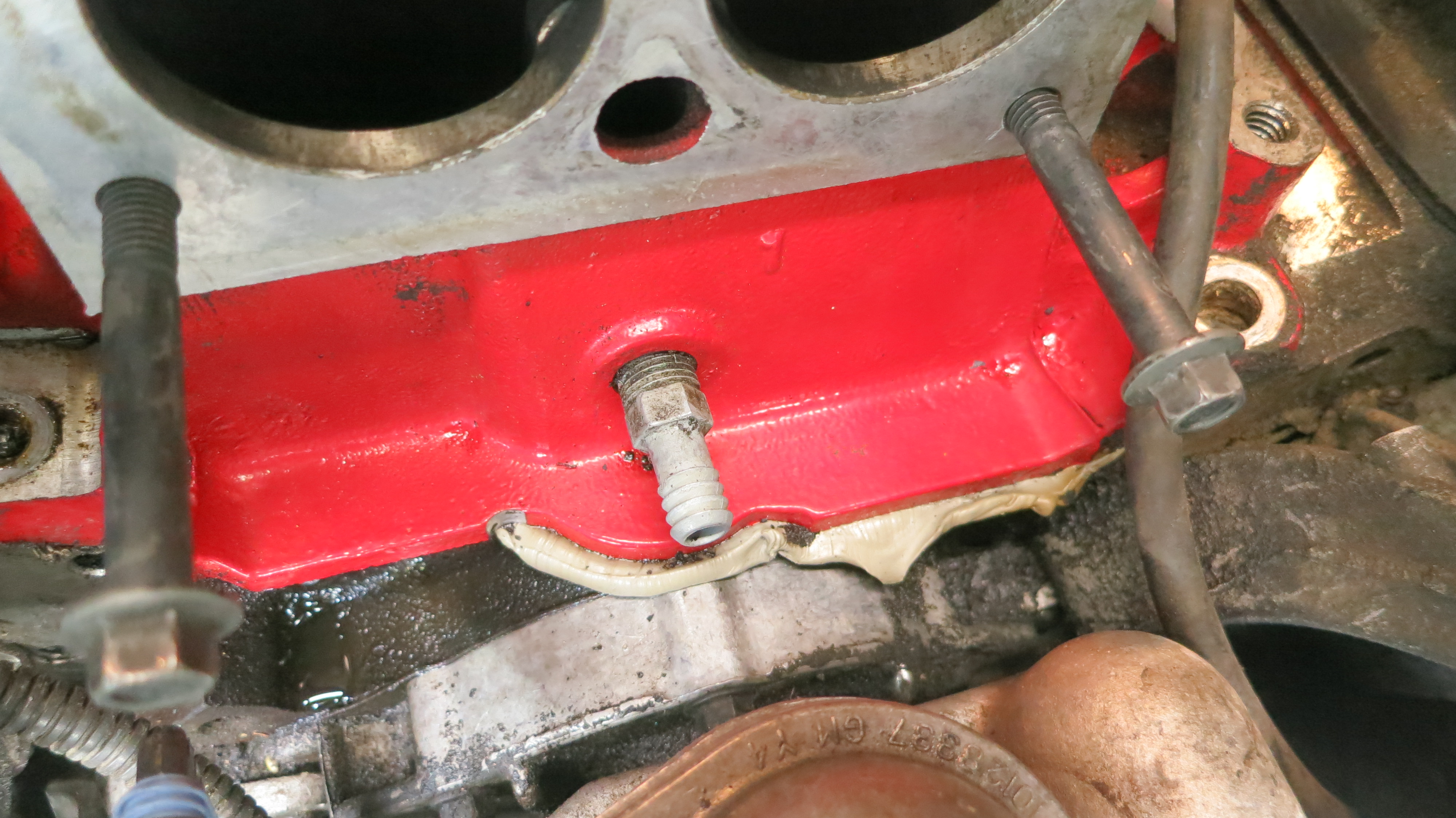

This doesn't look like a factory sealing job on the front of the intake.

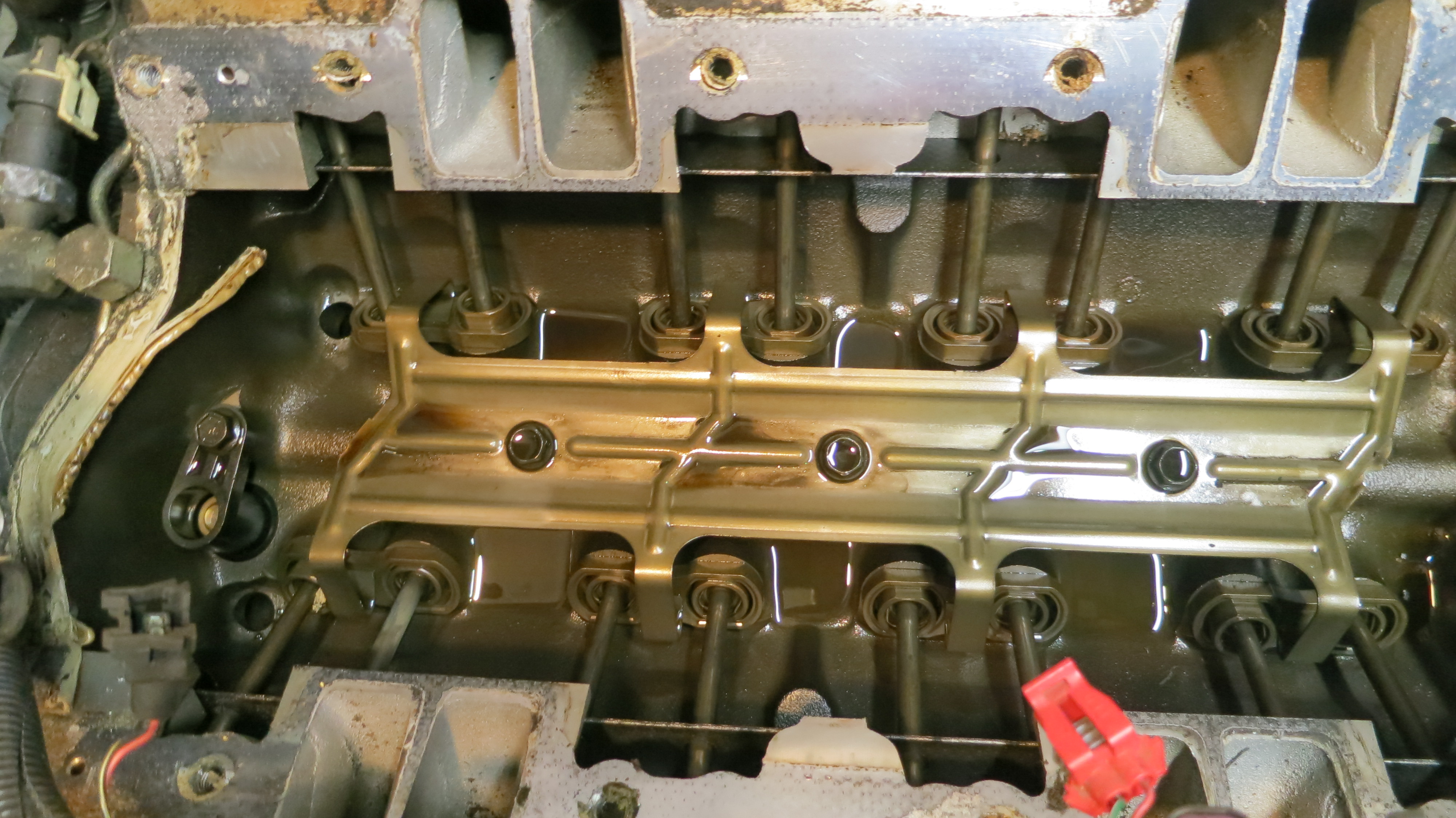

No surprises underneath the intake.
