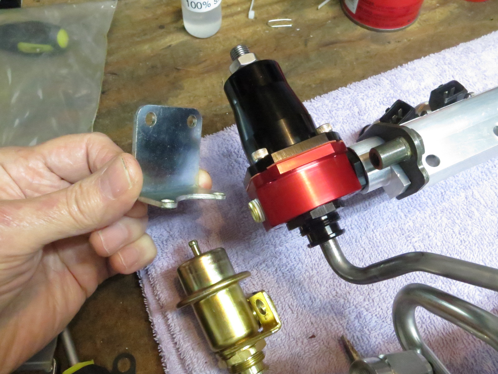

My new Aeromotive adjustable fuel pressure regulator arrived yesterday. It is the one I chose to replace the Holley with the ruptured diaphragm.
It, like the Holley, is advertised to mount to the fuel pressure rail on the Vette. Well, it has the right fittings to connect into the rail, but nothing to hold it in place. The supplied attachment bracket has no resemblance to what is needed to secure the regulator in place. I need to make my own bracket. Does it ever end?
UPDATE: 12/13 I called Aeromotive tech support and he put the blame on Amazon for the wrong bracket, but agreed to ship me the correct one.
Update: 12/15 Correct bracket arrived via UPS

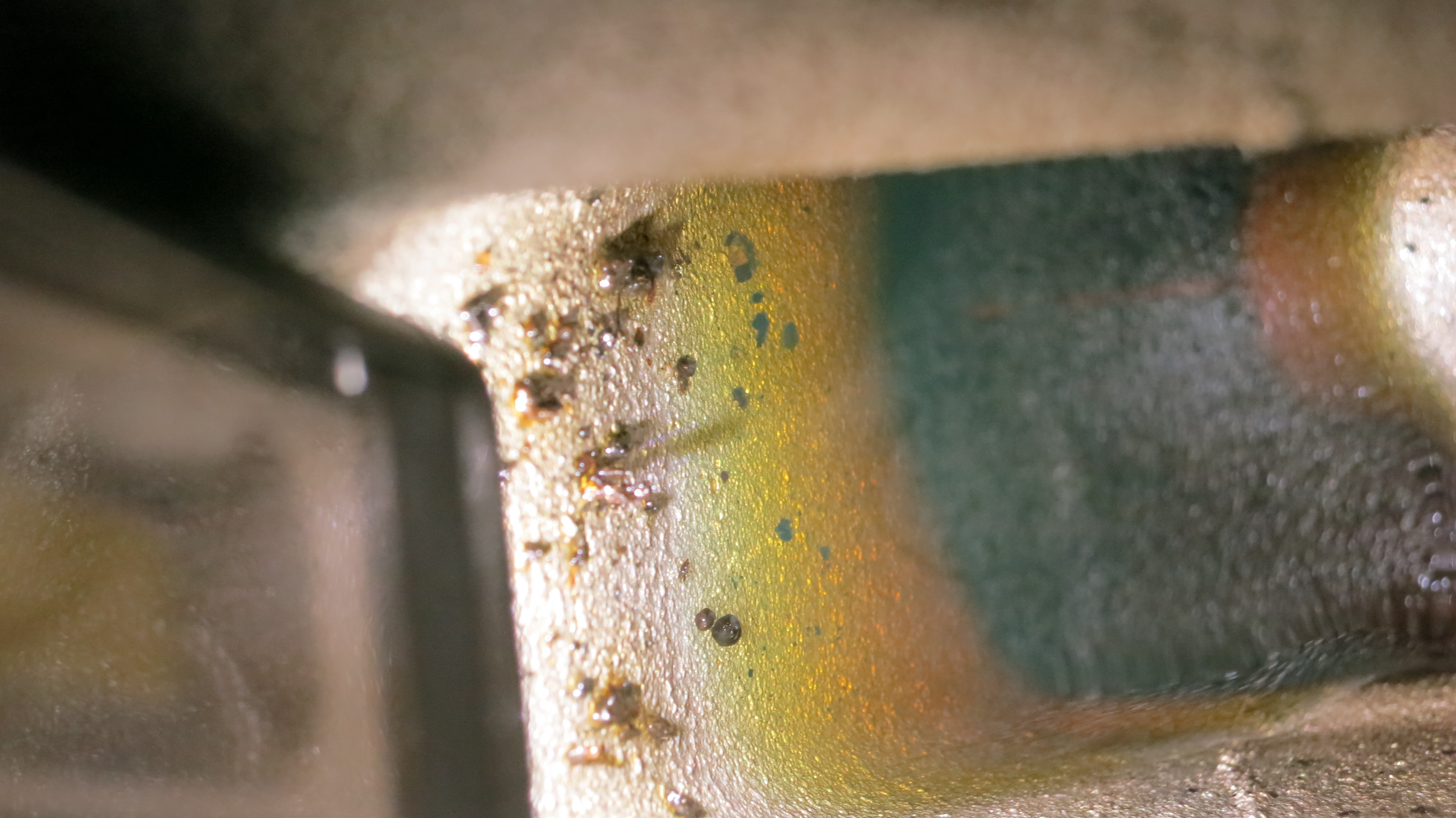

I took another opportunity to look for the lost washer. Maverick gave me a video camera and I stuck it down the suspect injector hole in the intake. To my surprise it was wet with gasoline when I pulled it out. I got out my MitiVac and sucked about a third of a cup of gas out. I'm still struggling with perspectives from the injector hole, and trying to understand where that gas was puddling. Anyway, I'll figure it out when I take the intake off.
It once was lost, but now it's found!
I got back to work on my pride & joy today and found the lost washer. It was sitting next to the valve on #8 cylinder head intake floor. It was poised to go into the combustion chamber the next time the valve opens. This is the the place where I sucked out 1/3 cup of gas a couple of weeks ago.
Today, with my MitiVAc, I removed pools of gas from several other cylinders. Another potential opportunity for hydro-lock while trying to start the engine?
