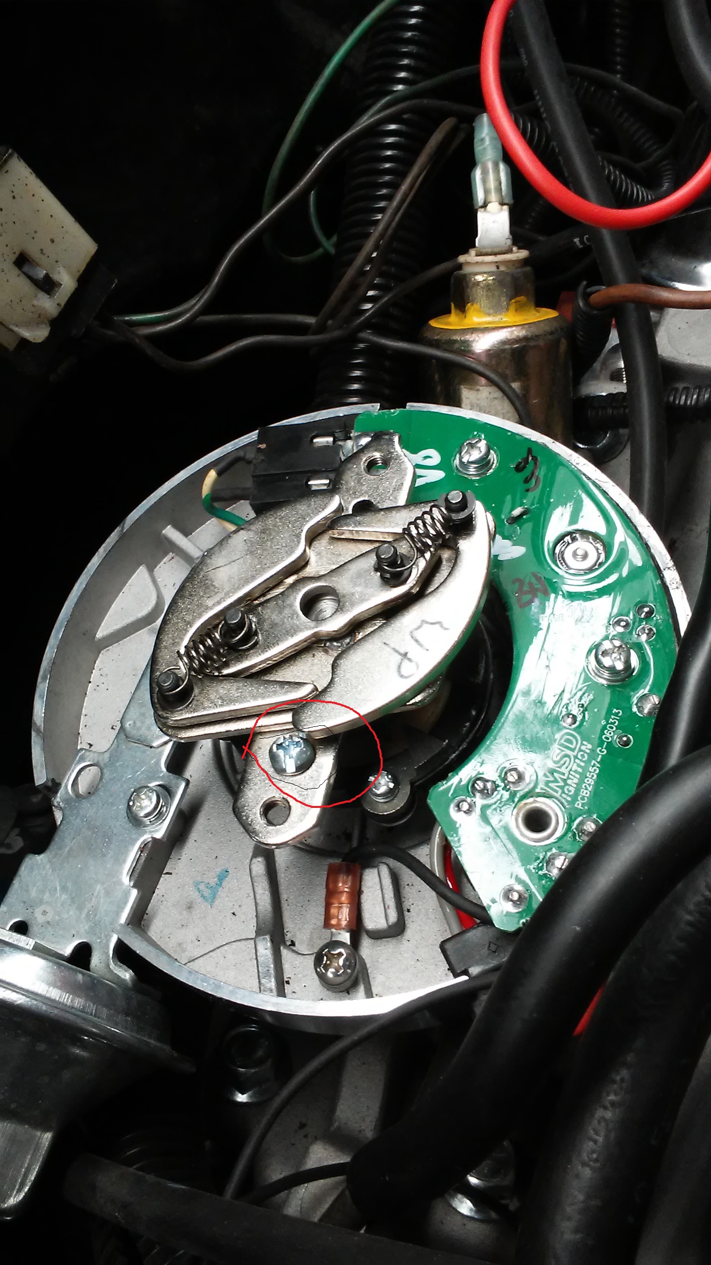

This might get me admitted to the Cheap Bastages club it if works. Need to limit the mechanical advance to keep total in check with as much initial as the 383 seems to need. A 10-32 screw fits nicely in the holes on the plate and limits the weight travel. One side of the screw head is ground down to the diameter of the thread and a cam shape goes around to the original diameter on the opposite side of the screw head to provide for adjustments. A nut under the plate secures the stop cam. There's room for a lock nut on the screw that will be added when adjustment is final. Some clearancing of the rotor may be required to fit over the screw head.
First try will have the stop set for maximum travel.
Tomorrow, when the neighborhood is at work and school, I'll see what that does for total advance.

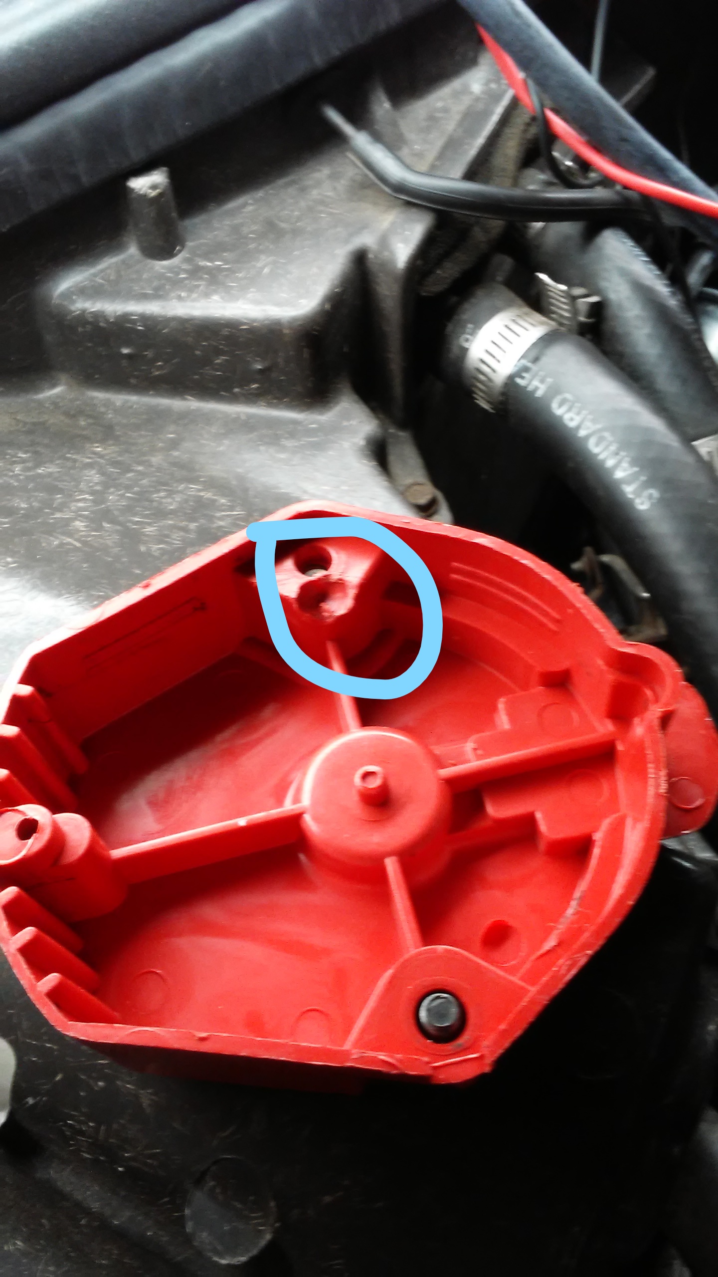

Clearanced the rotor for the new stop screw.
Initial timing was only set at 9* BTDC and total was 30* with the new stop screw set to allow new max advance. Moved initial to 11* BTDC and total was 32*. Close enough for government work.

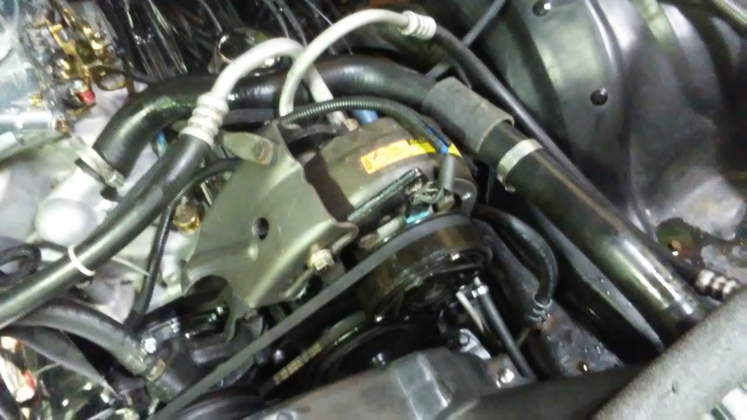

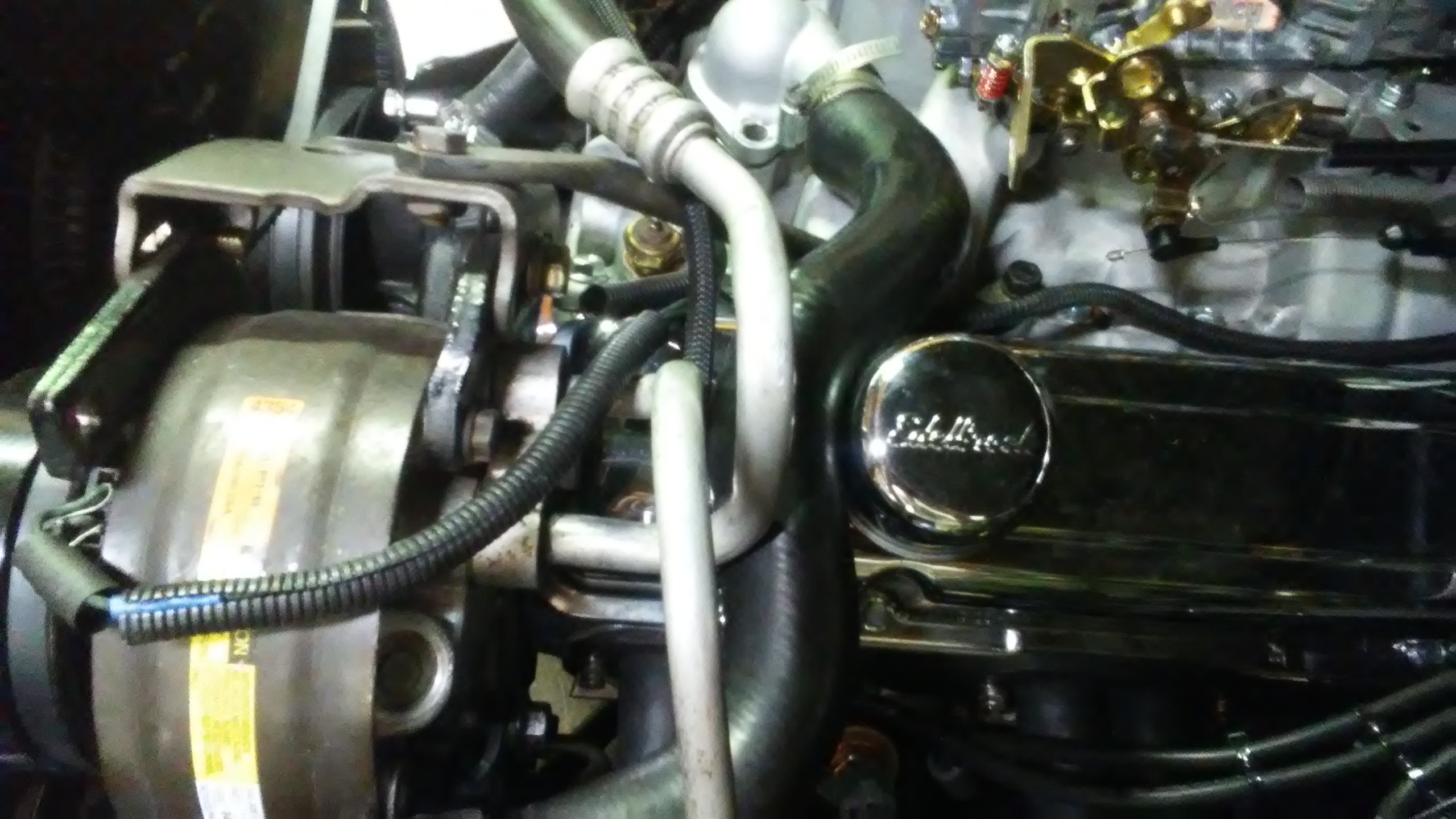

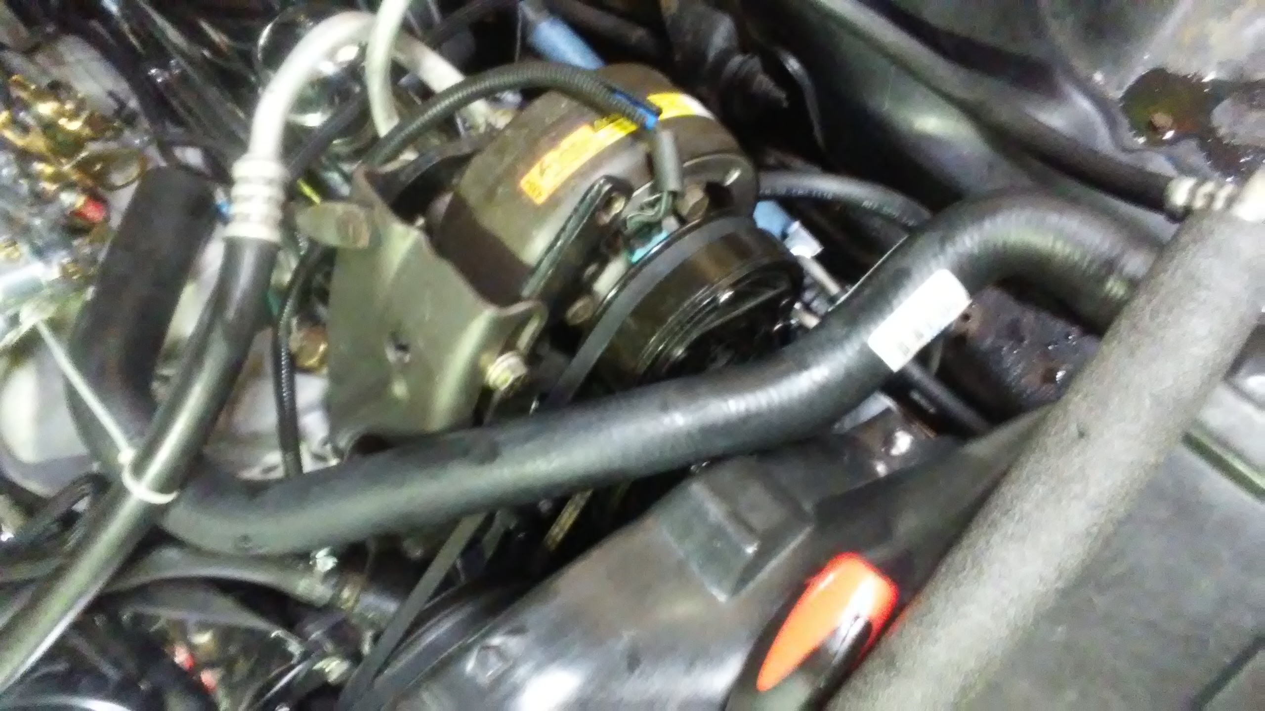

Got the Holley AC idle solenoid but when I tried to put it in it's place, the upper radiator hose was in the way. I never liked that hose anyway. It runs sideways from the thermostat housing over the valve cover, squeezed in between the AC compressor and the oil fill cap.
Before:
A guy on the El Camino forum suggested a hose ("It is an upper hose for a 1990 Suburban 1500. Carquest E71973") that goes forward from the thermostat housing. Fortunately, I already had a swivel housing to point the hose forward.
After:
That picture shows the hose before about 8" was cut off the engine end to make it work.
With the new radiator hose, the AC idle solenoid goes on.
The solenoid was adjusted so, idling in gear, no RPMs are lost when the AC cycles. 8)

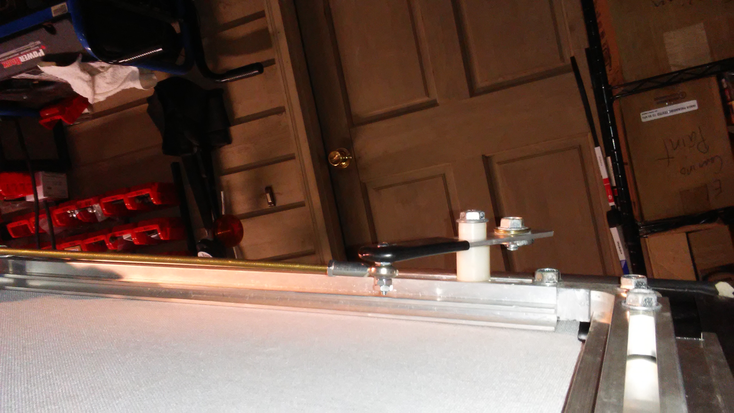

Got the electric releases installed for the tonneau cover. Picked up two generic door lock solenoids from ebay for $10 shipped. Set them up to pull the levers on each side to release the cover.
Previously, the tonneau cover was opened with a strap hanging over the tail gate that pulled the tail gate release lever on the inside of the tail gate to get access to the levers that held the cover down. Didn't like the strap hanging out.
10-32 threaded brass rods with helm joints on the ends connect the solenoids with the levers.
Works great. New tips for the soldering gun will arrive tomorrow so I can finish the wiring and mount the push button behind the driver's seat.

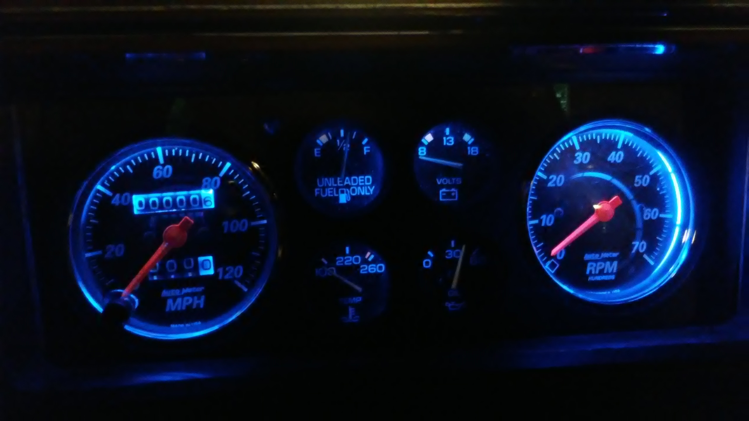

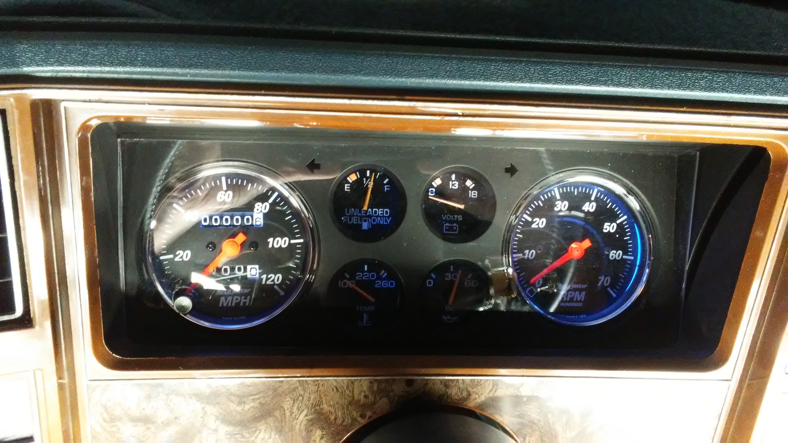

Got the Autometer tach and speedometer installed to replace the non-working clock and broken speedometer. The 3 1/8" gauges fit nicely where the original gauges were. Also installed blue LED gauge lights. Pictures aren't great because of reflection off the lens but it all looks pretty good.
Haven't tested the speedometer yet but everything else works. Custom cable fit well. The contacts for the ammeter were cleaned and treated with conducting grease. Loose copper ribbons at the gauge connector were glued down with conducting glue. Volt meter is reading accurately for the first time.
Its drivable again. :D
