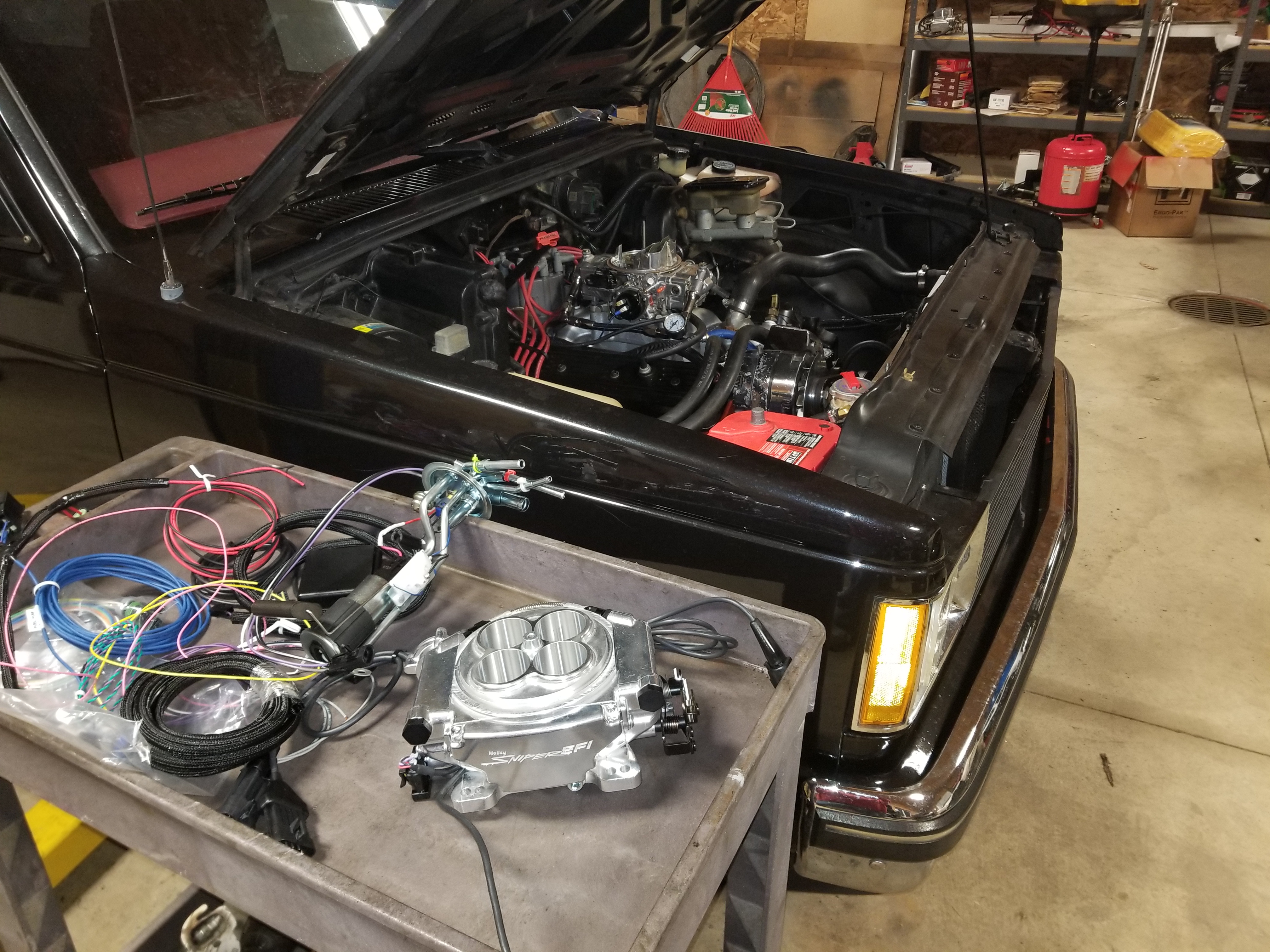

I finally pulled the trigger and am converting to EFI. I've done two Megasquirt installs, but this time around I wanted to try the Holley Sniper setup. It's a self-learning computer (a neural net processor!!) that will bolt right in place of a 4bbl. It's very self-contained.

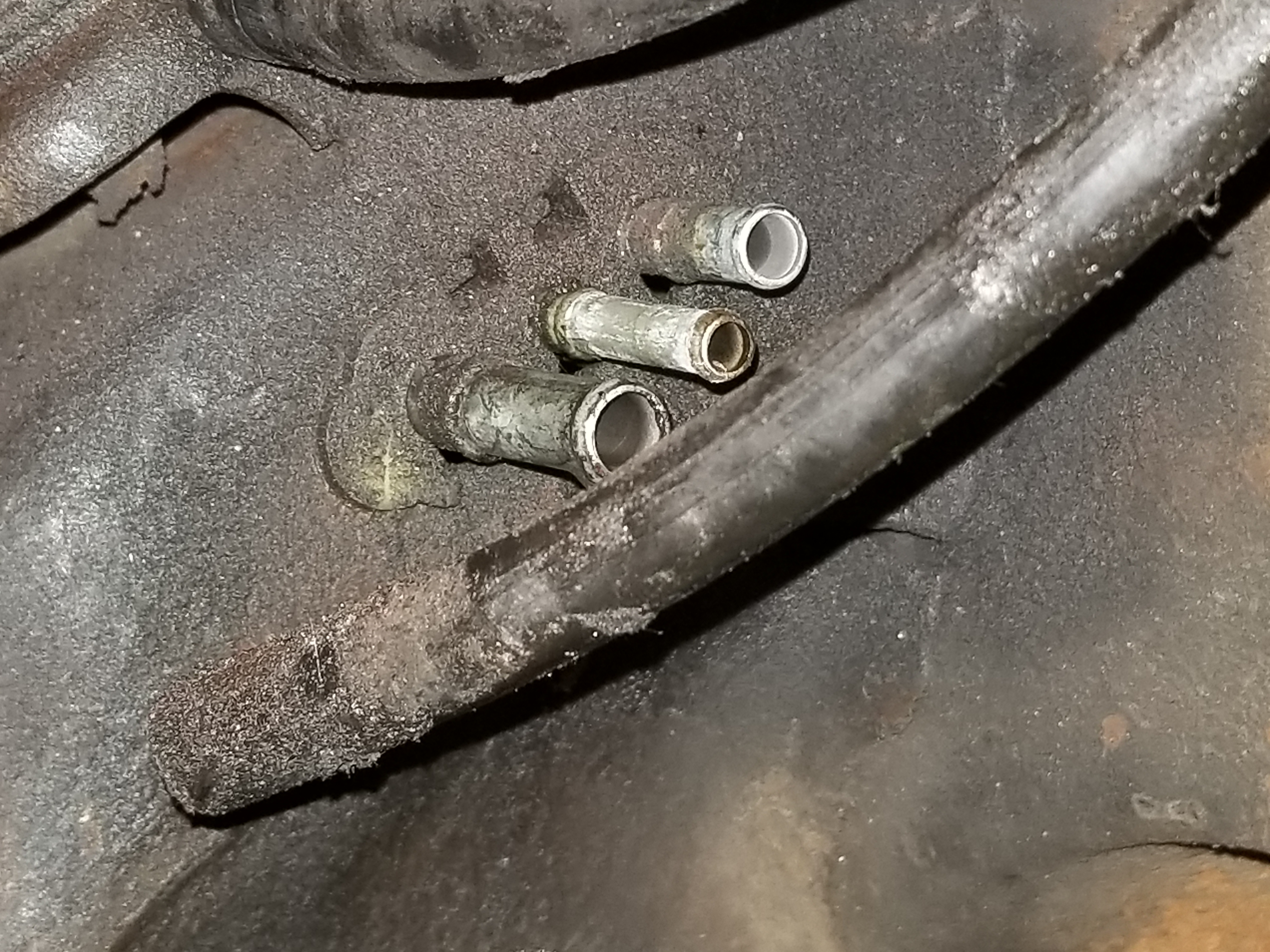

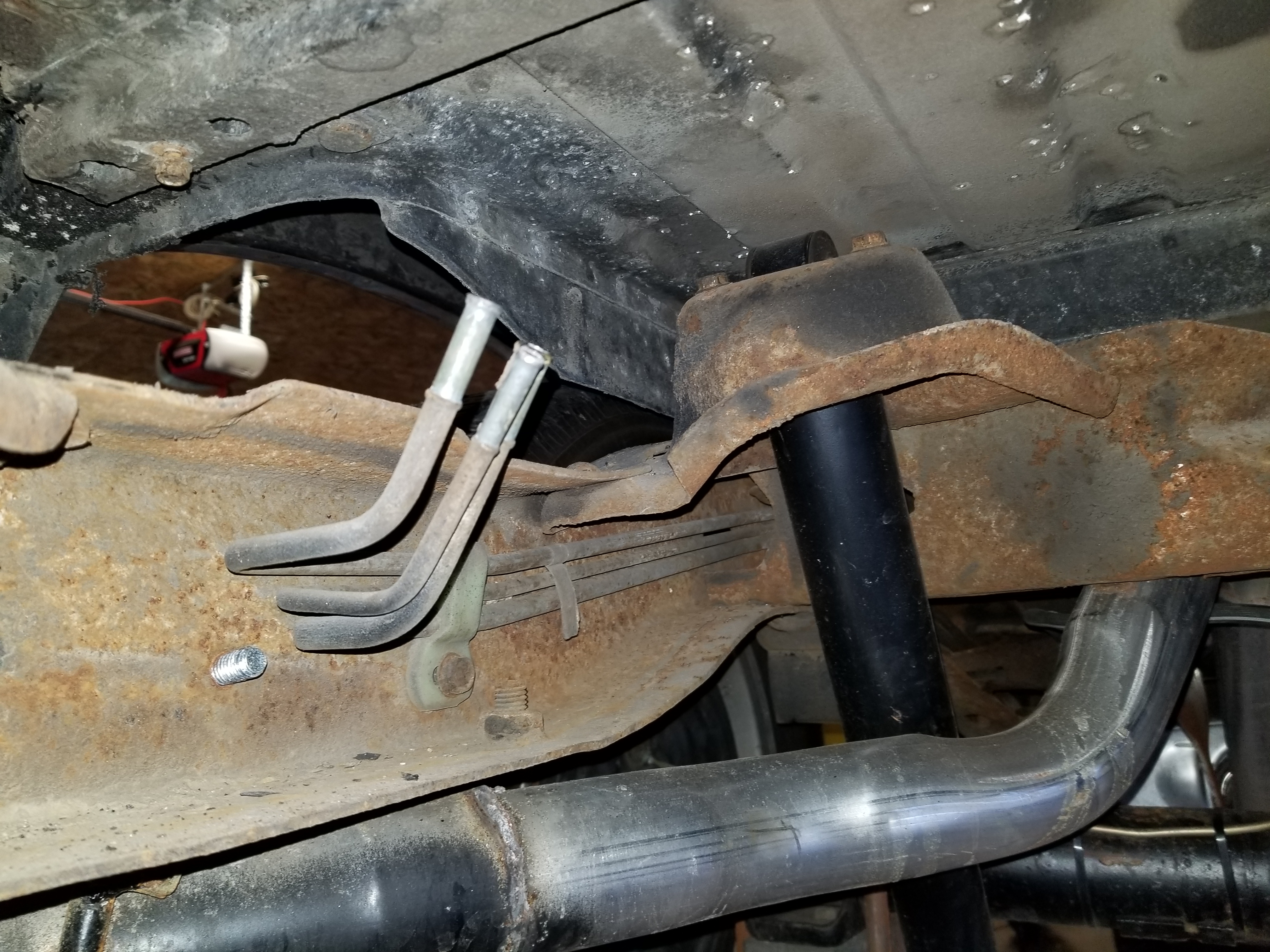

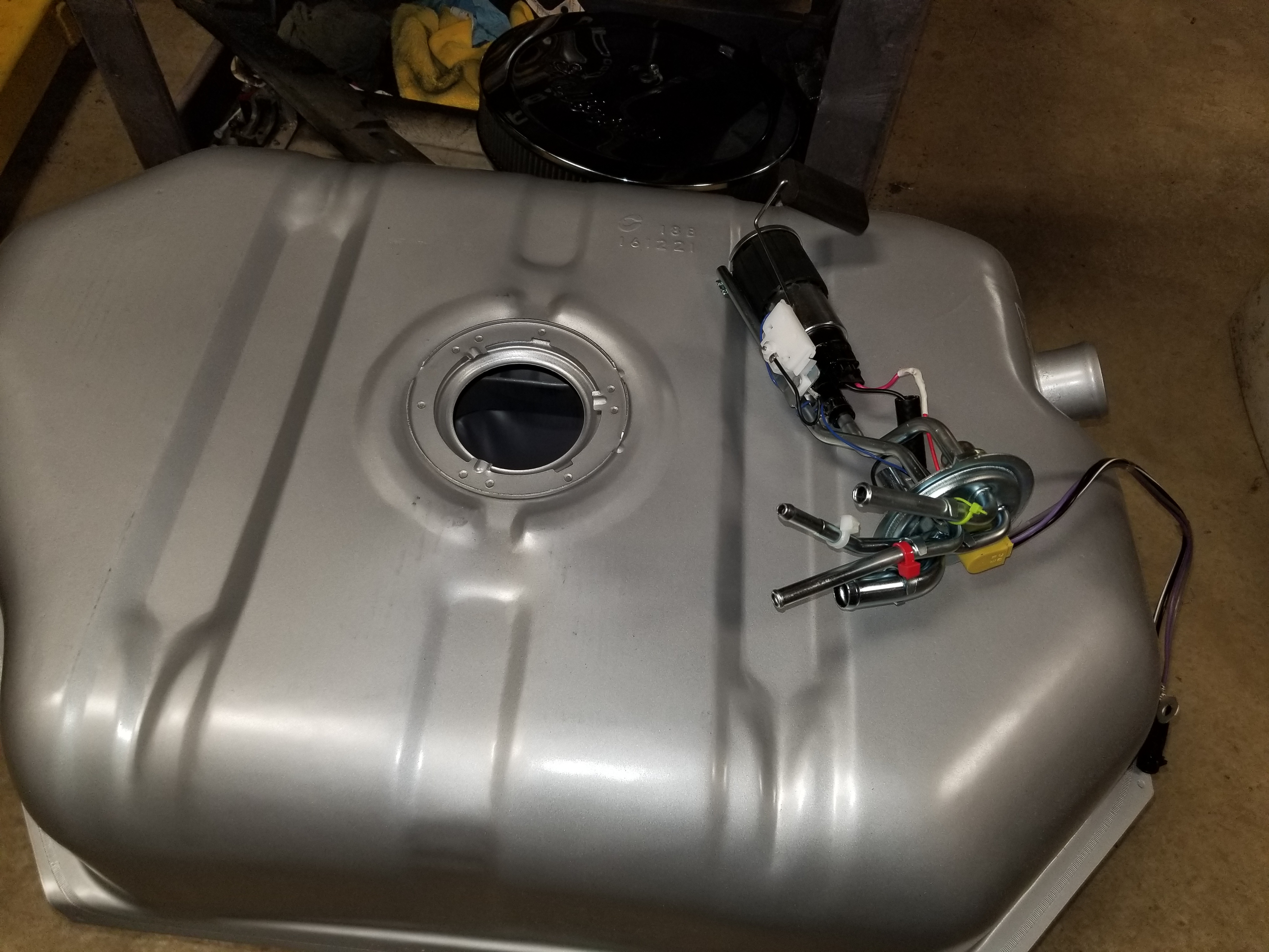

First step was pulling the old tank. I had every intention of just putting a new sending unit/fuel pump into the existing tank, until I got it out. I don't know if that's undercoating or silicone or what, but I can't even make out where the locking ring is. A new tank was only $75 shipped, and it looks like a decent quality piece.
The factory hard lines are in excellent condition, and I will re-use them. The feed line is 3/8" and the return is 5/16". 1/4" is just a vent, I assume.
