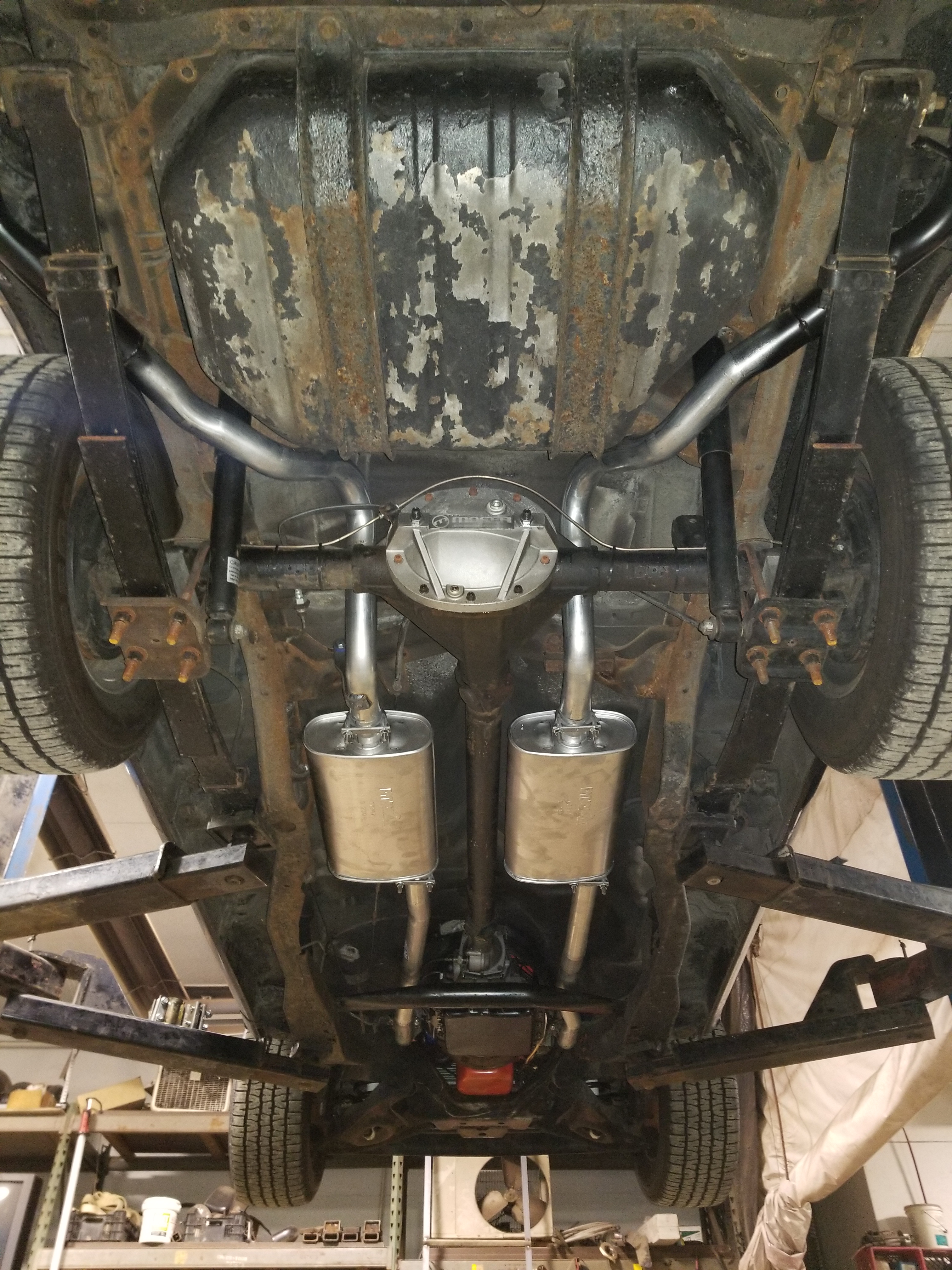

The good news is that I finally got the exhaust fixed. It was too loud, it squeaked and rattled, had a couple leaks, and was just overall pretty lousy. I made an appointment with Paul Carson and he was able to knock it out this weekend. He basically redid the whole system, installed some flanges near the trans bellhousing which will make it much easier if I ever need to take it apart again, new large-case Dynomax mufflers (p/n 17747) and new tailpipes that exit out the back instead of to the side. WOW, what an improvement. It's nice and quiet inside. Probably erred on the quiet side, but I'm totally fine with that. Paul did some really nice work.

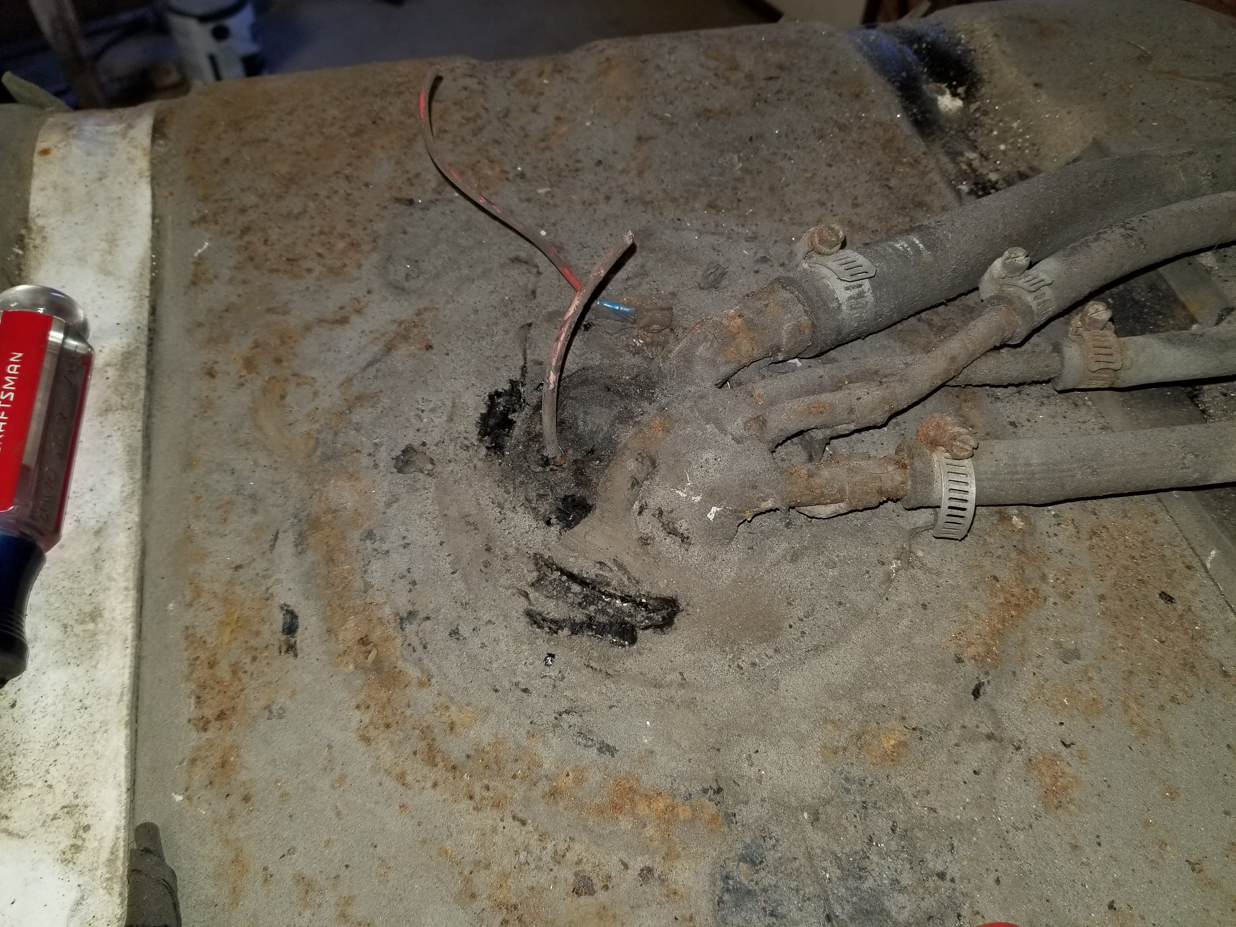

First step was pulling the old tank. I had every intention of just putting a new sending unit/fuel pump into the existing tank, until I got it out. I don't know if that's undercoating or silicone or what, but I can't even make out where the locking ring is. A new tank was only $75 shipped, and it looks like a decent quality piece.

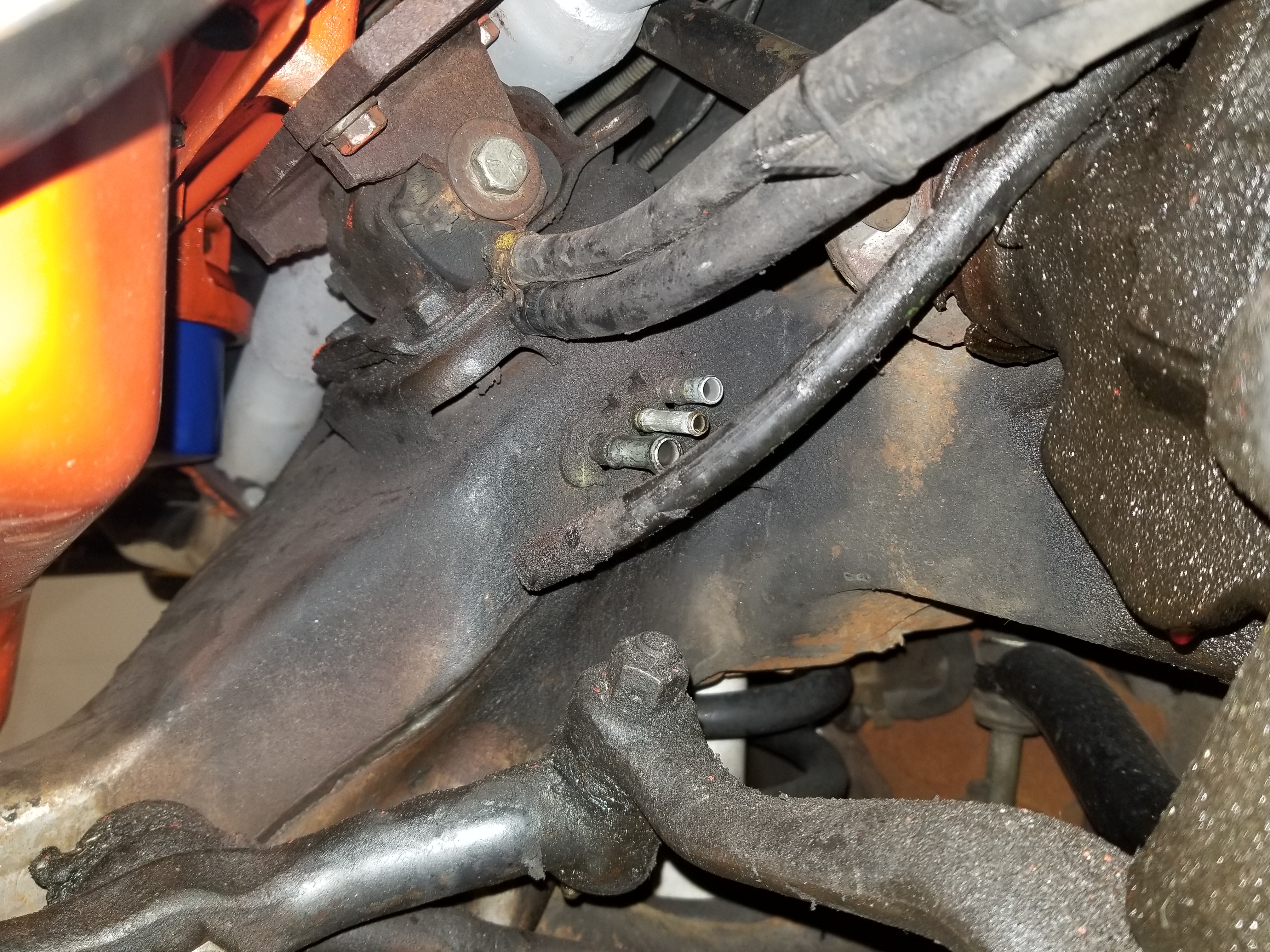

The factory hard lines are in excellent condition, and I will re-use them. The feed line is 3/8" and the return is 5/16". 1/4" is just a vent, I assume.
