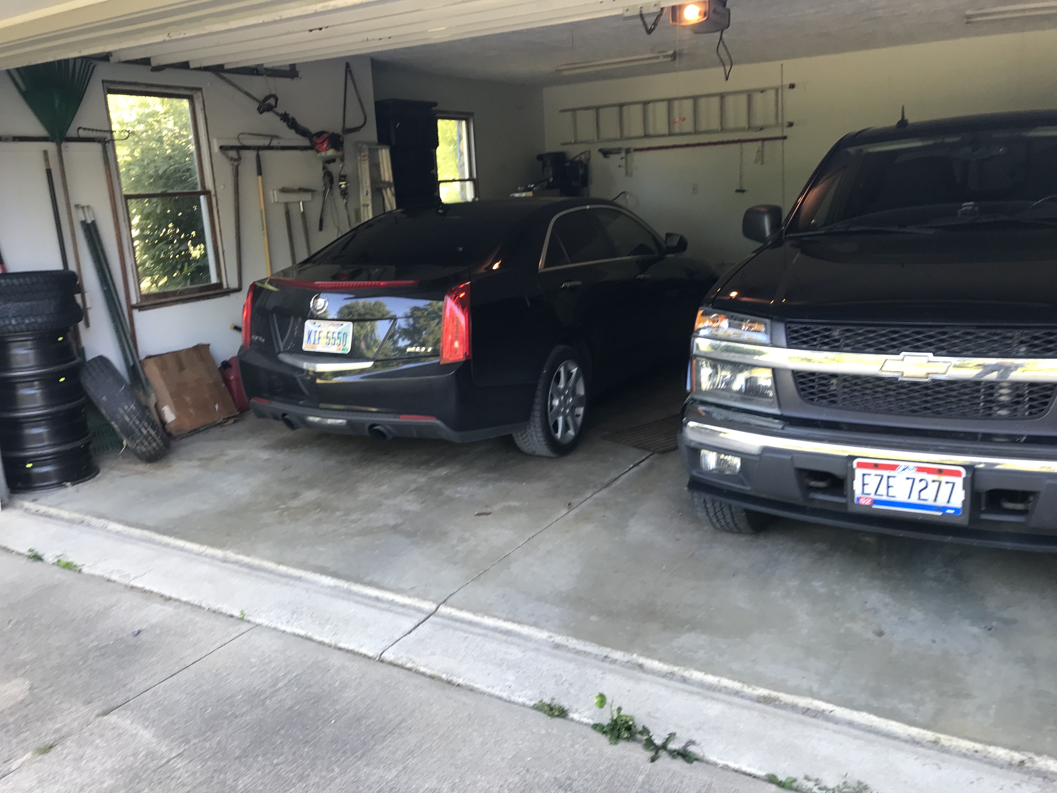

Few little updates:
- removed some annoying stickers from the windshield

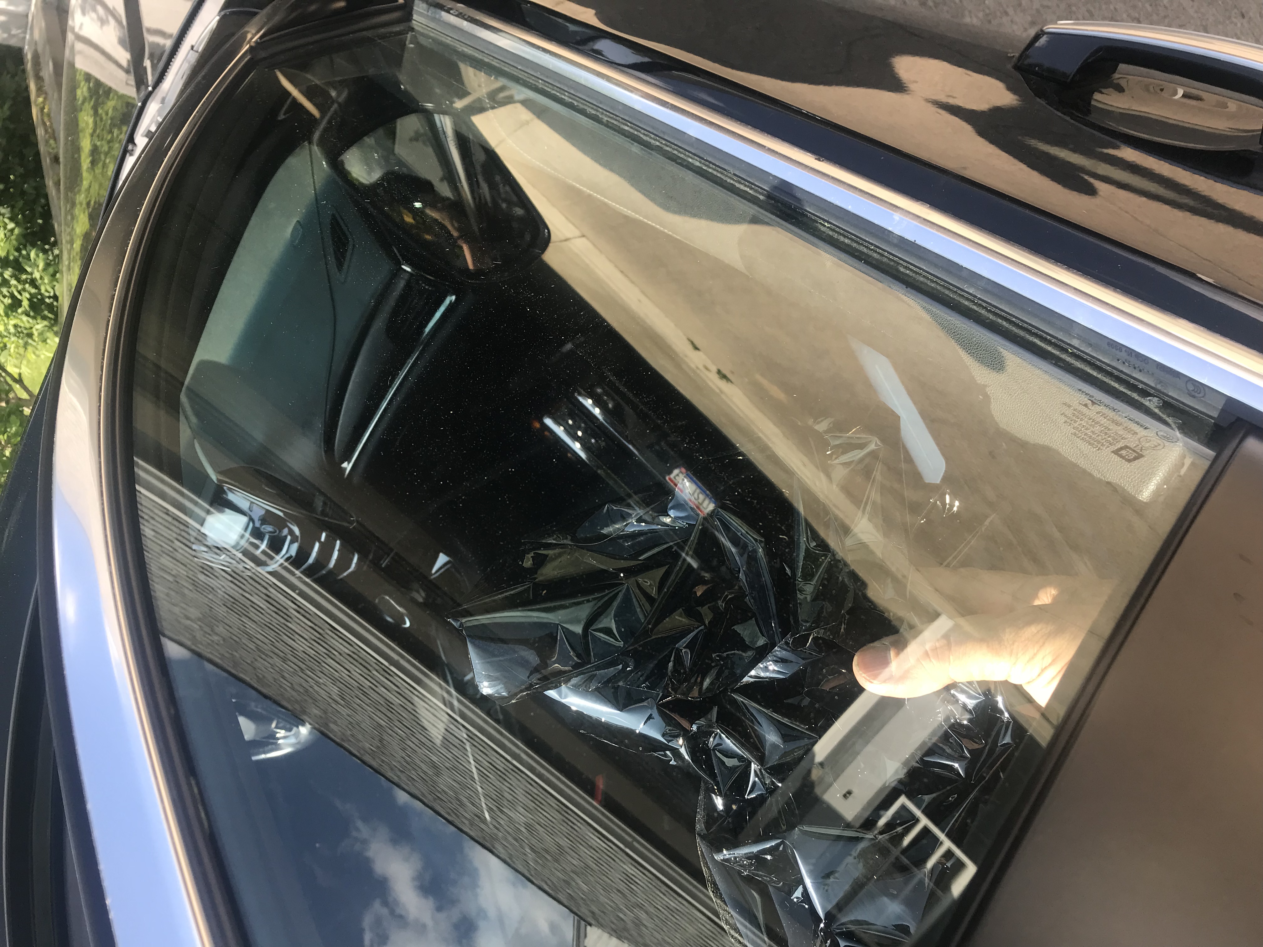

- removed the window tint from the front windows. Put it out in the sun and the tint peeled right off not leaving any glue behind
- put the rear head rests down for better visibility. So easy
- set the clock. So easy
- car went to emissions testing and passed
- today it got regular license plates

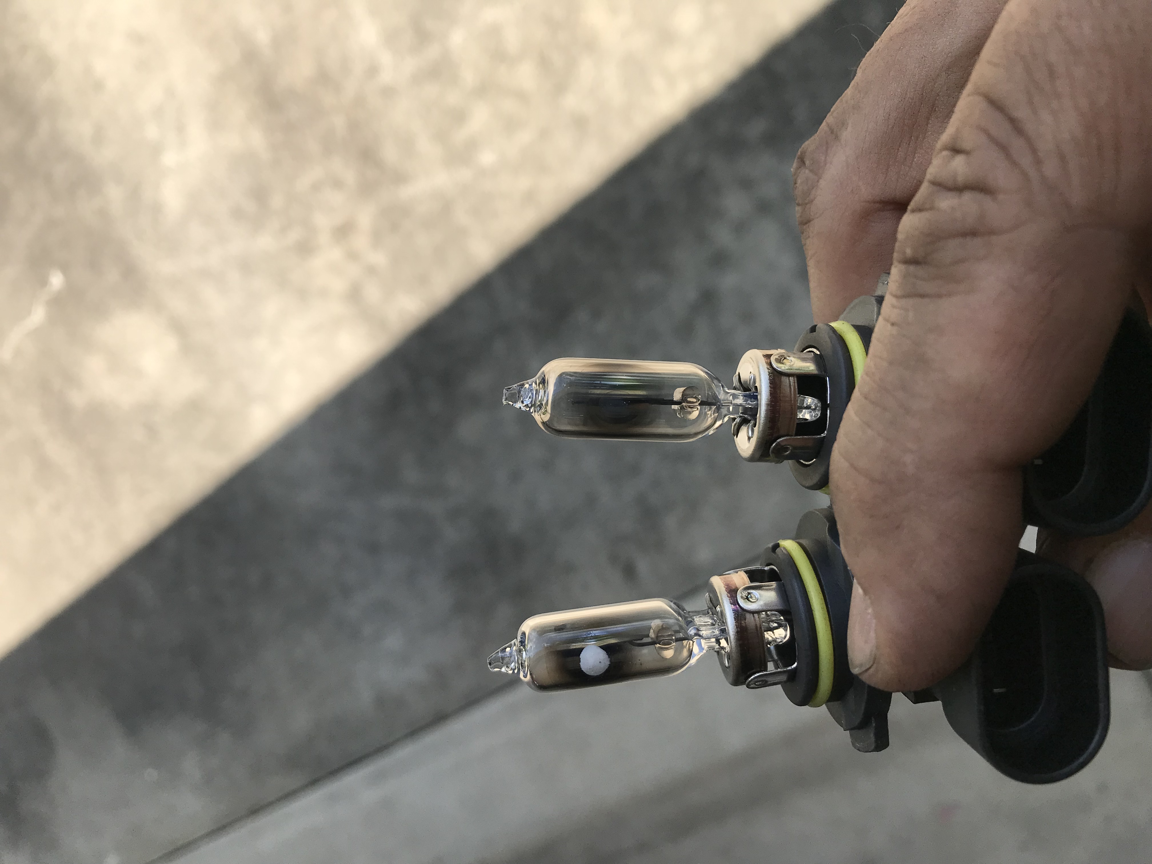

Replaced the headlight bulbs. Turns out it had NAPA bulbs that didn’t look too good. Have to change them by pulling back the inner fender

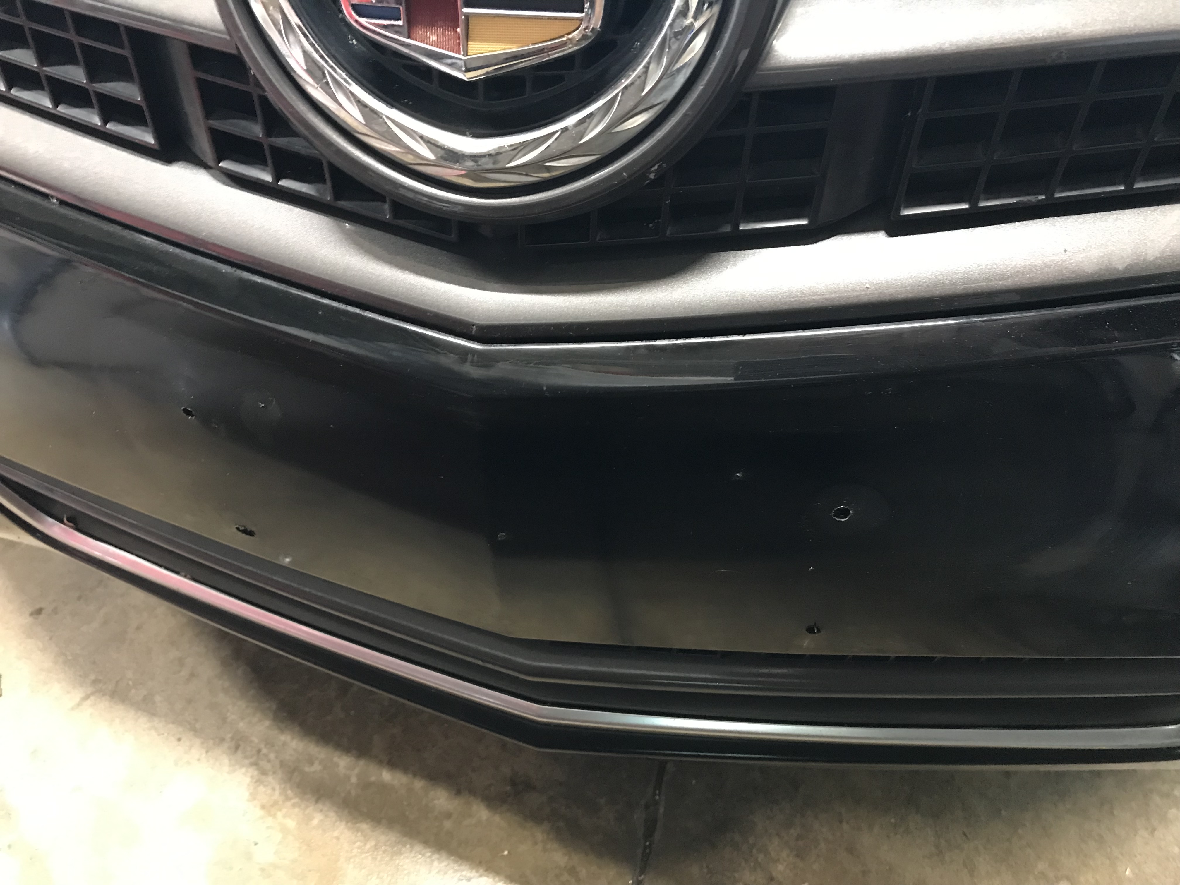

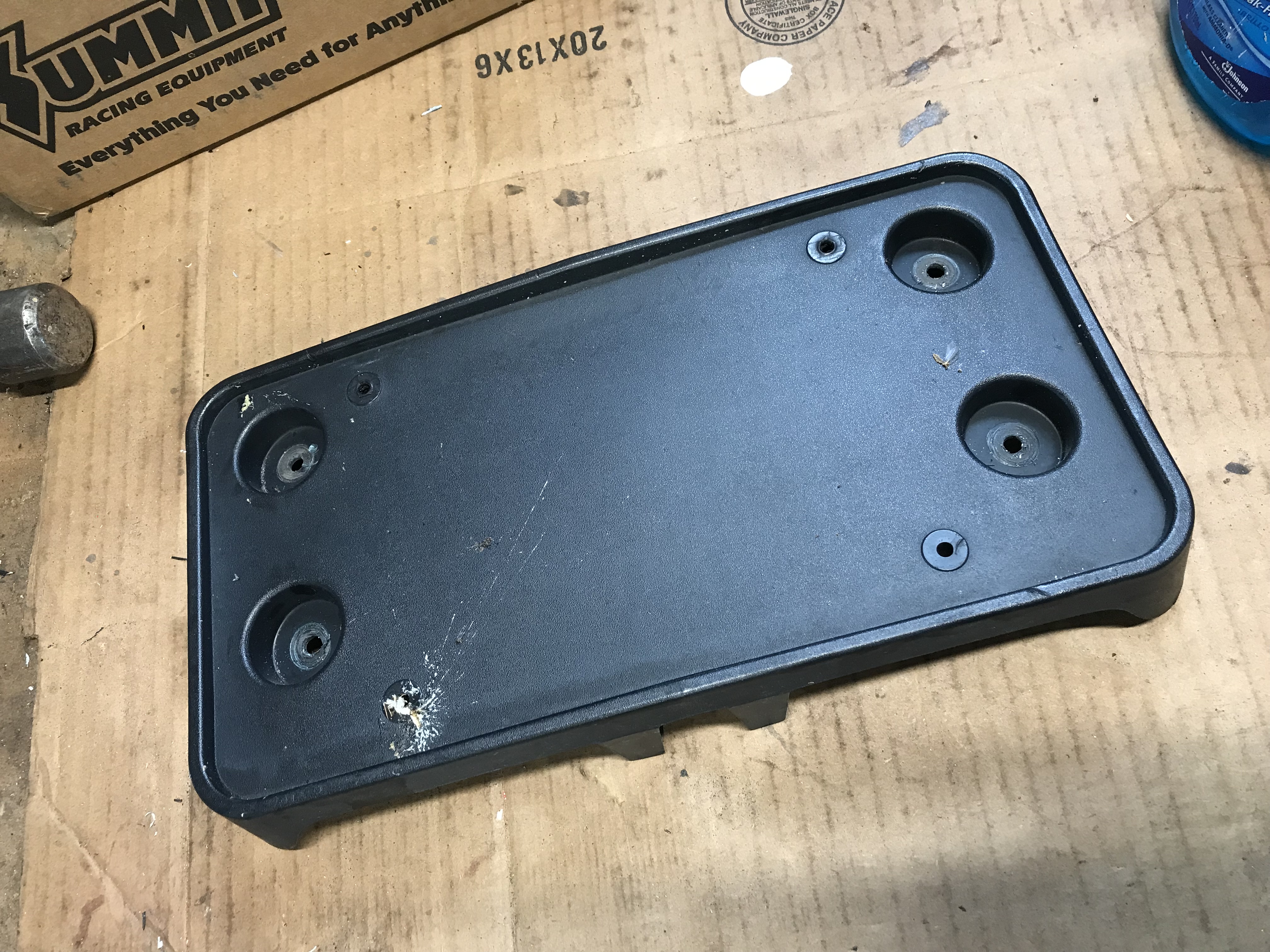

Also removed the front license plate frame and got a license plate.

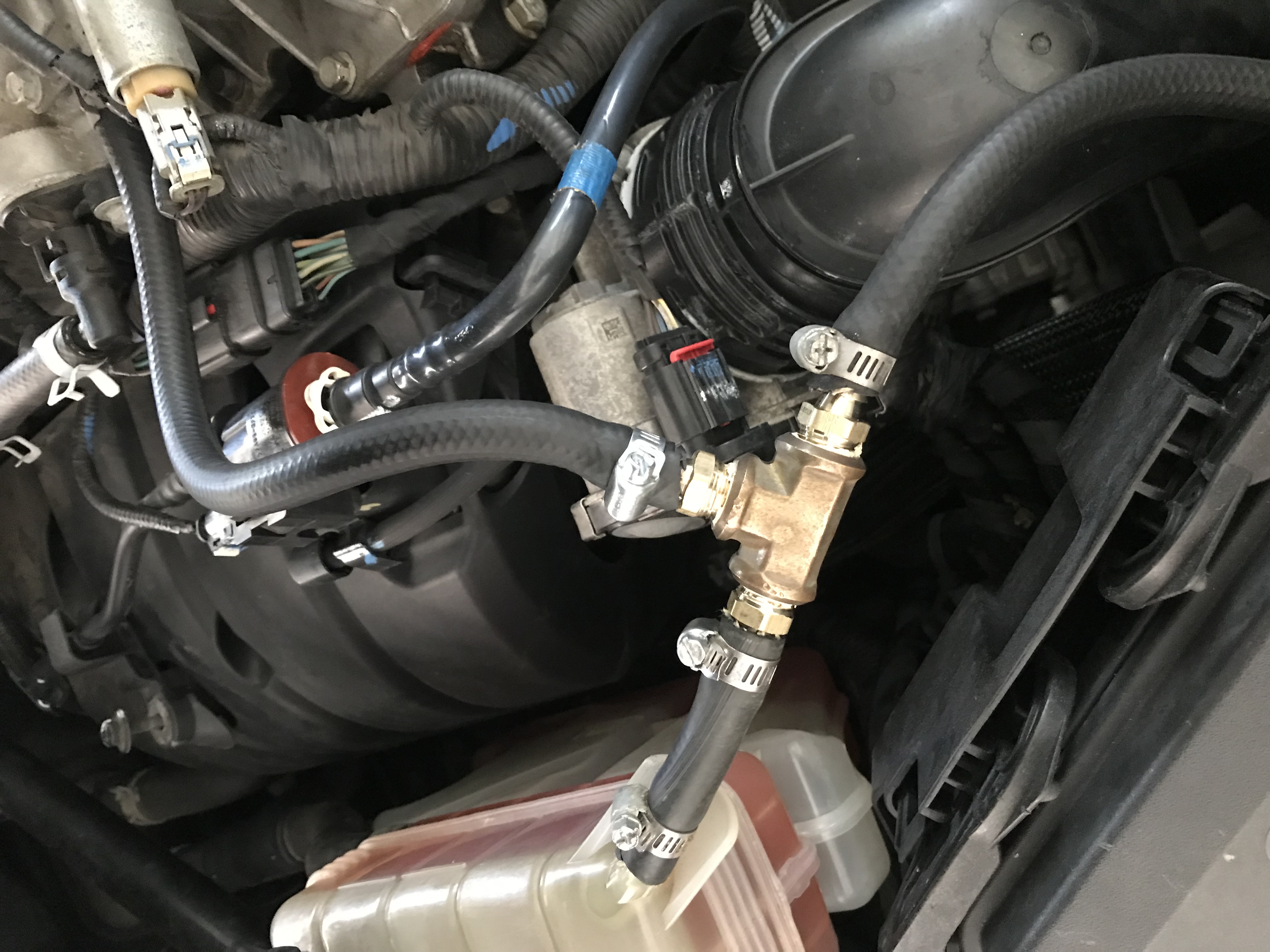

Plastic tee in the cooling system failed. The first time the hose slid off I didn't realize it was broken at the barb. This is already a replacement vs the factory piece (its a Y) so I decided to fix it with a brass tee. The back of the rear seat is unbolted so I can remove it when I need to carry long things. It's a bit of a hassle but it'll do until I can find a fold down rear seat.
Also, it is now rare that the car leaks oil. I don't have the pattern yet but I think if I keep driving it it won't leak.
