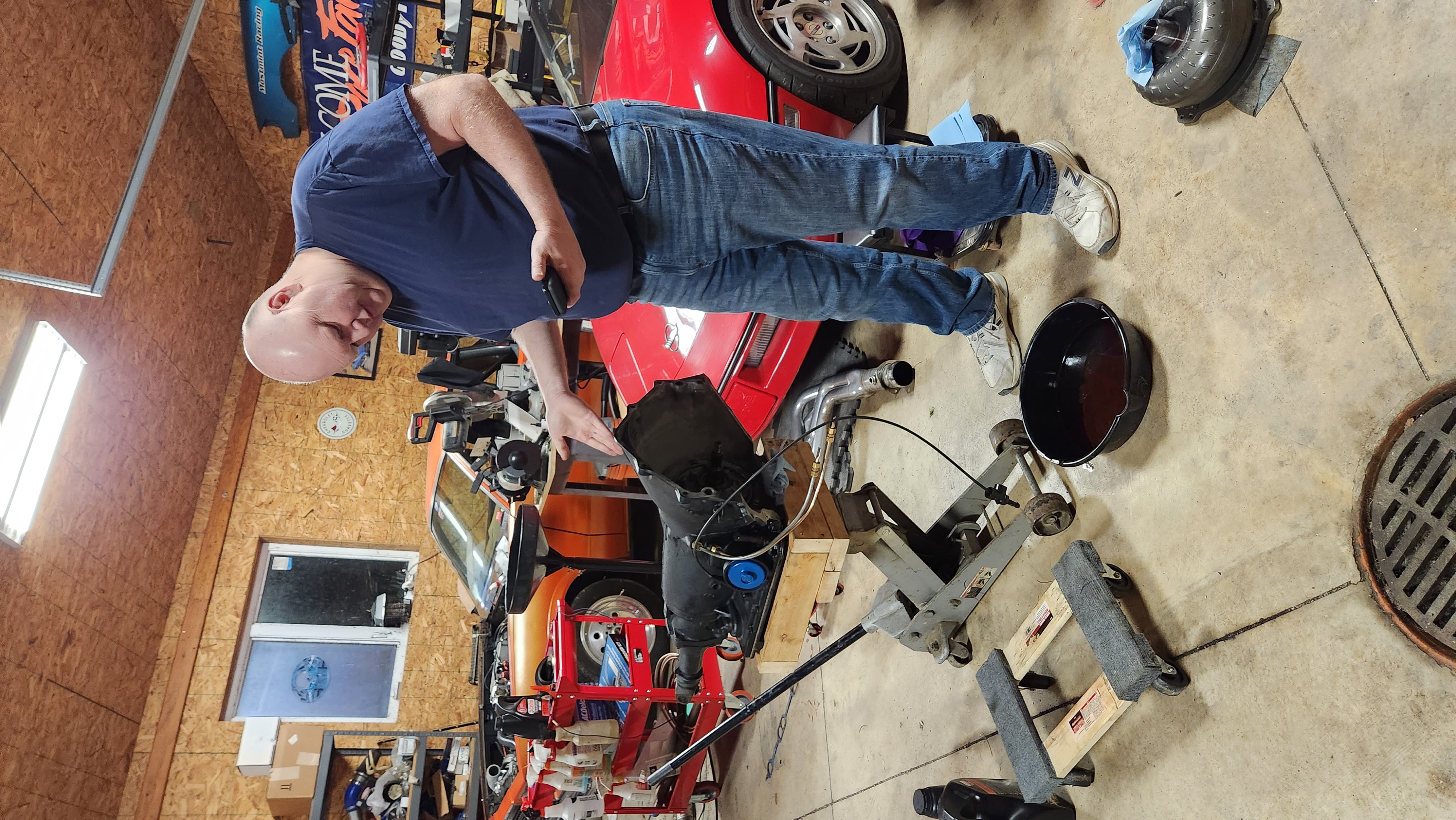

We had dinner with Speeces last night and Dave mentioned his little transmission jack adapter that he had made for a 700r4-4wd. That little wooden box captures the pan on all 4 sides. And it's bolted to a saddle for the jack, it's very steady.
He came out tonight to help and it went pretty easy since I had everything ready to the last bellhousing bolt. I just had to crawl under it, situate the jack, pull the crossmember out (already unbolted), and then just raise the car up in the air.

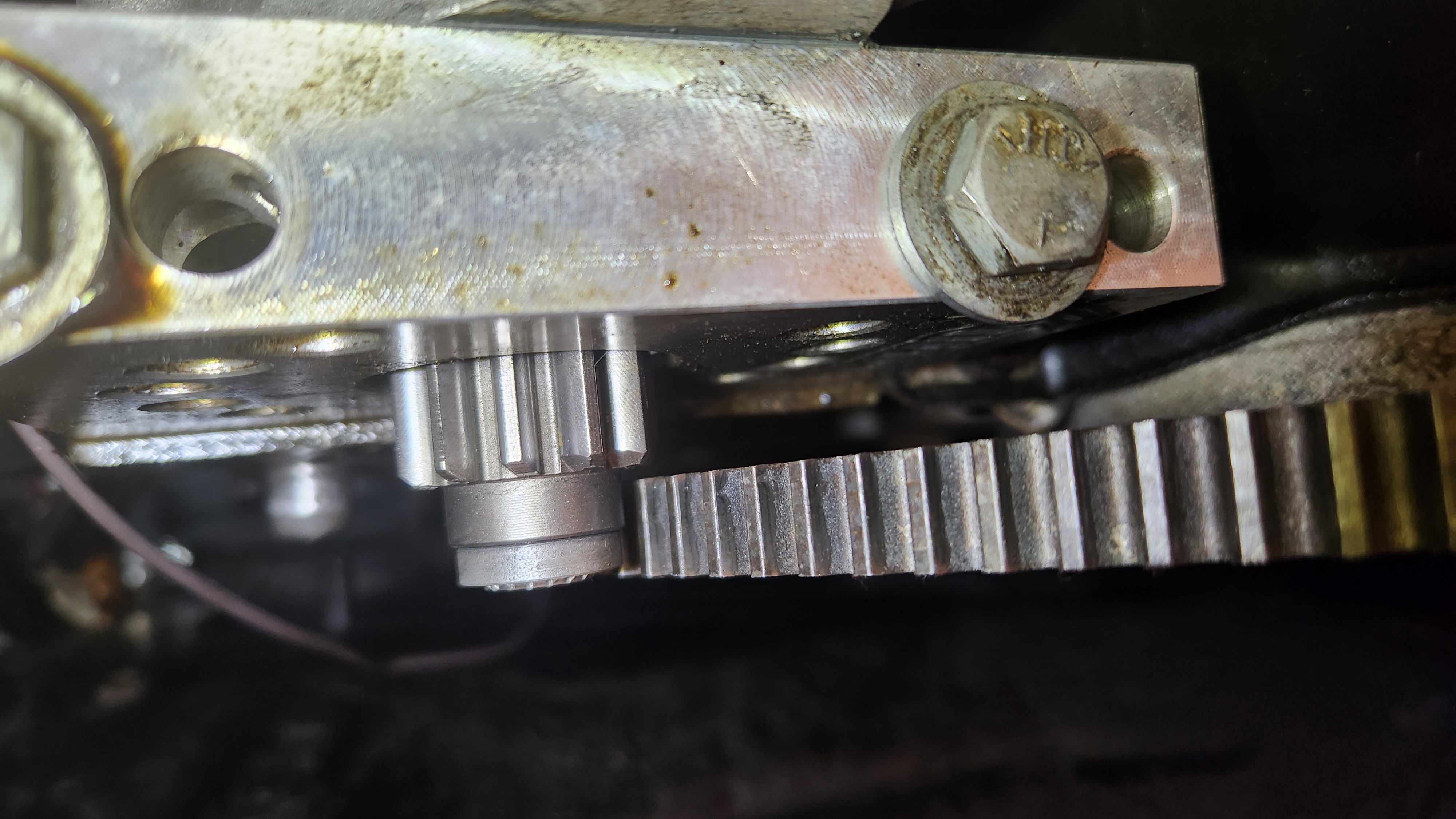

Well, I just got off the phone with Andre @ Edge, and he says the converter is perfect inside. I had sent him a link to the video I posted and he saw something I didnt -- At 0:26, just as the noise starts, there appears to be a spark by the flexplate/starter area. He thinks my starter/flexplate are making contact. I'm gonna give that a look-see. I do have replacement flexplate.

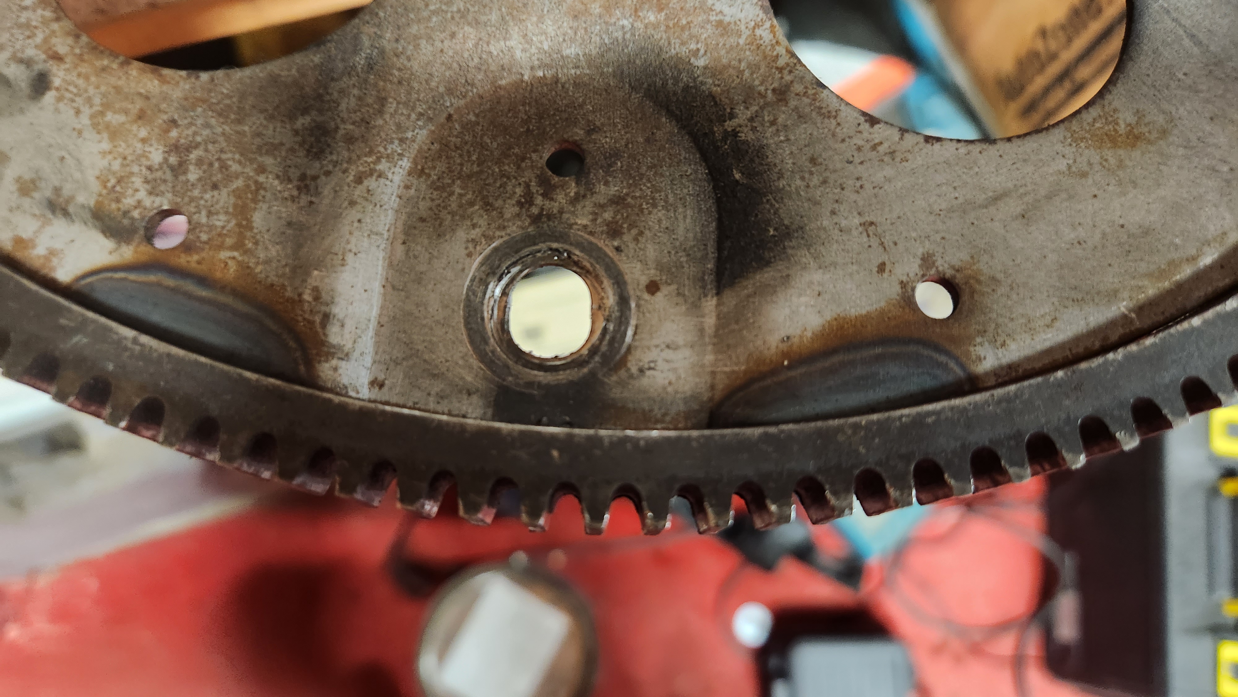

Well, good news and bad news. The good news is, that upon closer inspection, it does seem the starter was hitting the flexplate. I took this pic before removing the flexplate, and there certainly isn't much clearance between the starter gear and the flexplate.
But I can definitely see some contact marks now.
That's the good news, because I feel like I've found the problem.
The bad news is that the flexplate Paul found at Summit is the wrong size. I didn't know there were two different size flexplates for 1pc Rear Main Seal chevys. Interestingly, it's the same size as one from one of my 400s. The one from the ZZ383 is probably an inch smaller in diameter. So I gotta order a new flexplate. More to come...

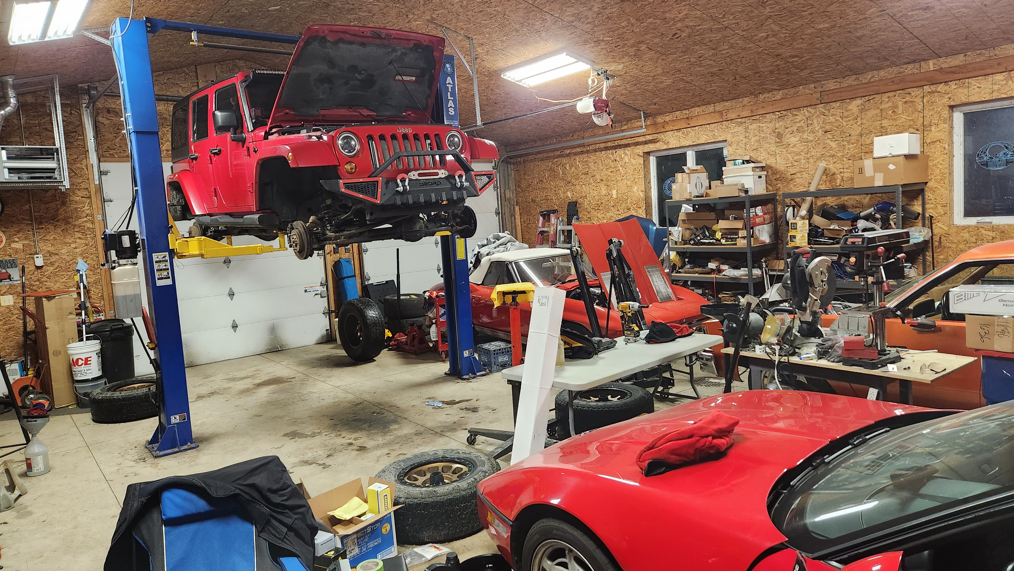

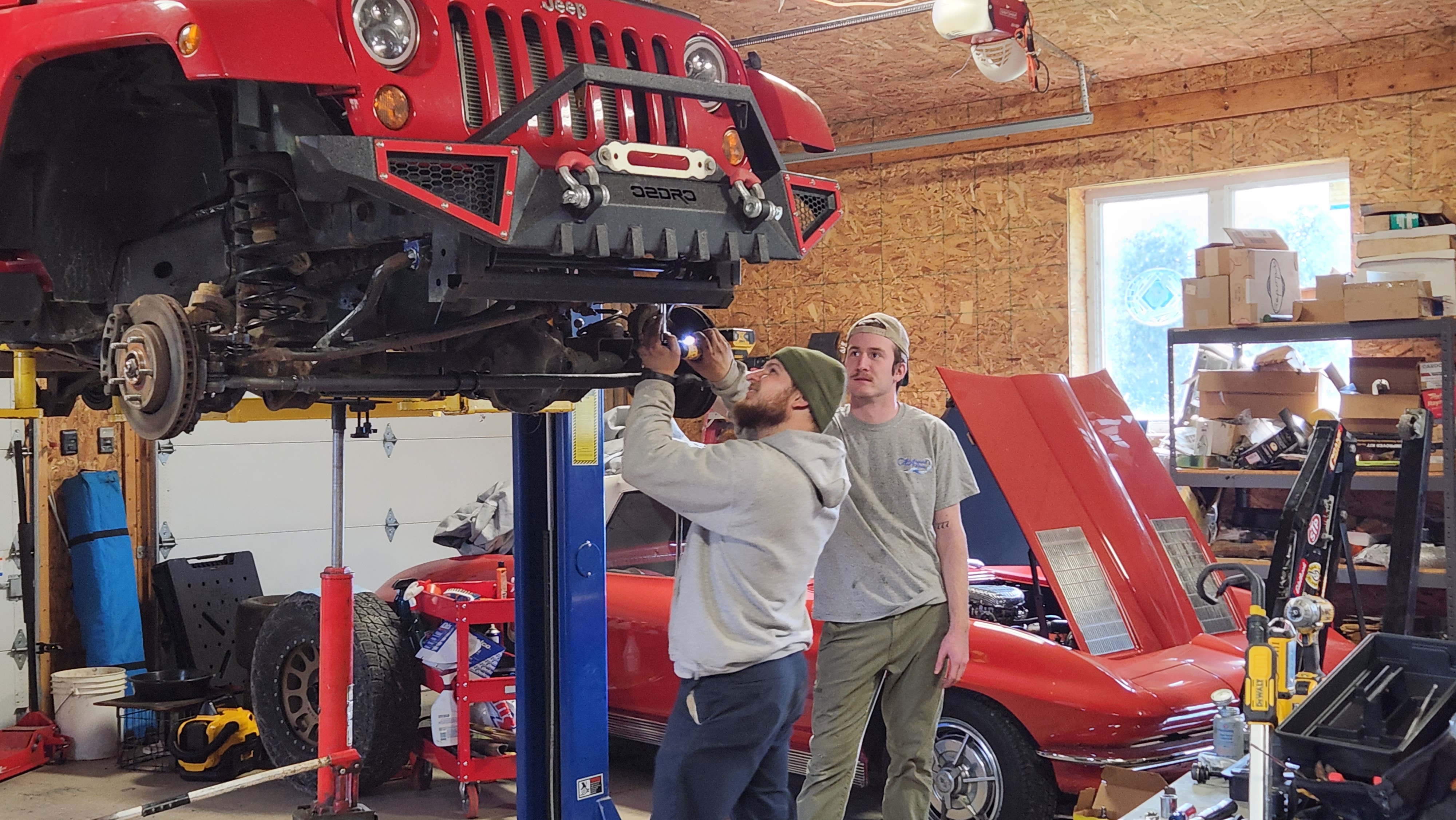

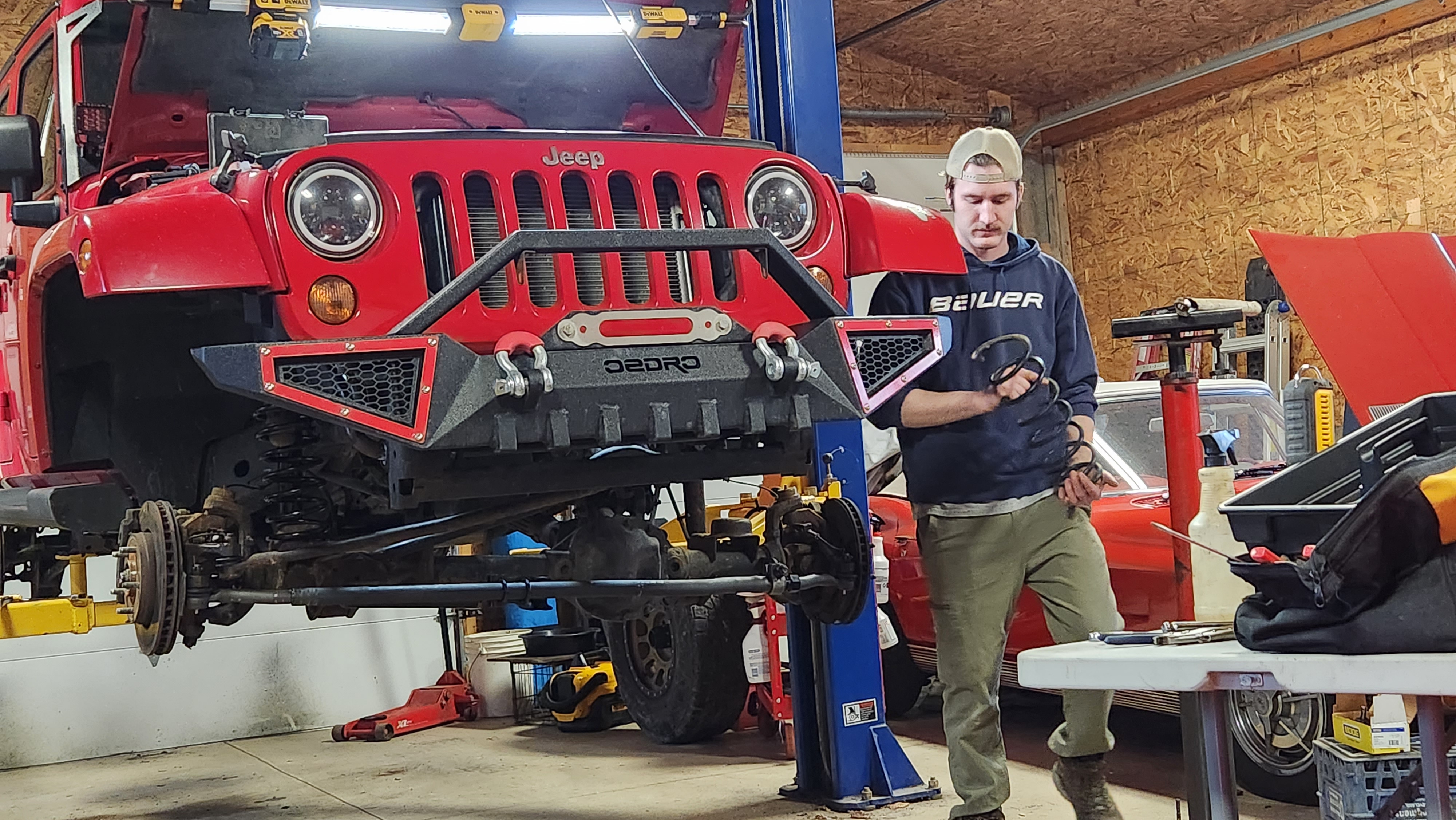

So while putting it all together, I had an audience of Jered, Charlie, and Mike Steigerwald. Jered had asked me a few weeks back about bringing his oldest-son Charlie's Jeep in town for some suspension repair and other maintenance. I told him Sure, no problem once my Chevelle was back together. Jered recruited Mike to help him and Charlie. We pulled the Jeep inside and pulled the wheels off and WD40'd the fasteners that were to be removed.
Saturday was spent in the garage working Charlie's Jeep. Mike and Charlie did the bulk of the laboring, while Jered and I, and later Chris too, helped with tools and guidance and such.

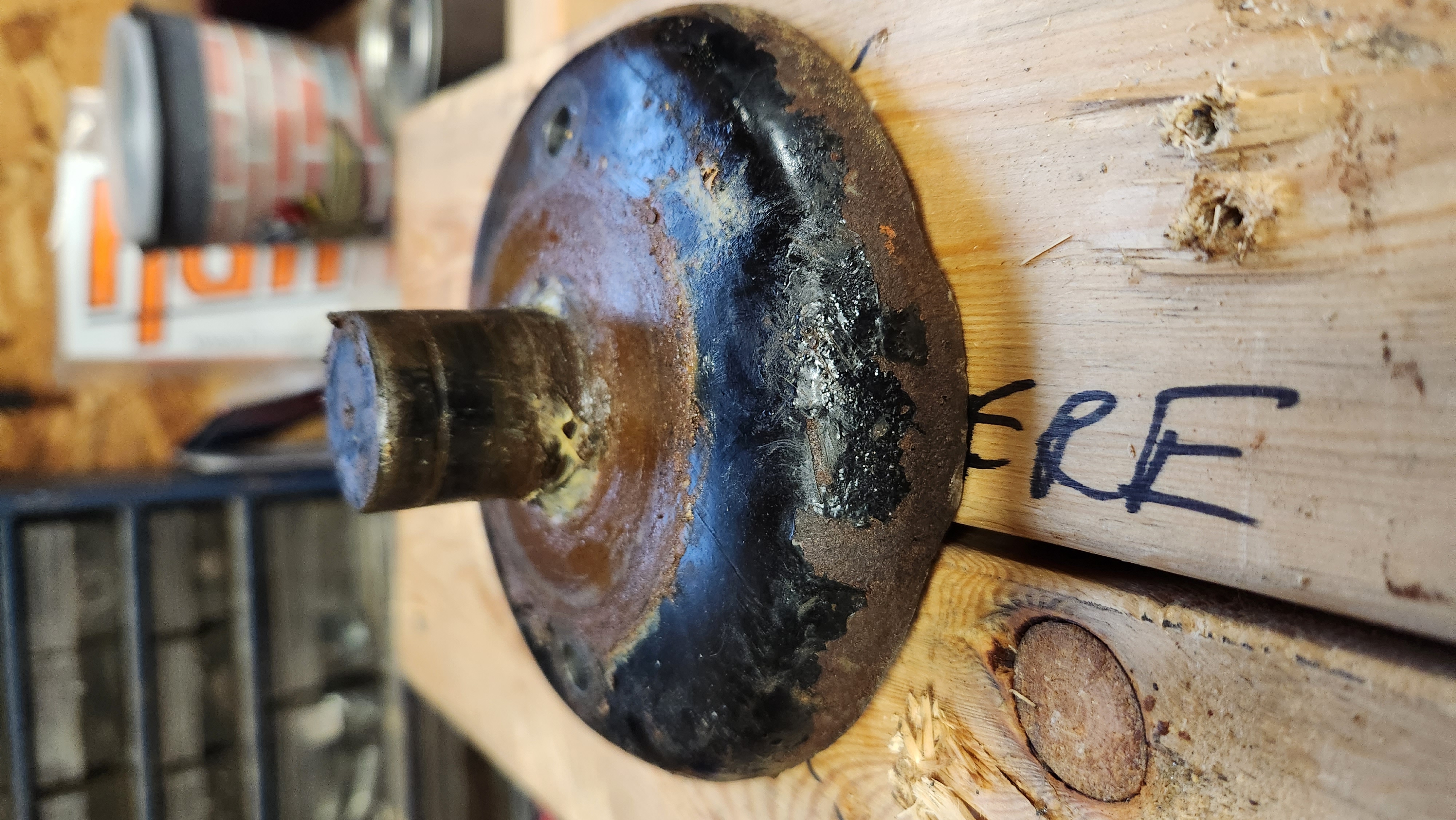

At the end of the day, the Jeep had new rear shocks, new front shocks + springs, new sway bar bushings + end links, new tie rod, oil change, 6 new spark plugs, plug wires, and an air filter. Between the broken front spring, bad tie rod and crappy shocks, it had been a disaster to drive, so we made a substantial improvement. He had parts to do the front axle u-joints, but that looked a little more involved. They didnt seem terrible and would provide questionable improvement.
