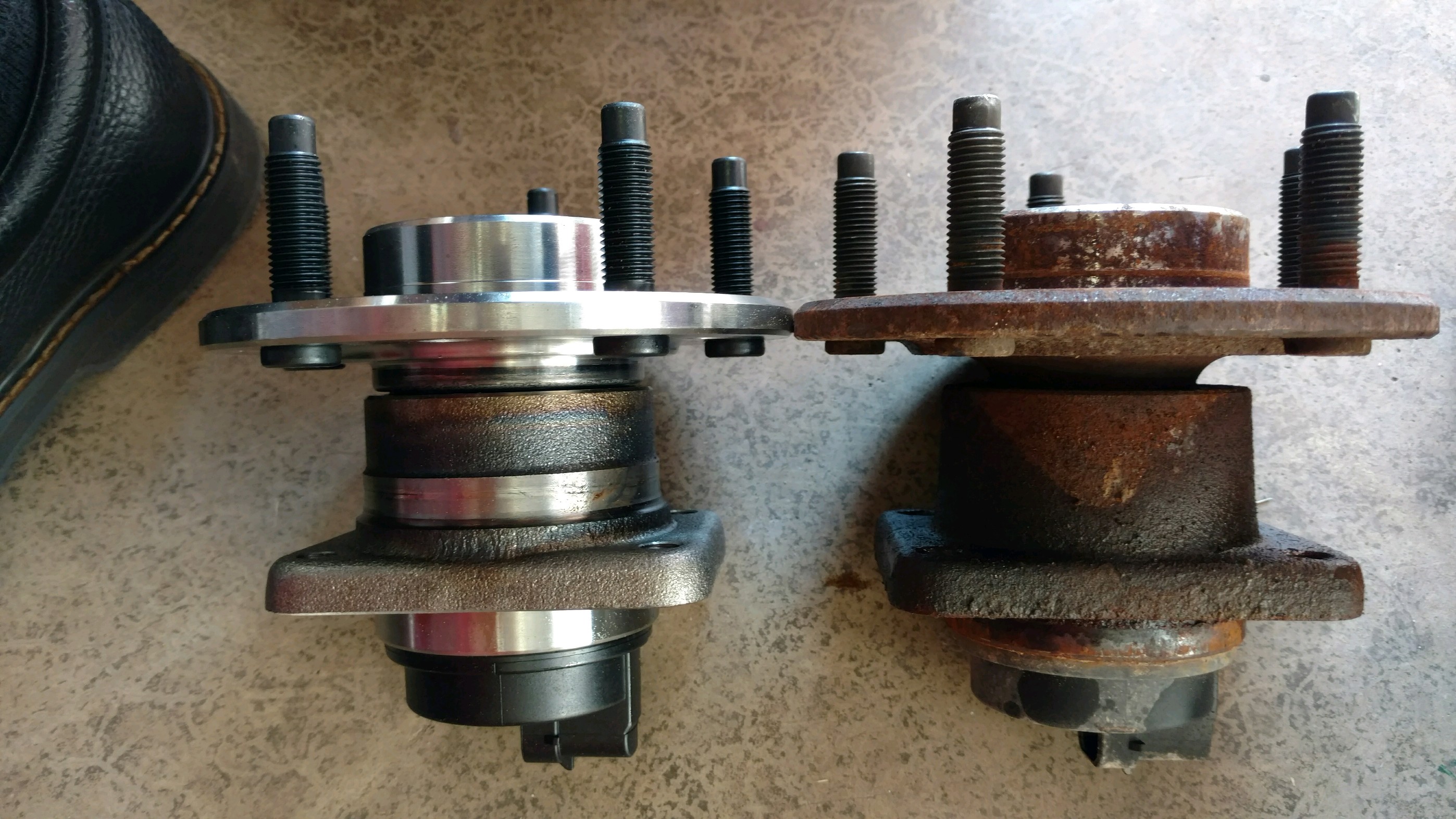

Yesterday I installed the new Moog front wheel bearing / hub assemblies on both sides. The previous owner claimed to have installed new ones and made it seem like it was done recently. I'm sure this car sat outside, and being low to the ground doesn't help rust issues, but these things looked terrible. They were also in worse shape than I thought after inspecting them once removed. They would spin almost freely and I feel the slop wiggle in my hands. After putting the AutoZone version next to the Moog, there's a pretty noticeable difference in the too, and the Moog is even a little heavier. I cleaned up all the rust on the bolts and mounting area, slapped some never-seize on them (in case I have to do this again), and put it all back together. It wasn't a terrible job and each side took about 45 minutes because of the sanding and clean up time. I believe if I was in a hurry and didn't have any rust clean up, that I could do this job in about 20 minutes.

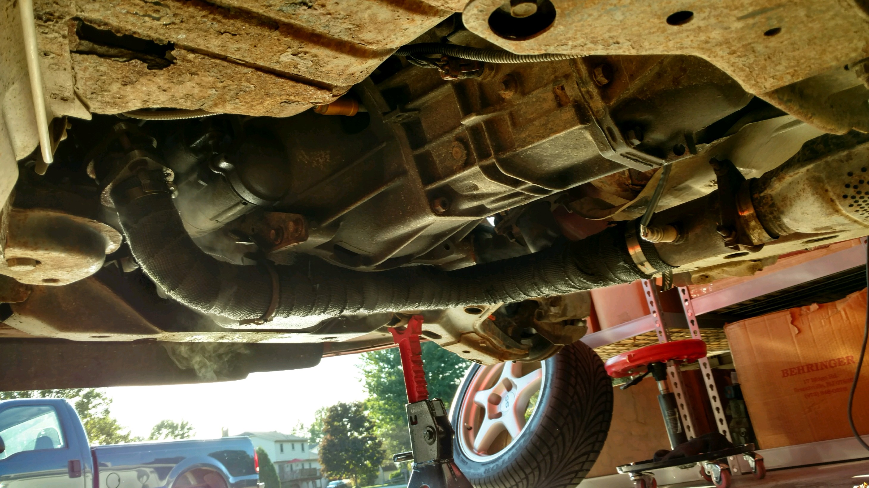

I still have the y-pipe to put header wrap on while the car is in the air, and the bottom portion from the molding down to wax, and I should be good to go for now. I looked and there's pretty much no way I'll be able to wrap the headers in the car, but the y-pipe wrap will help two things: keeping the transmission cooler and keeping the interior cooler also. Worthwhile investments since I already have the wrap.

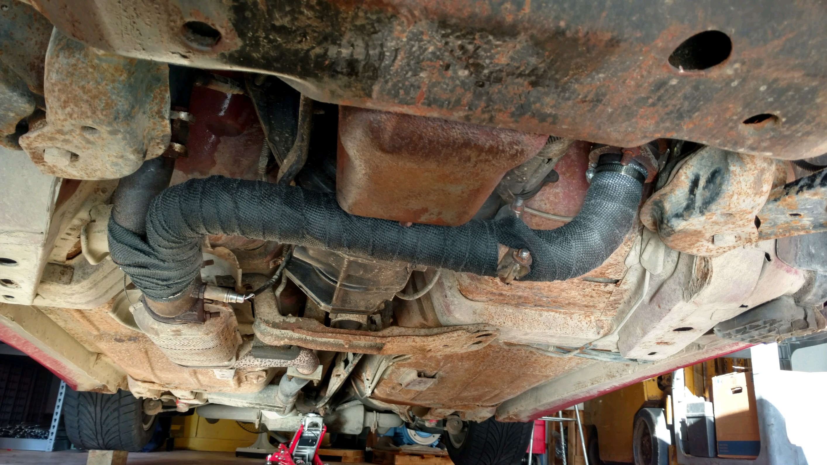

Last night I was able to get the y-pipe wrapped up. Not sure if it helped or not, but I figured it was free, and it couldn't hurt. Boy is that a messy job once you get it wet...

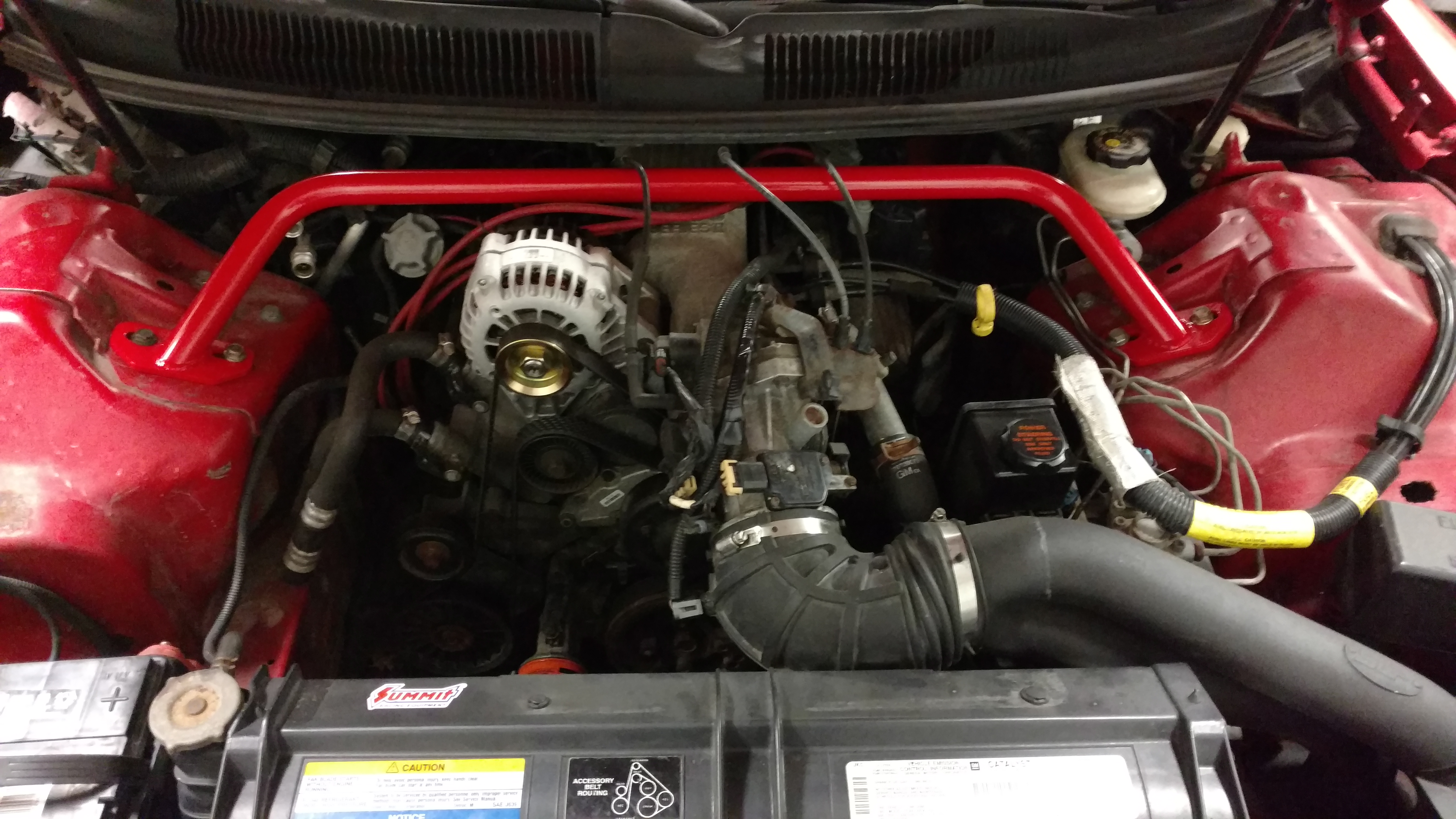

Re: 1997 Pontiac Firebird
I got this mounted tonight. It's never as smooth as you hope, but a longer bolt here and some lube there and it was in. It seems like a real solid piece.

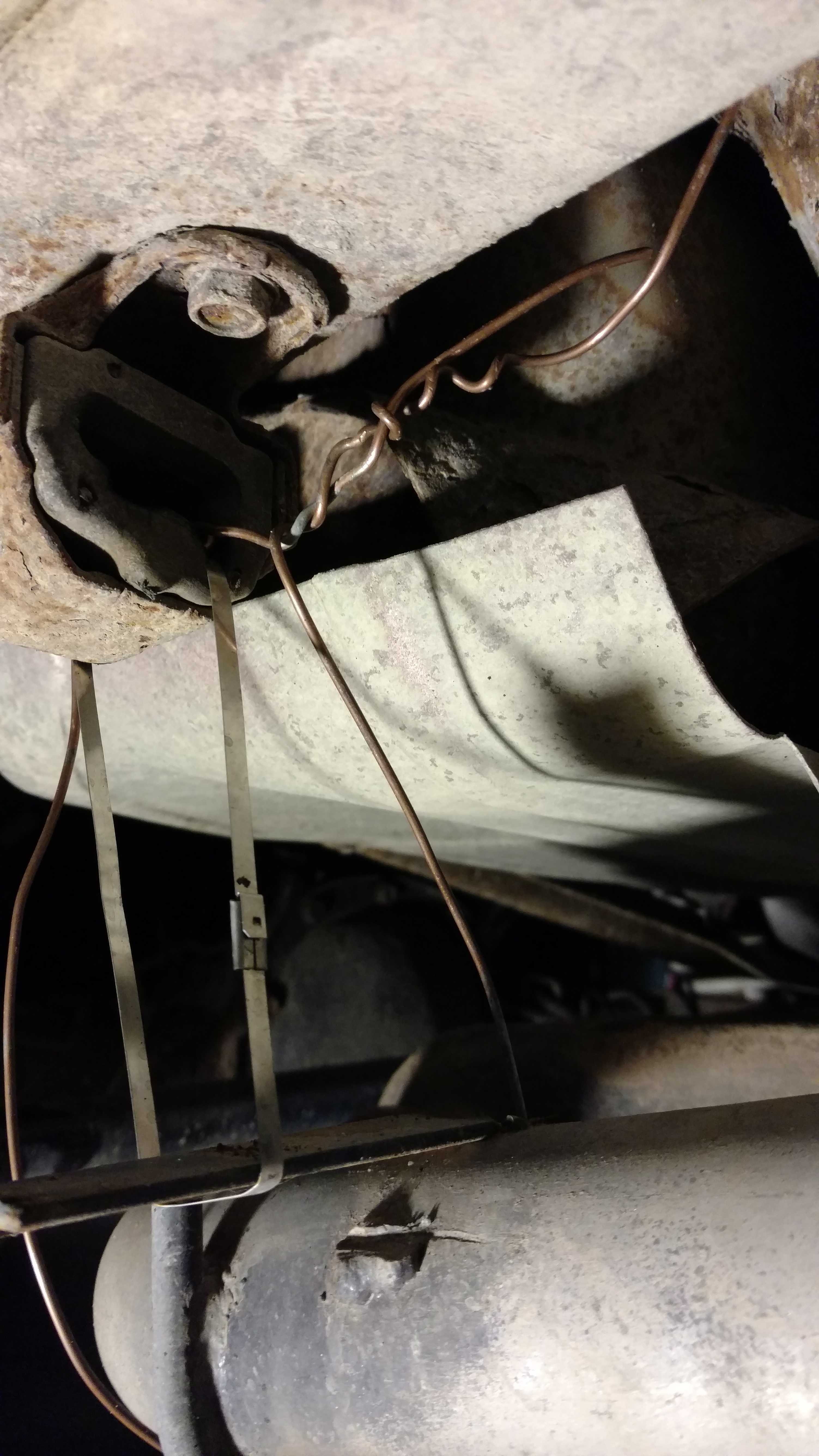

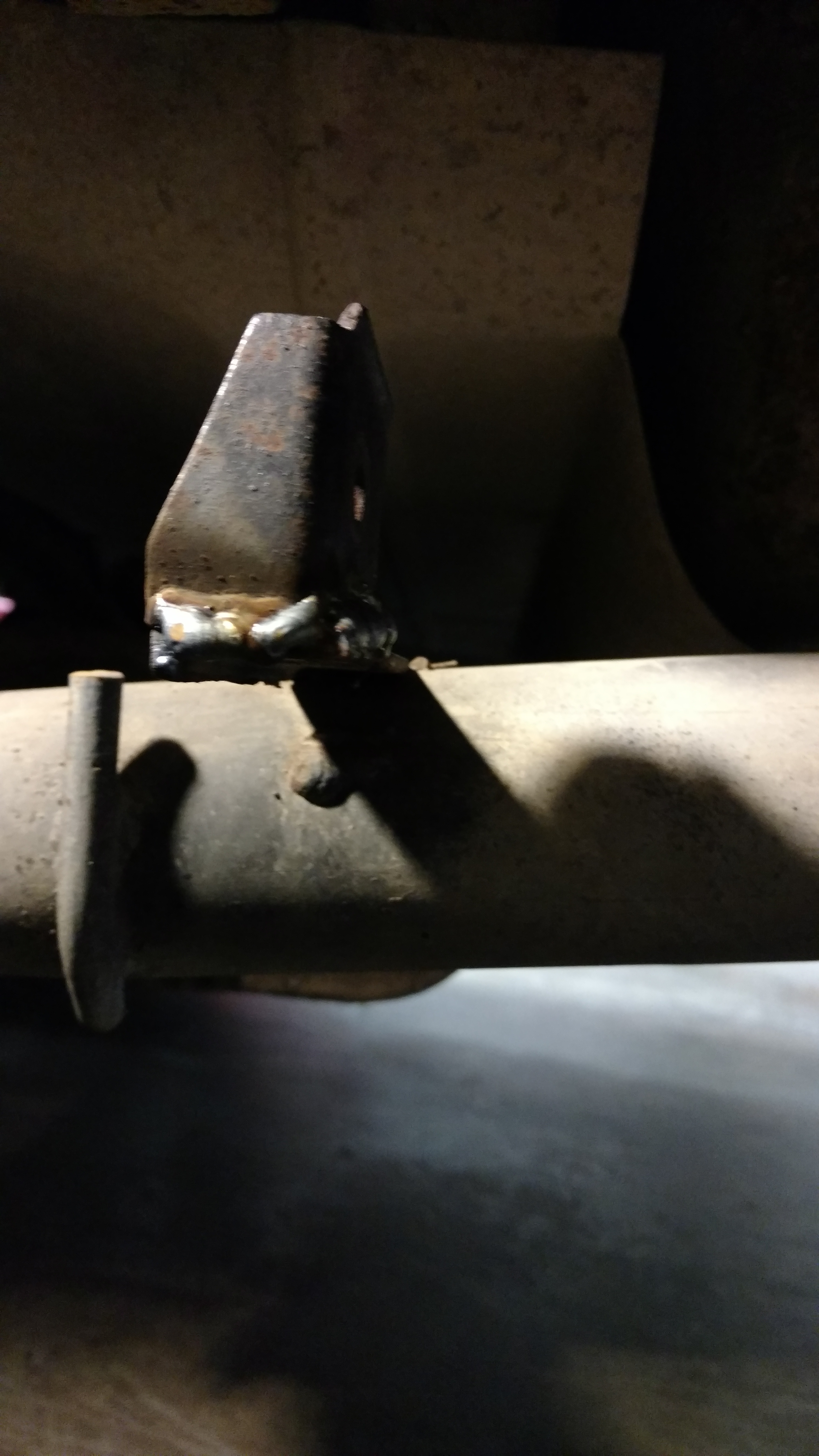

Just by chance while driving to the track day yesterday, the left rear exhaust hanger broke. Mostmint had a couple steel zip ties that got me through the day. Tonight I broke out the welder for the first time in years and got it put back together.

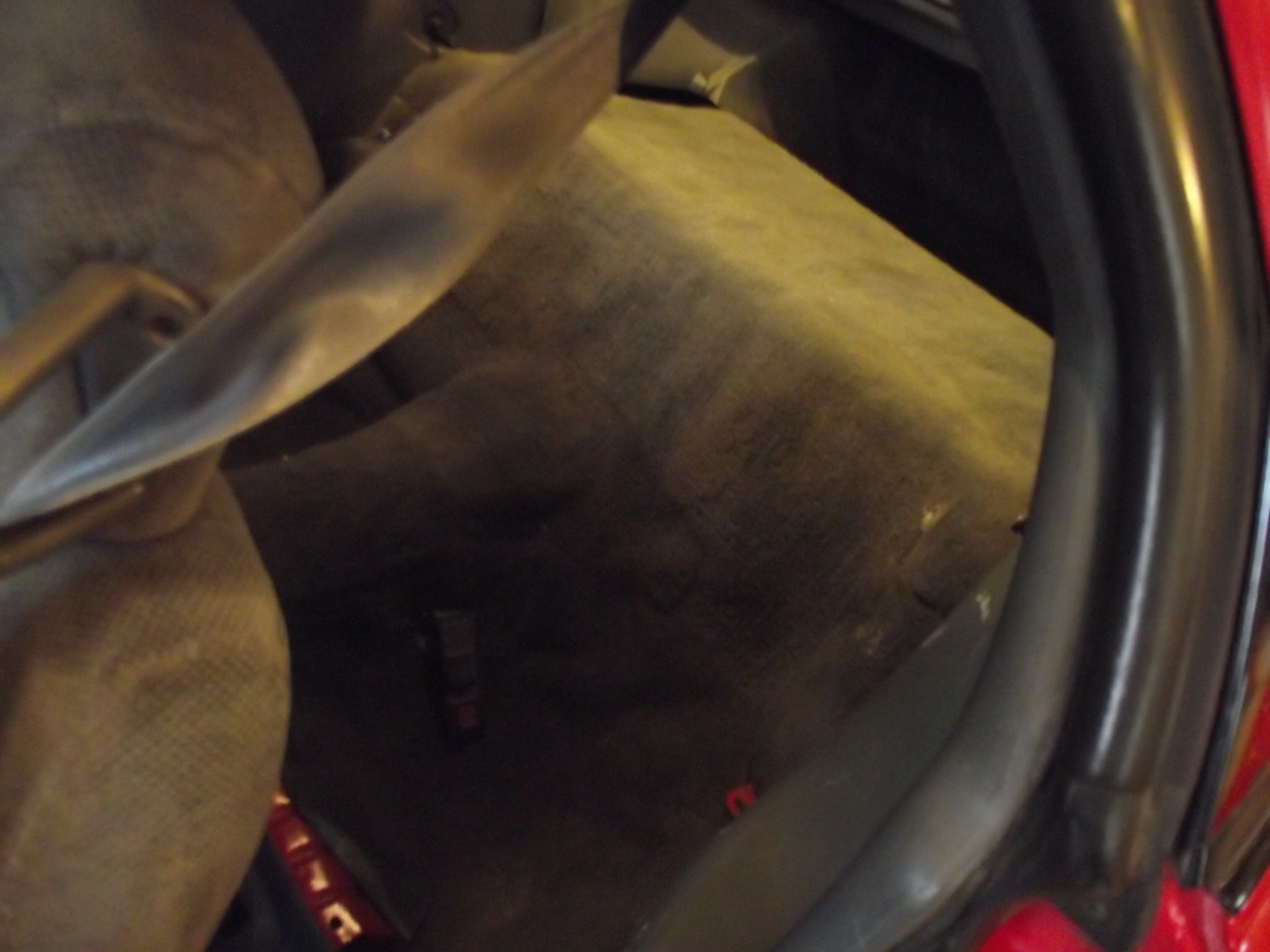

With another track day looming, we had a few things to do. The most important was the power steering cooler and synthetic fluid. We also rotated the tires, checked the brakes and fluids, installed the new non-leaking gas cap, and pulled out the rear seat and seatbelts. Good thing too as there was a stinky mouse nest onder the driver's side rear seat.

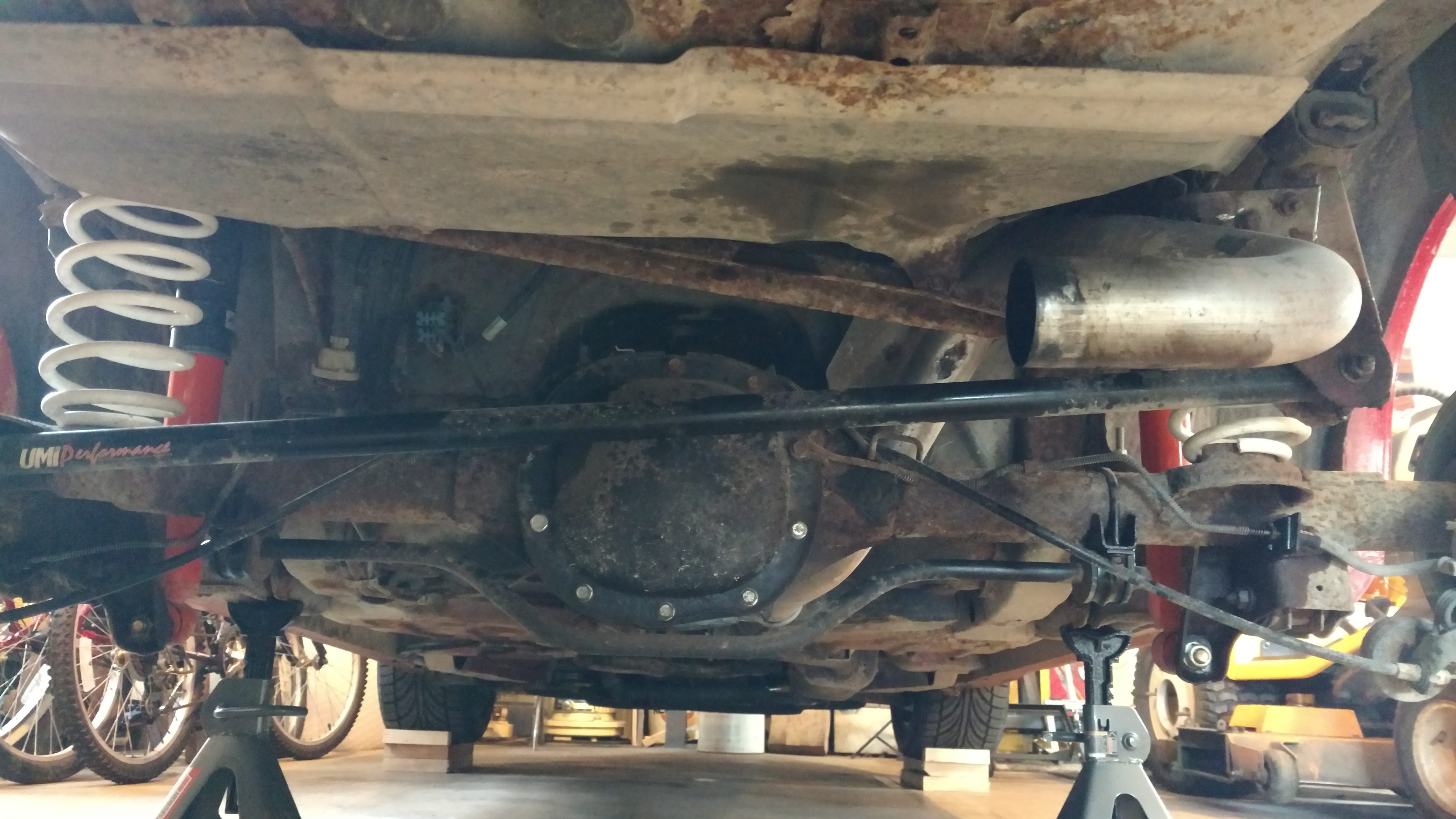

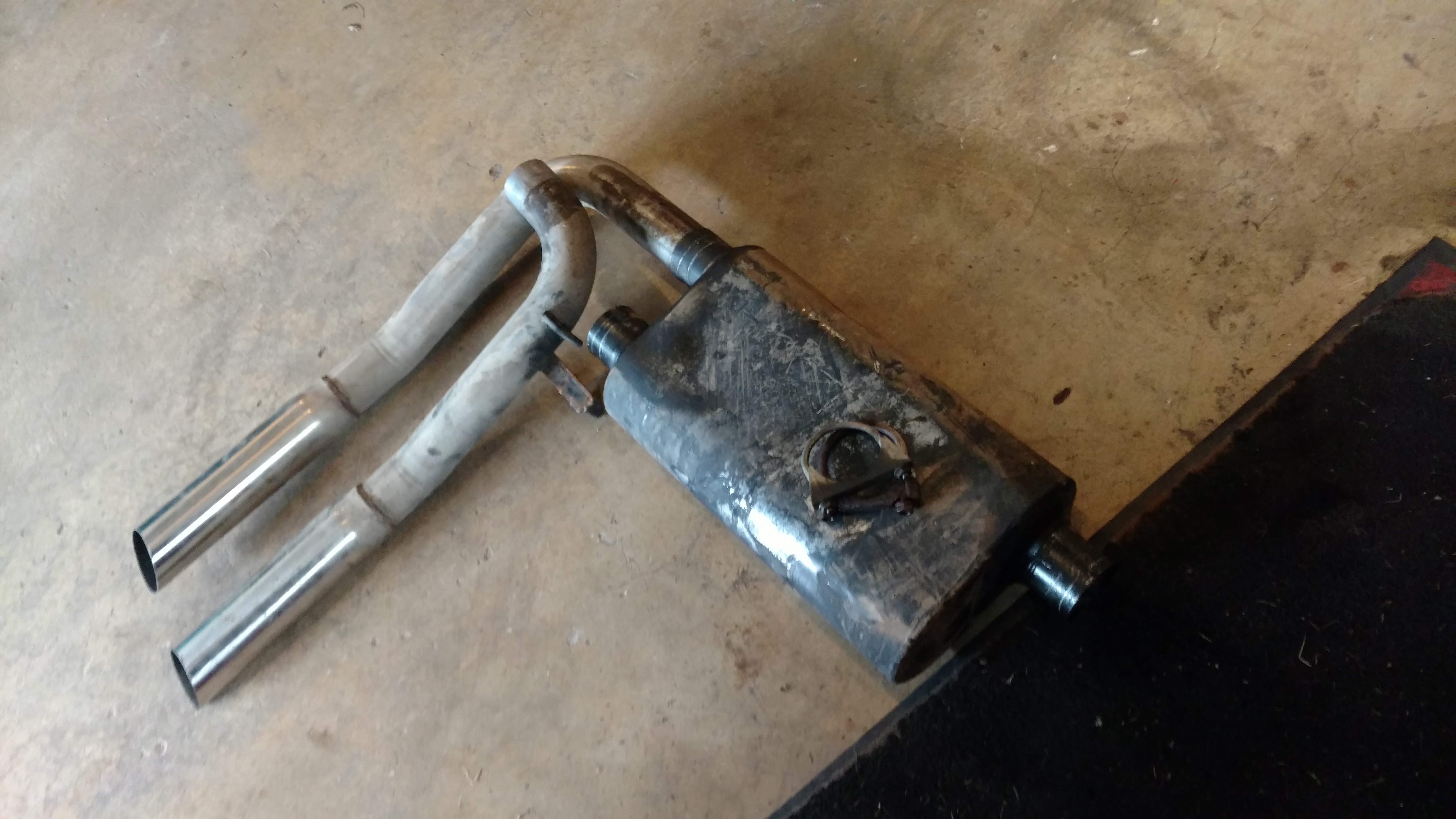

Yesterday I did a little prep work to get ready to pull the rear end out. Got the car jacked up, put my newly made wood lifts under the front tires, and pulled the muffler and tailpipes off. I ordered a 3" muffler last week, but realized that the current pipe is only 2.5", so I'll have to swap it out on my next trip to Summit.
Hopefully next weekend we can get the rear end out so we can get it to JD race for the 3.90 gear install. I also have an aluminum driveshaft and tubular rear lower control arms coming this week.

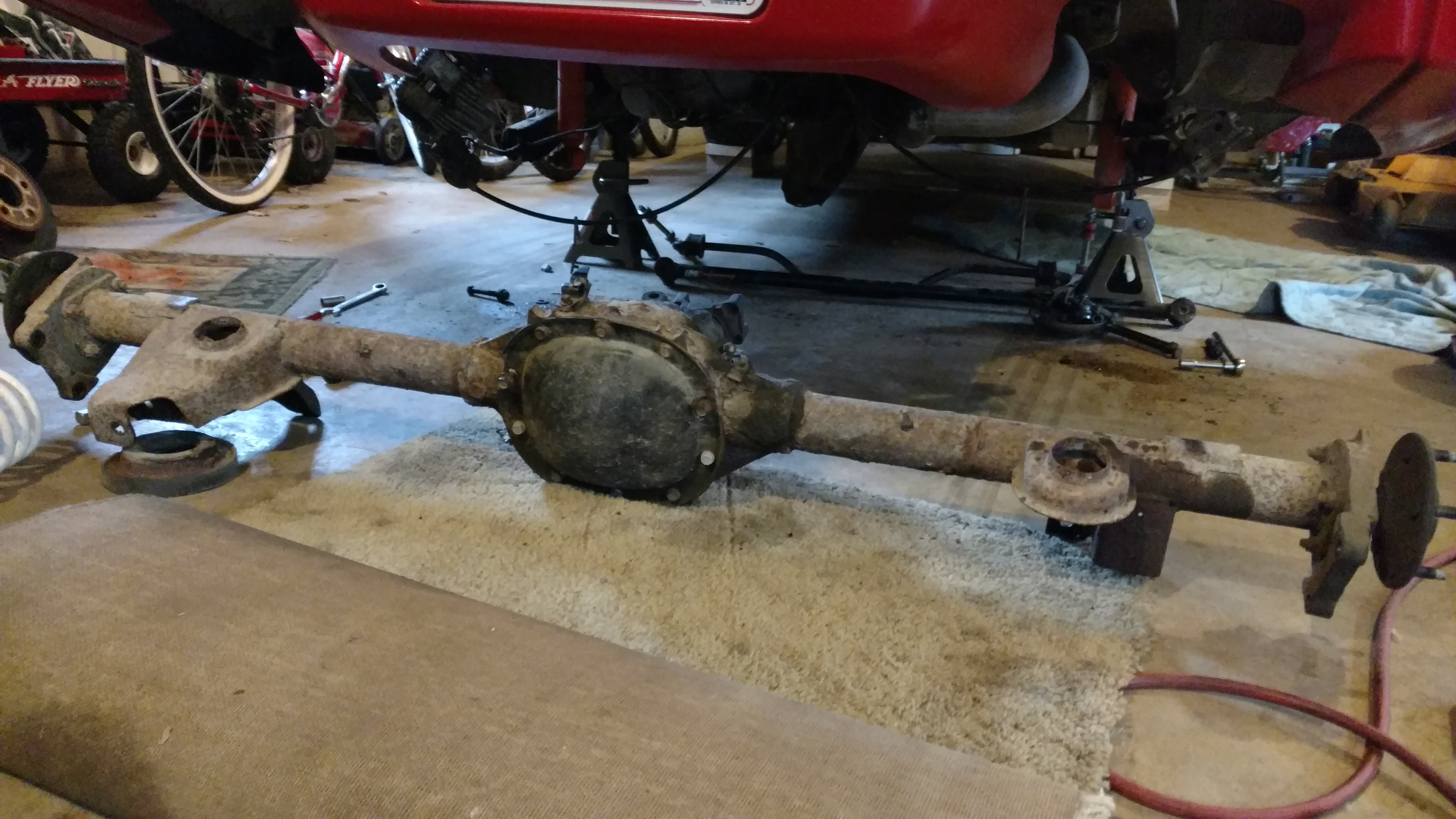

Today we got the rearend tore out without any issues. Should be taking it to JD Race early next week. We also figured out the yoke we're going to use in the transmission. The one that came with the "new" eBay aluminum driveshaft had a steel ring with a rubber center attached to it. The rubber was dried and cracked, but it was 1/2" longer than the one that was in the car, but it's an OEM piece. The one that came out of the car was just a Turbo 350 piece.
