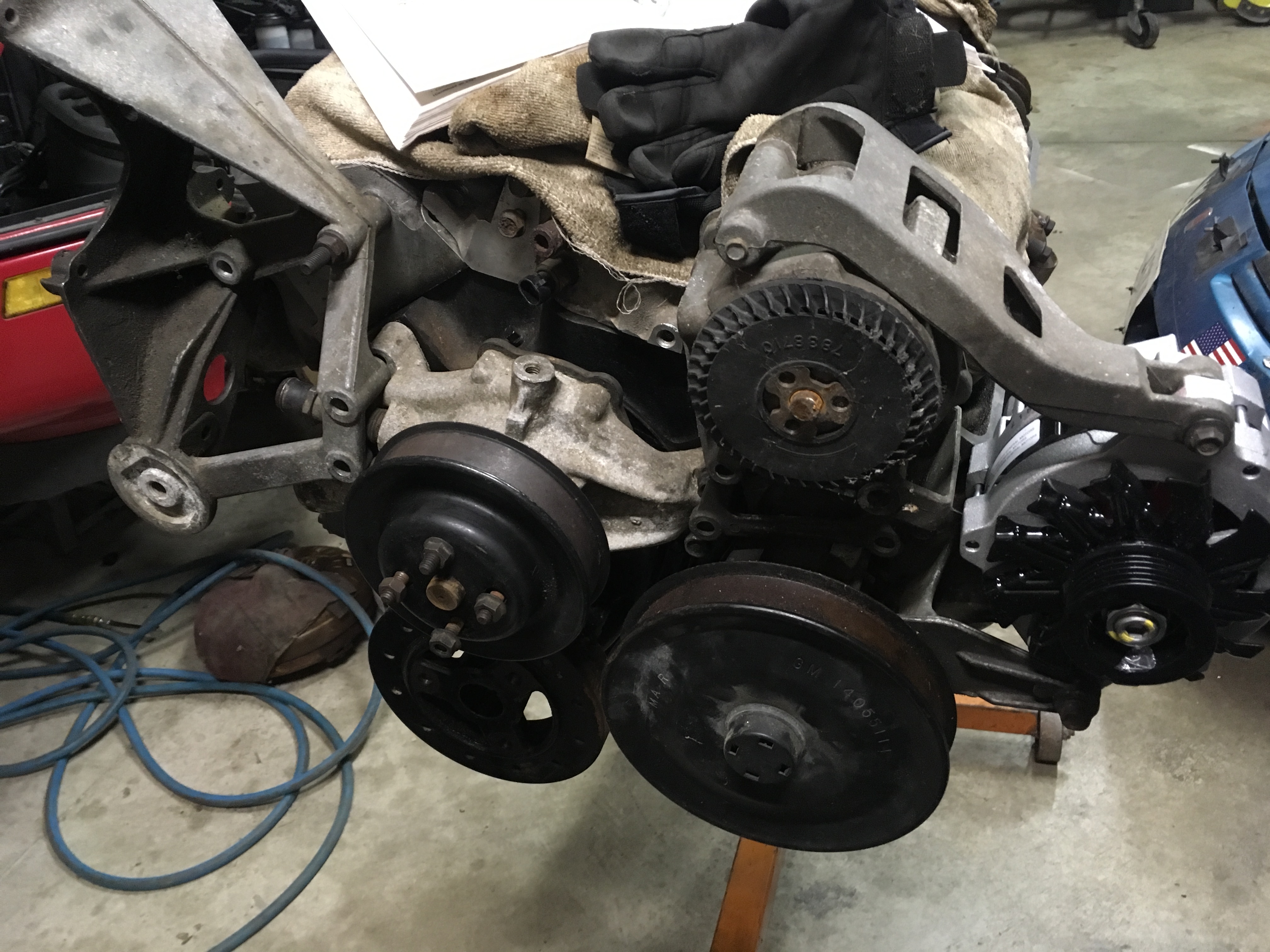

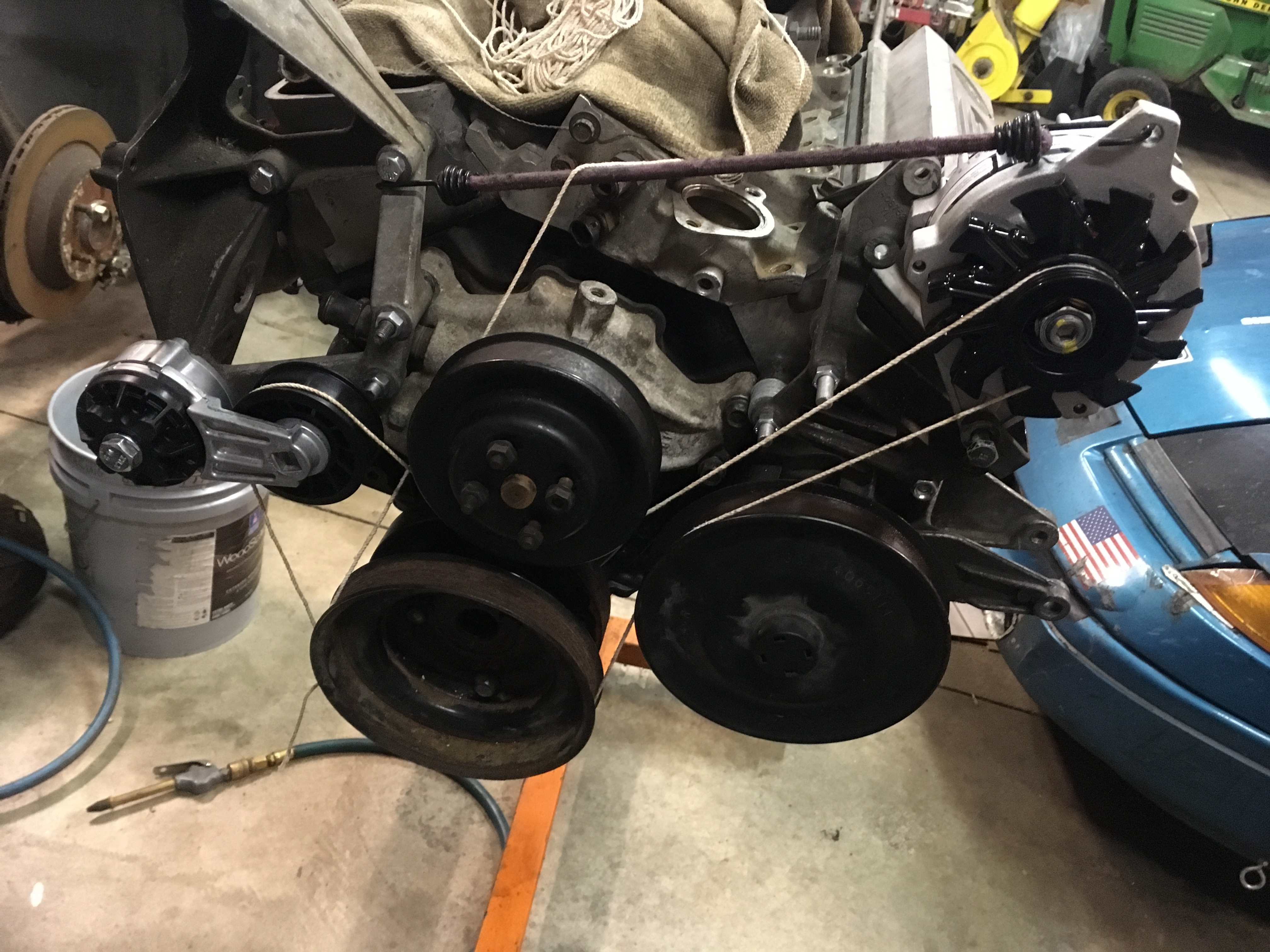

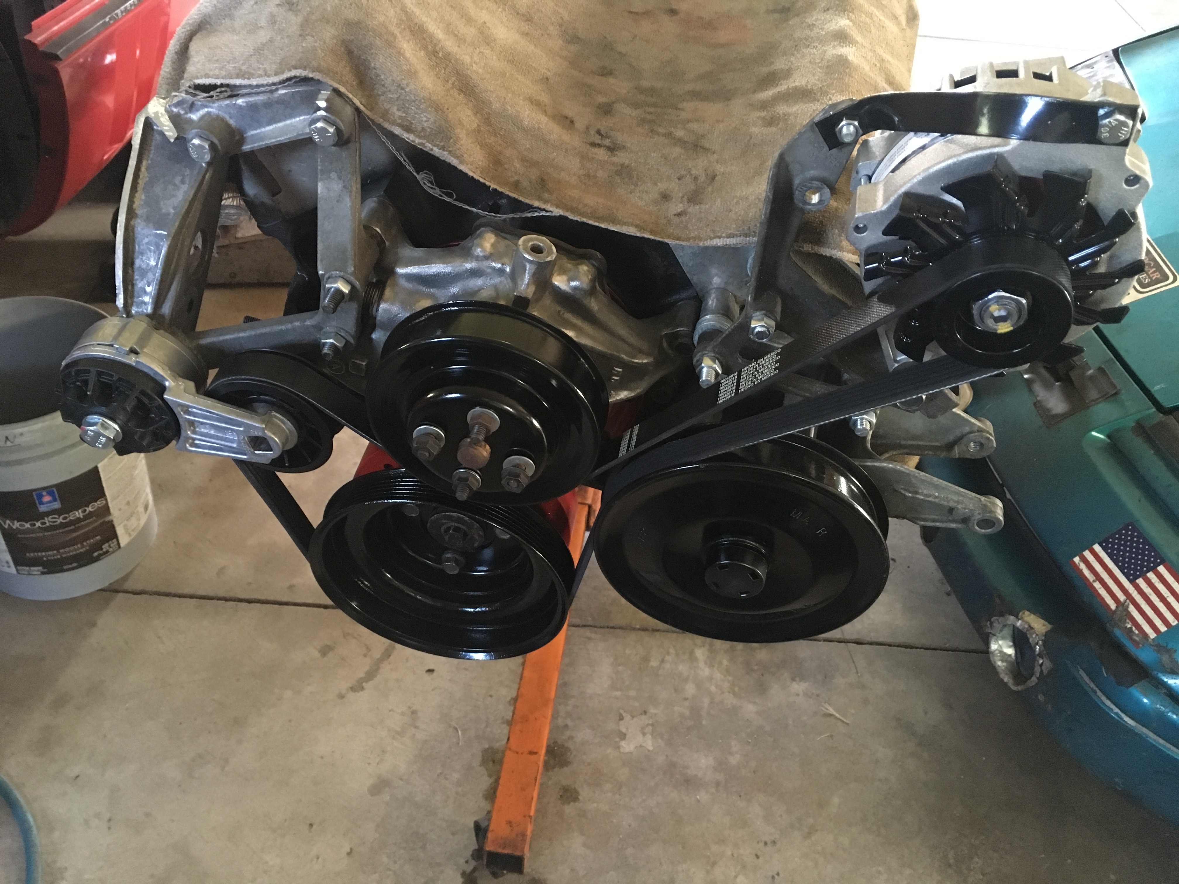

I have a path to a belt configuration. Had to buy some hardware to get it all attached. Pics are of the original configuration. What I will do is move the alternator to where the air pump is located, and run the tensioner backward. Plan B could be tensioner where air pump was. Tensioner on order will have tonight. All the bolts are standard except the bolt holding the tensioner appears metric.
Re: 89 Corvette Mostmint #39
Going to make brackets and aluminum shims. I like using studs makes it easier to assemble. Below you can see the string on the path for the belt.

It took two tries but I now have a belt that fits.
Pretty, looks stock to me.
- Posts: 3607
That looks like a nice solid, straight setup. Should be good forever.

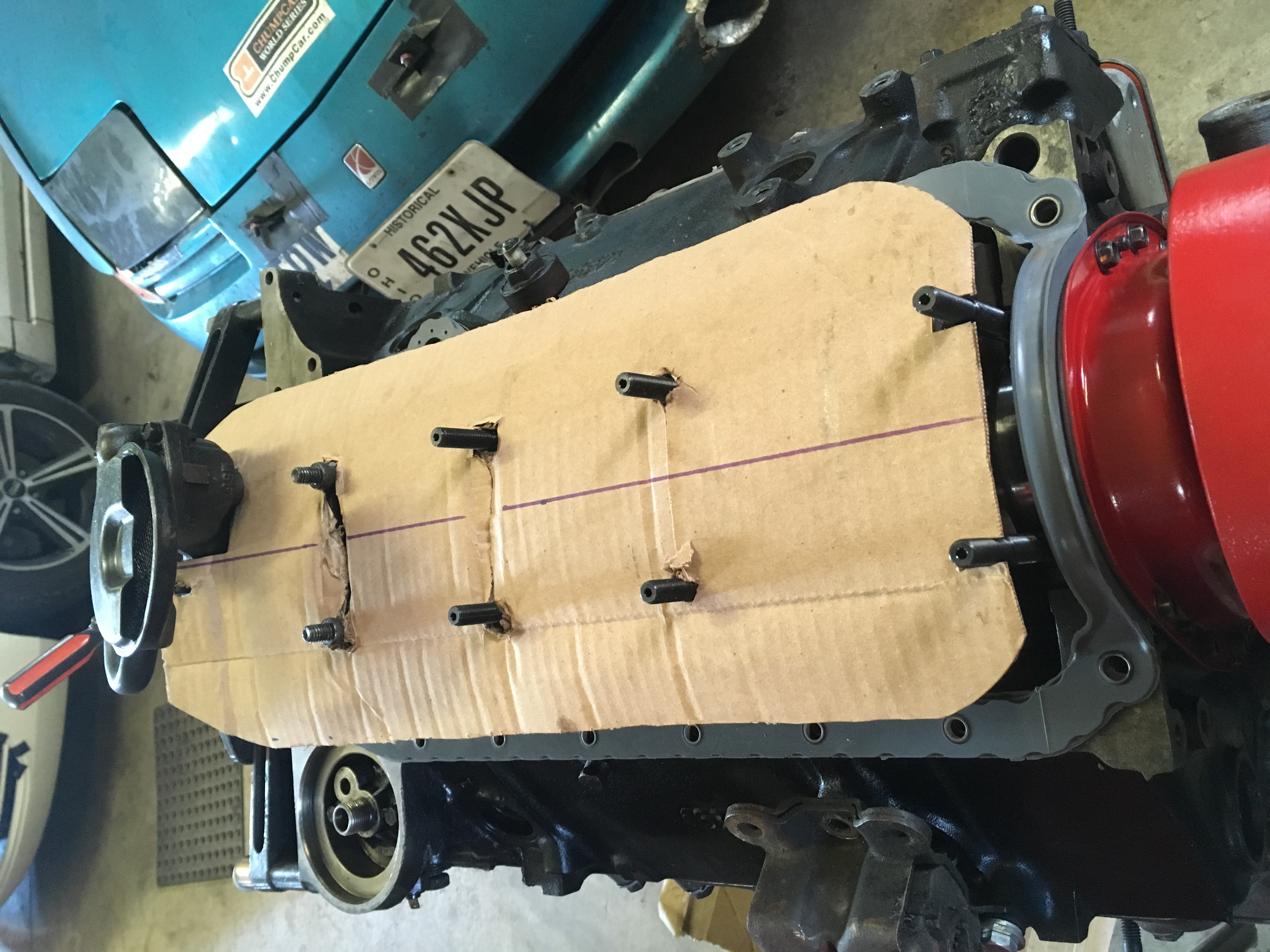

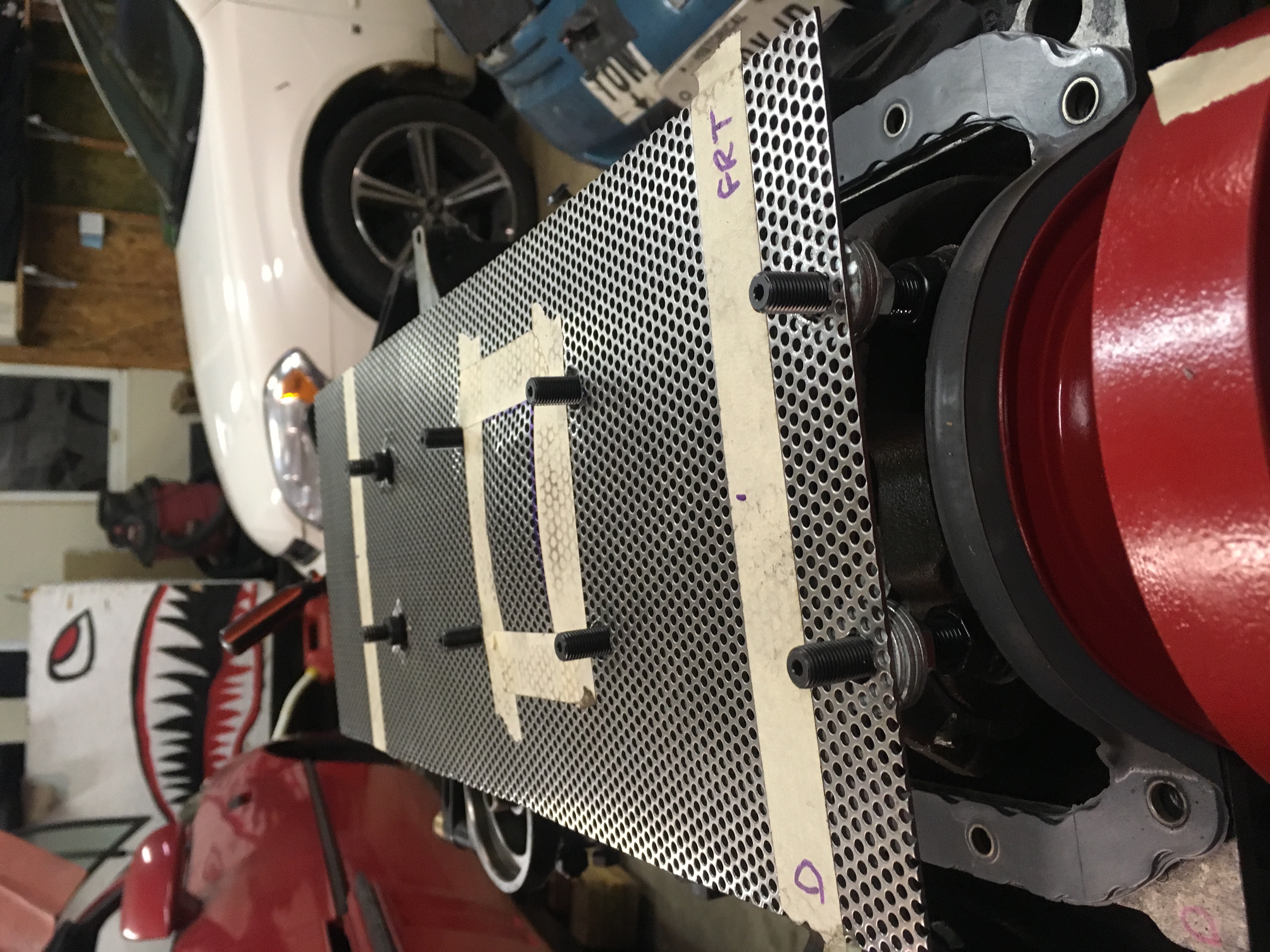

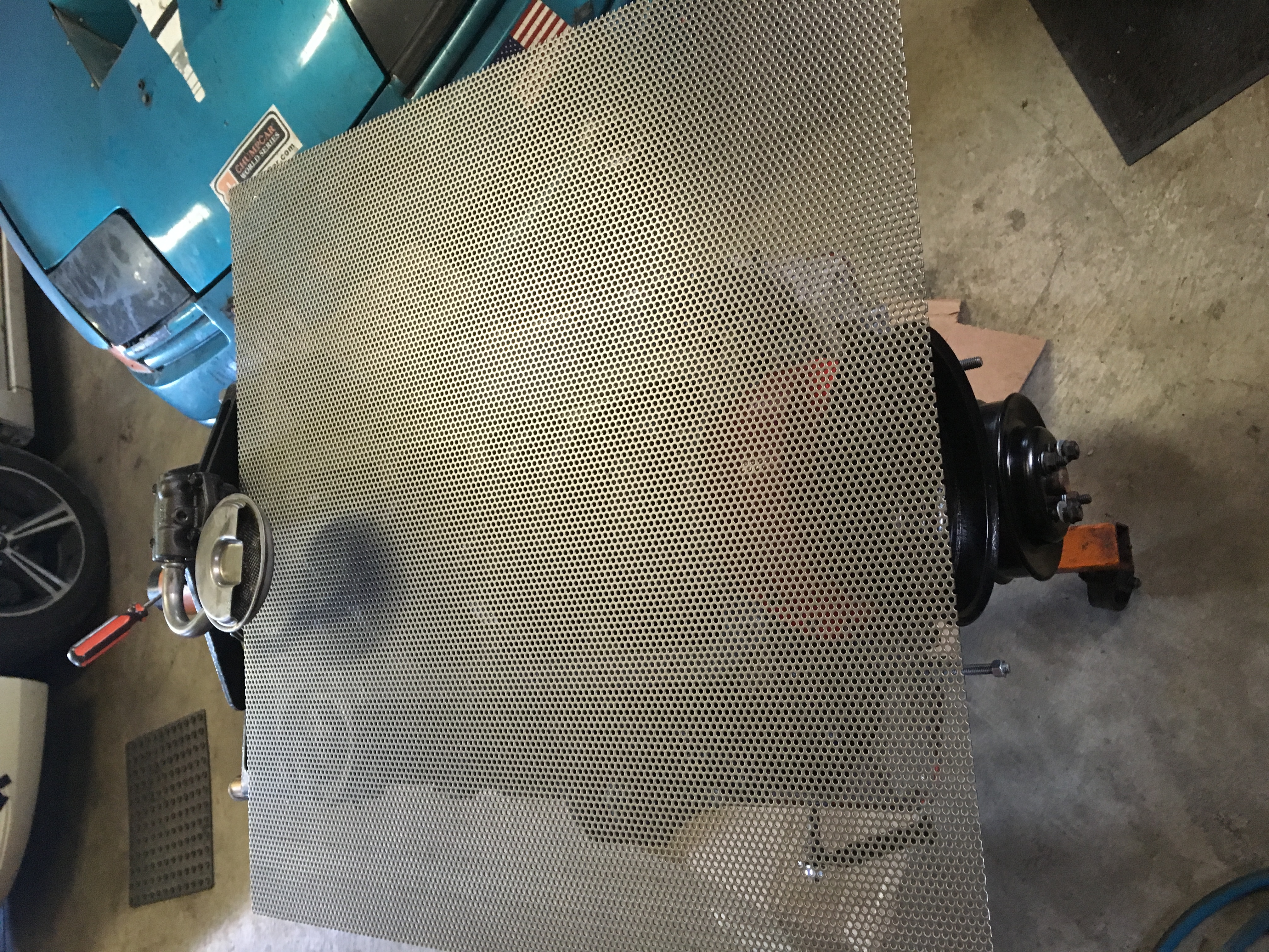

I am also interested in oil management in the pan. The car has a factory windage tray but I am going to experiment with making one from perforated sheet.

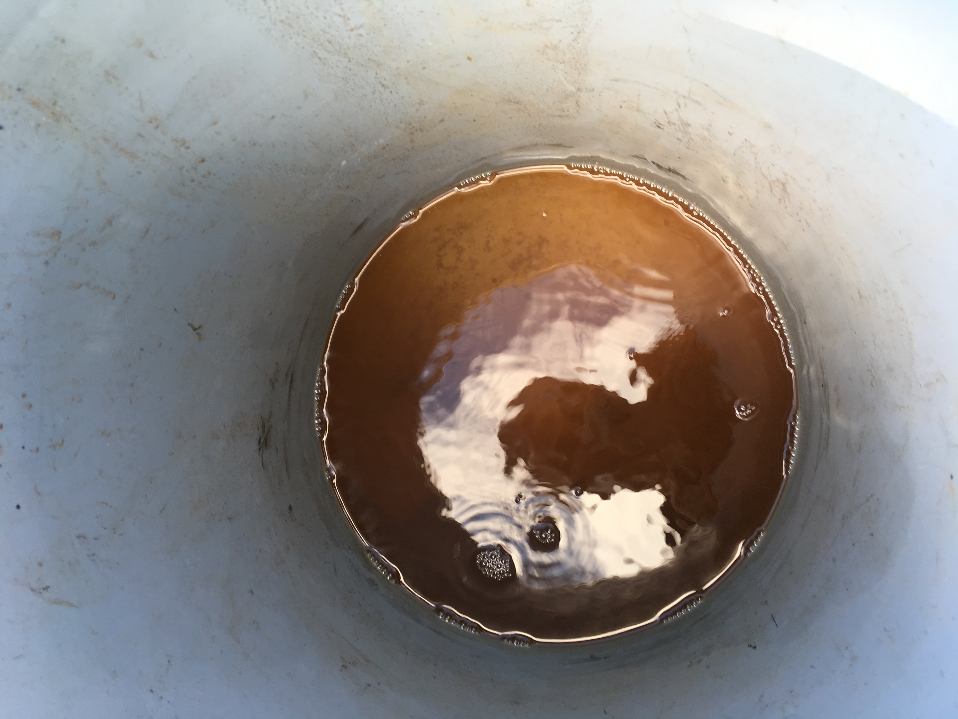

While I had the hose out I flushed the radiator which brought out a lot of rusty water and some rust chunks.

If you buy a non running you must assume this is what is in the gas tank. There were several gallons of rust, water and gas in the bottom of the tank. Tank is plastic so it will clean up.

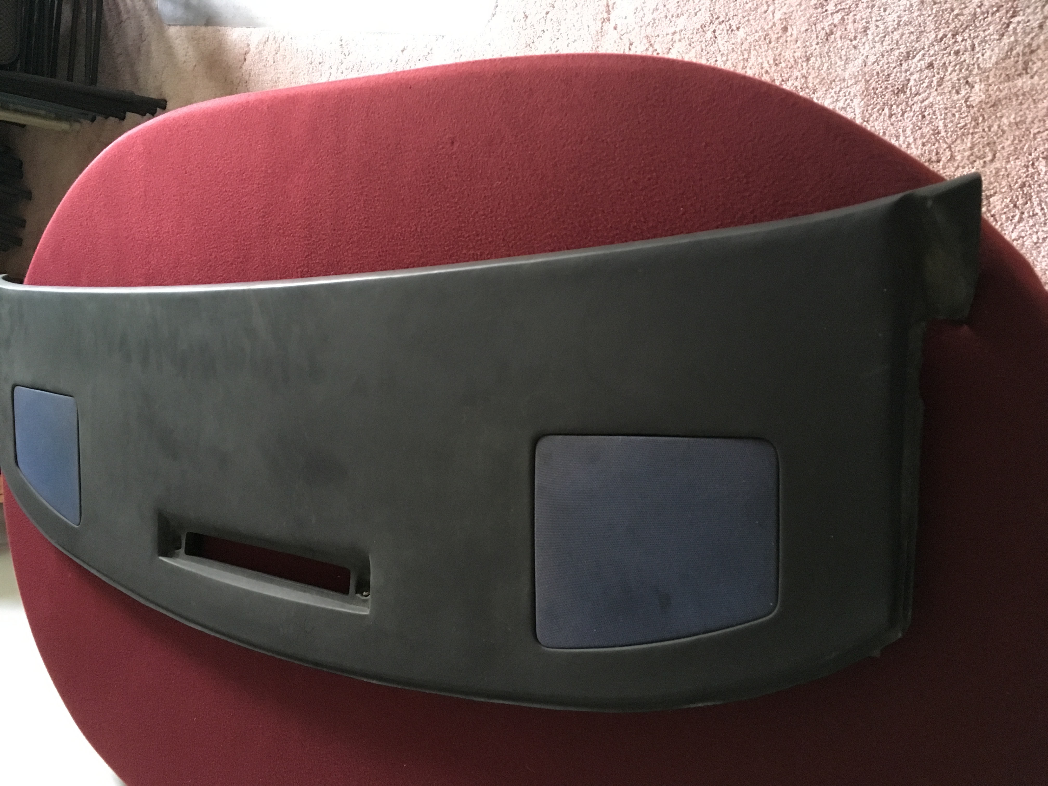

Also, surviving the prior owner is the dash pad which has no cracks and can be had for $75 if anyone is actually restoring a C4

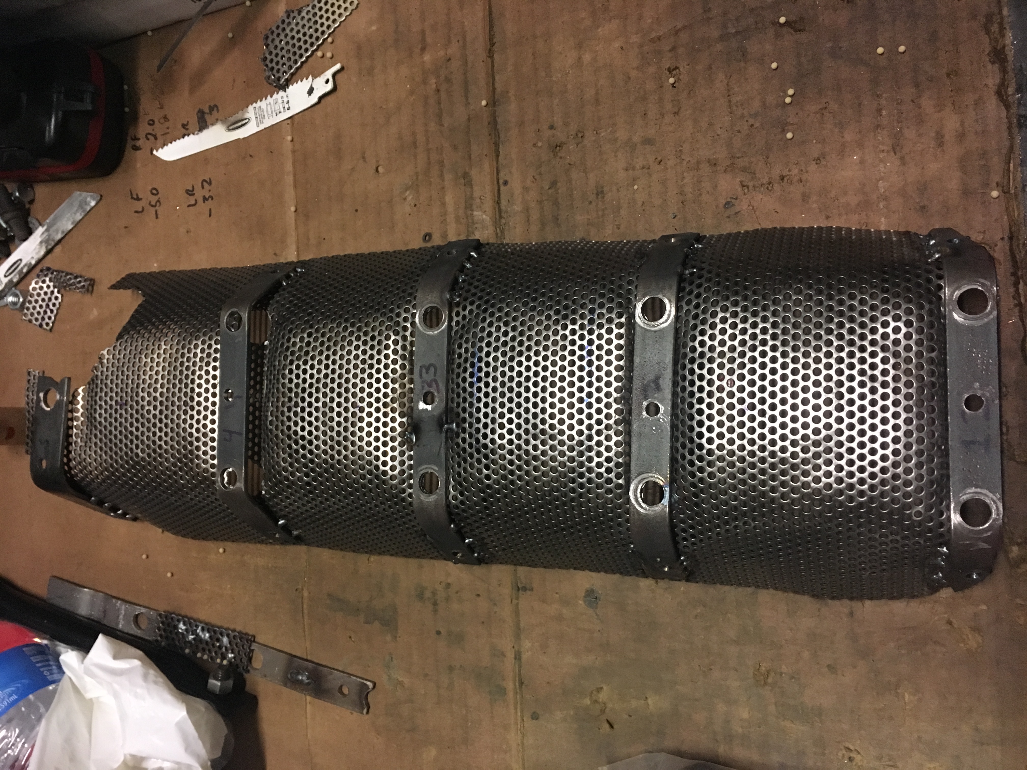

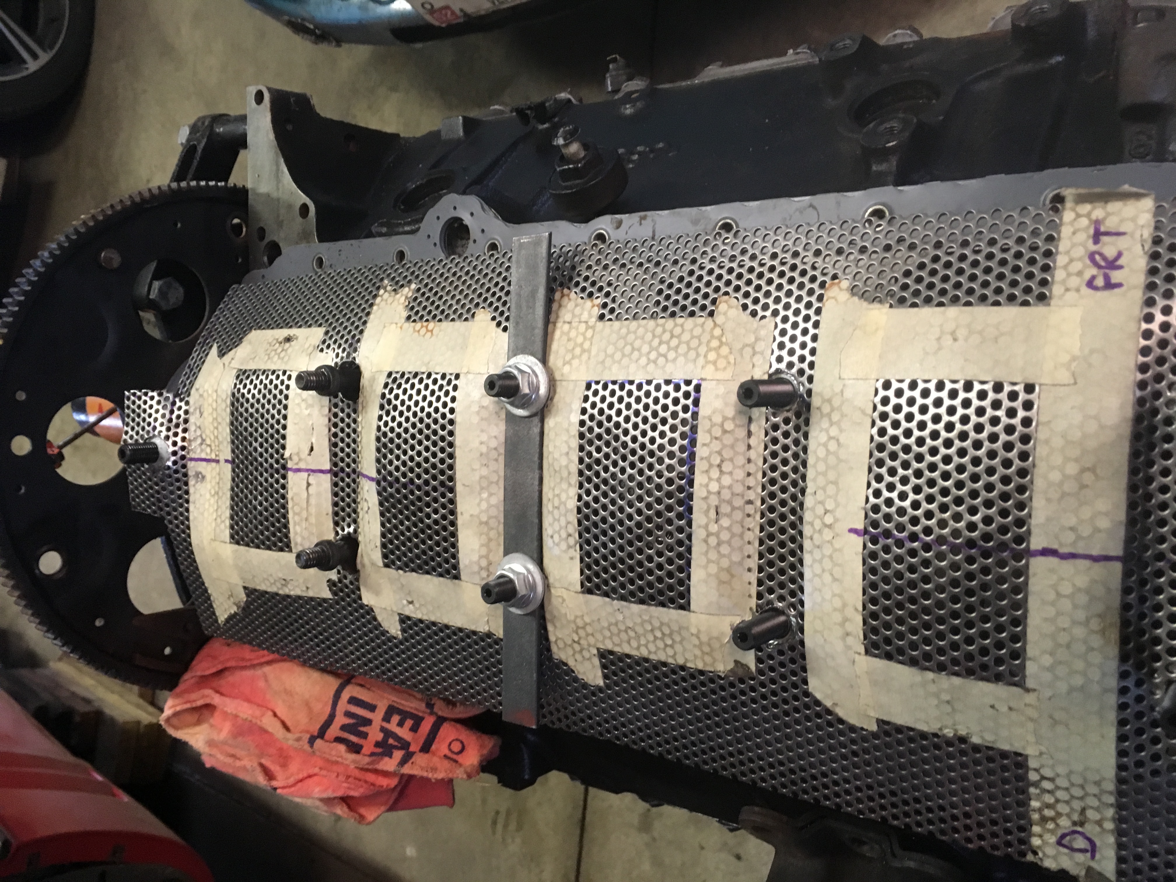

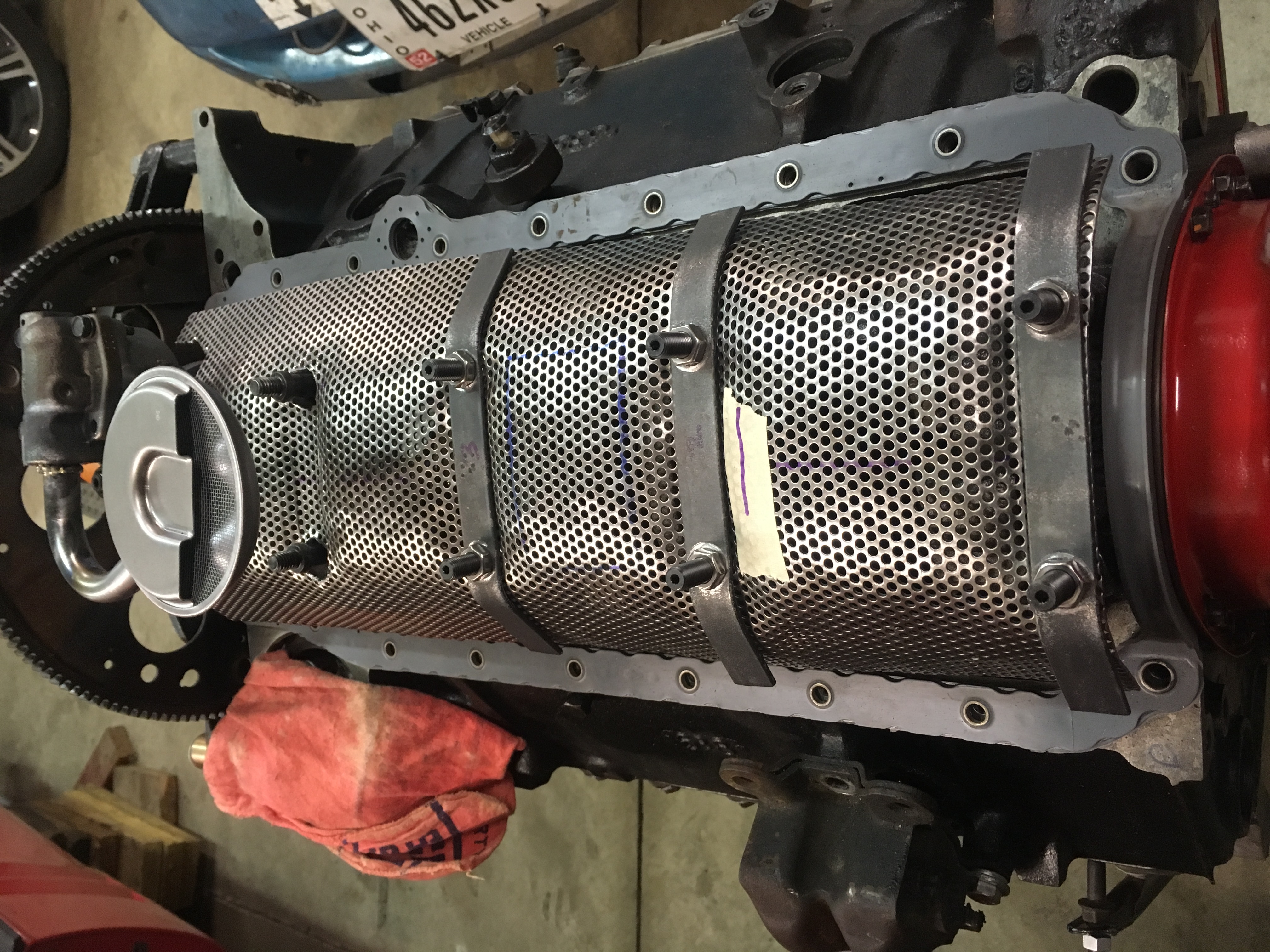

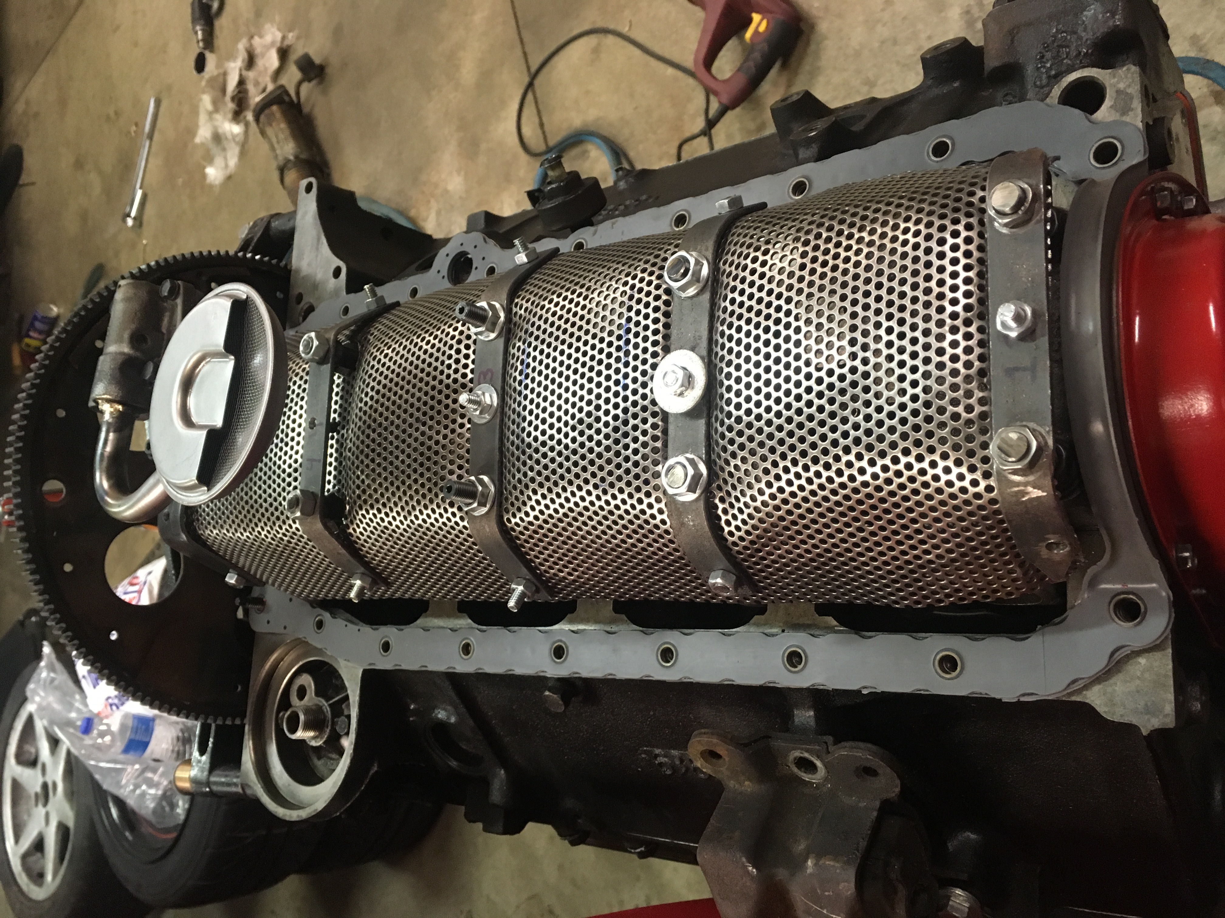

I talked with WXO this afternoon about the C4,
he would like to see a picture of the wind-age tray.
I am not sure the pictures do justice of how much hand fabrication was needed to make this tray.
