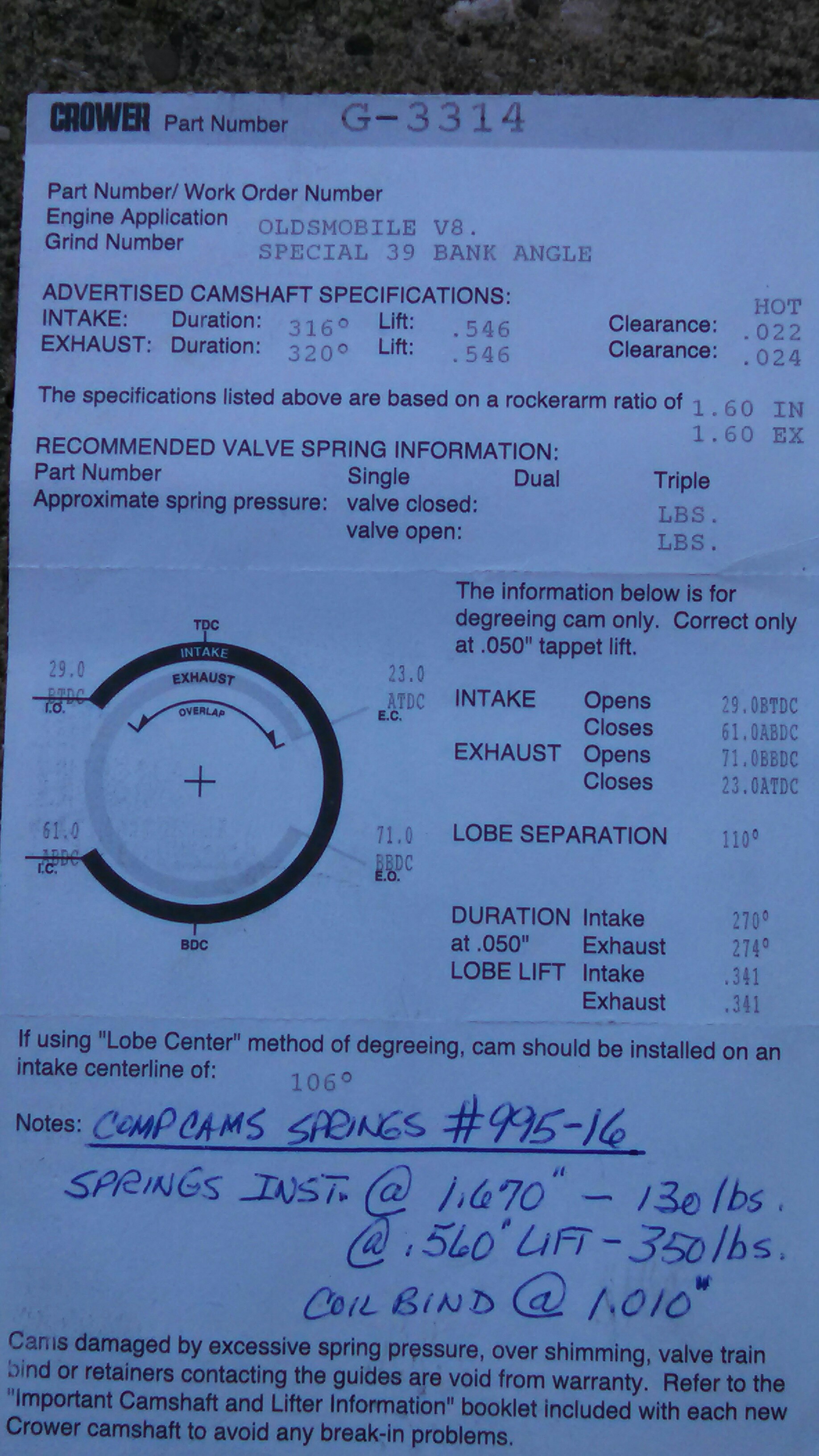

I should also have asked what do you know about the cam as far as recommended idle RPM, power BAND, etc.
Posts: 1299
Re: 1966 OLDS 442
The previous owner gave us the cam specs, but they are in my barn now. I'll post them this weekend.
I know that it's a .540 lift cam, but don't know duration and such off the top of my head.
Posts: 1299
Re: 1966 OLDS 442
Here are the cam specs for the 442:
Posts: 1299

With that big of a cam, those gears, and a pretty good sized motor with good compression, if you can hook it up at all, it should be in the mid 13's once you get your tune dialed in. I bet it sounds sweet too. That's the one thing I forgot to do when I stopped to look at it is have you fire it up. Duh.

So, I was out cruising late last night. 50 MPH per the GPS in my phone was around 2,250 RPM. That's with 3.36 rear gears and 255/60/15 tires. Now, my small tach is hard to get very accurate readings on when driving at night....while trying to sync up to a GPS reading.
Also, am I reading that cam card correctly? 270/274 duration @ .050 lift? Is that a solid lifter cam?
Posts: 1299
Re: 1966 OLDS 442
Blue_69_malibu wrote:So, I was out cruising late last night. 50 MPH per the GPS in my phone was around 2,250 RPM. That's with 3.36 rear gears and 255/60/15 tires. Now, my small tach is hard to get very accurate readings on when driving at night....while trying to sync up to a GPS reading.
Tony ----
I'd love to have those lower RPM's while cruising. I'll definitely be working on that, it's high on the priority list.
As for the camshaft, I'll have to look at the paperwork the guy gave me to see if I can figure out if it has solid lifters
in it. I did a quick check on the part # online, but that yielded no information.
