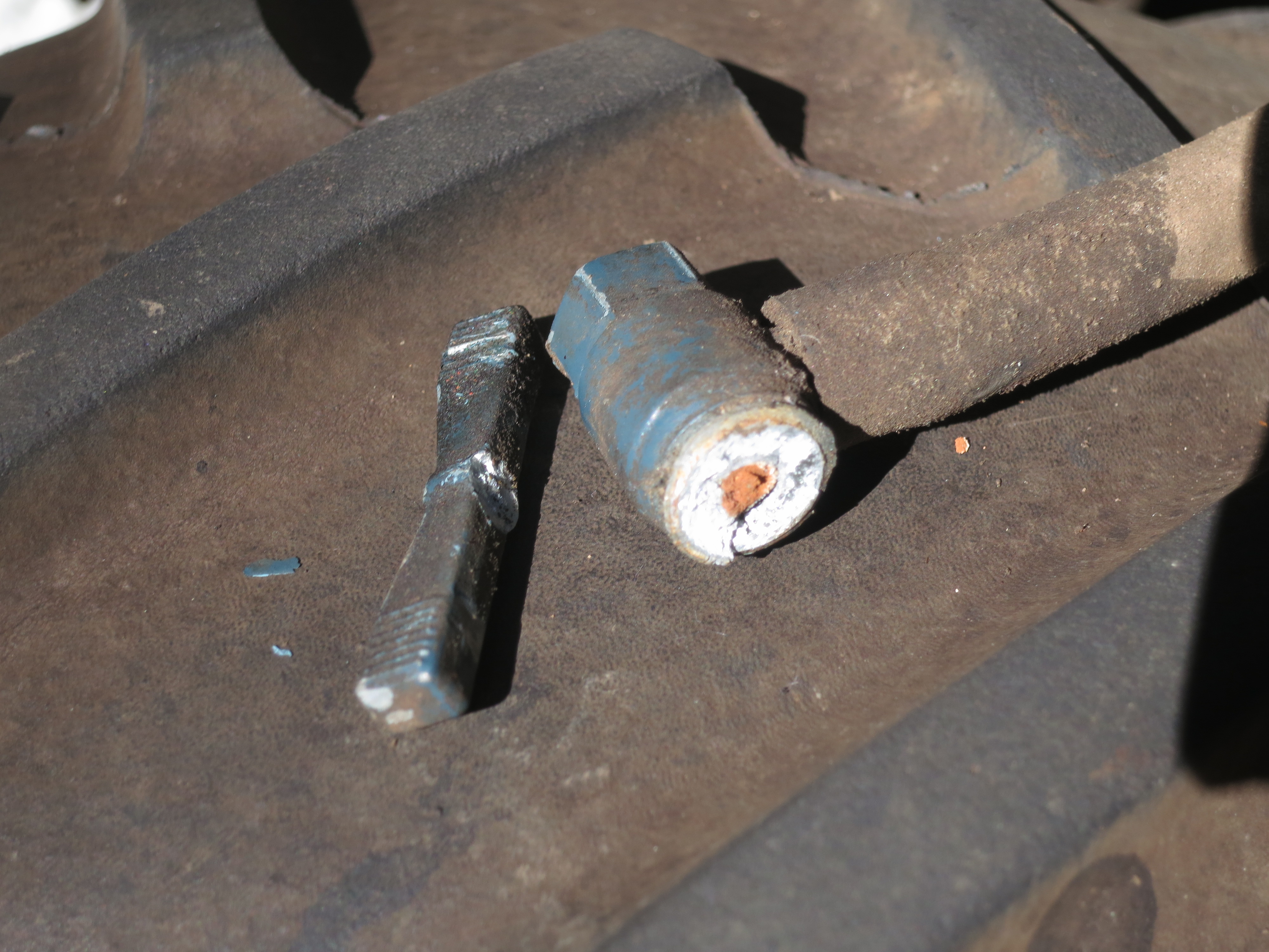

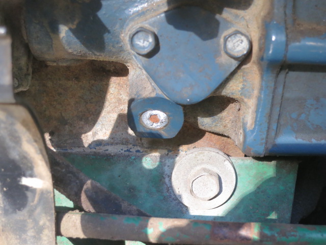

After replacing the hydraulic hose, it was time to change all the fluids and get the old girl back to work. When I tried to open the petcock to drain the block of antifreeze, this happened:
It turns out that the petcock is aluminum. I guess thirty-some years in service was too much for it. After I broke off the handle, I put a socket on the hex part of the main body and broke the whole thing off. Drilling it out wasn't too bad because it was aluminum and very accessible. Bruno gave me a tip that worked very nicely to remove the outer portion left in the block. He suggested inserting a hacksaw blade and cutting slots at 12, 3, 6, and 9 o'clock to segment the remaining aluminum ring. It worked like a charm. Tapping around with a punch dislodged the segments and out they came. The threads were serviceable so I just replace the petcock with a steel plug I had in my parts drawer.
After adding oil and hydraulic fluid, I poured in some cooling system cleaner and ran it for a while then rinsed it out a few times. I don't think the cooling system cleaner helped at all. I couldn't see any difference. Anyway, Gladys is back up and running better than ever. I have a few more things to do, but the major problems are fixed.

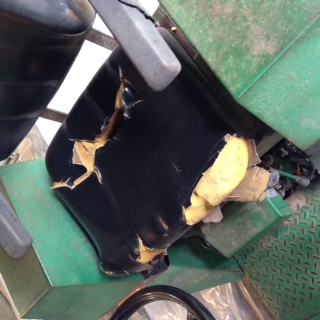

But first, Gladys and I need a new seat. I like this OEM one because it has a drain hole at the lowest point.
They are still available at Steiner, but they are grey and cost $236.

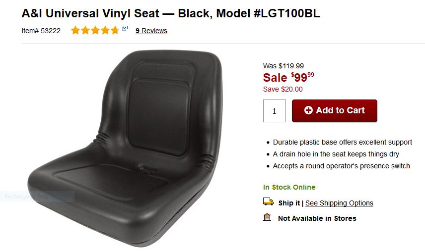

I've decided to simplify Gladys' seating arrangement by eliminating the arm rests and just going with a simple seat from Northern Tool.
It was one of the few I found with a drain hole for water and had some good reviews.

Add shipping costs and it comes out about the same. I'm near a Northern Tool store, so I can pick it up there.
