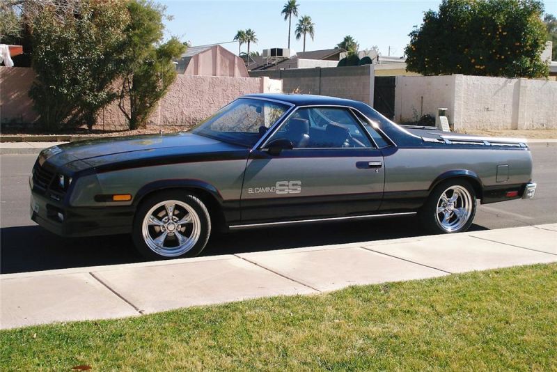

The tires were manufactured in 2004 so should be replaced for any more Interstate driving. (Lucky they held up for the NY-NC trip!!) The Rally wheels don't really go so well with the El Camino and the 225/65 15's rub on the left lower A-frame. (Wheel width and back space unknown.)
WXO and I really like this paint and wheels.
WXO says that's a Monte Carlo SS front end but the '81 El Camino front end would look good too. If I decide to do paint, I'll try to find someone who will spray it after I do all the disassembly, prep and reassembly. Have two possible painters in mind.
Blue interior wouldn't be the best with the silver and black paint but wouldn't be too bad.
I wouldn't want to put a bunch of money into body and paint AND make expensive performance improvements.

I've always liked a good two-tone -- but I'd take the gray all the way down to the bottom. The Torq-Thrust wheels are classic, hard to go wrong with them. Chevy did make some El Camino SS's with that actual front-end on them. I'm pretty sure I remember seeing one on Classic's showroom floor back in the day with that same lettering. Probably pretty rare, though.
