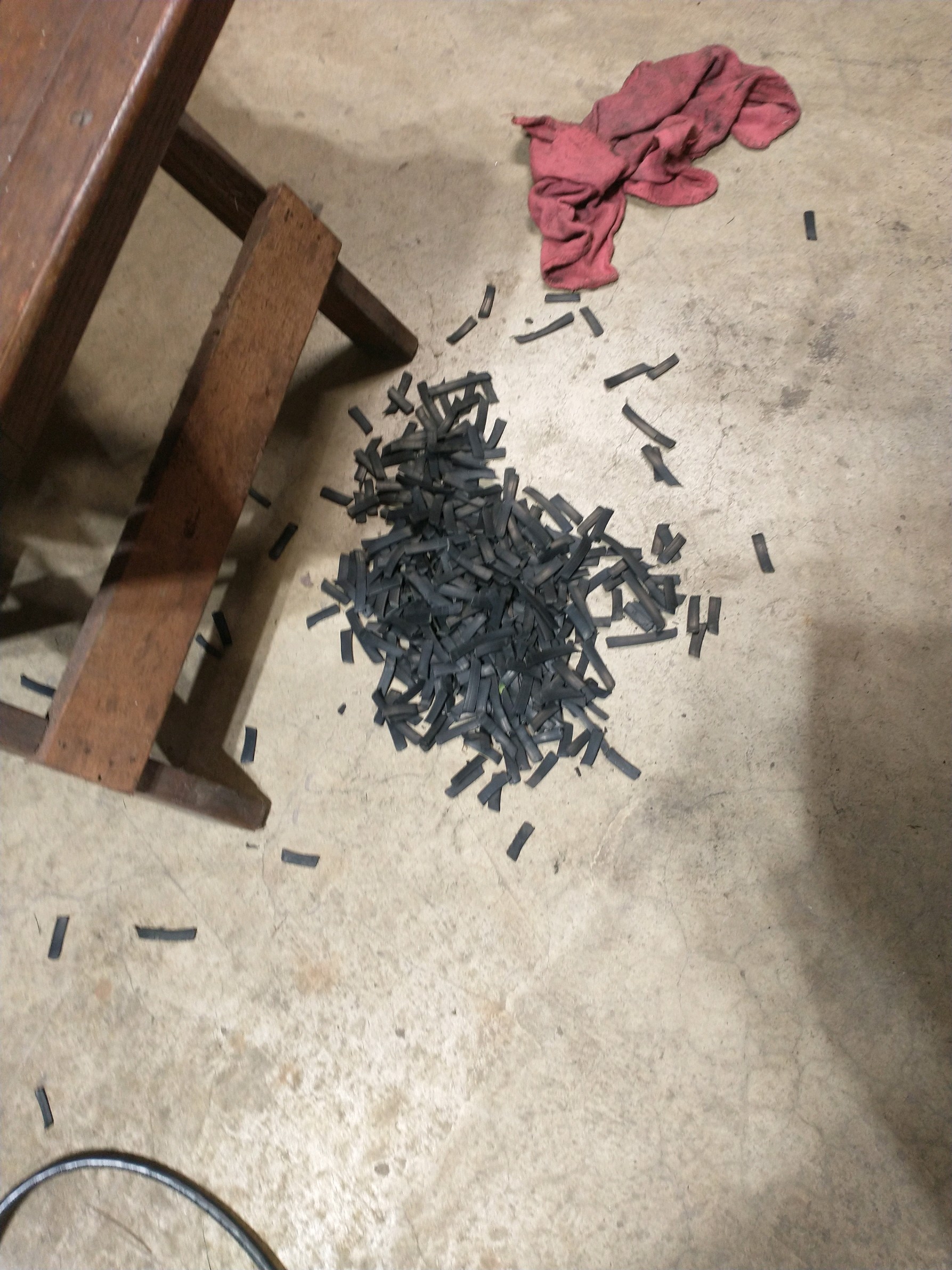

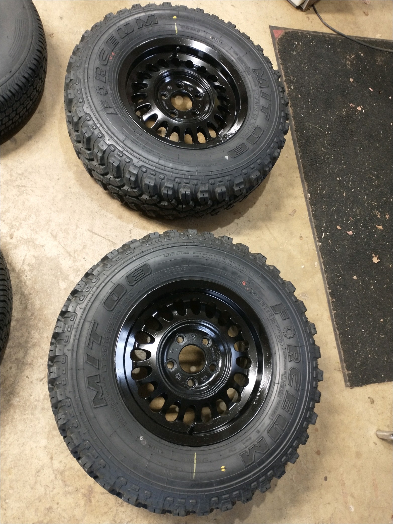

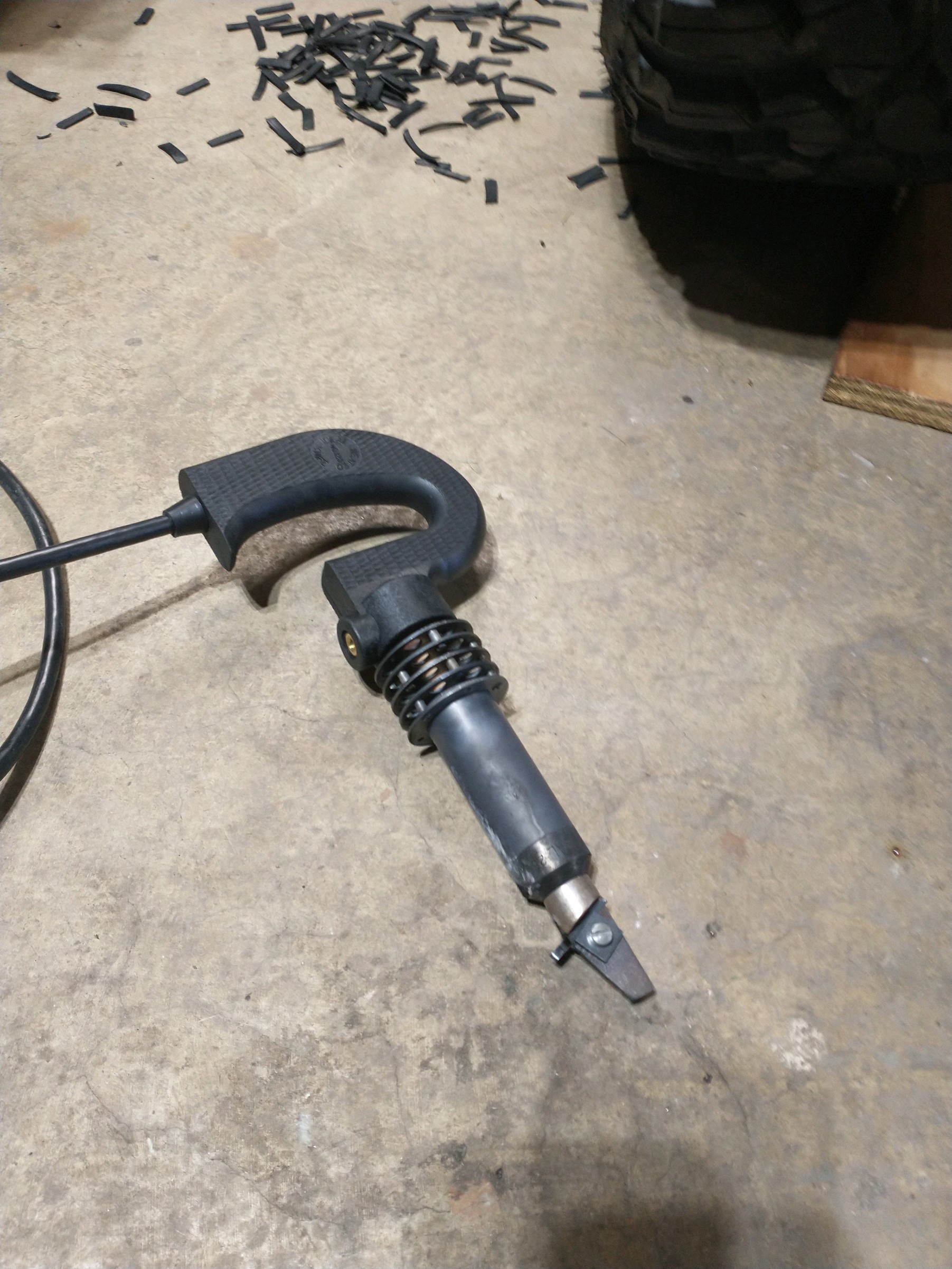

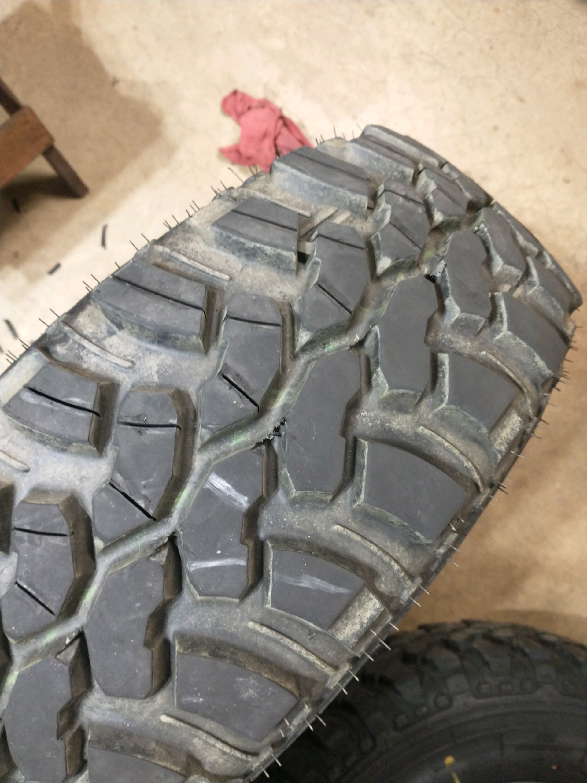

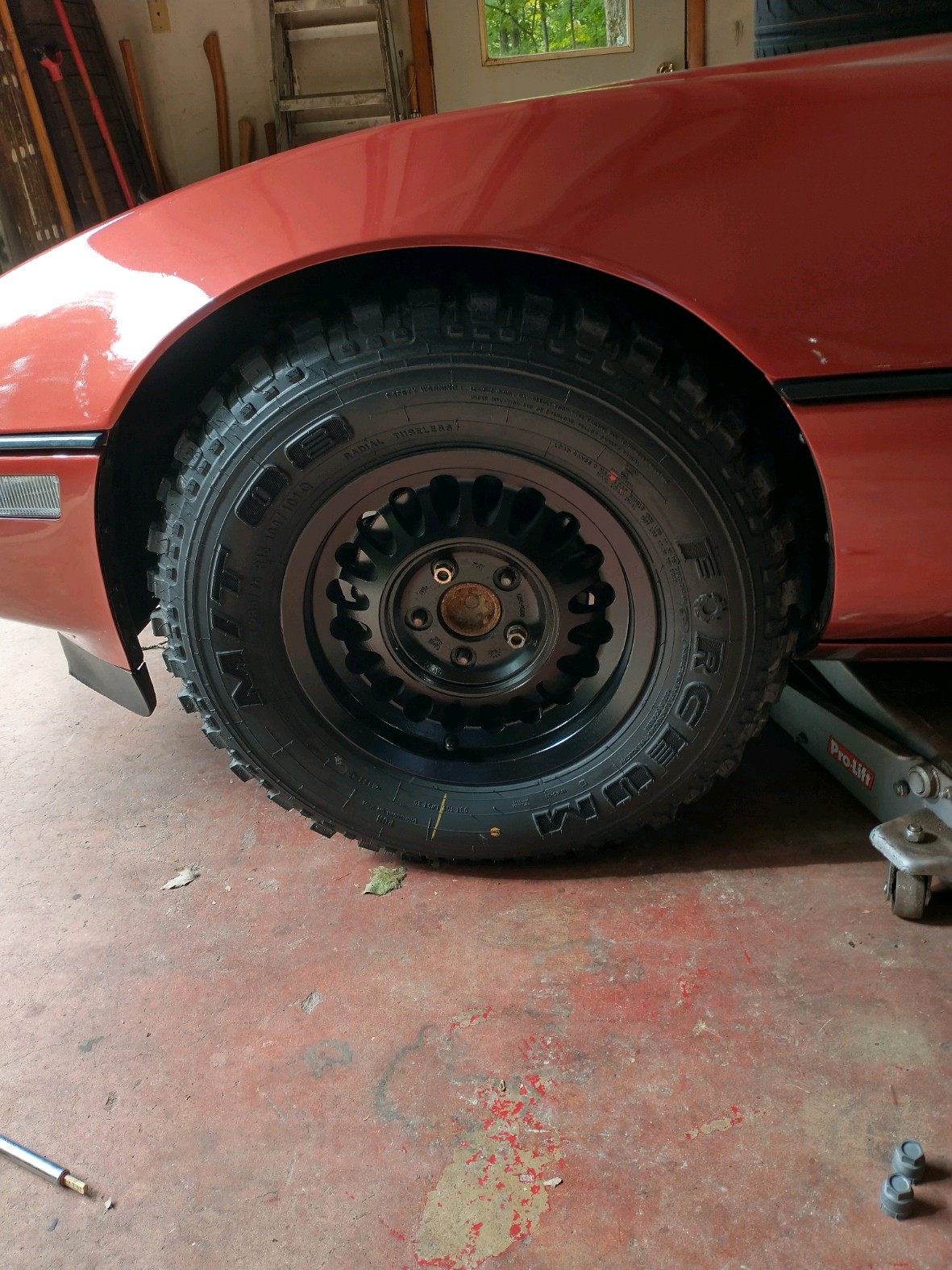

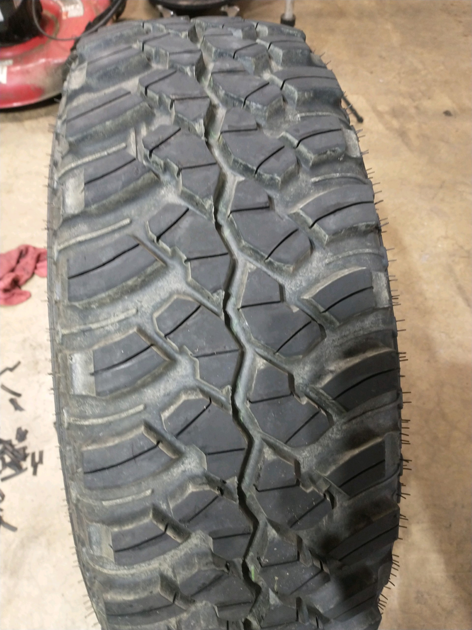

After some discussion with my buddy Tony Reed (he's the guy I go dirt racing with...maniac with a 2 stroke 4 wheeler), I decided my rear dirt tires needed more block than they have. He has a tire grooving tool that he let me borrow, and I hacked up my tires for about 2.5 hours yesterday morning. This should get me more grip in several ways, especially on a loose dirt track. The process of cutting is pretty simple, it's just a HOT iron with an adjustable height small u shaped blade on it, and you hold the tire with one hand and push with the other. It's requires some effort, but you don't need to be a gorilla to do it. After you do this several hundred times, your tires are ready to go.
The one picture shows half the treads done, and half not. I'll be ordering the 215-75r15 front tires this week sometime.

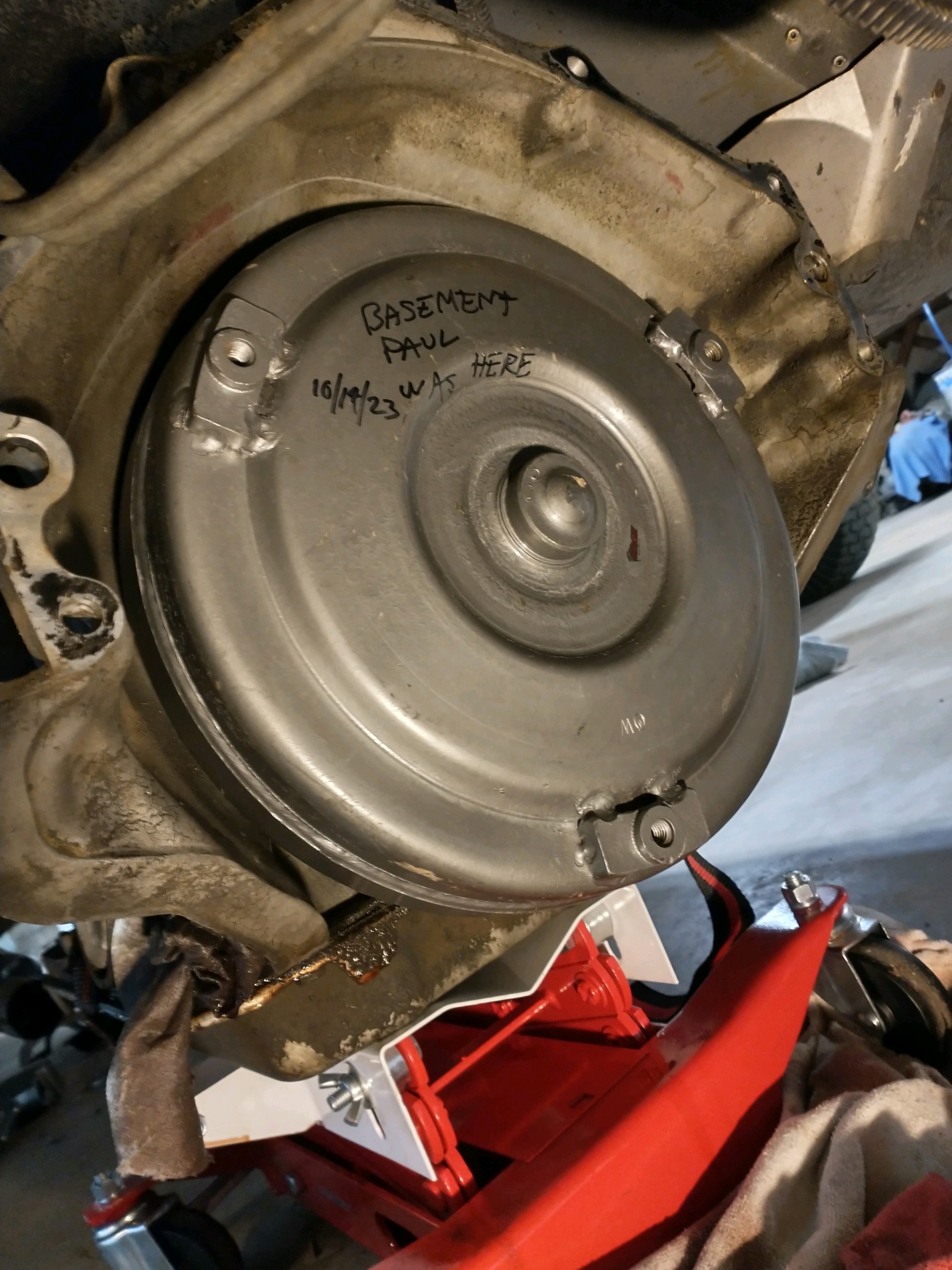

We've been working on the torque converter swap since last week sometime. So far we have three sessions maybe 3-4 hours each, but we're getting close to having it back together. No major surprises, just a lot of steps. The transmission jack from Harbor Freight though not perfect, made handling the transmission a relatively safe and light job for one person, so worth the money if you plan to swap one on the floor.

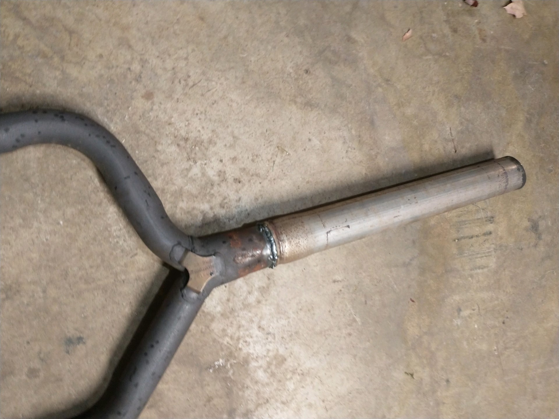

I took the Y-pipe home after the first session to weld up a previously clamped and not perfect connection where the old big cat converter used to be. As the car sits right now, the converter is in, the trans and motor are bolted back together, the torque arm is bolted in place, and the new trans pan (with plug) and filter are installed. When I was going to put the driveshaft back, I noticed the rear u-joint was pretty stiff, so we're going to replace that one for sure. The front one seemed pretty good still.
What's left is the driveshaft, exhaust, torque converter - flywheel bolts, inspection cover, reinstall the dist cap, hook up the shifter cable on the trans, and hook up the TV cable on the t-body. Add oil and hope for the best.

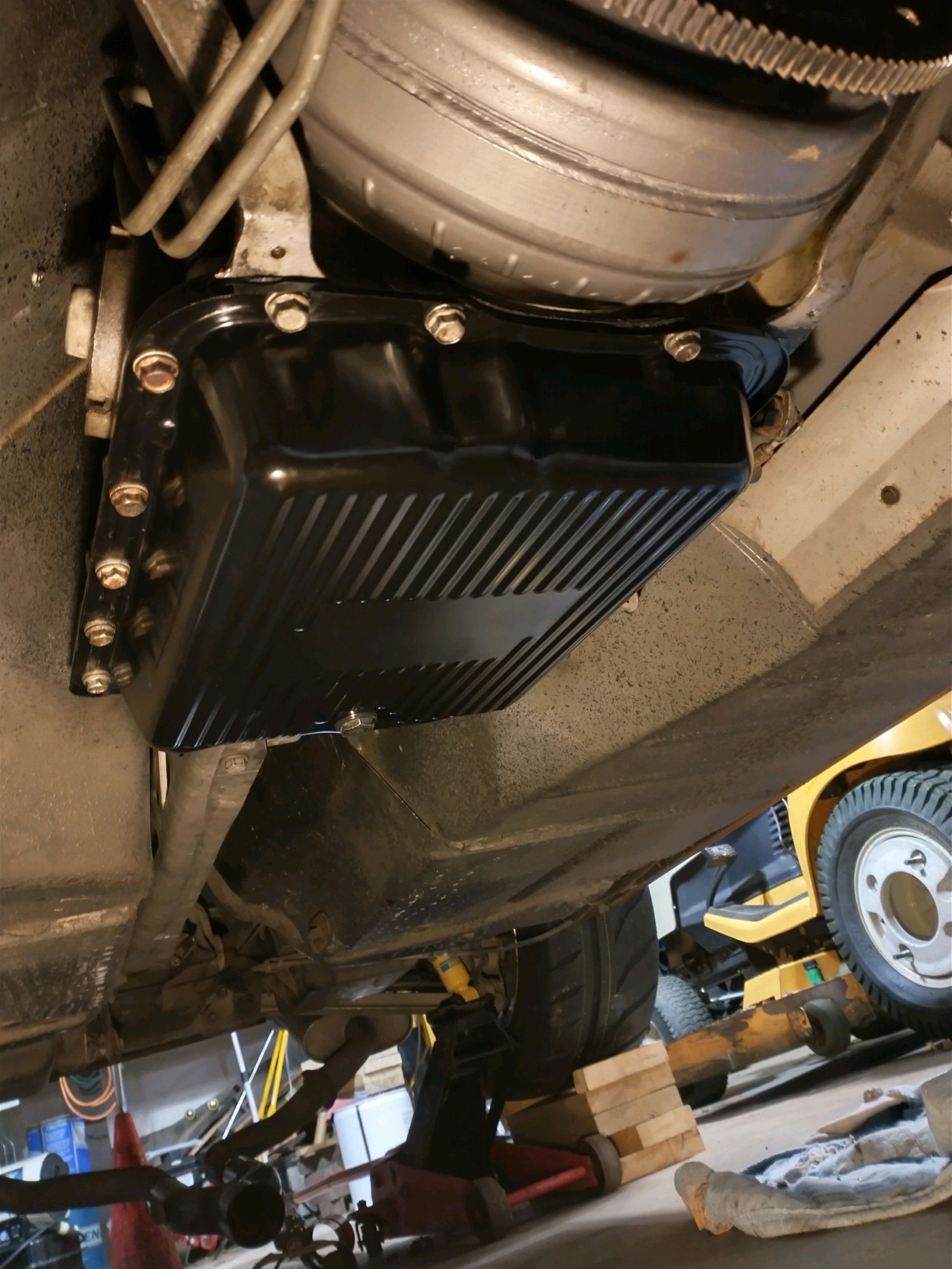

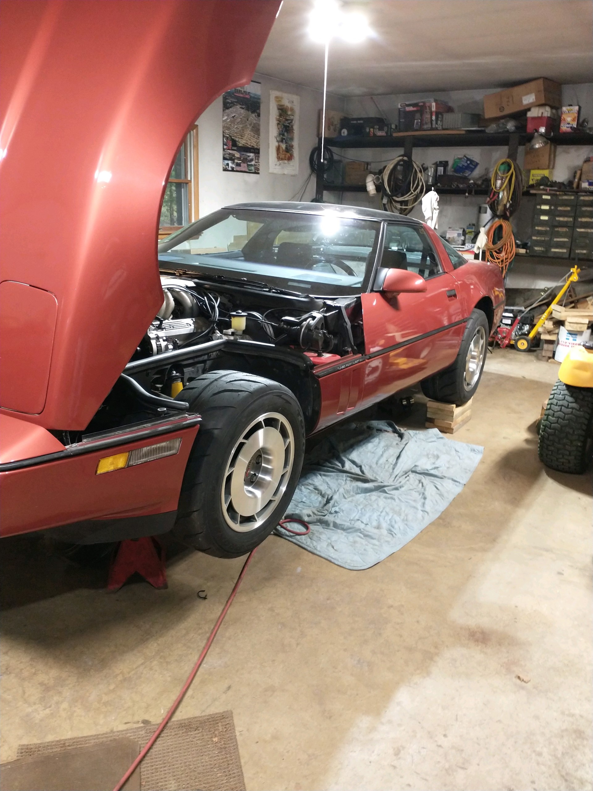

Today we finally got all of the pieces of the puzzle back together and we're able to get the Vette off the jackstands. With 10qts of tranny fluid the stick showed full before our test drive.
The converter definitely feels peppier both off the line and through the gears. One quick test let me brake torque up to 1900 easily and I'm sure if i push it it will be 22-2300. When we got back from our short drive, the dipstick was dry again, so we need another couple quarts.

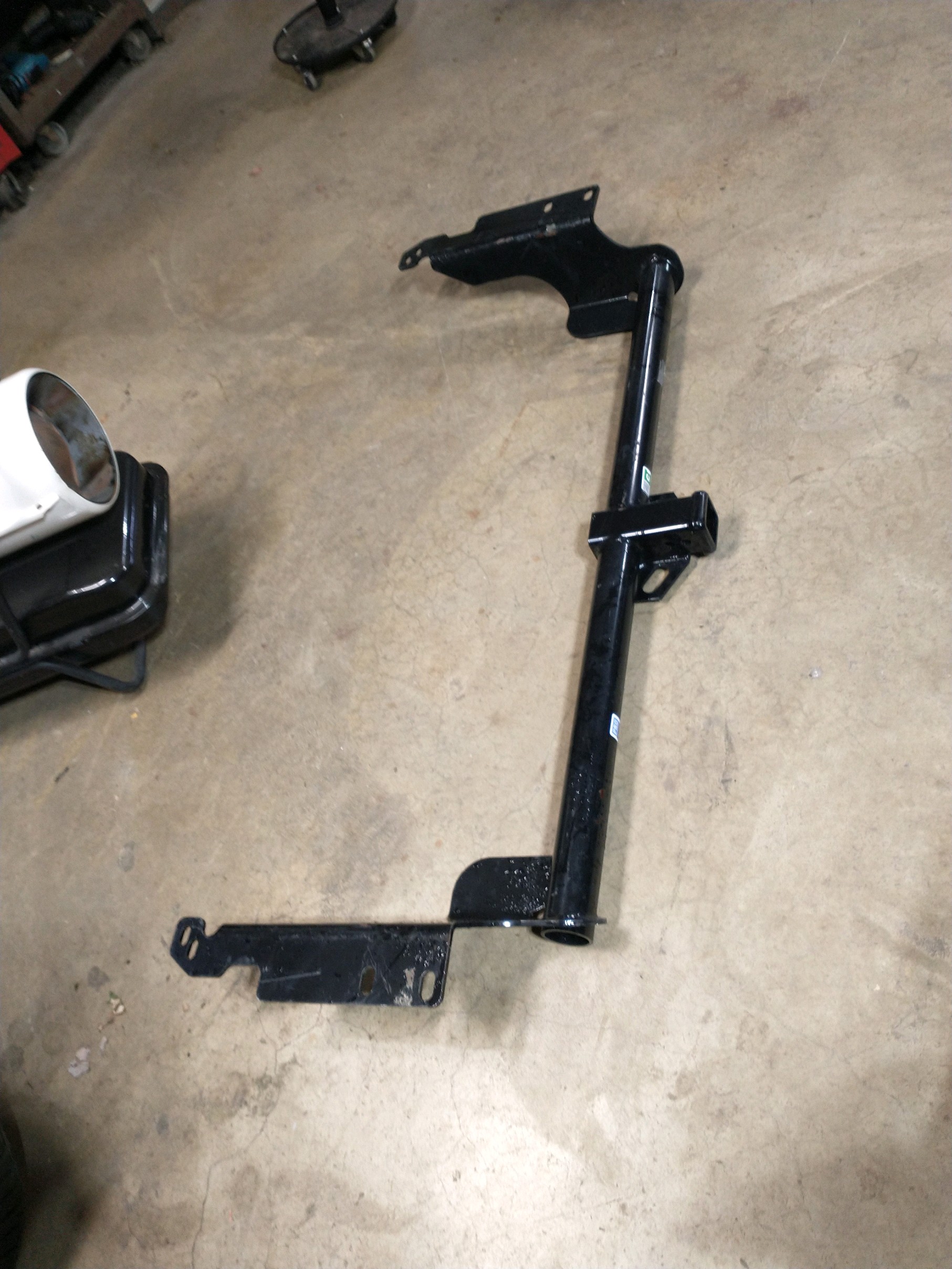

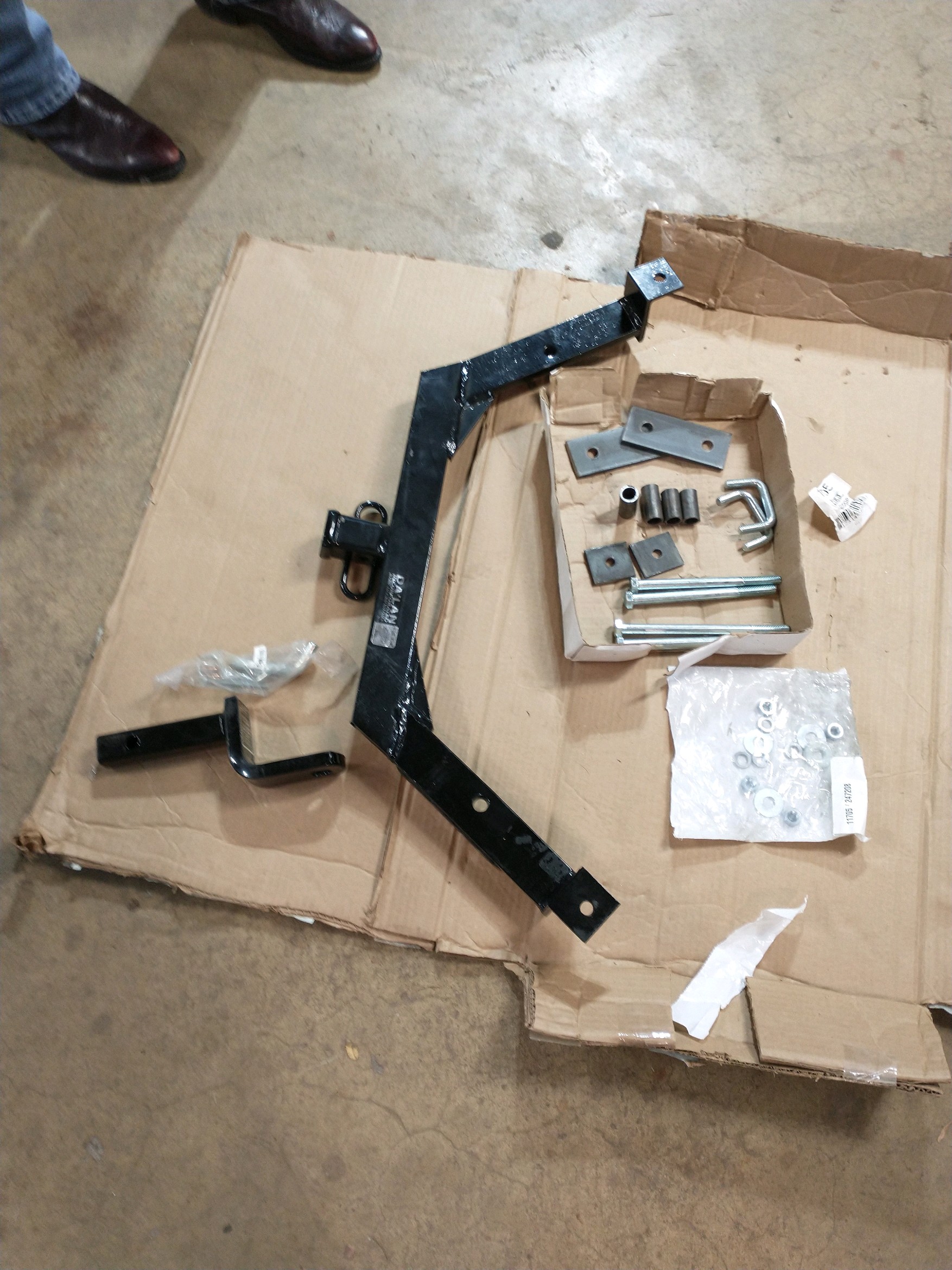

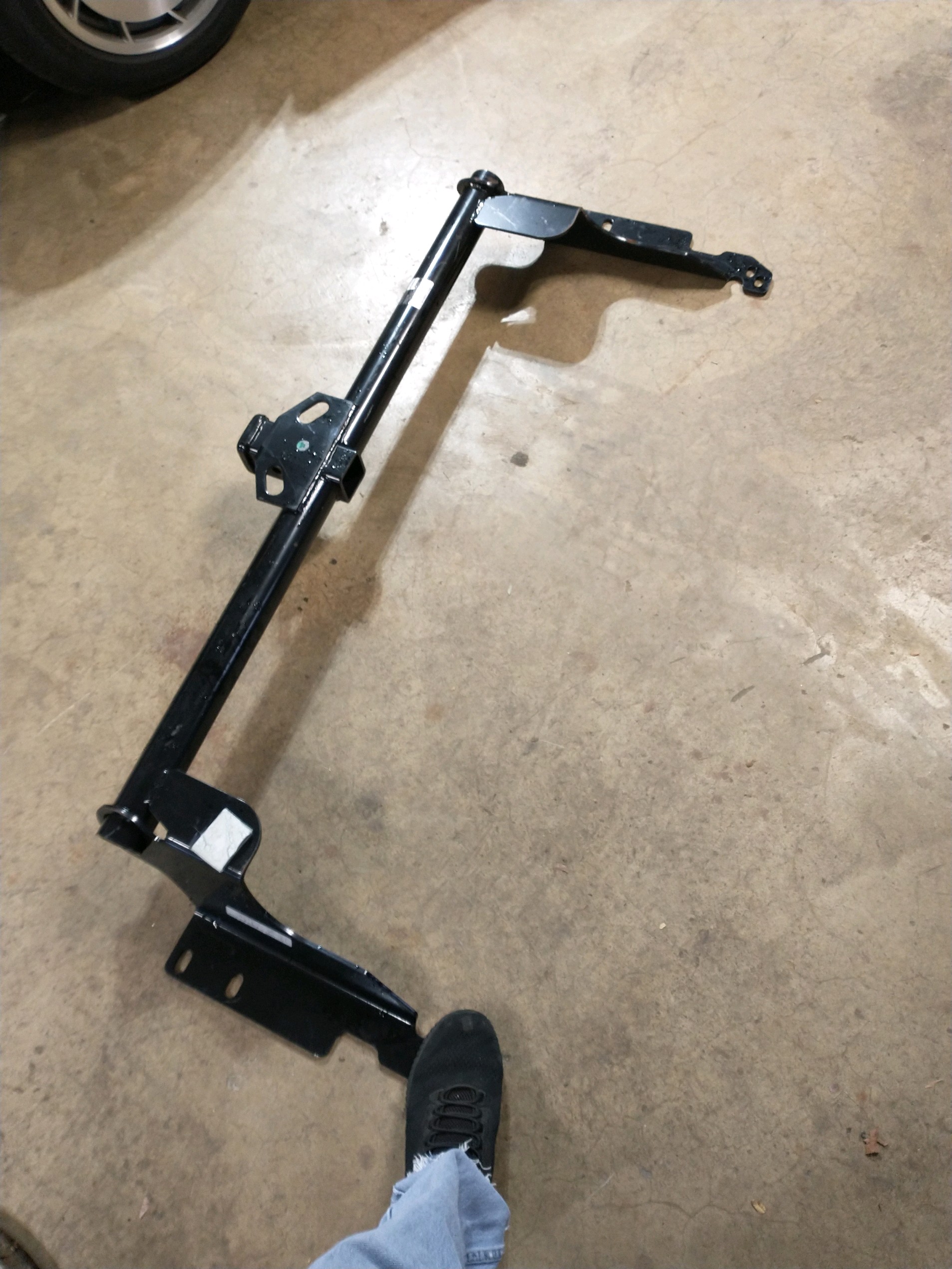

I found out recently that although Curt advertises a hitch for the C4, they have been discontinued. So on to plan B, which is to make one work. I bought the hitch pictured for $20 off FB. It's allegedly for a CR-V, but has never been installed. Basically it's too big, which is perfect so I have material to work with. I think if I cut here, and weld there, and a little drilling where it needs it, I can make it work. For $20, I'll give it shot.

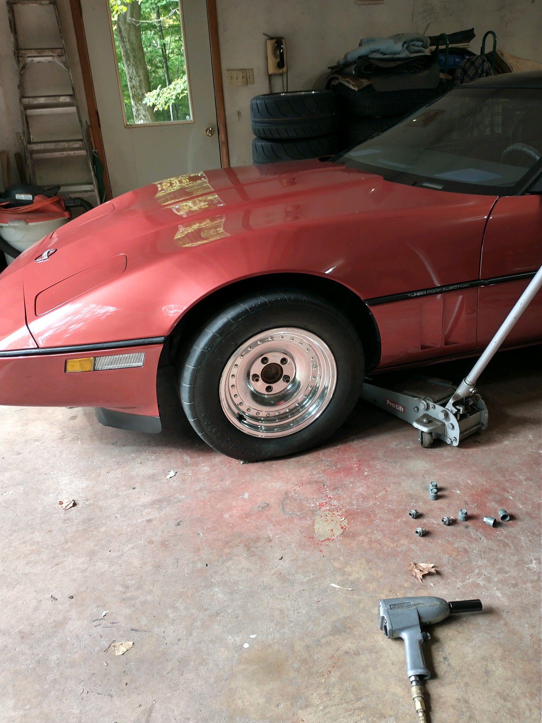

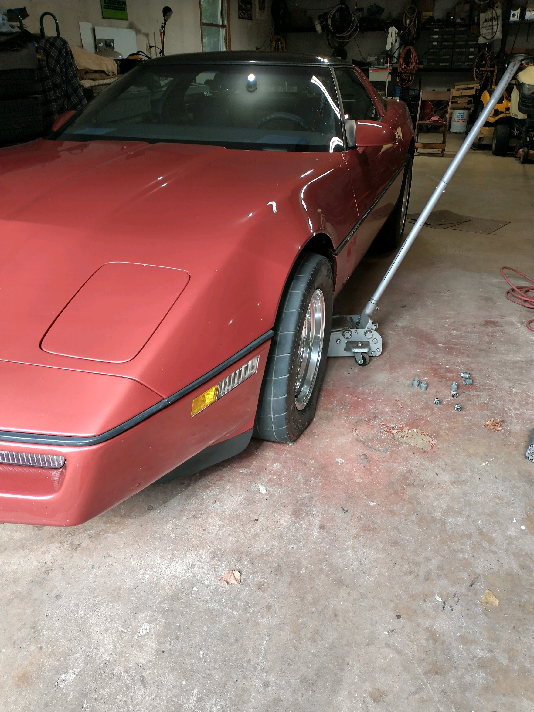

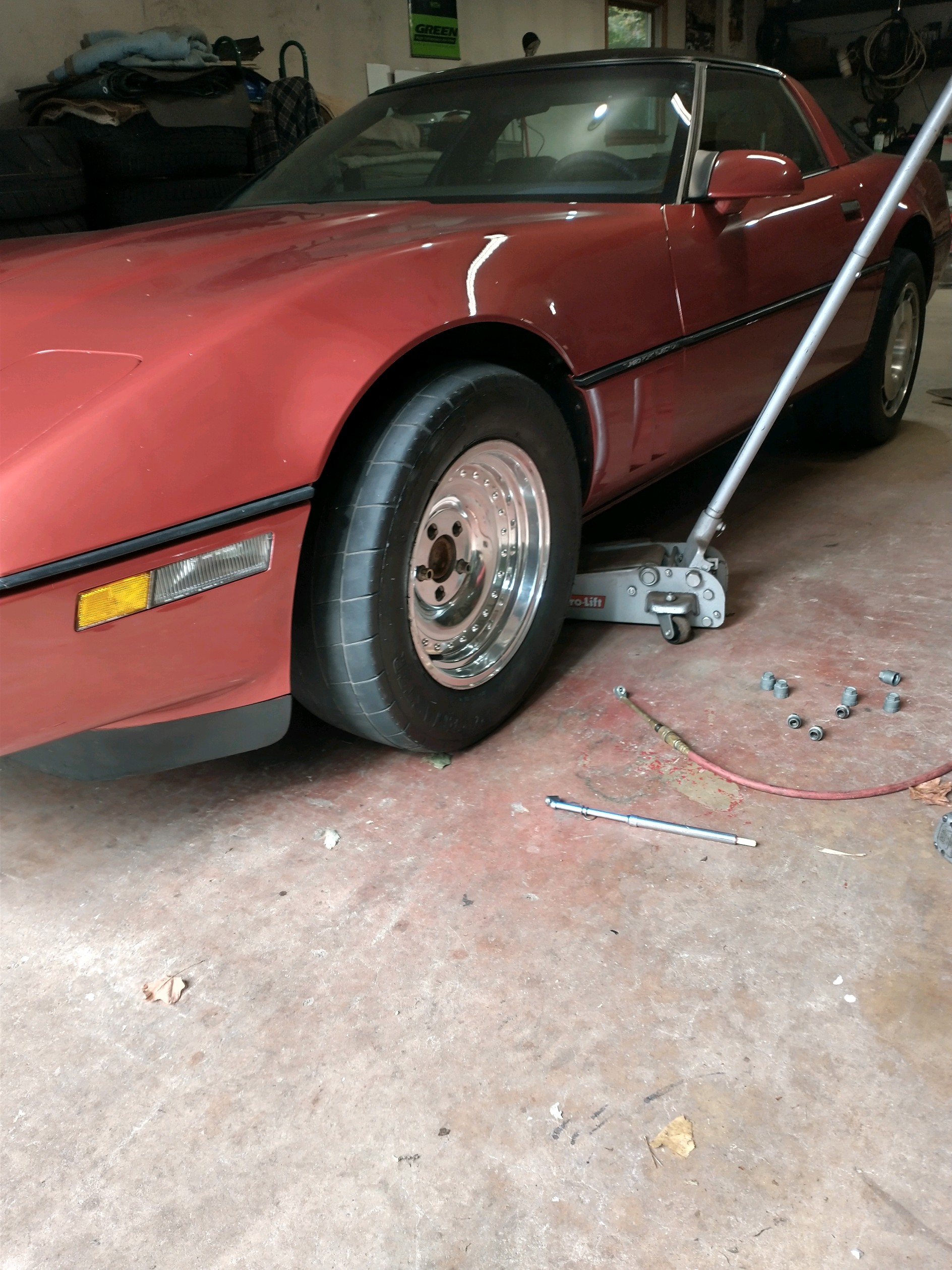

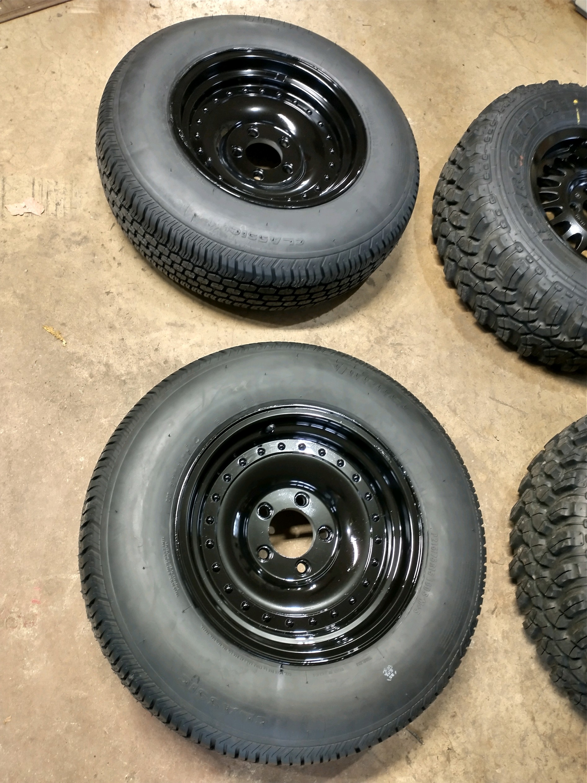

Saturday it was warmer outside, so I wanted to get some paint on the "new" dedicated front wheel combo for dirt racing. So I got those scratched up, primed and painted pretty quickly with semi-gloss black. They're still pretty wet in the pics and have since calmed down a little. The rears had a few places where I could see through the paint, so since I had the paint out, I recoated those too.
I got the car all jacked up in the front and back and got to work changing the rear differential fluid. Since there's no drain plug, you have to suck the fluid out. 40 degree gear oil moves a little slowly, but I was able to get about a quart and a half out of the rear. It holds just under 2 quarts total from what I've read. So now it has 4oz of posi lube and almost a quart and a half of new synthetic fluid.

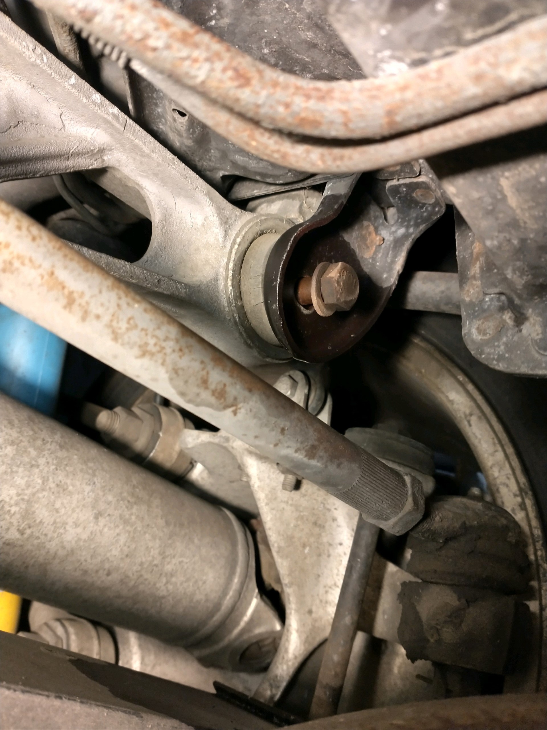

While I was under the car, I noticed one of the bolts that hold the rear suspension assembly was LOOSE. Turns out the nut back out, but has not fallen off, and it doesn't really look like the hole has been wallowed out at all. I ran out of time but will attempt to retighten it next time out. I did lube it up in the meantime. Looks like it has been this way for some time.

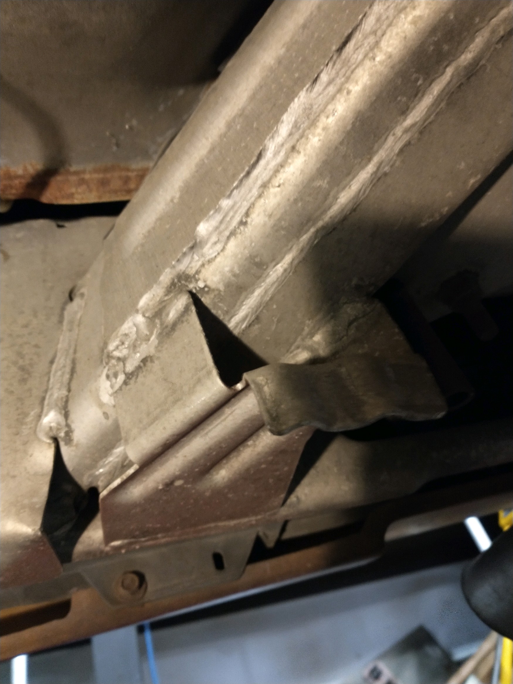

We got the bolt in the suspension all tightened up. It wasn't very simple due to it's proximity to all the suspension crap under there. If the rear shock was out, it would have been much easier. Then we turned our attention to the trailer hitch, since we were back there. Oh, I found a NOS hitch on FB for $25 but with no shipping in MD. After messaging him, I paid him $60 for the hitch and packaging, and sent him a UPS label on my dime. All in I got the right hitch for about $76 shipped to my door. PERFECT! And then I cut up the $20 hitch and put it in the parts bin for fab parts later. Anyway, after reading the instructions several times, I had to put the hitch under the car so I could visualize what they were trying to tell me. Since there's hole drilling in the frame of the car, I thought I would make sure what they wanted.
There's some odd bracket in the way that doesn't seem to have any function at all, so that got trimmed down so the hitch would at least rest solidly against the frame. At that point I was able to vice grip it in place so I could start drilling without having to do a bunch of measuring and guessing. I'm to the point where the exhaust has to come down and I got a message from Jim Curtis that he had a cancellation at his body shop and I could get my S10 in sooner. Since it was a nice day Saturday, and he was going to be back there later in the day, I got to work securing a trailer and getting home to get everything loaded up.

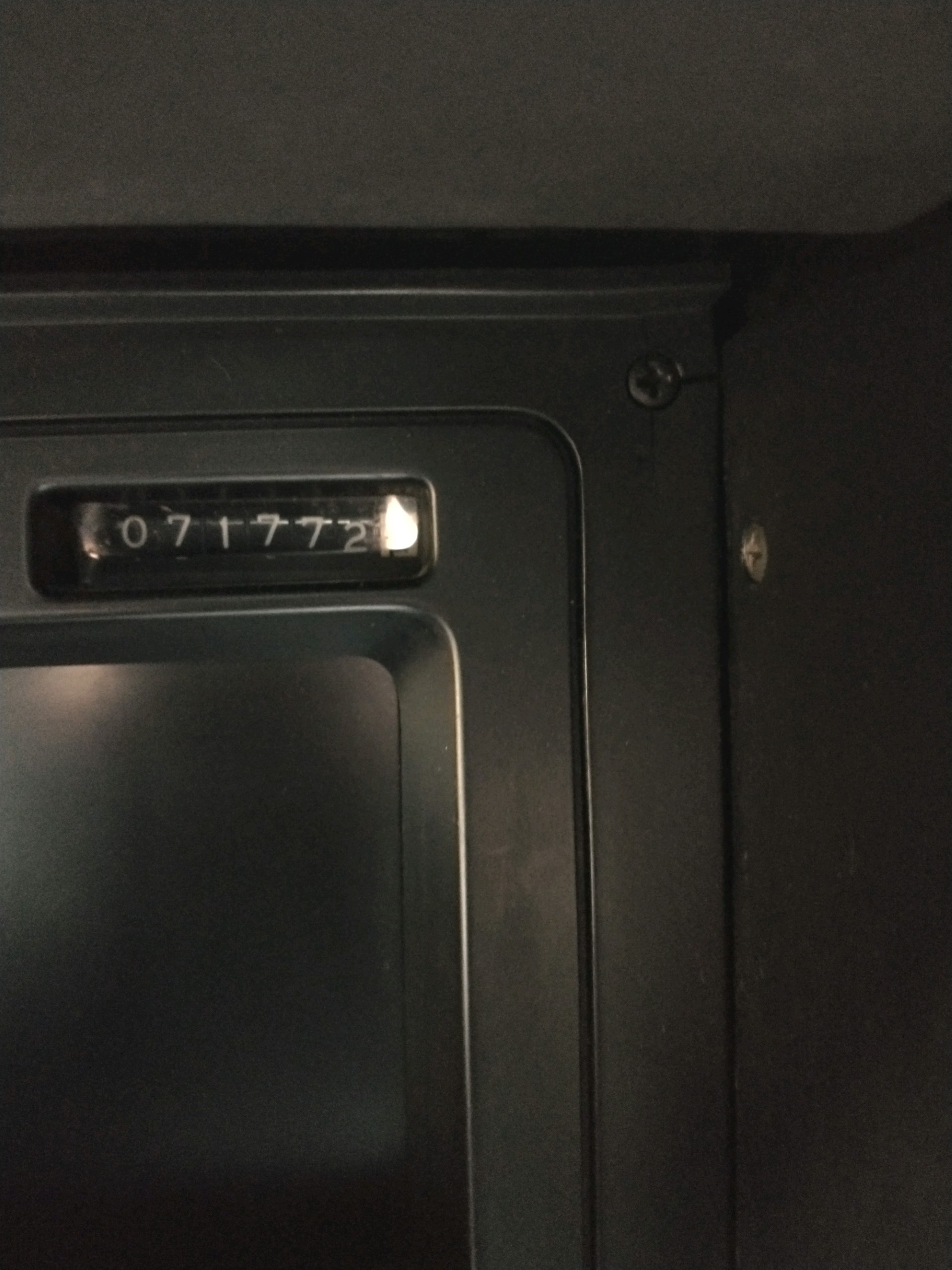

Then we changed the oil as it had most of a season full of drag strips, dirt drags, and autocross under it's belt. Mileage is 71772 now. This time we used Quaker State high mileage synthetic. I used Quaker State normal synthetic last time that came from the Dave Bales collection, but I was pretty satisfied with how it worked in both the Corvette and my Ranger.

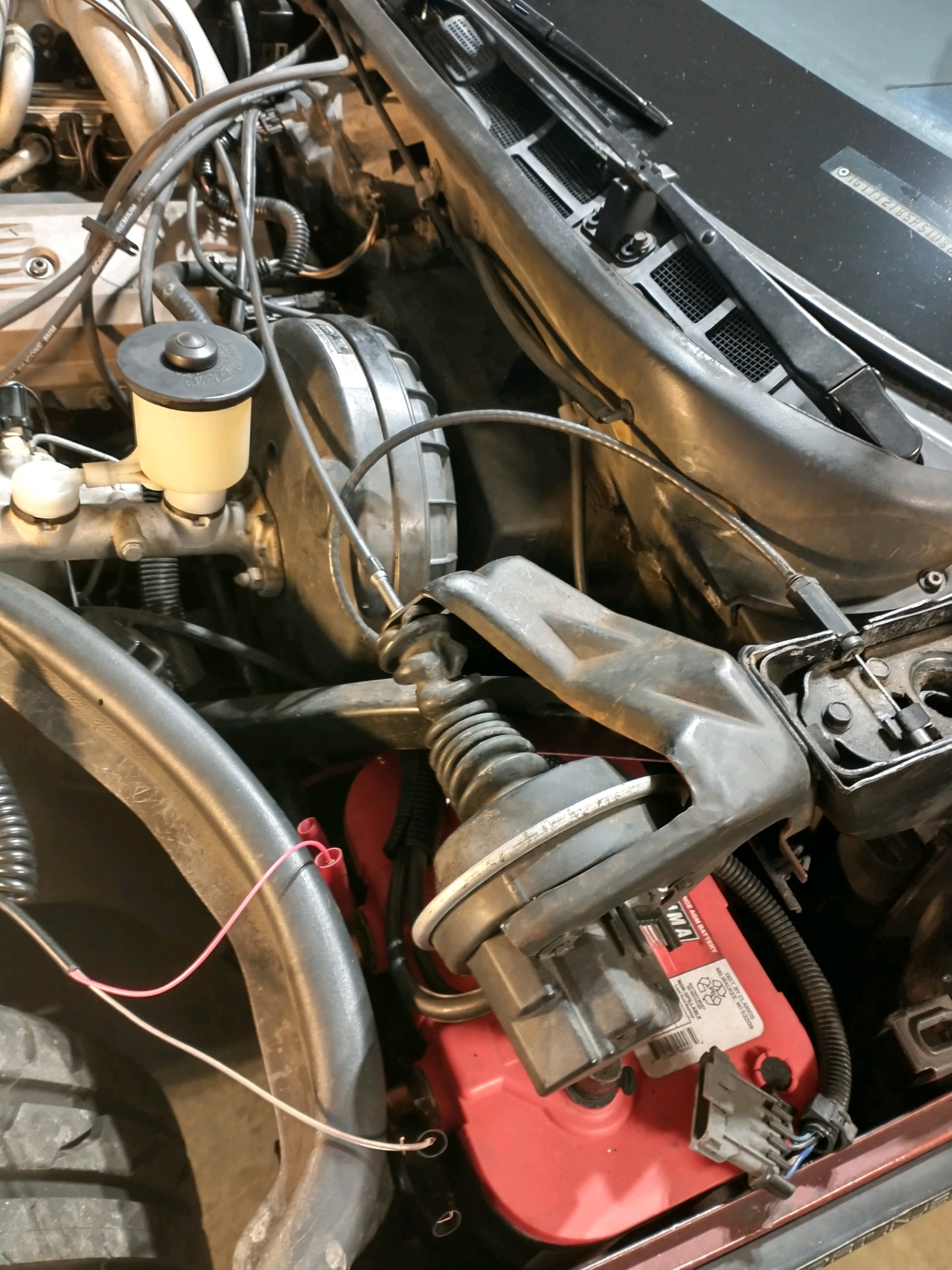

The last small project was removing the cruise control bracket, cable, hoses, and controller. This was only about a 15 minute job, but one less thing to clutter the engine bay. It didn't work anyway, and I didn't think repairing it was necessary. Saved a few pounds too.
