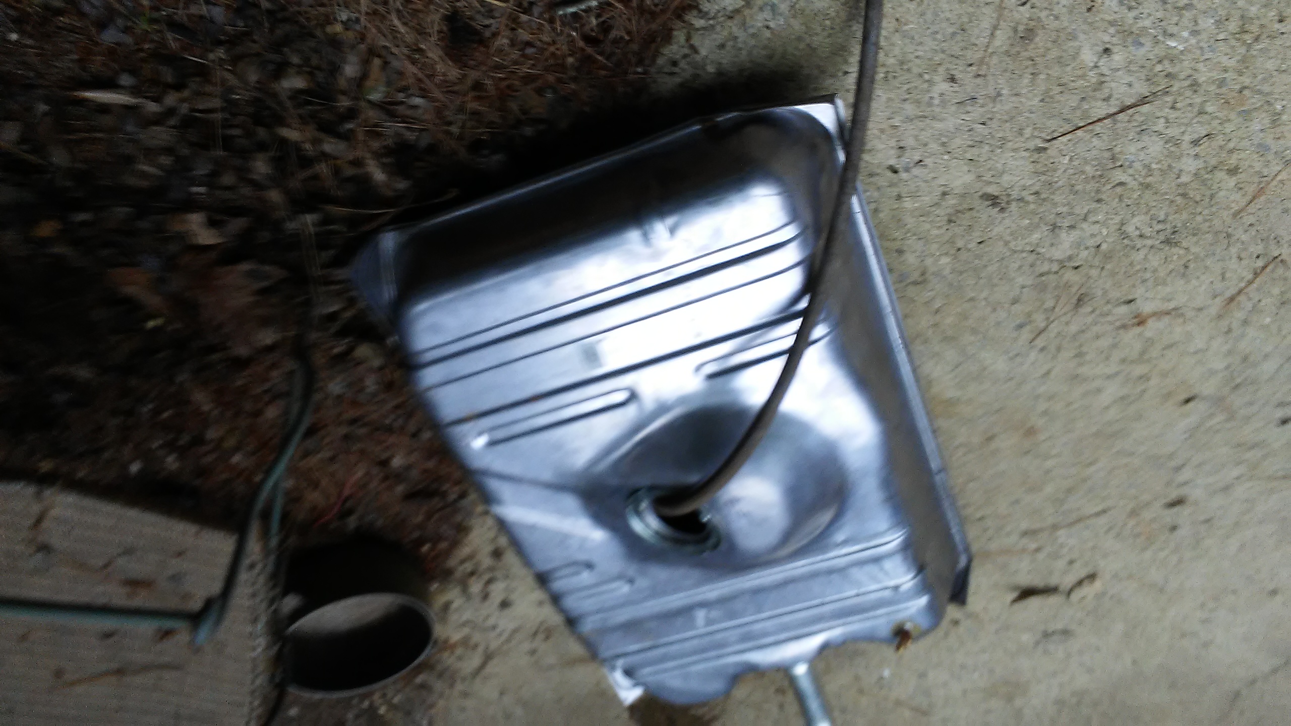

Fuel Tank Vent
The first 5 gallons of fuel went into the new tank no problem. The second 5 gallons had to go in VERY slowly, maybe 2 gal/minute.
Turns out the aftermarket tanks are not vented correctly for filling and the 5/16 vent hose I put on to compensate for expansion and usage won't handle the flow for filling.
Lots of years-old threads on this problem on the El Camino forum but it was supposedly fixed in the newer tanks. NOT fixed on this one.
A mod to the tank is required to get adequate fill rate. The fix is to tap into the tank near the top (should be some air space left for expansion) and up high in the filler tube and run a 1/2" hose between the tap ins. If interested, see post #11 in this thread. http://www.elcaminocentral.com/showthread.php?t=34336 He recommends brazing the nipples in but I plan to use an epoxy gas tank repair kit to install the nipples.

I deliberately ran the gas down low on the trip to Henry's Muffler so I could pull the tank, drill it and install the vent but I didn't know how low it got. Lucky to make it home. Tried to start it today and its OUT!!
Guess the fuel tank vent gets moved up in priority.

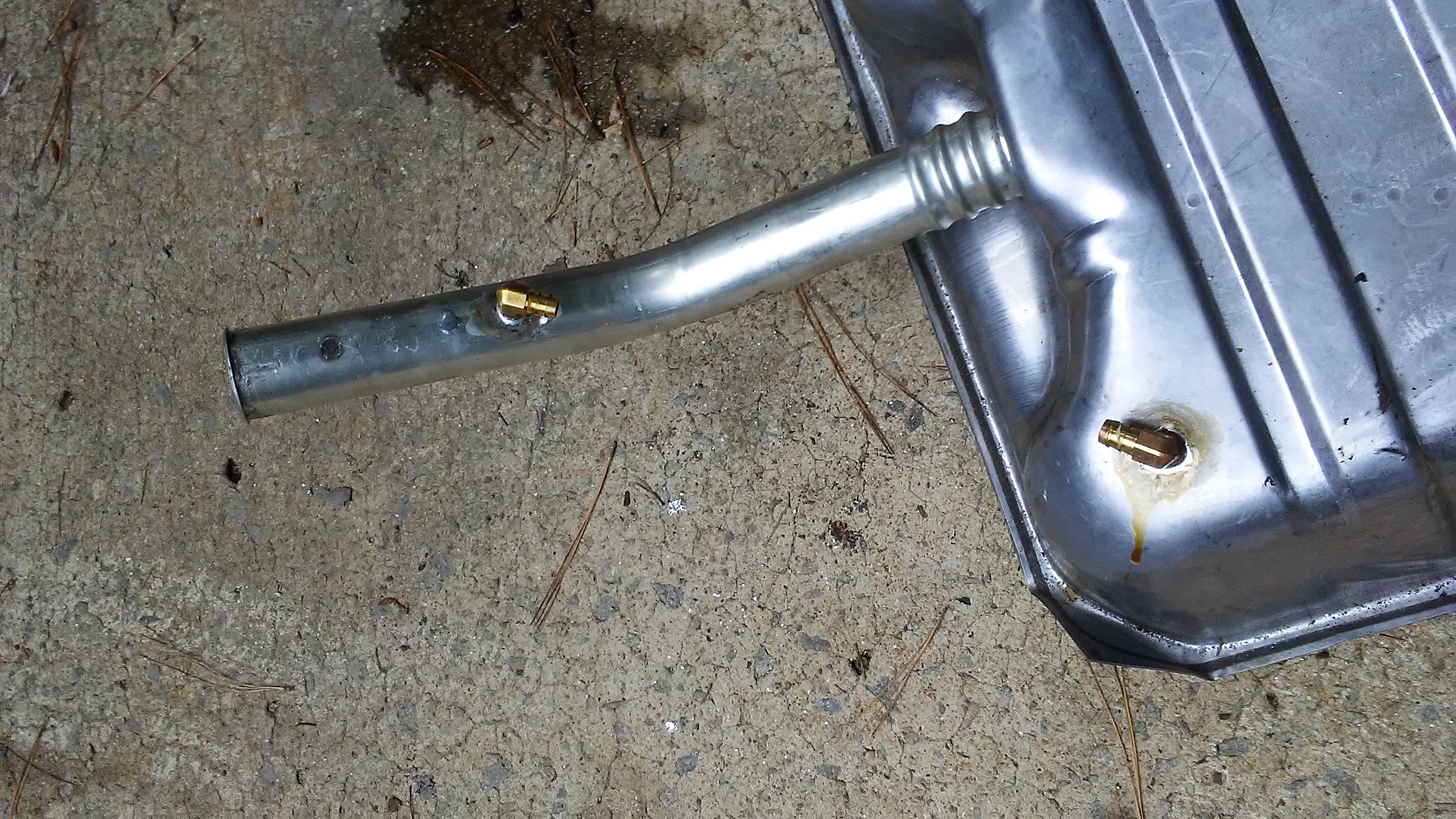

Got the tank out, drilled, and fittings soldered in.
A 1/2" fuel hose will connect the two fittings to vent the tank while filling.
I used the method Bro Willy recommended to eliminate fumes in the tank before a torch is applied.'
That's how the Army does it. Worked. I'm still here.
I used a magnet to get most of the chips from the drill out but I know there are some still in there. Hope the filters stop them.

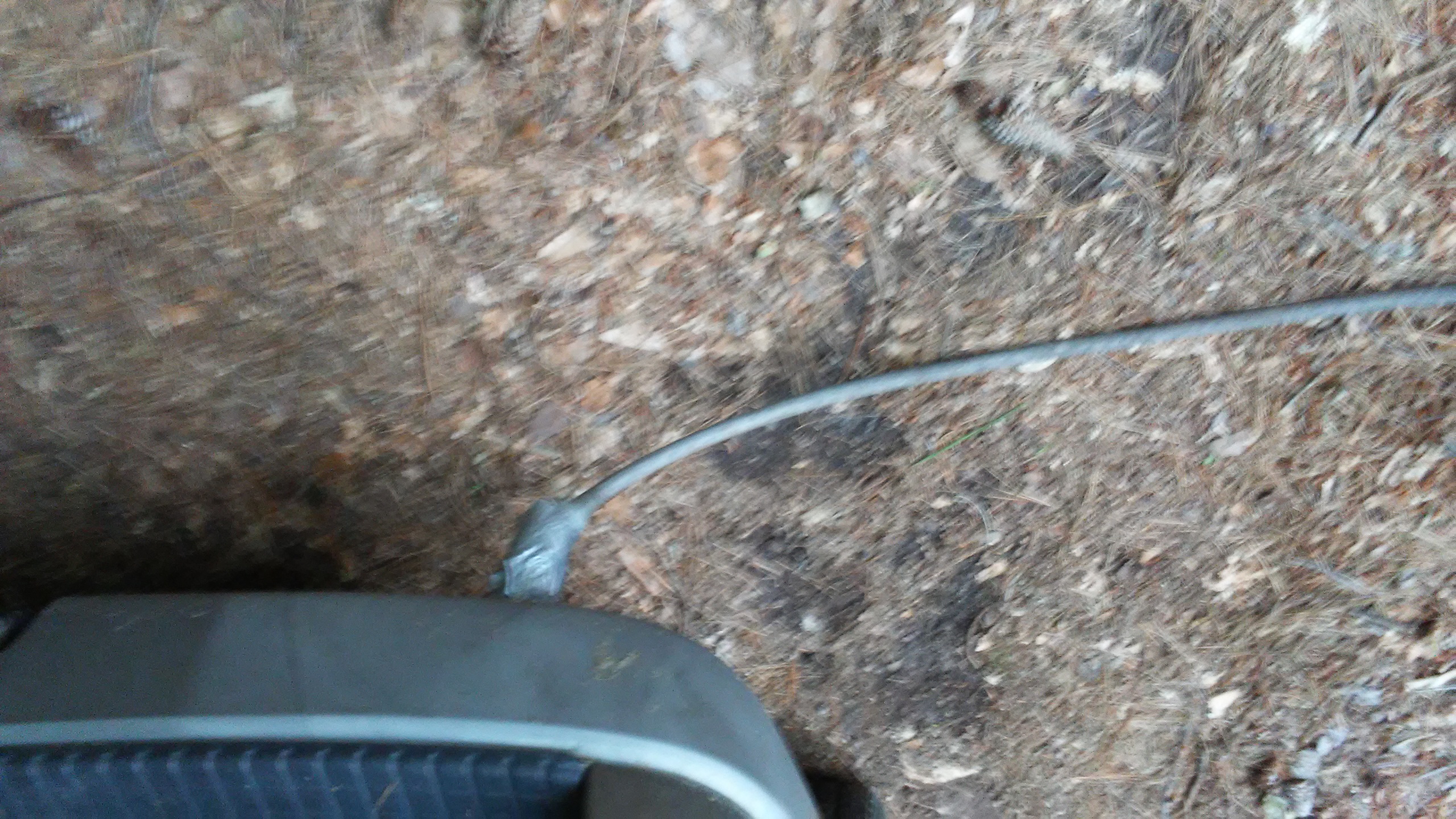

After the instrument panel was replaced, the speedometer (among other things) didn't work. Figured the end didn't get pushed in all the way. This is what the guys one the El Camino forum say about installing the cable.
http://www.elcaminocentral.com/showthread.php?t=217697
I can reach the cable by removing the cluster bezel, light & wiper switches and their mount, and reaching in. Gave it another push, jacked the rear wheels off the floor and ... speedo not working. Pulled the cable and the end, that should be squared off, is a rat's nest of twisted wire. Was it like that before? Is the speedo head seized? Who knows. New cable is $70. Haven't decided if the cable should be replaced or I should count this as one more strike against the stock instrument cluster.

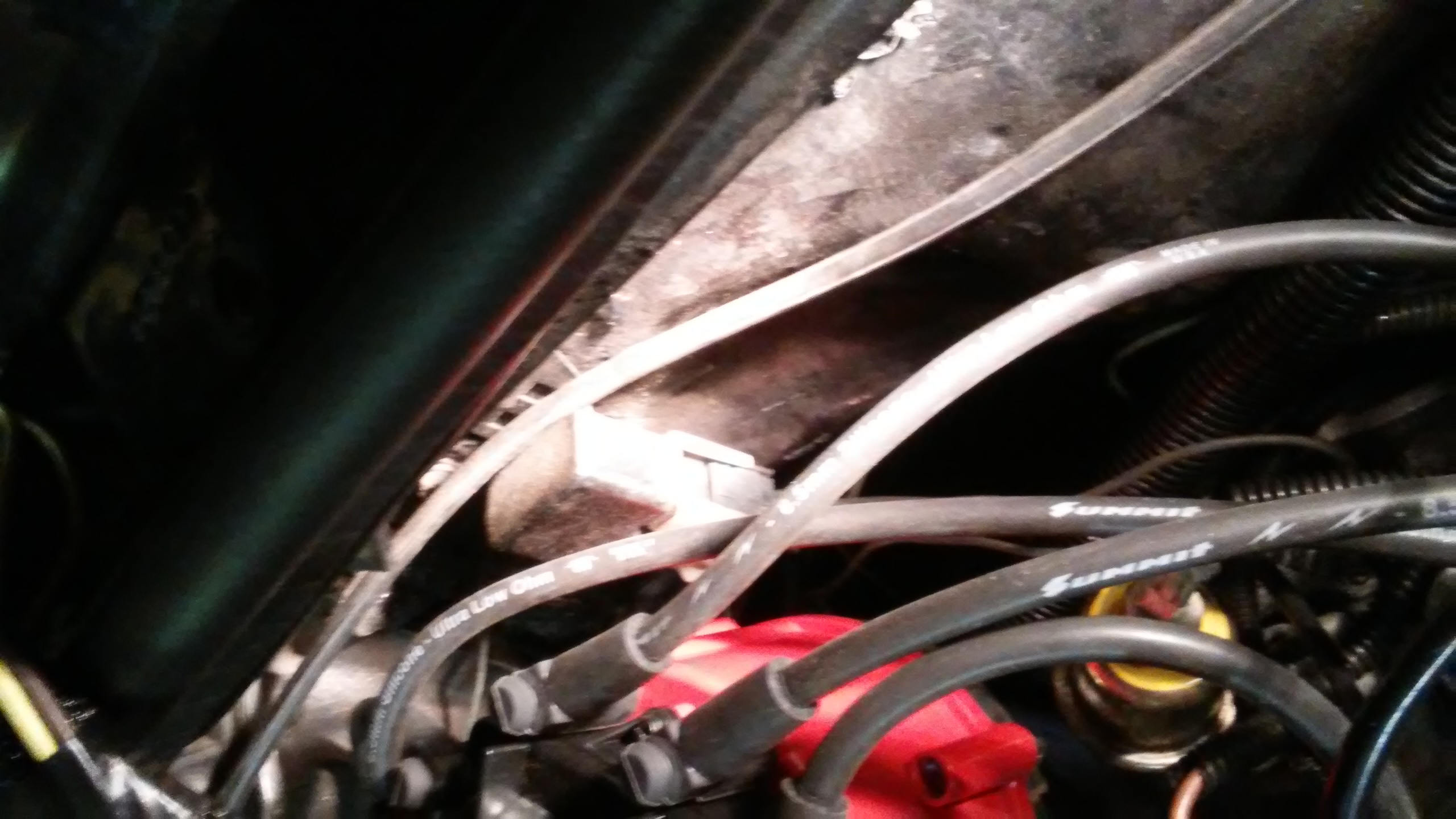

It quit again this morning with 12V on the distributor power supply. So, the no spark isn't related to the variable in-dash voltmeter readings.
Tried to order this https://msdperformance.com/products/ign ... arts/83647 but I don't think the order completed. No confirmation from PayPal. If there's no PayPal confirmation by tomorrow I'll order it again.
I'm OK with $109 for a hotter MSD replacement module with rev limiting. That'll make it safe to wind it up with no tach to watch. If the MSD module doesn't solve the problem, the original module will be a backup in the car. I'll either take a break for a few days or chase the variable voltage reading till the new module comes.
Alive Again
I believe the no start issue is solved. The middle (black) wire in the distributor connector wasn't caught properly in the connector. Removed the wire from the connector, bent the tab up, re-inserted the wire, plugged it in and it started. Still rough on idle but it's running. Sounds good when the throttle is cracked.
