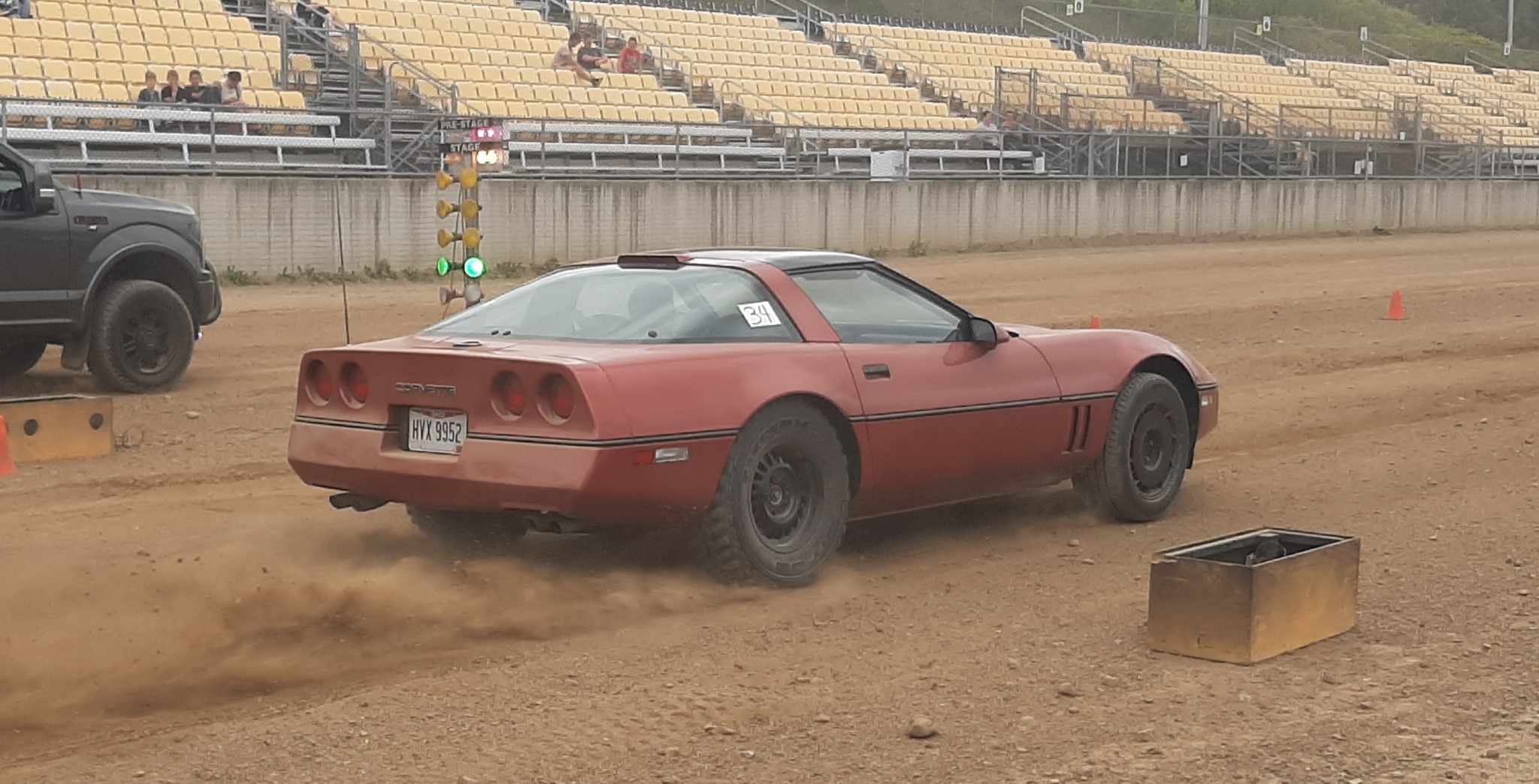

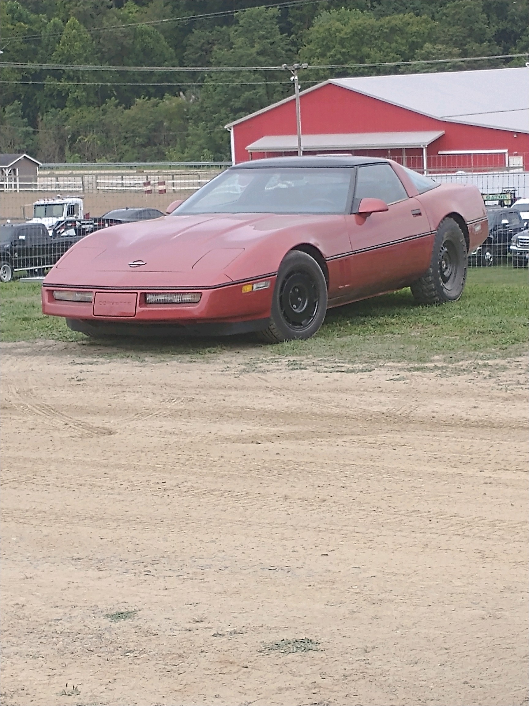

Yesterday I made the trip to Holmes County Fairgrounds for the KOI dirt drags. I was the ONLY car there and maybe one of the only people without cowboy boots. I made several passes early on in the practice session when the track was still pretty good, and a few after it fell apart. It's a 200' track and I'm 2wd, so traction goes away pretty bad for anything 2wd as the track dries. They reprepped it for eliminations but by the time I got to run, it was pretty much destroyed and dry again from the badass 4wd diesel trucks.
My first class was Street Stock gas (no diesels) but with 4wd trucks. I was about .3 sec off the faster trucks, but still quicker than several. Since it's double elimination I had a couple shots but came up short both runs by about a half a car length.
The second class I ran was 2wd V8 which is a DOT tire, and basically a street driven vehicle. This is where I figured I would have my best shot. And I was correct. There were six vehicles in the class, but it seemed like I raced way too many times since I THOUGHT I won all my races. Turns out one of my run I was flickering the second bulb on the tree and when I punched it I tripped the red and never saw it. I was typically at least two car lengths ahead of everyone in the class and was lifting before the stripe to no show all my cards... But I ended up racing in the finals against the guy I redlit against and he threw his two buddies out before the run to lighten his truck cuz he knew I was faster. I was able to beat him by almost a second on that pass too for the win. It's a hot lapping event, so once they pull your class, you run until you're done. It goes by pretty fast, but is totally fun and I love the heads up nature of it.

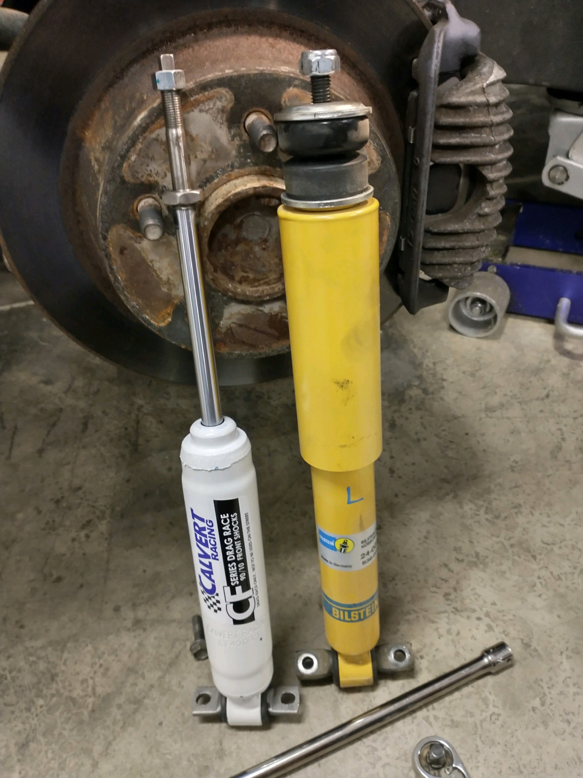

Driving down there I had a full tank of fuel, 75lbs of sand, and a 5 gallon gas can along with some tools and other stuff, so I was weighted down pretty good. At 75mph on some of the bridge dips, the LR tire would rub the inner plastic. So to remedy that, I'm going to put a spacer in the rear spring rods. When I put longer rods in before, it lowered the car, so I'm going to use the stock bolt that's in there and put at least a half in spacer in there to raise the rear and stiffen it up a little. Then I think I can safely carry more weight, which in testing proved was better to have in there and not tear up the car on the way there.

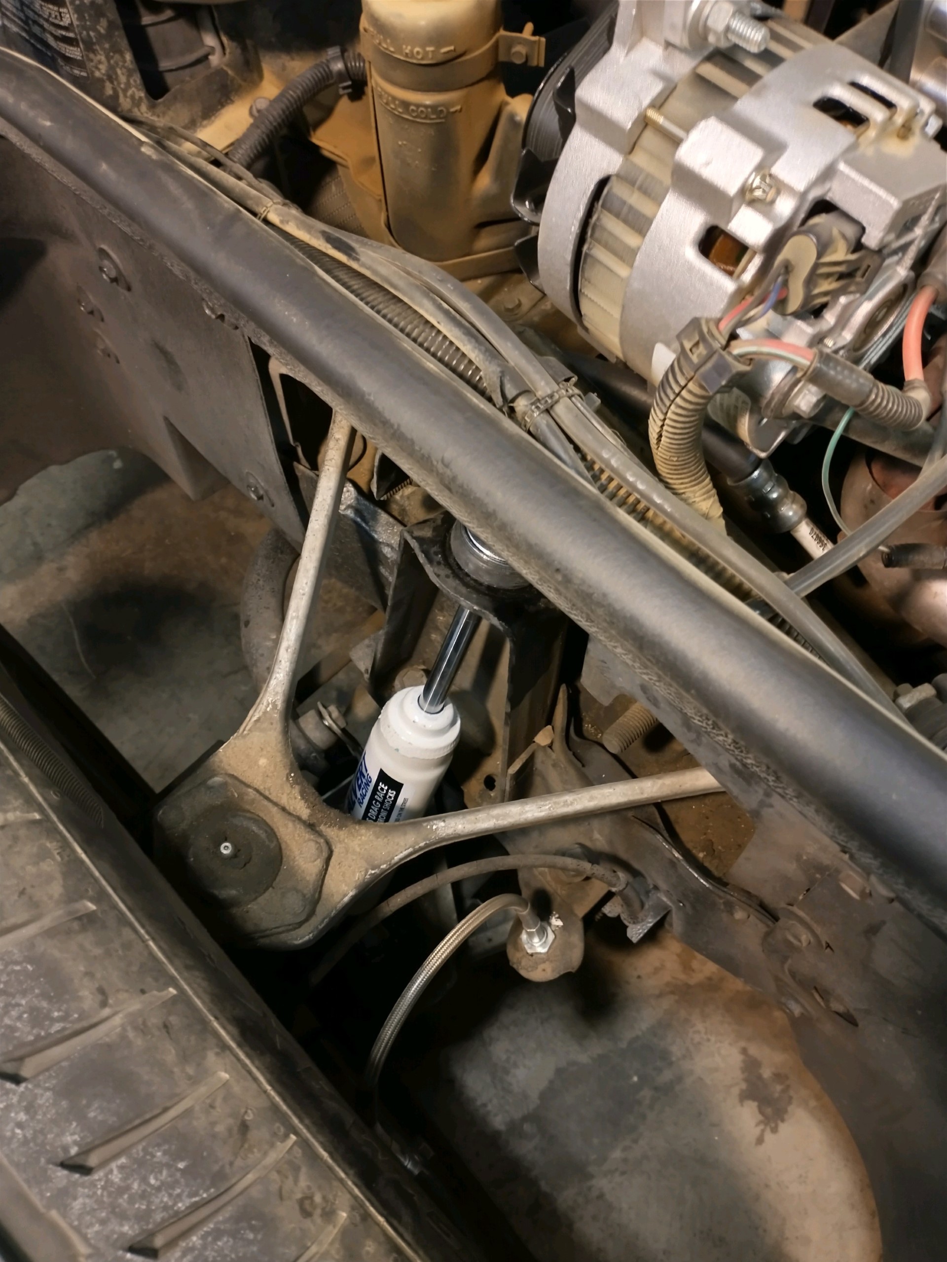

I'm also ordering 90/10 drag shocks for the front. They're super easy to change on this car, so I can swap them out when I go to drag/dirt racing vs when we want it to handle. I believe the drag shocks will help immensely and I think I will be able to compete with the 4x4 street guys with those changes.

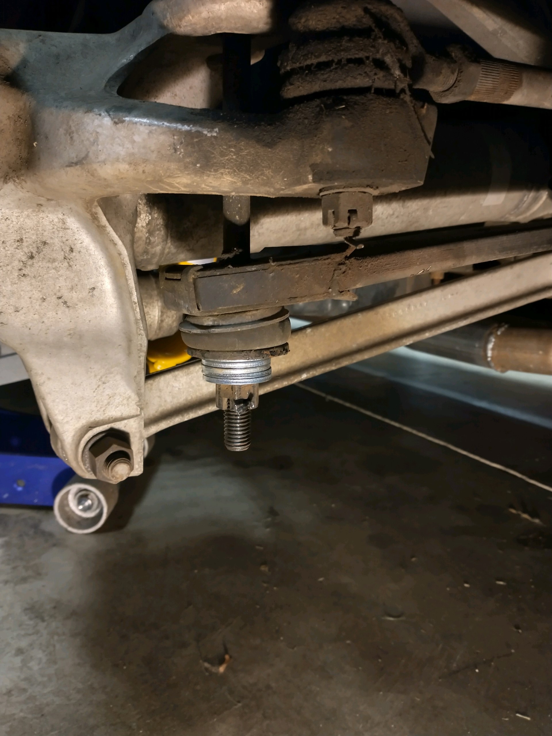

In a effort to help the car hook up better in the dirt, I bought a set of 90-10 drag shocks for the front, and shimmed up the rear spring so I could carry more weight in the back without scraping the rear tires on the inner fenders while driving to the races. Both of these seemed to work well as it basically dead hooked this past weekend at the 42 race. BUT, I'm not sure now how much of that was my upgrades and how much was the track. See the 42 track ended up being a very hard, smooth surface where the track at Holmes County was super loose and I think would have benefitted more from this set up. So now I think I kind of have to prepare for multiple surfaces. In hindsight, I believe the car would have been faster at 42 towards the end of the night with less weight in it, where the exact opposite was the case at Holmes County.
Adding taller and lighter tires to the front will also help with the weight transfer, and I plan to do some tire siping to the rear tires which should help in pretty much all scenarios. The car will also lose some weight over the winter which I think will help everywhere. I would ideally like to run it as light as possible on a sticky track and have it hook and only add weight on the loose dirt tracks. I had 200lbs and Andy in the car with a nearly full tank of fuel at race time. If I get rid of the weight, the Andy, and some of the fuel, that's 400lbs which would really help my down track speed.
