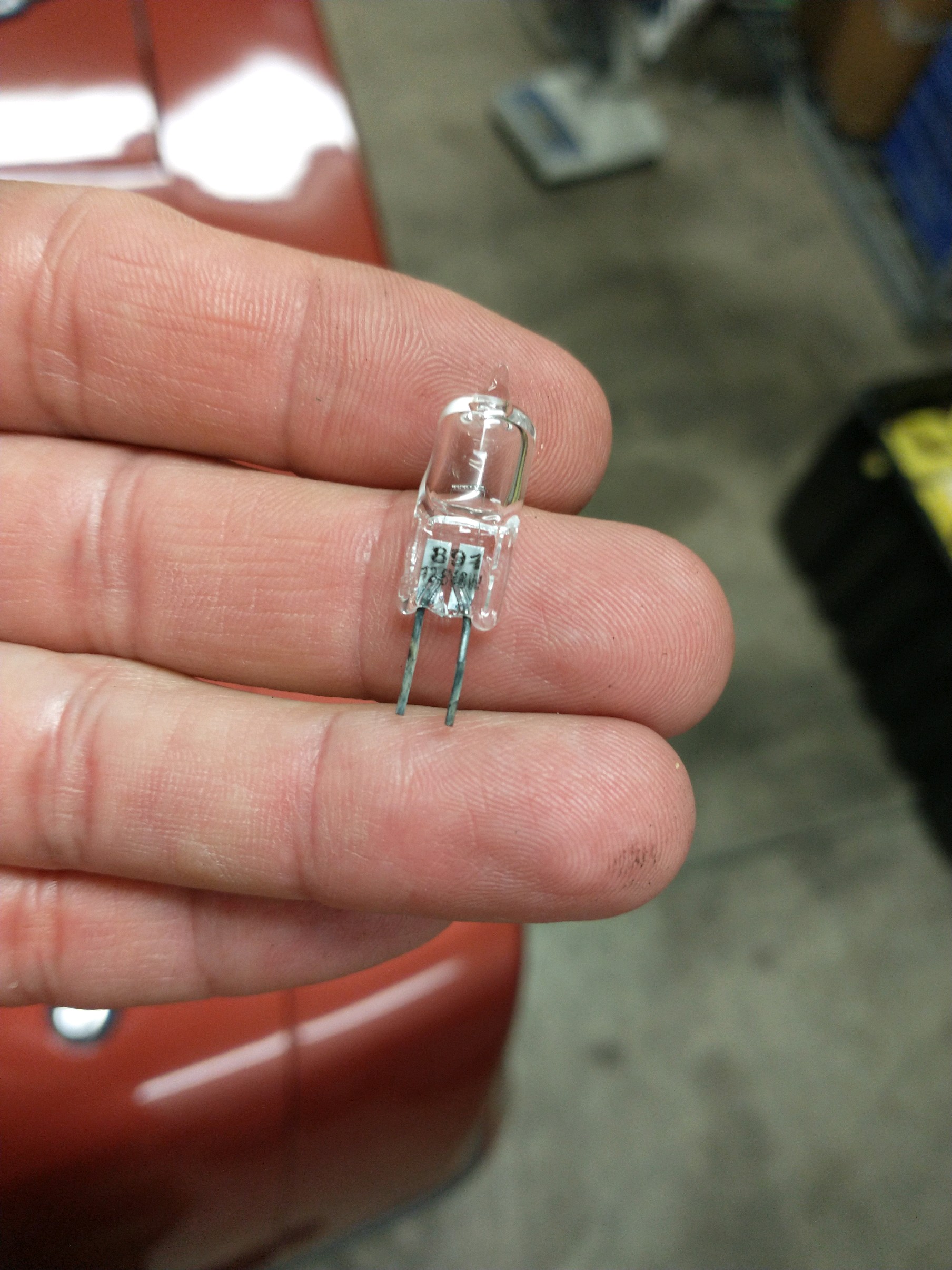

One of the four 3rd brake light bulbs was out. An 891 halogen push in deal from the 80s. Apparently no stores in Painesville carry them, but every store that's 10miles away does... So I'll just have to drive a little farther this morning to fetch one. Don't worry though, it's sunny and I have a convertible, it will be OK.

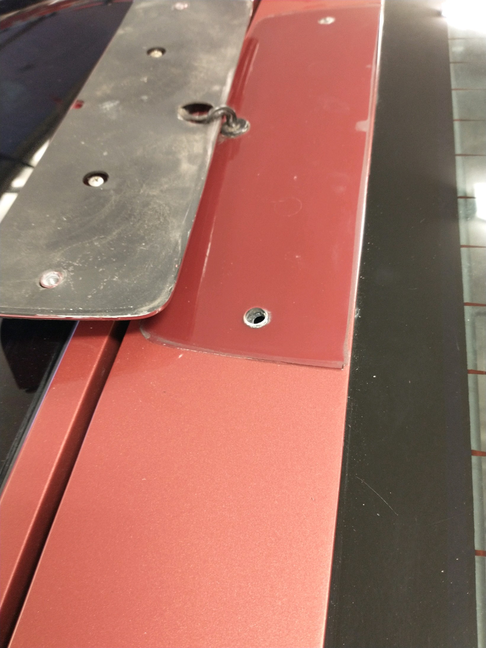

When I took the third light assembly apart, I could see how poorly the paint doesn't match the original color. I like the new color better, but now I have absolutely no way to touch it up as problems arise.

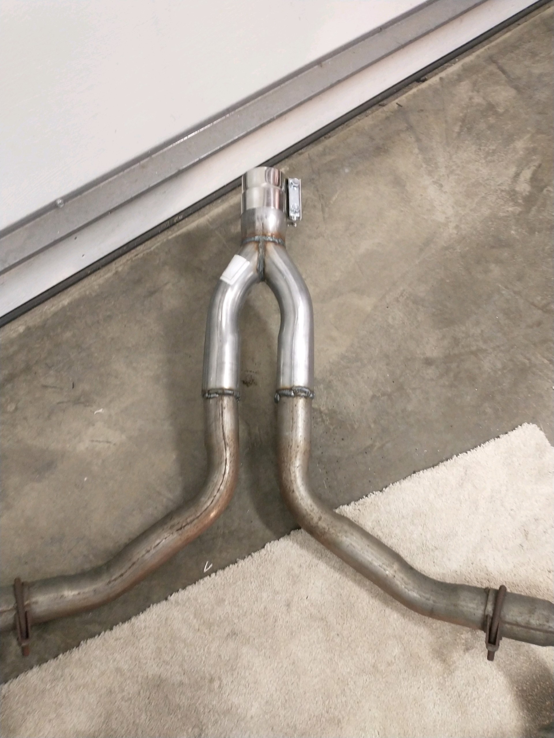

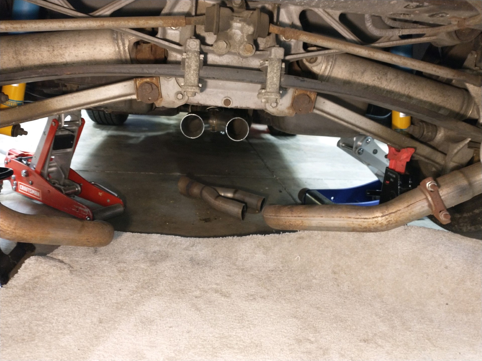

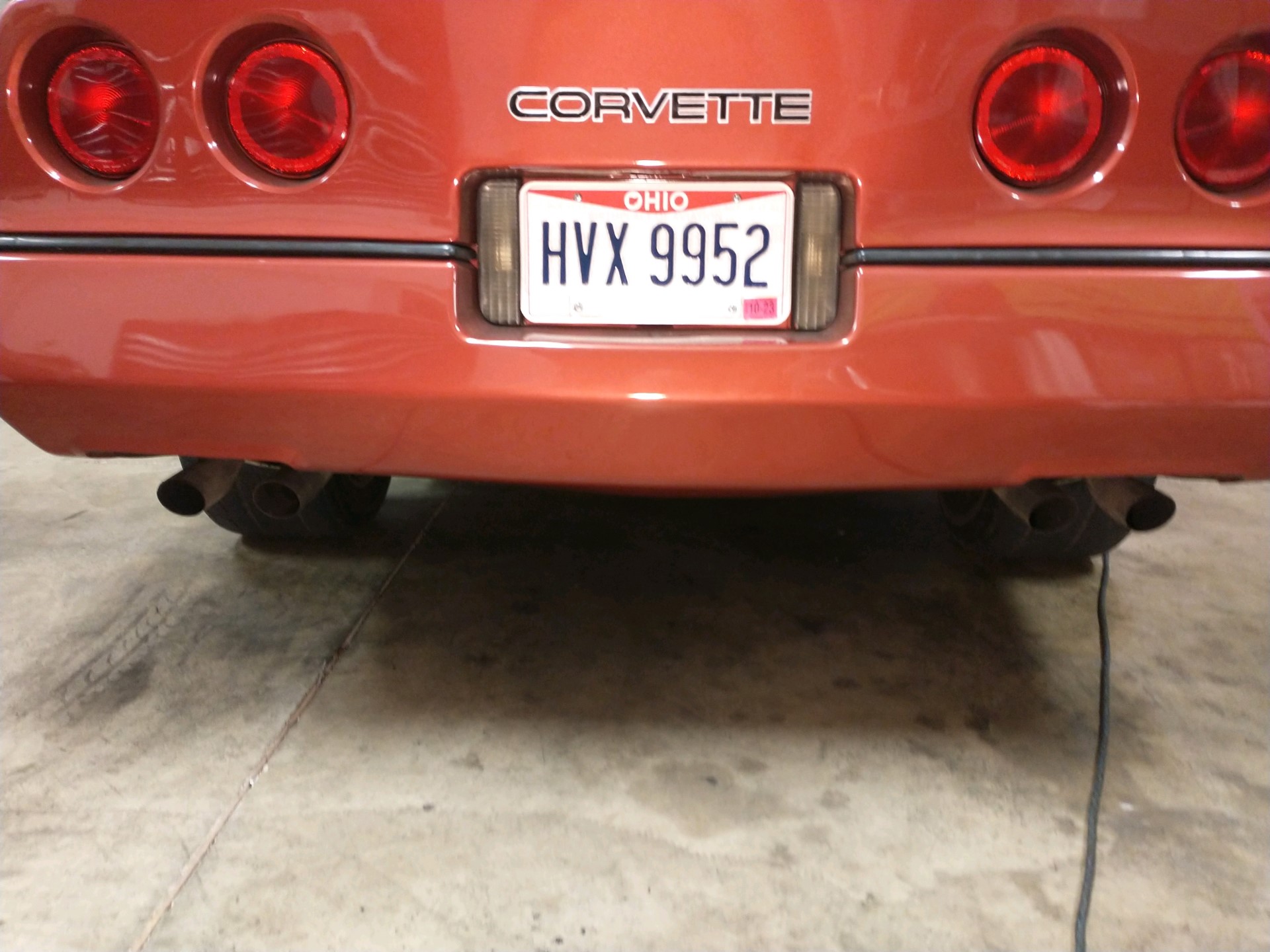

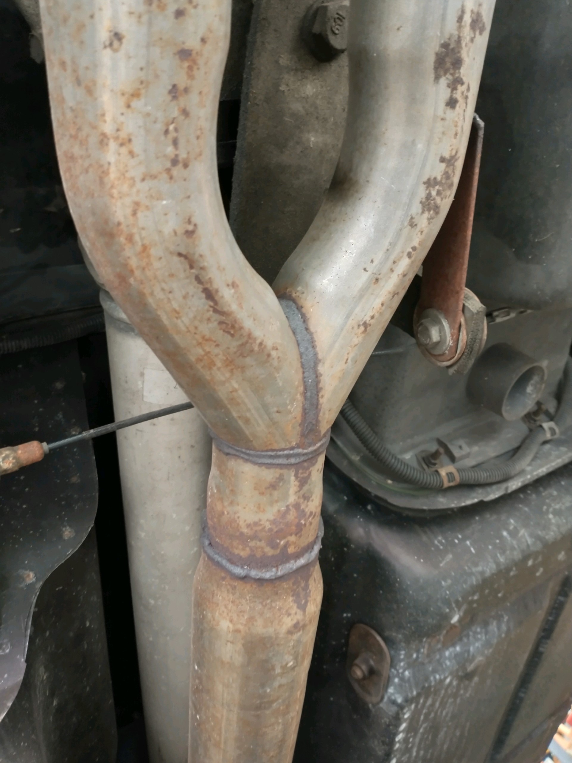

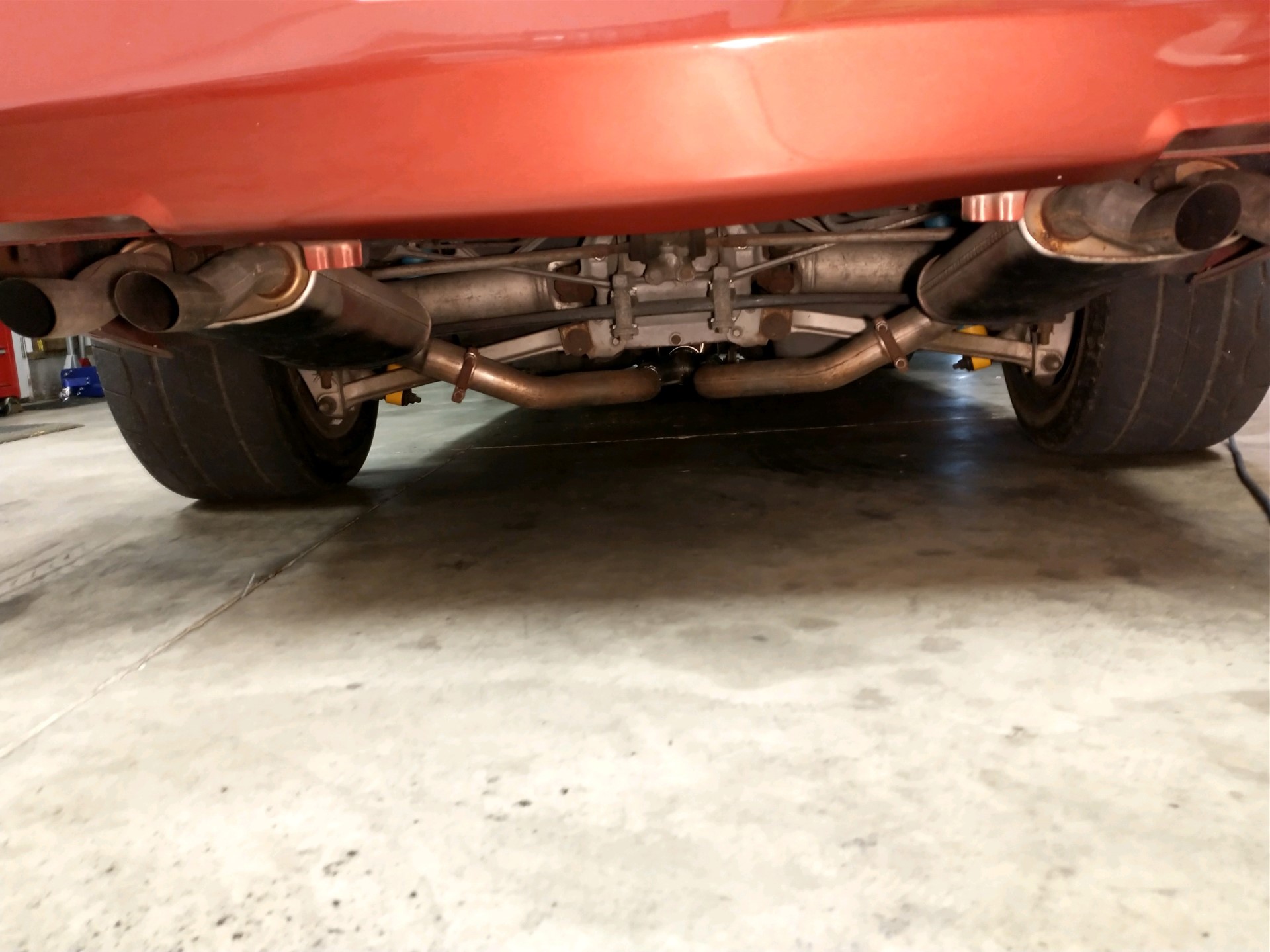

The rear y-pipe has been bugging me for awhile since whoever replaced the large rear cat converter put this pipe that chokes it down from 3" to 2-1/4" before the Y. I bought a cheap 3" to 2.5" Y-pipe to replace (https://www.summitracing.com/parts/JEX-U6-4) the crappy choked down one. I got to work Saturday night and was able to sawzall the cuts close enough to where I needed for welding in the rear, and clamp in the front. I wanted it to look stock like it did before and not leak and I was able to accomplish that mission. I can't really feel a lot from the seat of the pants but I guarantee it will be stronger as it's a way bigger and smoother setup.

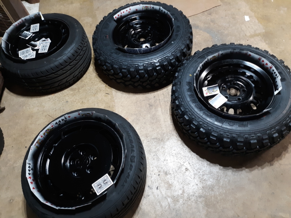

We did some stuff buying another set of rims and tires for the dirt drags. I'll let 32V post pictures of the wheels.

The wheels picture that BP promised, two Jag, two Vette, now all are black.
Black wheels
Black wheels
Ready for whatever is to come.

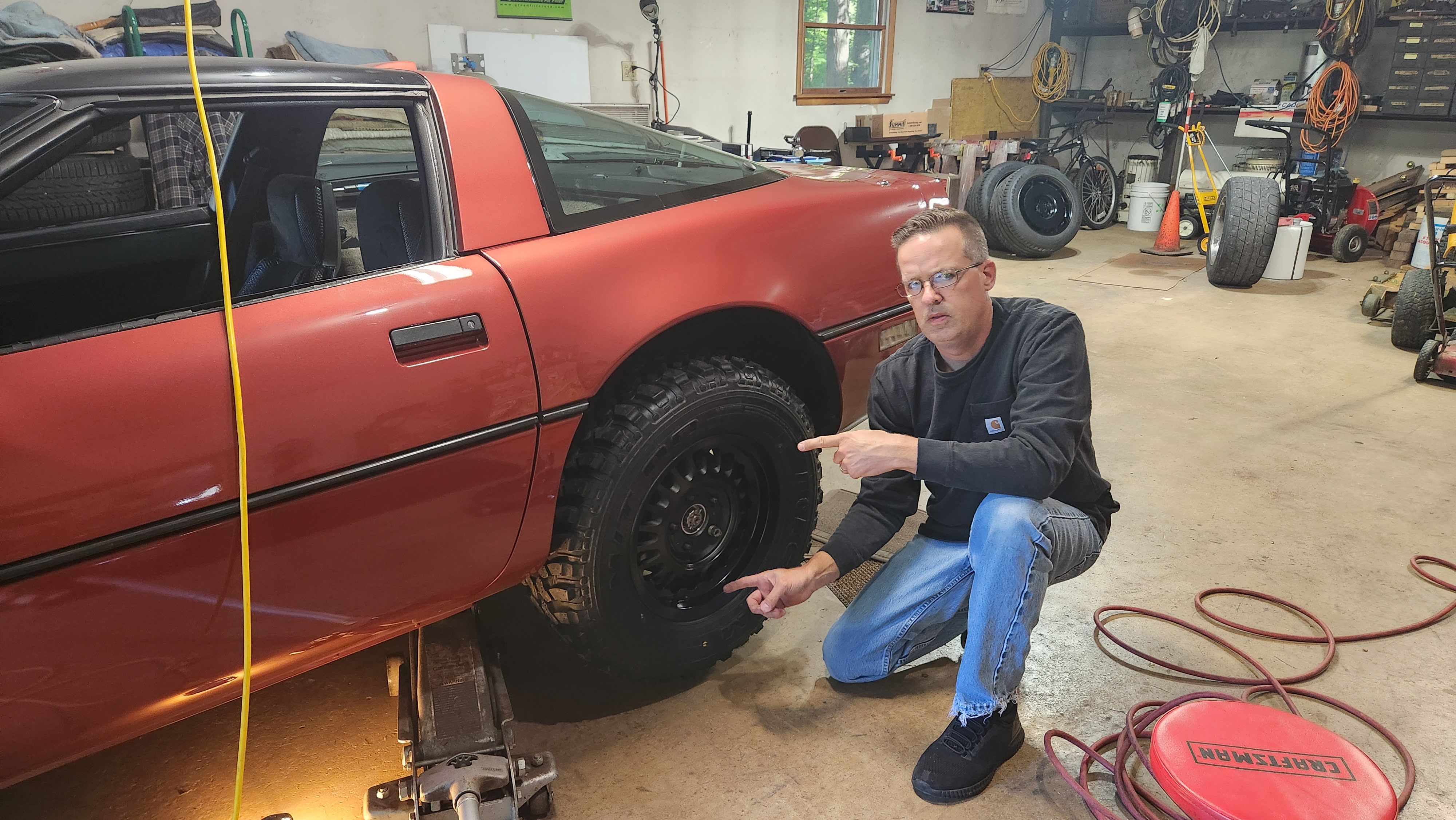

You know the tires are badass when you mean-mug the camera and point at them. Obviously we test fit them but decided not to drive on them until we get new lug nuts with an extended thread to go inside the bigger lug holes that the rims have.
