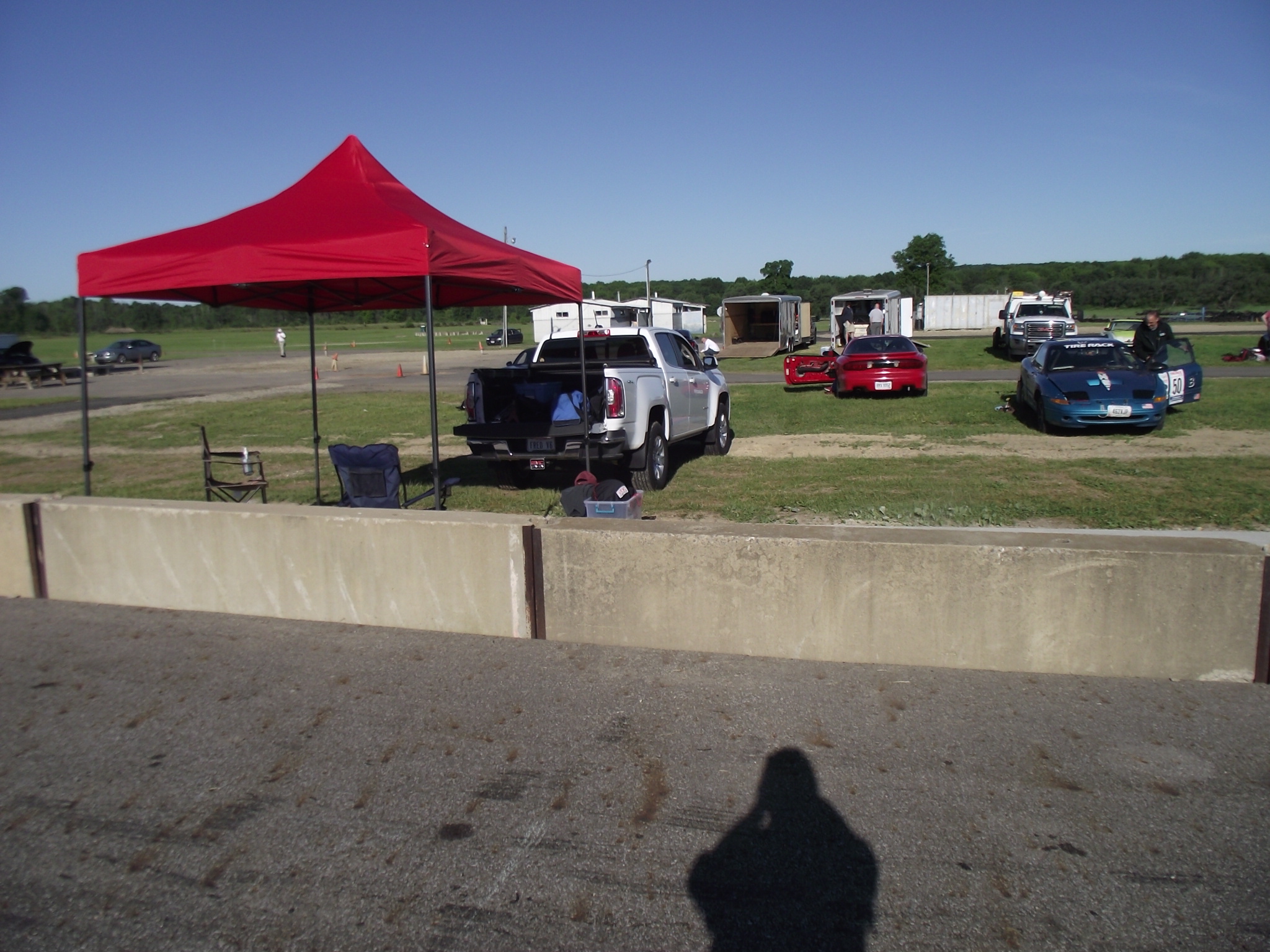

Old Fred32v and BP had a great time yesterday at the MostMint One's Track Day at Nelson Ledges Road course.
BP and I were there early and put our set up on the pit wall. Driver meeting was at 8:30 am. I had my 1st ride in a track situation since last fall. The weather was perfect and the TrackBird provided the entertainment! TrackBird was driven to the track and driven back to its' roost in the 32V Garage,
that's the definition of a good day.

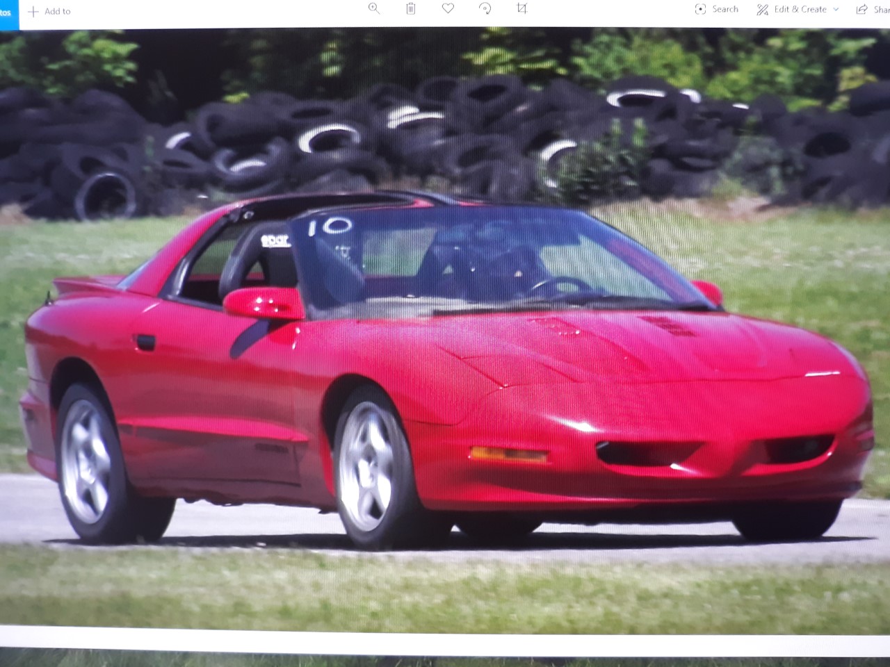

Re: 1997 Pontiac Firebird
That picture of the Bird in action must have been under HARD braking. We definitely couldn't have asked for better weather. There were some pretty fast cars there too (we weren't one of them). I think the groups we ran in were set up pretty well as I was one of the faster cars in my group. In the open part of the day though, I was still pretty slow relatively speaking.

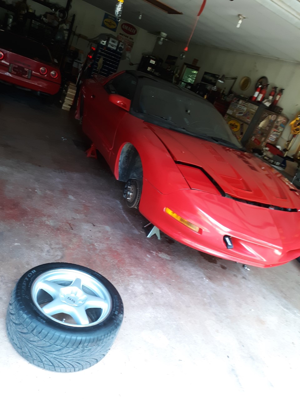

Today the Trackbird got a fresh oil change and the old steel driveshaft re-installed with the newer u-joints from the aluminum one. We're hoping it solves our high speed vibration issue.
During the week 32V washed the track day off the car and straightened the steering wheel out. Currently the car is on jack stands waiting for more parts to show up.

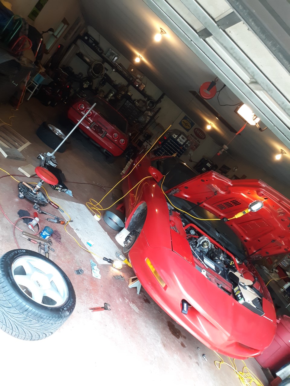

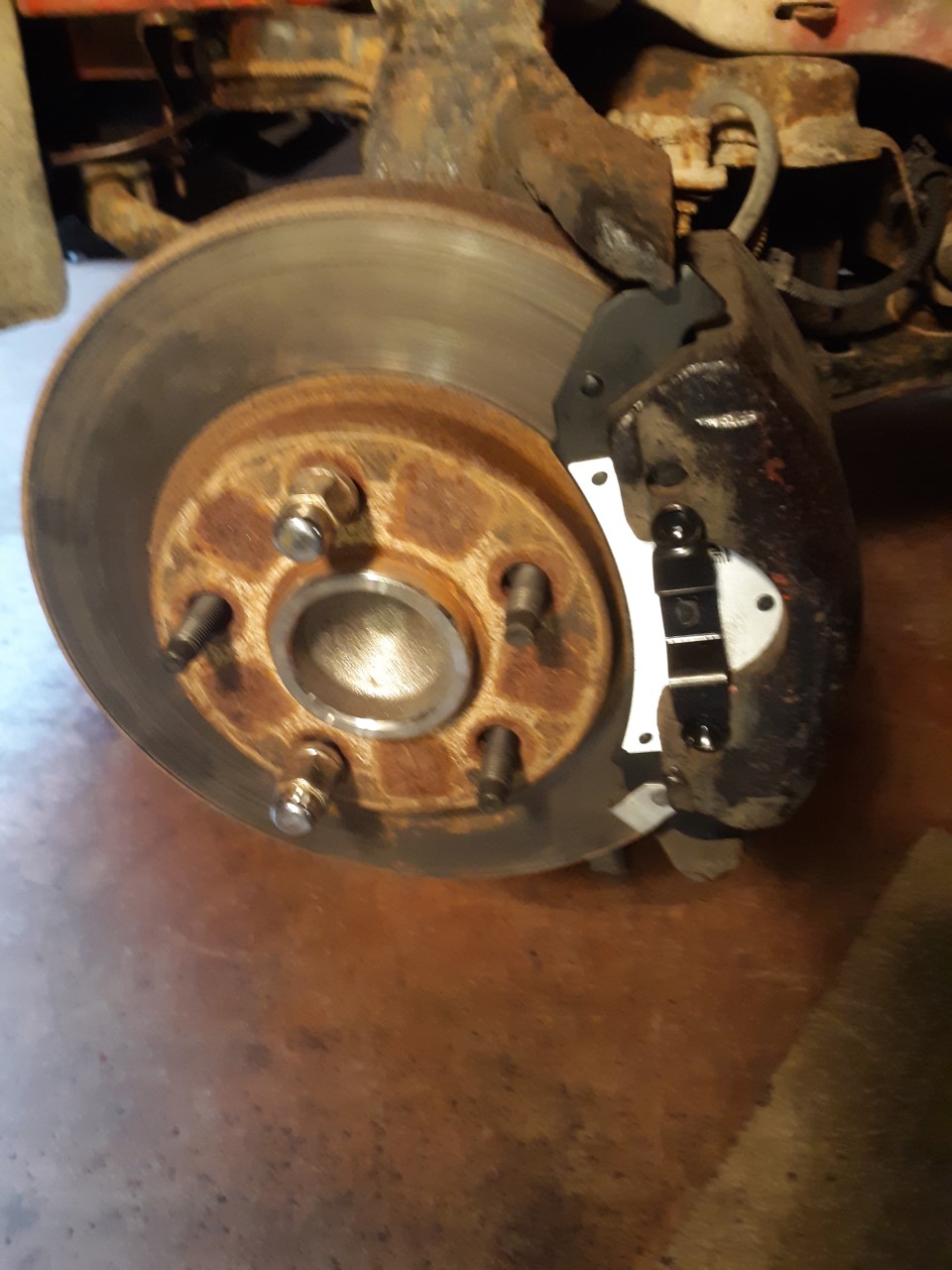

TrackBird received much attention this Saturday working into the afternoon.
I replaced the rear brake pads. BP replaced the plugs and wires and stuff under the car.
Then we tag teamed the right front brake pads, BP to the rescue.
Still need to do the left front brake pads, etc..

I did finish installing the driver side front pads.
Then BP called asking if I wouldn't "Brake-in" the new pads. That was a first for me.
He directed me to the Powerstop web site for the procedure.
I took the TrackBird for its' break-in run after 8:00 pm, no traffic.
It was pretty much good fun, tested the seat belts, I could smell the brakes were hot.
On the return back to the 32V Garage I ran the Bird up to the top of 3rd gear a few times,
no surprises, just the way we like it.
