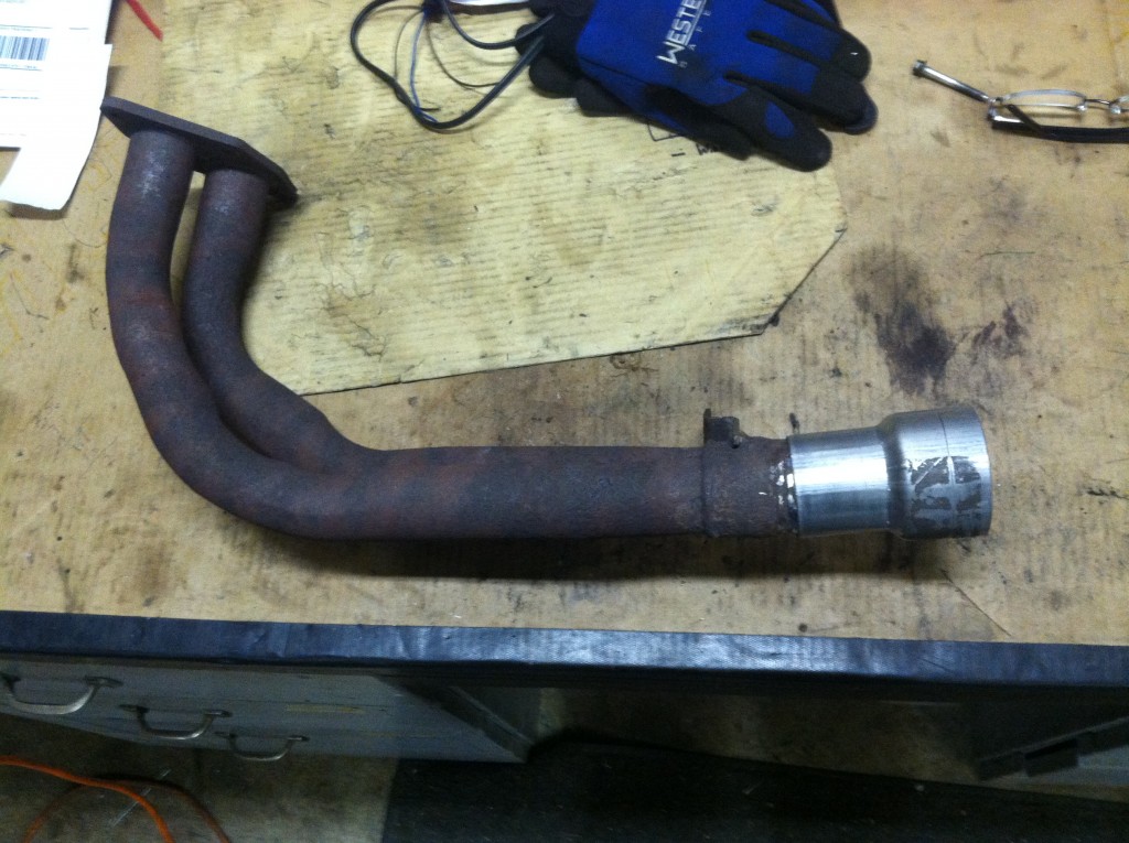

Wow am I behind on posting here. Last year the plan was to free up the exhaust. I have already explained most of the mods above, but the downpipe did not get done until after the 2015 racing was done.
The worst downpipe - and what had been on the car since fall 2011:
- IMG_0865.JPG (211.34 KiB) Viewed 34593 times

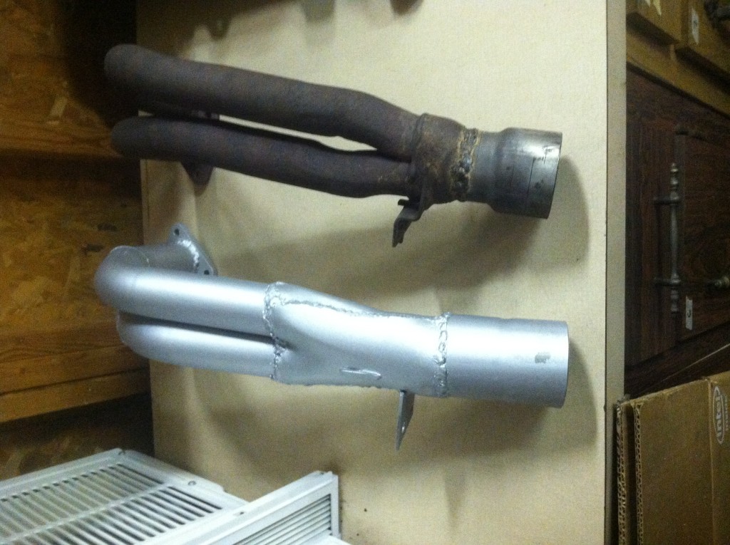

The original downpipe - adapted to fit large exhaust - on the car for 2015 race:
- IMG_0929.JPG (181.03 KiB) Viewed 34593 times

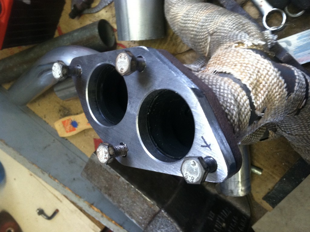

When this year came I wanted to improve that a step further so I got to fabricating a down pipe. There is no one offering a flange to fit the Saturn header so my cousin machined one:
- IMG_2178.JPG (182.52 KiB) Viewed 34593 times

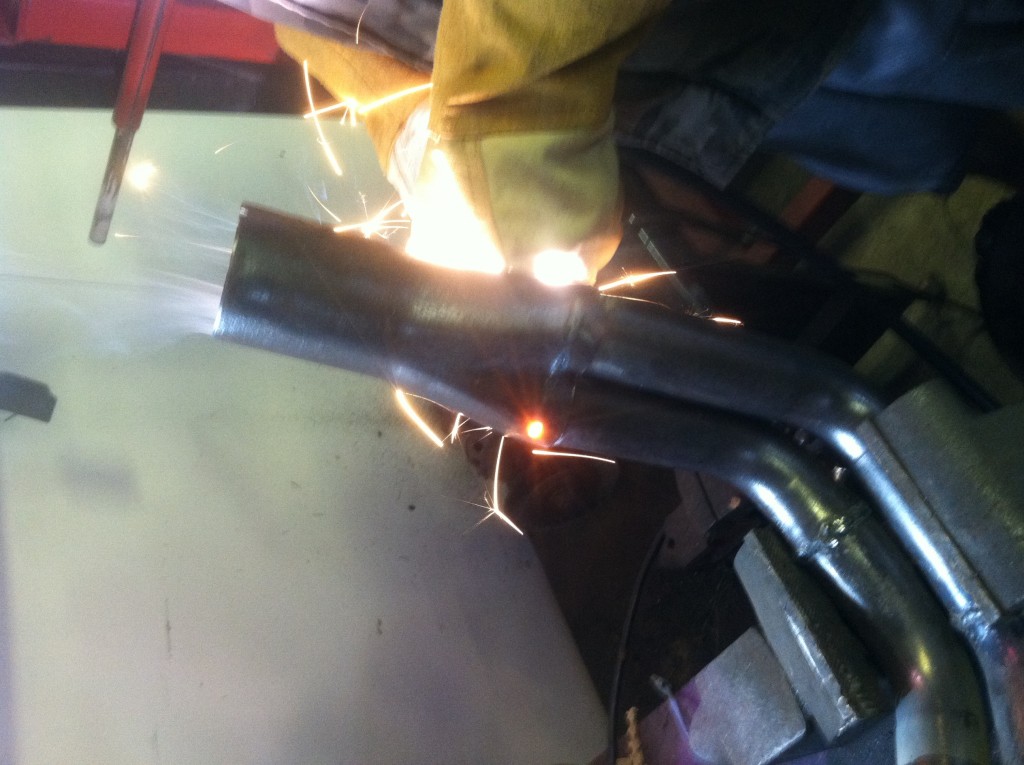

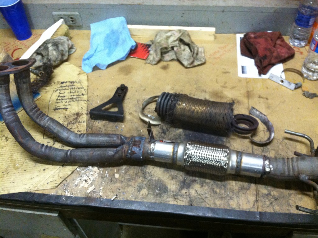

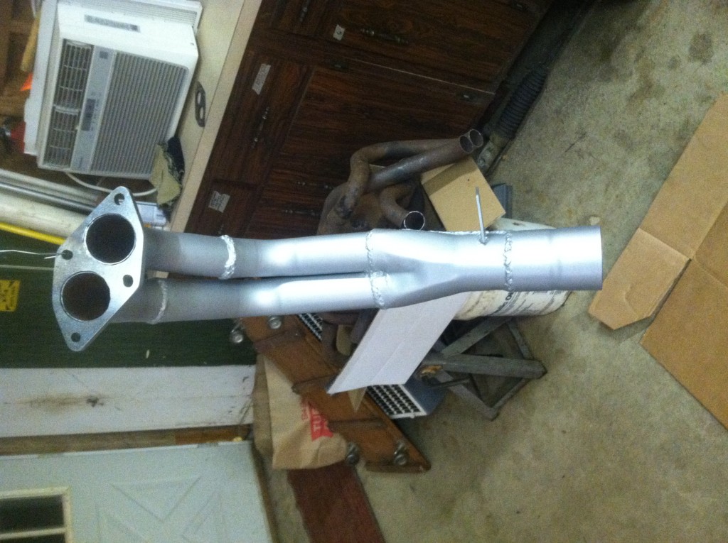

I then needed the 1 3/4" downpipe material. I tried having a local chop bend them up but they did a poor job with the bends, so I found a used set of Chevy headers and cut them apart. I found the bends I needed there and fabricated the pipes. $50 was a lot cheaper than $160 to buy a kit with these types of bends for $160. Kurt welded it together:
- IMG_2201.JPG (138.94 KiB) Viewed 34593 times
- IMG_2204.JPG (185.23 KiB) Viewed 34593 times
- IMG_2210.JPG (185.01 KiB) Viewed 34593 times
Putting it on the car, you could feel the improvement immediately, and the air-fuel ratio got a lot leaner.
