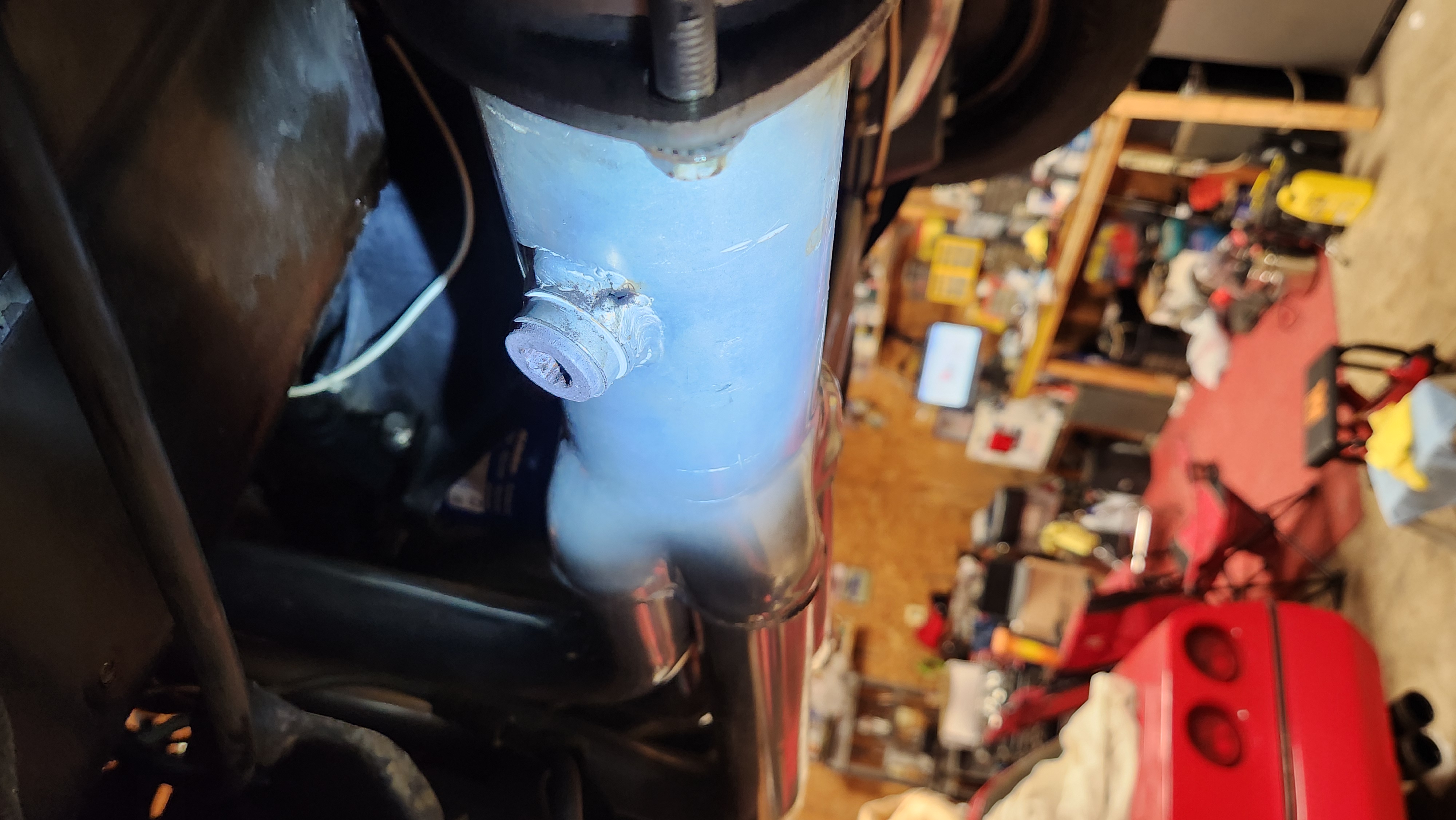

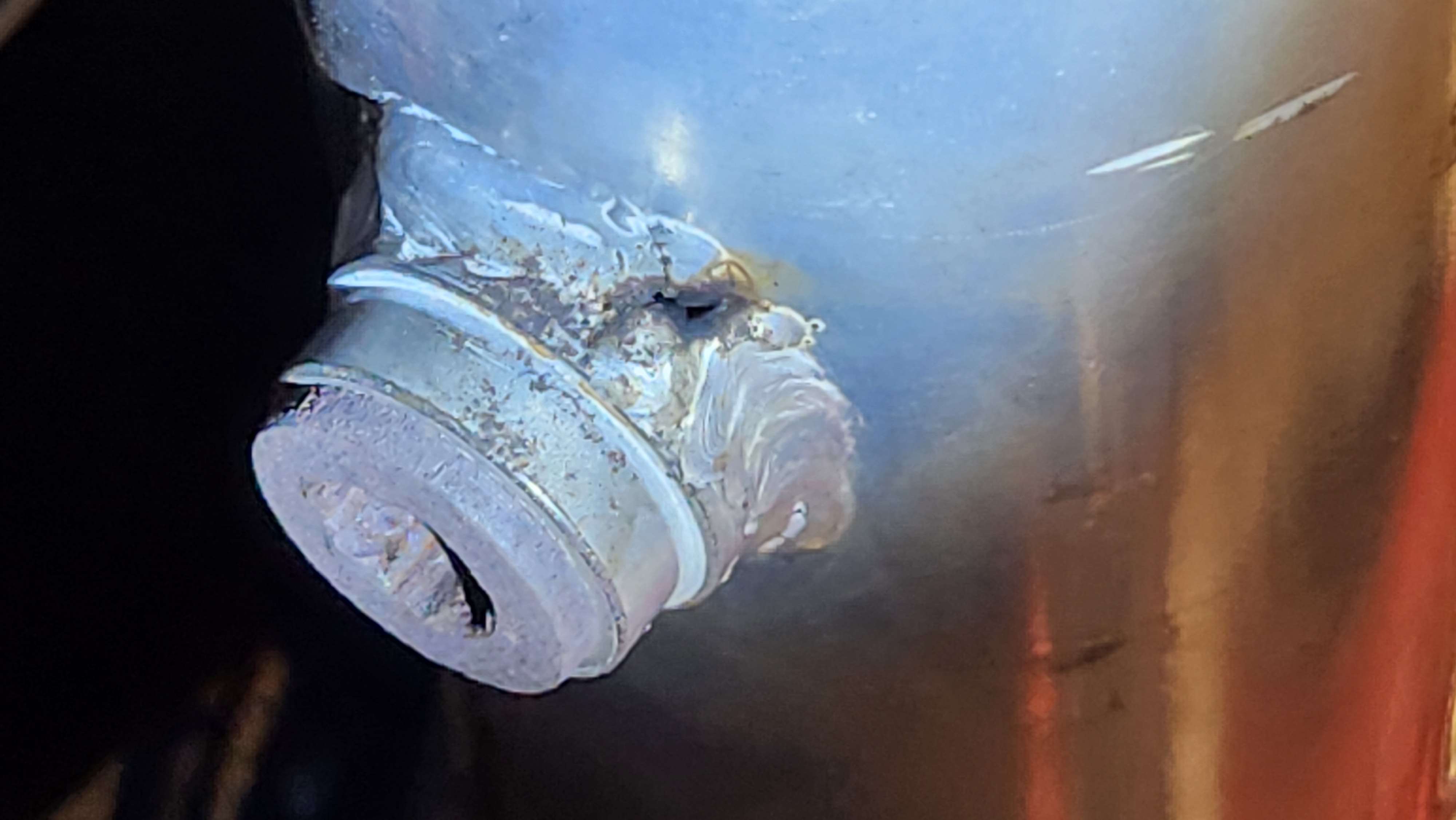

Well, I haven't gotten to any of those items, but there is a new #1 on the list:
This just developed the past week or so and makes the car totally un-enjoyable to drive. tick-tick-tick-tick.
Can I just weld over top of that a little?
Re: Chevelle Projects 2024
Should be able to MIG weld that. The challenge will be guessing thickness to apply the weld without blowing through what is there
How about some JB Weld or some other type of goop as a temporary repair?
- Posts: 2613
The only thing I had on hand was some Ultra Copper, but I figured it would just get blown out. JB Weld might be ok. I do have my new welder I could try too. (still in the box)

It's not real thick there, but welding over it should be easy on a lower setting. You're not welding a frame together, just plugging a tiny hole. A little spot weld would just about do it. And it's in an inconspicuous place so it doesn't even need to be pretty. No problemo.

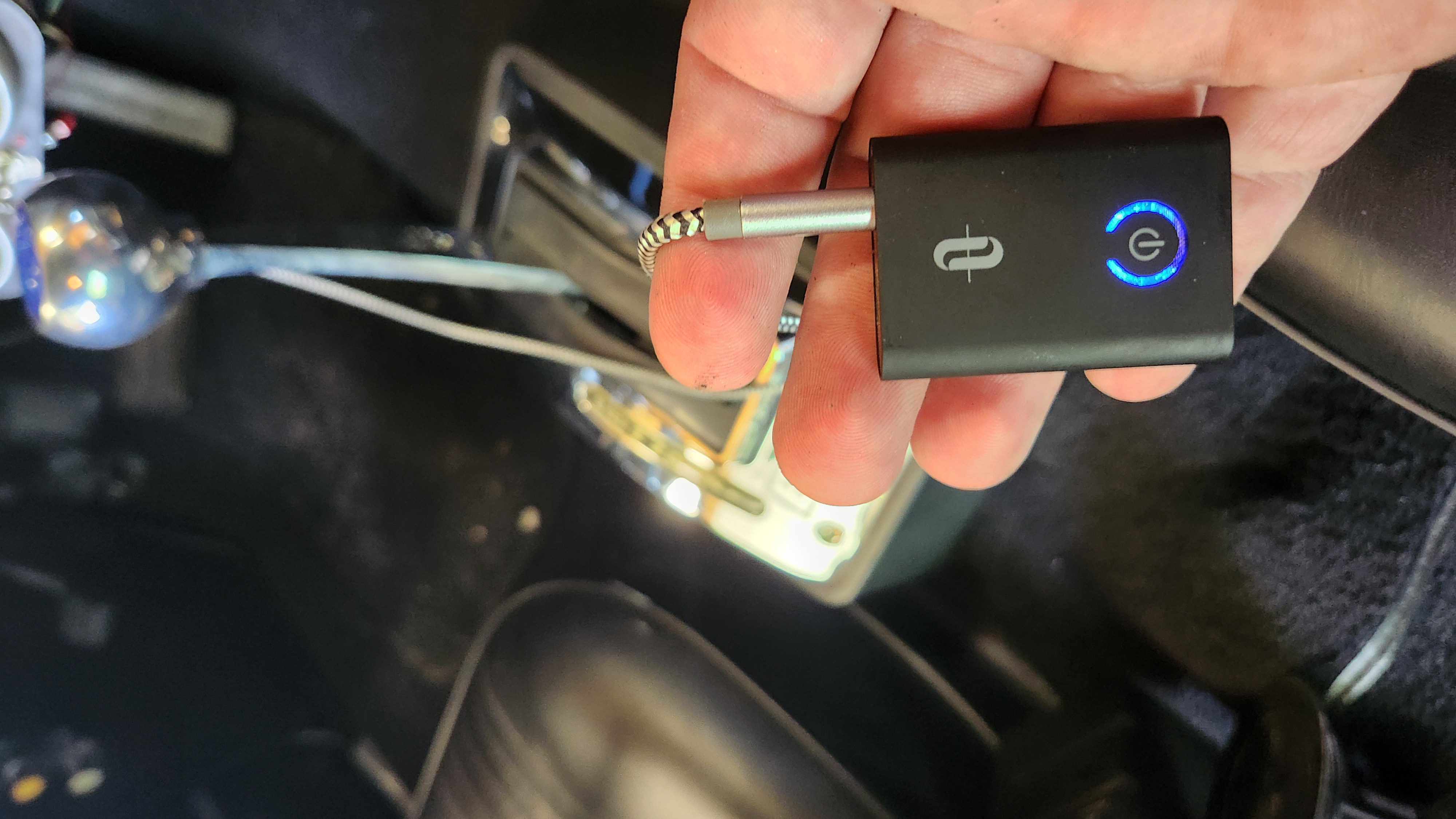

Hard to believe, but the ZZ383 is in its 10th year of service! I bought it at the end of 2014 and got it running in 2015. It has been a great engine. I'm also going to into my 20th year running a Megasquirt in this car. It is now the 1st year with bluetooth music from my phone.
