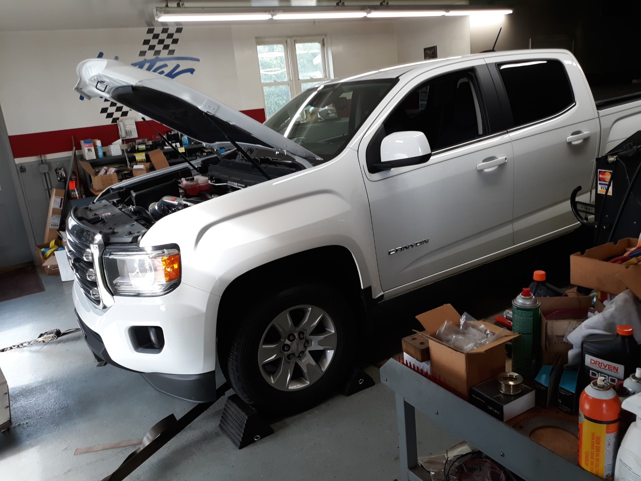

I requested a Hutter (Trever) tune back in March, June 30th was the earliest I could get.
Well today was the day, I was at Hutter's at 8:15am, my Jimmy was on the rollers until 1pm.
Canyon ready and waiting.

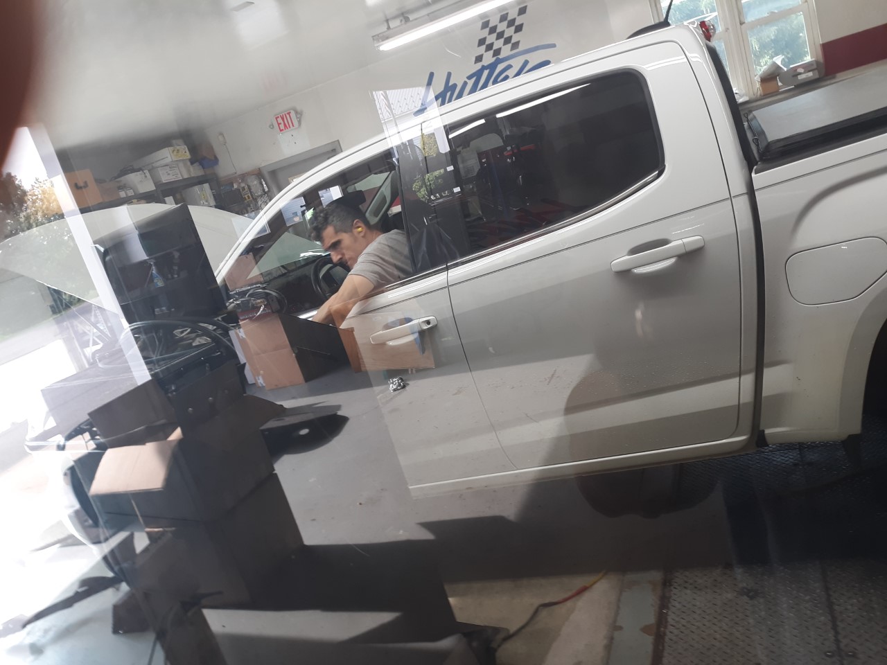

Tuner in action
Tuner in action

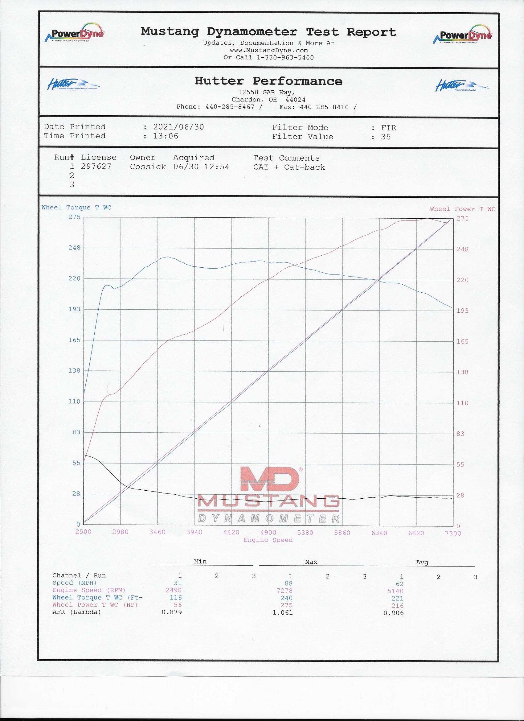

Results.
Eleven horsepower
Eleven horsepower

What did the “seat of your pants” meter say it did? Any better?
Posts: 3602
Re: Fred32v's Little Jimmy
The 11HP is probably more really. The Canyon had 89 octane in it, but Trevor added more timing so when he runs Premium, it will run better still. Also, we learned that this motor pulls strong to 7200rpms, but the transmission in Auto shifts significantly sooner on it's own. So there will be some real gains by holding the gears longer with the shift button. He also raised the top speed to 120mph from something just under 100.
It will be fun to see it come alive with good gas and some higher RPM shifts.
