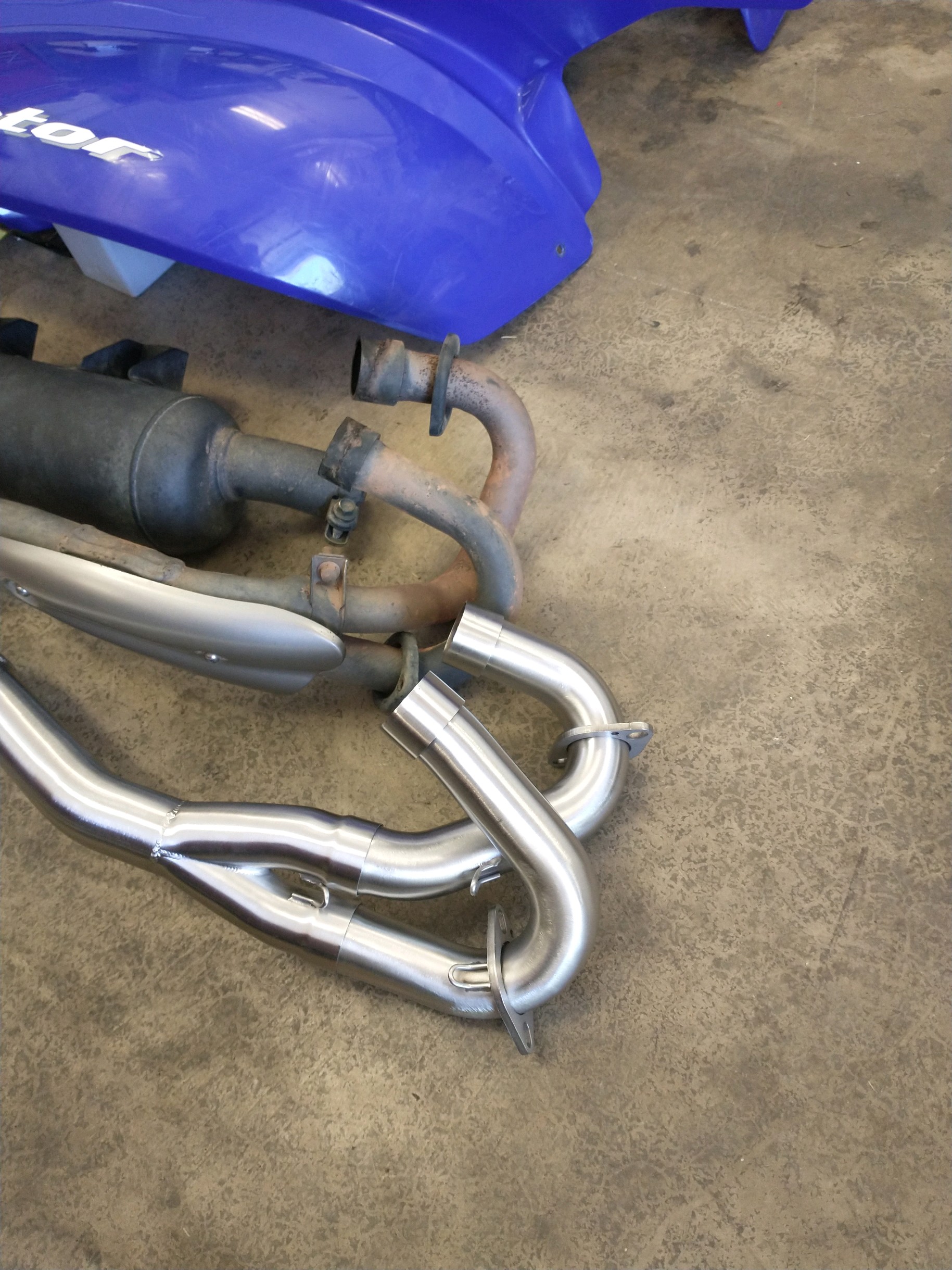

Since my last outing at Dragway 42's dirt drags, I decided I could use more power (duh). The easiest way to make substantial gains on this is a full exhaust and some carb tuning. I was leaning towards and HMF full system and really liked the way they looked and sounded, and once I found out they're in the Cleveland area, it was a no brainer. I ordered up my system on Thursday and it arrived on Saturday afternoon with no special shipping, which was sweet. Along with my system I ordered a jet kit for the carbs too.
Sunday we had plans that took up most of the afternoon, and Monday turned out to be a beautiful day after the heat spell we had, so I checked with the boss, and he said I could work on the quad instead of work and that's what I did. All in I had just under five hours swapping out the exhaust and installing the jets which requires about half the bike to come apart. But since I had done this before, I wasn't too concerned. The exhaust went pretty quickly and fit really well. The carb jetting took a little more time, but HMF provides you with a rough idea of what jets to use based on your combination. Sadly, they recommend using two 155 jets based on what I have, but only include one size from 140-160.. As I learned though, the right carb does more work (because of two intake valves on that side of the carb and one on the other) so I fattened up the right to 160 and ran a 155 in the left. Running more fuel in the right side is pretty commonplace so I felt good about this move.
After reassembly, it fired up immediately and seemed to do everything like it did before, only a lot louder. Under normal cruising, it's not a ton louder, but when you whack the throttle, it will wake the neighbors now. I'm happy that under normal riding it seems to perform as good as stock, but at WOT it's making a LOT more power than before. Depending on what you read and who you believe, it could be up to 15hp more than stock and it only makes about 37hp in stock trim. Time will tell for sure, but I expect to be solidly in the 14's in the quarter and hopefully will touch the 8's in the eighth. Most important though, I would like to knock at least two tenths off my 200' time in the dirt. That will make me a lot more competitive there, and I think that's very realistic.
It does make a lot more heat than before on me, the rider, but that's the price you pay for more HP. That, and potentially going deaf. But a helmet will tone it down some.

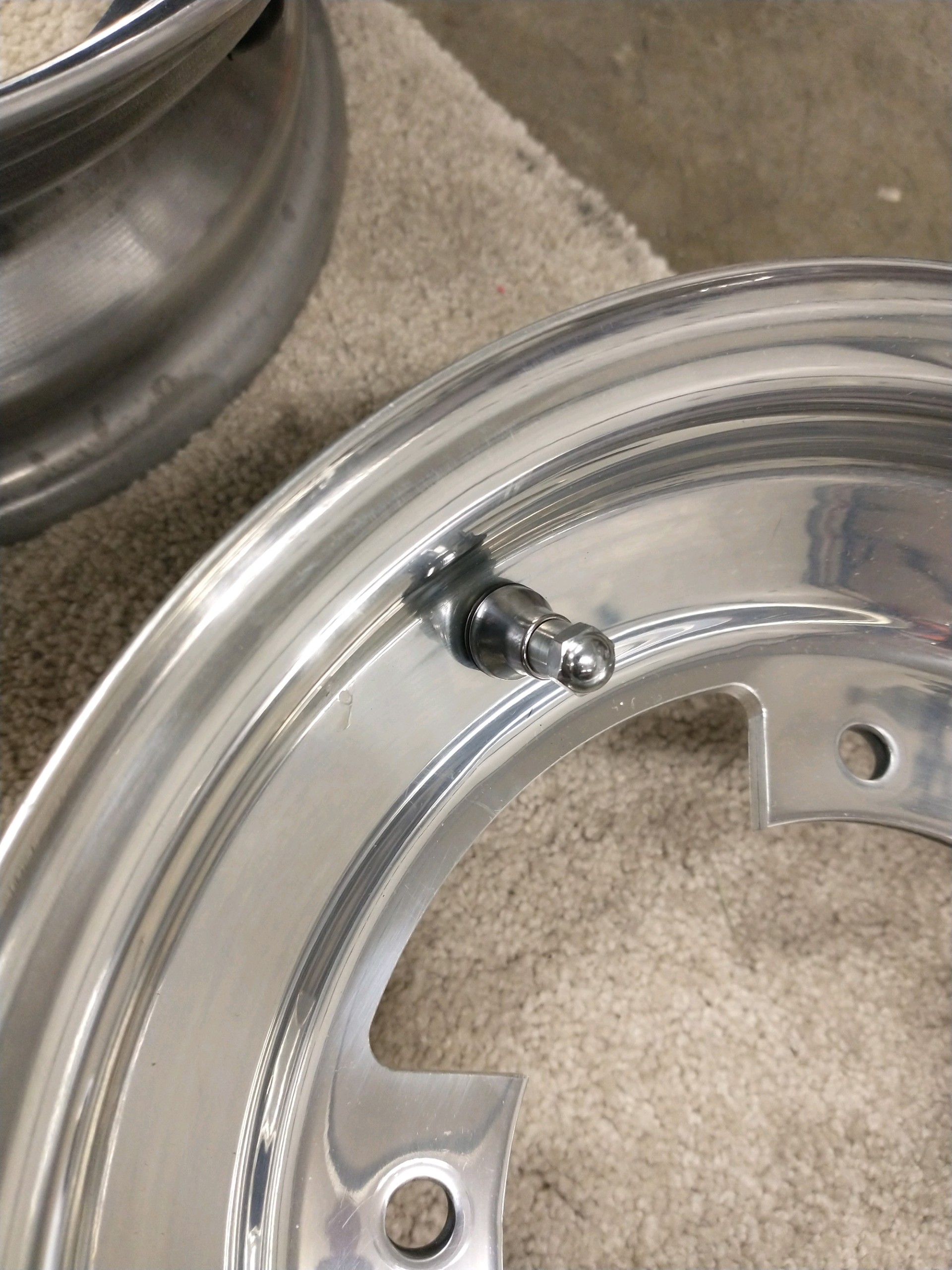

With the North vs South race coming up in a couple weeks, I wanted to be quicker again than I was the last time out. Weight, and especially rotating weight is an easy way to achieve this mission. I bought a one size smaller front tire, and a one inch narrower rim, that is already lighter than the stock ones, and then is CNC cut to take more weight out of it. Then, since the tread on the sides of the tire don't really do anything in my application, I borrowed Two-Stroke Tony's tire cutter and chopped all those off, but still leaving a little on there to not look too obvious. This has netted me 4.6lbs lighter per front wheel. So over 9lbs of rotating weight. I could have gone smaller and lighter, but it would have cut me out of at least one class I like to race, so this is where I landed. It definitely feels snappier on the street with this setup.
This will help it go quicker, but my racing advisory board tells me I need to be launching in 2nd gear and not 1st. 1st is too short, and since I changed the gearing, the 1-2 shift has become almost impossible to navigate under power. I think it just winds up too quickly now. I understand the how and why, now I just need to execute. This will be my focus at North South. I think it will knock another two tenths off my time and get me real close to the magic 4.0 second mark. We'll see how consistently I can launch this combo on a pro tree... I have tried it on the street several times, but won't really get any accurate feel until I'm on the dirt.
Otherwise the bike is basically ready to race.
