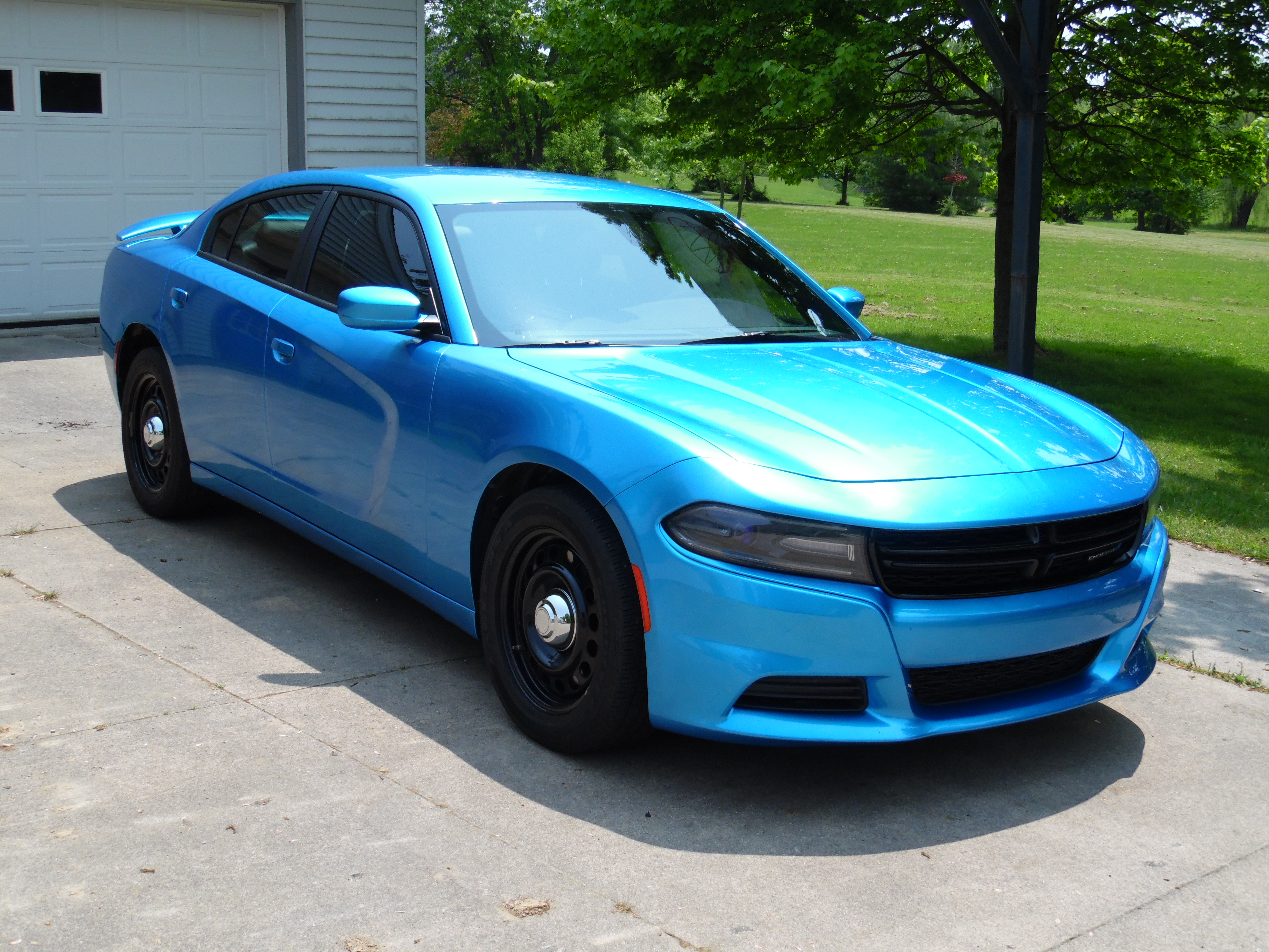

Over the past couple weeks I put the finishing touches on the car. Rear wing installed, Charger emblem added, front bumper cover on, cleaned up most of the dust and runs in the repainted parts until the sanding discs wore out. Removed the sticky stuff off the rear window. I also checked the rear toe in and it was spot on so there was no damage there.
Today I washed the car one last time before Rachel picked it up. We snapped a few pics.
Changing of the guard.

That thing turned out awesome. Great job! With that paint color, I really like the cop car wheels with poverty caps. I'm not a black wheels guy, but the steelies are cool with the blue.
Re: 2019 Dodge Charger
That's funny, 'cause I also thought those black wheels look really sweet on the blue car. Unique for sure!
Great transformation, almost can't believe it's the same car.
