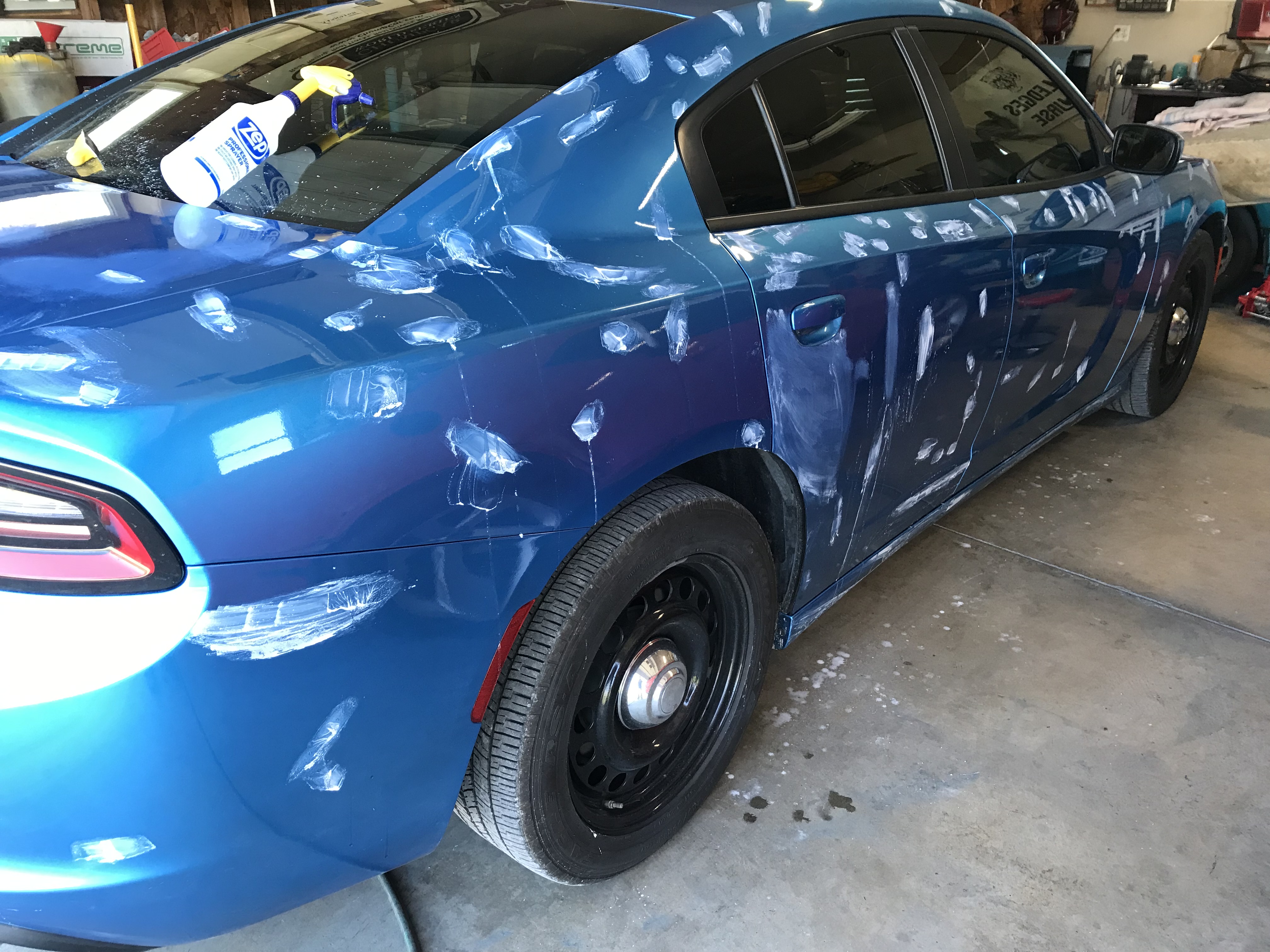

Updates:
* was able to push the dings out of the decklid and fill the remainder with glazing putty
* finished up the bodywork on the A-pillar with glazing putty
* there were two 3/8" holes in the rear bumper cover from police lights - plastic welded in some plugs
* also applied glazing putty to small ding in driver door and LR quarter panel. there were some gouges in the bumper cover and I'm risking it filling them with the glazing putty too.

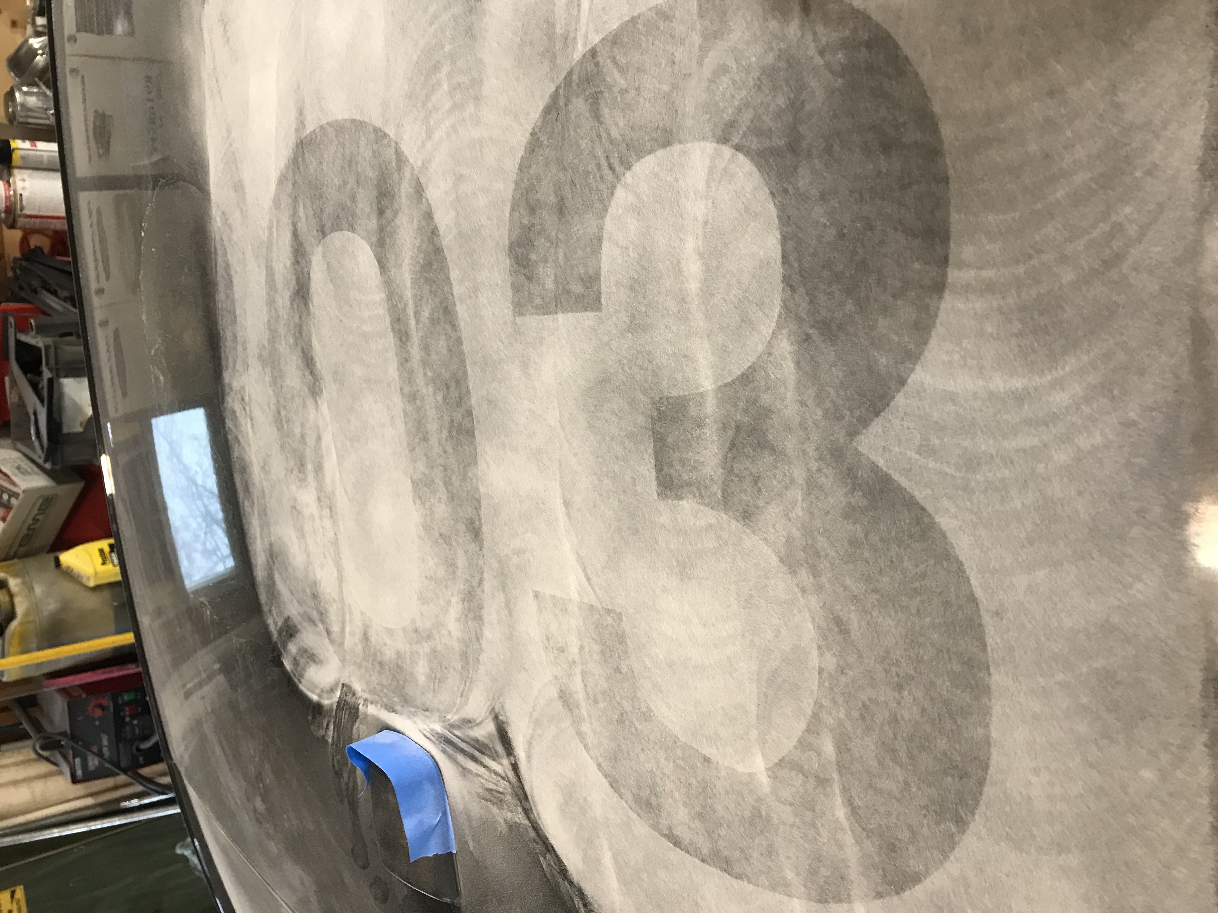

* lots of sanding. The police decals left a mark and I literally had to sand off the clear to eliminate it. Also sanded off the overspray from painting the bottom of hood and fenders, feathered out many spots with nicks and scratches. Finish sanded hood, frt fenders and driver side doors with 400.
every one of these pieces of tape was a scratch that needed feathered out

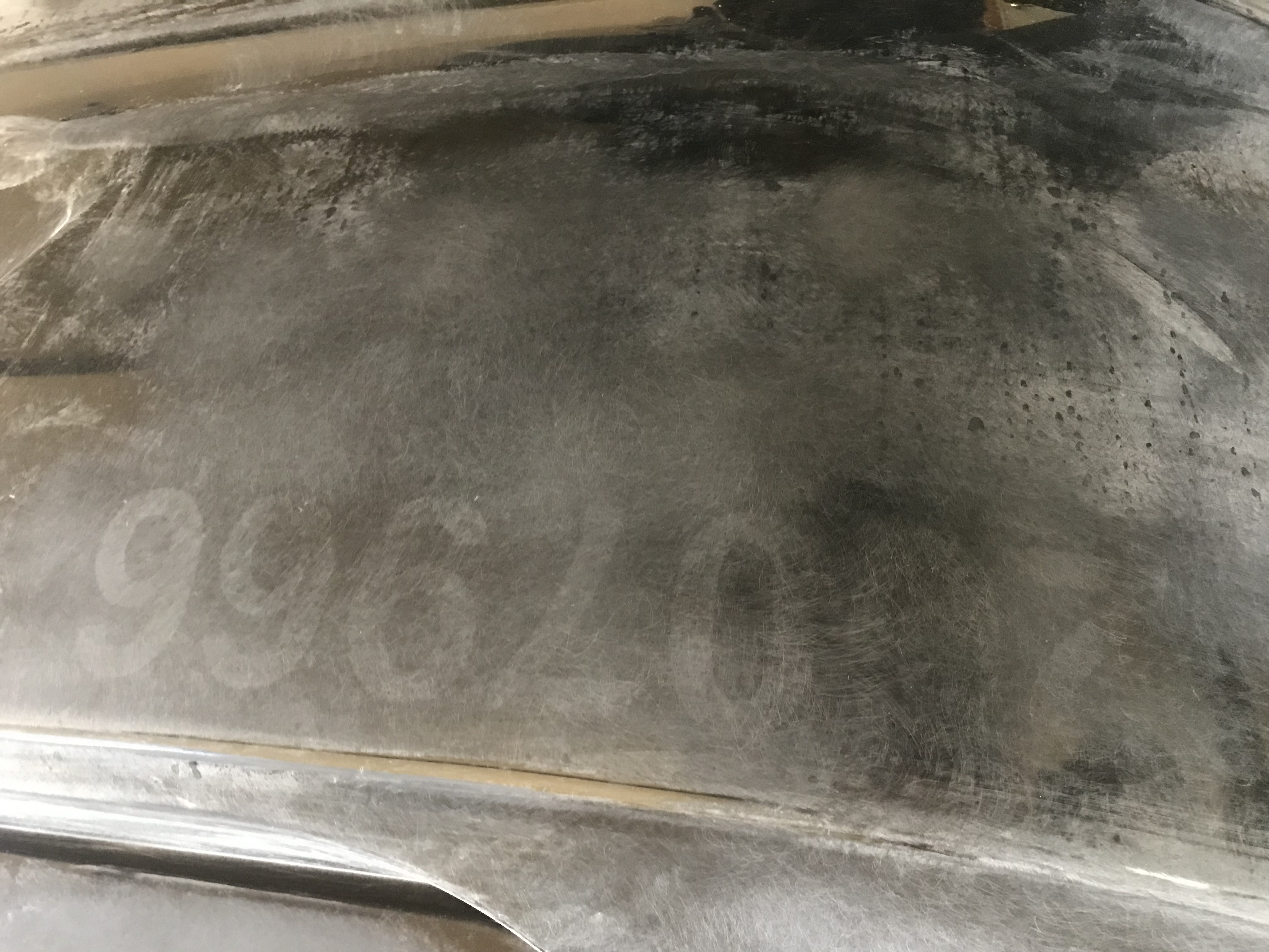

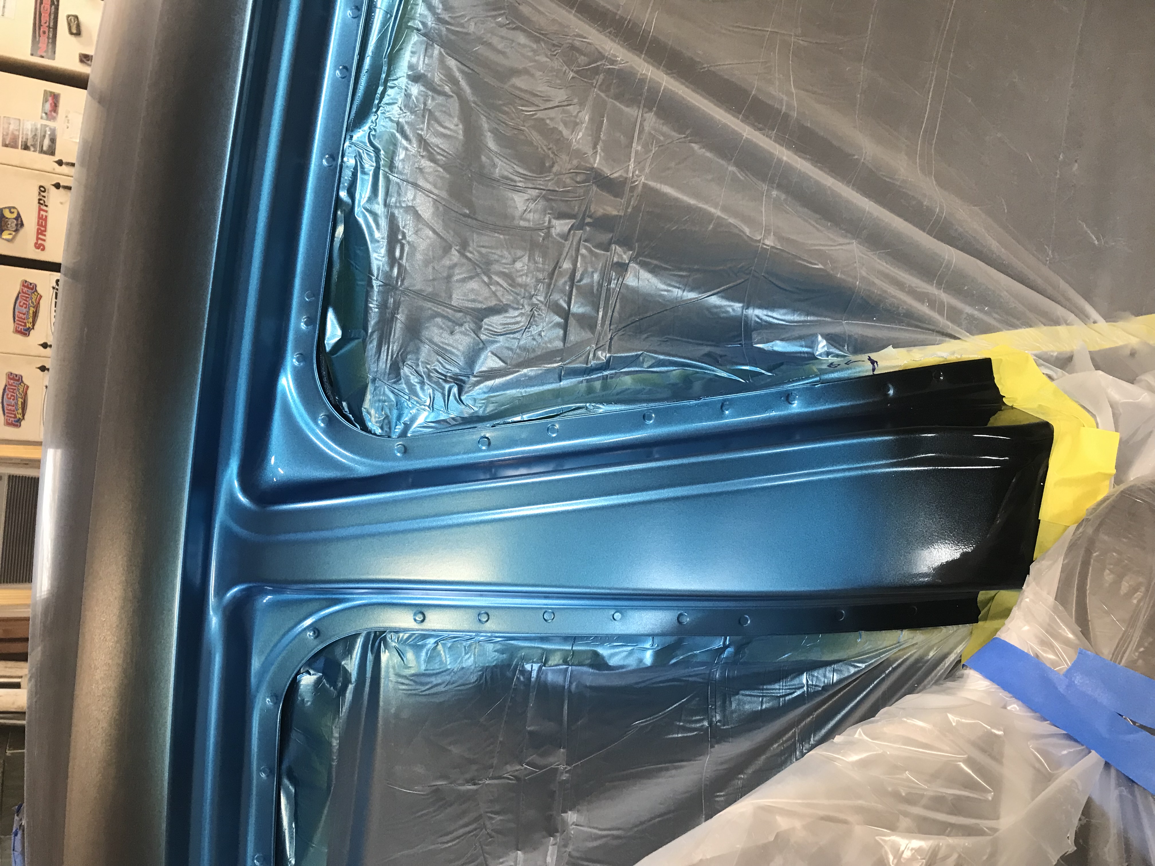

* Lots of sanding followed by cleaning and masking in order to paint top part of the door jambs. One of the challenges was sanding past the residual of the police decals - see below
* Paint the tops of the door jambs, followed by unmasking all that

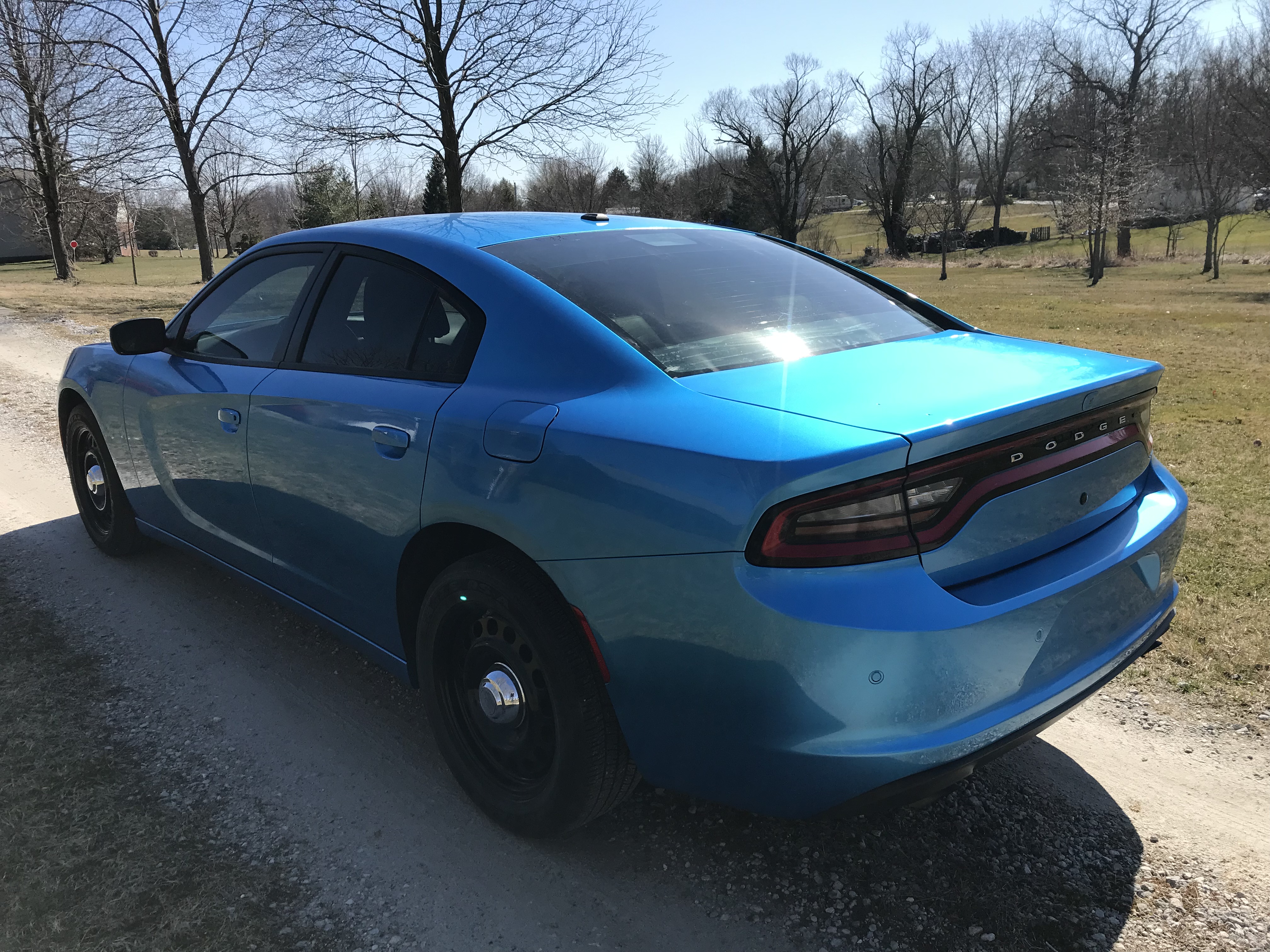

Paint is on and car is reassembled. Windshield coming tomorrow and off to inspection on Tuesday

Wow! It's come a long way. Pretty amazing. Great result!
Posts: 3648
Re: 2019 Dodge Charger
I think the wheels that are on it actually look really cool with the paint color. I wouldn't change them... Paint turned out really well.

The clear coat laid down quite nice so it shines really well. By no means is it perfect though. There are several runs in the clear that can be fixed with some fine grit sanding followed by polishing. There are several other problems but I'm going to have Rachel look at it and decide if it needs rework.
Rachel will be here on Sunday to see it.
She definitely wants some aluminum wheels. I really wanted to paint the wheels B5 blue to match - very retro - but she doesn't seem too excited about that either.
