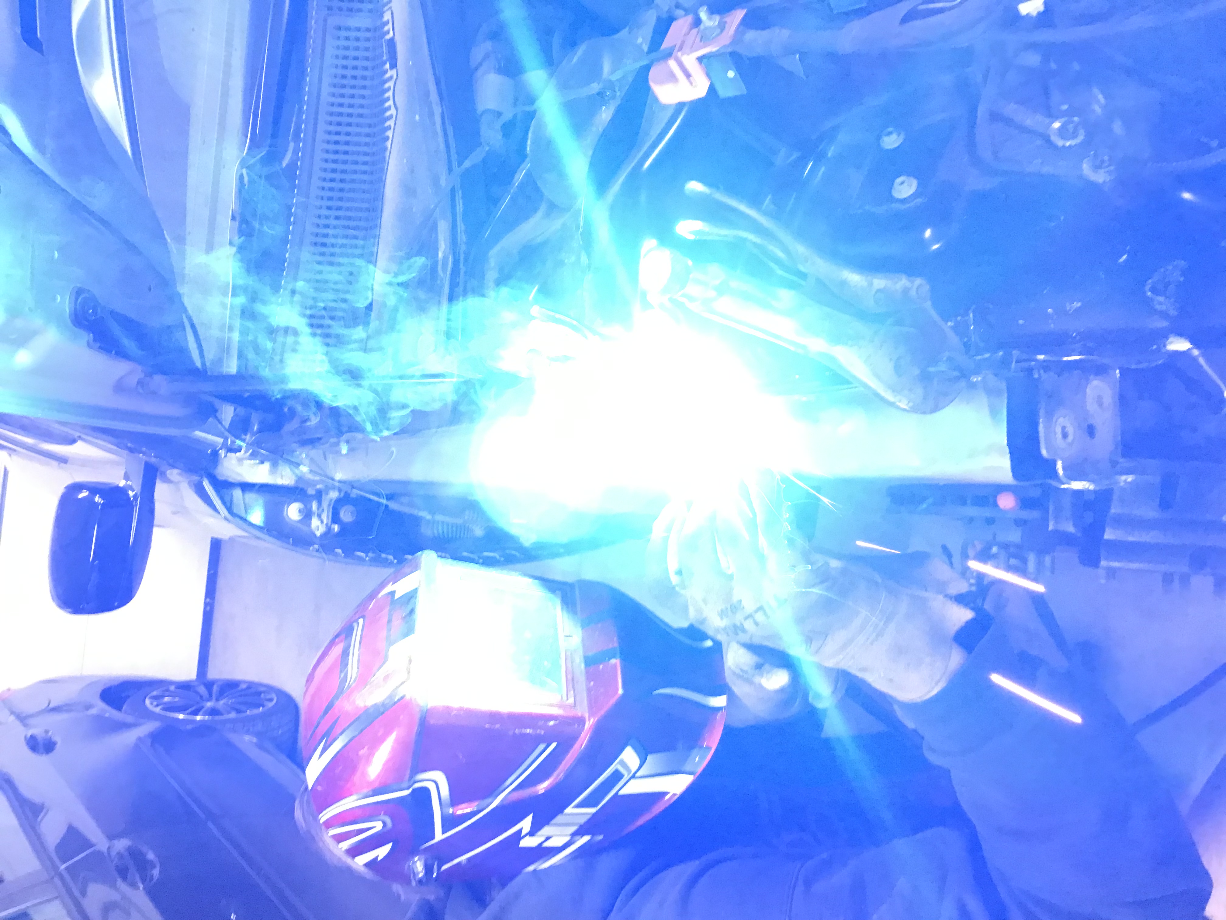

• Removed the front clip, prepped all surfaces, Kurt welded everything up

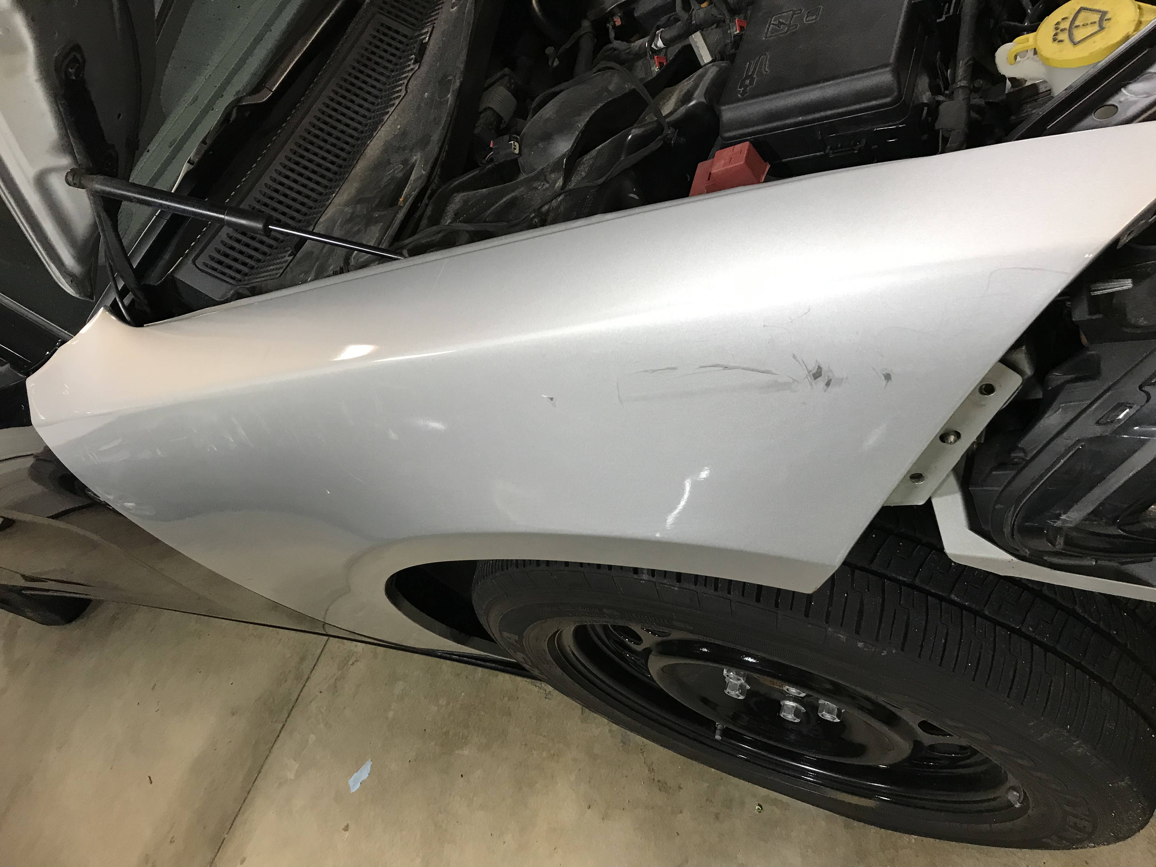

• Straightened some minor damage on the RF – put my newfound knowledge with hammer and dolly to work

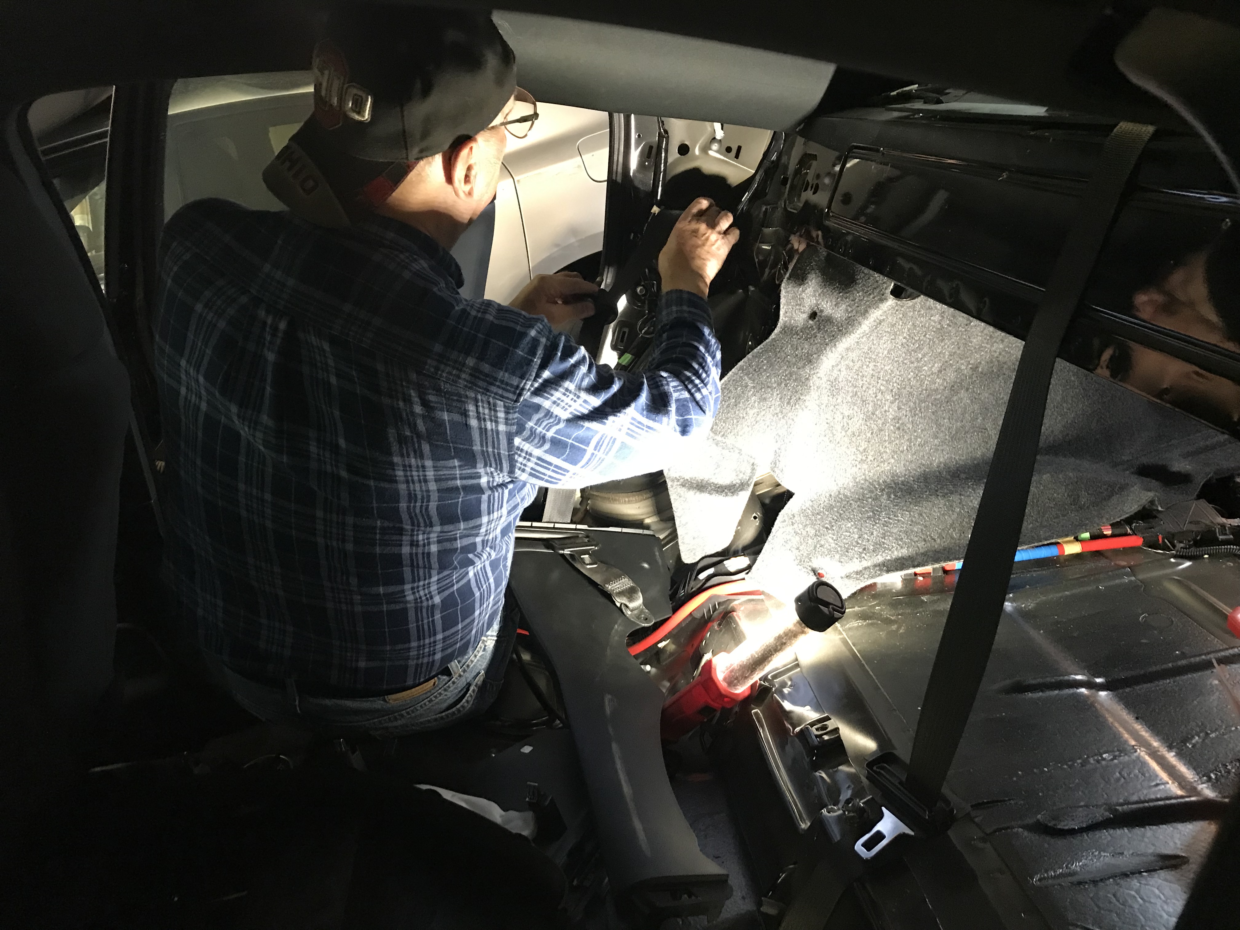

• Fred32v was over today and got the rear plastic seat/belts out and replaced them with the OEM seat and belt • Removed police wiring harness – this was over 20 lbs of stuff • Crossed the 100 hour mark on this project

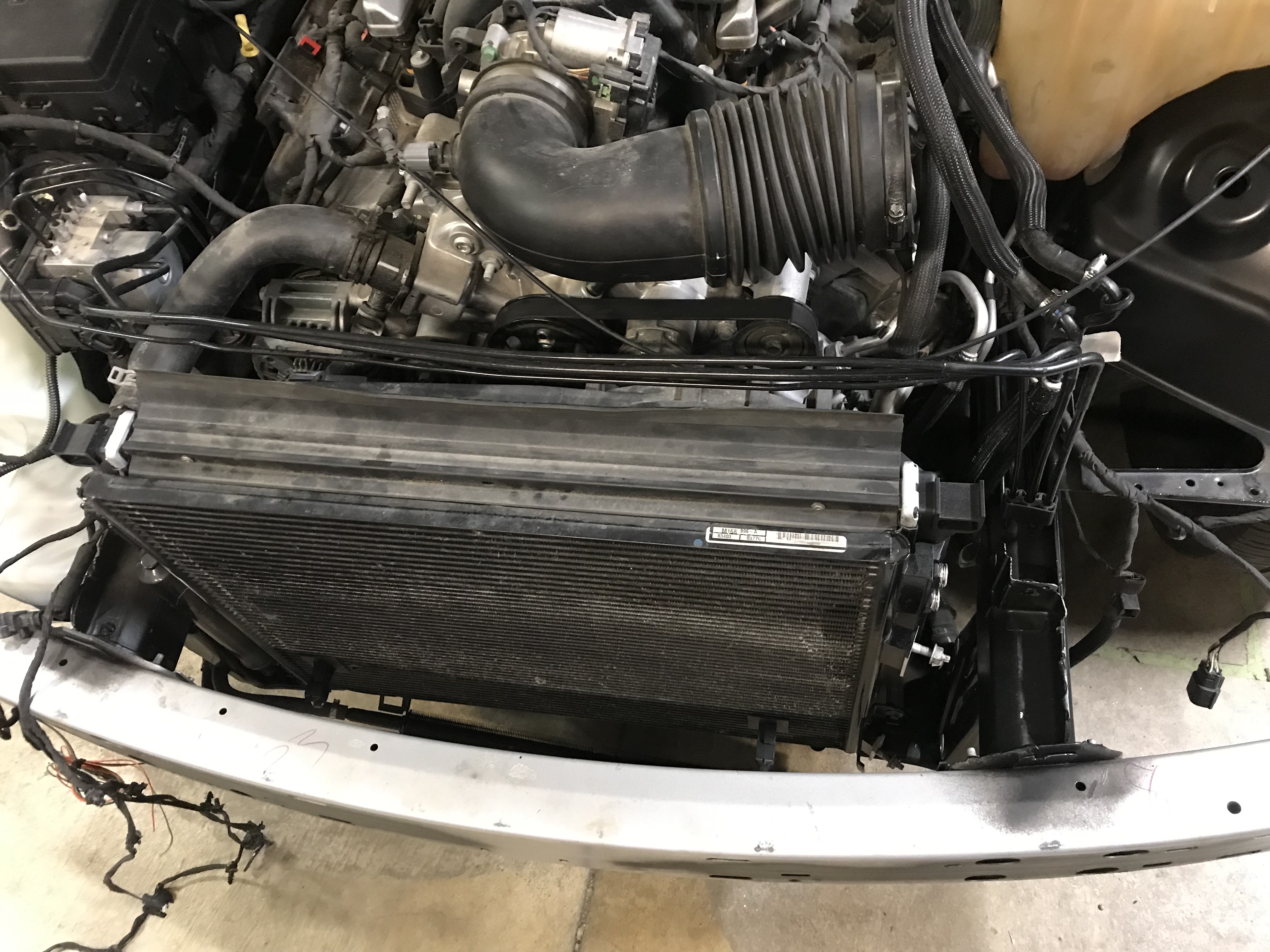

Updates:
* Radiator, A/C condenser, fan assembly completed and installed. The radiator from the parts car had an issue with the petcock so ended up ordering new radiator. With this done I could add radiator fluid and run the engine to test the cooling system. This uncovered a leak in the thermostat housing which was damaged in the crash. With some speedy dry and a quick trip to the parts car this was fixed. * Removed seat belts and driver air bags from parts car, and installed them. The connections to the steering wheel airbag melt when it deploys so the clock spring has to be replaced. This requires the wheel to be removed, but is actually quite easy just have to take care to keep the orientation of the wheel and clock spring right - again used a part from the donor car. * The parts car spent several days in the garage while I was fetching parts. I also chose to hang the old fenders on it to get them out of the way. Now the car is outside alongside the garage where I expect it will sit for some time. In addition I started to throw out a lot of the ruined parts I had removed and been holding in case I needed something. * While the steering wheel was off I removed the main bezel on the dash to clean up coffee. Coffee is in so many places. Coffee made it past the dash bezel to splash around on the internals like A/C ducting, insulation, dash frame, pretty much everything you don't see. If I ever estimate a coffee spill crash car again I'll add four hours to the estimate for cleanup.
* The control panel for the A/C and radio had quite a few sticky buttons due to coffee so I swapped in the same unit from the parts car. May try to clean the original.
* With the engine running I took the time to let it warm up a little and test things. The trunk release button on the dash does not work, dash lights for ABS, traction control and the airbag system are still on. There is a squeak from I think a pulley on the driver side of the engine. * To address the squeak I removed the idler and tensioner pulleys from the parts car. To address the airbag system light I removed the airbag control module I'm fairly certain the next step is to send this in for service. This was a royal pain due to it is located on the tunnel above the trans, under the dash, and it has some kind of rubber protective cover so you can't really reach the bolts in back holding it on. Well I had to cut the thing to get the rear bolts - and I question the value of it since there was coffee on the bottom of the module bracket.

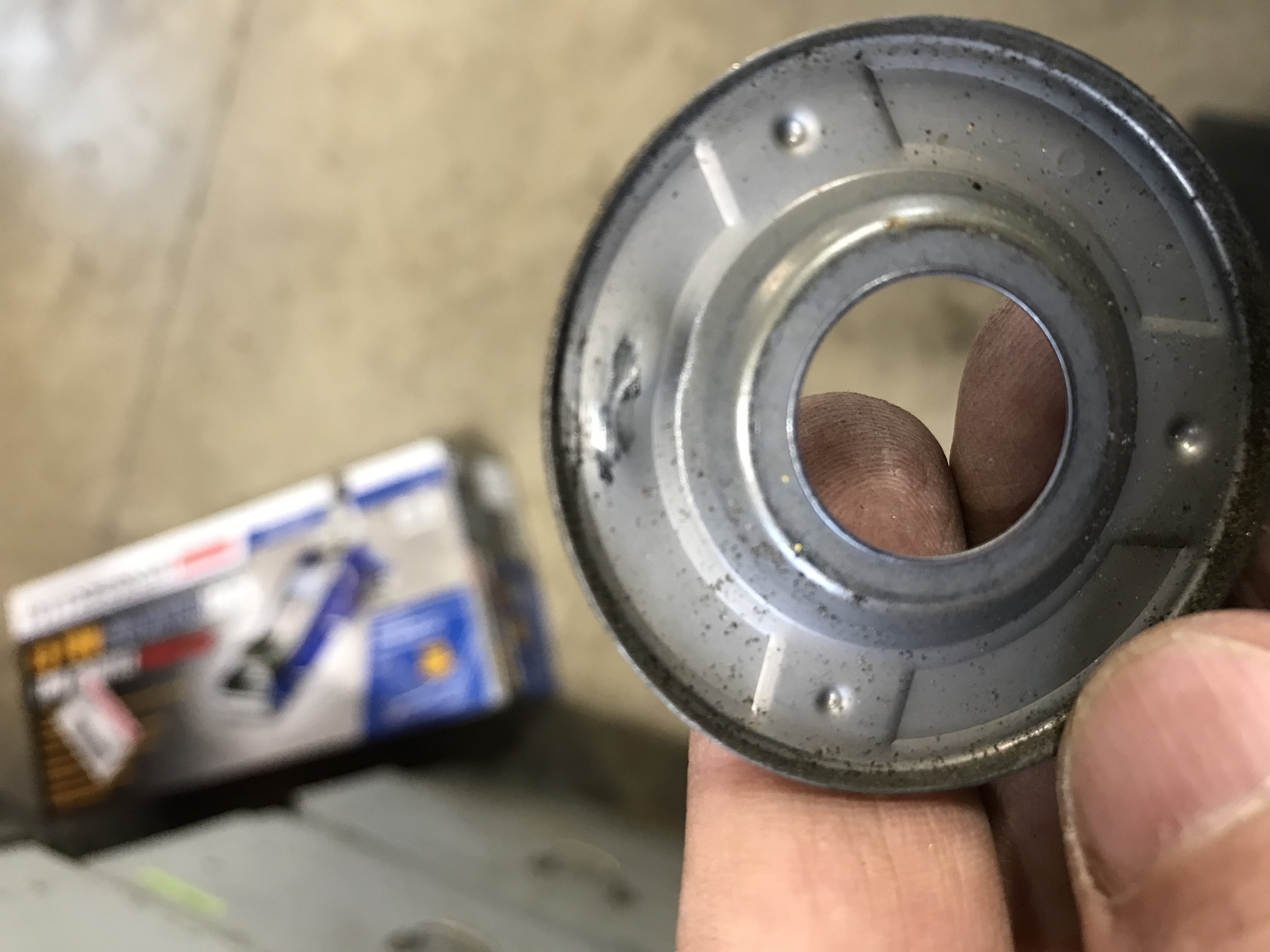

* The airbag module is out for service, expecting it back within a week
* Sold the light bar for $350
* Replaced upper radiator hose it had a small cut
* Replaced the dust cover for idler pulley - it was dented in the accident * Assembled the front core support - attaching horns, hood latch and other misc items

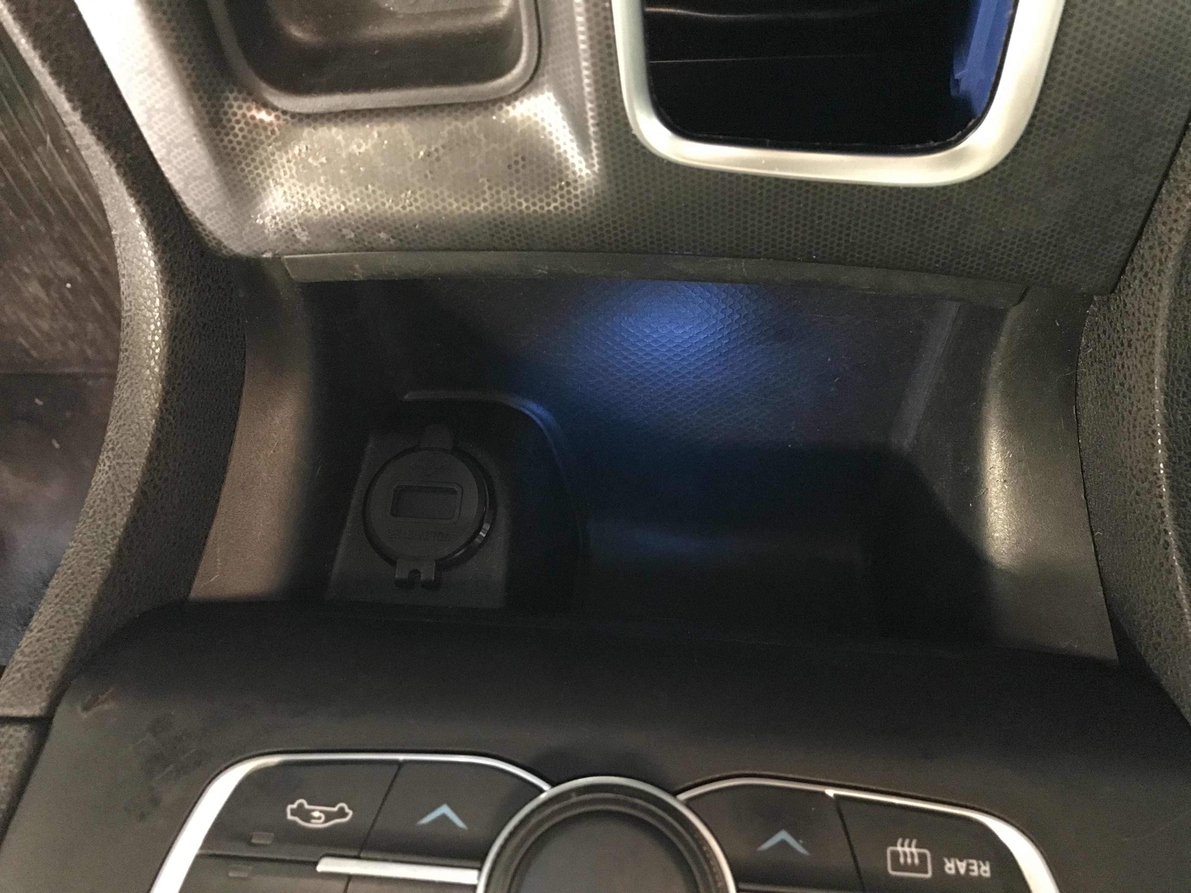

* Center console is done (almost)
Discovered there is a tray with a 12v outlet that I did not get with the console. on eBay this part is like $90! The whole rest of the console was $140
Wired in two USB charging ports - one in the back and one for the little console tray. Each has two USB connections.
Fabricated a mini storage bin to replace the original shifter location. Used a plastic storage bin from the Dave Bales collection.
The unit is installed and all powered items tested and working.
Once the console tray is obtained and installed this will be done

Latest progress:
* Interior
Obtained center console tray, remove factory 12v plug and replace with USB charging ports, and connected the courtesy light to come on when the doors are open
Did the final assembly of the console

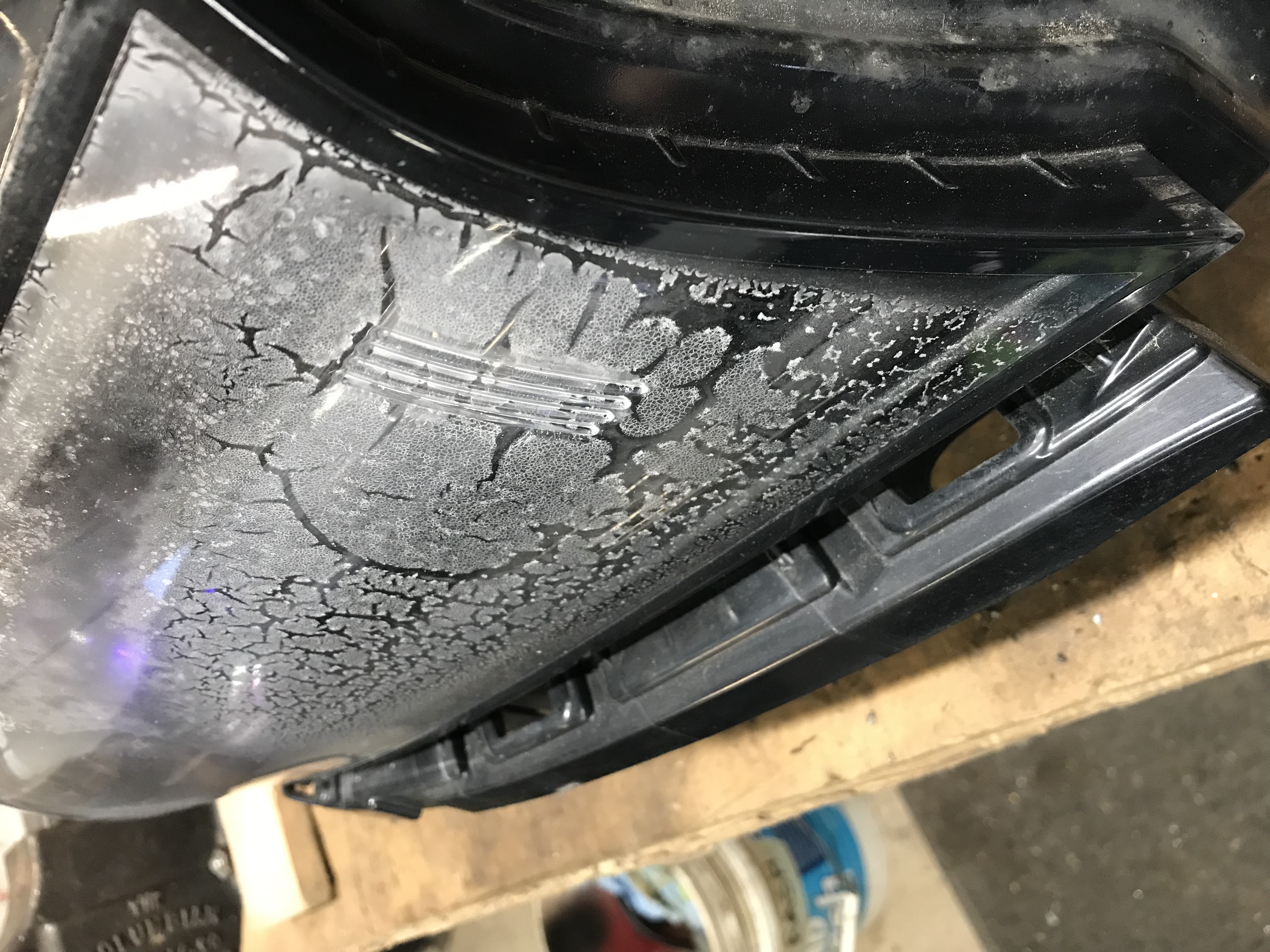

Obtained oscillating cutting tool and cut open the front headlights. The inside of the lens has some type of film on it that has dried up and cracked and fogs up the lenses. I cleaned up one of them.

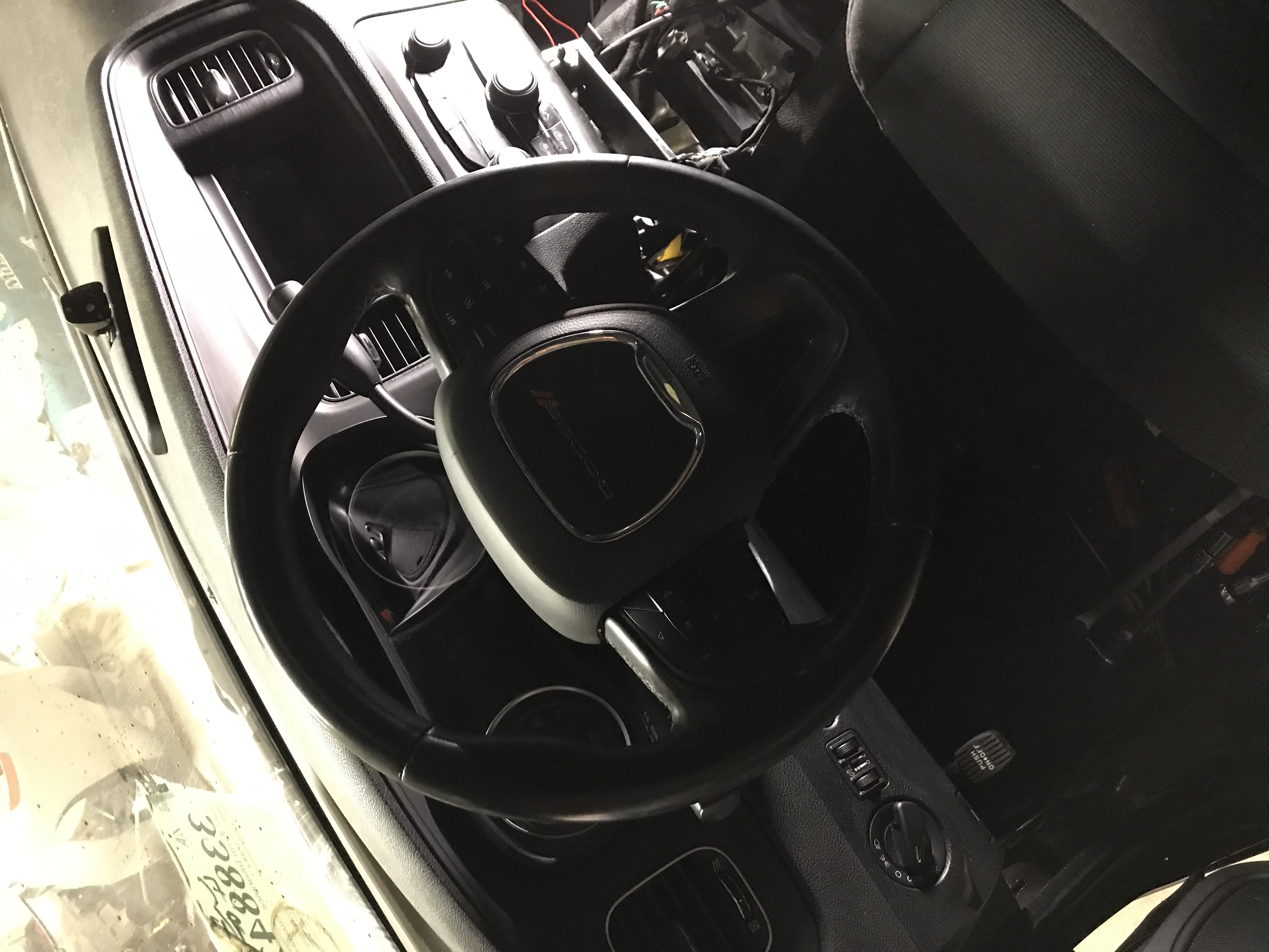

Removed the police spotlight. Obtained replacement A-pillar trim - will install after the A pillar exterior is fixed as I might need to go inside to install patch for exterior
Took another pass at cleaning up coffee - found it on the passenger visor, and in the air duct on passenger side among other places. I am basically done now though I expect it will show up in a few more places before this is over
RR window switch arrived and is installed
The LR interior rocker panel was not installed correctly so that got fixed
Excepting the A-pillar trim the interior work is I believe done.

Fixed the RF fender bracket it was pulled out a bit too far

- finish repairing headlight lenses

- A/C is evacuated, charged and functioning. Was able to recycle most of the refrigerant I captured from the other car. - Finished cleaning up inside of headlight lenses and reassembled. Used small pieces of wire mesh and newly acquired plastic welding tool (wide end soldering iron) to secure the connection in 5 places, followed up by plastic welding about 2/3 of it for rigidity. Finally followed that up with black silicon to seal it up. This was the last mechanical type thing to do on this car. When it’s done there may be an exhaust upgrade and different rims, but basically from here on in its bodywork. - A-pillar driver side trim installed
- Rear wing is fitted and installed – then removed in prep for paint - Learn the process required to get this inspected so it can go back on the road.

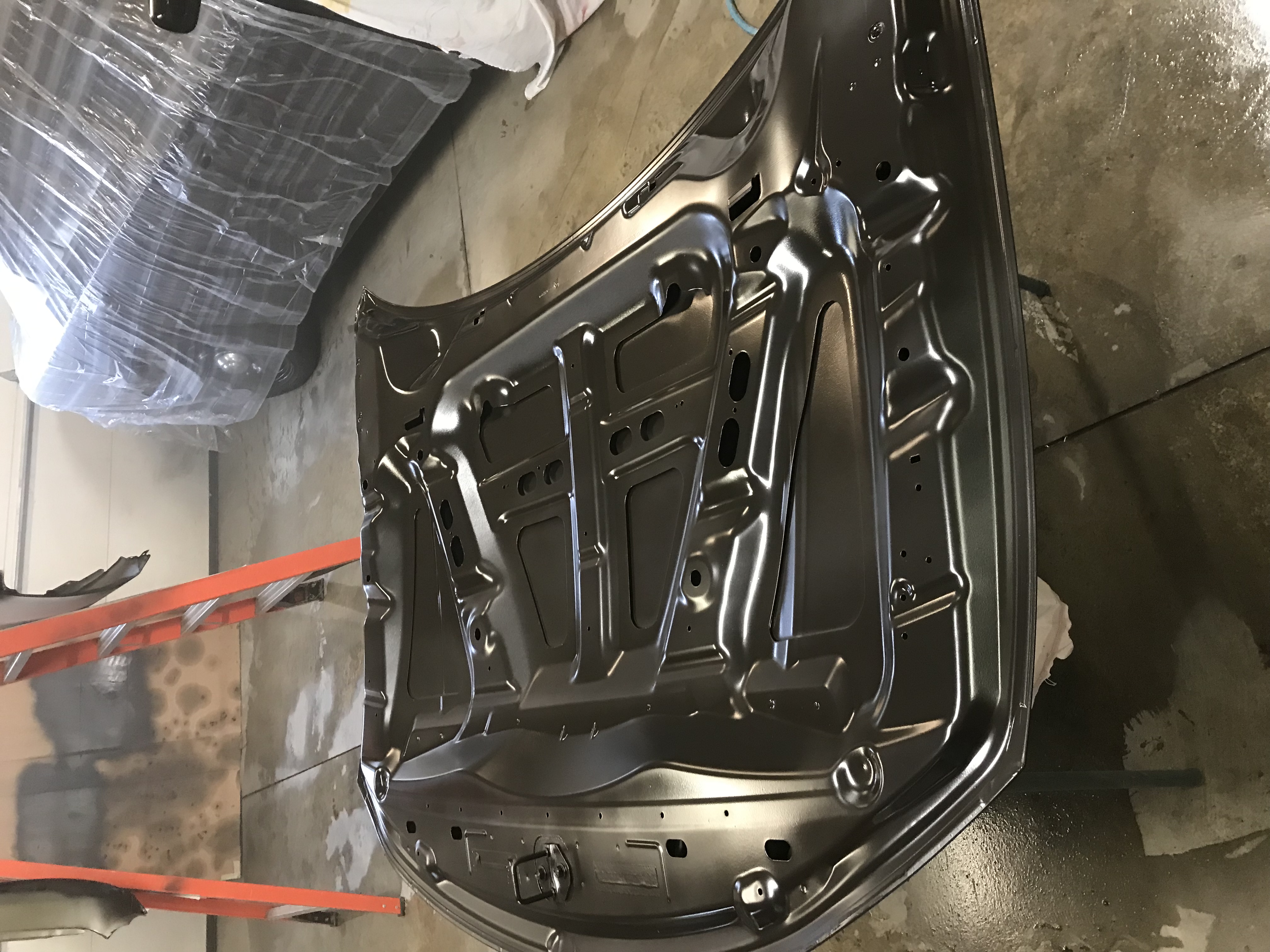

Put some color on the bottom of the hood and inner edges of the front fenders
