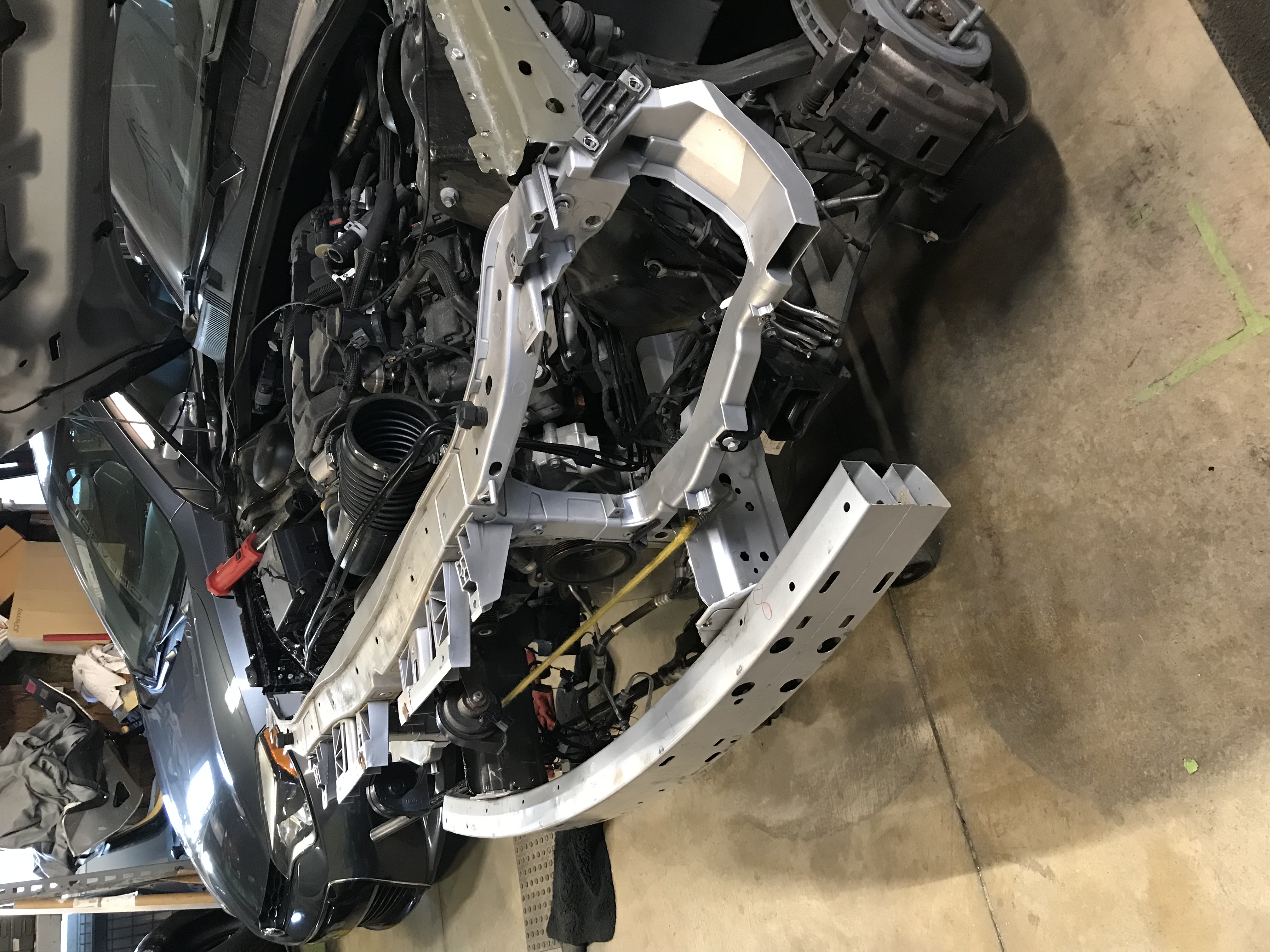

After that the first step is to get the car apart to get a good look at the damage. So the push bar, front bumper cover, front bumper, brake ducting and other plastic pieces up under the bumper cover, headlight, top half of core support, air cleaner, radiator, cooling fans are all off the car. The headlight is salvageable but the rest is pretty much trash. The hood latch cable is broken so it will need replaced
I have an extensive list of things I was planning to fix, and preliminary assessment has uncovered a few surprises - nothing to panic about as there is room for error in my plan.
1) + no holes in roof
2) + has front windshield light bar that we can likely sell - new retail is $1800 so maybe 1/3 to 1/2 that
3) + front subframe looks straight
4) + has inside rear door handles
5) - front windshield is cracked. I looked back at the pics and you can see the damage if you know what to look for
6) - RF fender is damaged
7) - leaking power steering fluid - power steering fluid reservoir is broken in two
8 - engine accessory belt is destroyed
9) - driver side tie rod is bent
10) - forgot we will need the spare cover in the trunk
I was happy to see no apparent damage to the engine up front.
I left the AC condenser in since it appears to have the transmission lines going into it, and the power steering cooler is attached to it.
Bonus light bars
Current state of affairs in the damage zone
Rachel said there would be a "pile of attrition" so here it forms
