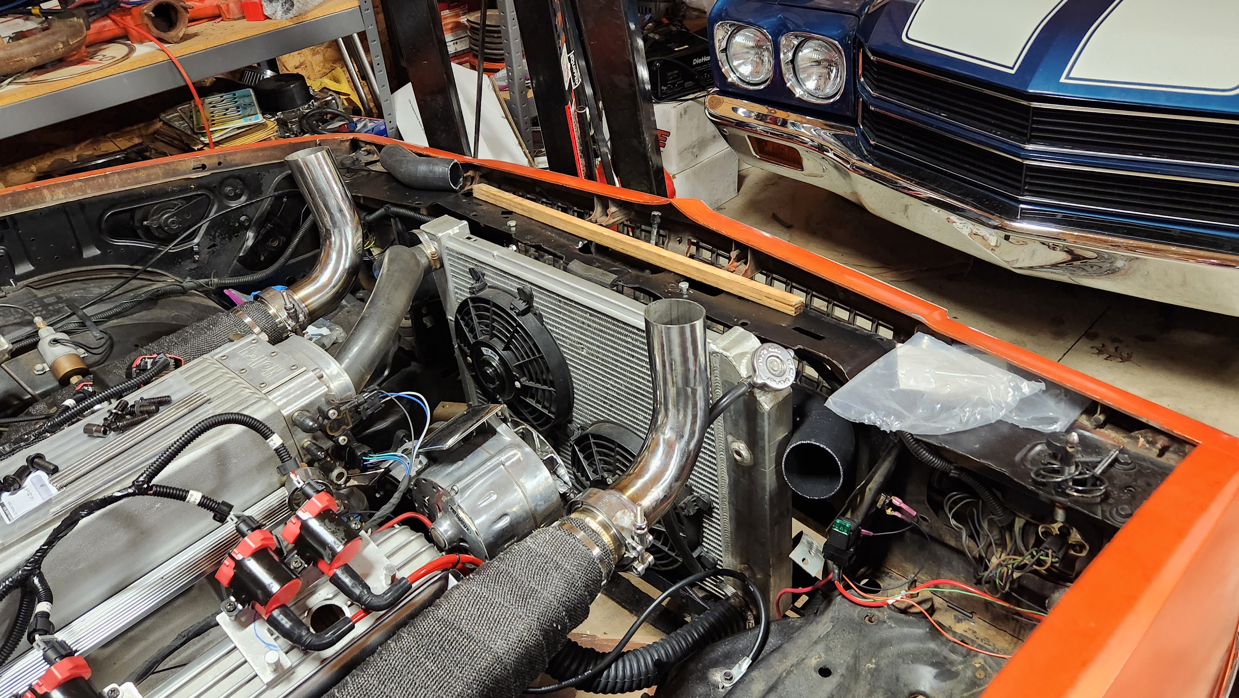

Alpha prototype.. spark plug wires will route around front and rear tubes of headers, instead snaking straight down between header and valve cover.

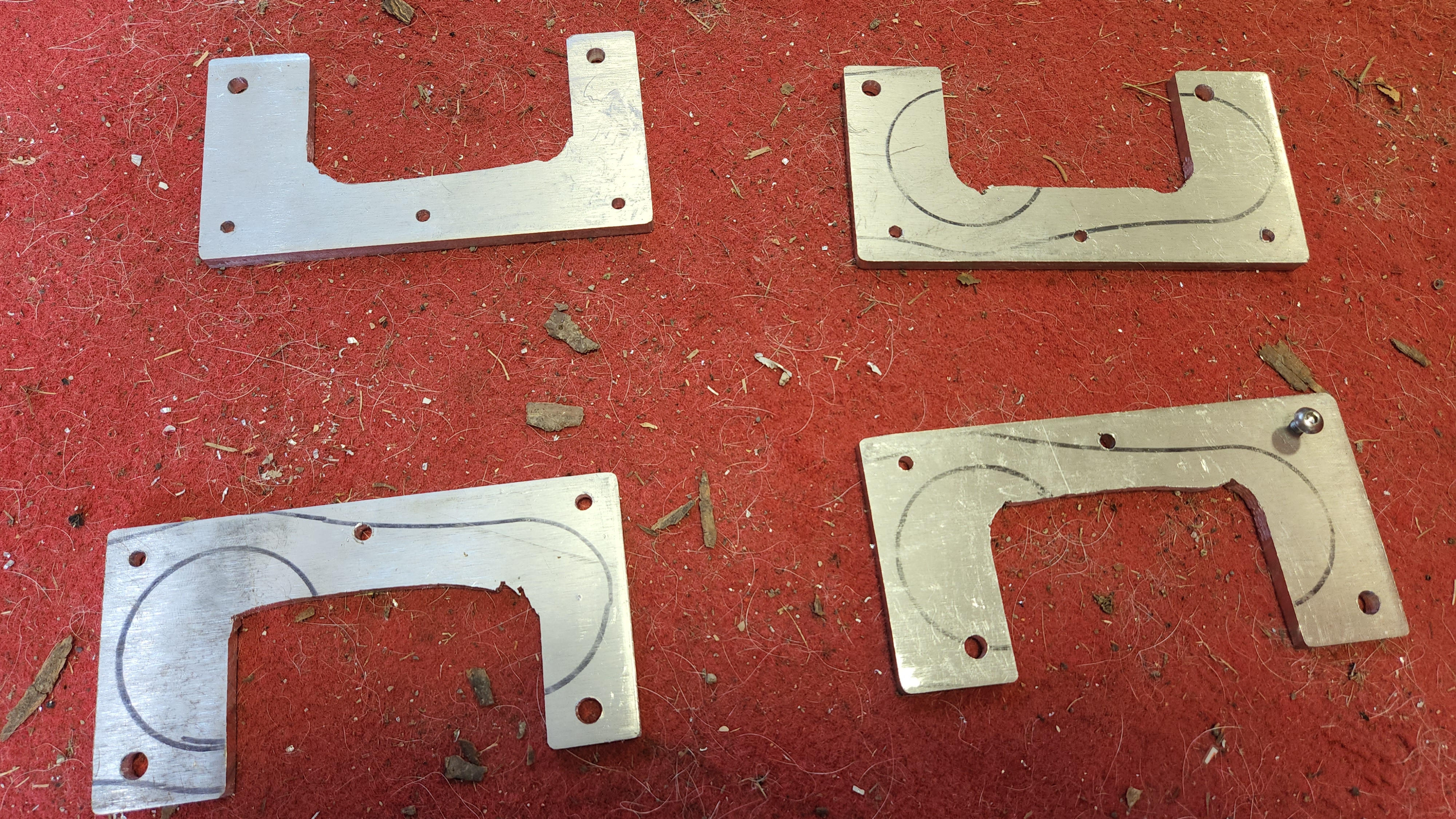

I made some coil brackets. They're not pretty, but I think they'll work. I'll get them all finished up and then finish off the new plug wires. I'm also going to use these talled, finned valve covers. As a bonus, I put my good EFI Connection coil brackets back on the Chevelle, which means I can put everything back together on that one.

Finished and ready to fire, save for longer studs for the valve covers. I dont want the coils flopping around. But otherwise done.
Fun facts I learned.. the spacing between the front two valve cover bolts is different than the rear two.., by about 5mm. I really need to space the coils further apart on the pairs that go around a PCV/breather hole. Also, those coil boots are so big and everything is sealed so tight, I end up having to 'burp' them with a small screwdriver between the coil and boot to let the air out. You can hear it.

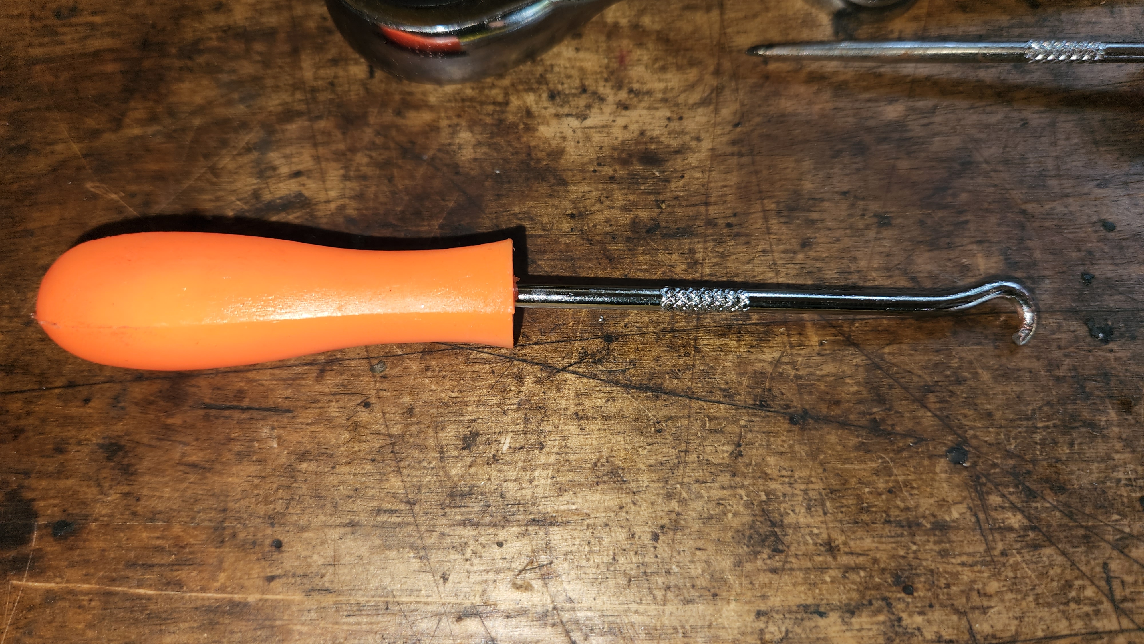

I modified one of my tools to have a small hook. This was huge in trying to get those 90 degree boots on the coil side. I fished my hook through the boot so I could pull on the plug wire while guiding/sliding the boot down the wire. (wd 40 to make everything slide easier) Otherwise, it's like trying to push a slippery rope. The spark plug ends are a piece of cake.

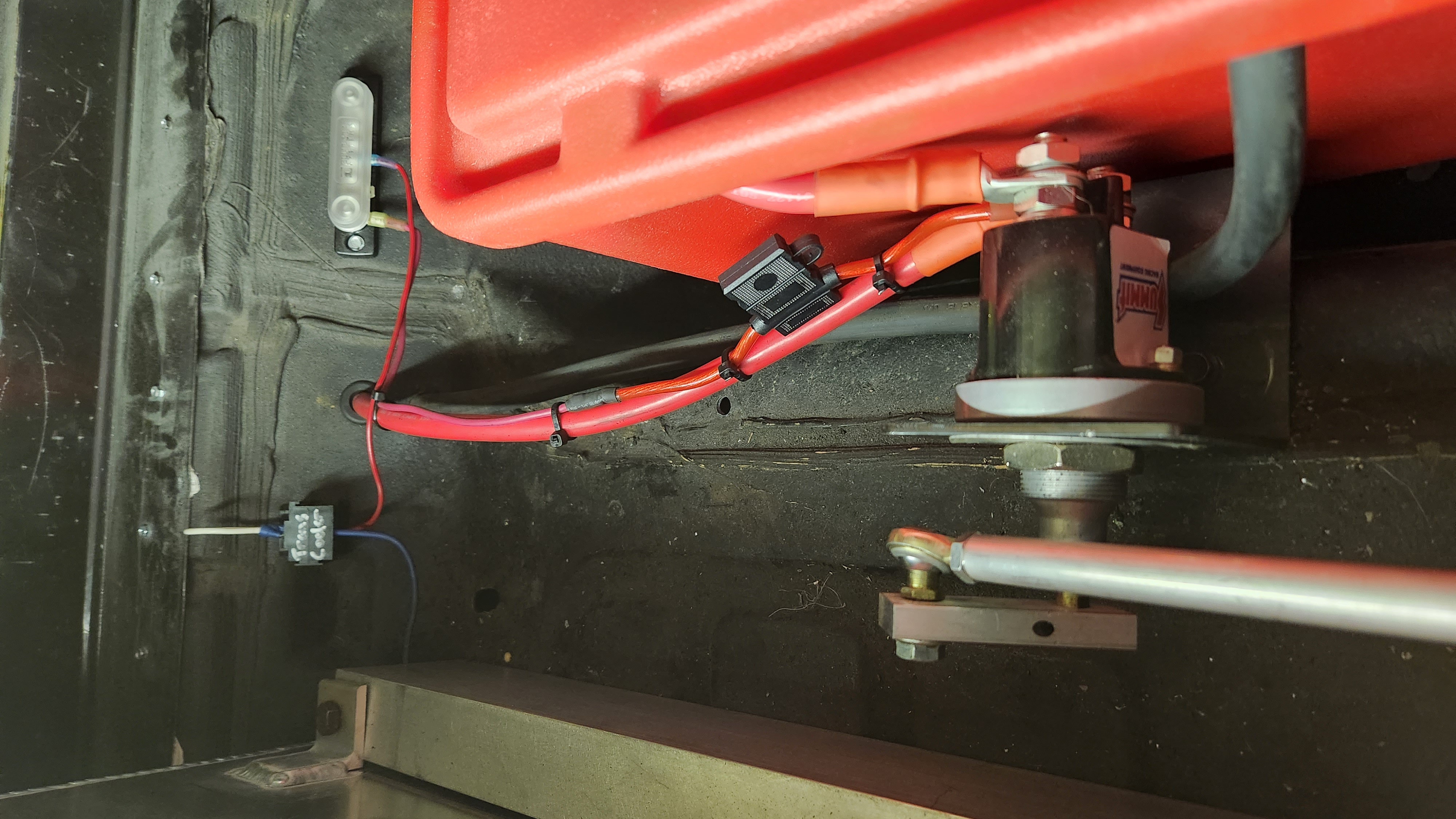

I've been working on finishing up more wiring. The Spartan WBO2 controller is done except for the status LED, which is optional. I'm 75% done with the transbrake and launch control wiring. I'm really curious to try this out. Line lock is up next.

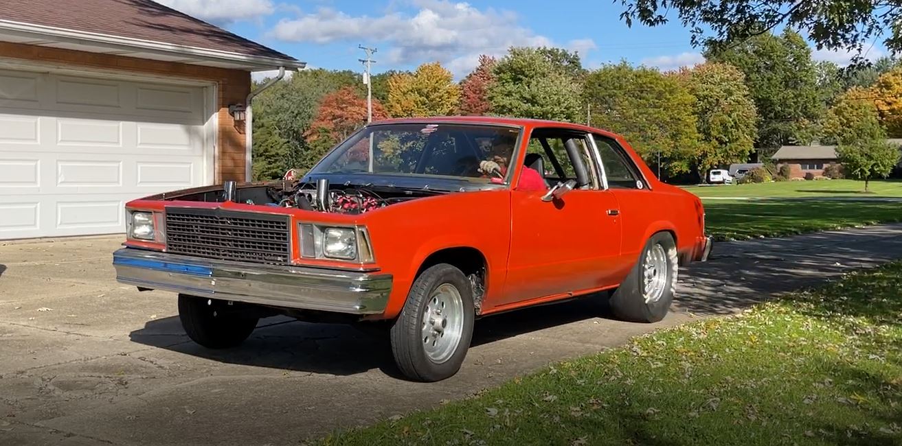

After I got home, Chris stopped over. We properly zip-tied the radiator in place and I pulled the car into the driveway and made my first holeshots with it!! It wasnt running super great, some stumbling and such. I was looking over my tune file tonight, after upgrading to the latest firmware and noticed the crank trigger was set wrong -- set to Rising Edge, needs to be Falling Edge. That's a major error. I also enabled the cam sync and was able to get it running in full COP mode, full sequential fuel. It seems to fire up better now. I actually never got the cam sync working and enabled on the Chevelle, so this is a first.
One problem exposed -- on a quick, and even slightly more careful inspection, the alternator belt looks right, but I saw a bunch of belt dust. Sure enough, the alternator looks a little crooked. I'll have to address that.
I'm going to play with it more in the driveway tomorrow, hopefully with the transbrake working.

Transbrake and Launch Control are fully wired! More driveway launches tomorrow.
